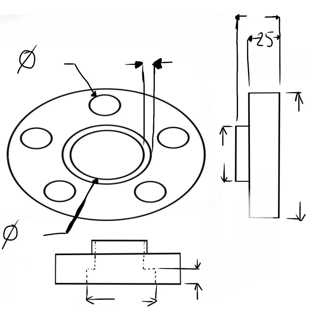

Can anyone with spacers do me a favour and fill in these dimensions please
Quick iPhone doodle :p
Would you recommend the above type with longer bolts or the bolt to hub type?
If you recommend the bolt to hub type what is the thread size?
The reason I'm asking this is we have a few blocks of aluminium at work that aren't being used, so I've got my eye on them to make some spacers.
Cheers :)

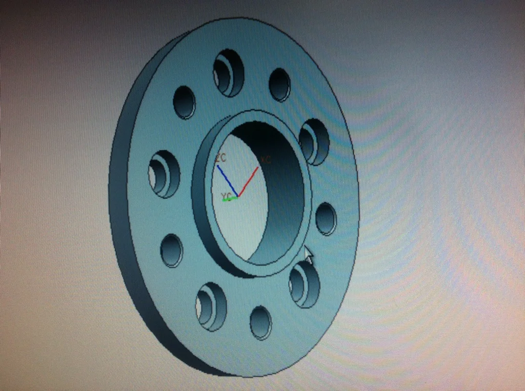

i was persuaded to make bolt to hub spacers... gonna whack a wheel off next week and design them from scratch to get a couple of dimensions im missing.
had 5 mins free in work so made this :p
my plan is to model it properly and get the stress guy at work to tell me if theyll be ok to use on my car (wont shear off and kill me)

If your making from aluminium id certainly make the design that uses longer wheel bolts, bit dodgy (imo) having the bolts screw into the alloy and holding the wheels on.
  phase 1 flamer 172
Theres no extra stress if the bolts are tight i wouldnt think, and yes they may be made from alloy but do you know the grade/type.
