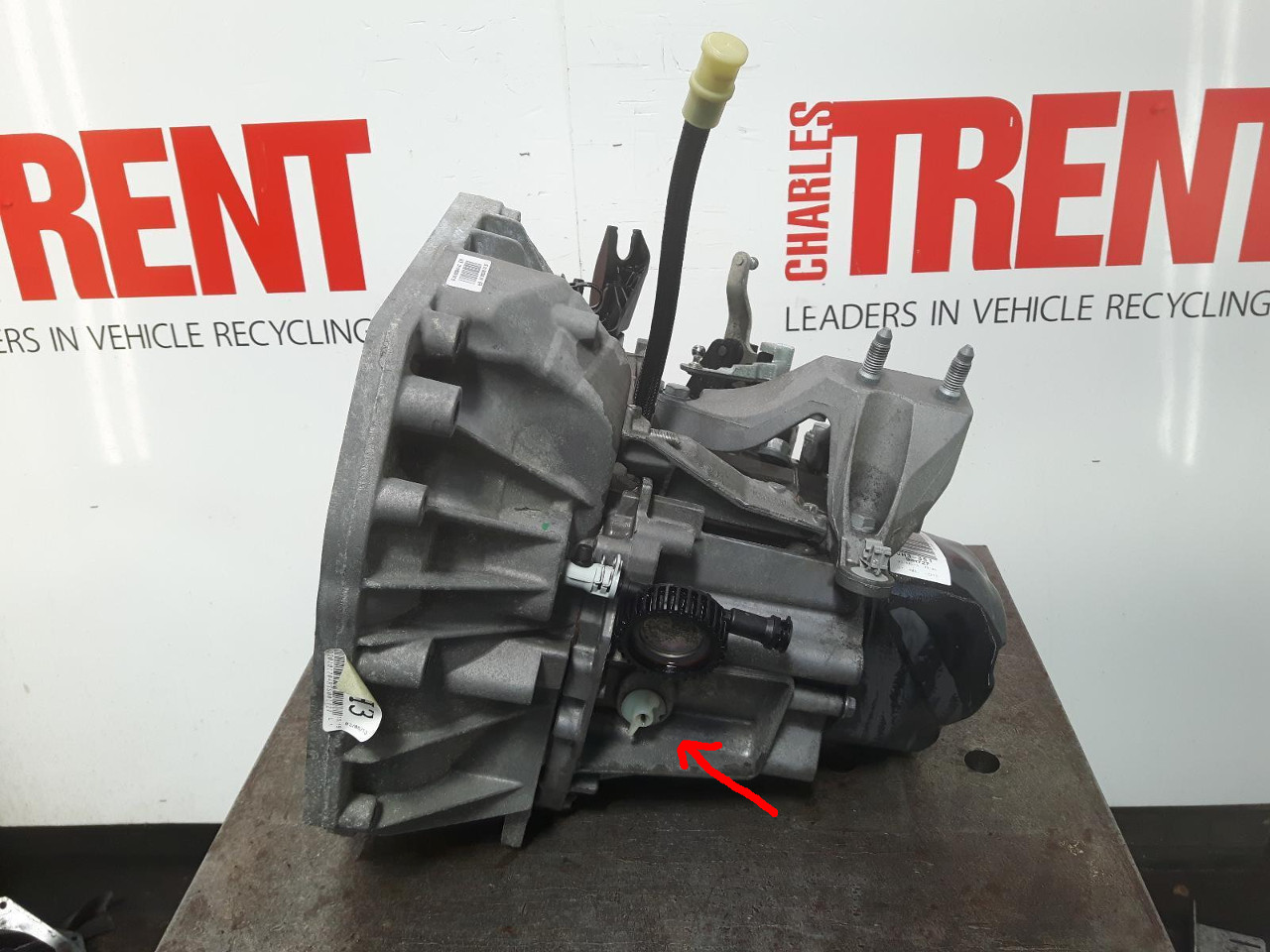

I'm a brand new member here, and a brand new owner of a 0.9 TCe (2013 35,000 miles). So I decided to do an engine oil + filter change. A simple job I thought. However I made a stupid mistake and undid the gearbox oil drain plug instead of the sump plug! Before I'd realised what I'd done the gearbox oil was drained. Therefore my question to the knowledgeable folks here is how do I refil the gearbox with oil?, as there is no obvious filler/level plug. Its the 5speed manual box, and any advice would be gratefully received.

Is there nothing about halfway up at the front of the box for filling it?

Plastic wing nut on the front of the box?
