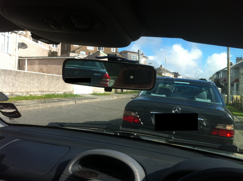

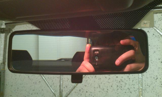

Driver's view

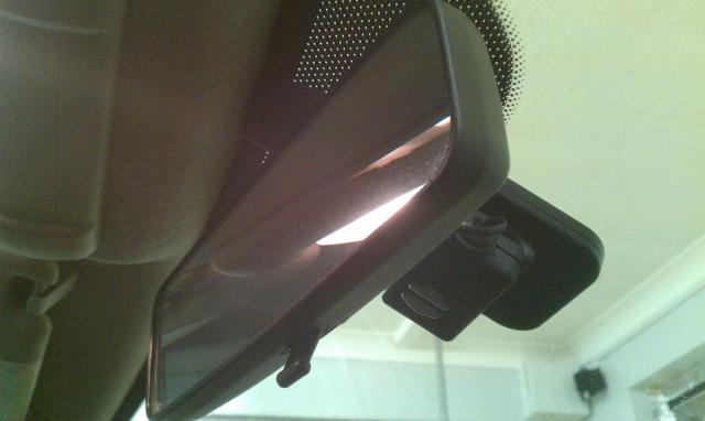

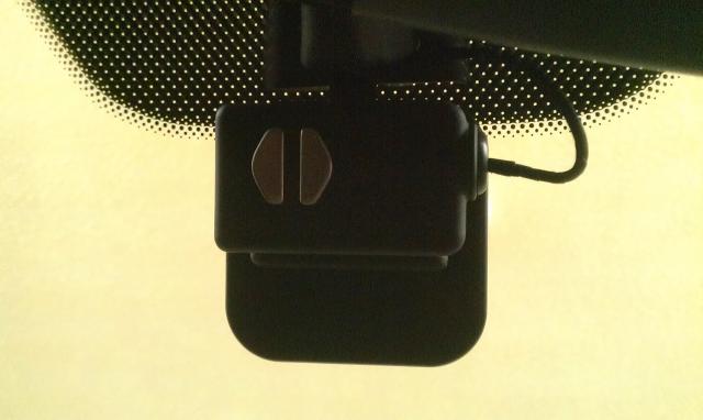

Behind the mirror

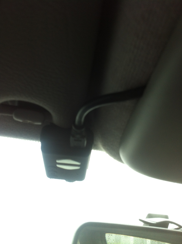

Exterior

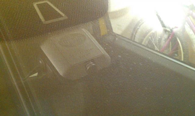

It's not 100% yet, I could do with dremelling some more of the GPS case away to lift the lens up slightly and possibly move it back so that it's not in contact with the window. At the moment it captures the top of the dash and ideally I am going for just the bonnet with maybe a thin sliver of dash.
The GPS case literally just slides between the window and a small mount on the back of the mirror, which pushes it against the windscreen. The body of the camera is fixed with velcro to the mount, so it should all be easy to take out if the velcro stays put. I found a nice fitting grommet to fill the hole where the lens originally was and used the original GPS grommet where it runs into the GPS case.
There is wiring going to the GPS receiver so it might be possible to wire it in properly, but I have no real clue so I'll stick to batteries for the moment!
I think there might be enough room to fit the innards of the camera into the GPS case along with the lens, sorting the buttons and heat sink would be hard the hardest bit. Memory card could just stay in there and I guess the USB could be sorted with a short mini to female USB cable, would take more space up inside though unless I cut another hole into it.
For now I'll just get the lens pointing where i want and make sure everything is secure for Oulton Park next Friday!
