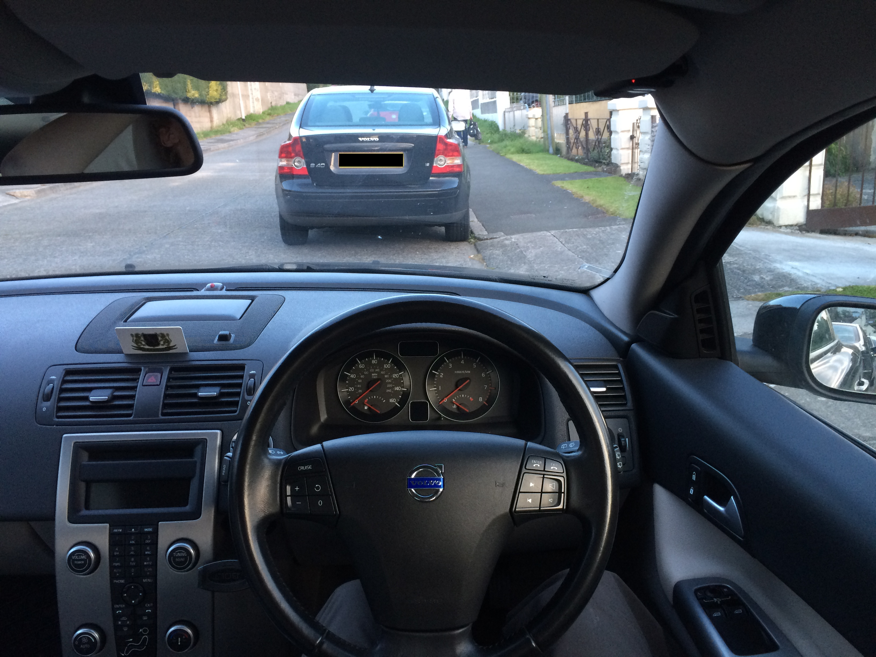

@McGherkin Can you take a pic of the mount from the side (appreciate it wouldnt be easy) - just wondering what angle it's at as my mount appears to take up far more room than yours!
  997, e208, I.D. Buzz
From windscreen to base of the mobius is around 5cm, yours looks much 'shorter'
I'll get a pic of mine when I go out shortly.
