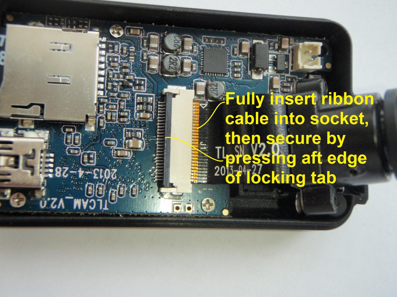

I have just fitted a Mobius as a dash cam and all the highlights (ie clouds, sky etc) are showing up as pink any ideas why this would be like it?
Can you post a screenshot?

This is what I am on about, looks like a thermal imaging camera

Psychedelic colors may also indicate problems with the CMOS lens module. Make sure the CMOS lens cable is correctly seated and not cracked. The lens cable is very fragile.
I'd try and see if it's saveable. Re-seat the ribbon cable and hopefully that'll fix it.
Worst case scenario is a new CMOS sensor. If it's brand new and you can't fix it I'd send it back/ask for a refund though.
