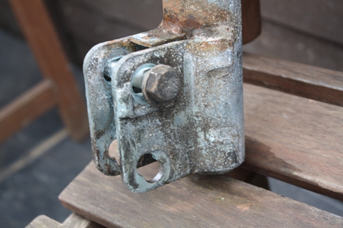

You need to drill out the shock Mike to slot the hole, but the way in which you do it will reduce your ability to adjust camber.
KTEC coilovers are done like this. Simply re-drilled for cup packed 182's.
Here you go -
The lower hole is a sideways 8 silhouette.
By moving the lower hole down and inwards, you immediately reduce the camber.
To move it down and outwards would put too much stress on that thin bit of mounting plate.
Big washers or small plate welded onto the strut will be the strongest idea, then you can make big long slots for loads of camber adjustment.
It all depends on what coilovers you are modifying and how much material there is to play with.
Here you go -
​is that way safe?
