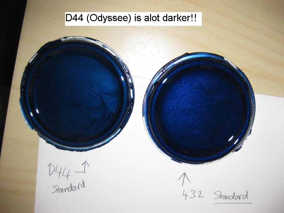

My ph2 is odyssee blue and from what i know they don't do ph2 sports in odyssee (correct me if i'm wrong). But was just wondering how much colour difference is there between monaco blue and odyssee blue? As i'm after a 172 rear bumper but dont want the expense of respraying the bumper.

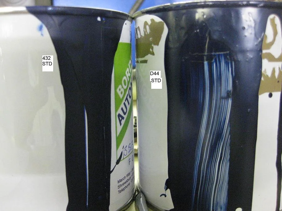

As im in the shop today, heres a picture from the tins. (Both are standard shade)
D44 is quite a bit darker, if you can find something in Monaca(432) dakrer shade you might have half a chance of it looking "reasonable". Heres the MIX for both paints......as you can see very different.
D44 =========

432 (Monaco) =================
