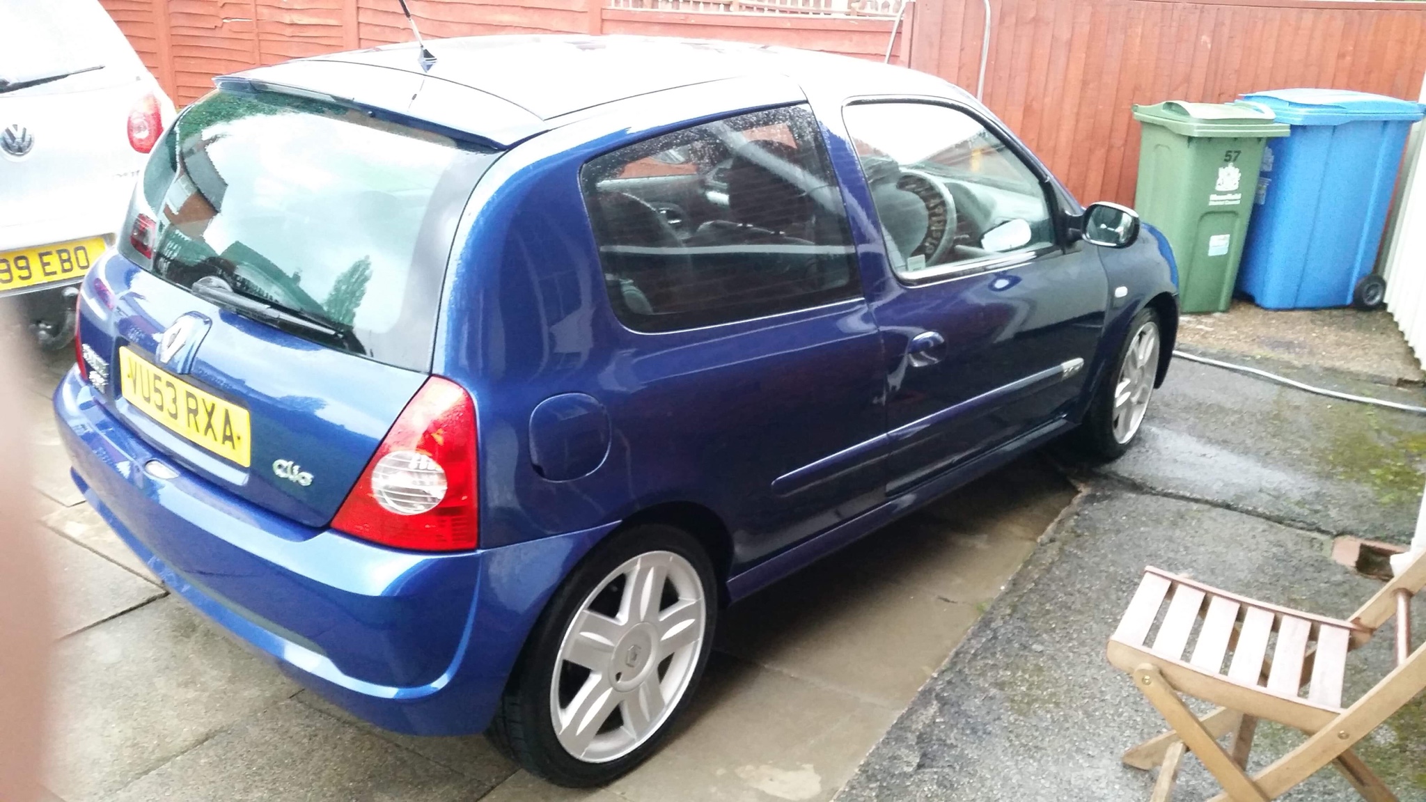

Back in 2015 I bought a dCi 100 for pennies, it’s now on 243k and I have it where I like it. It’s taken a few years and a lot of miles to make it look alright.

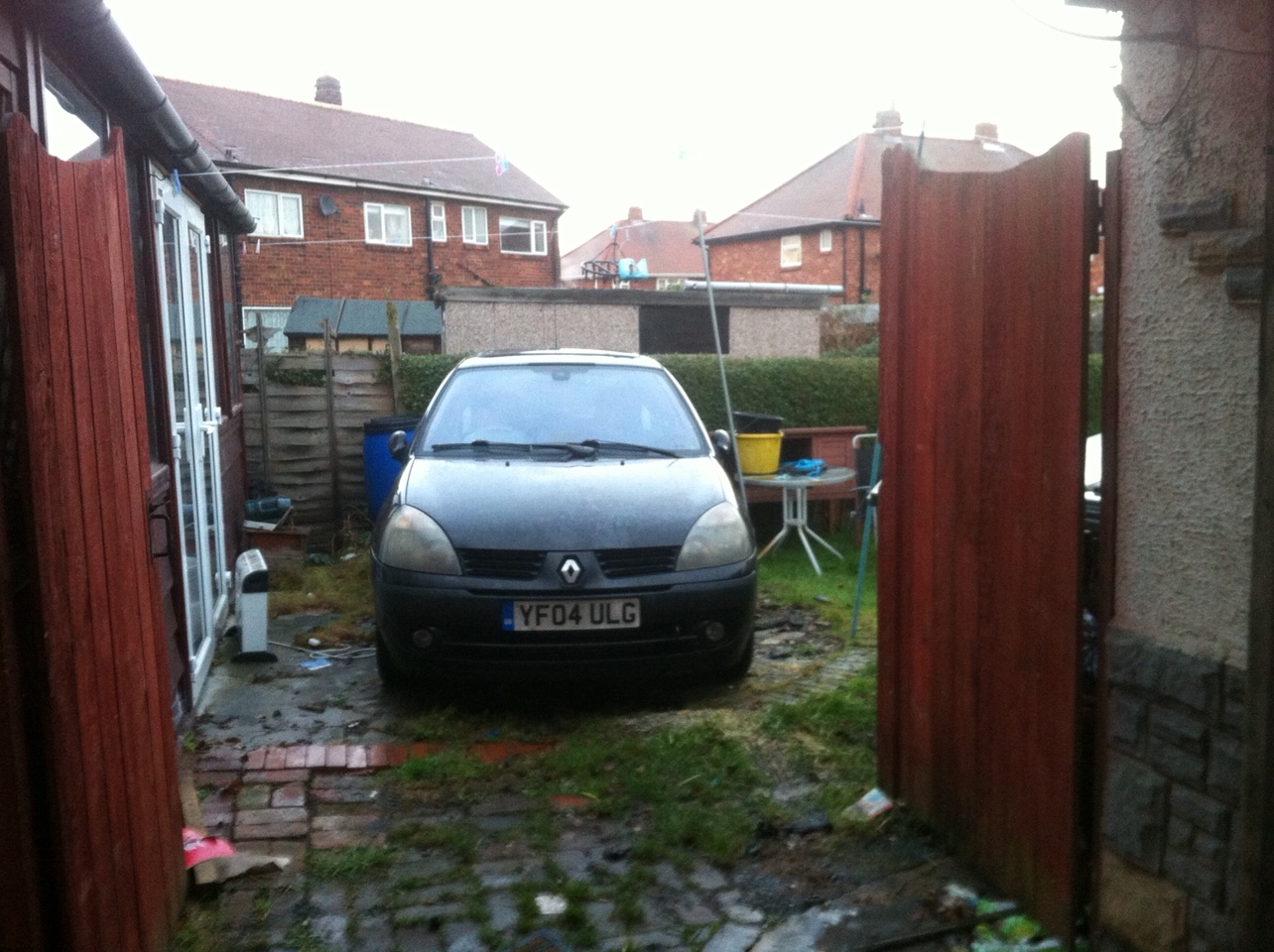

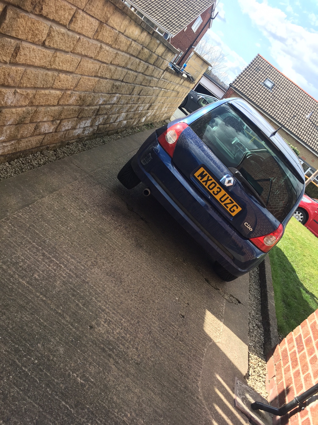

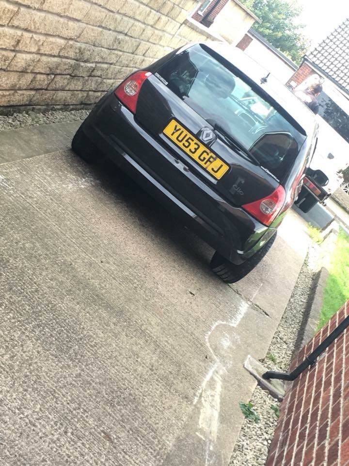

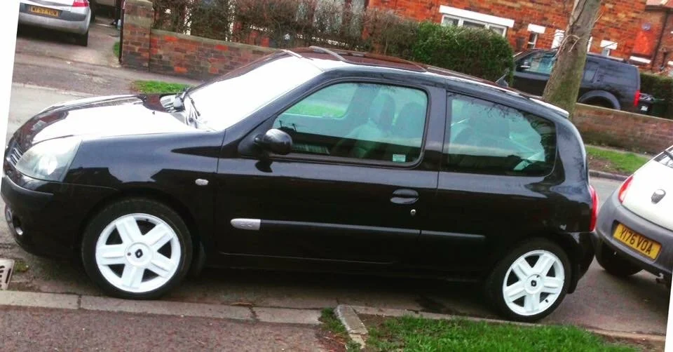

Few pics of my dCi when I first bought it

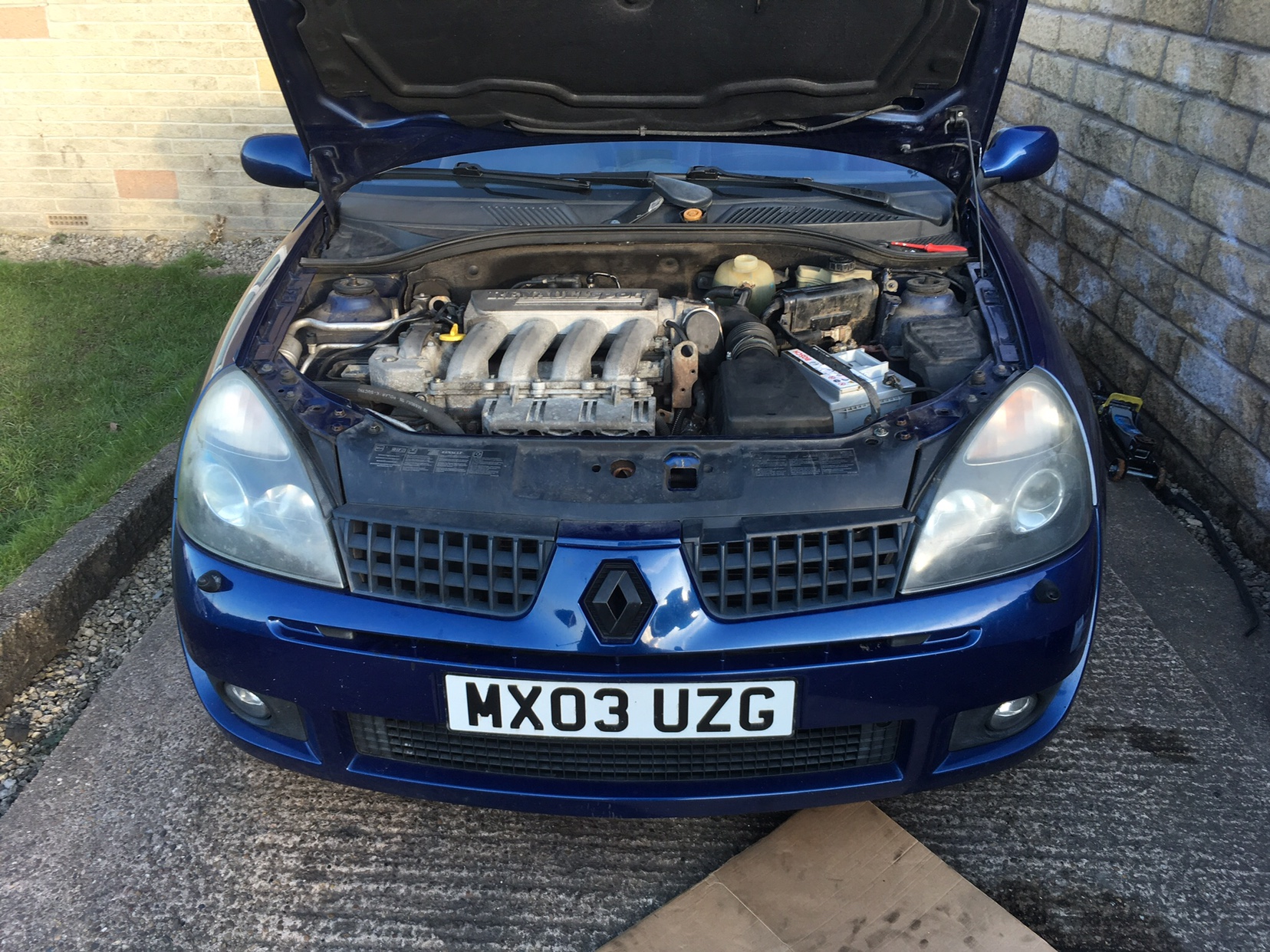

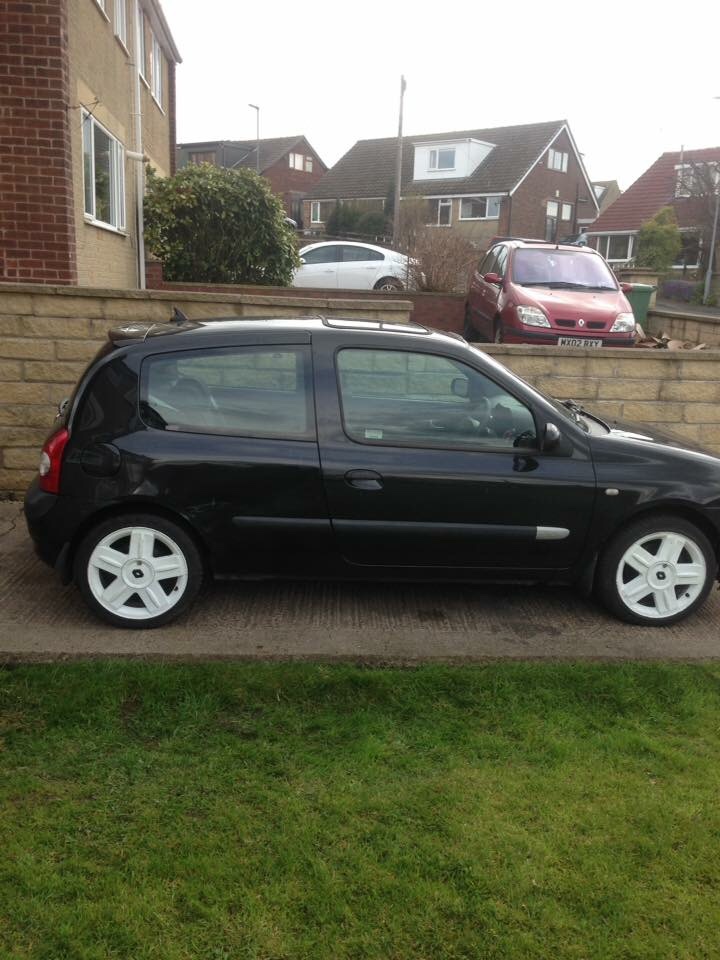

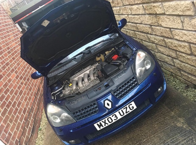

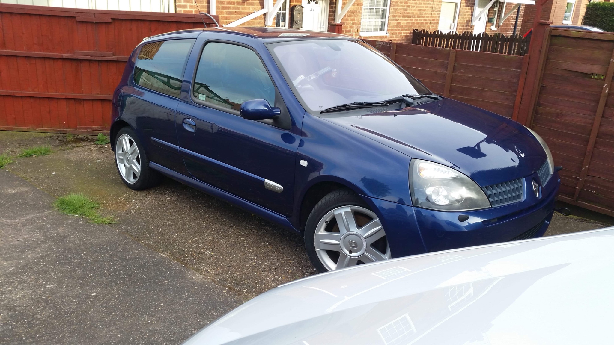

Few pics of my 172 when I bought it last month
More pictures and plenty of mods to follow!

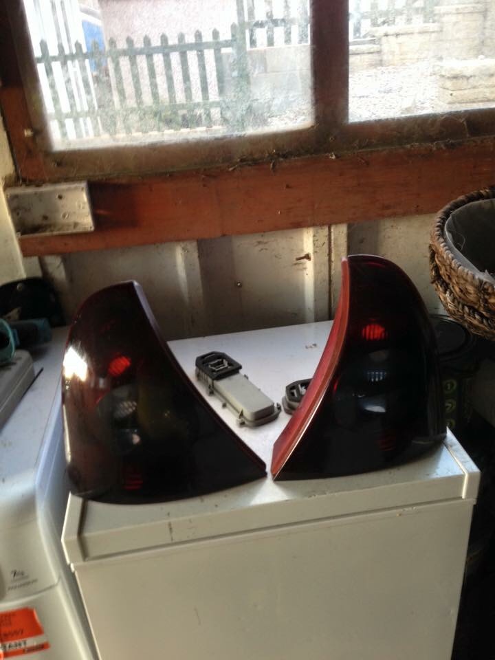

I also got rid of the horrible Megane alloys (until winter time anyway) and sold the tinted rear lights as I’m not a chav[emoji23]

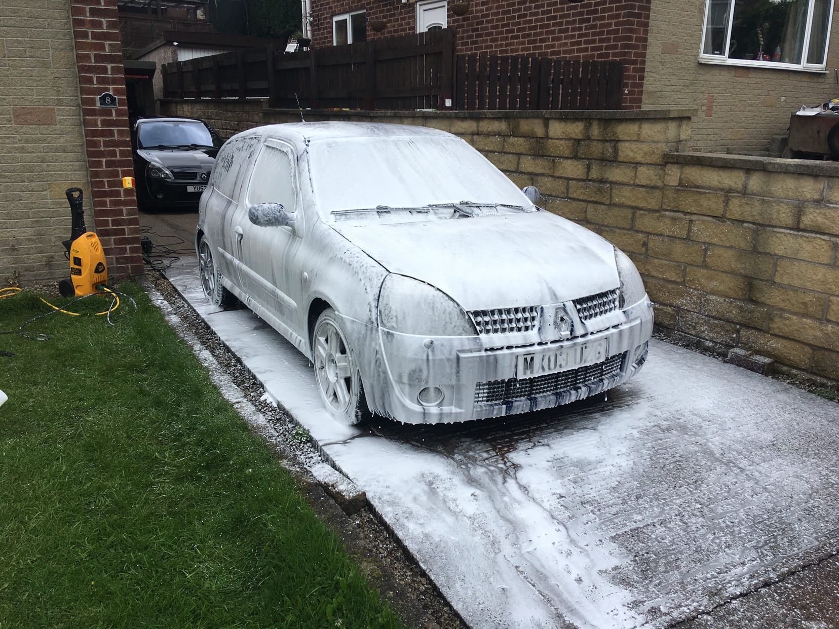

I was sick of the car being filthy so I detailed it. I didn’t go full ham on the paint but I wanted the interior to be nice as thats where I spend my time.
The outside was cleaned and spray wax used. Photo is edited but back then I thought I was the dogs nuts with my white 172 alloys haha.

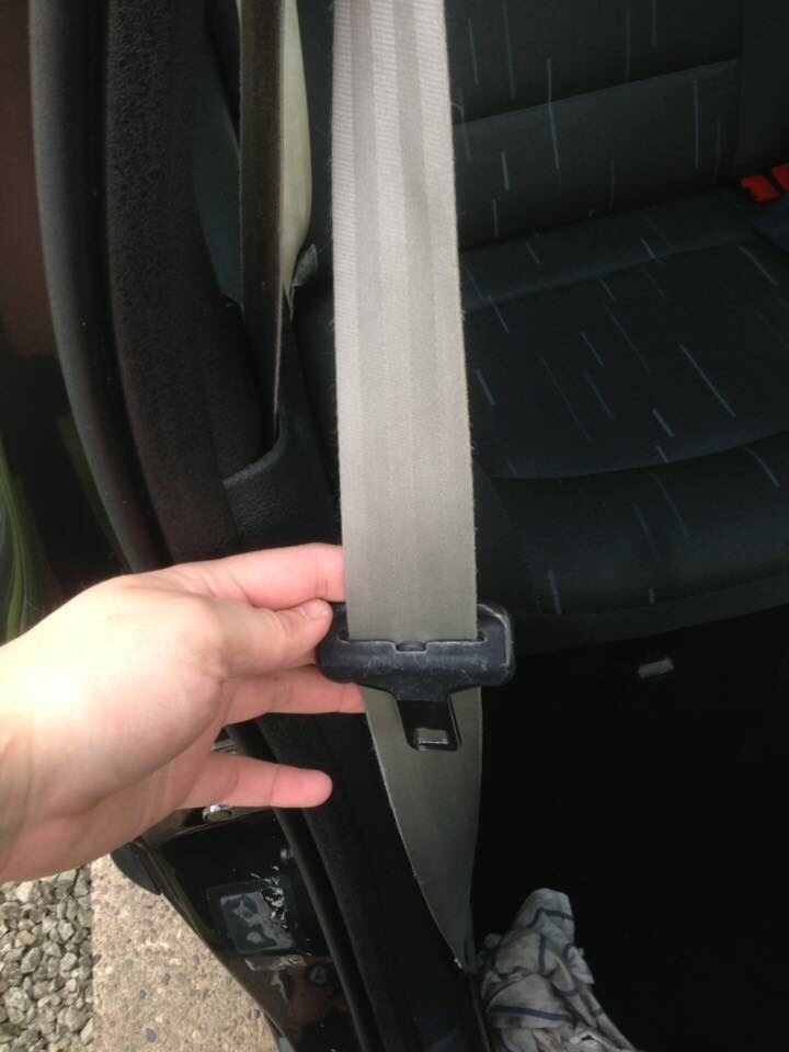

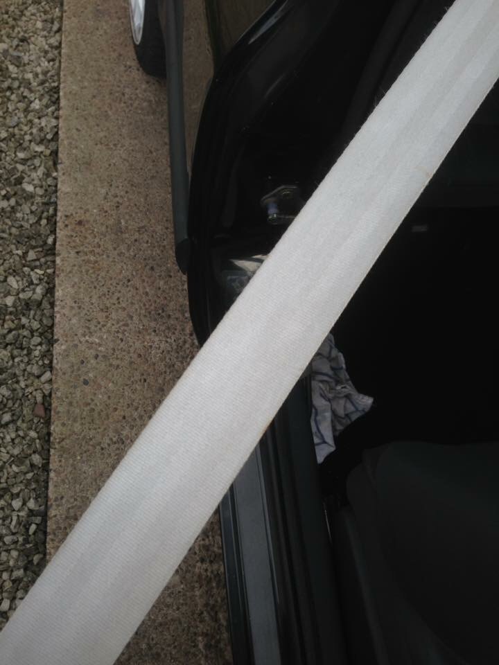

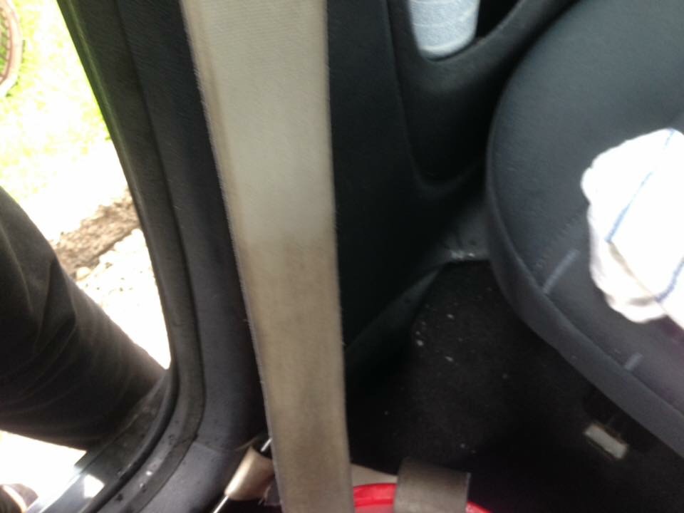

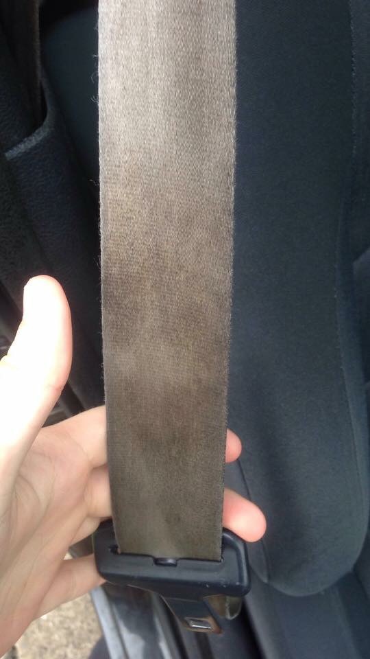

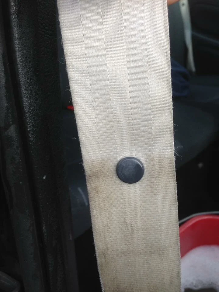

First it was time to tackle the seatbelts as they were hanging[emoji40][emoji23] I used vanish gold and red hot water to get rid of the bulk of the hunk and then just some HG upholstery cleaner with a rag to get the rest off and to stop the seatbelts being sticky after the Vanish.
Minging drivers side belt
A slight 50/50 after one scrub with the Vanish
After a few passes with a nailbrush. Coming along now

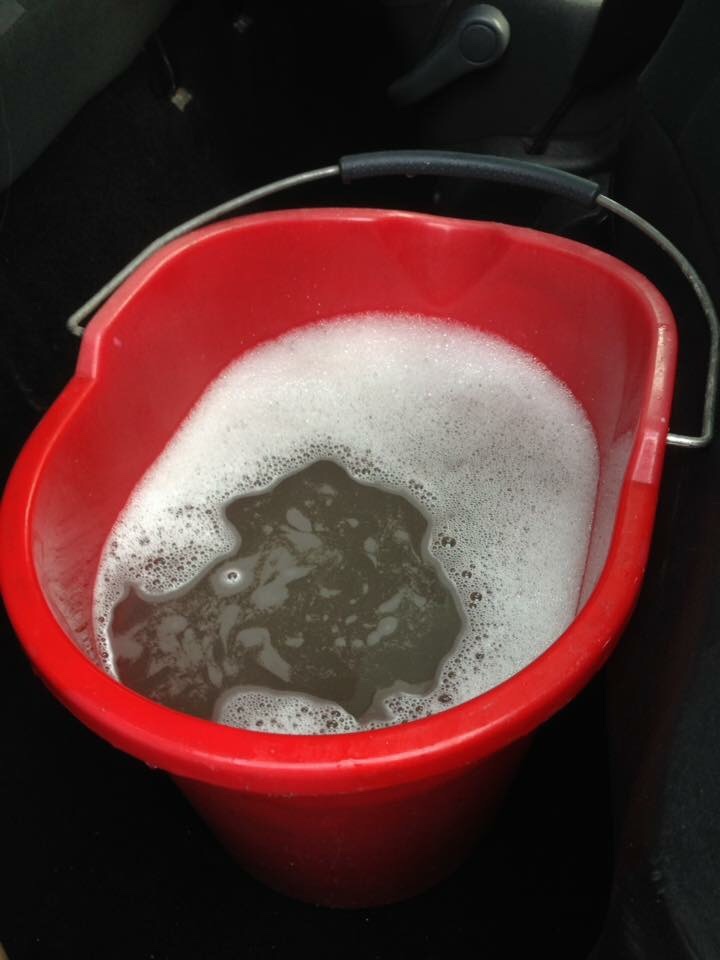

The water after doing most of the drivers belt. Only 4 more belts to do[emoji52]
After the Vanish treatment. Now just for a few wipes to get the rest of the crap off.
Loads better now and that towel got thrown which my Mrs wasn’t best pleased about. I bought her some more to replace the ones I used[emoji23]

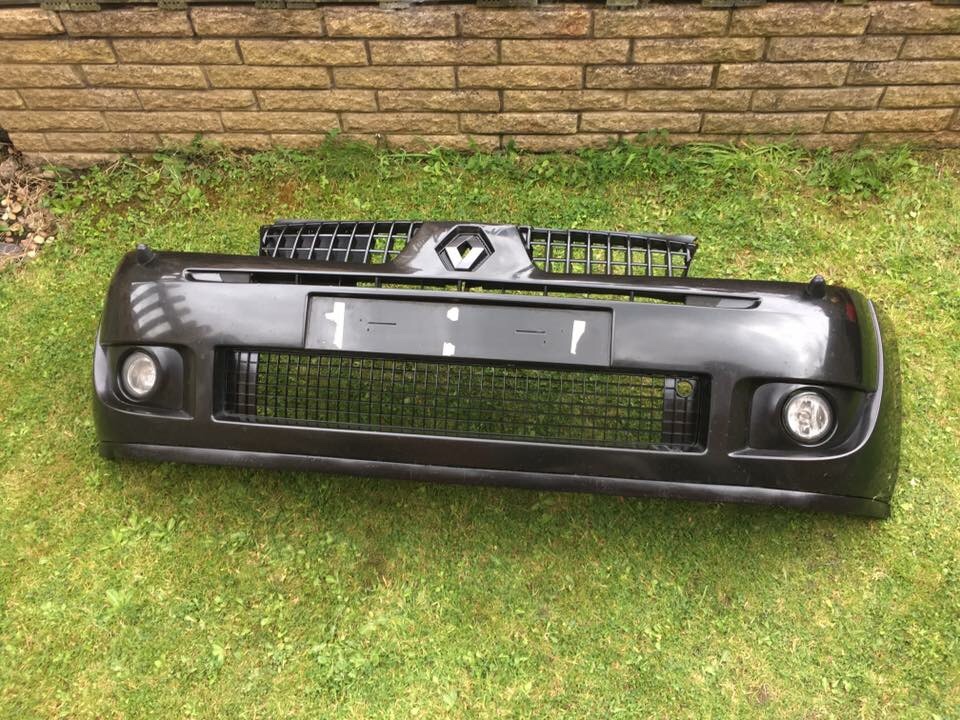

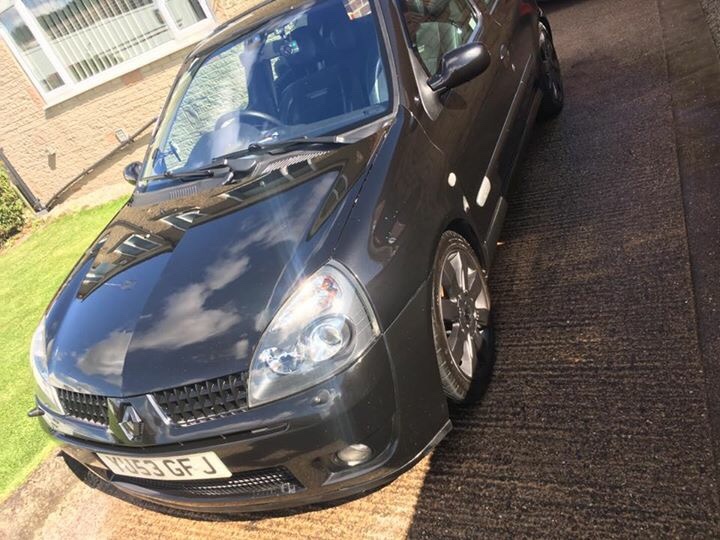

After a while of having the dCi I picked up a full sport kit in Pearl black from my mate for £80. So after it sitting in the garage for a while I decided it was time to make the dCi a rep[emoji85]

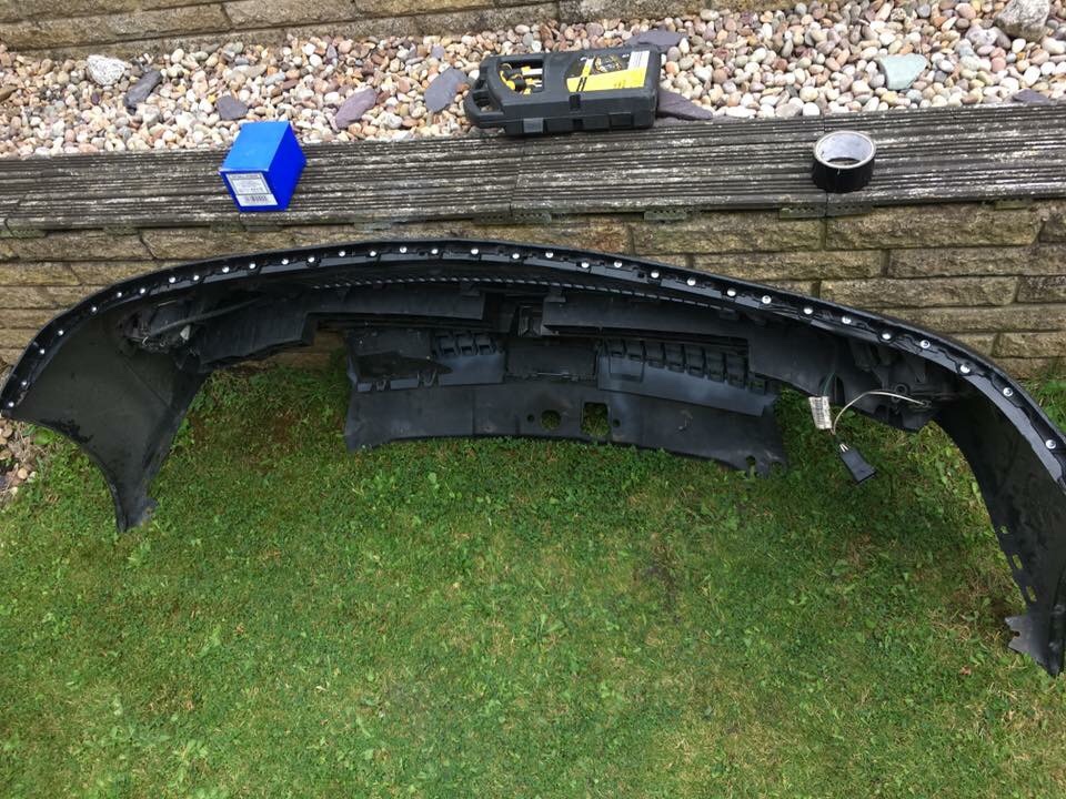

A billion self tappers in my painted Fabia splitter[emoji23][emoji23]
All grilles sprayed gloss black as the faded plastic looked shite
First wash being a rep

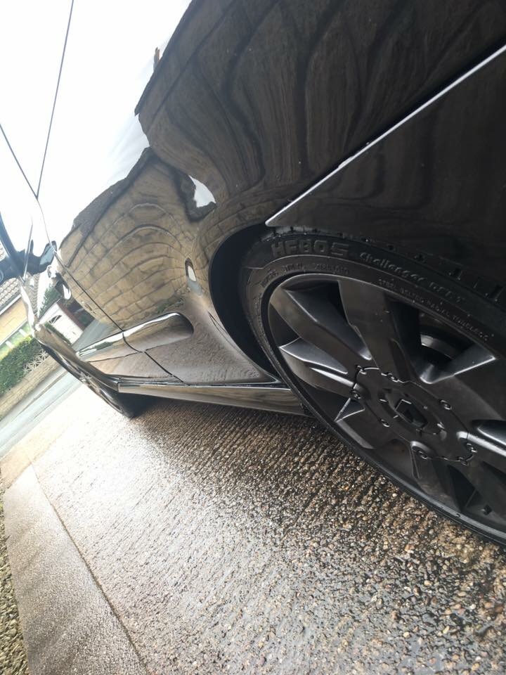

At this point I was well into washing my car and it was summer so it got washed every few days[emoji85]
Car looks so much better with the whole sport kit on
I also fitted sport seats and the door sill protectors. The car already came with a 172 steering wheel. I’m sure at this point the car was a full rep apart from the engine and running gear etc. I also did a proper pikey job of my backbox by welding in some excess pipe I had lying around[emoji23] Pics of that to follow

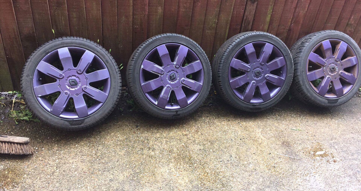

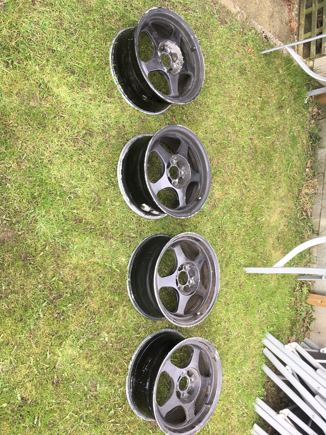

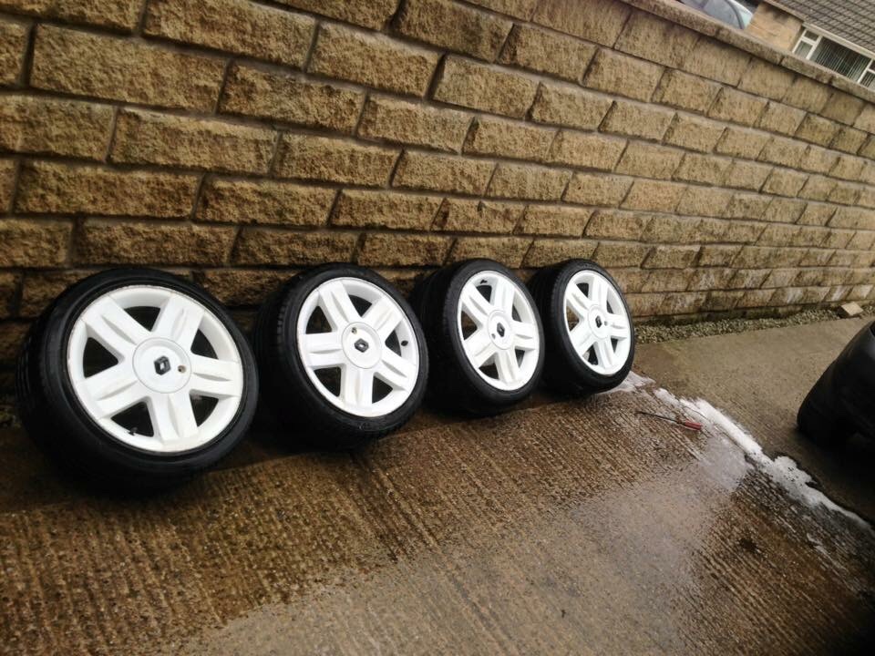

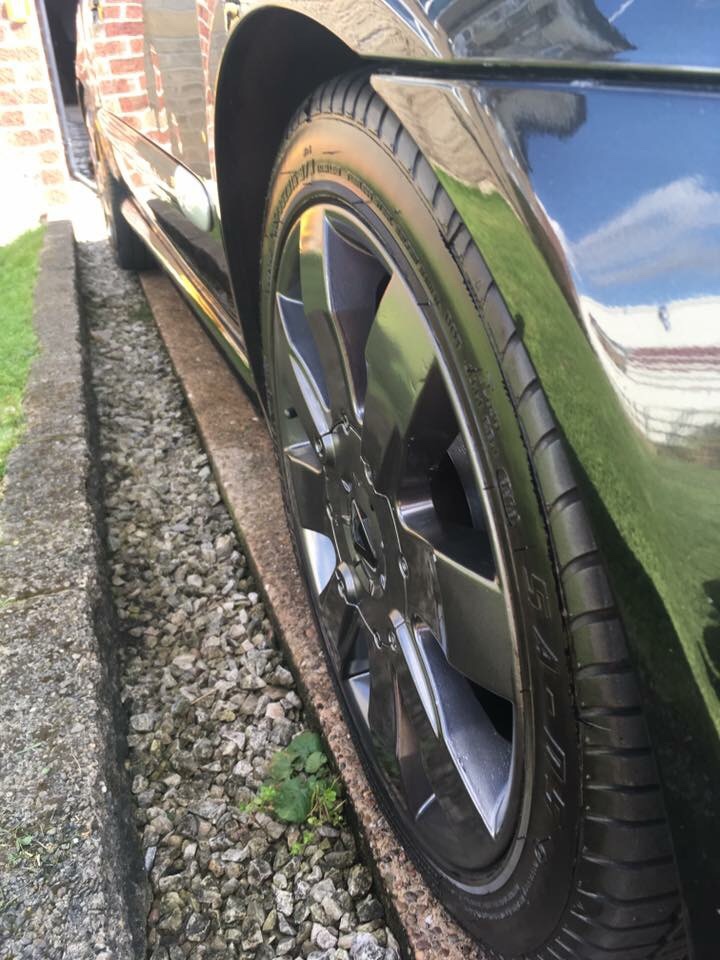

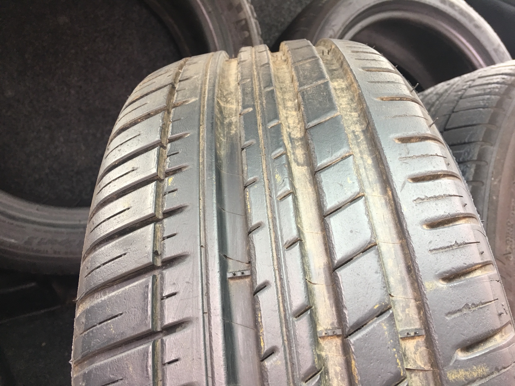

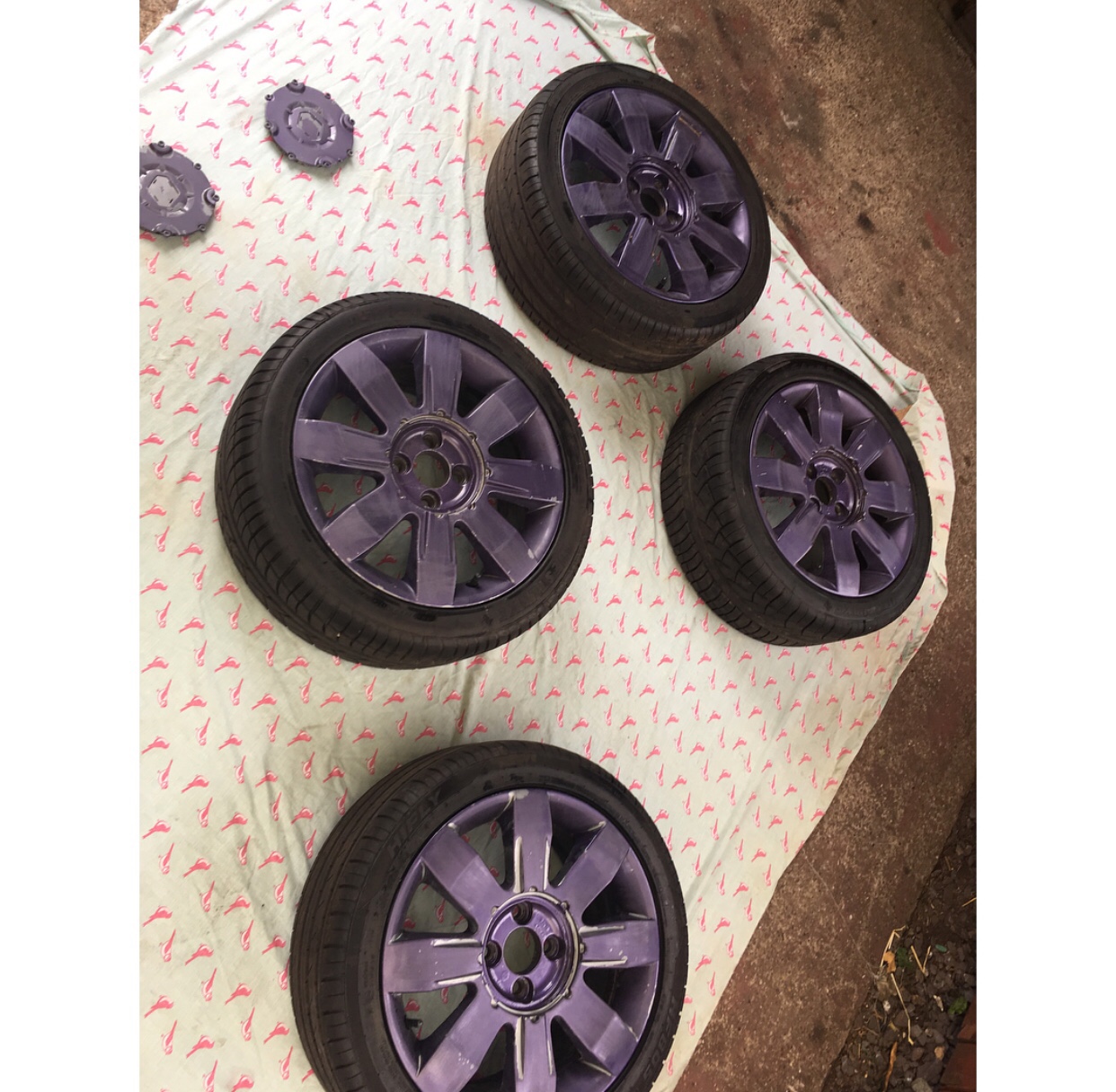

I also got a set of 182 alloys with nearly new tyres for £50. They were purple but a trip to Halfords and £30 later they were a nice dark shade of anthracite.

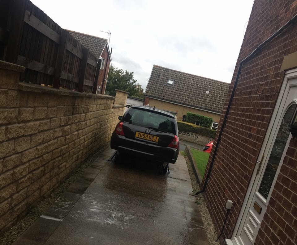

While I was waiting on J28 M62 Roundabout for my mate and his truck to turn up

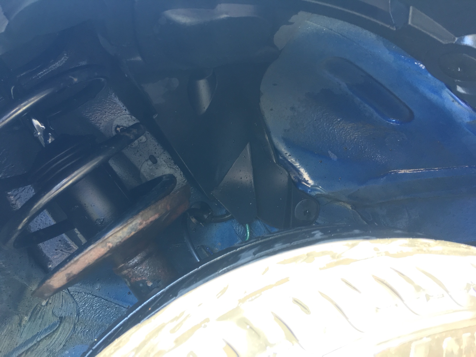

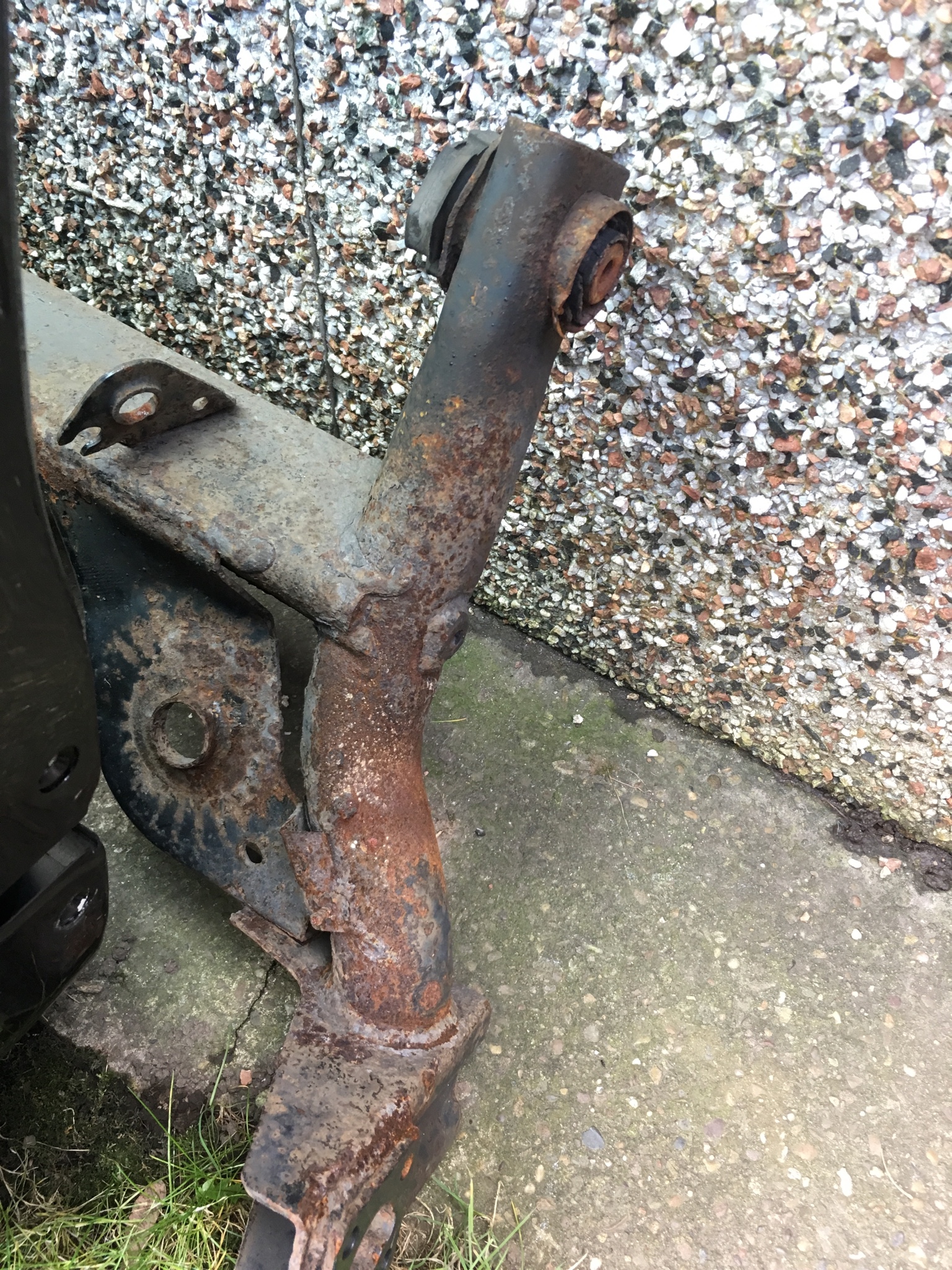

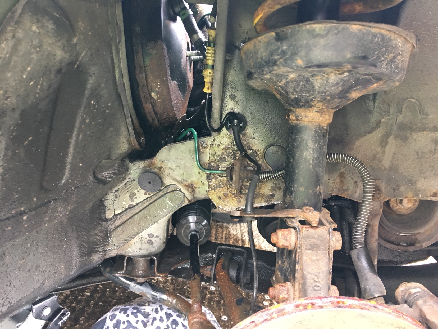

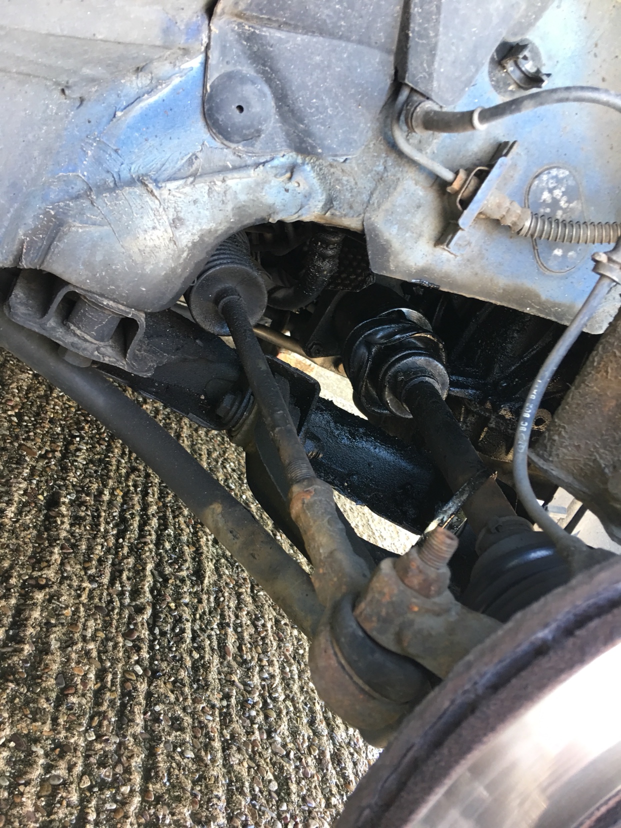

It had completely bent the rear beam and the car was doing the Stankey leg... No damage to anything other than the rear beam[emoji15]
I then bought a fully hammerited rear beam with brand new bushes etc. Me and my dad took the beam down and I decided it was a good time to spray down the underside of the car, while everything is out of the way.
You can also see my pikey job and my welding with wet rods on a stick welder exhaust‍♂️[emoji23][emoji23]
After a day the car was back down on planet earth and it felt better than ever to drive!!

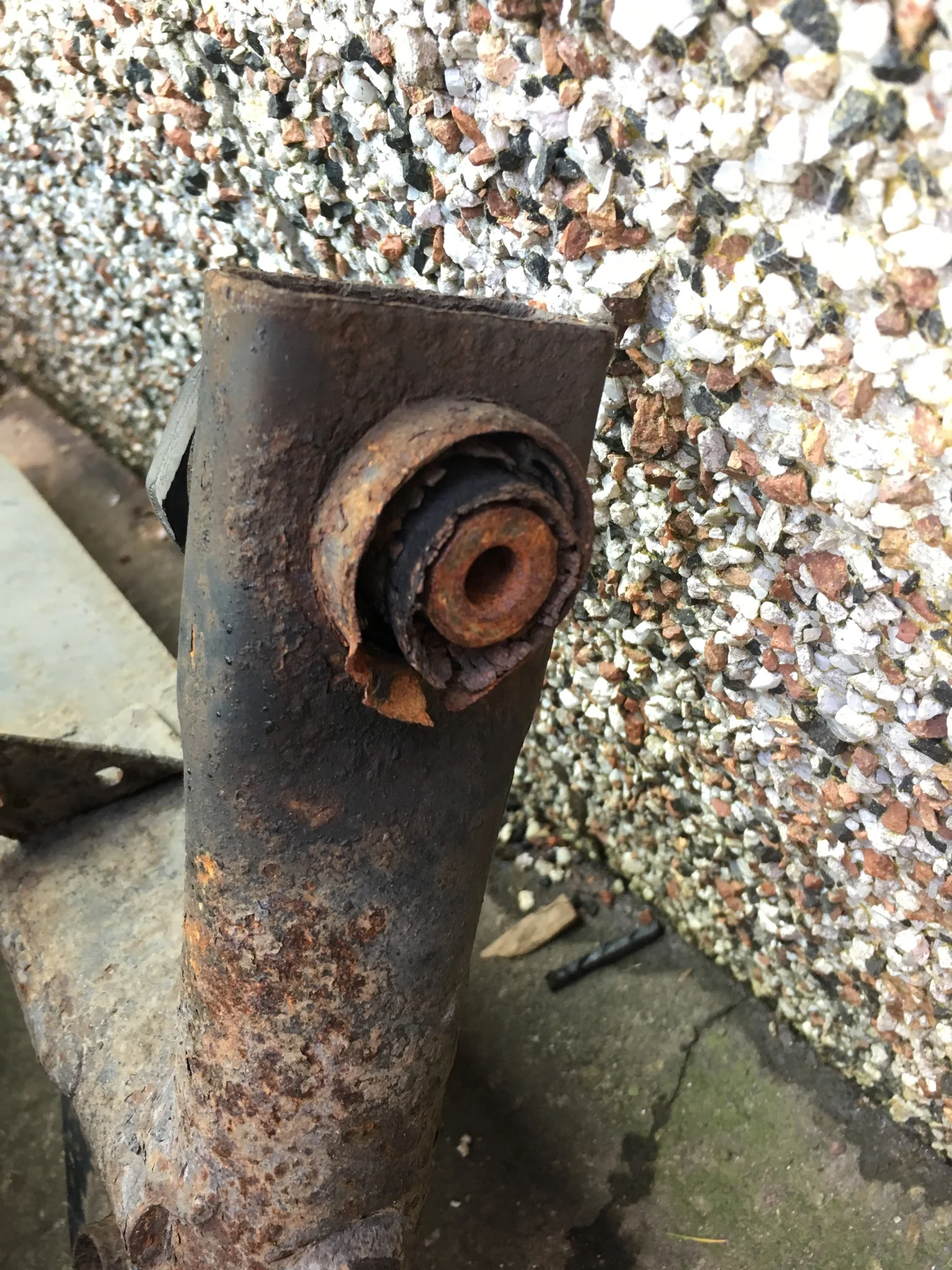

The beam bushes were that bad on the old one they caused the whole axle to move when compressed which meant the back wheel rubbed on the arch. Now the beam doesn’t rub at all! Even with 4 people in the car (I had to test it[emoji23]) Win!
Bent as a 9 bob note
State of that bush!

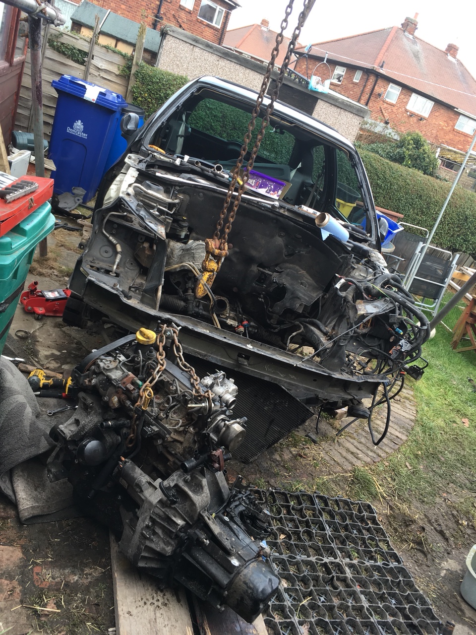

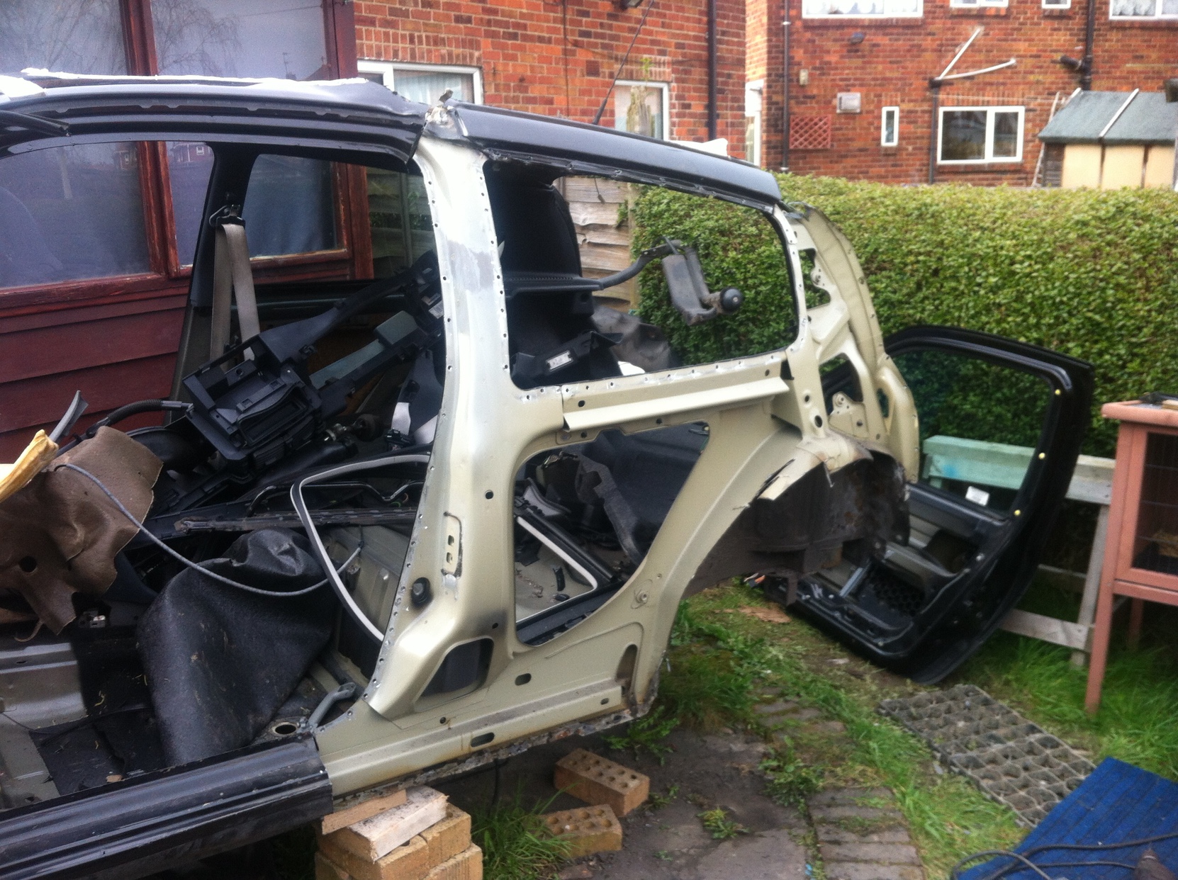

So after 240k of fairly faultless miles I decided I wanted to stop spending loads of money on my daily...
So I bought another dCi 100 purely for parts for the humongous sum of £150[emoji23][emoji23] Unfortunately the cambelt had gone... but the car paid for itself after I sold the interior, front bumper, bonnet and bonnet hinges. I then sold the alloys with new tyres for £80, a rear stub for £35 posted and I’ve now doubled my money and still have pretty much a full car left.
I have the EPAS column, rack and dash to go in my 172. I’ve already swapped over the rear discs onto the dCi as they were new, then the rest of the car has been stripped and stored. I think it’s pretty much just the shell left with a few wires and a headliner[emoji23]
In a nutshell I got a full car cheaper than a set of injectors for my car is...
In its final resting place...
Dead car after a few hours...

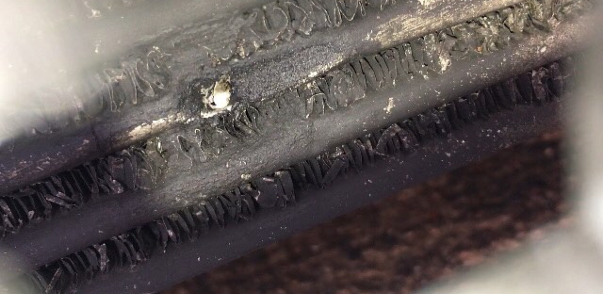

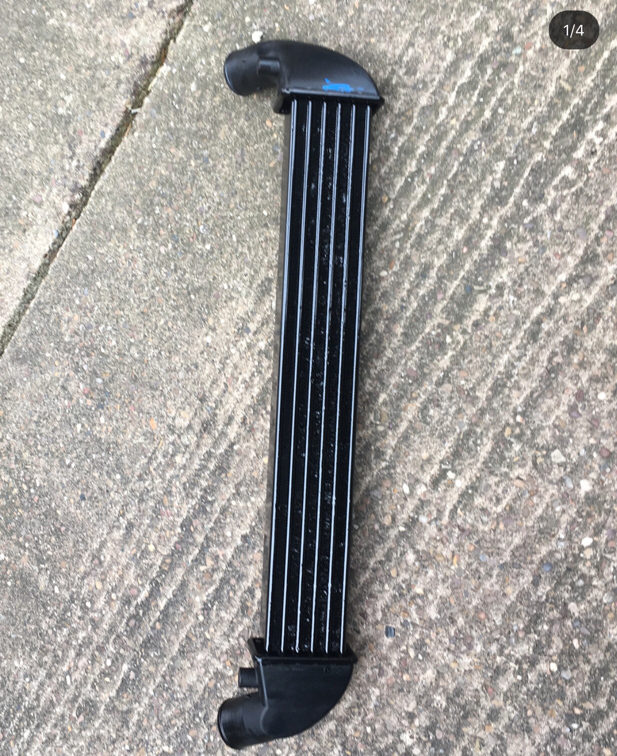

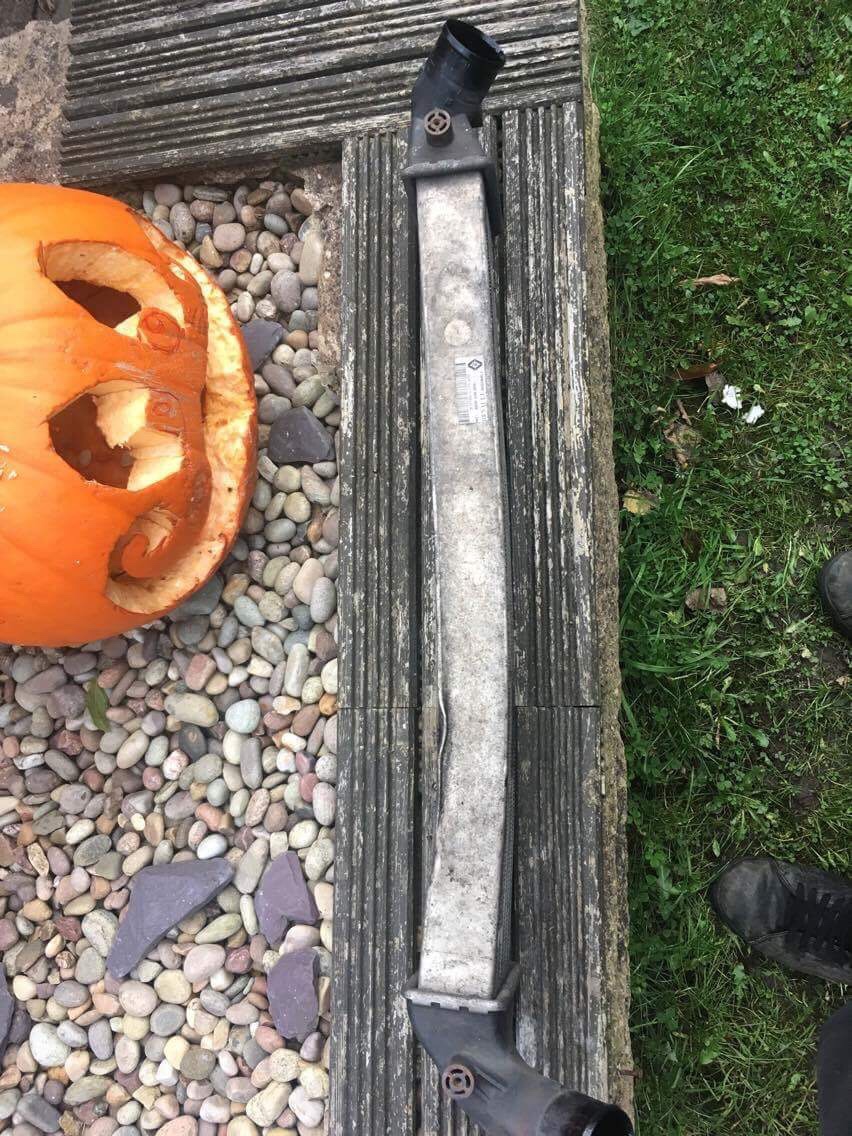

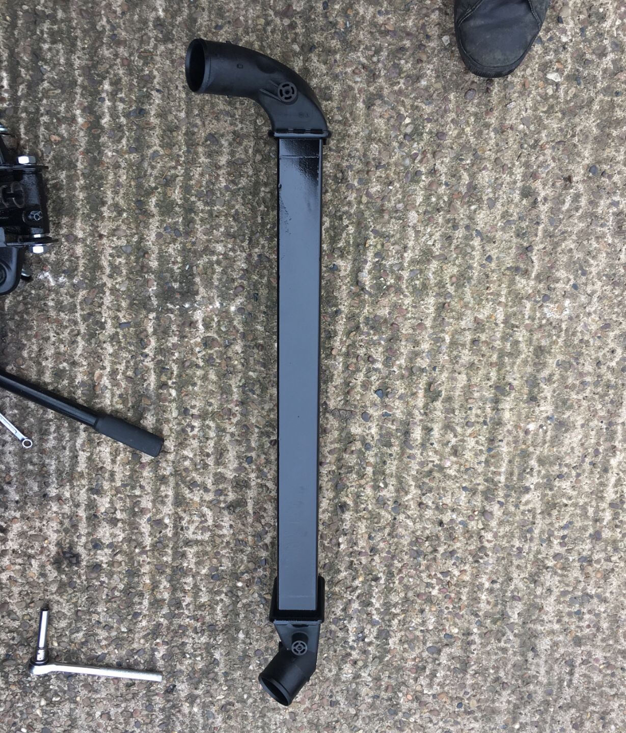

Finding and fixing boost leaks...
I found that my cooler had a massive hole in it from a stone... so I set out to repair the massive mess with epoxy putty
Pic of said bullethole
The epoxy sort of did it’s job but looks horrendous...
The cooler is bent from a previous owner and mangled from 240k miles
So I found another dCi 100 in my local scrappers and bought the cooler for £20[emoji1305]
I had to paint this one black as I hated the silver
Another job complete and it looks so much better now the cooler is black!

-172 bumpers, skirts, wings

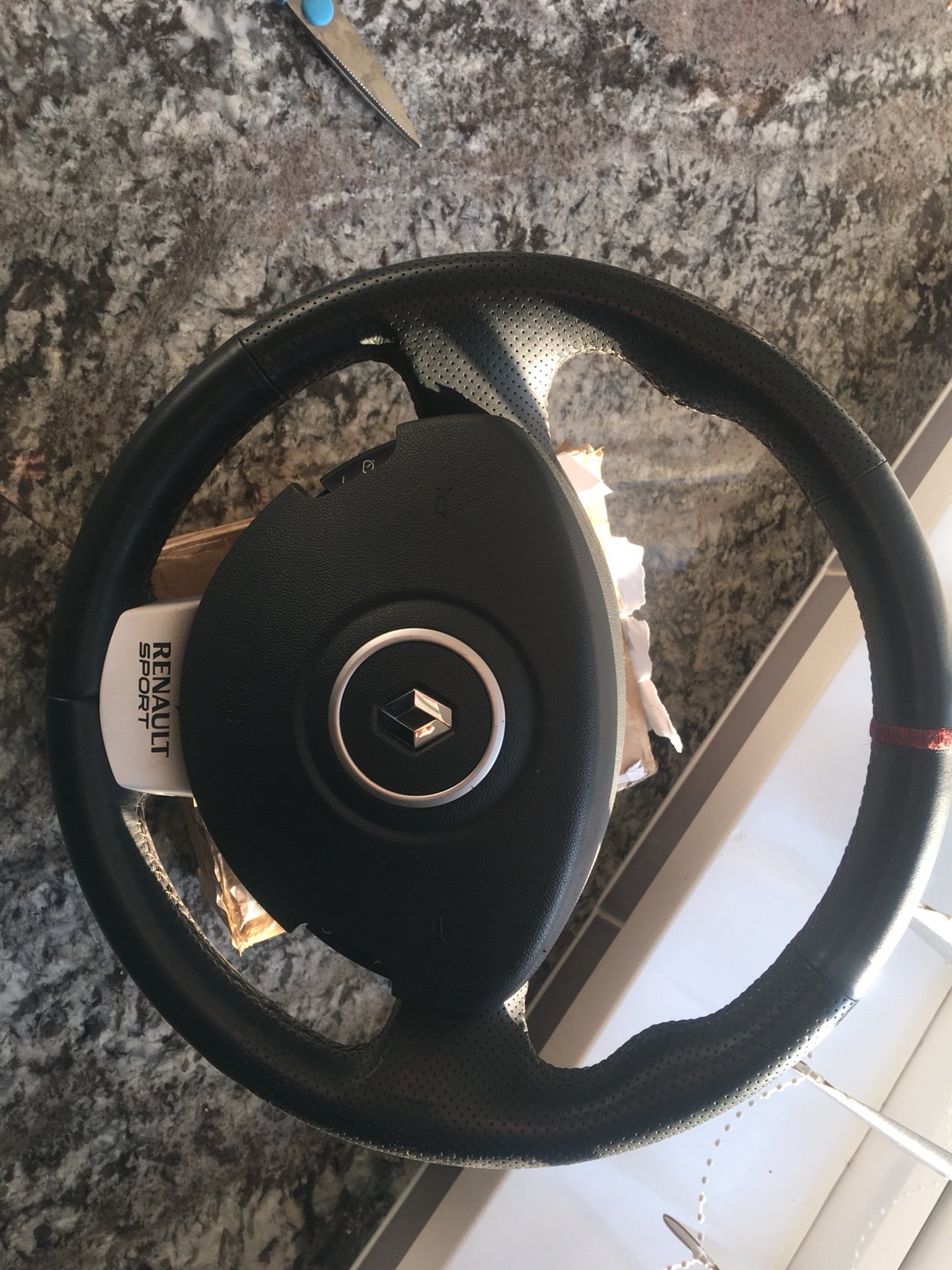

-Cleaner sport steering wheel

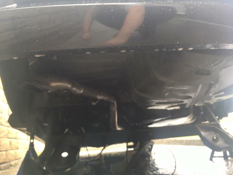

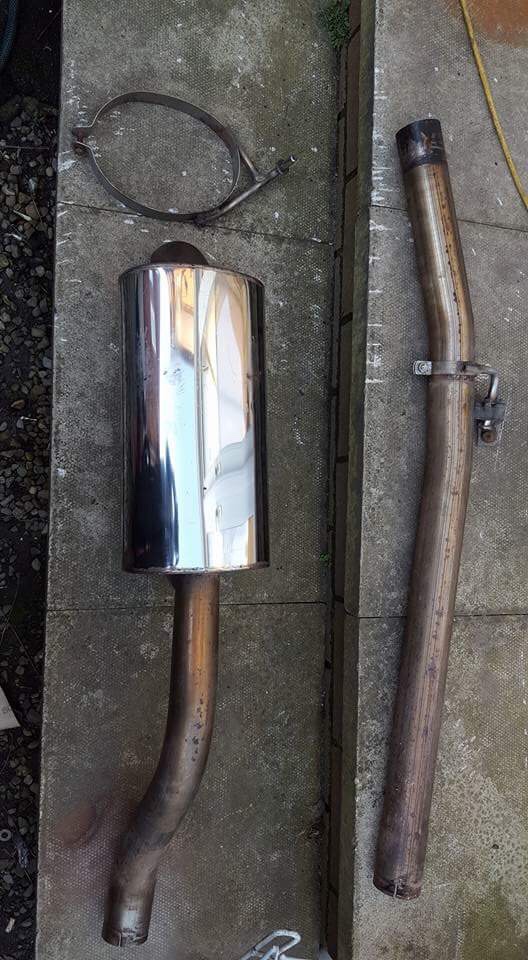

-Chopped off backbox

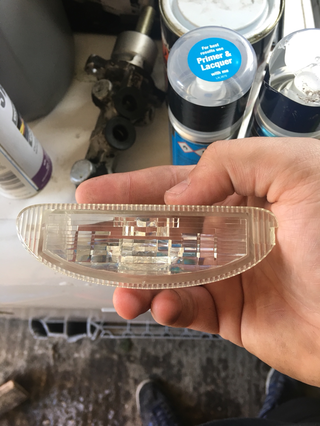

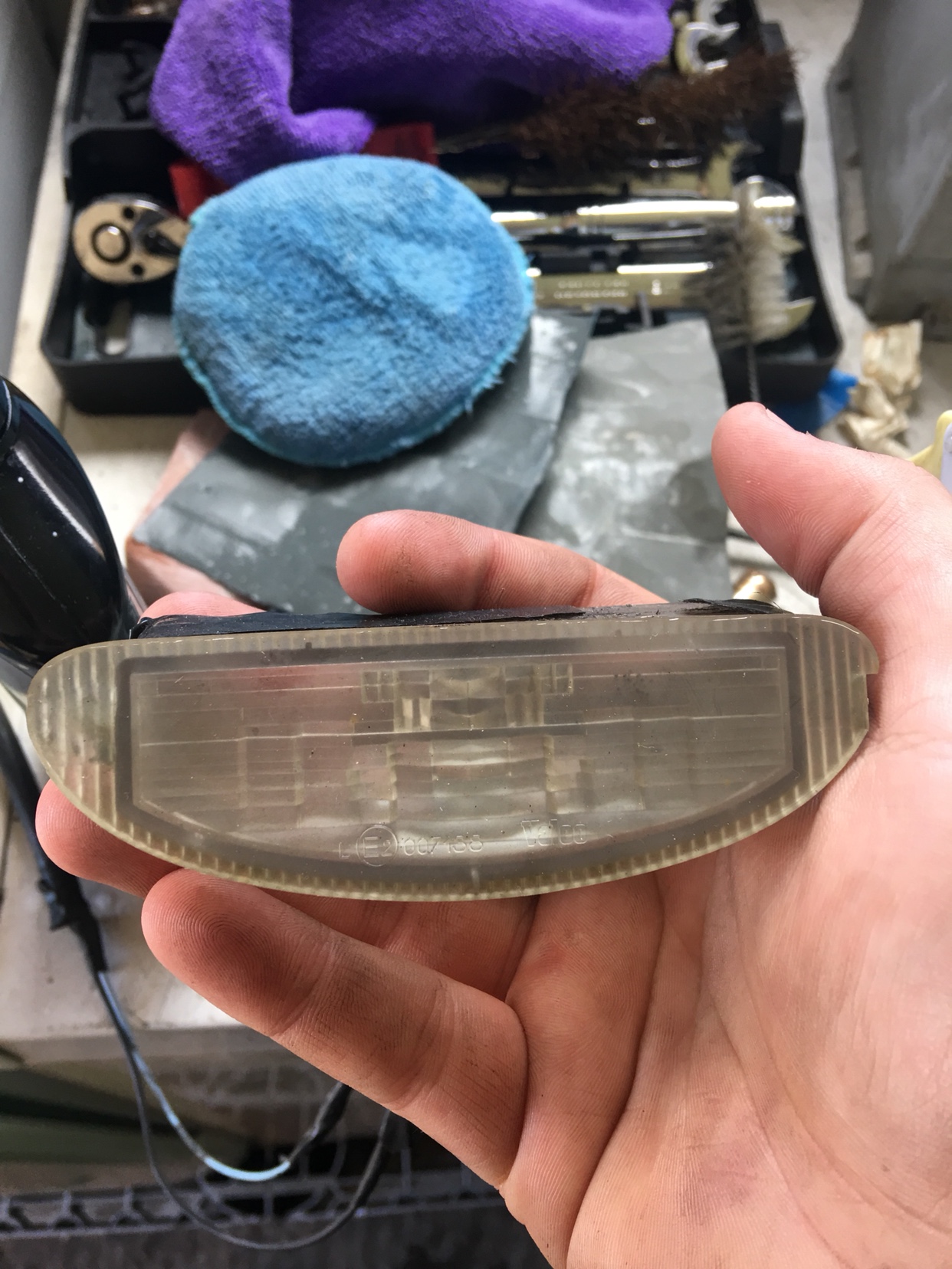

-Rear numberplate light holder

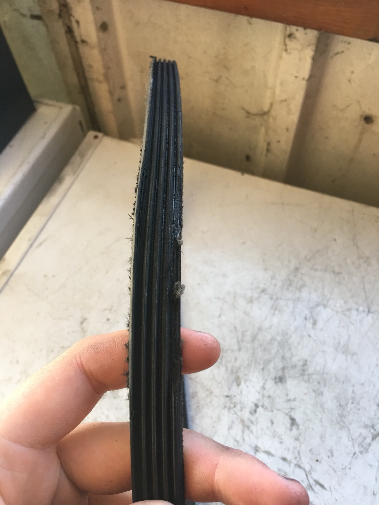

-Timing belt, water pump + aux belt (done that many miles it’s due another one...)

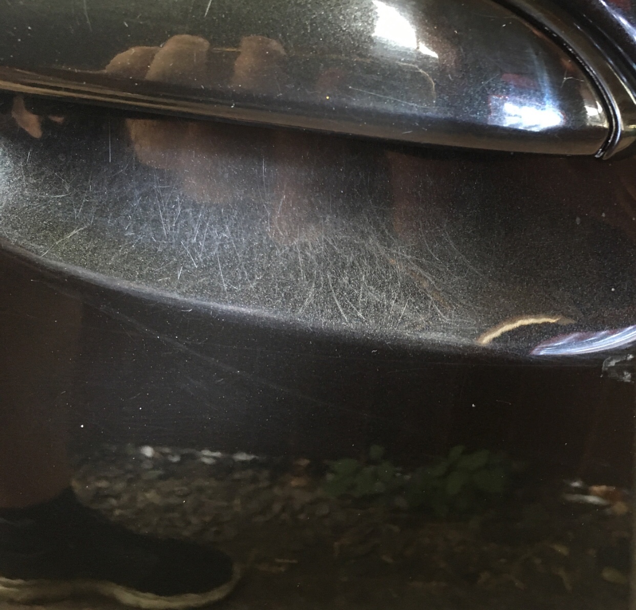

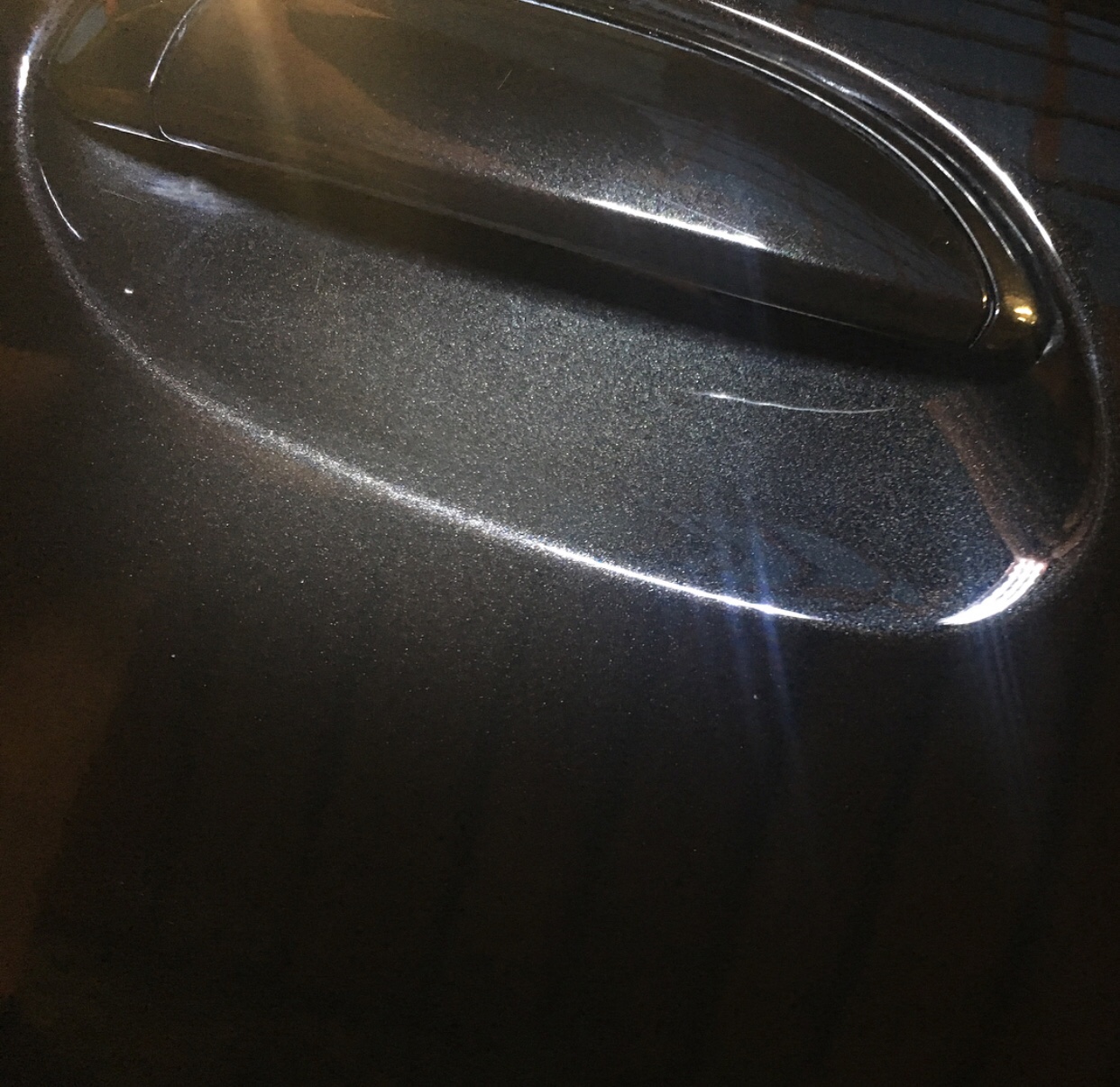

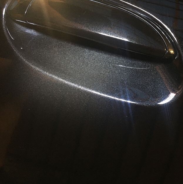

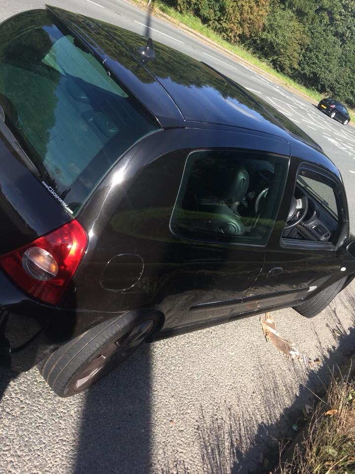

I took a day to fully detail the car, this was after owning the car for 2 years so it wasn’t that dirty.
However, the paint was disgusting after 235k-ish.
-Full wash
-Decon with tar remover and iron remover
-Another wash with Fairy to remove previous waxes
-Fully clayed the car (sounded like a washboard)
-Wipe down with IPA
-2 stage machine polish
-IPA wipe down and then fully sealed
-Paste wax on top of sealant
-Spray wax on top of the paste wax
-Hosed the car off and sealed again with Hydro2
-Dried with a waffle weave and quick detailer
-Stuck some Rain-X on the windows
Before of the paint
After

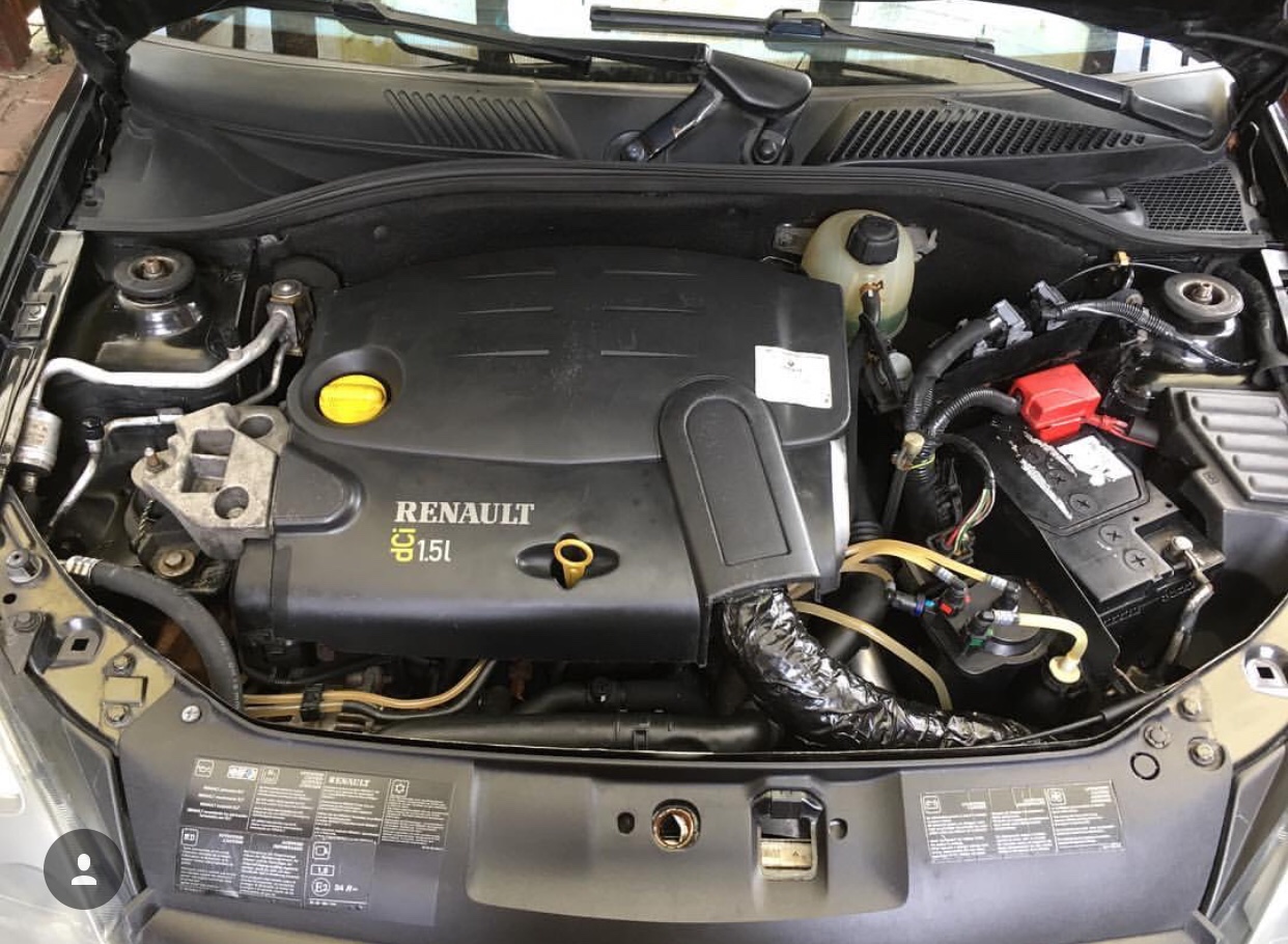

I also cleaned the engine bay prior to this

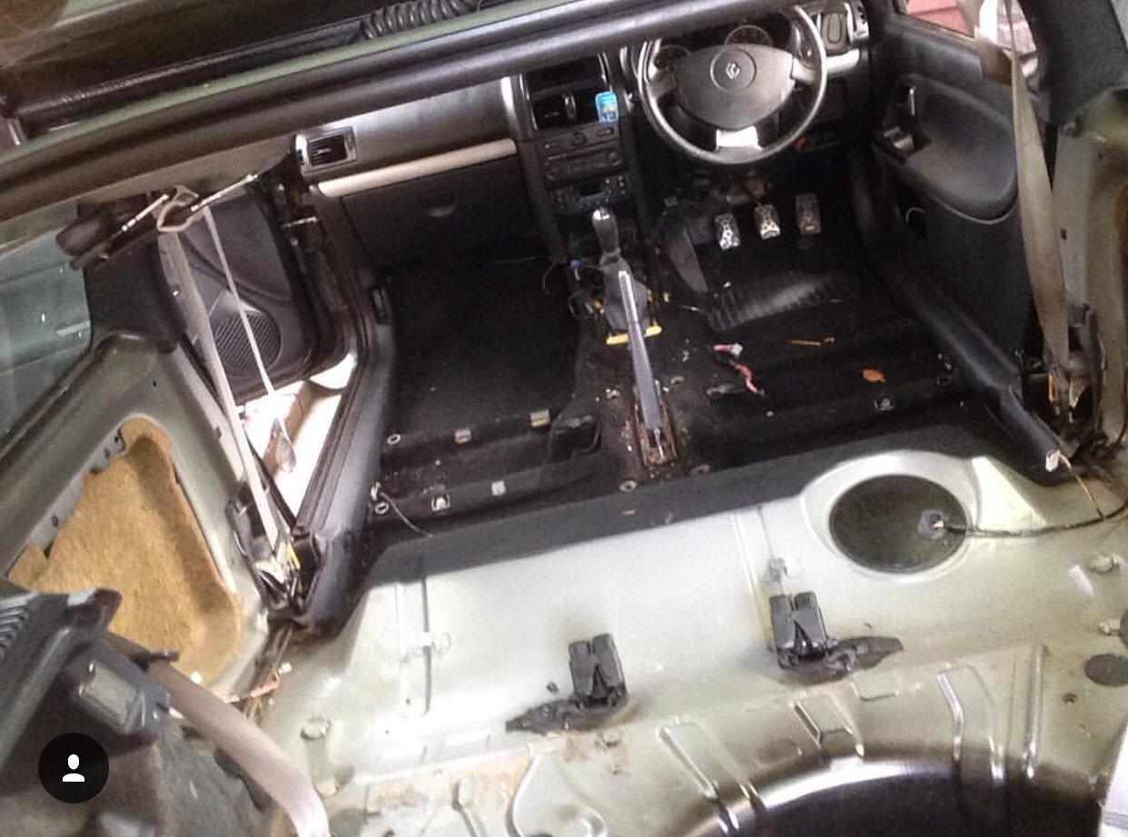

I gutted the whole interior when it came to putting in the sport seats so everything got taken out, washed as dried then.
The only pic I have from then

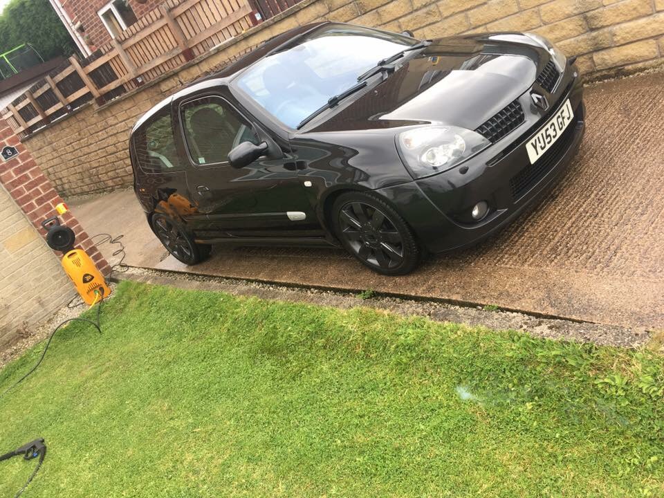

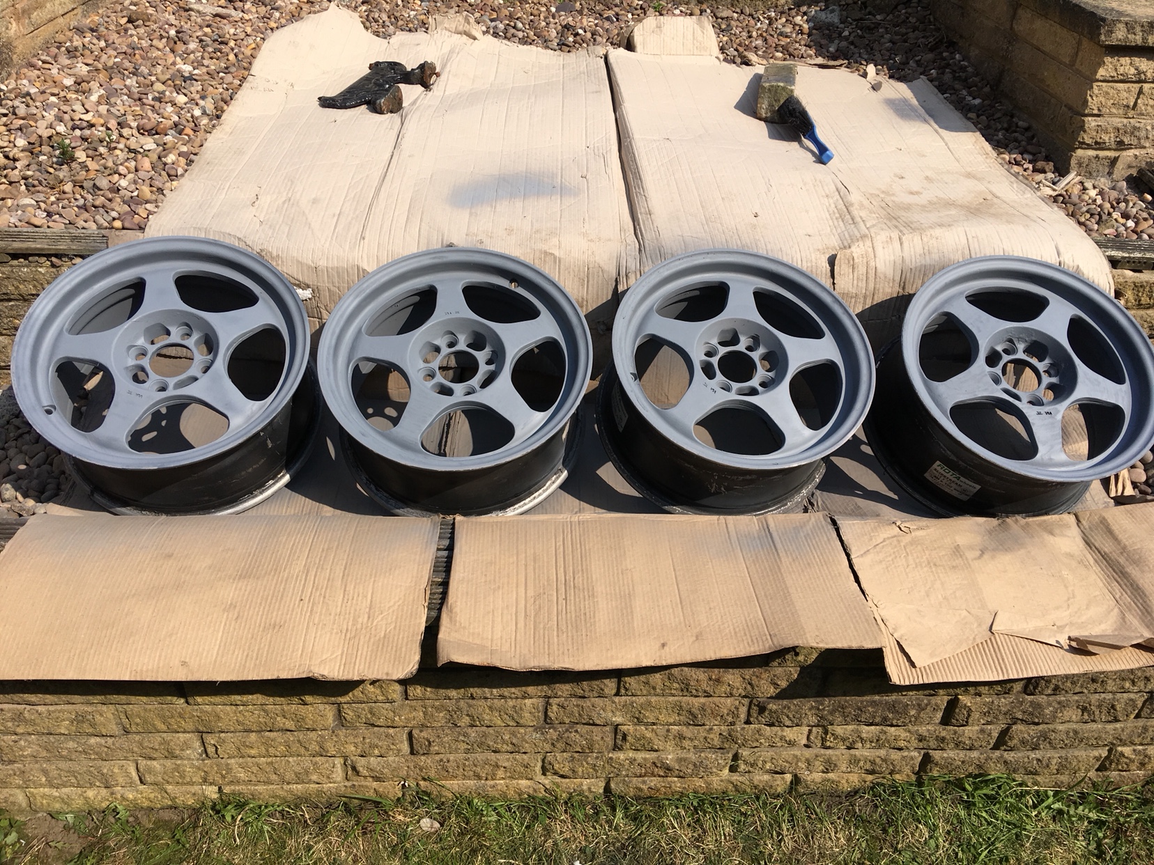

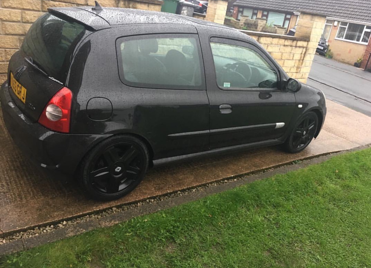

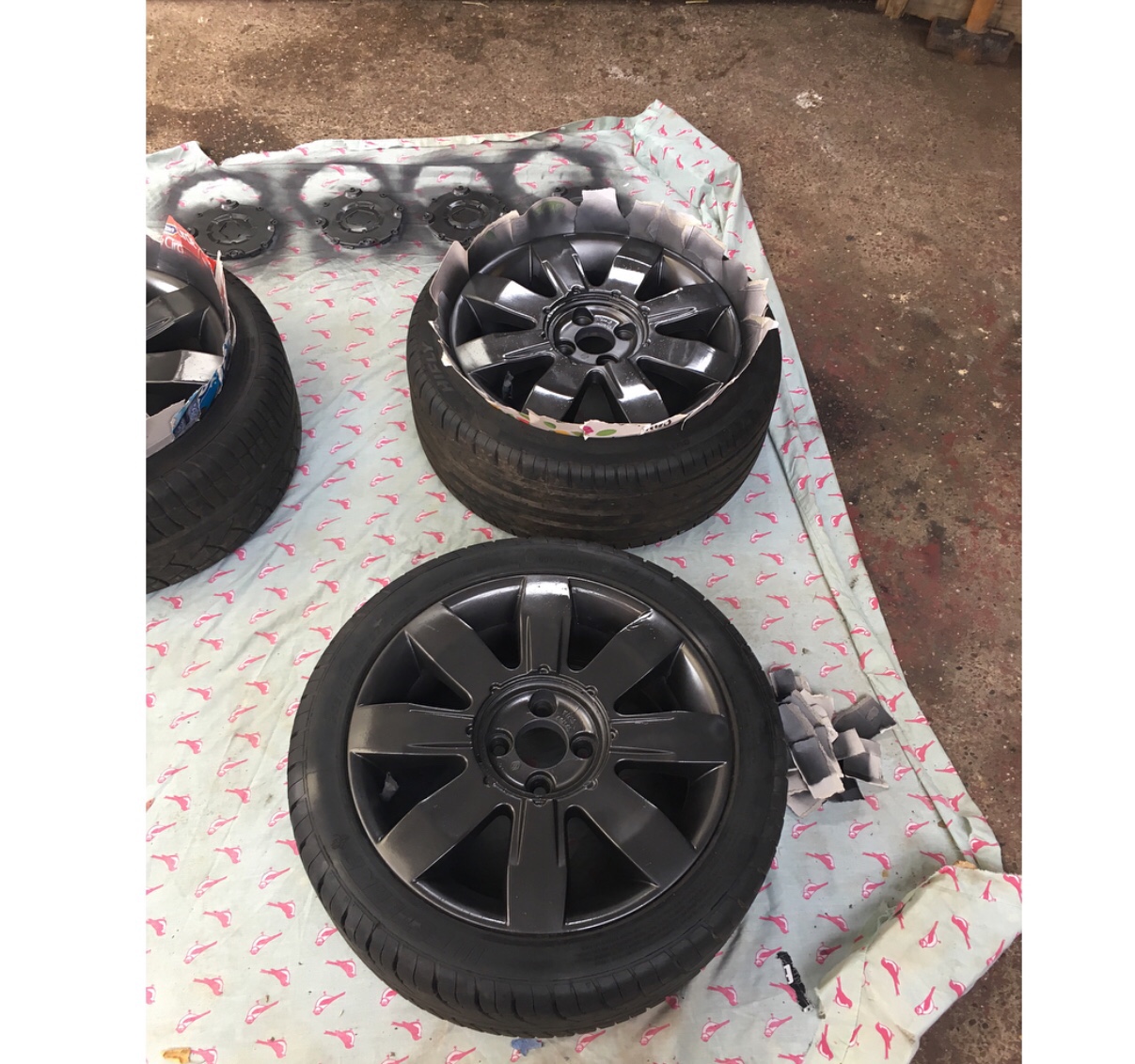

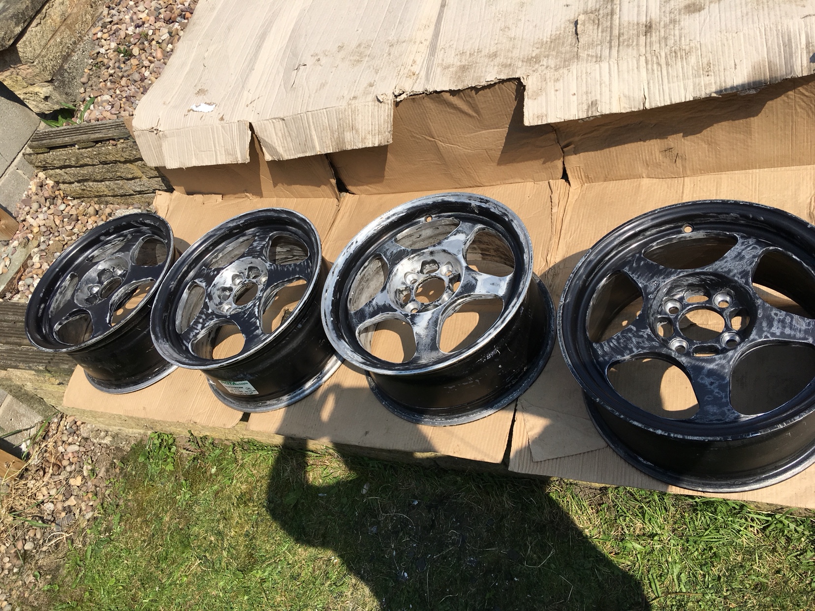

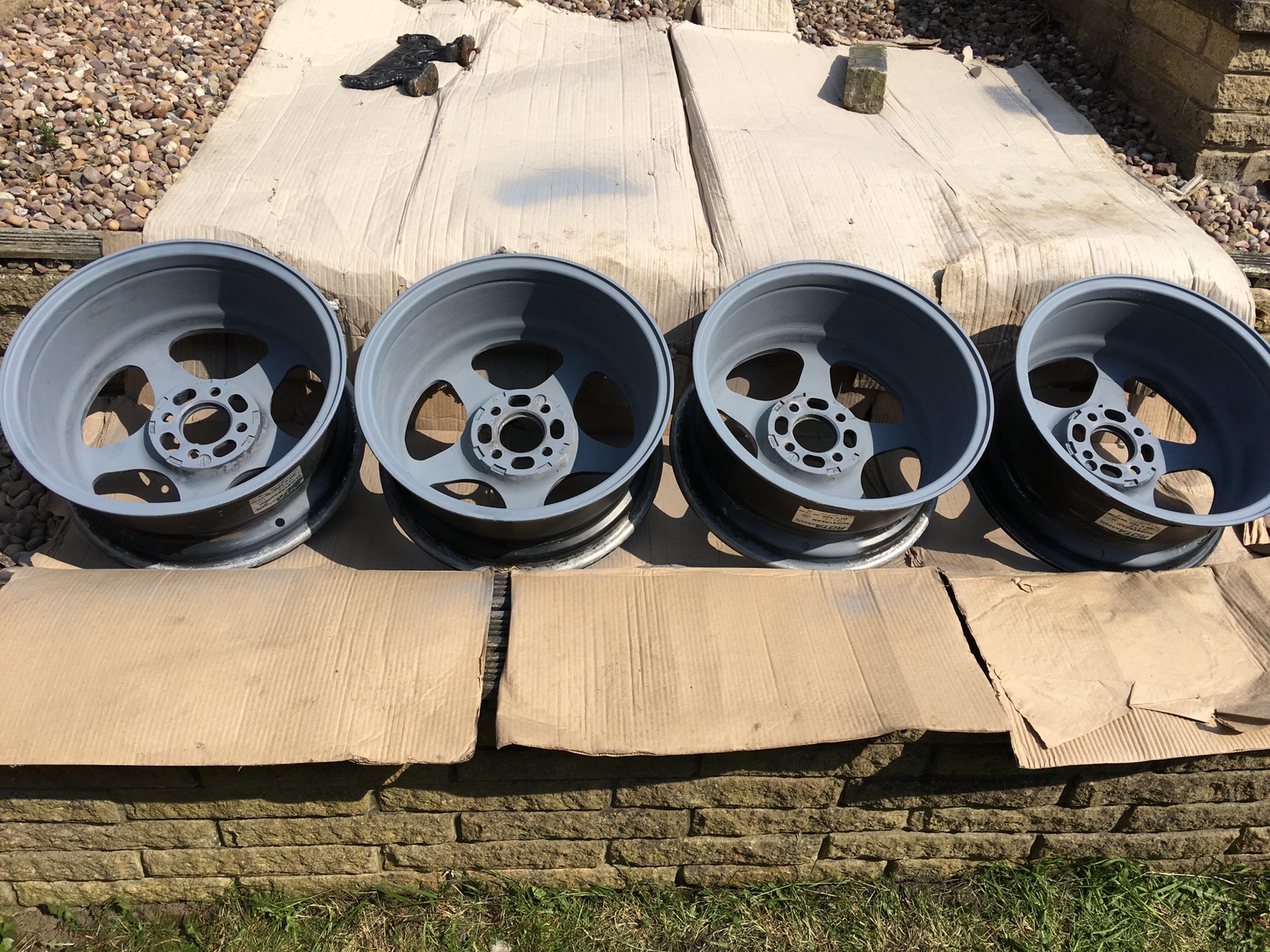

This is how the car now sits, black 172 wheels I paid £25 for and used Poundland spray paint on, because winter beater wheels and tyres[emoji23]
There’s probably loads of bits I’ve missed off but can’t remember. The car currently sits with no MOT as the rear lines are shagged and the master cylinder is needing a rebuild as it’s leaking! (waiting on the seal kit but will post about this soon)

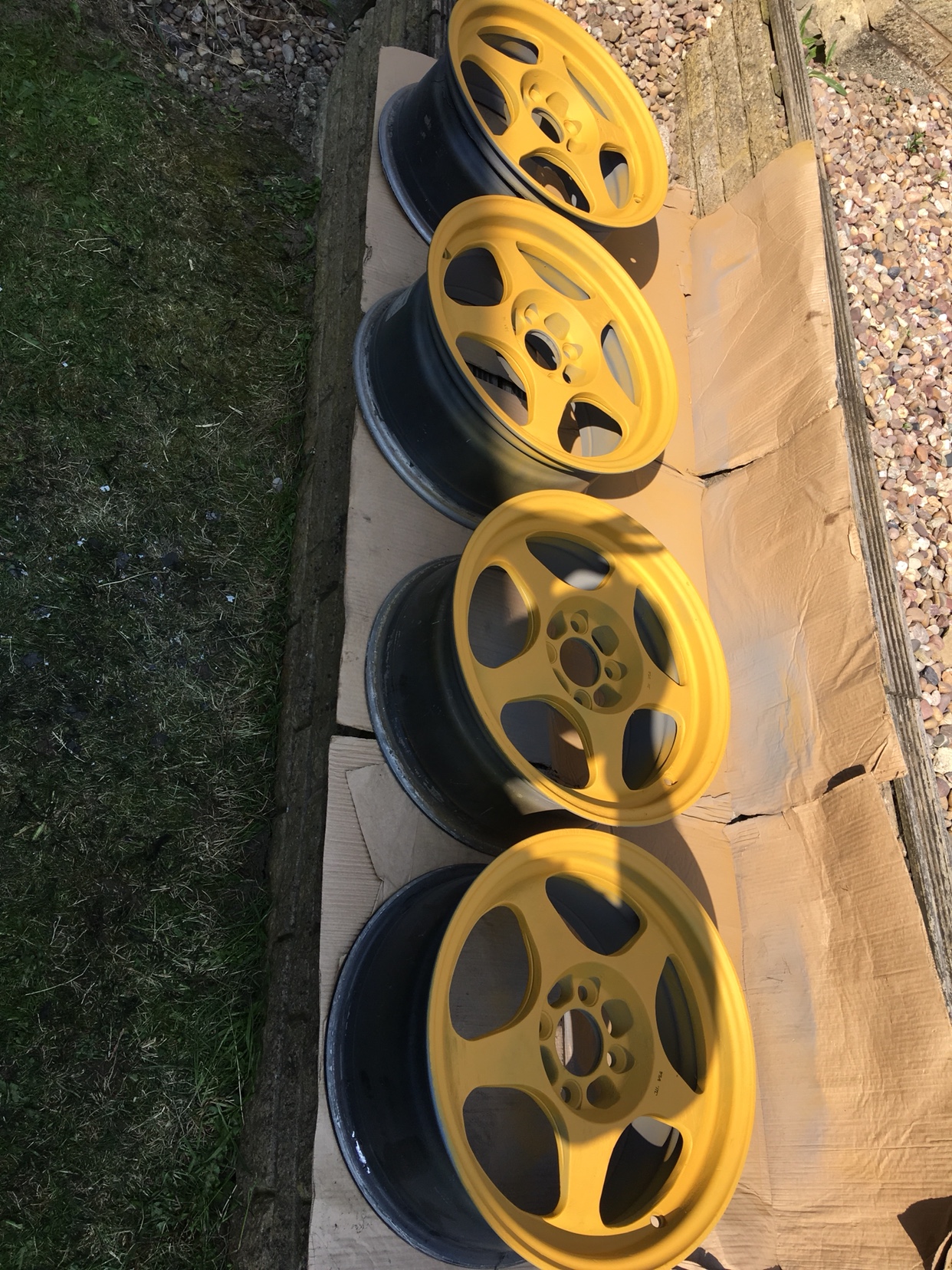

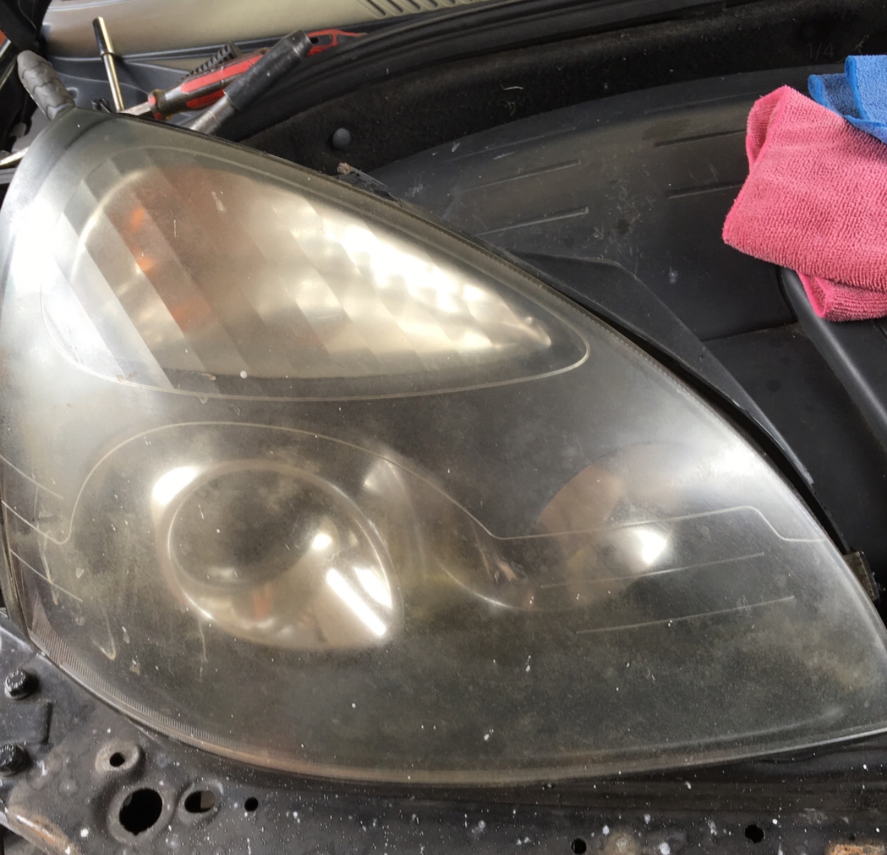

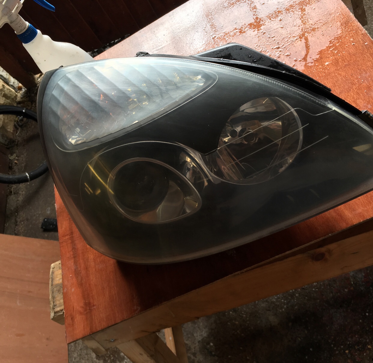

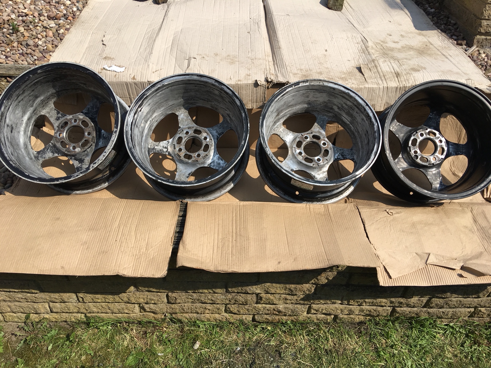

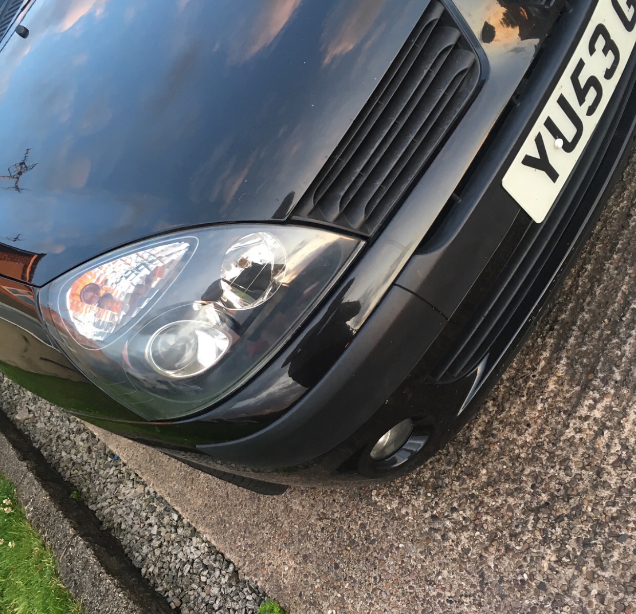

I’ve also got some pics of when I cleaned up my headlights and when I sprayed my wheels so I’ll add them down below :)
Headlight before
During
After
Wheels before
When they’d been sanded down
And after

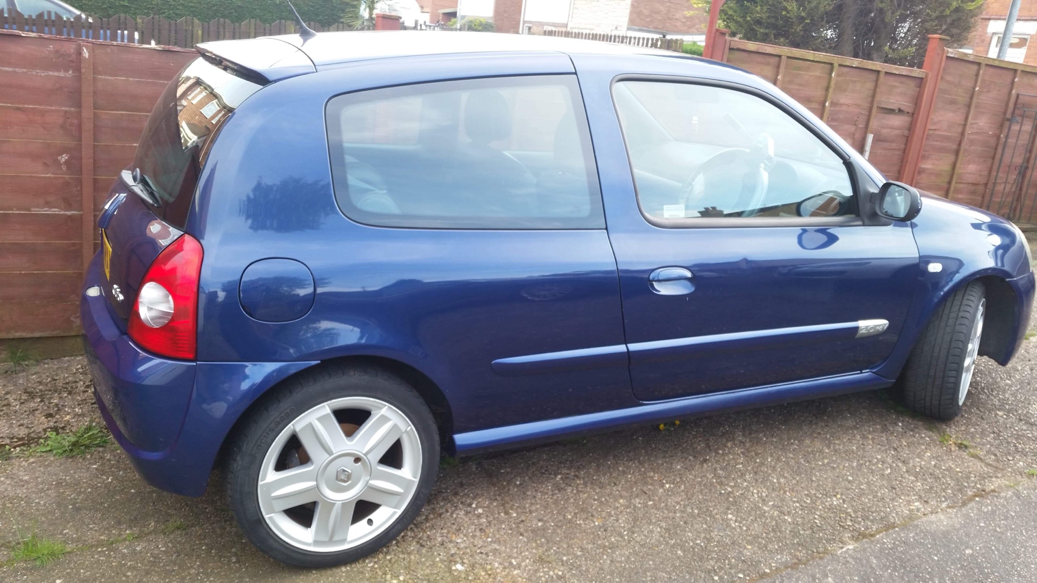

So I finally get to how updates about the 172[emoji1303][emoji23]

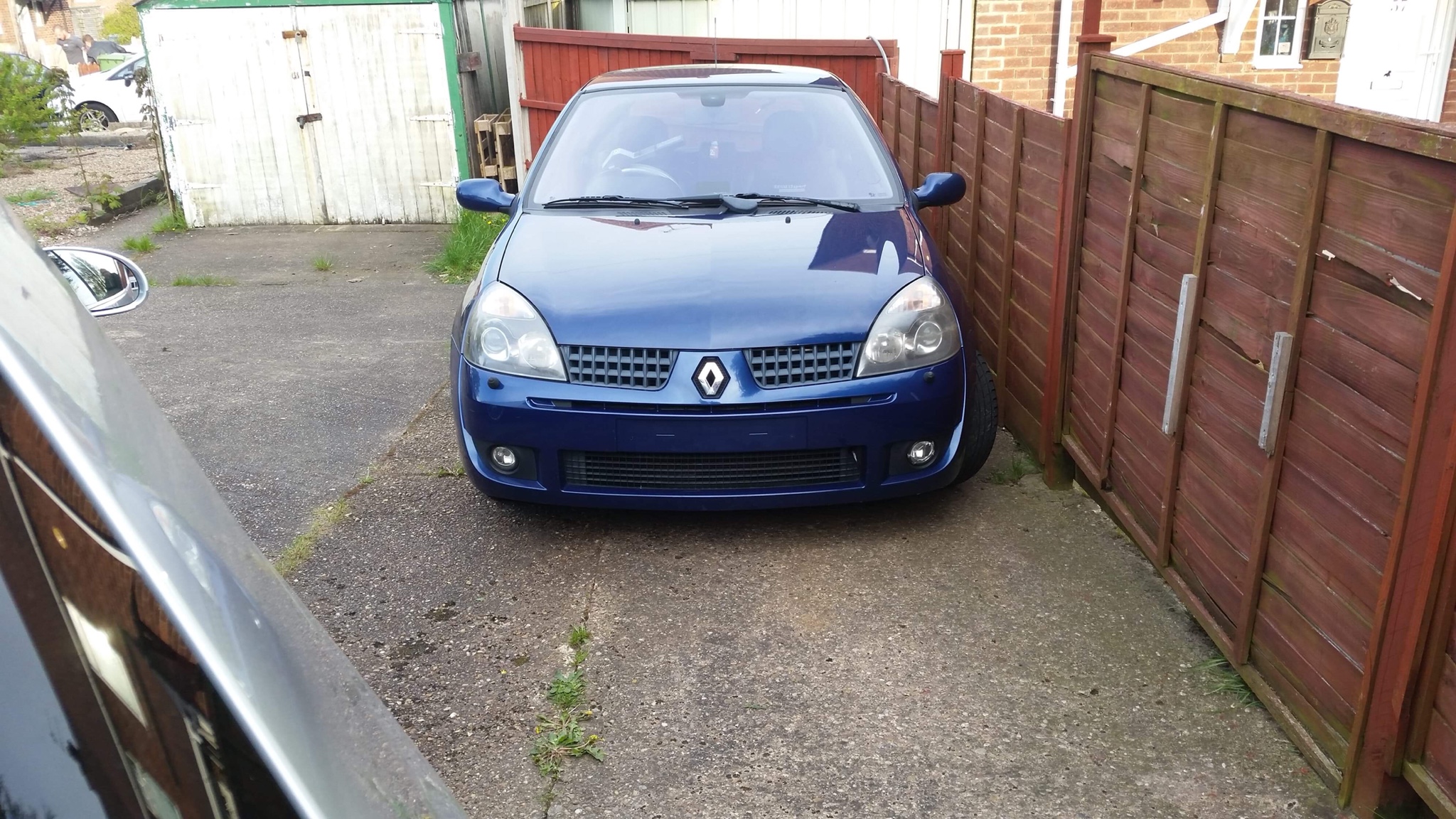

I bought it back in February for a measly amount of money. So far the car has gone from being my fun car to my daily as the dCi decided it’s not allowed to pass an MOT first time ever...

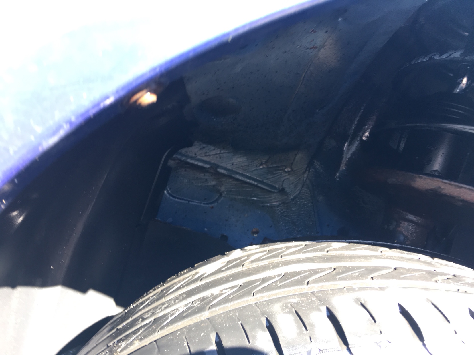

The issues it had when I first got hold of it are:
-Gearbox groan on acceleration and harsh vibrations (I feel this is the spider gearbox mount)
-Gearbox has a massive crunch into 2nd and is developing one into 4th
-Needs an injector and a service as it misses badly on idle
-It’s absolutely filthy!

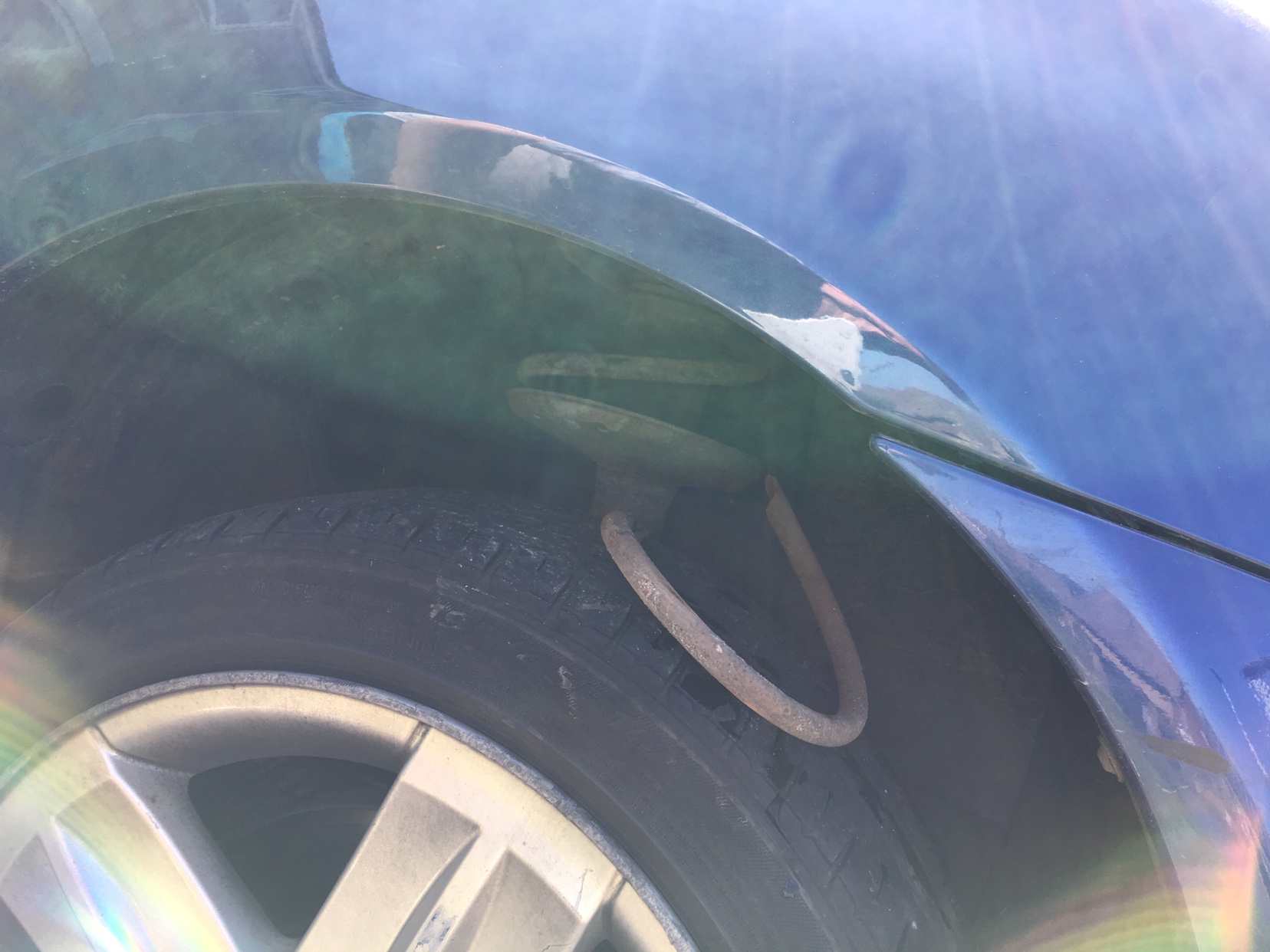

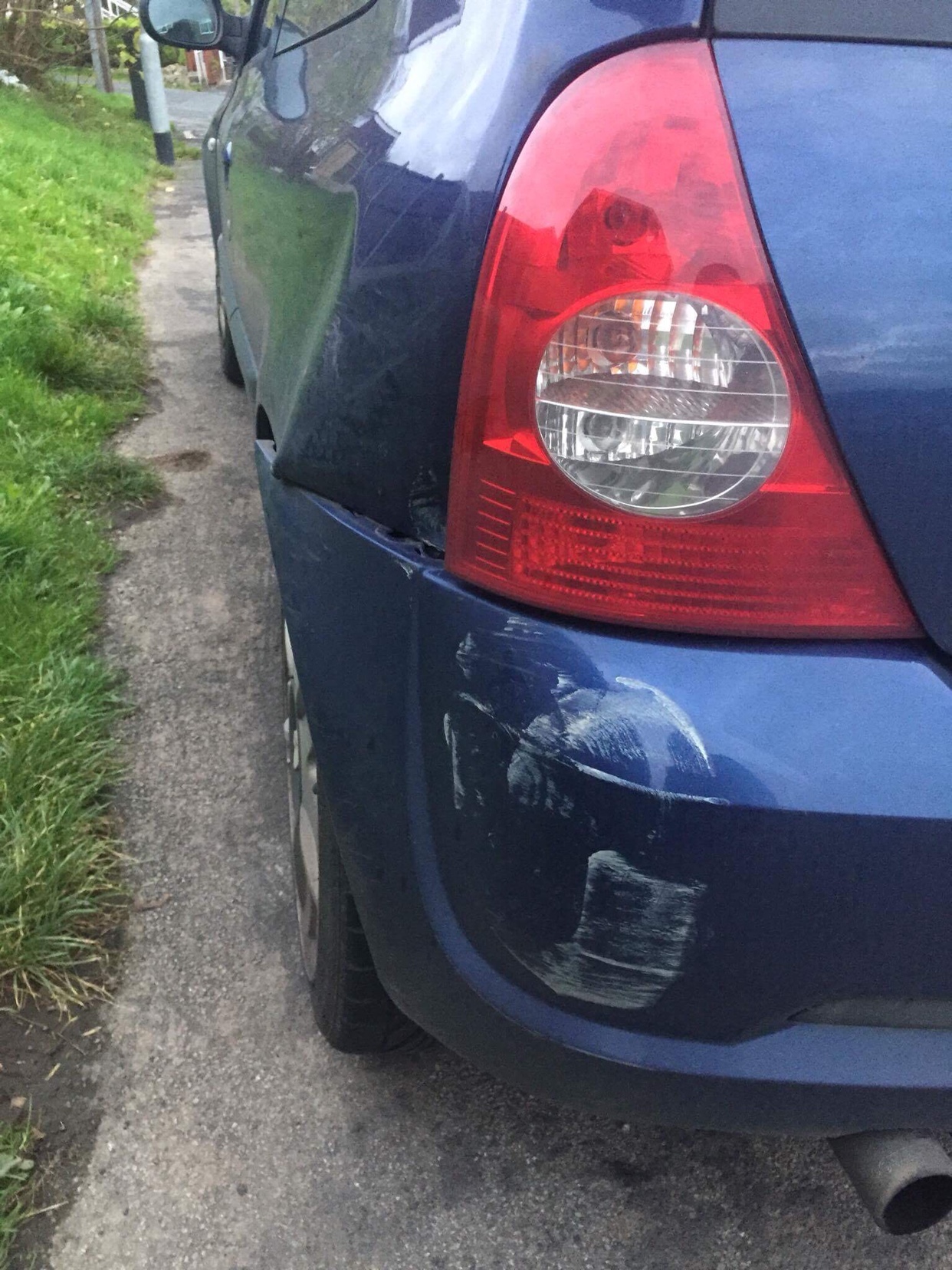

-Nearside rear quarter has a massive ding in it where the previous owner had a fight with a bollard
-It needed a battery as the old one was w**k
-Interior is dirty and all the soft touch has gone a bit sticky
-Oh and did I mention that it’s absolutely filthy!!!
Other than these issues the car drives bang on and pulls very well. I’ve had countless people try and pull away from me in A3 diesels and stuff of that sort but I’ve just dropped a gear and roared past them and they’ve looked at the car like “WTF how fast a that 1.2 Clio”[emoji23]
The only Mod it currently has is a Powerfliw backbox. However, this will soon be changed as I already have a mountain of parts to go on the car![emoji102]
A pic of the rear quarter, it looks particularly bad in this pic though

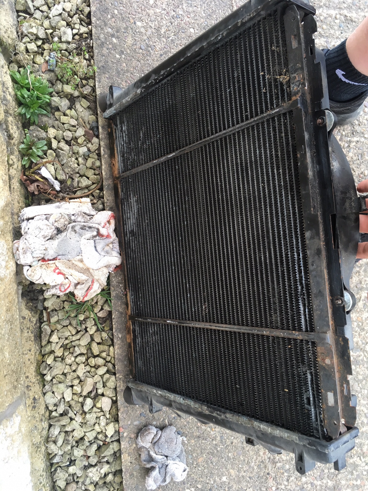

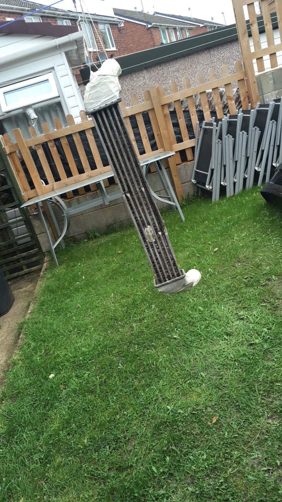

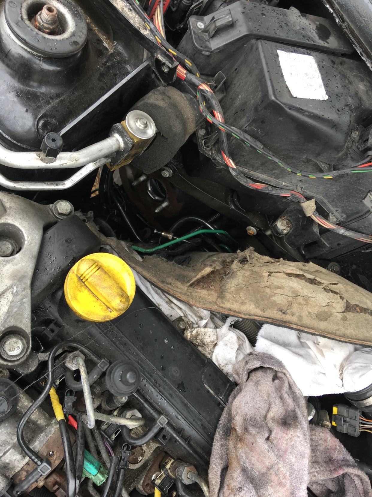

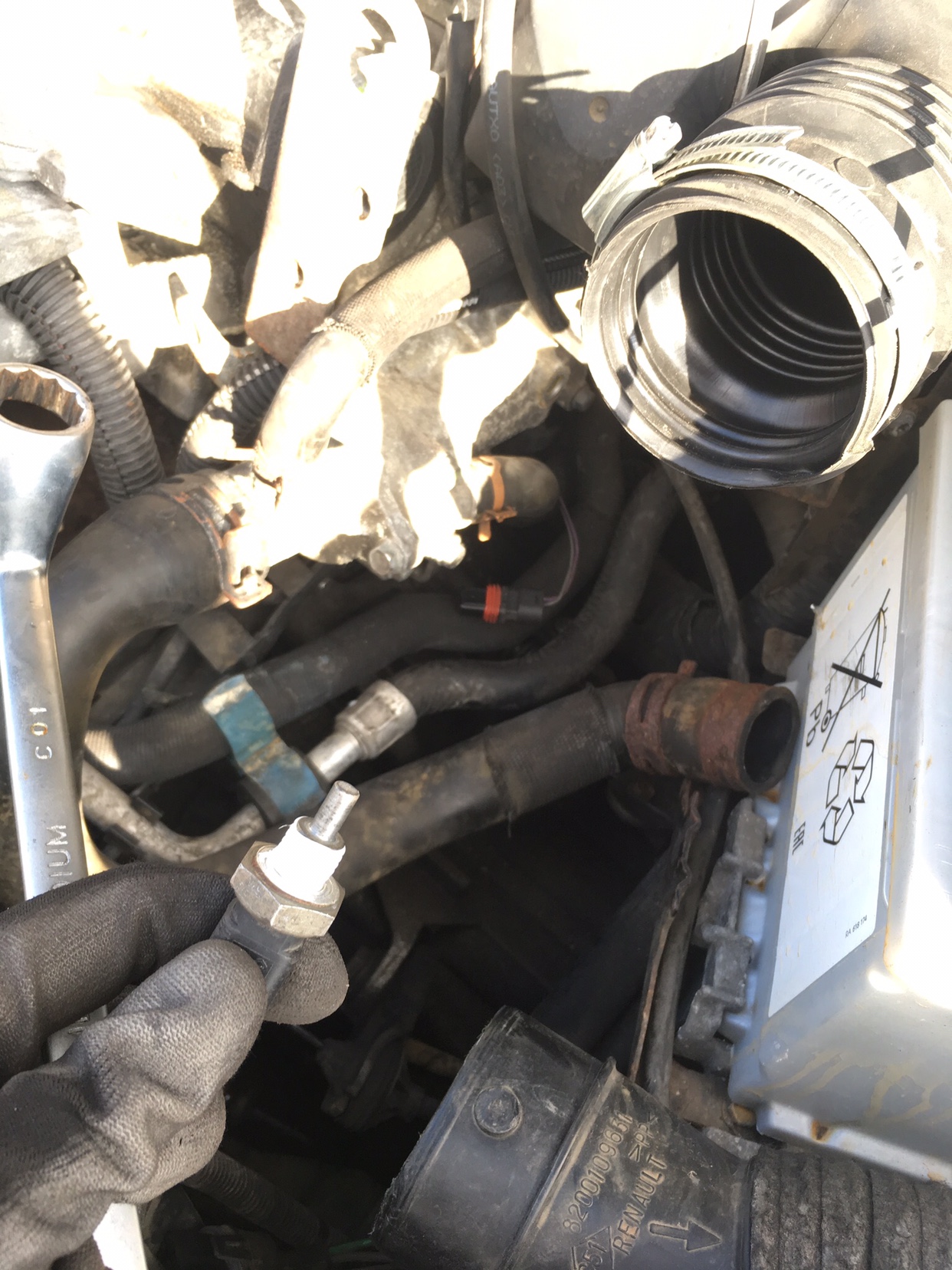

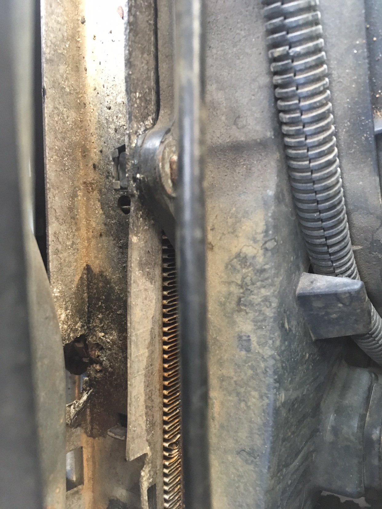

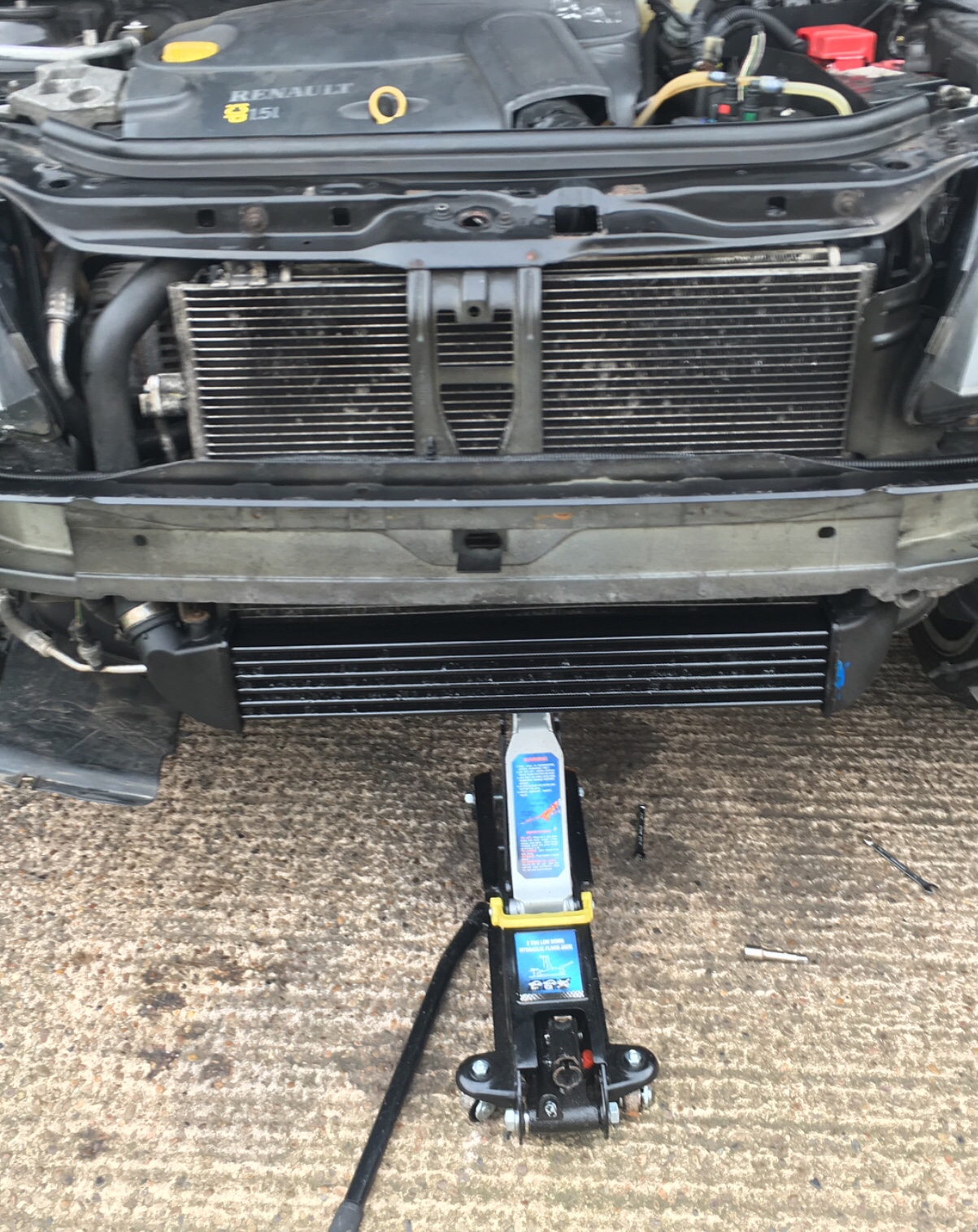

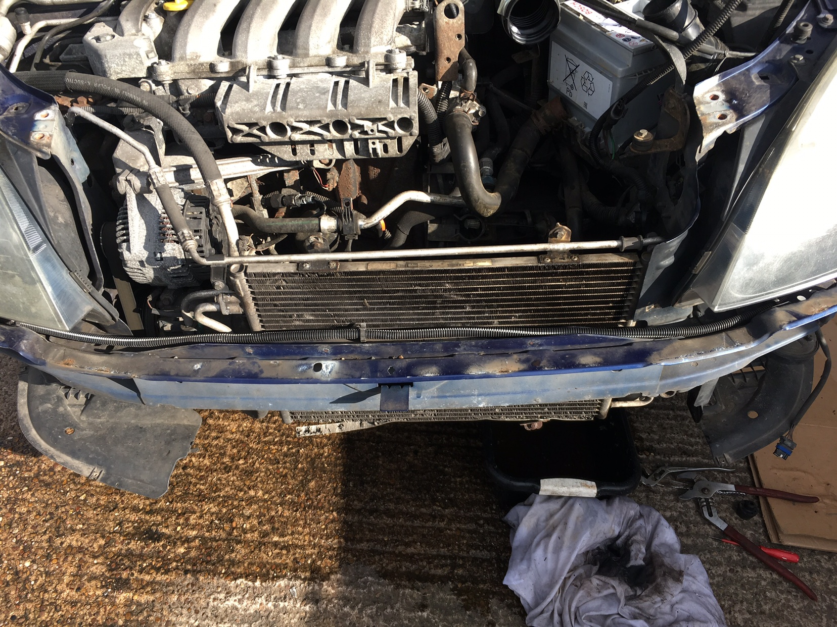

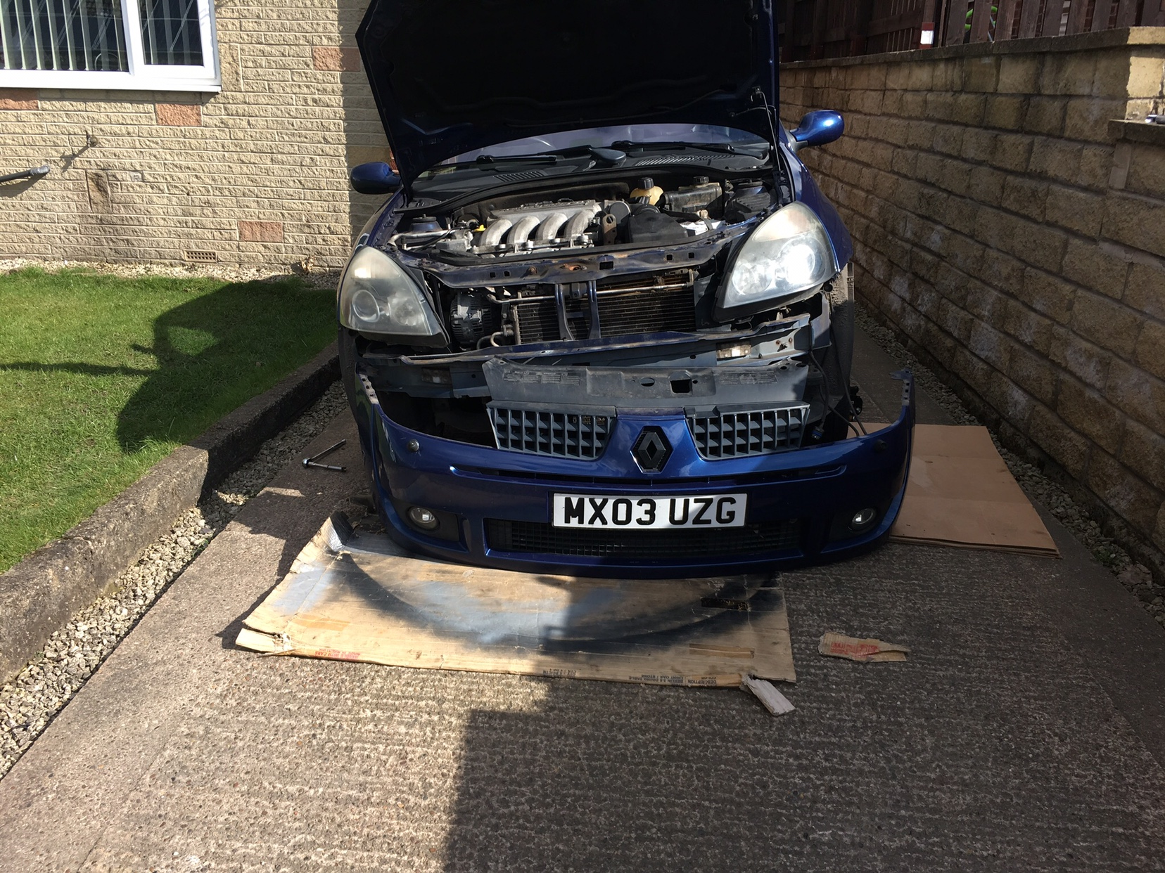

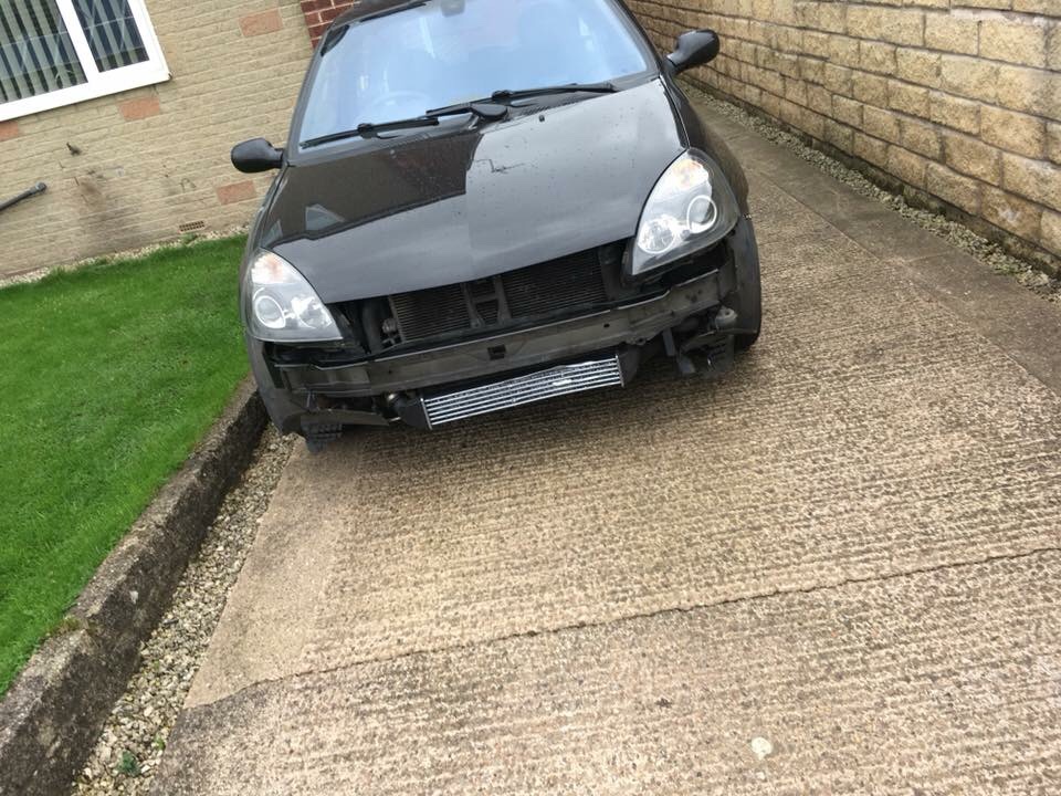

Well about 3 weeks ago I was driving along Otley Road and I notice the fan kick on, I though it was weird as I’d been driving like a granny through Leeds and through all the speed cameras.
So I pull into the BP garage to see what’s what as the blowers had gone cold too. Much to my amazement my expansion tank is completely dry!! Luckily I was outside the shop so I went in and bought 5L of water just to get me home as I thought it would start gushing out. So after about 3.5L of water I notice no leaks etc and there’s no mixing of oil/water so the head was fine. LUCKILY!
I drive home which is about 12 miles stopping off halfway to make sure it’s not empty again. I notice it’s a little lower than before but it could have just been an air bubble... or so you’d think[emoji52]

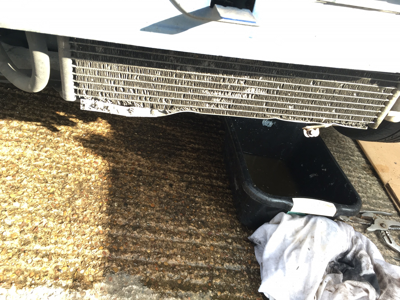

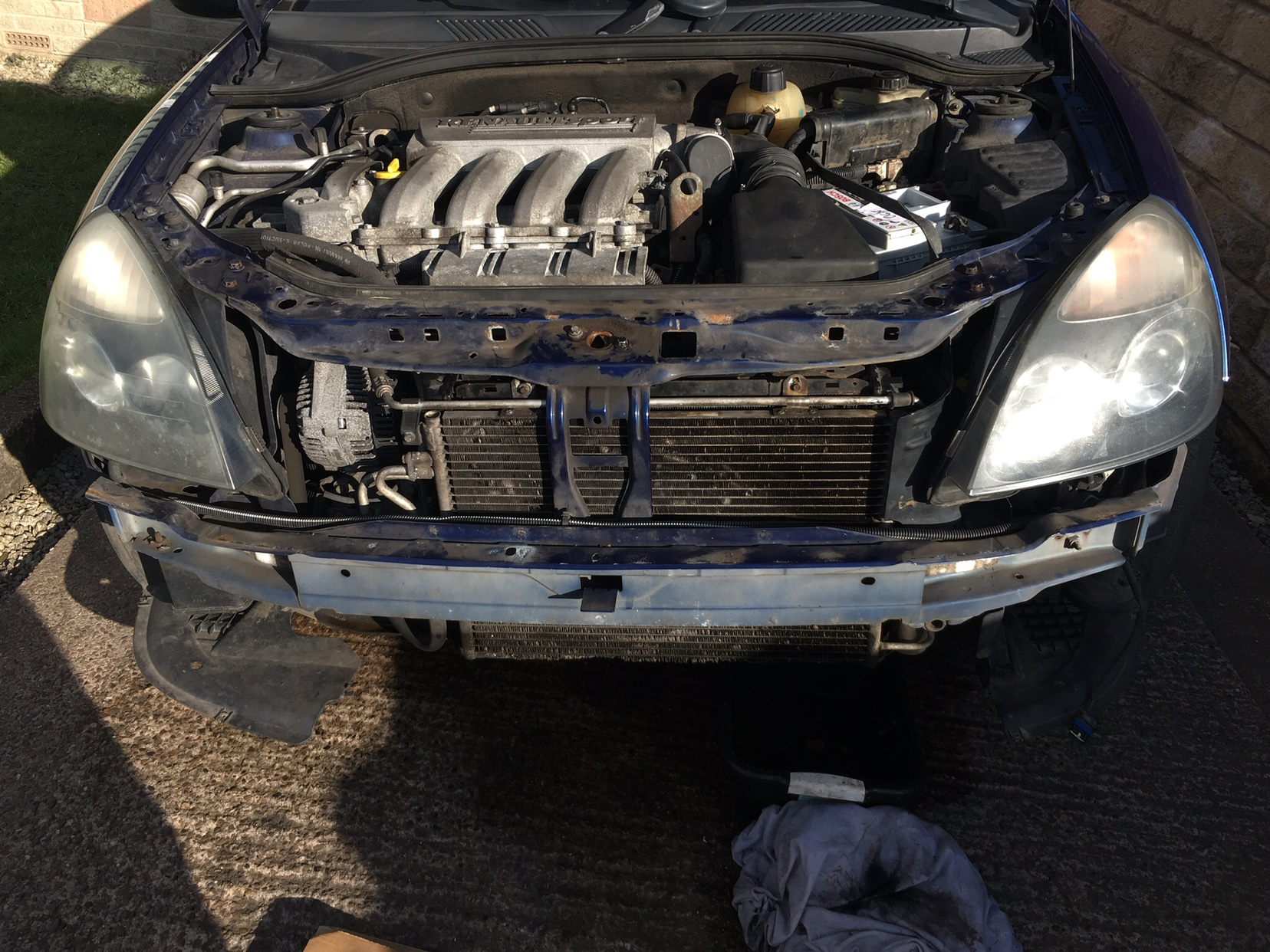

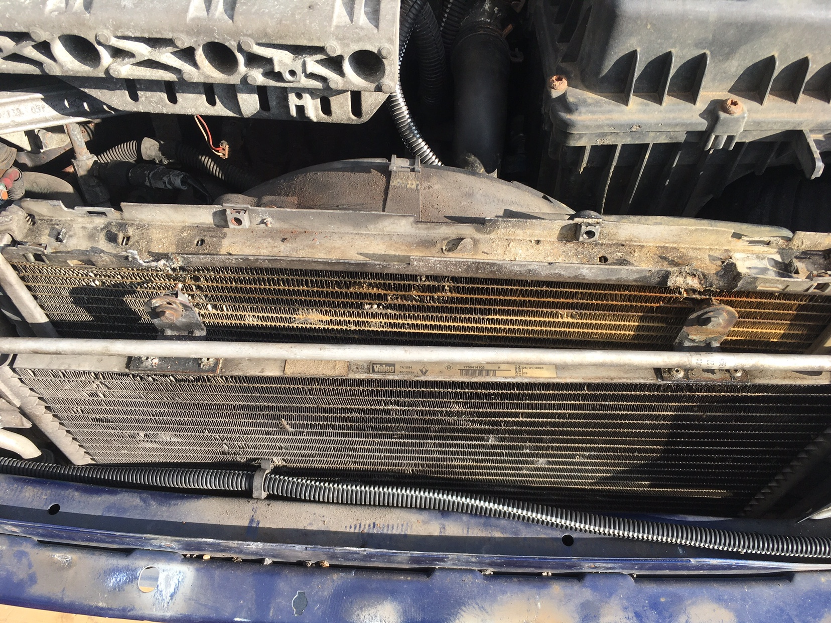

I get home, stick the bonnet up and my rad has a hole in the top and was whistling away like an old kettle!
£20 later I have a pretty much bang on, brand new looking rad pack from one of my mates down the road
So I set to swapping it out. Luckily the sun was out so the beers could flow while I cracked on
Stripping the front end down
My rad was a bag of shite, rotten and looked like it should have blown out in more than one place
The AC rad was completely shagged too so I’ll either replace this or just do an AC and PAS delete at the same time[emoji102]
Old rad and air box out
I took the air box out to clean up the coolant temp sensor

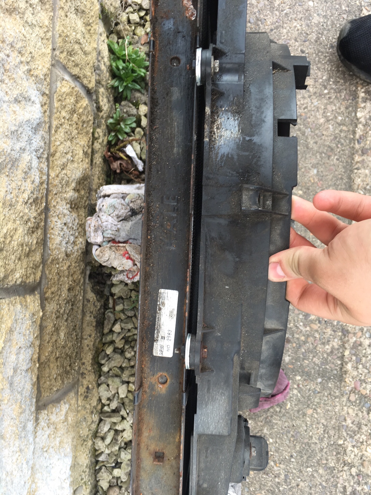

I decided to space the fan off the rad as I’ve had issues with other 1*2’s and friends track cars where a bad fan has just decided to munch it’s way into the radiator on track *sigh*
Front end looking the like a front end again
All done. The day before this I sprayed the Renault diamond black just to see what the black looked like against the blue

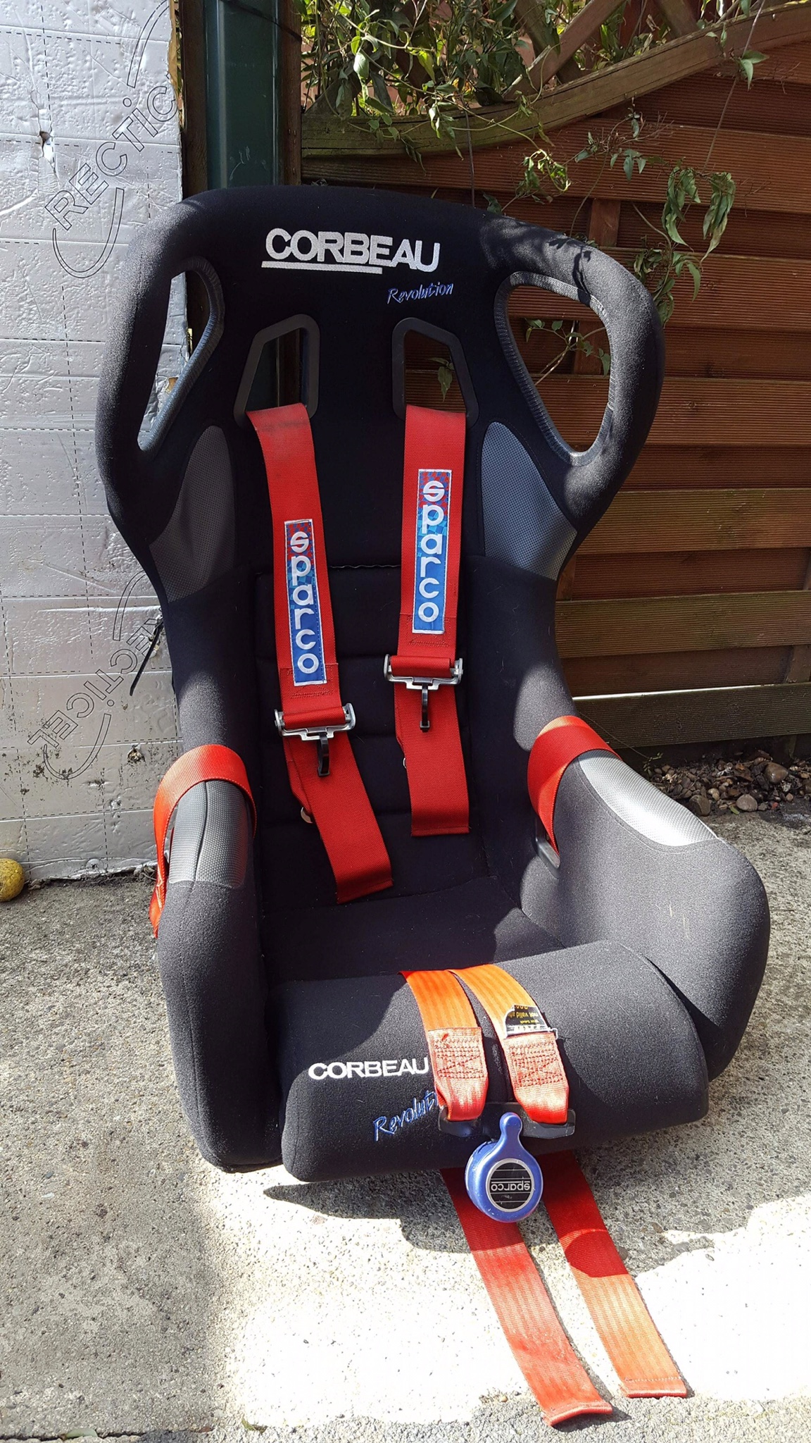

Corbeau Revolution XL with Sparco 5 point

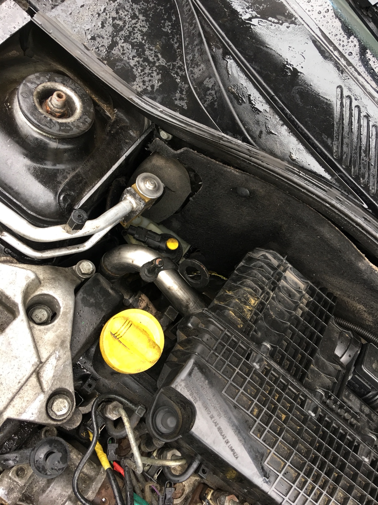

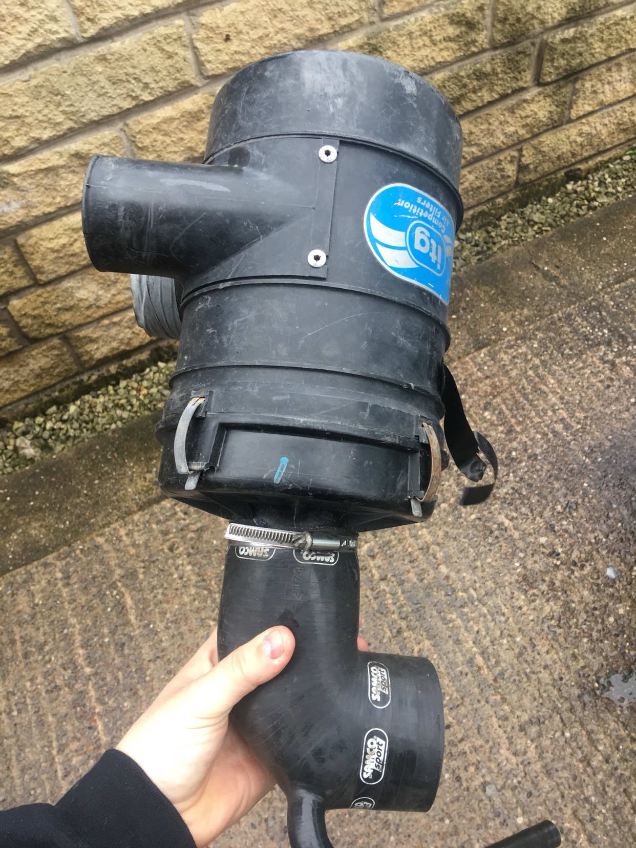

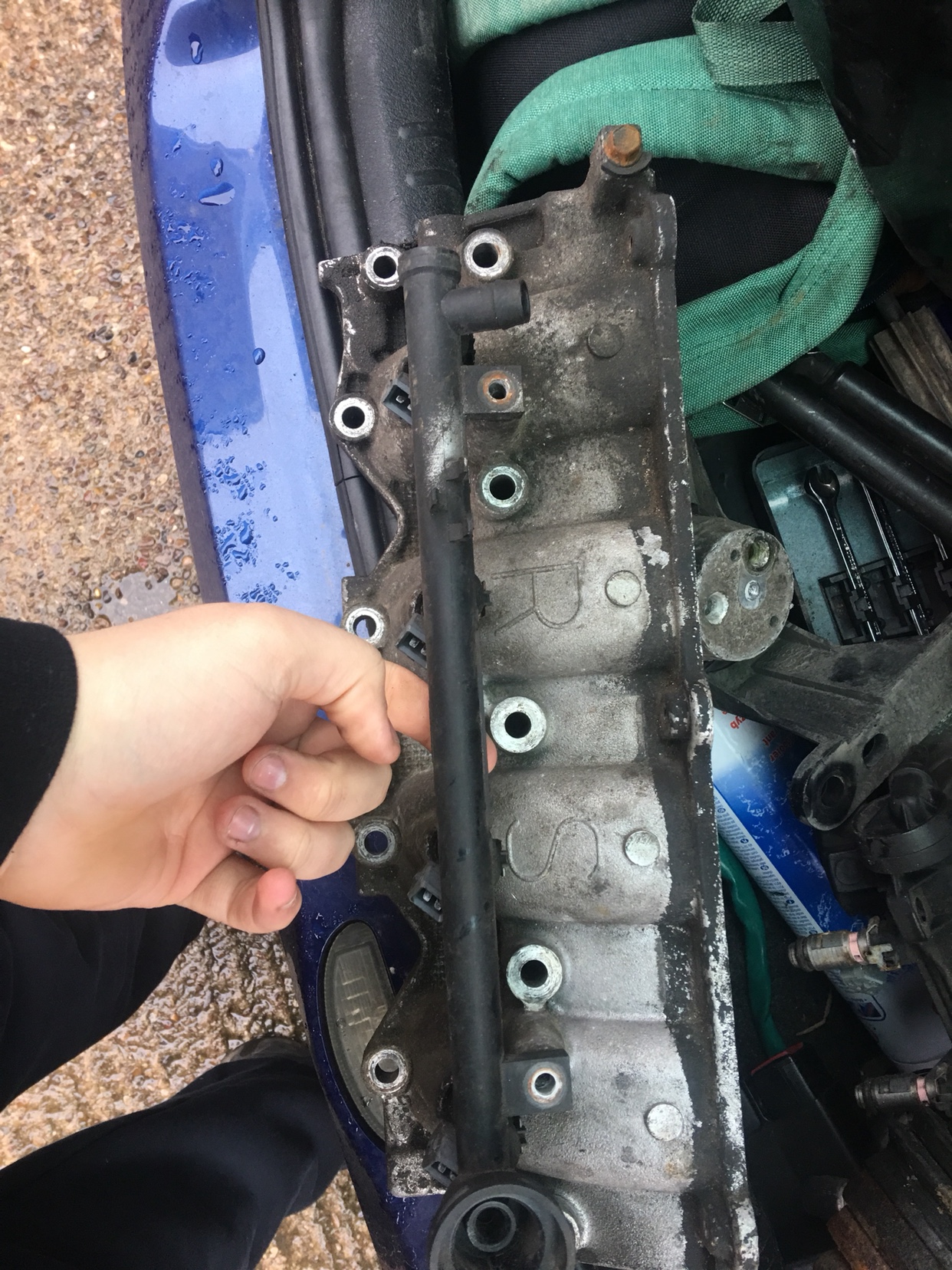

I bought a PH1 airbox with an ITG filter and Samco hose, RS lower inlet and a fuel rail with 4 injectors.
I managed to fit the airbag and injectors but left the inlet because CBA!

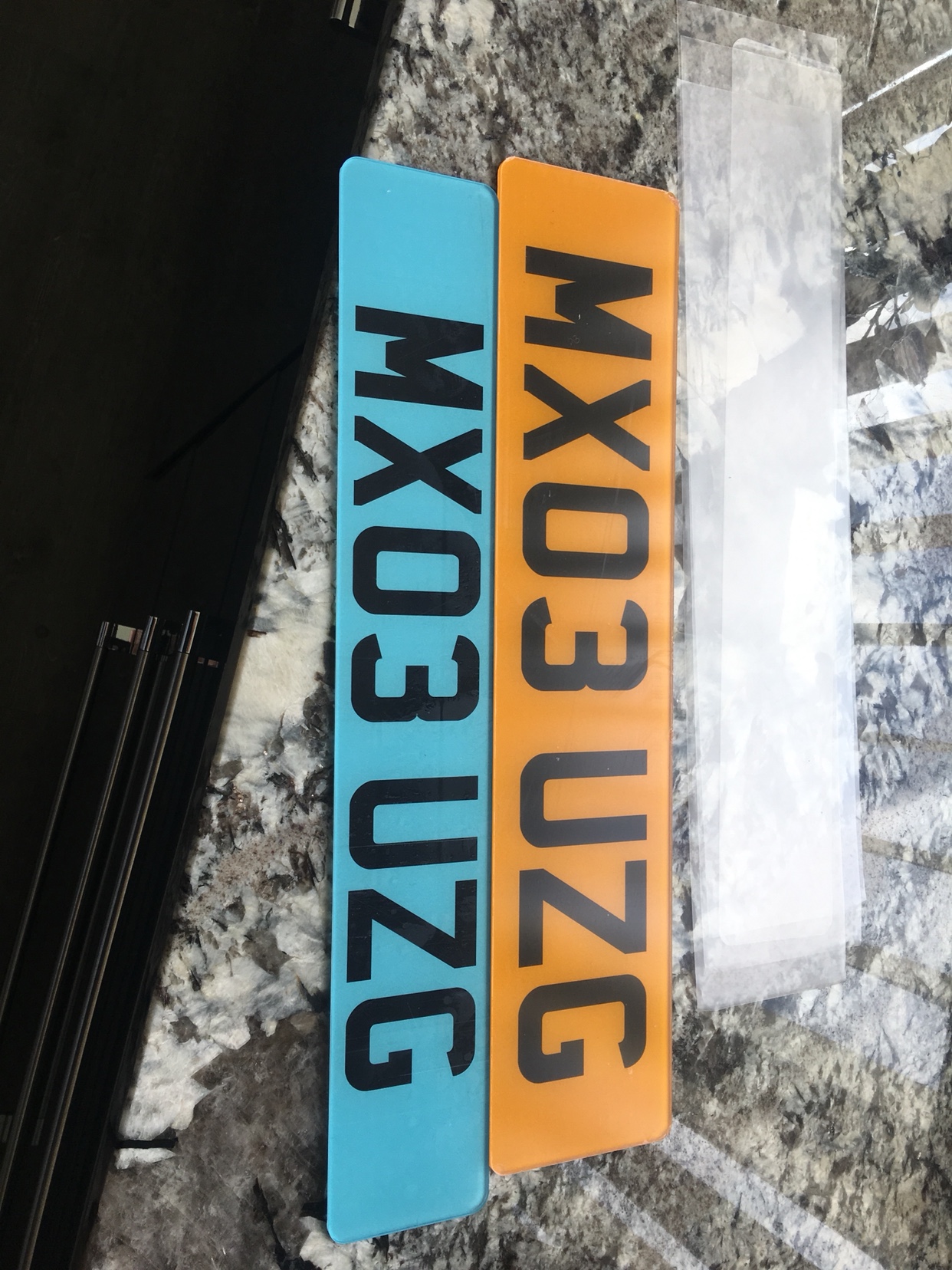

I also bought some new reg plates with a shortened front from ProPlates. Just need some Velcro to stick em on and get rid of the horrible pressed plates

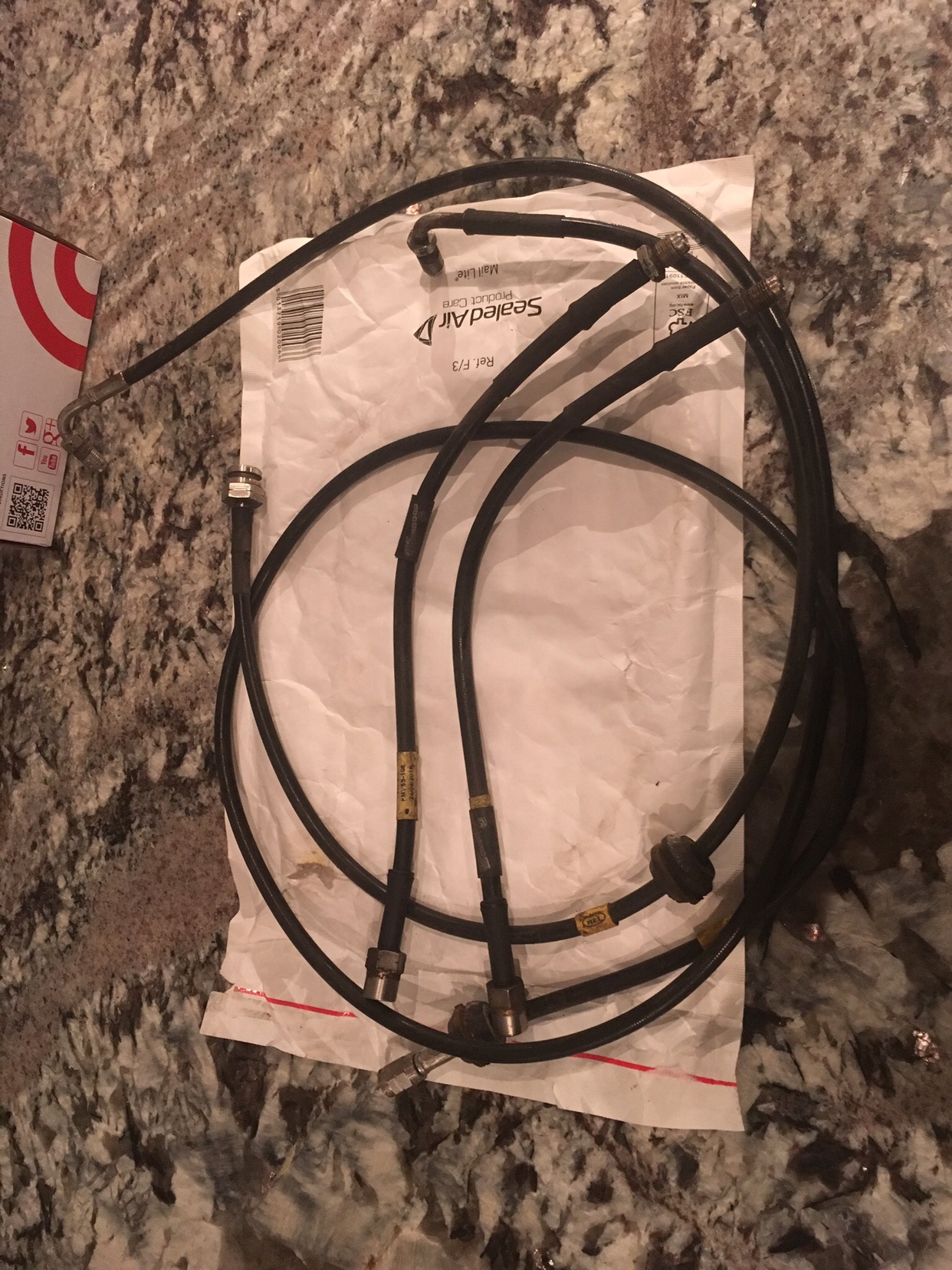

Front and full rear braided lines

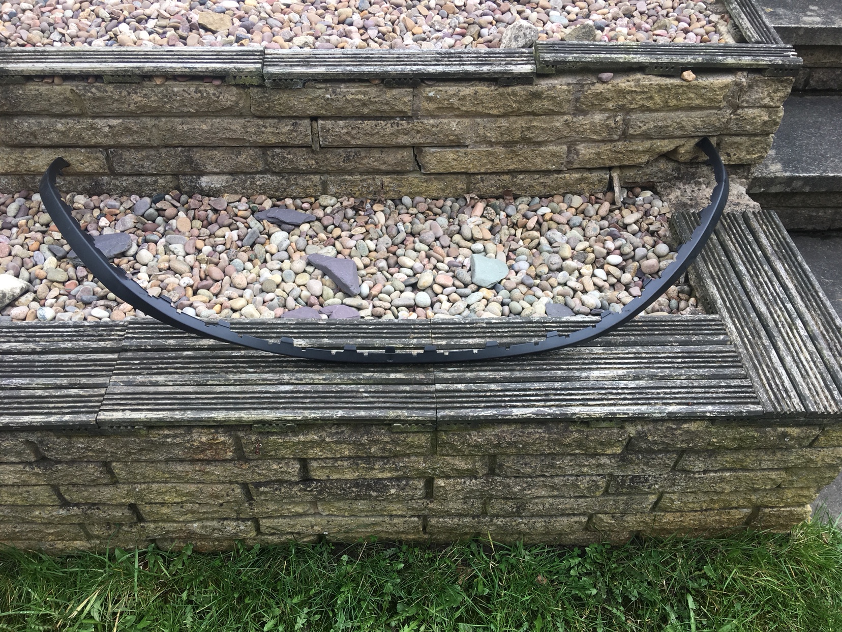

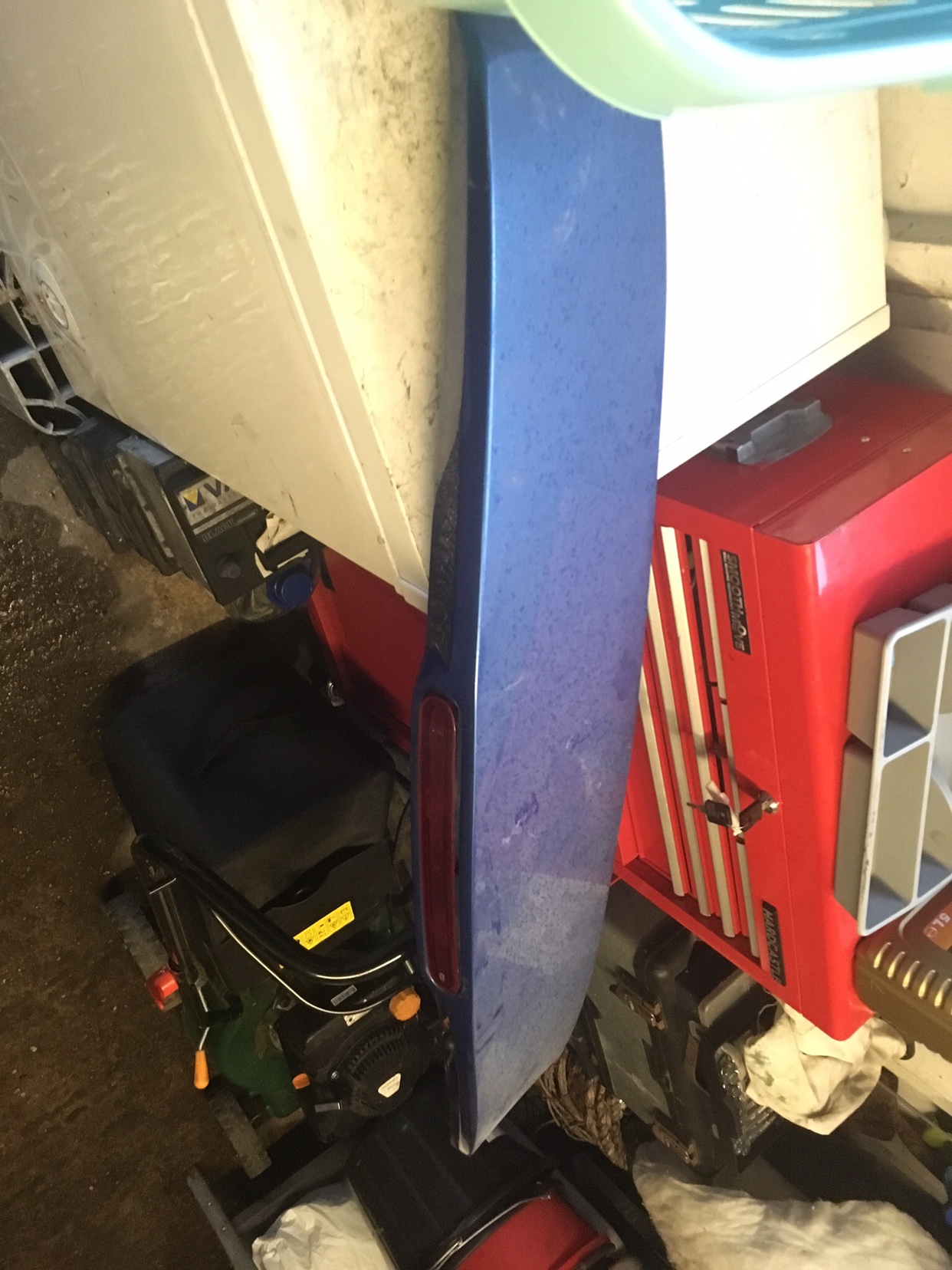

Fabia splitter, cup spoiler and washer blanks

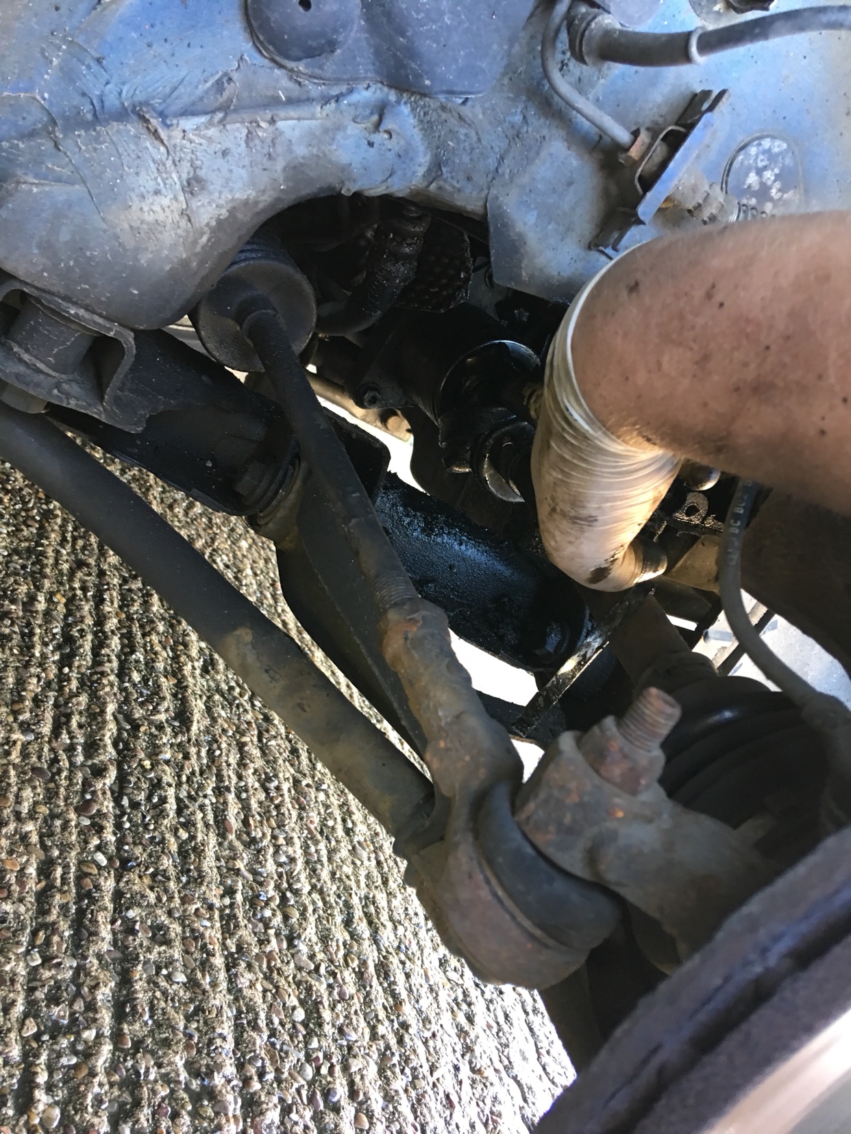

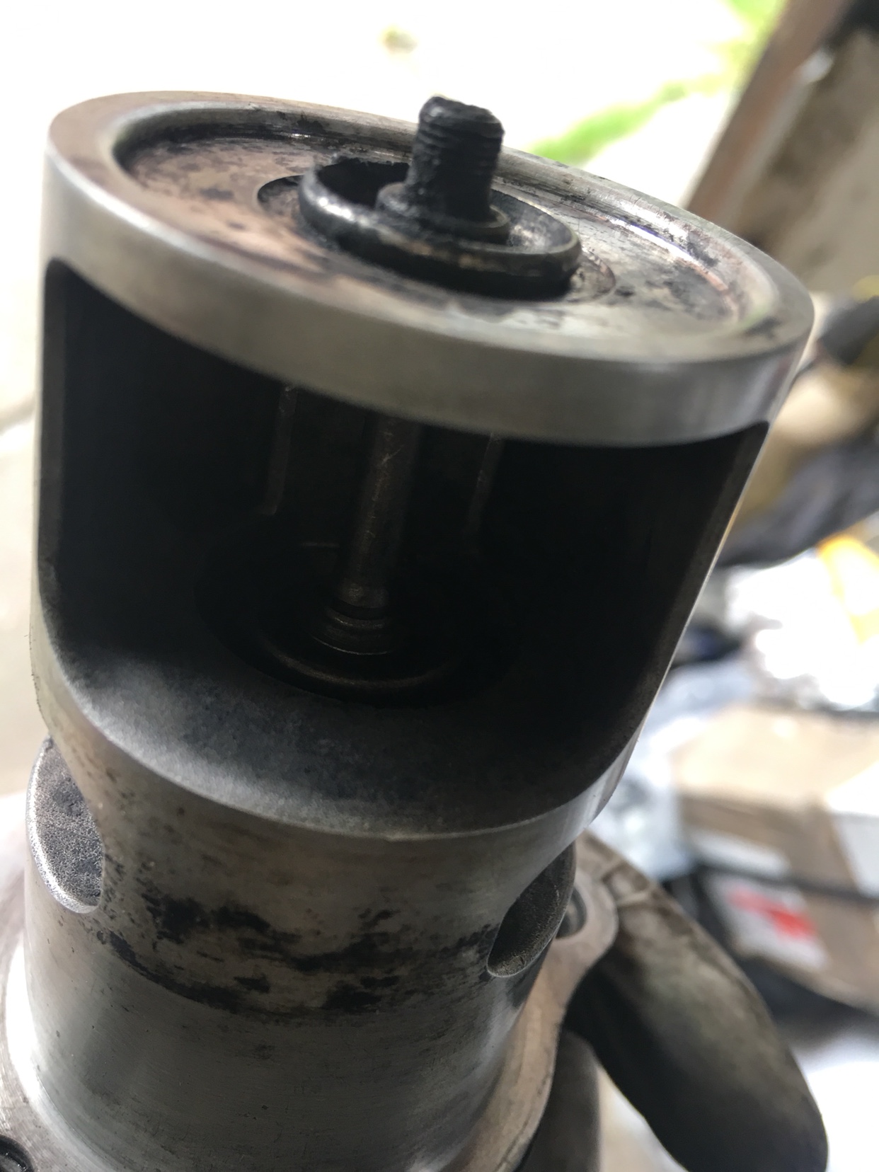

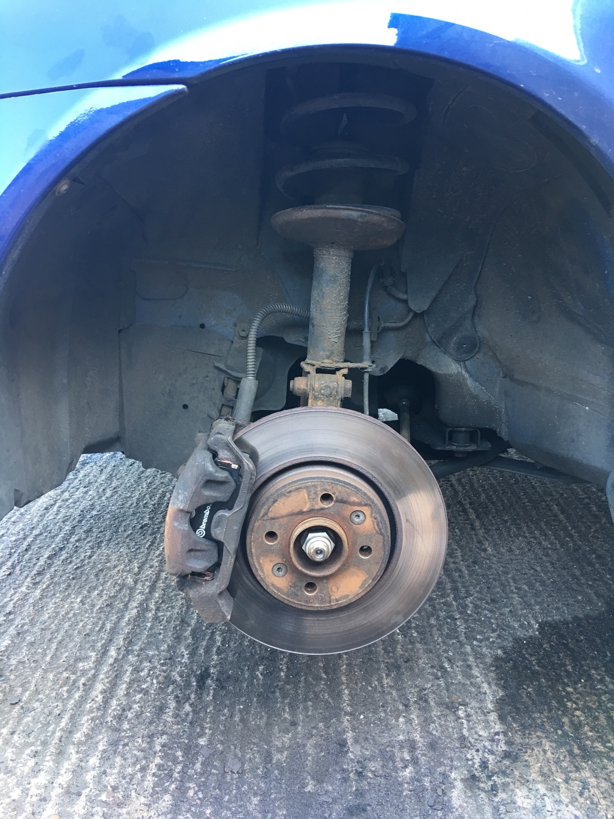

So yesterday I decided that I’d change all the pads out as I didn’t know the exact condition of the brakes and I had a full set of standard Brembo pads lying about.
So I did the rear NS fine, cleaned up the sliders inside all the dust boots and cleaned all the arch up too while I was in there. I did the same with the NS front and then cleaned that up too (the pic after ain’t the best as I’d already put the wheel back on[emoji23])
Before
After... sort of

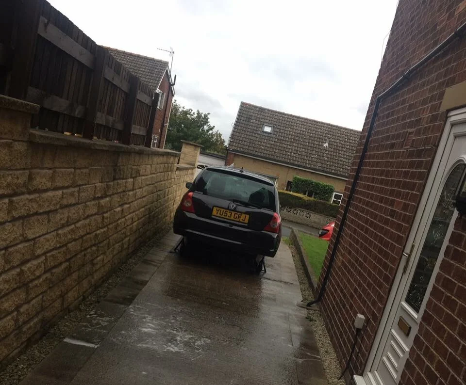

I then went round to do the other side starting with the OS front. Jacked up the car as I was greeted to this...
So I was slightly cheesed off but it wasn’t a biggie because I hoard parts and had a spare spring from my dCi. Not concerned about odd/non paired springs atm as I have the cooksports to go on soon.

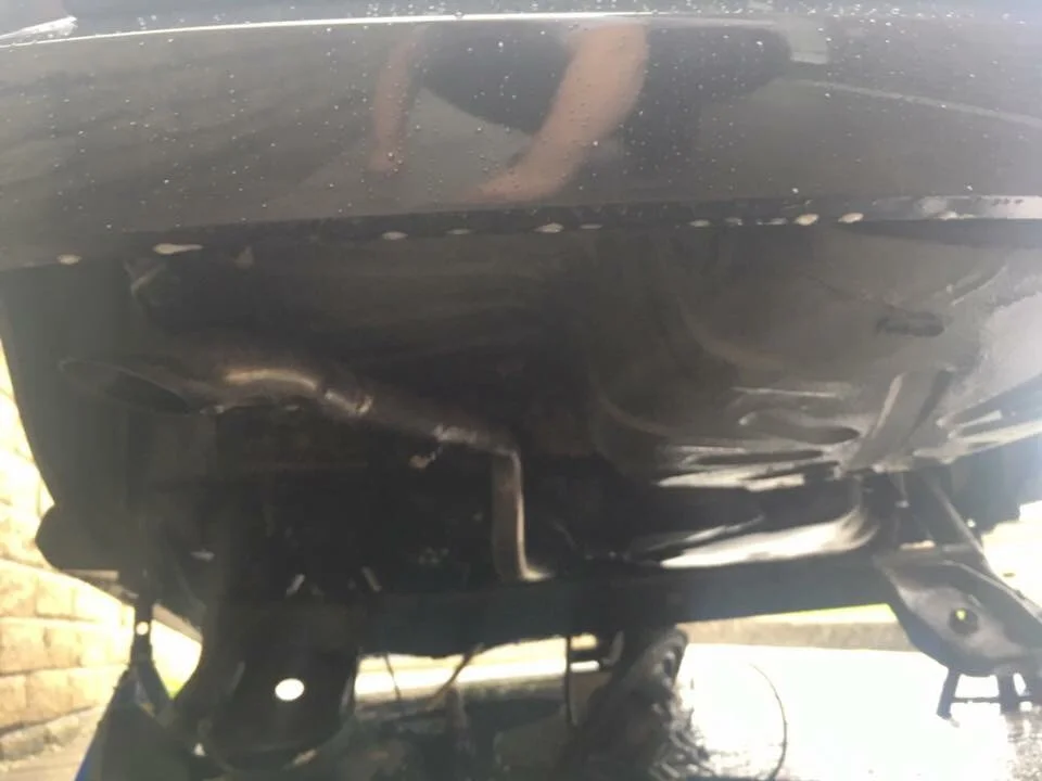

I then took the wheel off to yet again be greeted by another thing[emoji854]
So when the gearbox comes out that part of the block will be getting attacked with the grinder! I currently have a filed down cable tie on there and it just about clears the block. Smashing design from Renault as usual
Did the rest of the car and cleaned up all the arches and then put it back together. Now sat with minor sun stroke, massive headache and my arse cheeks hurt from sitting on the floor all day[emoji23]
No pictures of the car all back together as I was covered in grease and was feeling very ill[emoji23]

I also wet sanded and polished my rear number plate light lense, I bought a new ones but it’s cheap Chinese shite and doesn’t fit properly.
Before
After
Ain’t perfect but looks better

Although I was driving about and heard a weird noise and found this...
My 6 puck belt decided it wanted to live life as a 4 puck with frayed ends and chunks missing[emoji23] Swapped it out with a new one and all is good. Cambelt still looked new even after 60k. I have a full kit to throw on at some point but I now have 3 Clio’s... yeah I kinda bought another one
Another Monaco, I’ll be breaking my Monaco and all the good parts will make 1 great car, or so I hope[emoji23]

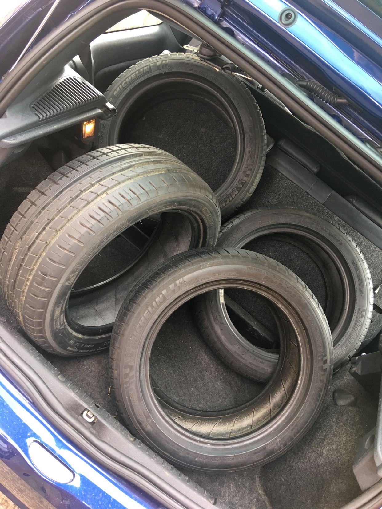

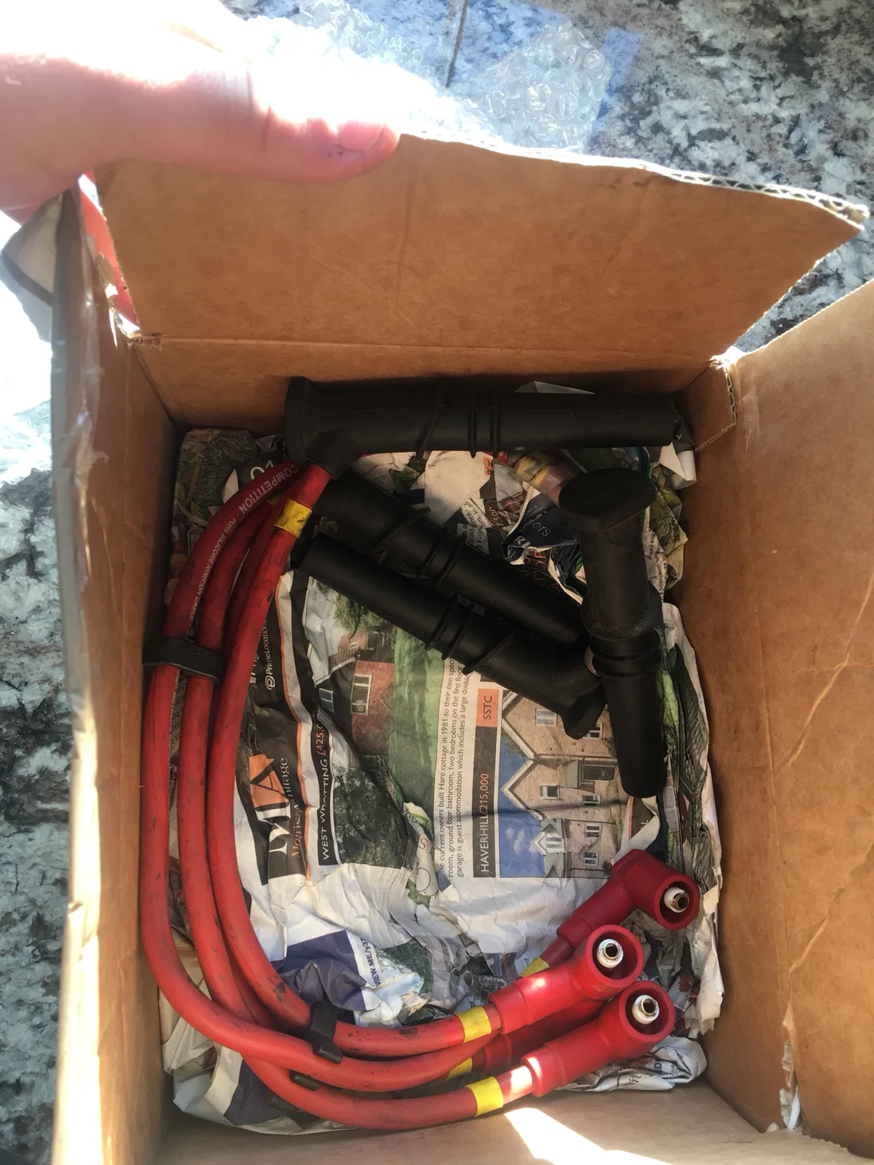

Bought loads of more bits[emoji102]
Michelin PS3’s
Brand new cup shocks
Black series insert
Magnecor leads
Another 197 steering wheel[emoji102][emoji23] One with cruise buttons and the RenaultSport insert
I’ve also cleaned back my Rota’s, primered the faces and barrels and filler primered the faces ready for sanding back

Oh yeah, I forgot to mention I bought another Monaco 172[emoji23][emoji23]
1 ever so small ding in the drivers door, luckily the other 172 has a lovely and straight door! Cha-ching!!! And the usual dint in the bonnet, not so bad that though!
Possibly the most unmolested 172 I’ve seen. The engine bay is stupidly clean and still has the illusive ECU bracket intact
Stupidly clean body, barely even touched tbh. It has supposed cambelt failure and the bloke that had it bought it for the cat and then sold it on to me. Its only had 4 owners (one is me) and the bloke that bought it before me didn’t even have the logbook back from the DVLA yet so he’d not had it long[emoji23]
The plan is to take all the nice bits from mine (mainly the engine) and make 1 lovely car out of 2.

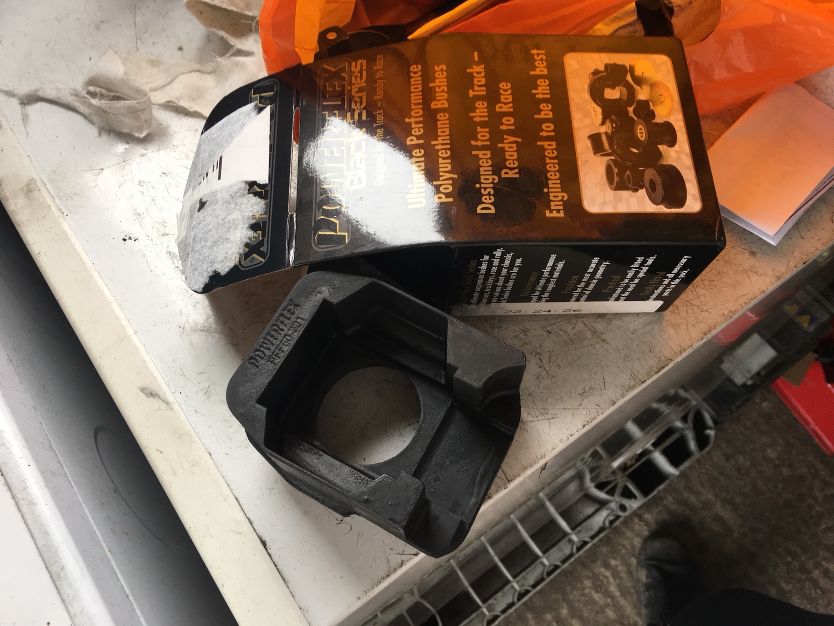

So far I’ve got pretty much every polybush mount you can think of bar the rear shocker mounts and upper gearbox mount, most of which are black series or Strongflex 90ShA[emoji23]

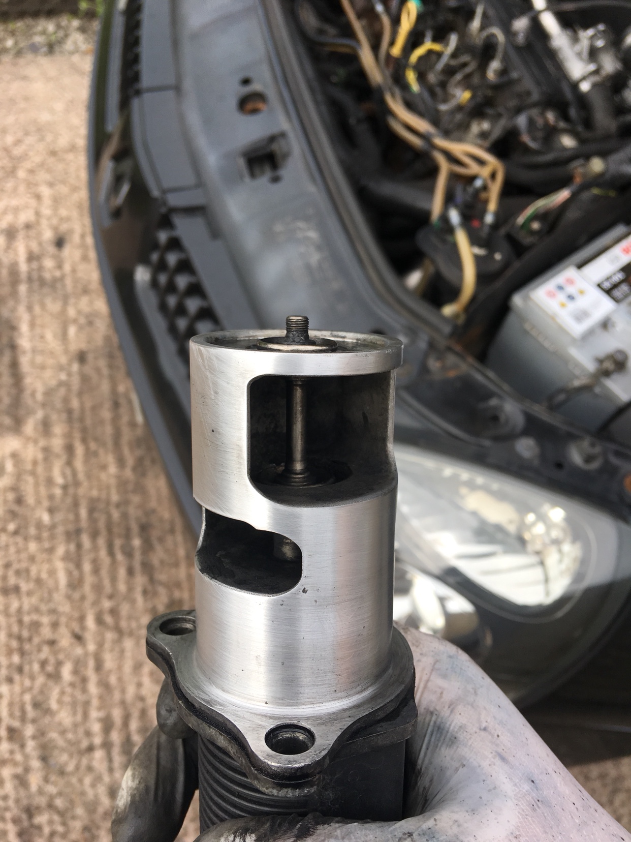

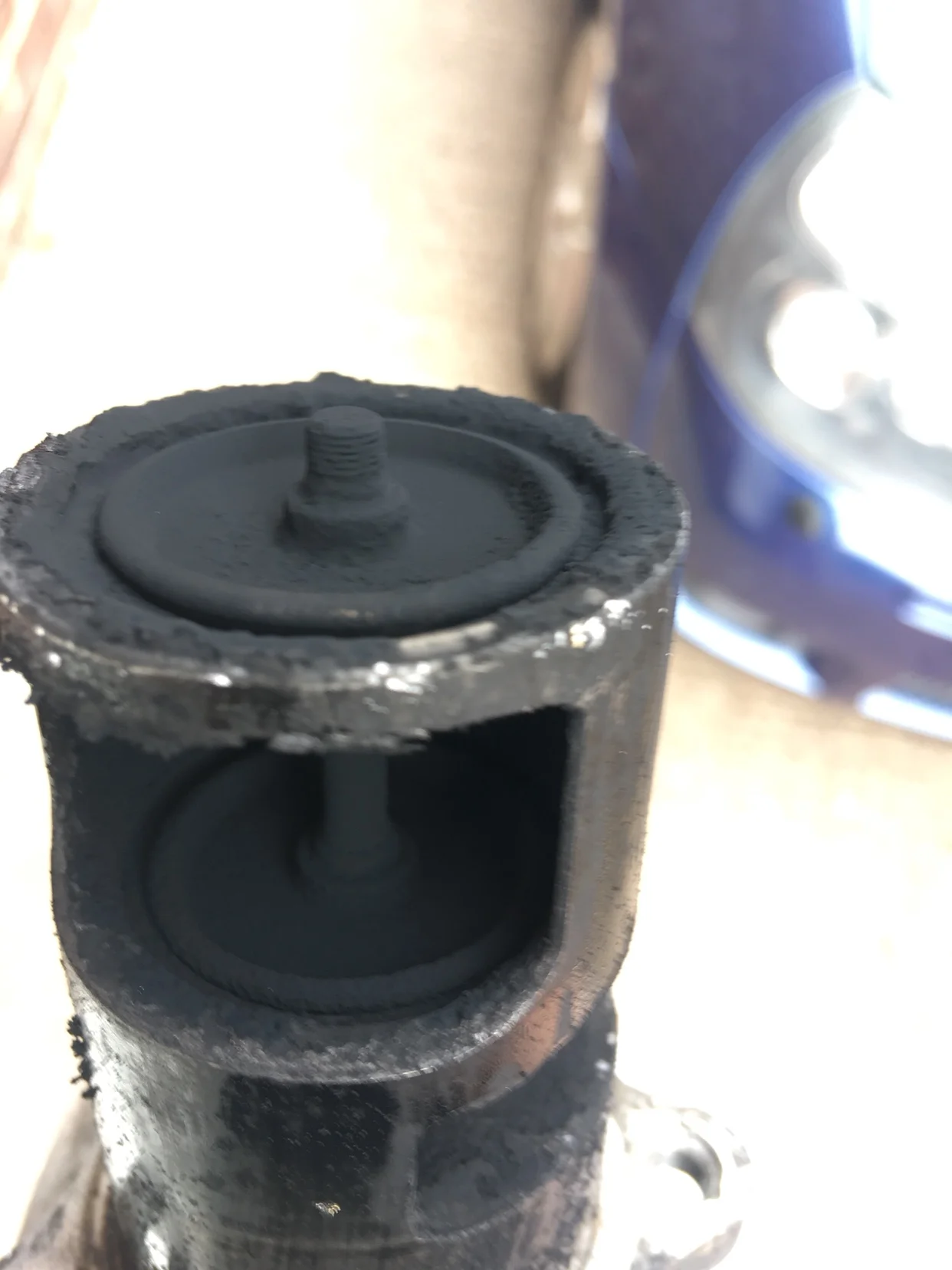

I changed the EGR, boost solenoid, MAP sensor and MAF sensor today as it’s been a bit s**t on boost and comes in and out. 100% not getting the full 18psi, then I’ll take my foot off and plant it again and it’ll pull like a lonely bloke on his rodger.
My old EGR with a large opening
The one I replace it with from my breaker car[emoji848] Drives bang on so I’m not fussed
Looked better once I’d cleaned it up too

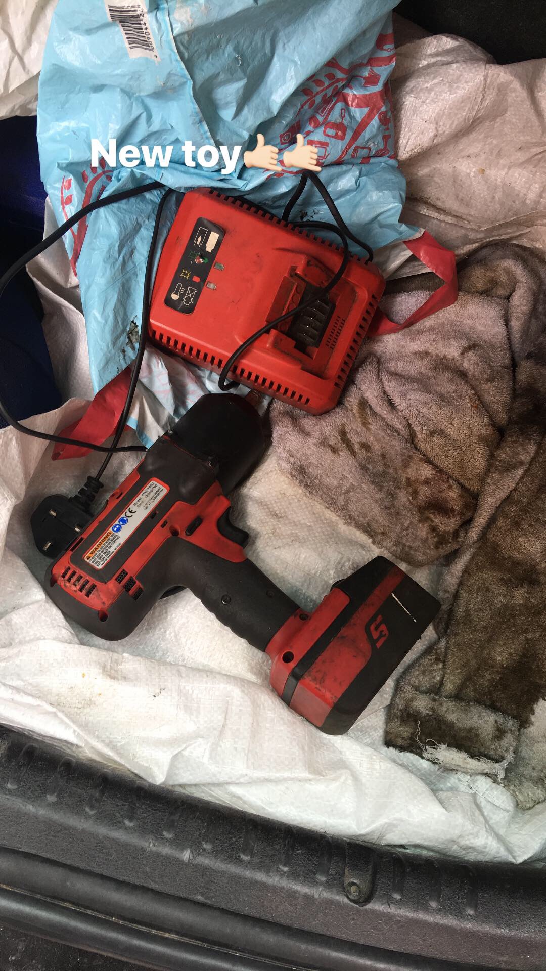

I also bought a new toy too[emoji102]

Changed all them parts on the dCi and it started running like a bag of s**t and I got barely any boost, I wasn’t getting the variable vane kick or any coo from the exhaust.
So I changed all the parts back, checked the vac lines from the actuator and to the boost module and all seemed fine. I pushed and worked the actuator (I’ve done this before and it’s not really made any difference) but now it gets up and f***s off like never before (figuratively speaking because it’s still not that quick at all). I think I’m gonna open up the downpipe and clean out the exhaust housing because it’s got 245k worth of soot in there??‍♂️[emoji23] I’ve got a spare turbo to play about with and a spare cat to accidentally knock the stuffing out of...
Whoops
