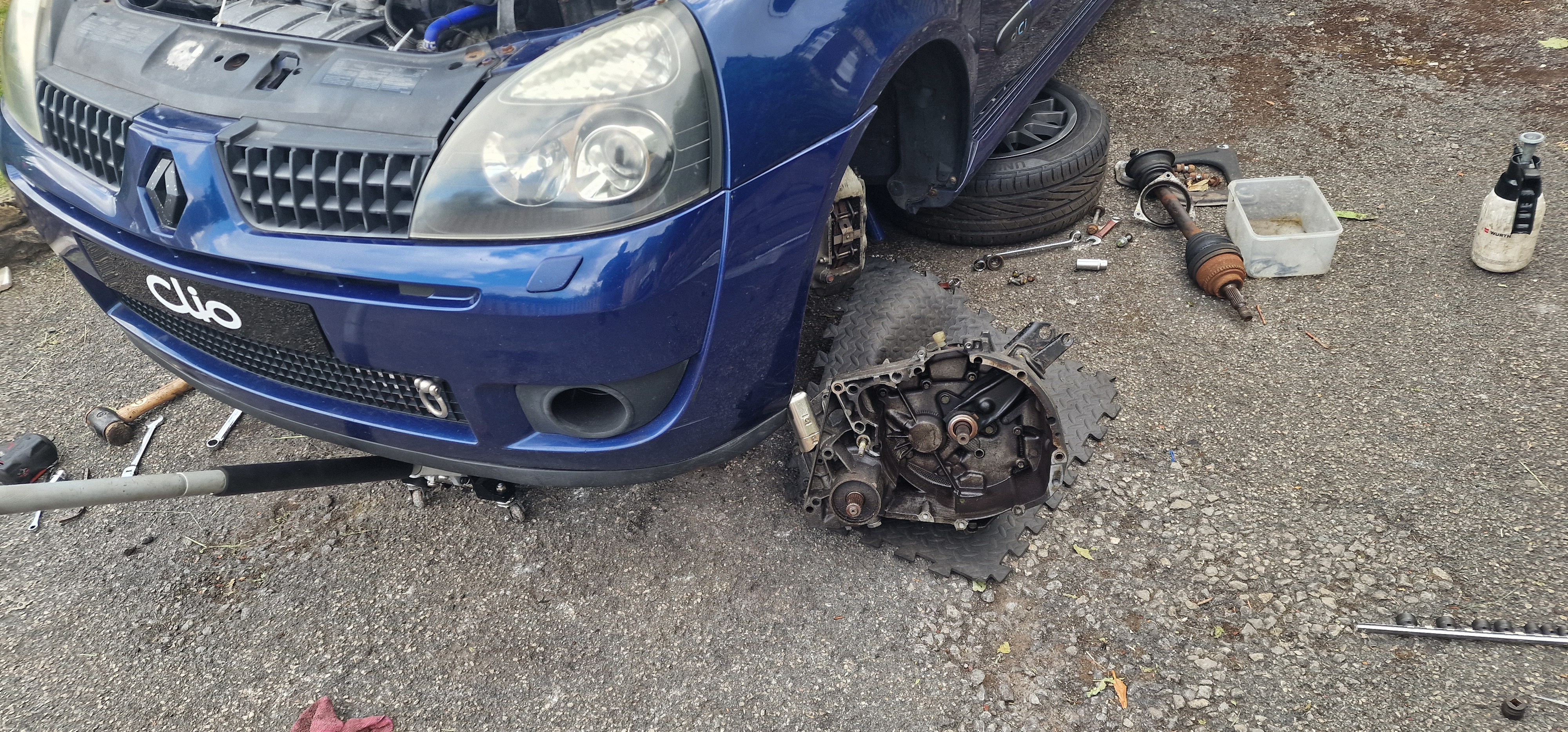

I got my gearbox back from @NorthloopCup
Rather than stick with the Quaife and the 089 final drive Mark talked me into getting a Gripper... and then the 4.28 final drive... 💲+ 💰= 🕊️ 👛

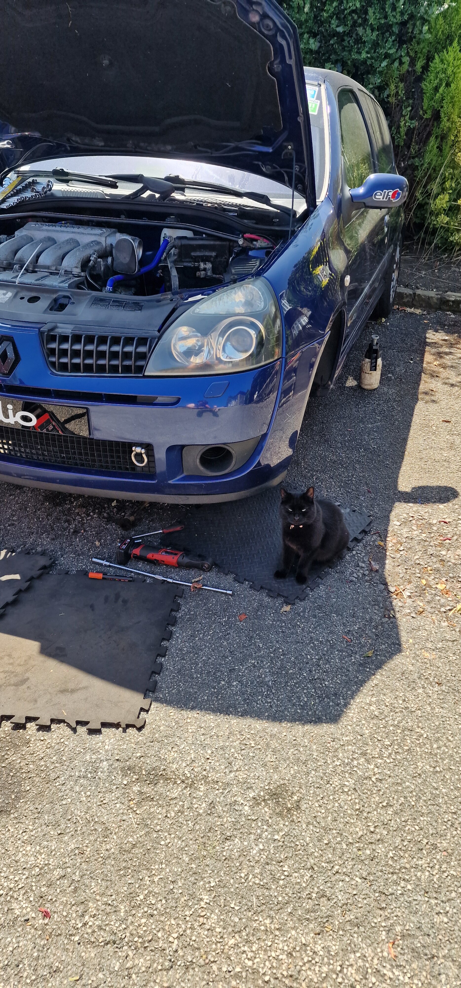

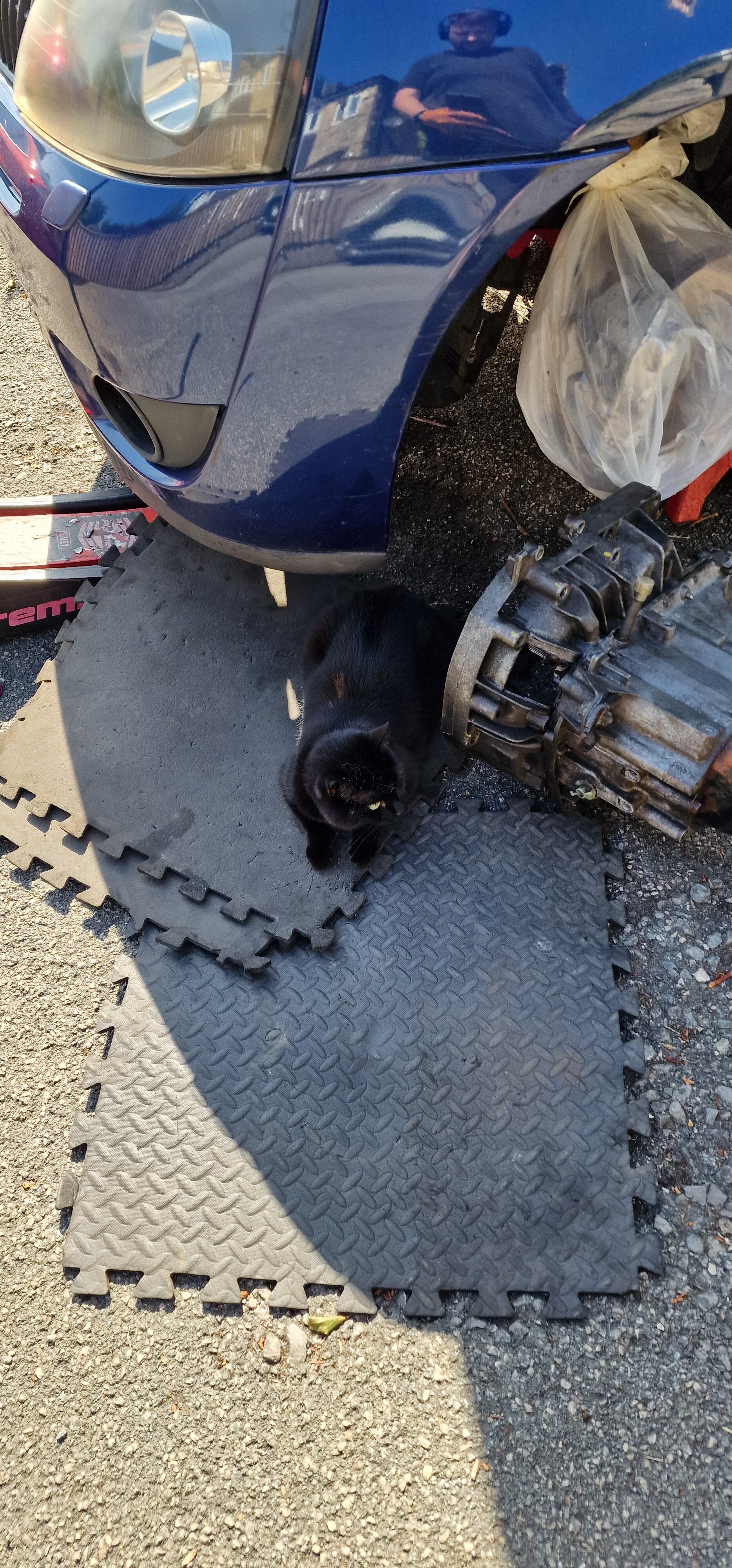

Saturday morning I got my helper to give me a hand
Gearbox in
Then she came back after the hard graft had been done and I was just about to put the subframe in

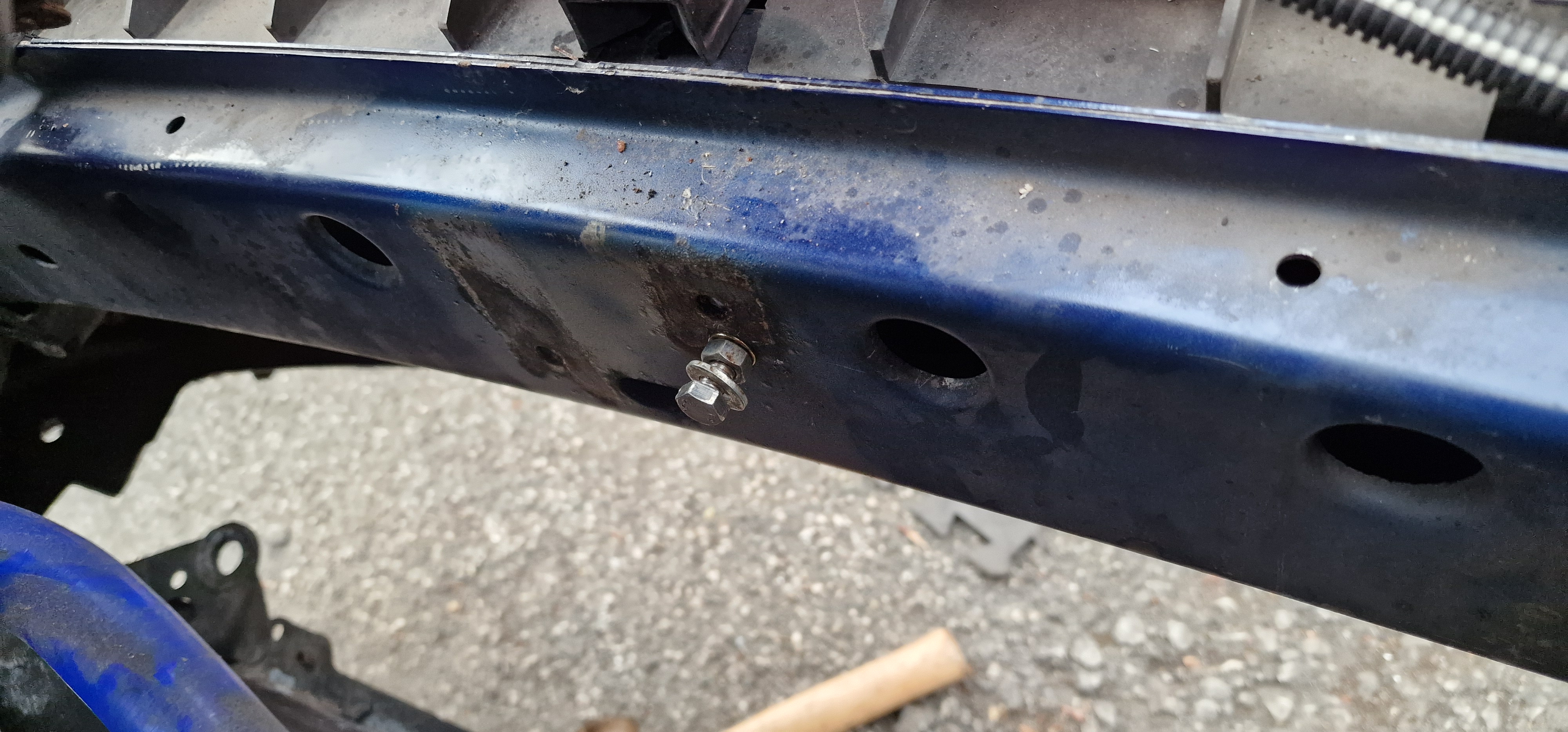

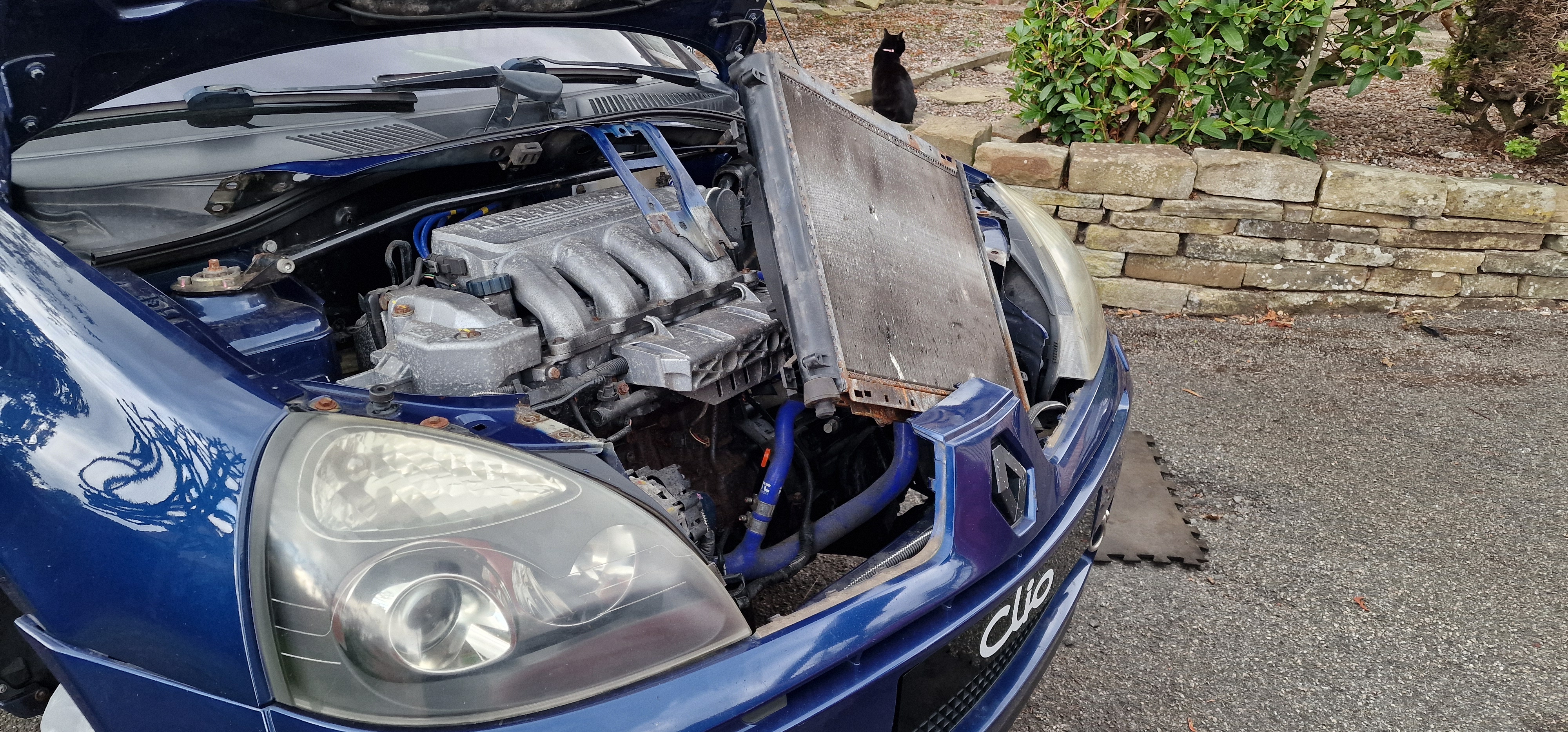

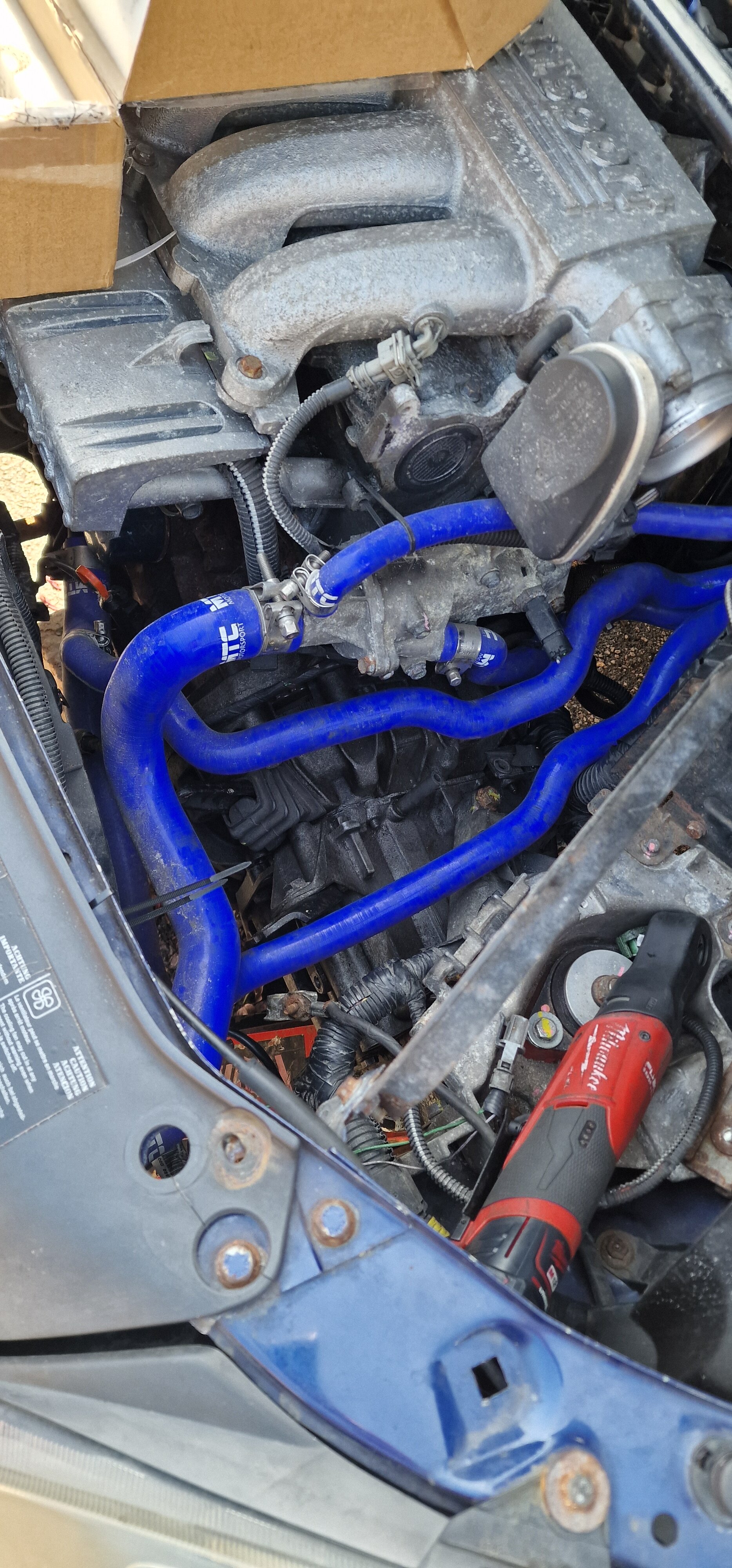

I got as much buttoned up as I could on Saturday, but because it was sweltering, I gave up at about 16:30. In bolting the rad in place, I disconnected the upper rad support and didn't put it back in properly...
So I had to break into my own engine bay, thankfully I've done it enough so I know where the bolts are for the rad support
Which led to...
Fanfuckingtastic. Just what you need 1 week before the car needs to be on track, yet more work

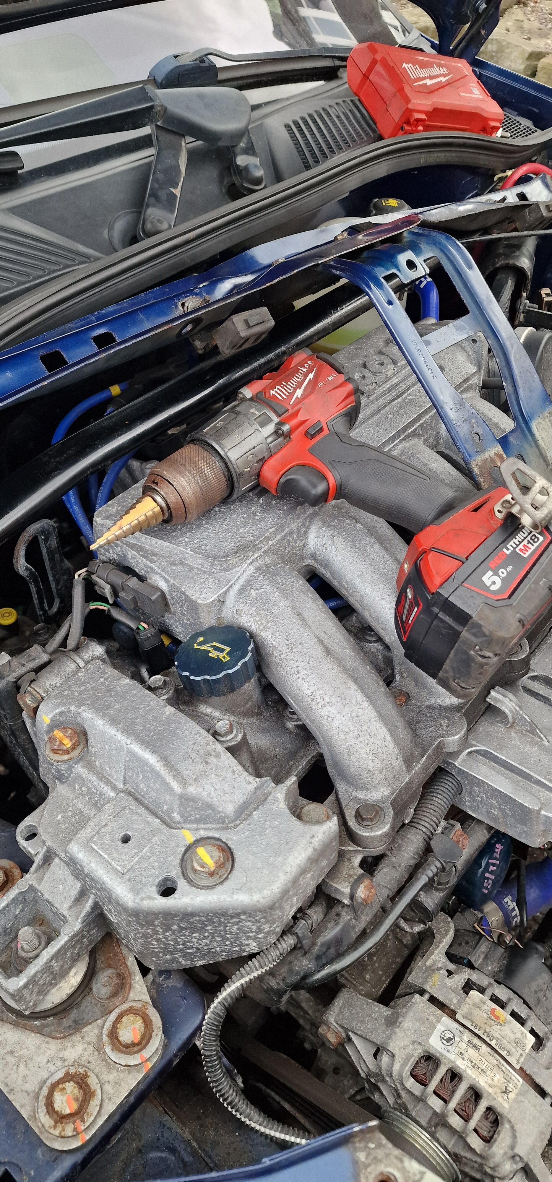

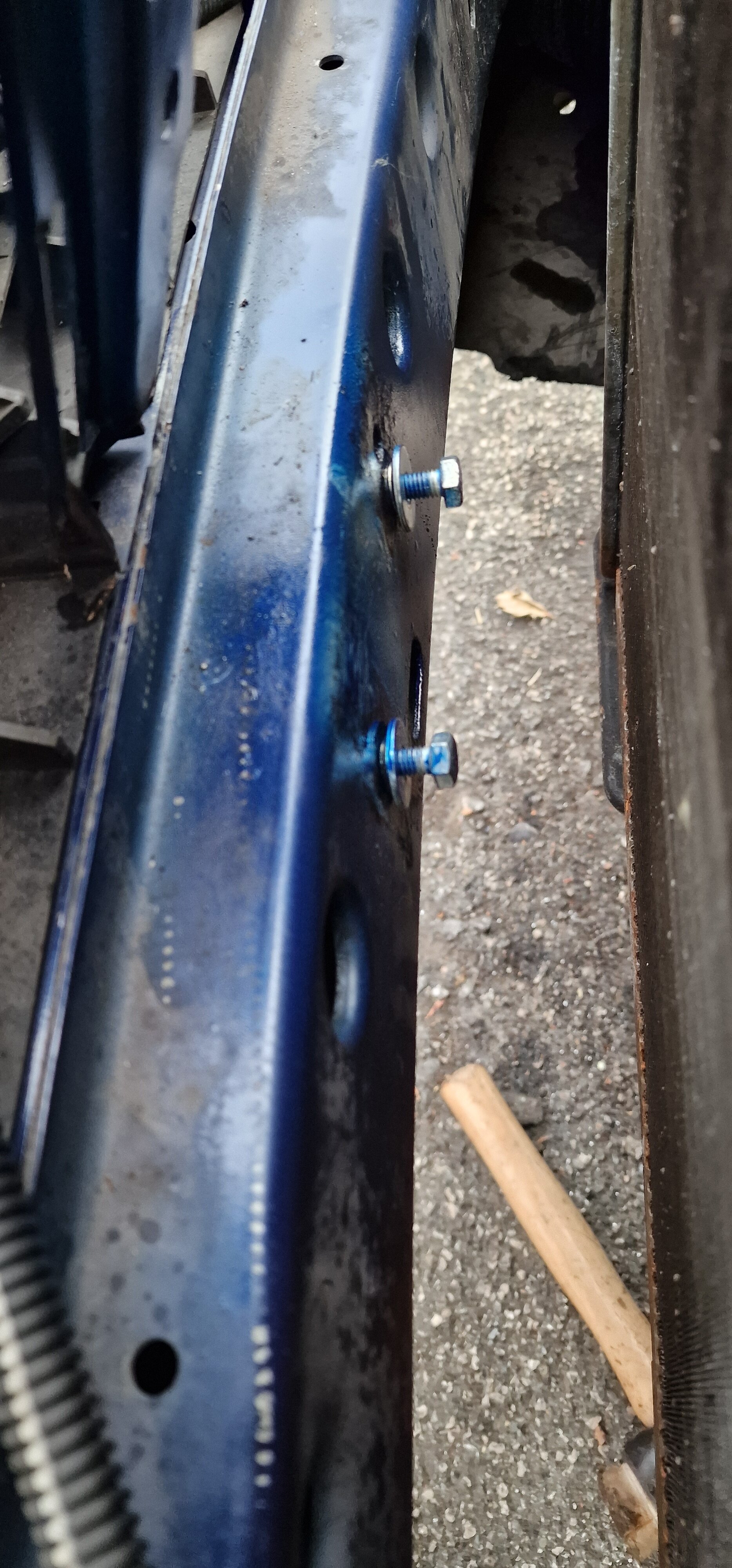

So those broken bolts turned into
And then

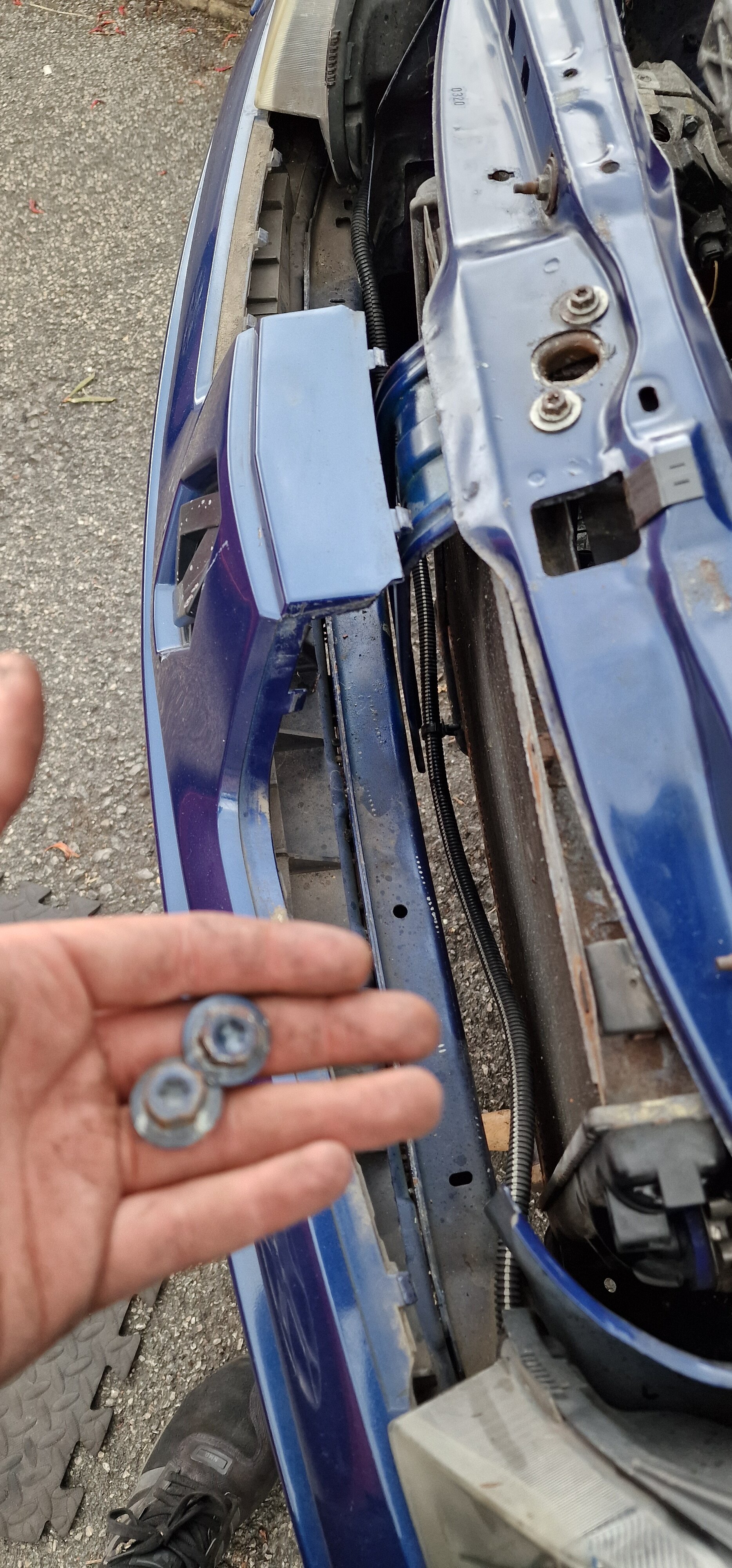

And then putting in rivnuts

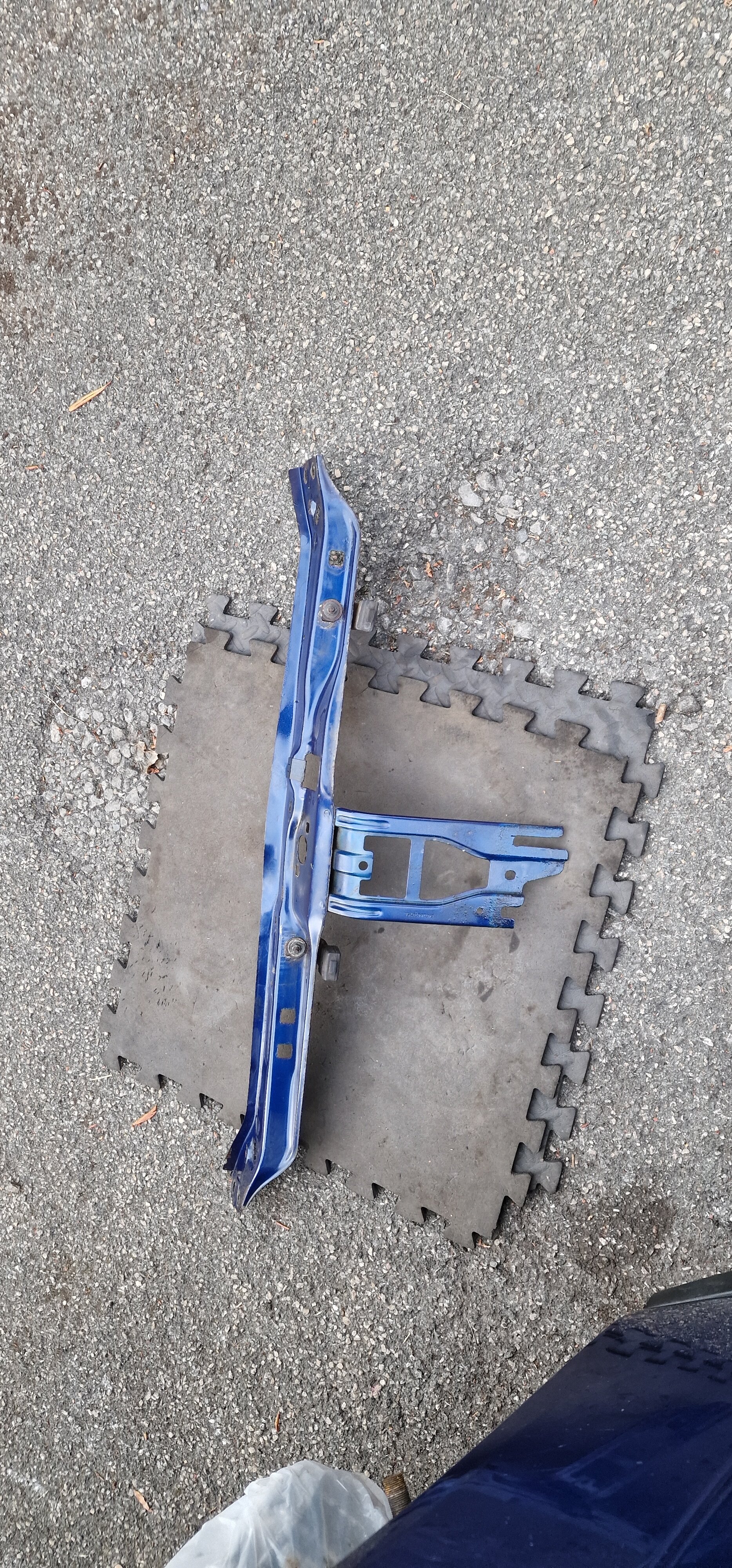

Which meant cutting up my bent rad support and painting it with a bit of Monaco blue
It bolted up lovely and was sturdy as chuff. I tried to get it bent back into shape but I think it's a bit too far gone. Which is great because I have a spare at work from the car I just broke...
Except I checked this morning and I don't because I lobbed it in the back of the shell before weighing it in... FUUUUUUUUUUUUUUUUUUUUUCCCCCCKKKKKKKKKKKKKK

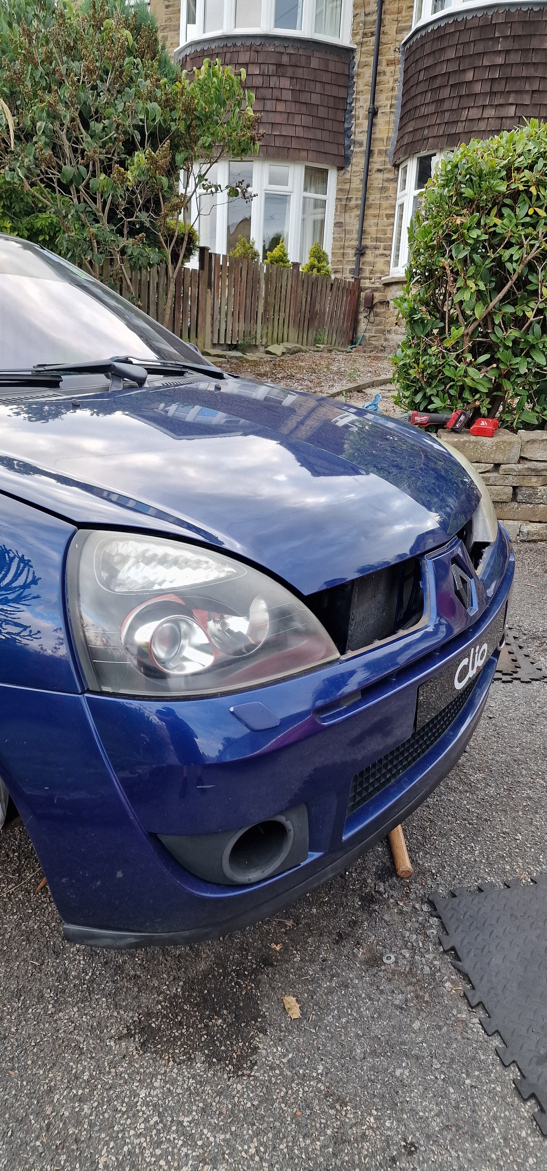

Bolted the panel back in to see what it looked like. Adjusted the catch and...
Yeah it still looks like the bonnet is open 😡 I think @Louis has one from his car, hopefully that one isn't bent like the owner WAHEY

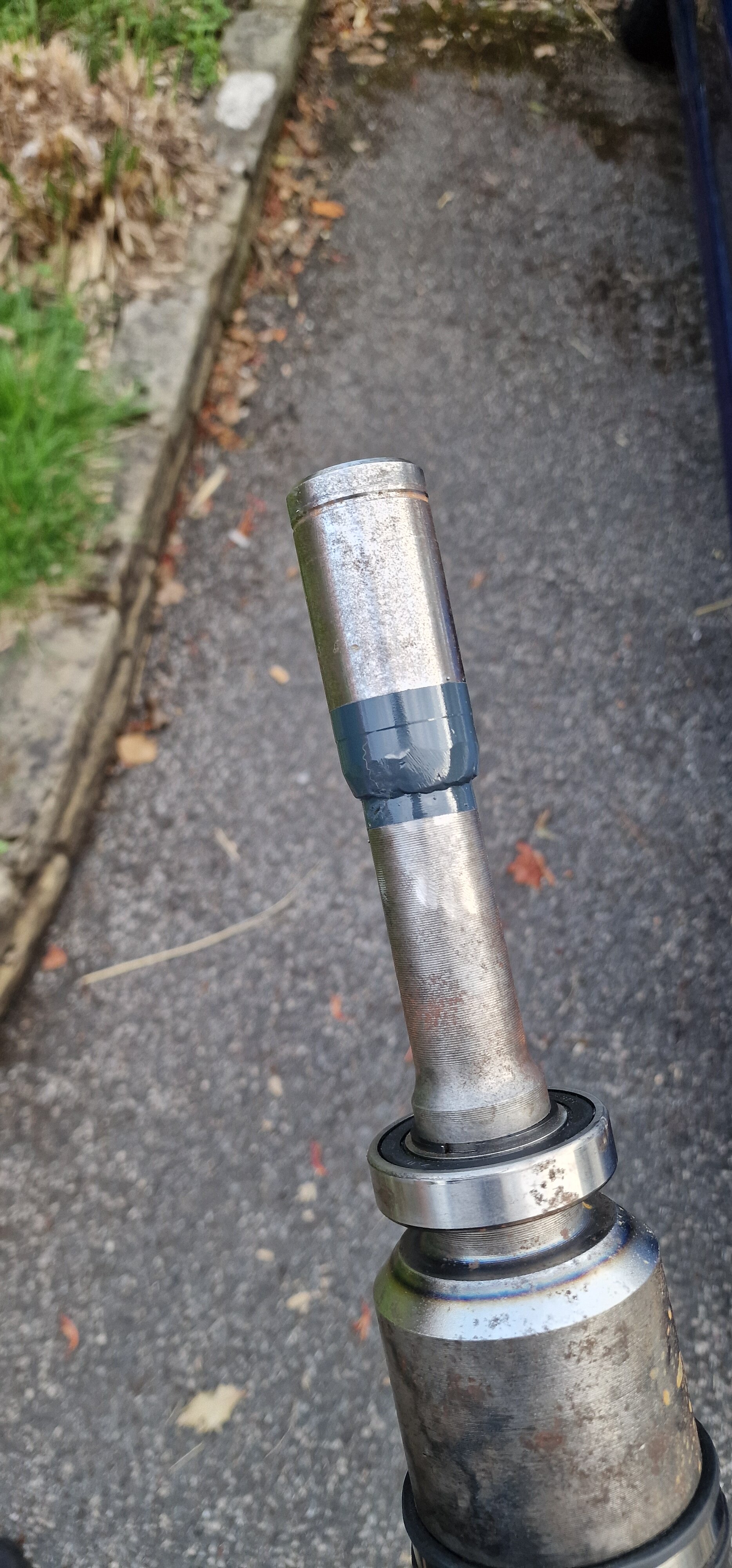

In other news, all of the tacks on my driveshaft broke from where I blebbed a bit of weld on it last year
So @OEM Battery Nonce kindly welded it up good and proper. I don't fancy that coupler coming loose and eating into my diff seal again

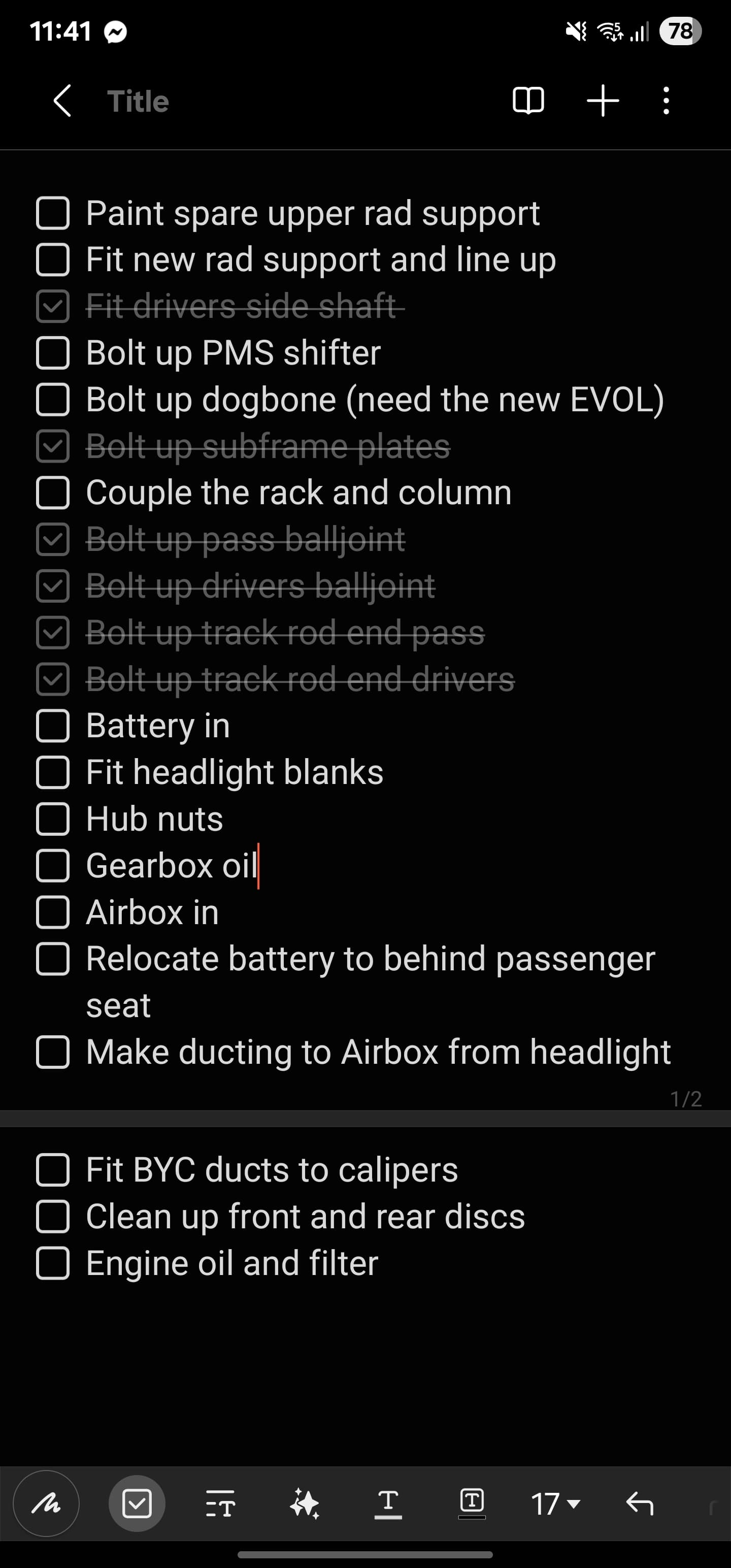

My list currently looks like this

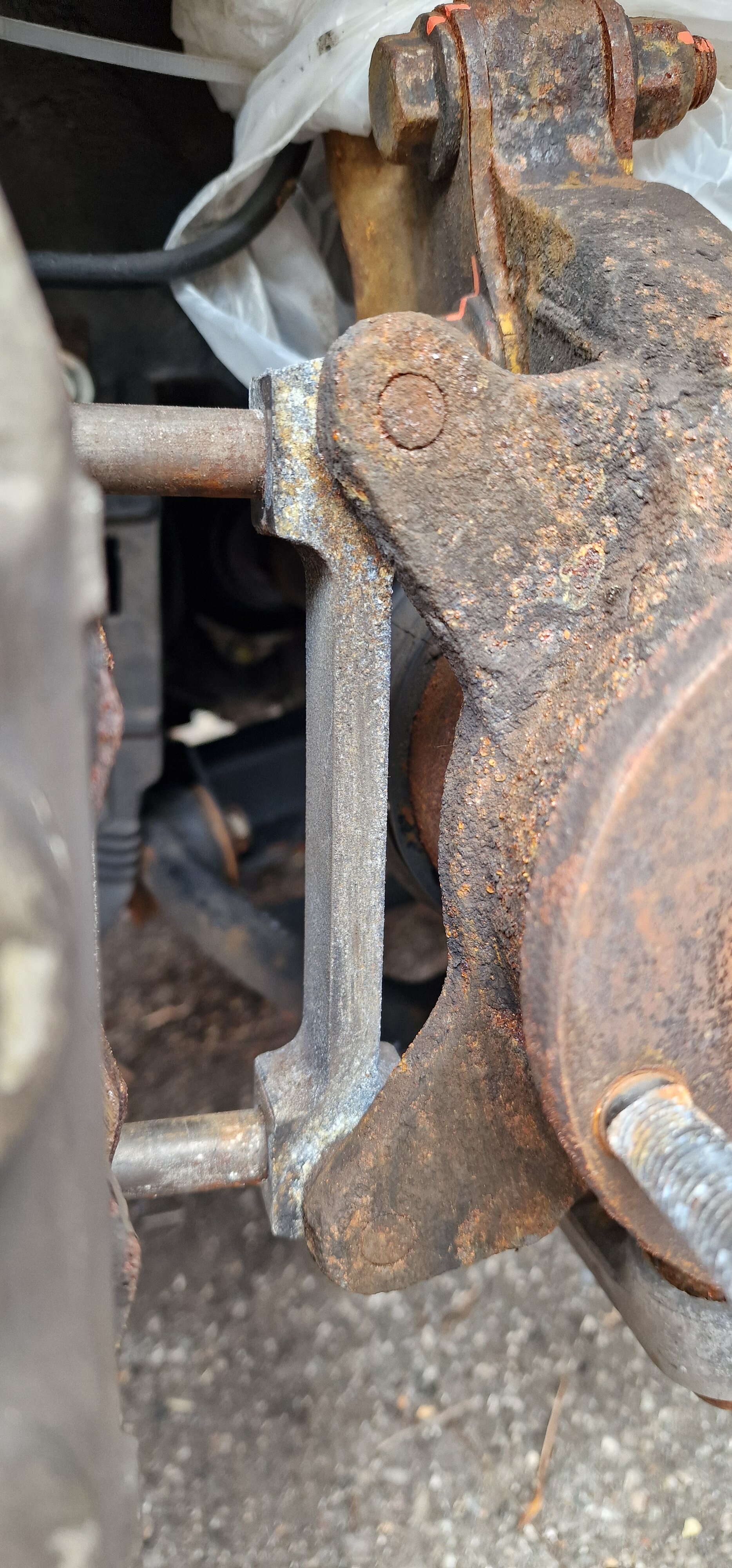

Started by stripping the discs off and giving behind them a check. The brackets @Clio_fool made me years ago are still absolutely spot on! Just need to clean the corrosion up a touch and spritz some ACF over everything

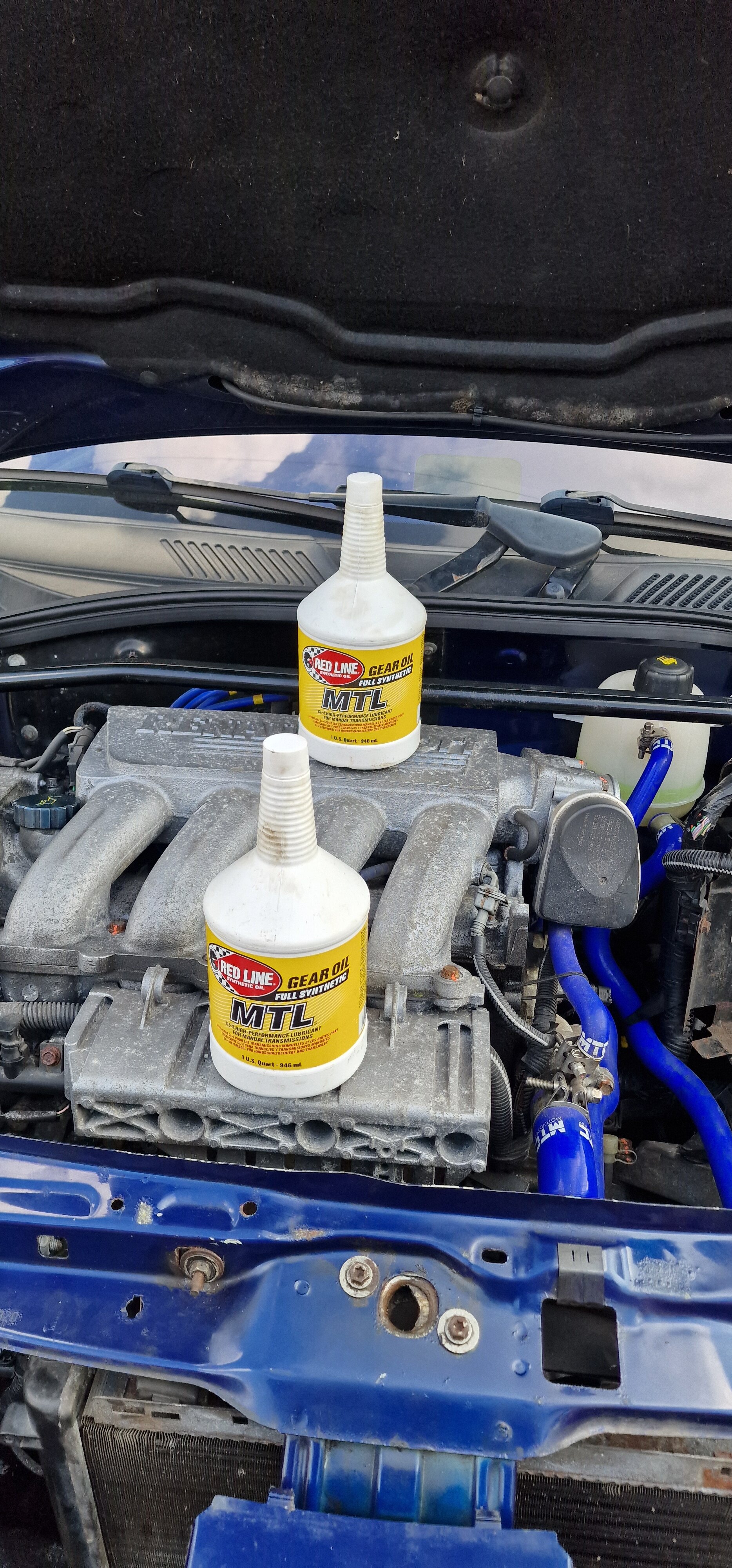

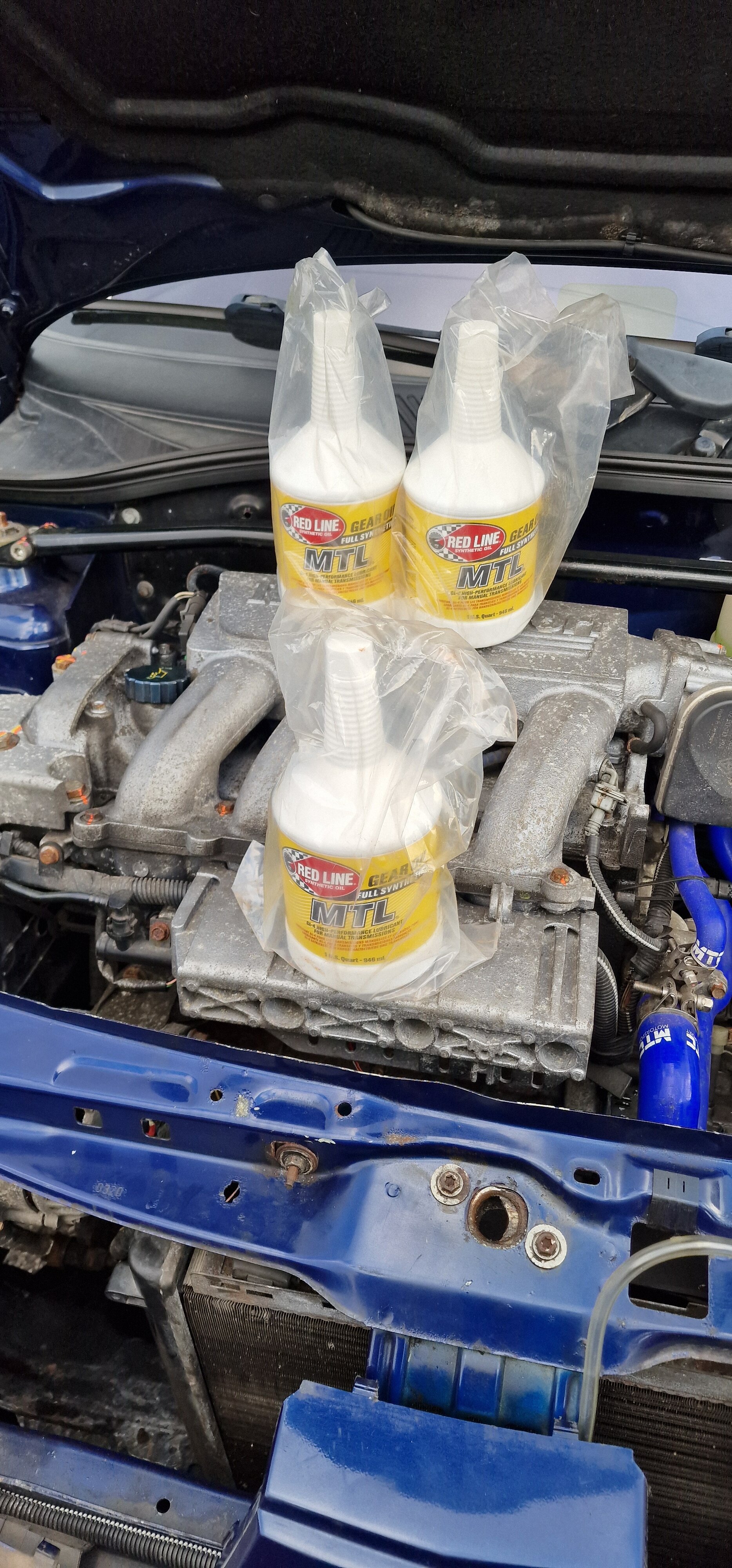

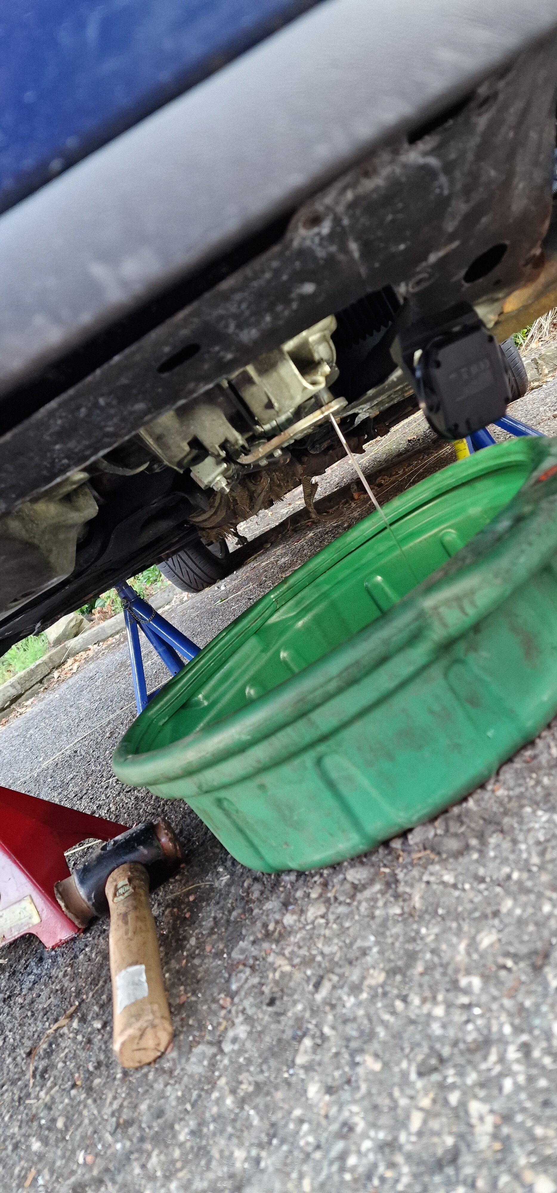

Started filling the gearbox oil
Ended up using the 3 new ones and then 1/4 of the 4th bottle

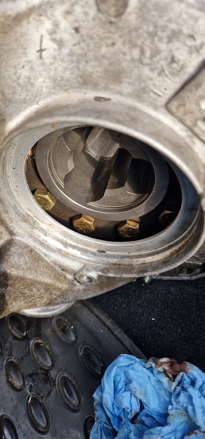

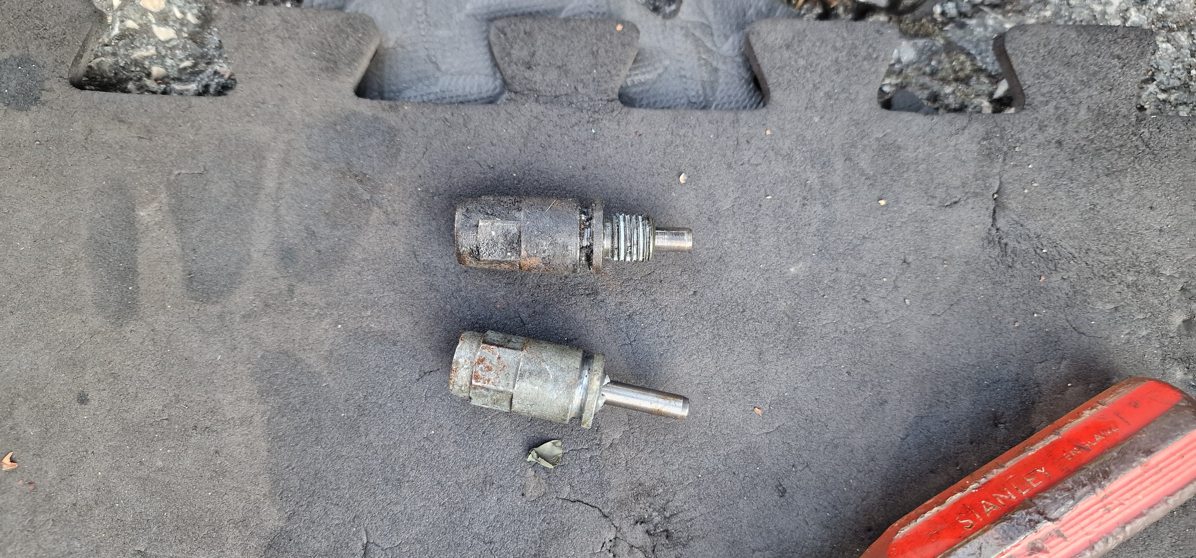

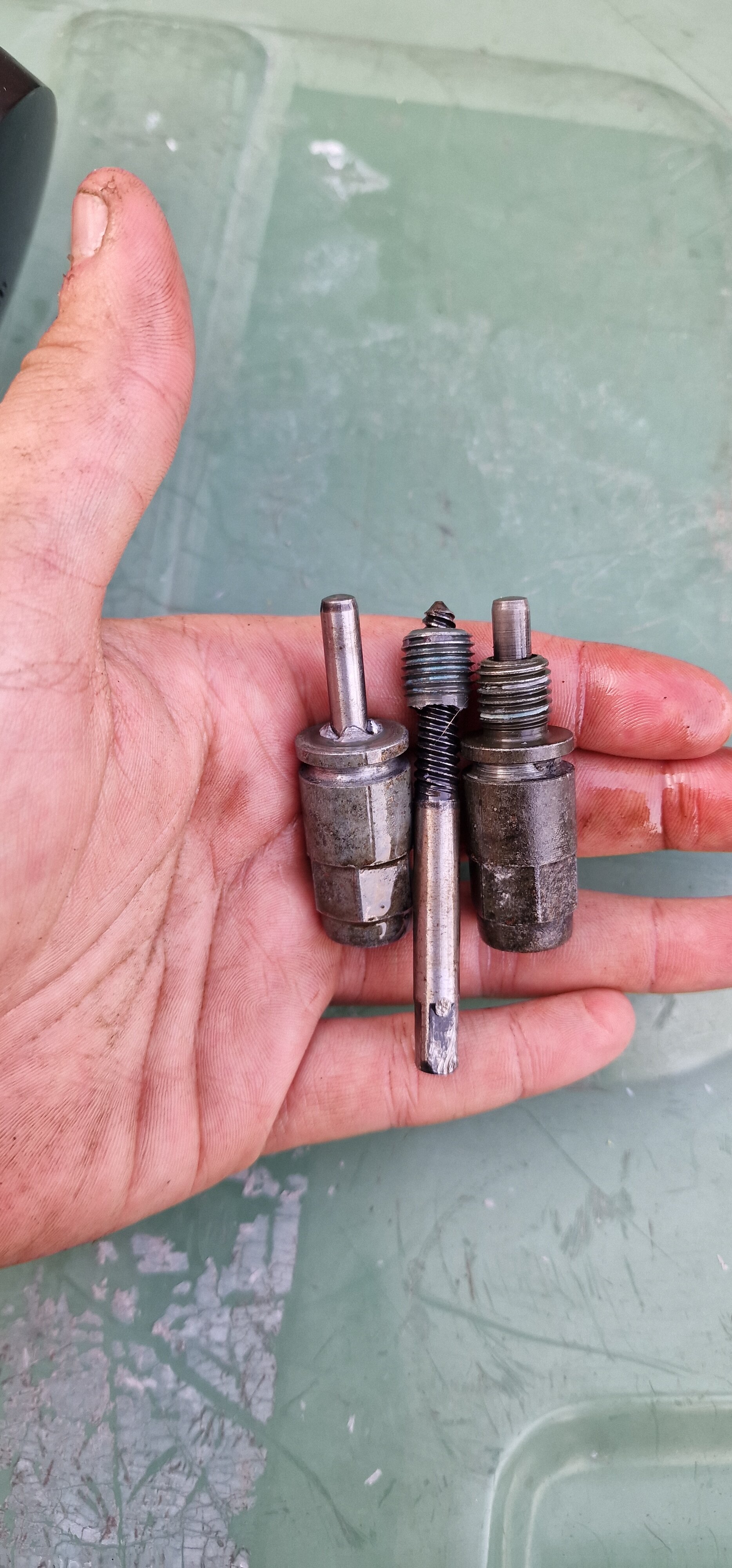

Then because Mark had had the box apart I just had a general check over whilst the box was full. Which resulted in me going to tighten the selector detent where the selector return spring sits... It went as well as Freddie Mercury having unprotected sex with multiple blokes
This happened. Yes that's all of the brand new gearbox oil coming out
Snapped the entire f**king thing clean off
Thankfully I had luck on my side (I guess) for once and I got it out

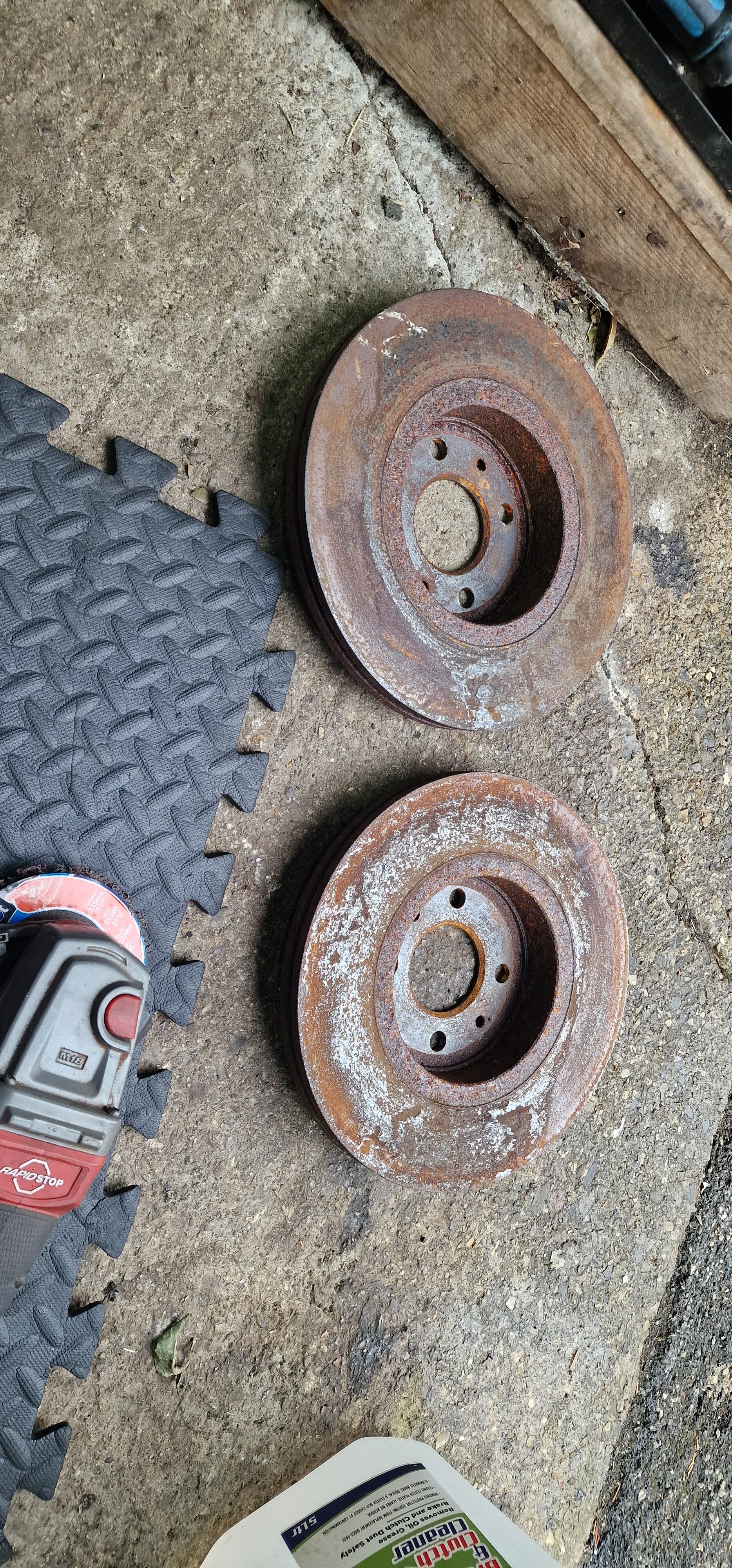

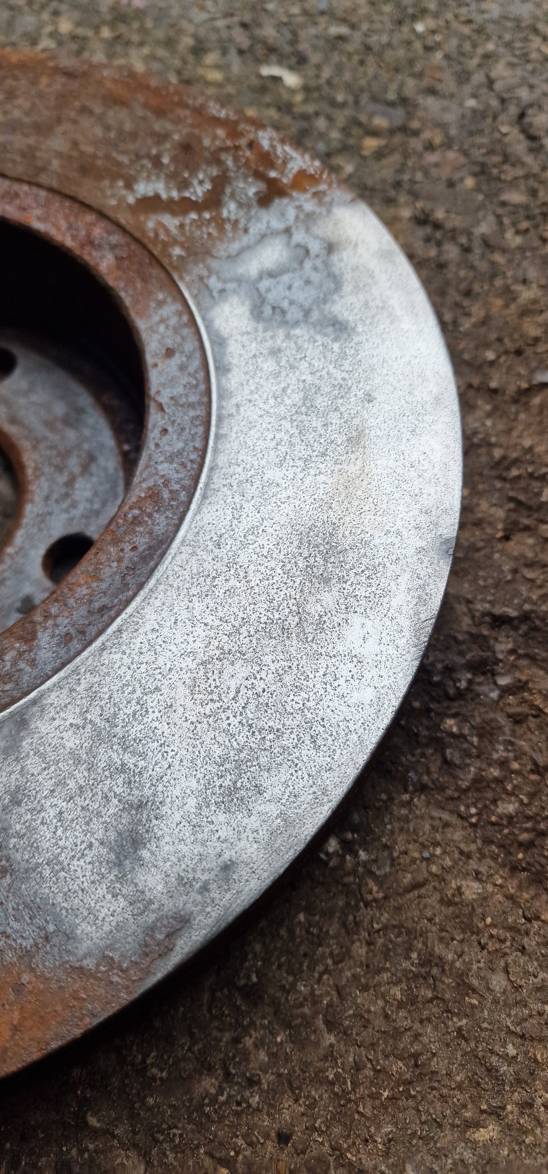

With it being raining today I didn't get much chance to do stuff to the car. So I went to clean my front discs up
Usually surface rust comes straight off but these were a bit too pitted on the inside and the outer edge had started to get microcracks. They're exactly 2 years old and 3 trackdays
Bought some Febi replacements that should arrive this week. Cannot grumble for £38

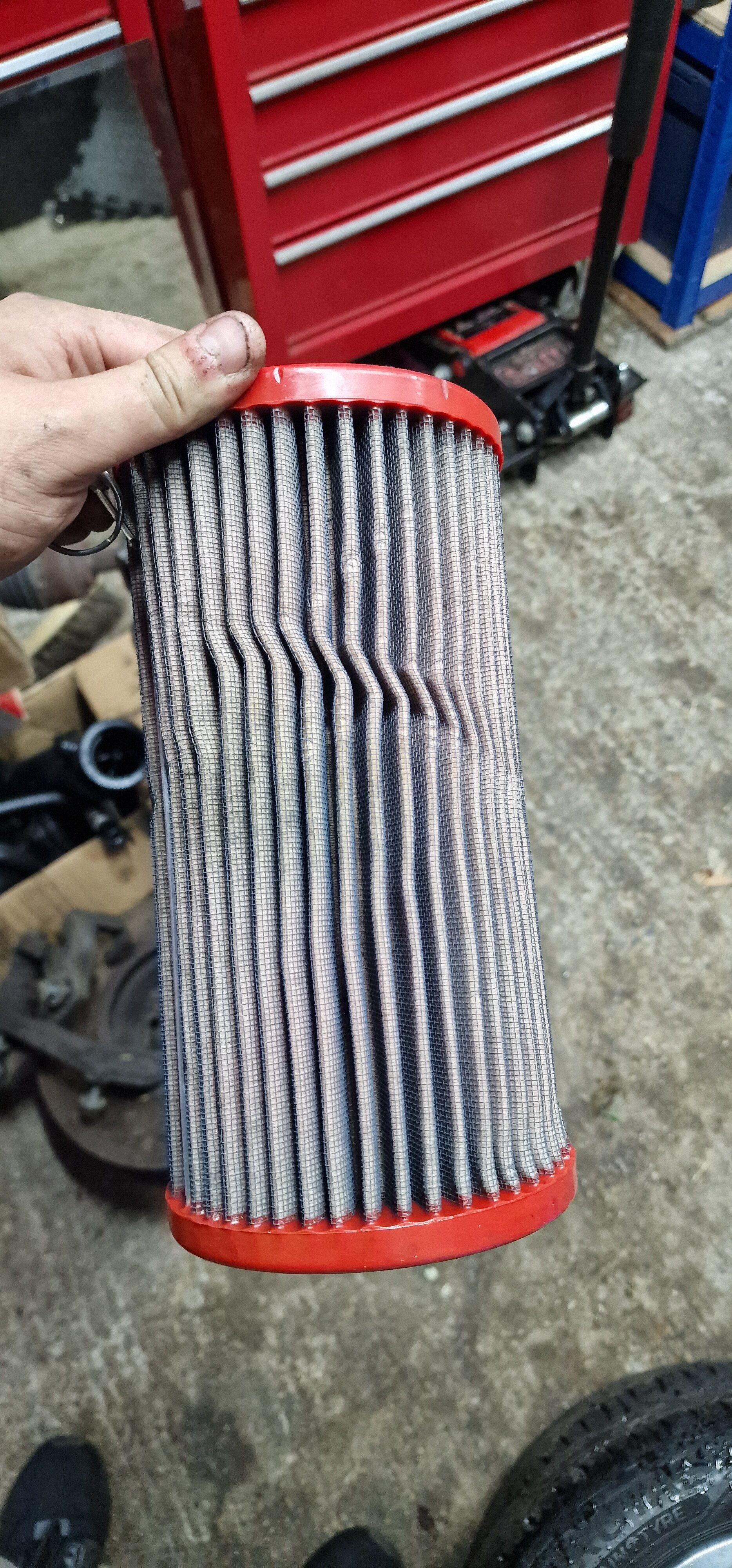

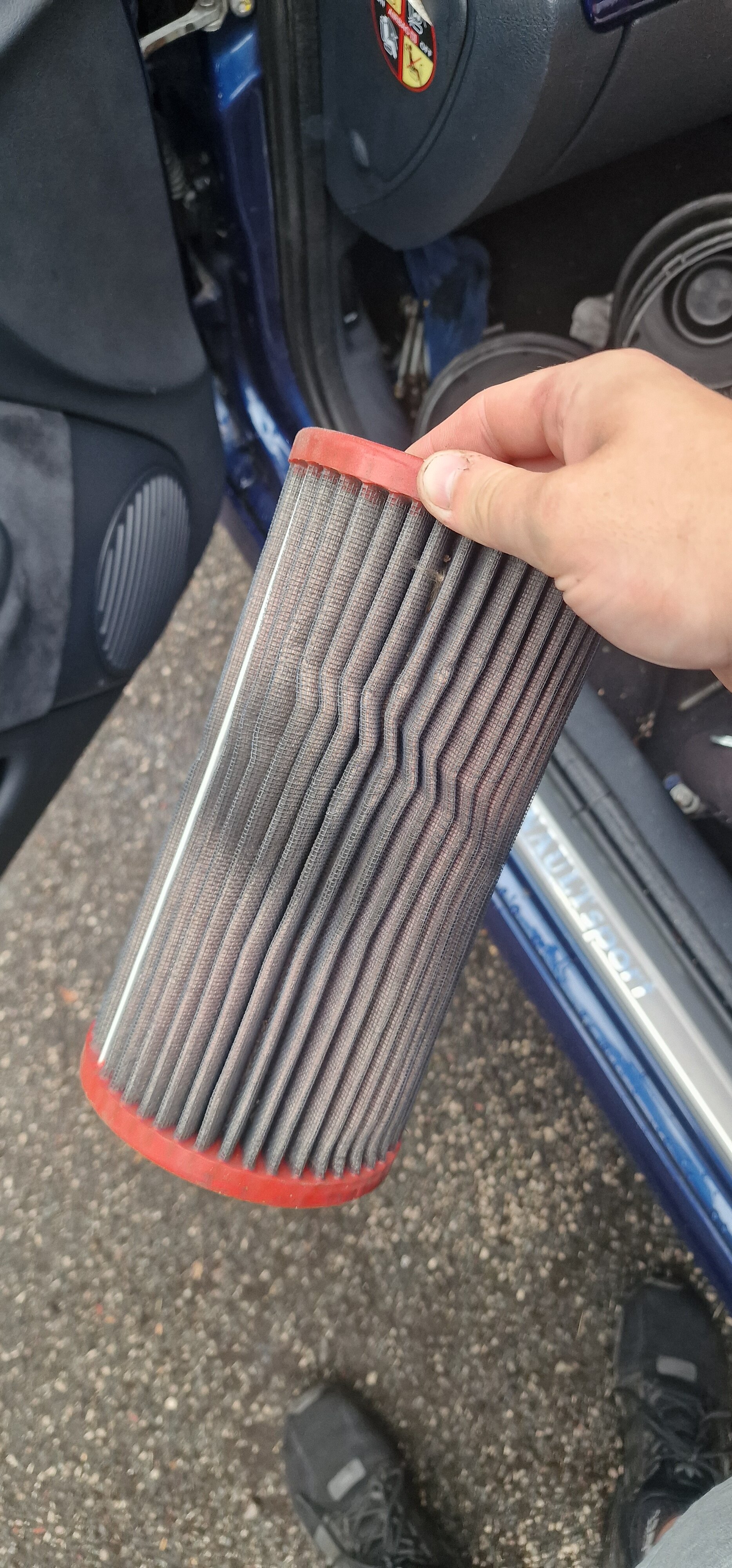

Cleaned my air filter as it was getting a bit acky
Before
After. Sprayed it down with some Surfex and rinsed it inside to out. The water came off brown

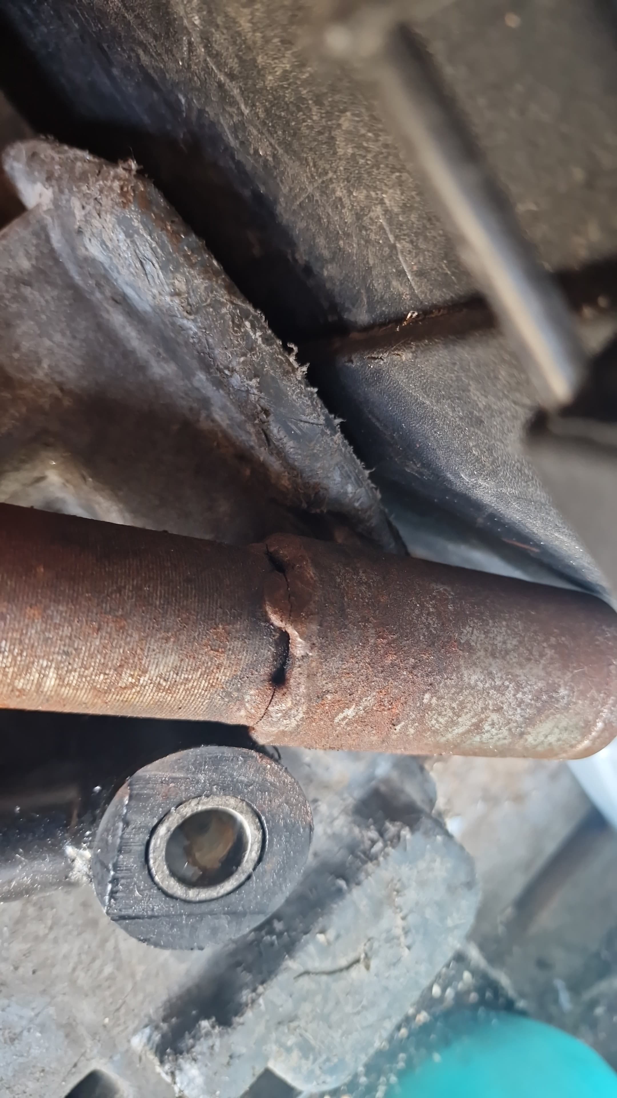

So yeah, pissing down rain when I wasn't meant to be doing much to the car meant I was now taking the exhaust off, taking the PMS shifter out and reaching up into the car like a puppet master to hit the unlock button

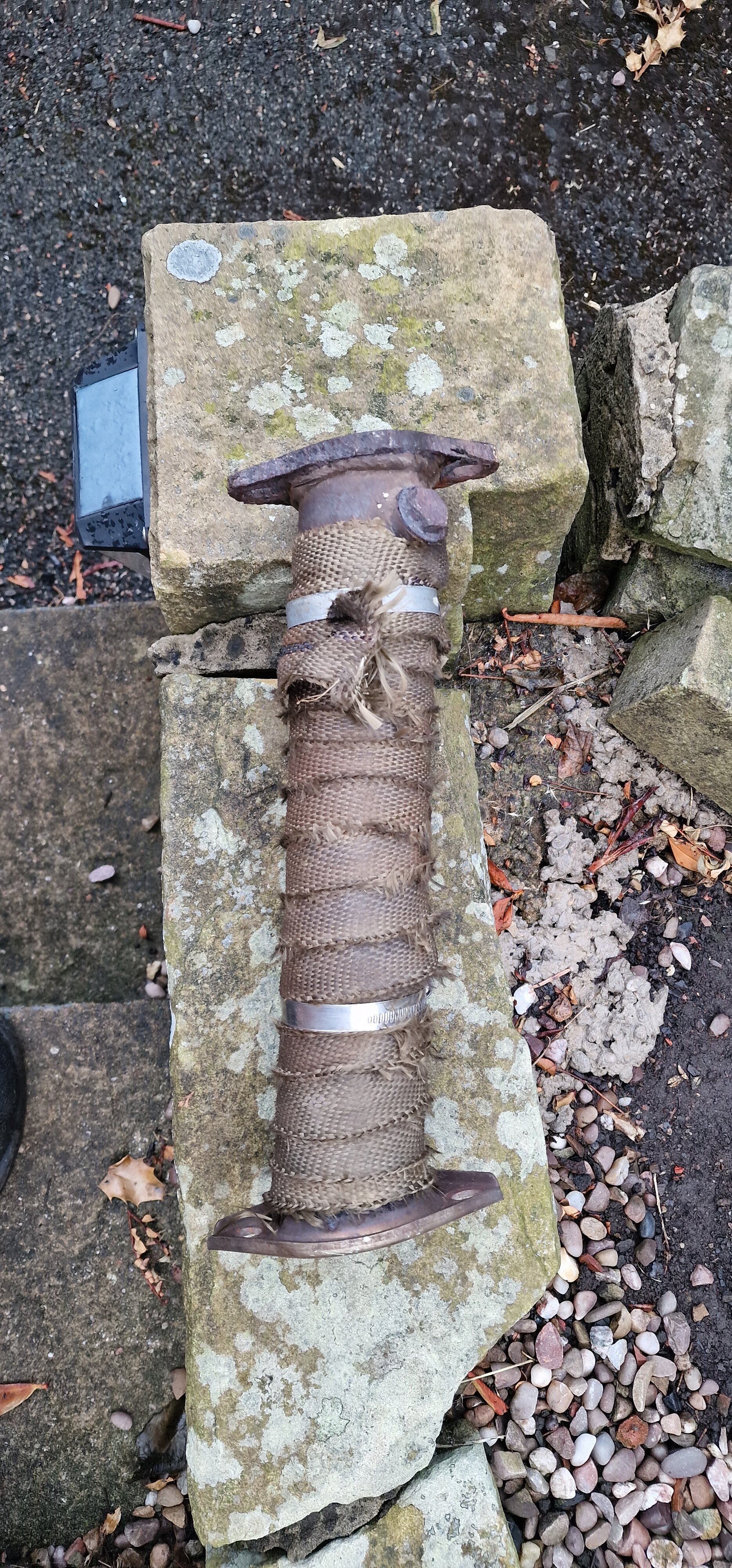

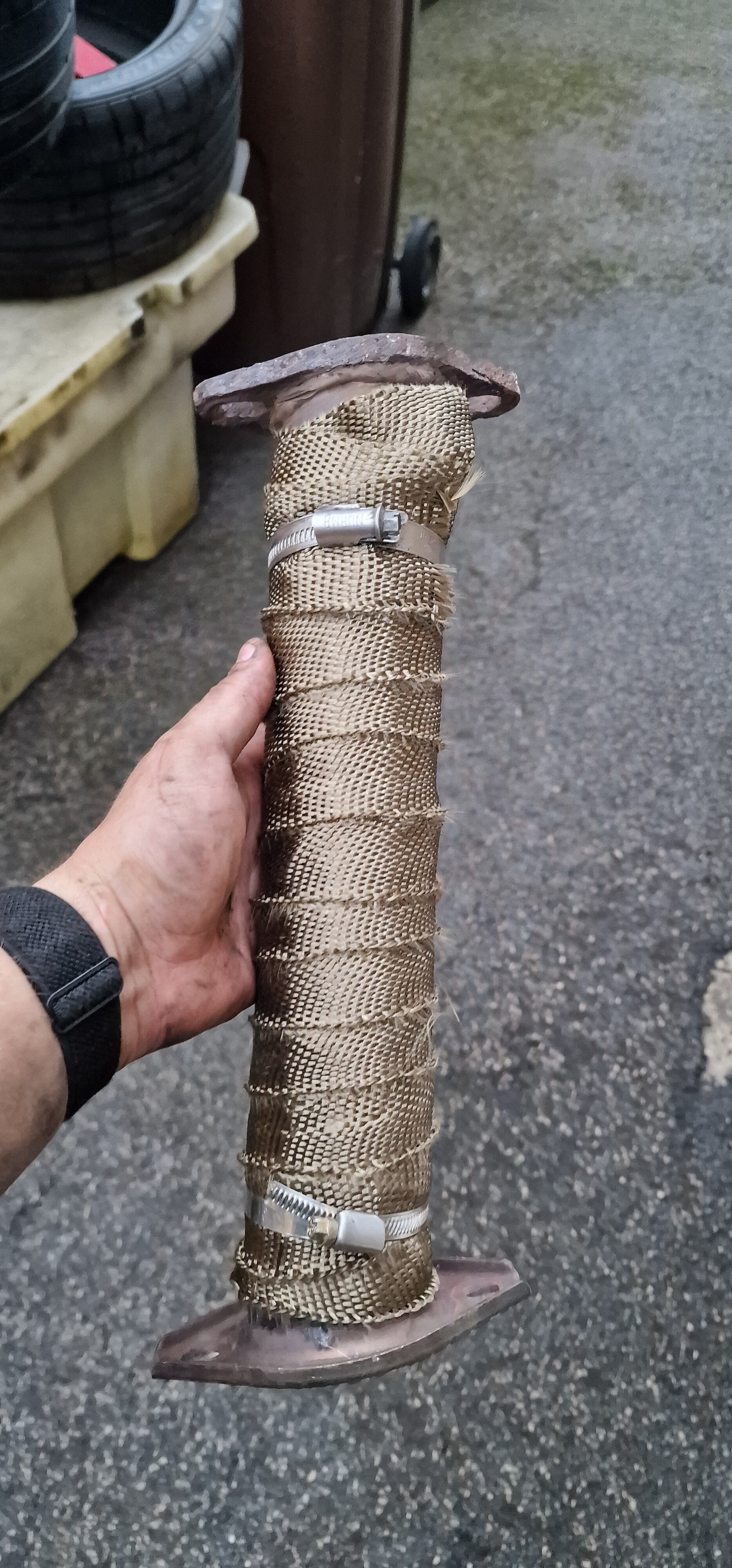

Since I had the decat pipe off I put some jubilees round the tatty exhaust wrap. I couldn't find my metal cable ties
I wasn't happy with that and luckily had just enough wrap to redo it all
With that I got out the exhaust paste and fitted everything back together.

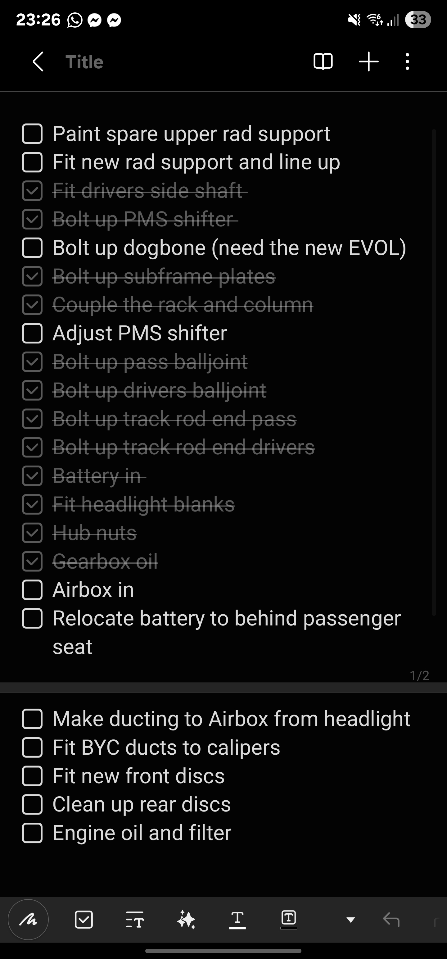

So next jobs are
I reckon I might have a look at fitting the BYC ducts tomorrow if the rain holds off. I can route them quite nicely. I reckon I'll cut into the bottom grille in the corners for the trumpets
