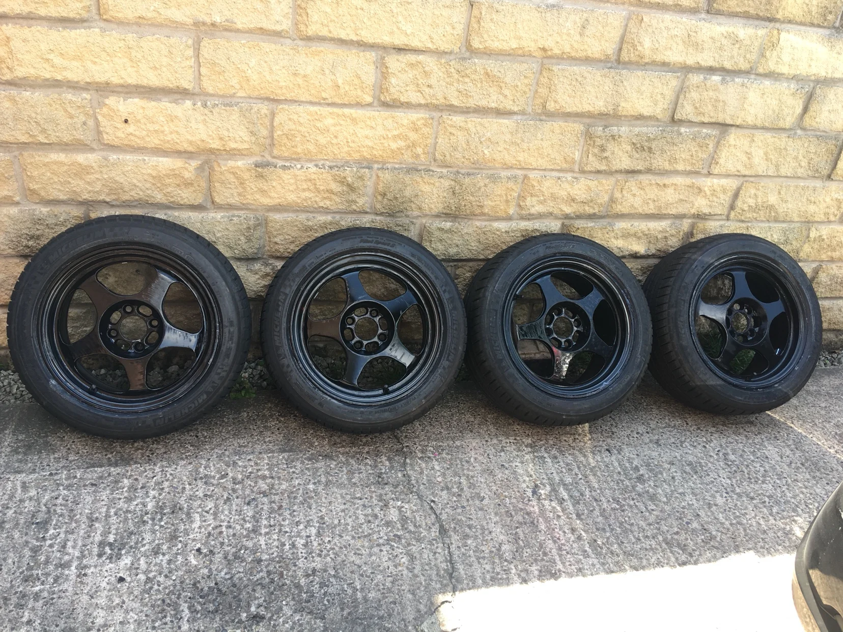

Got my PS3’s fitted to my Rota’s today

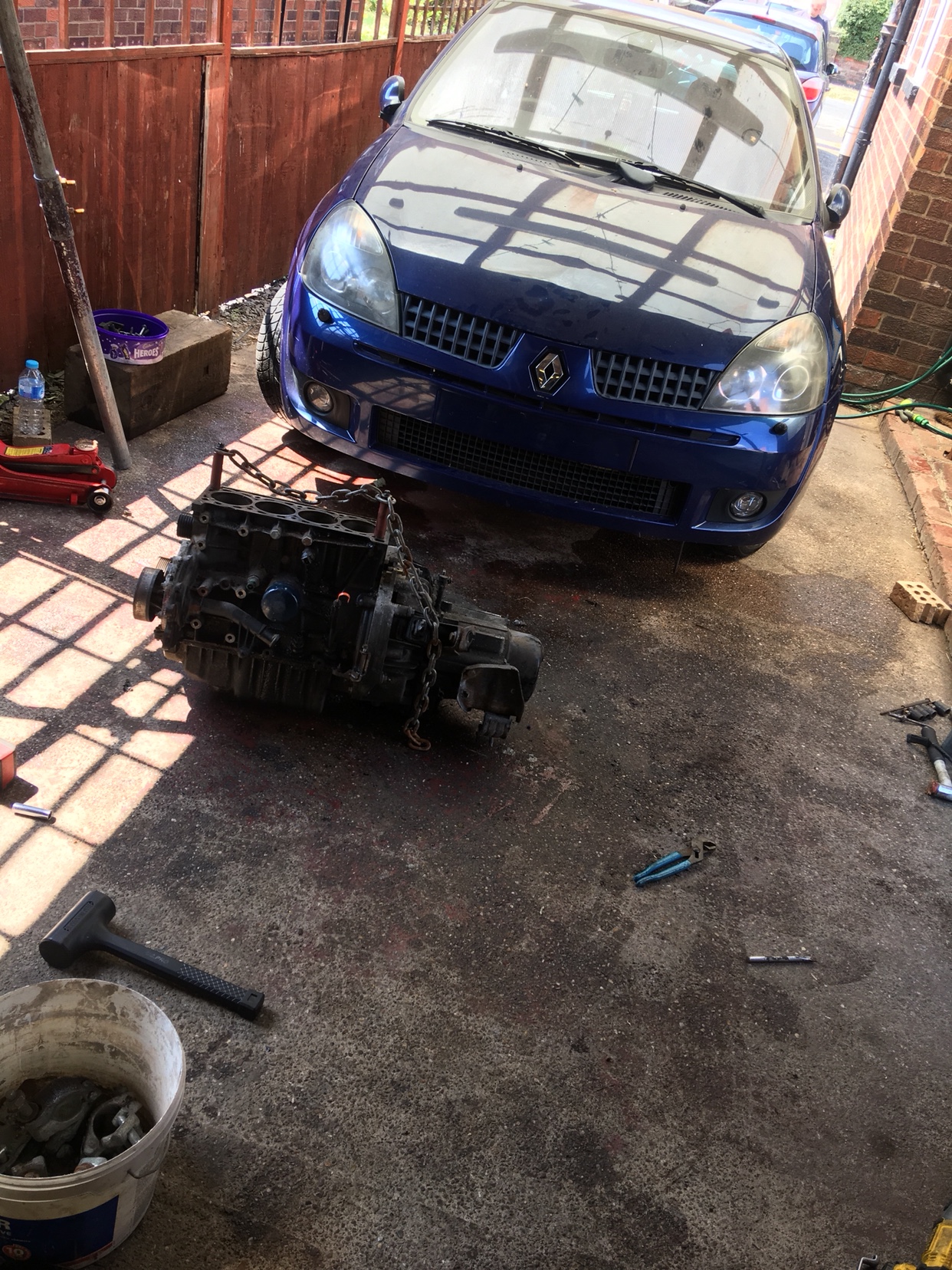

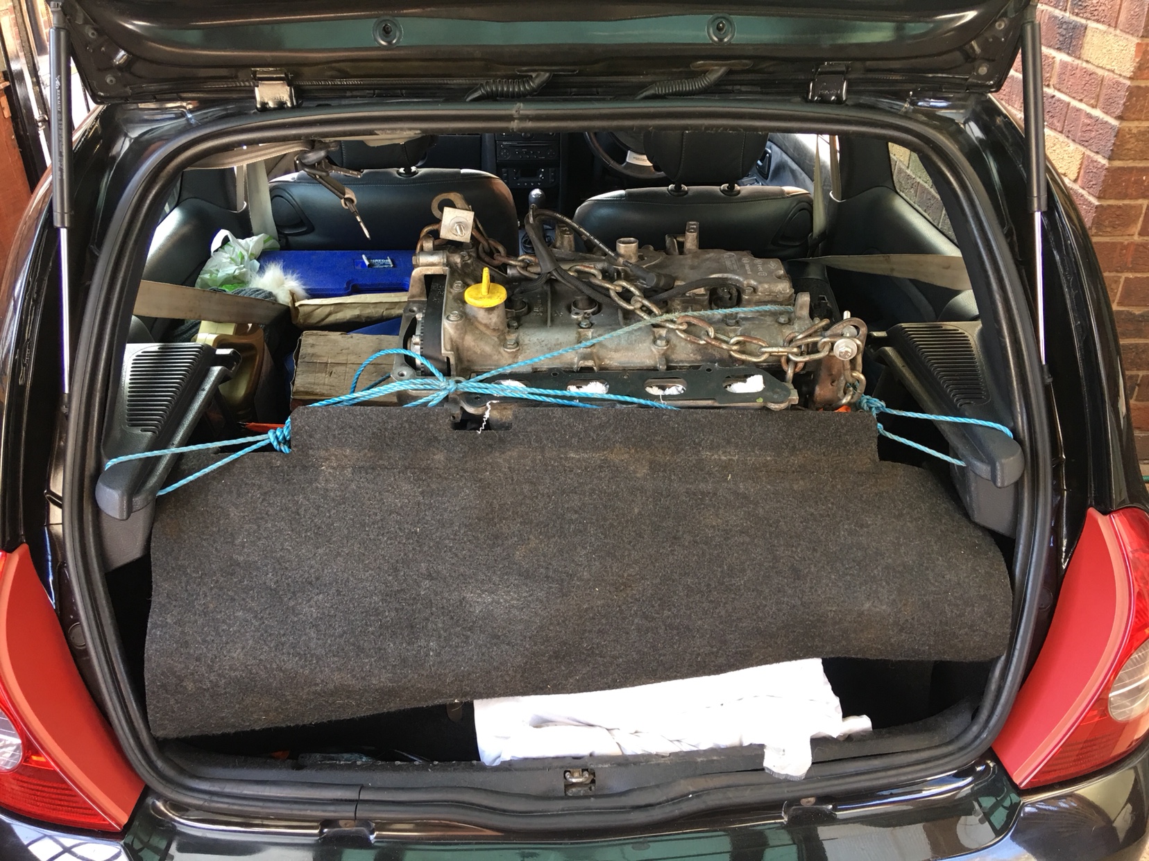

Also pulled the engine on my other 172
My dad said I have to sell or get rid of an engine before I can keep another at his house as I currently have 3 at his[emoji23] I had to demote 2 to outside (they’re both covered now)

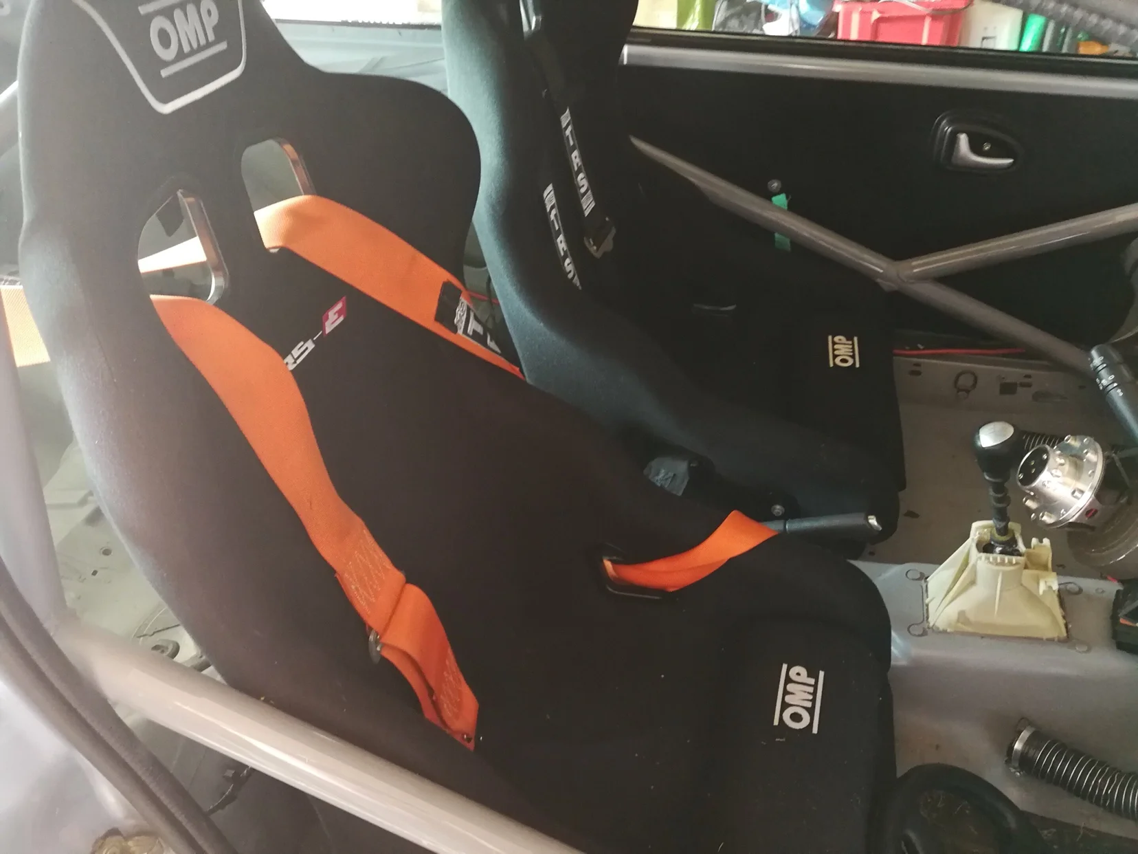

I also picked up all my goodies from @JP83
He’s a top bloke, lovely and stuck to his word. Can’t wait to get my car all sorted now! Comfiest buckets I’ve sat in!

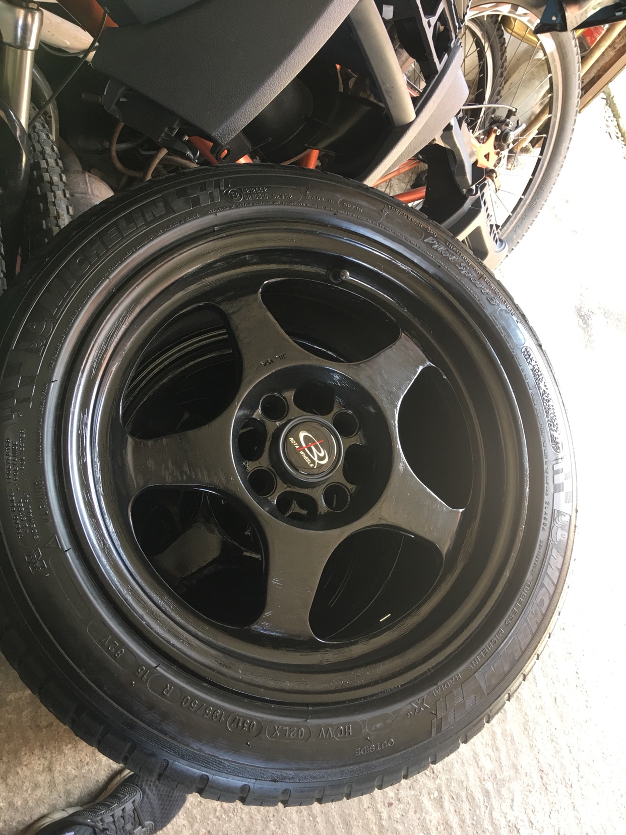

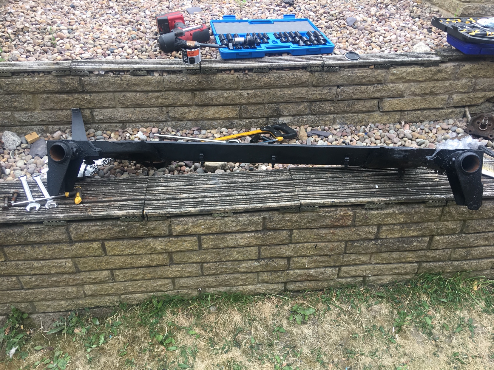

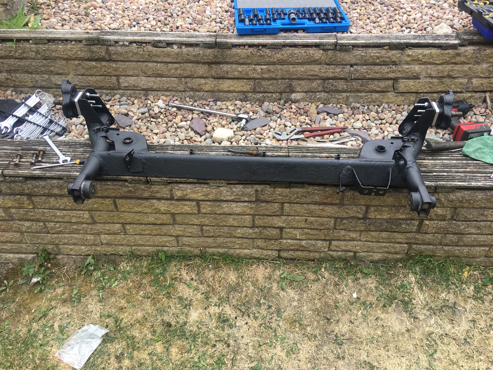

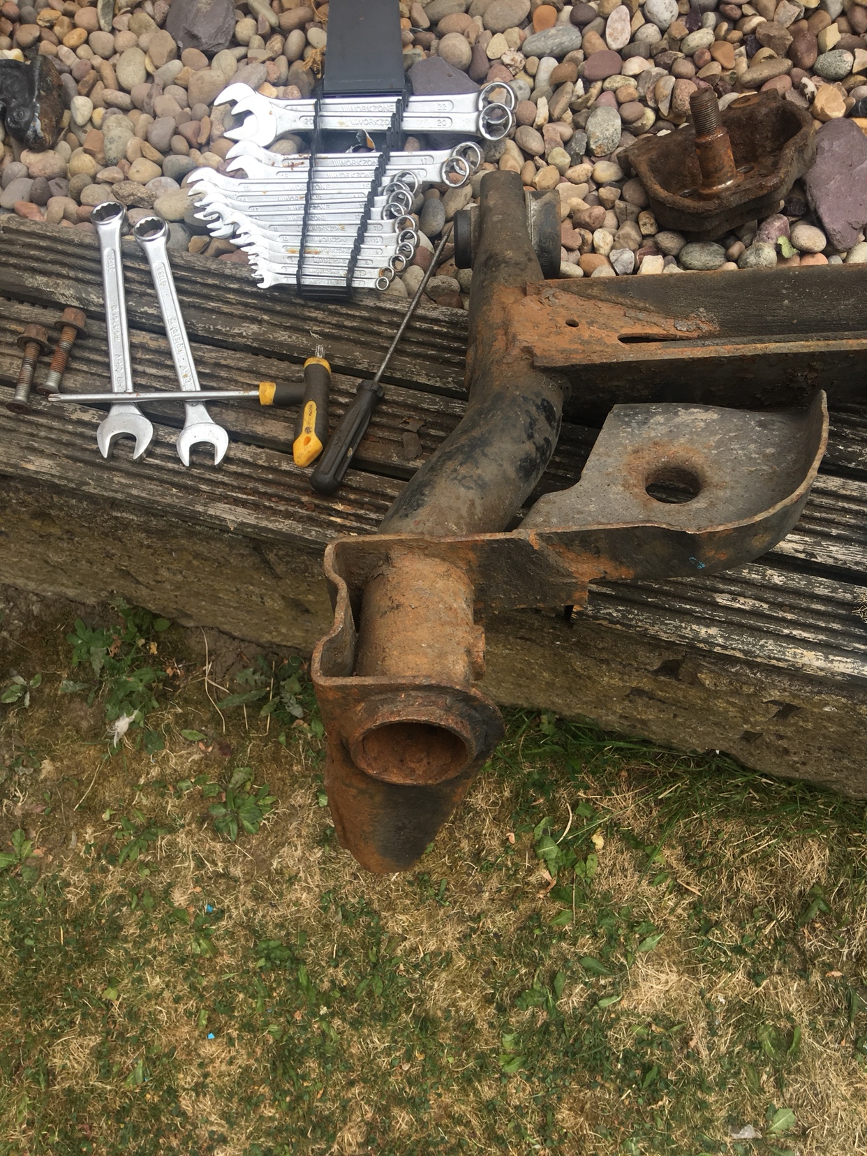

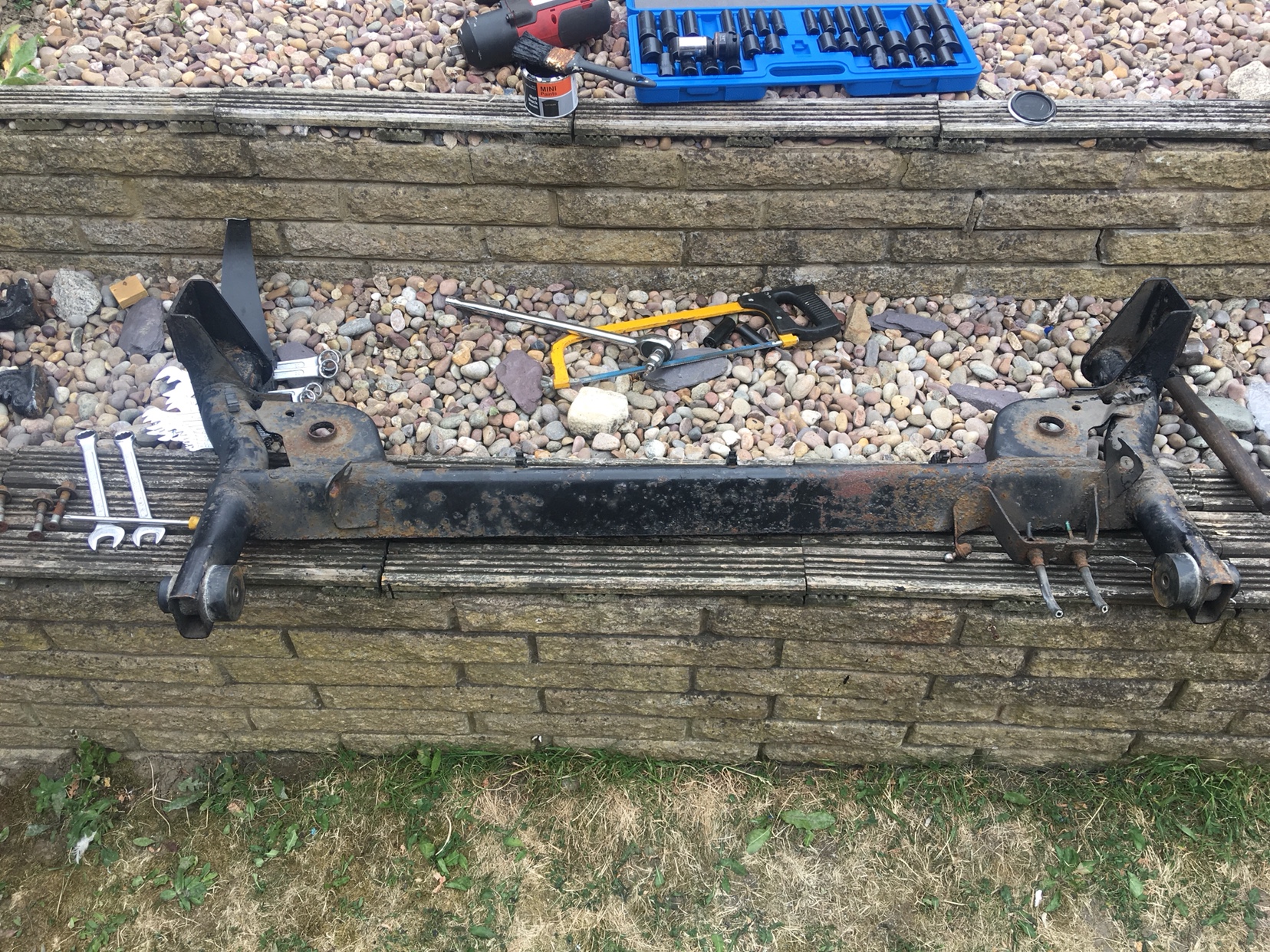

Started today by stripping down my spare rear beam with black series bushes
Wire brushed the whole thing by hand as my drill has shat itself, tried to buzz out the bolts but they just span then I rounded out the torx so I got funky with the hack saw (grinder is down at my dads ffs!)
I was just gonna install the 10mm hub spacers and have done but thought it would be easiest to just hammerite the sod now while I’m there
So I went from this...
To this
One less job I suppose[emoji23]
A few more pics of the final product

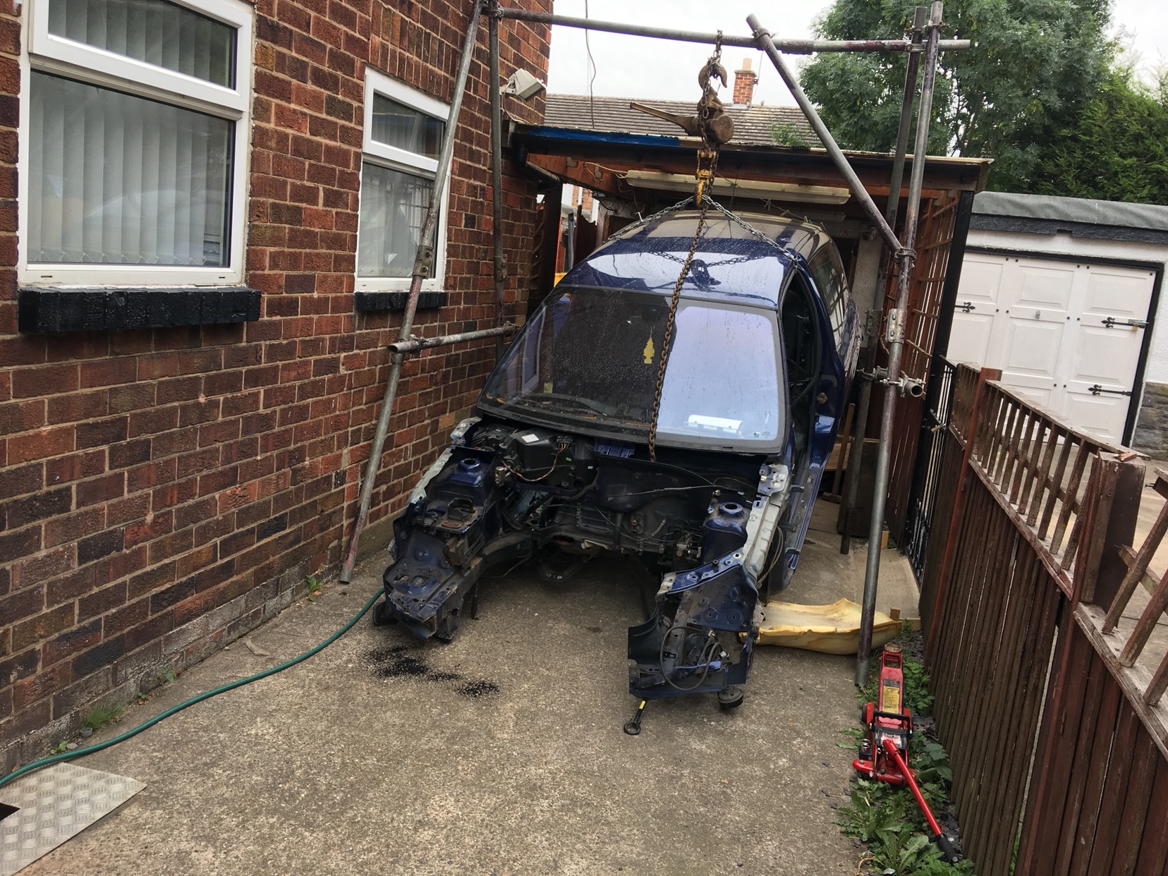

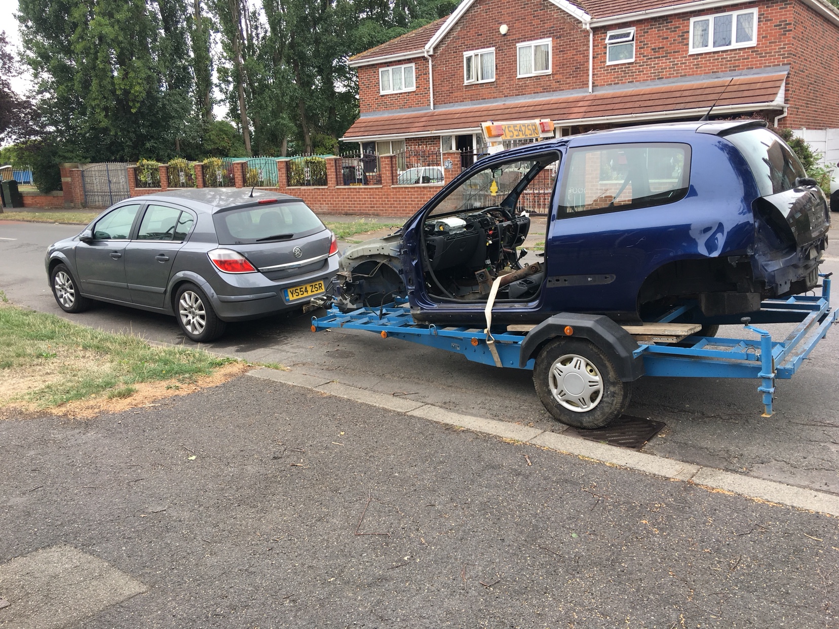

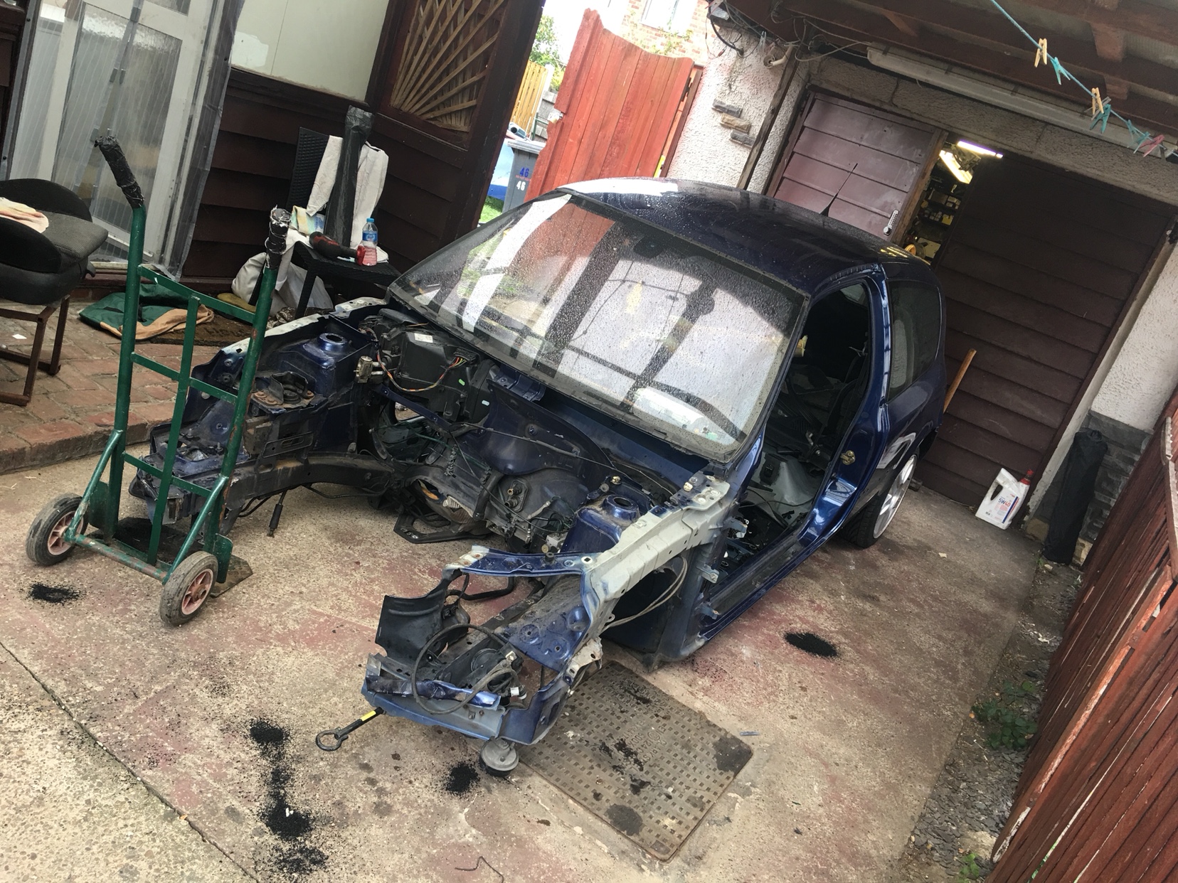

So now I’m technically back down to 2 Clio’s again as this happened
I found a f**k ton of bodges while pulling it apart and also found a tiny bit of rust in the back arches too.
The engine will live on in my other Monaco of which I will be getting the belts done on this week. Then it’s just a case of cleaning up the bay, bolting a few parts on and then slapping the engine in!

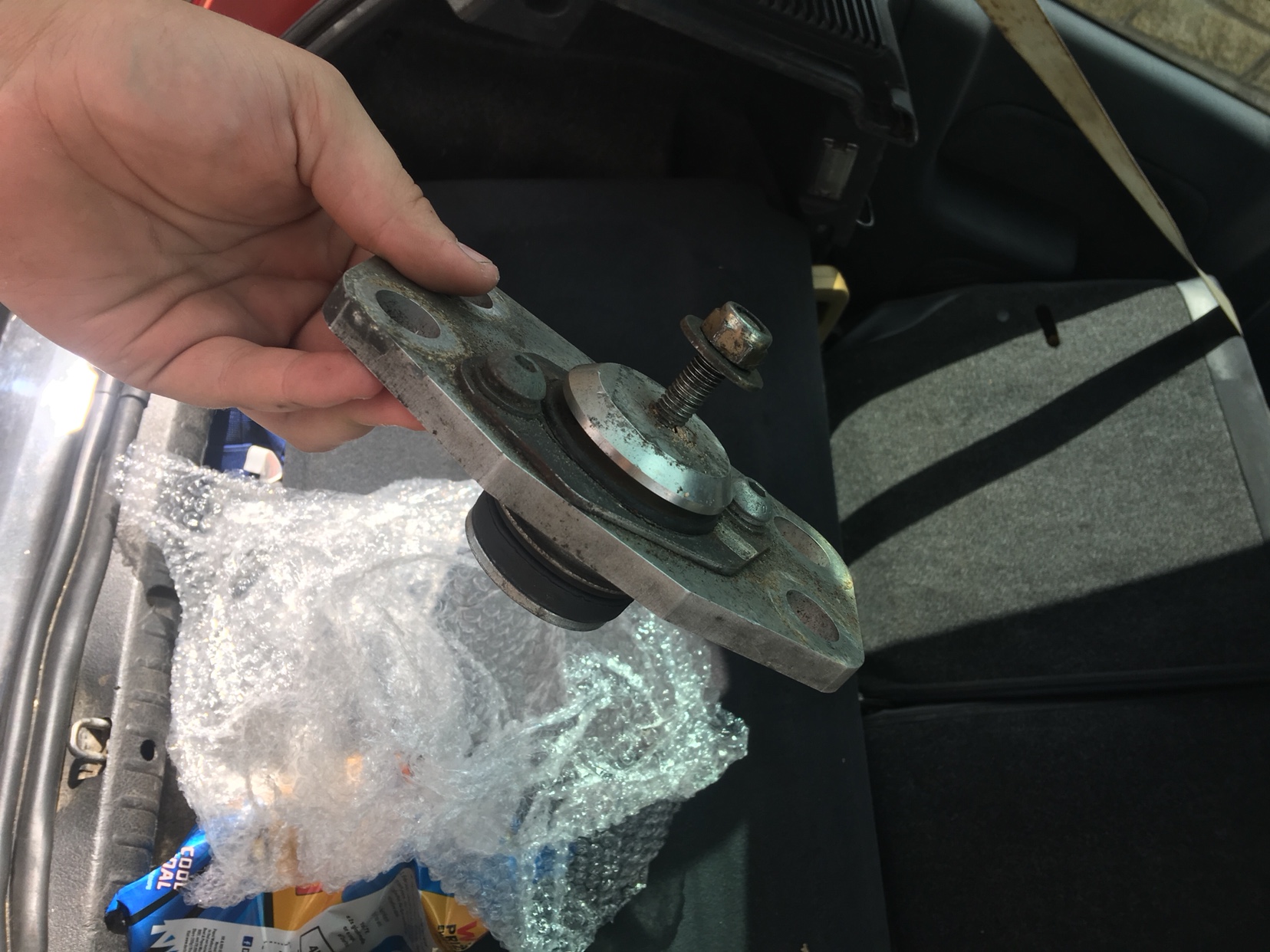

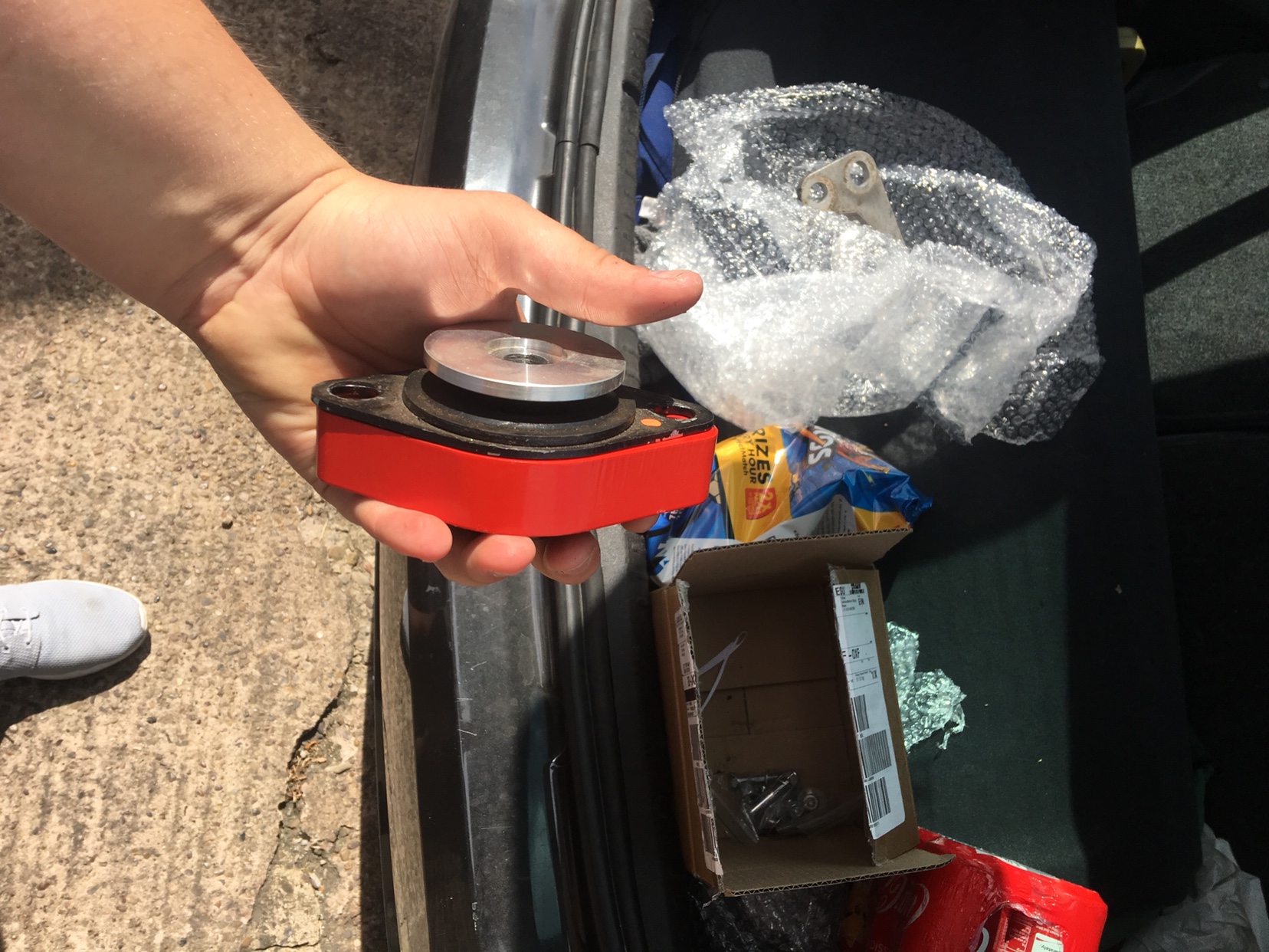

Every mount will be polybushed on the car now as I received my rear shocker mounts the other day! Can’t wait to get it back together and detail it![emoji24]

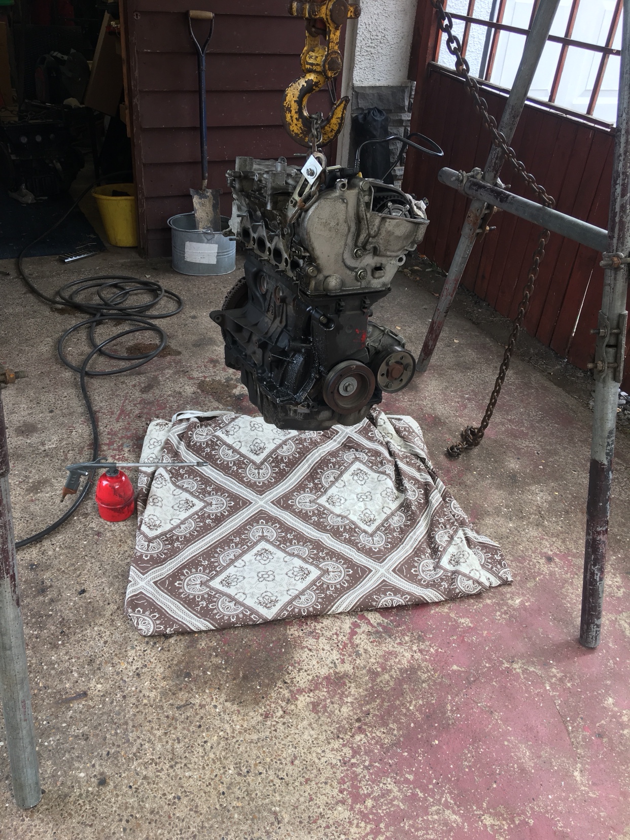

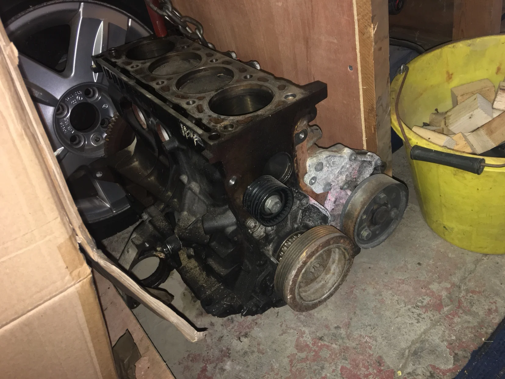

Took my engine to @bloke yesterday for belts etc doing, found a good sign it’s been looked after before as there was Megane bottom pulley on already. Engine already ran sweet but was good to see someone gave a s**t before me
Cleaned all of the grease from the block as my drivers CV had completely gone and caked all the way from the sump to the rocker cover in grease![emoji23]
Petrol in the spray gun took good care of that

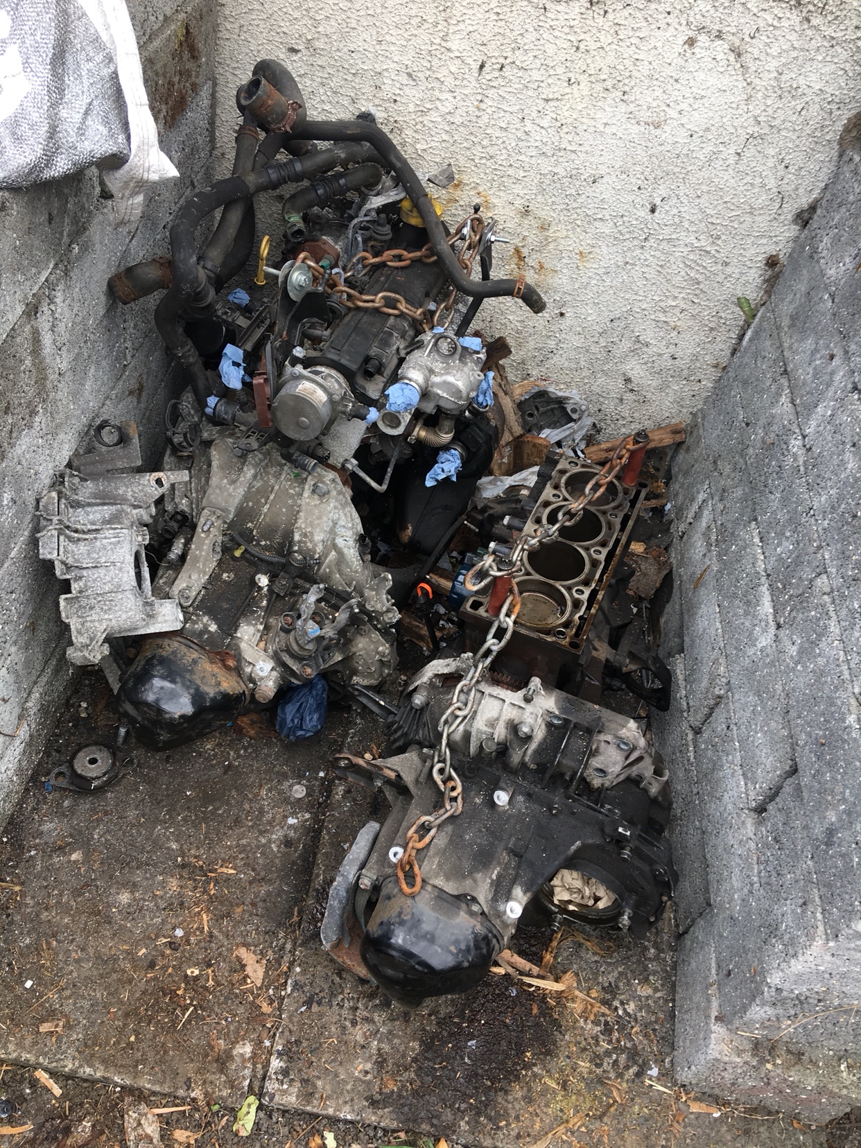

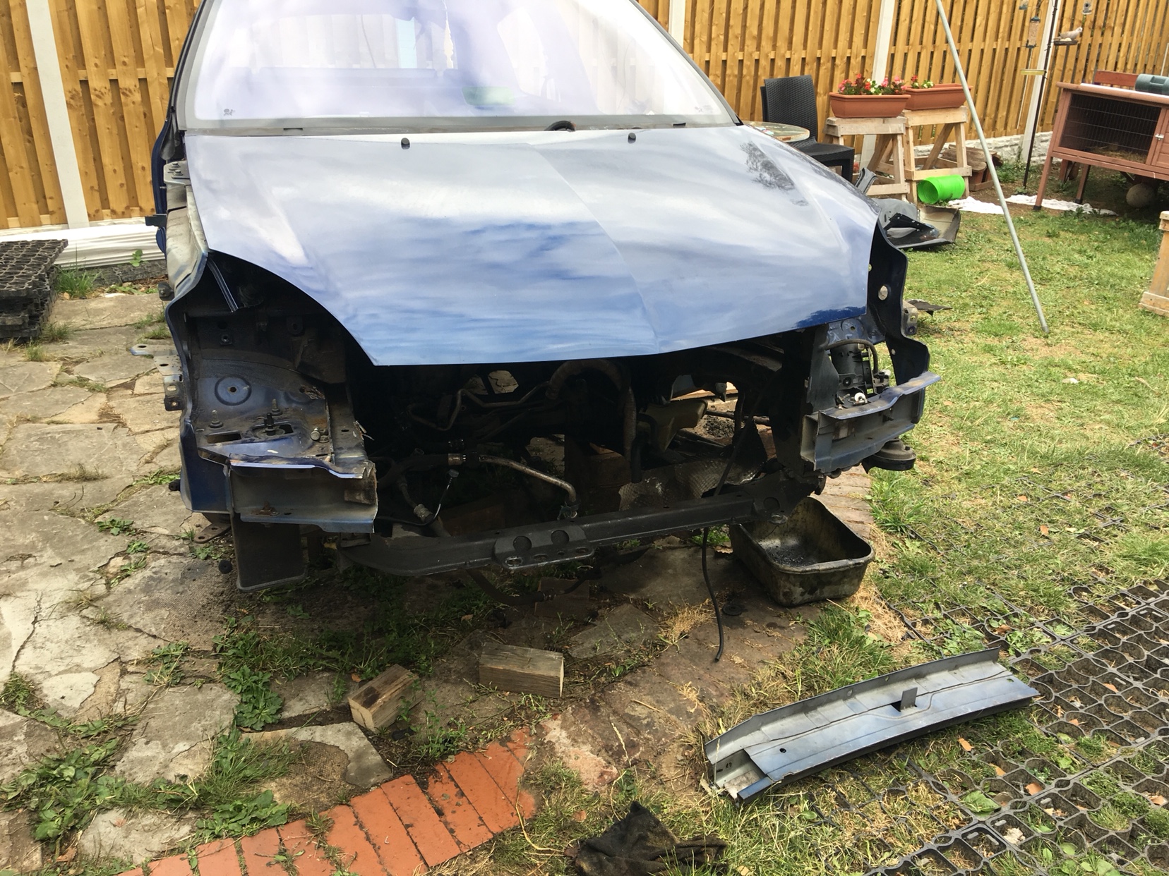

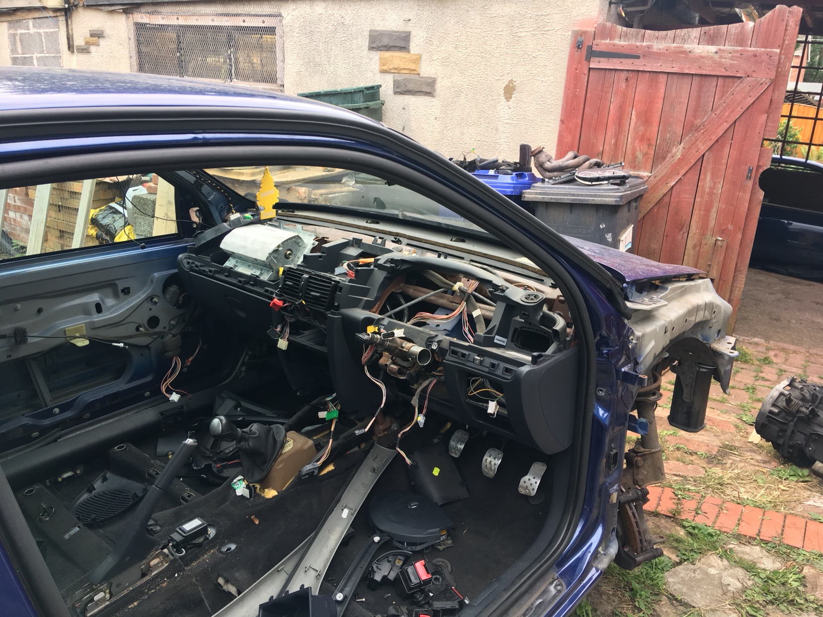

I’ve also been stupidly busy taking the rest of the breaker apart. Hopefully going in the bin tomorrow if all goes to plan
Might actually get the other 172 on the road this month fingers crossed... I don’t know who I’m kidding I’ve got so much to do[emoji24][emoji31][emoji23]
Breaker went in the bin. Price of scrap is at £99 a tonne!! Last time I scrapped one it was only £73. Nice bonus

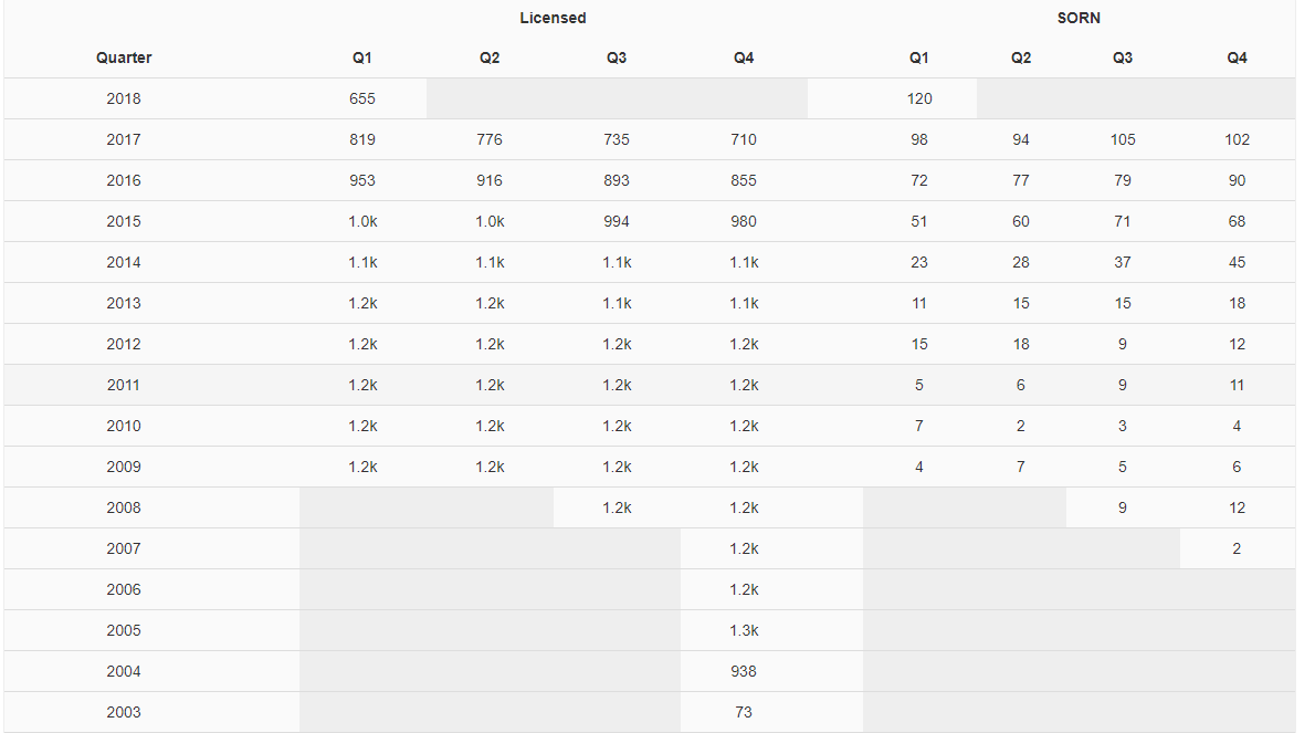

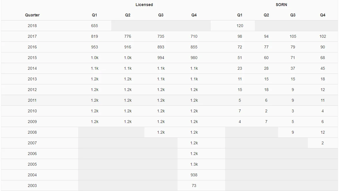

Found out today that my dCi is getting rarer and rarer?
Who knows, by Christmas there might be less than 500 at the rate that they're getting squashed!

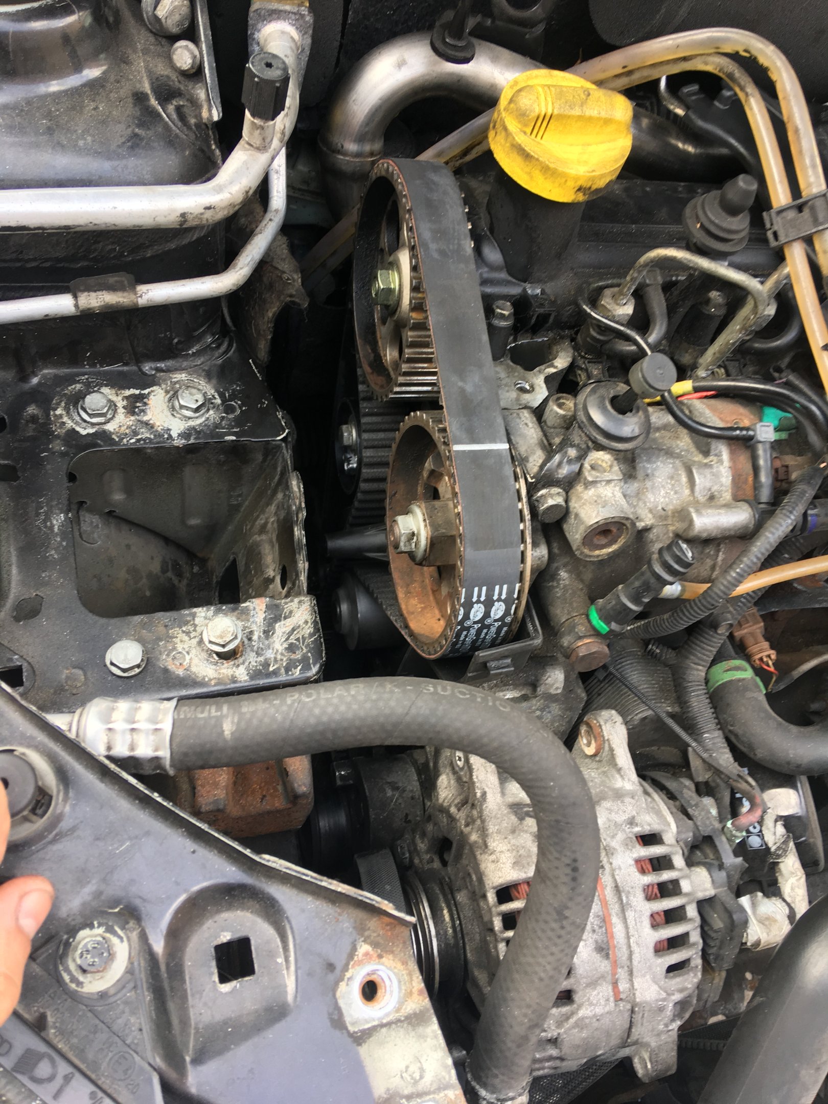

Cambelt tomorrow for the dCi, praying for everything to go right as I can't be arsed with any hiccups and I don't have a backup car either?

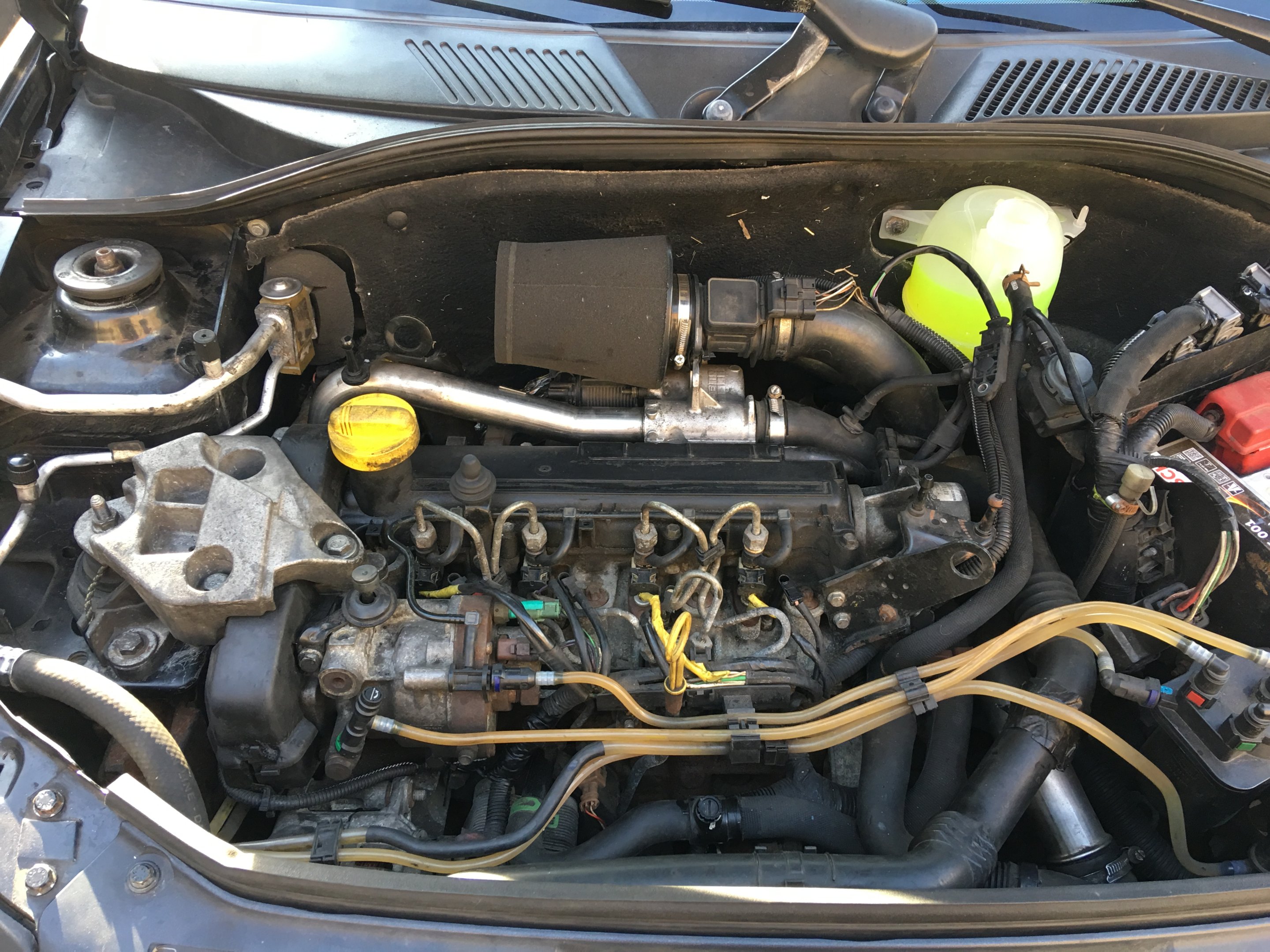

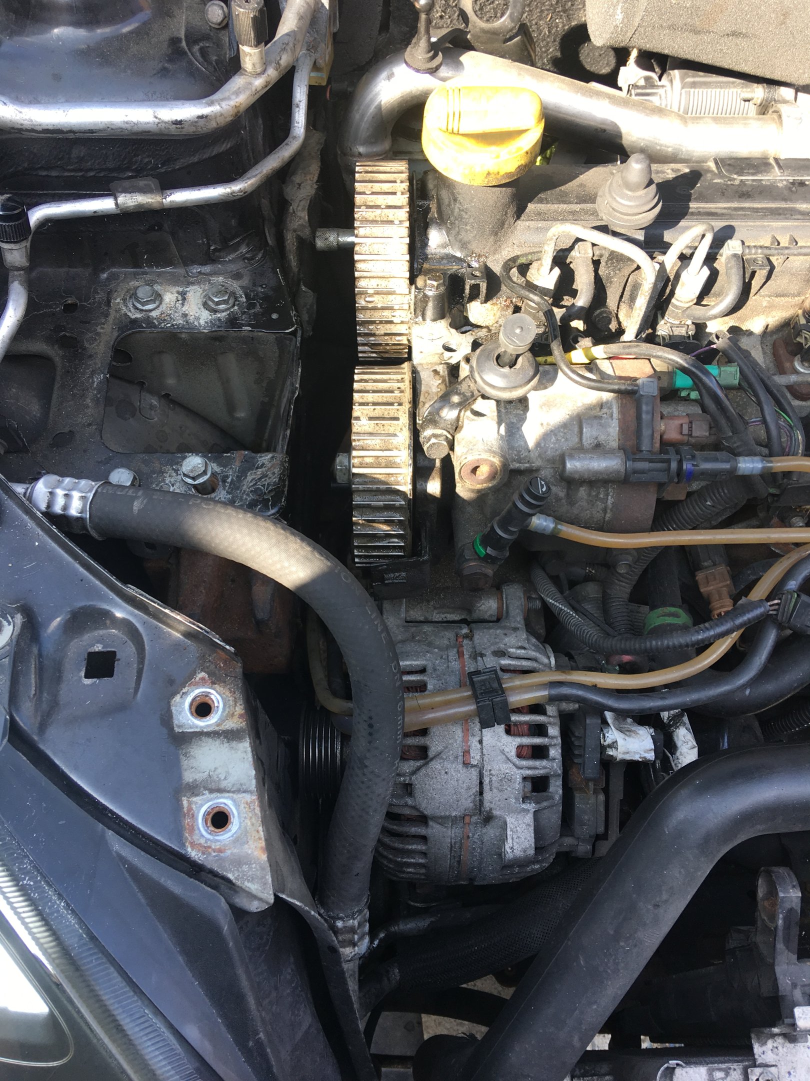

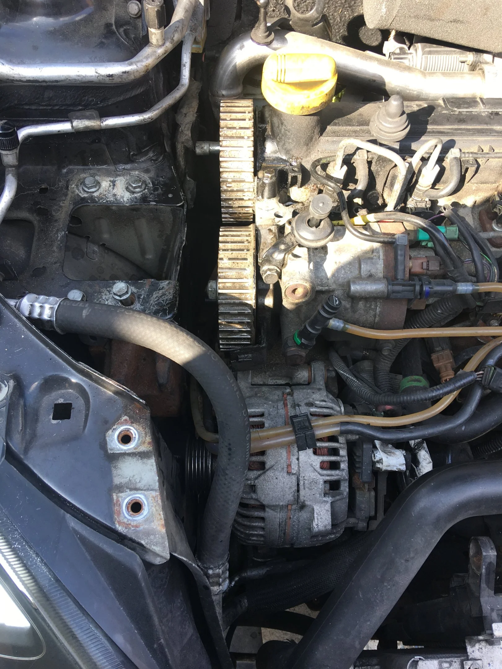

Cambelt today, new expansion tank and I must have cleaned off about half a mtric f**k tonne of grease and oil from inside my cable covers and down the side of the block!!
Cambelt/waterpump all back on and timed
Everything all back together. And to say this is when I “cleaned” a lot of stuff up too! Still horrid and dirty as sin!?
New fuel filter needed and found that my MAF wasn’t working either! Like not reading anything at all!?

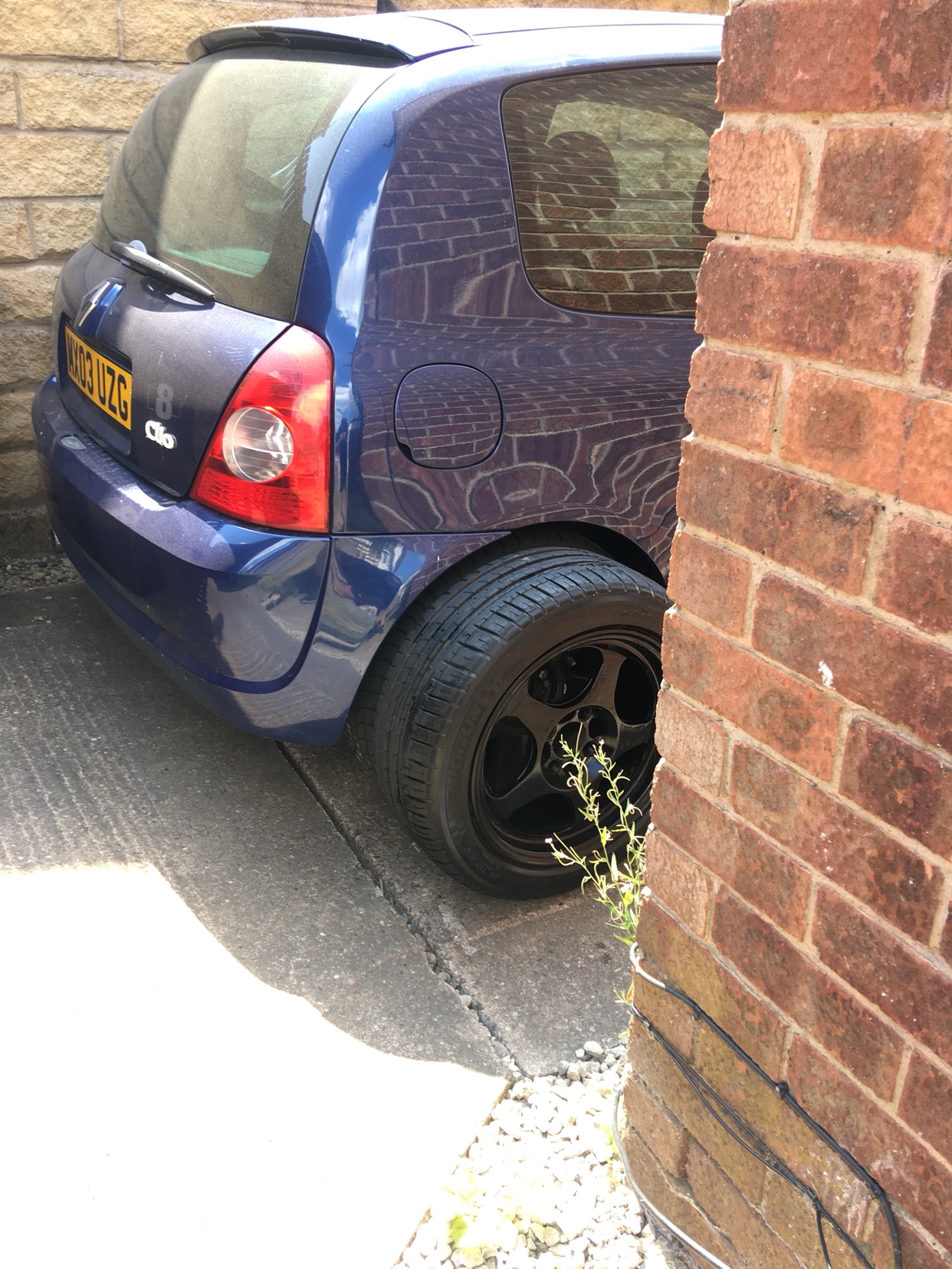

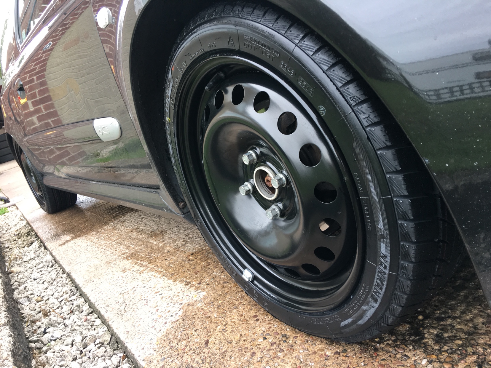

I also did a massive marmite thing... some of you will love it, some of you will hate it

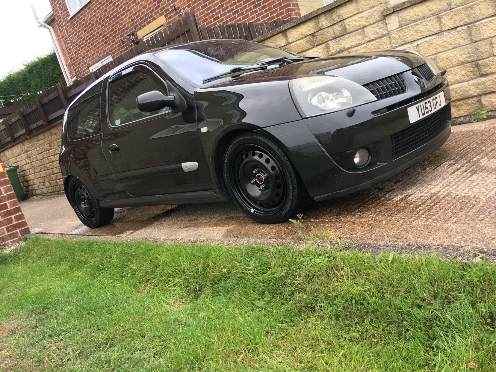

16” Megane steel wheels with brand new Nankang N-607+. Car is currently having tracking as we speak to make sure everything is all good for winter
I love the look of steels for some weird reason, can’t go wrong at £50 for brand new wheels that have never seen the road.

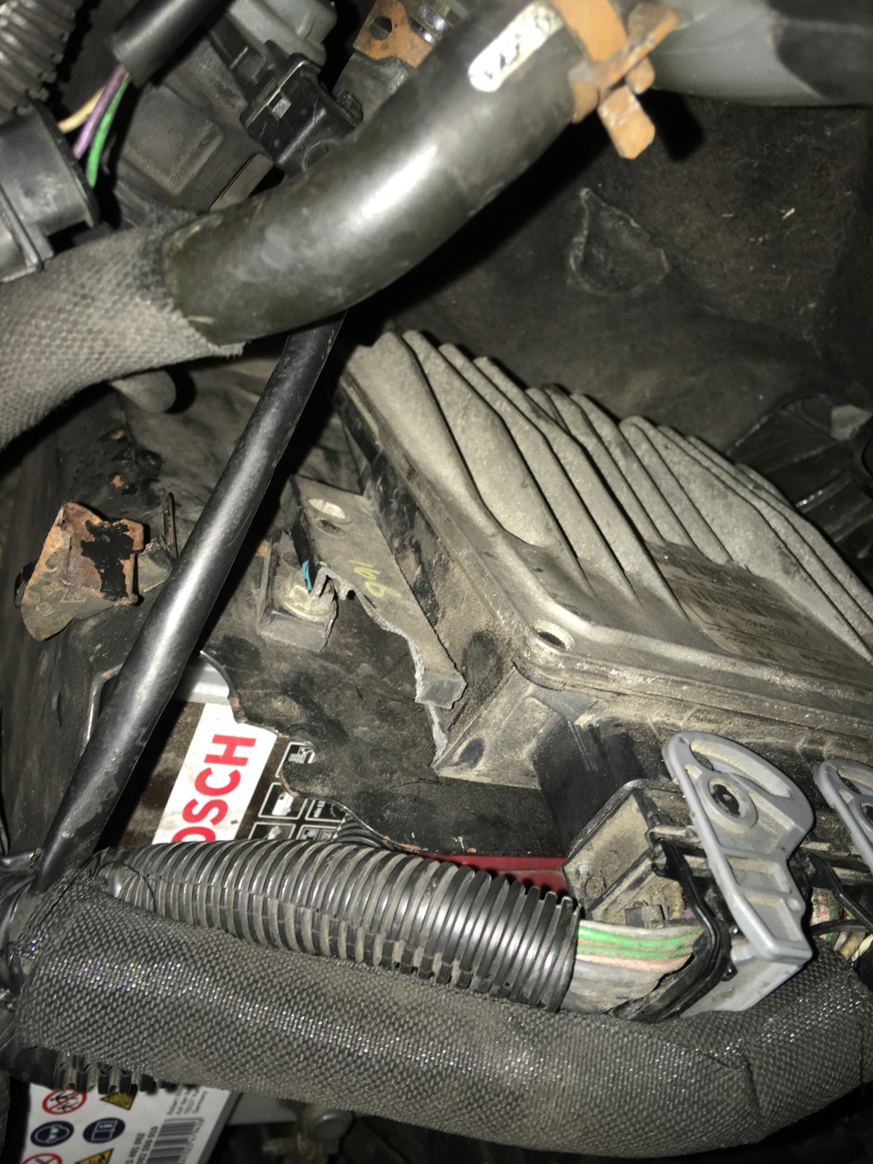

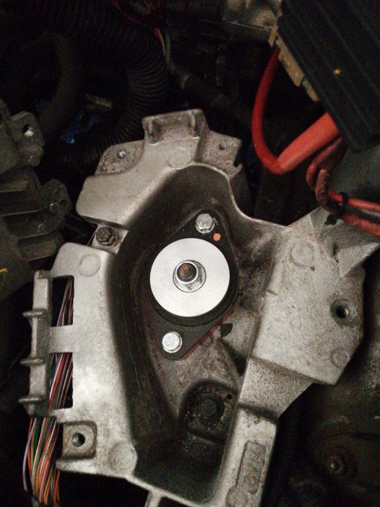

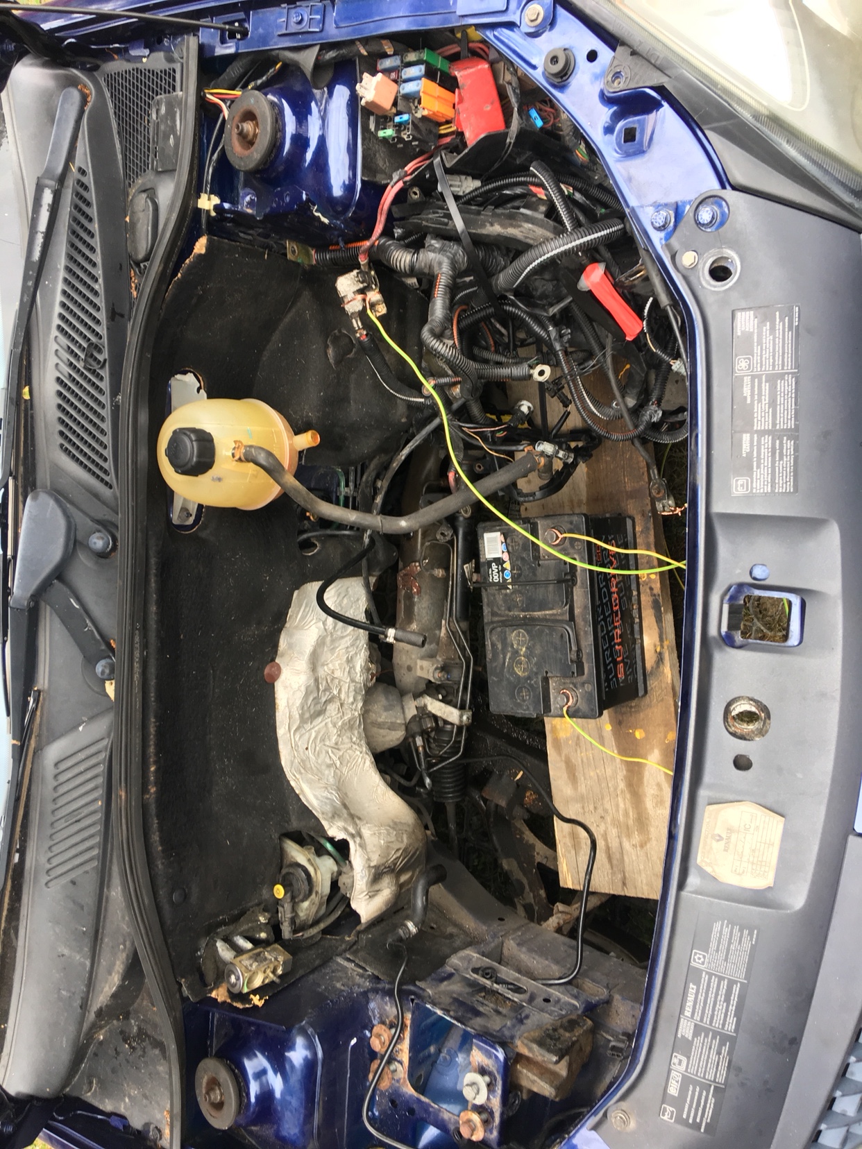

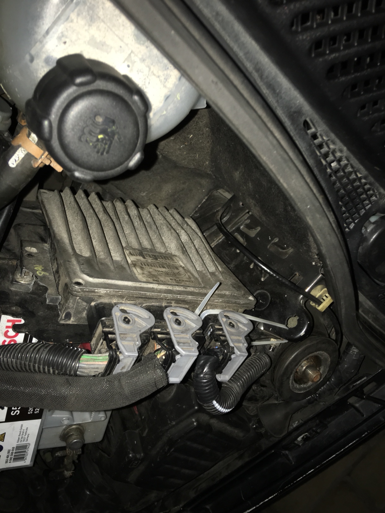

Been having the similar electrical problem where the dCi will idle at about a grand and I won’t get any substantial boost. No variable vane etc, I found that when I pushed down the second plug on top of the ECU it idled normally...
Shame that my ECU has 2 broken brackets and when I pushed down on it (not even hard) the French plastic gave way so now I have 1 original mounting point left[emoji52]
So now I’ve had to do this...
I used white cable ties so I could tell where to cut next time as I don’t wanna cut something black and it be the main body loom[emoji23] You think it would never happen but you never know[emoji28]
It seems that it idles better when the ECU is in a certain position so I’m either guessing my ECU is fucked or my wiring loom is (I know the loom is fucked, I’ve had to retape half of the c**t already)
Either way I think it would be best for me to replace the loom with one I have lying about and then stick my spare ECU, injectors and UCH on as I have 2 keys for the other set too.
Something I’d rather not be doing as the engine bay on a dCi 100 is soooo packed with s**t and hoses and wires all over the shop! It makes working on a Subaru look easy
I’m hoping I can get it sorted because it’s annoying me having about 5psi of boost, I just wanna work on my 172 and not have to worry about fixing a daily driver every 20 seconds[emoji23]

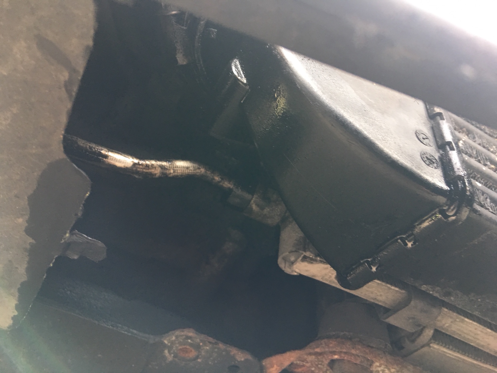

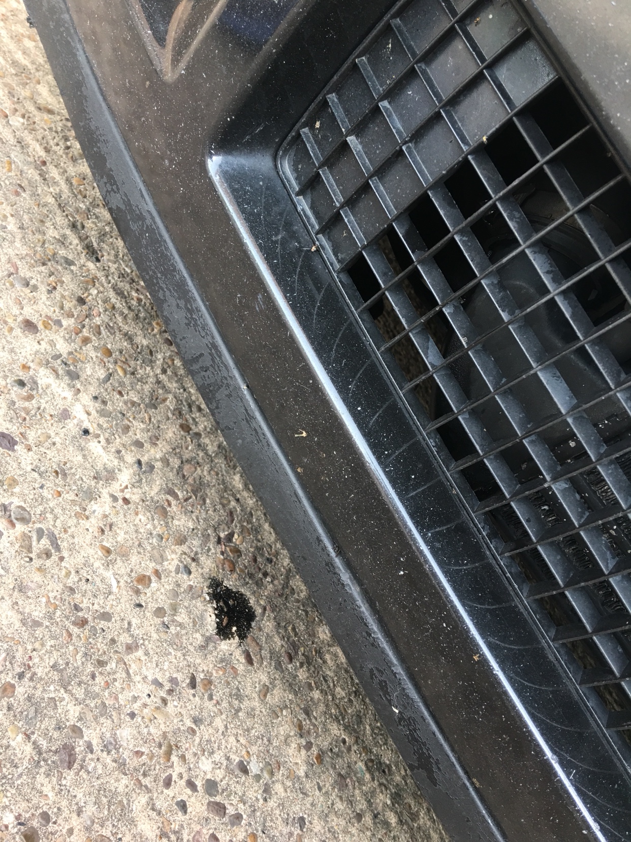

Soooo... been having some major boost and idle issues recently. Looked on the drive and saw this earlier
Looked through the front lower grille and saw that it was a leak from my front mount turbo side boost pipe
So I spent 5 mins tightening all my boost hoses up and now it goes like s**t off of a well polished shovel. The amount of oil seems worrying to some people but to me I really don’t give a s**t[emoji23] No play in the turbo at all even after 249,000 miles, can’t imagine what the inlet looks like now though, may need a @HMS Derv Destroyer special terra-action[emoji102][emoji23][emoji23]
