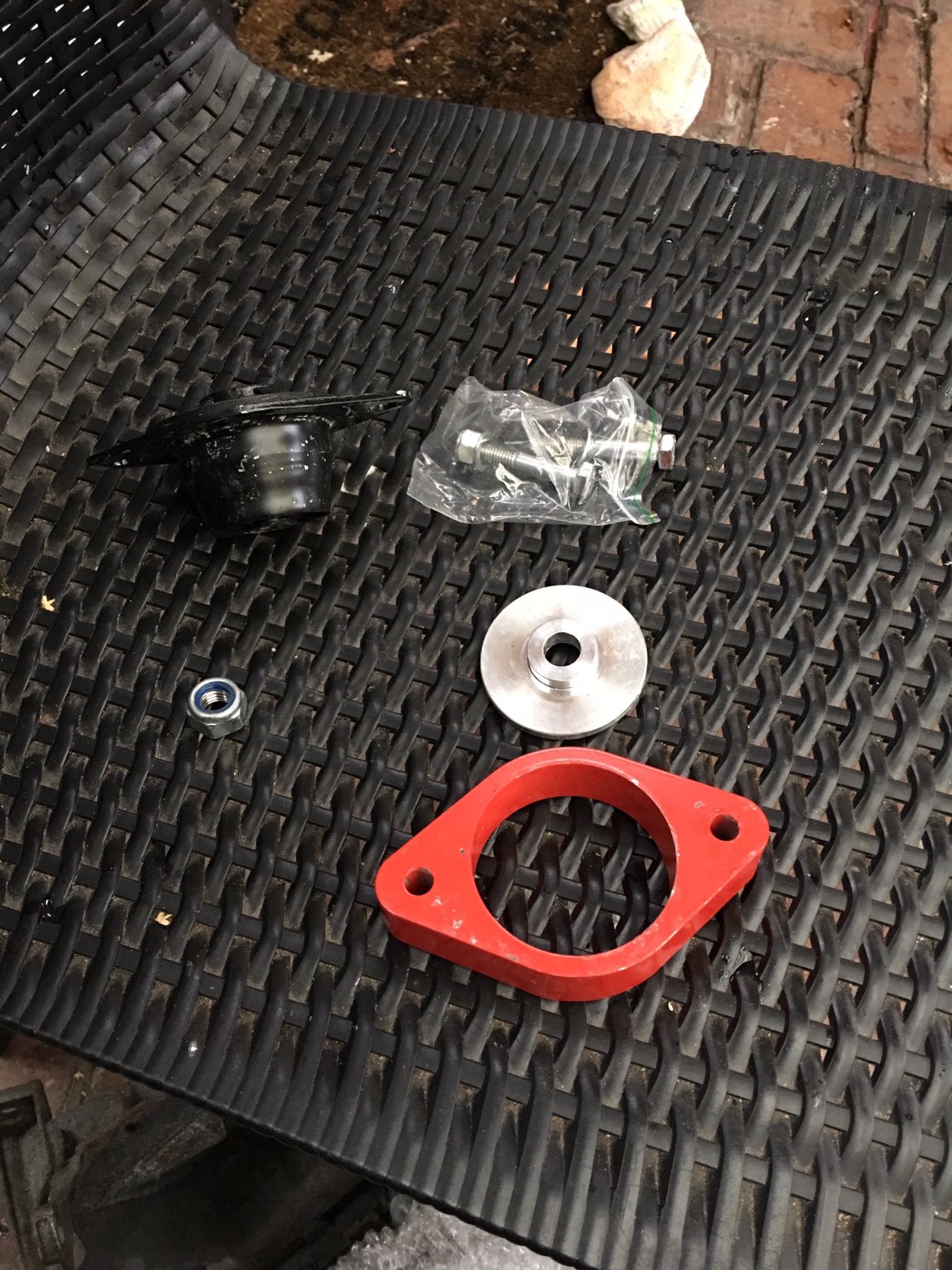

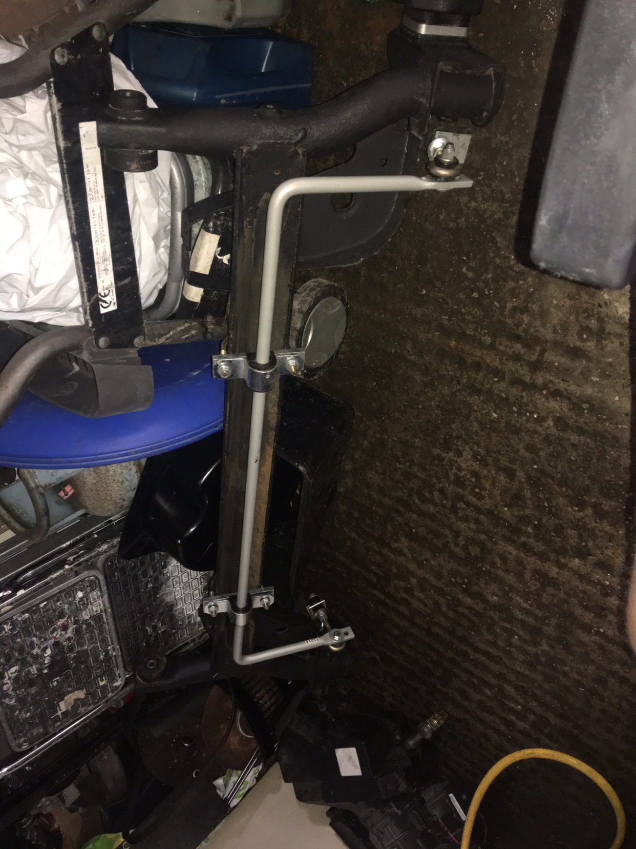

Rear ARB
PMS solid top mounts

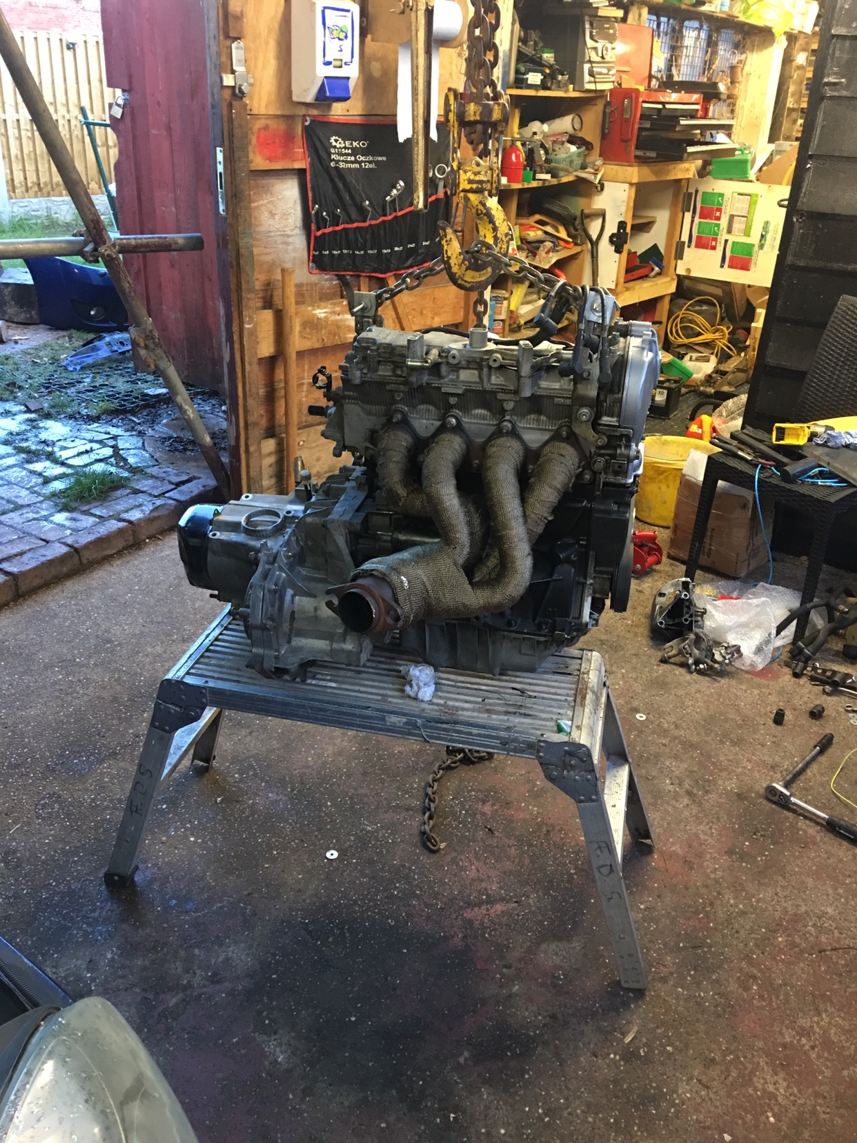

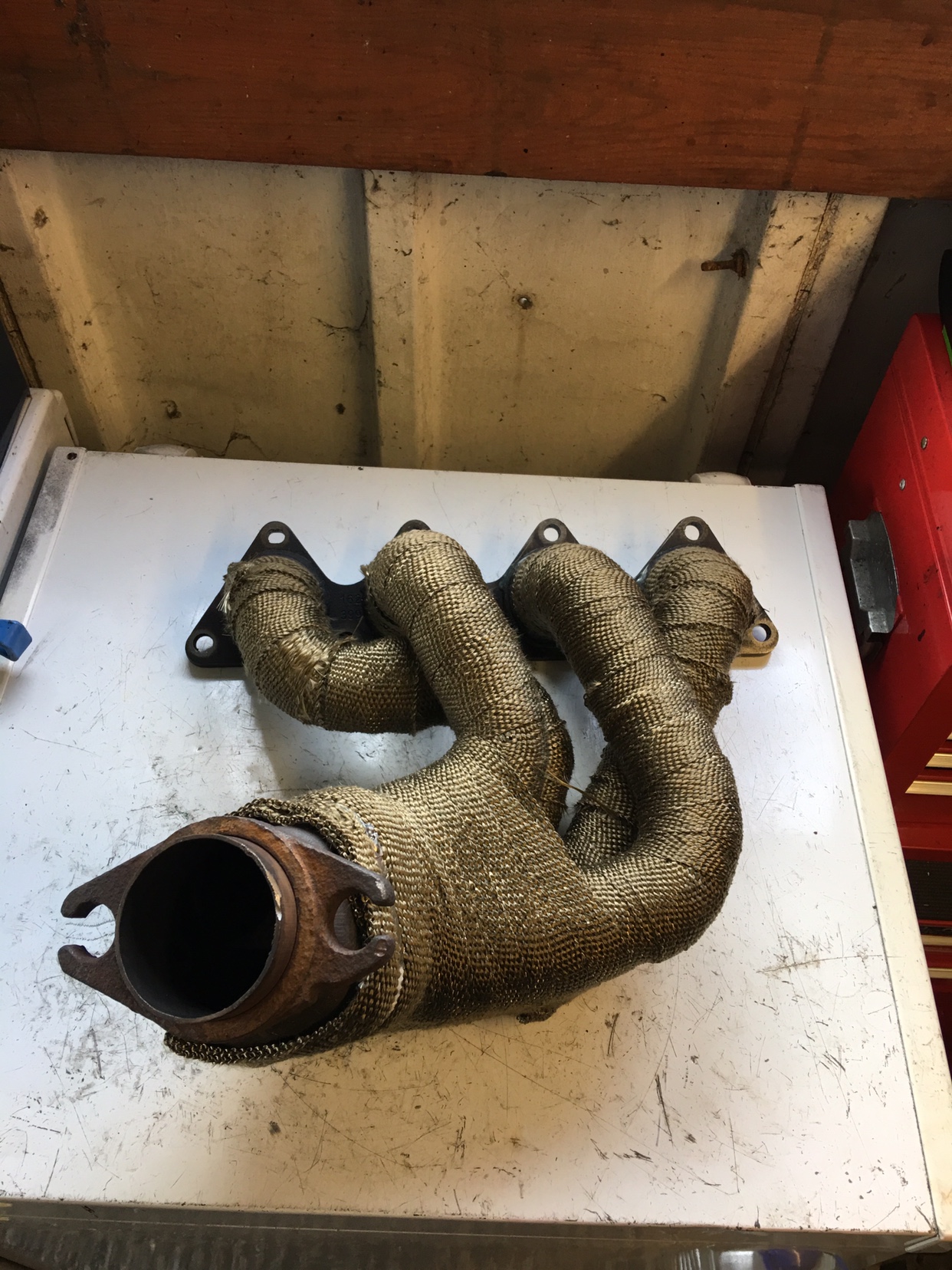

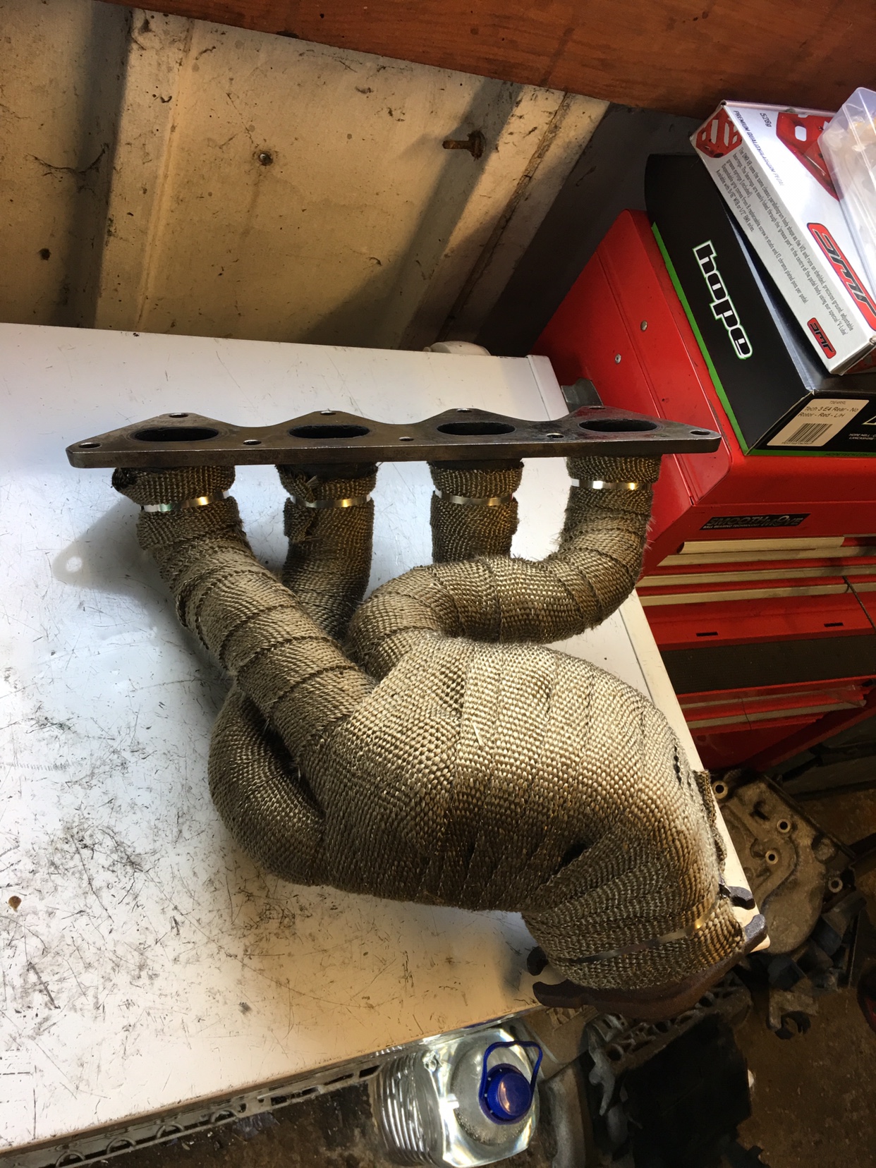

Titanium heat wrapped my manifold, some people will indefinitely moan and cry “it will crack the manifold” or “it doesn’t even do anything” yeah oh well.
Did the whole manifold in 2 x 10m rolls and still have loads of 1 roll spare. I’m not gonna be running a heat shield down the back of the engine so thought for the sake of £40 I might as well try it and if it doesn’t work then oh well and if it cracks the manifold then it gives me even more of an excuse for boost.
Pics of the finished product, not bad for my first time wrapping something but I didn’t really take my time to get it perfect as it’s only going to sit somewhere where it’s not gonna be seen.

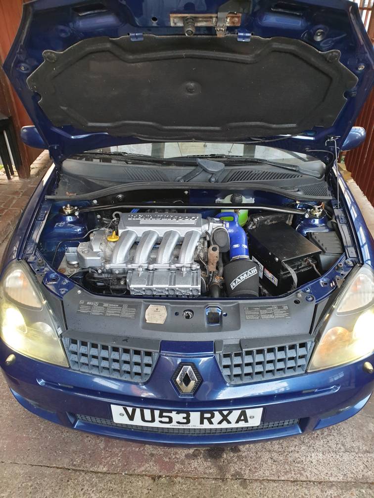

  Clio II dci

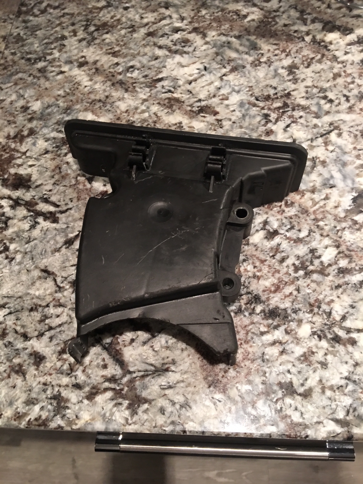

Where's that airbox from? I want to find a different kind of airbox for my Ph2 because the original has such a design that i can't stop it from making vibrating noise idling...
Also, nice project you got here ;)

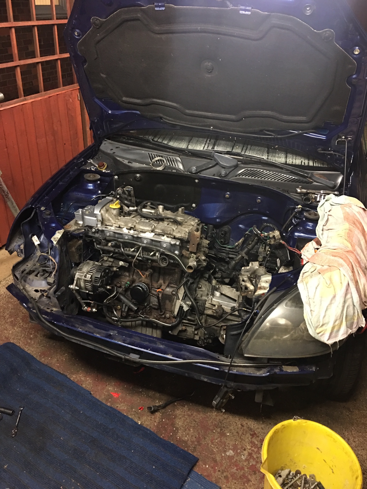

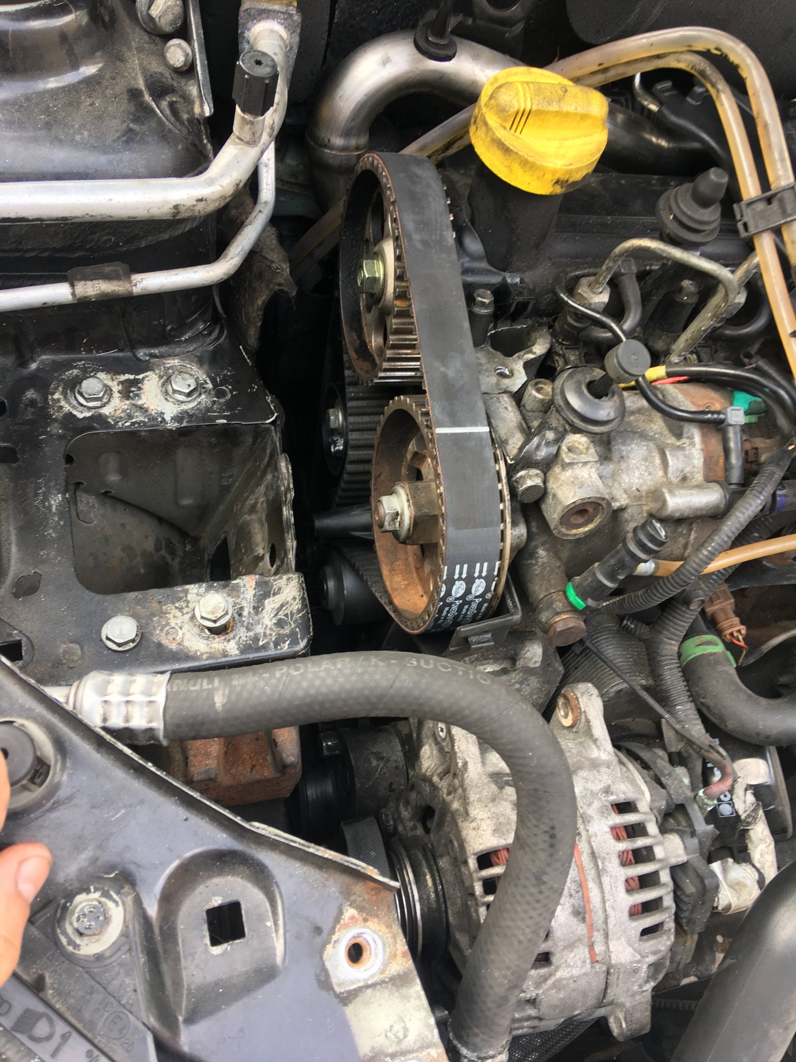

Cambelt today, new expansion tank and I must have cleaned off about half a mtric f**k tonne of grease and oil from inside my cable covers and down the side of the block!!
Cambelt/waterpump all back on and timed
Everything all back together. And to say this is when I “cleaned” a lot of stuff up too! Still horrid and dirty as sin![emoji23]

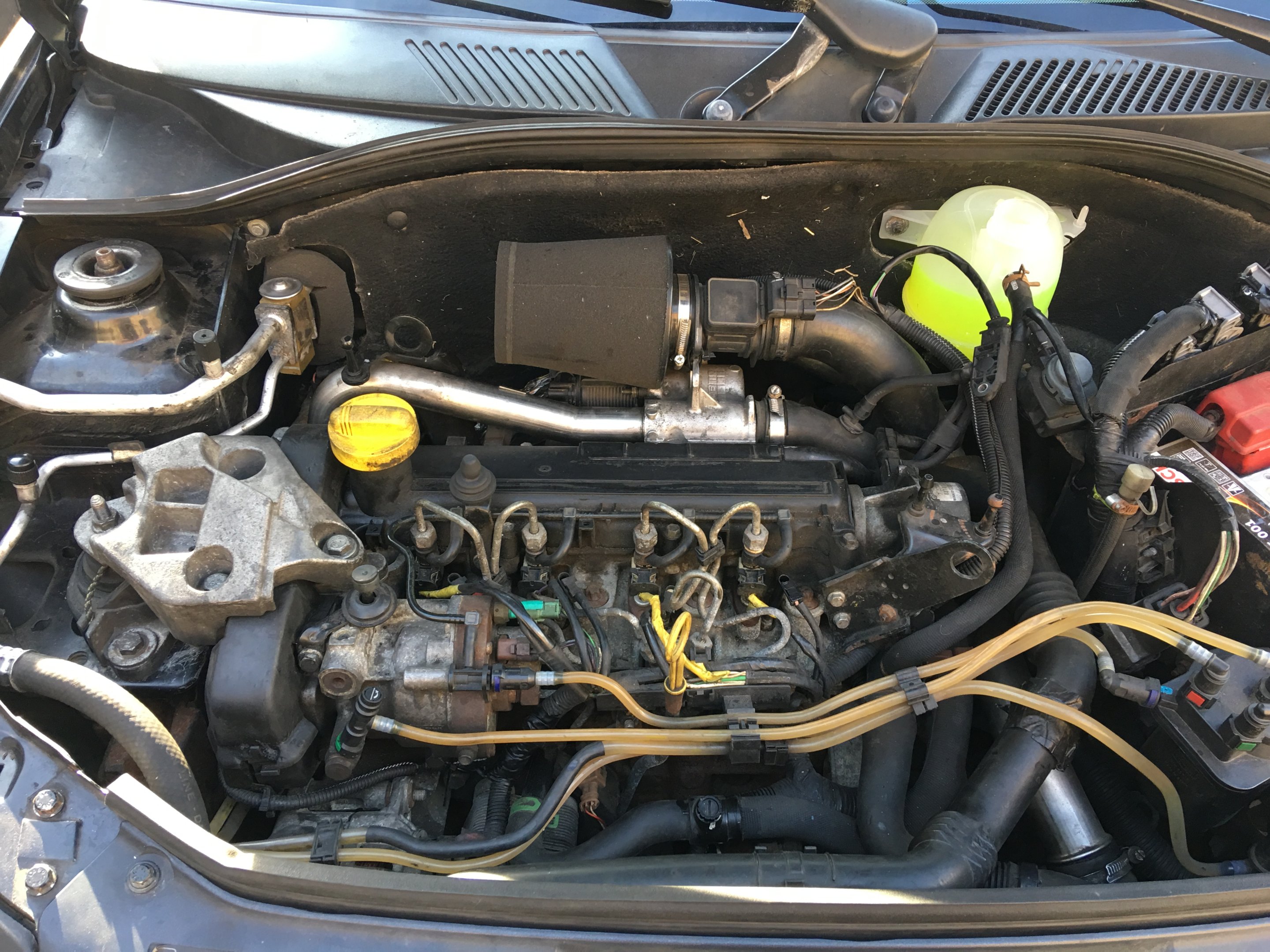

New fuel filter needed and found that my MAF wasn’t working either! Like not reading anything at all![emoji23]
The type D looks lovely and nice inside a new expansion tank, @Sj1782 it does look like it could glow in the f**king dark![emoji23]

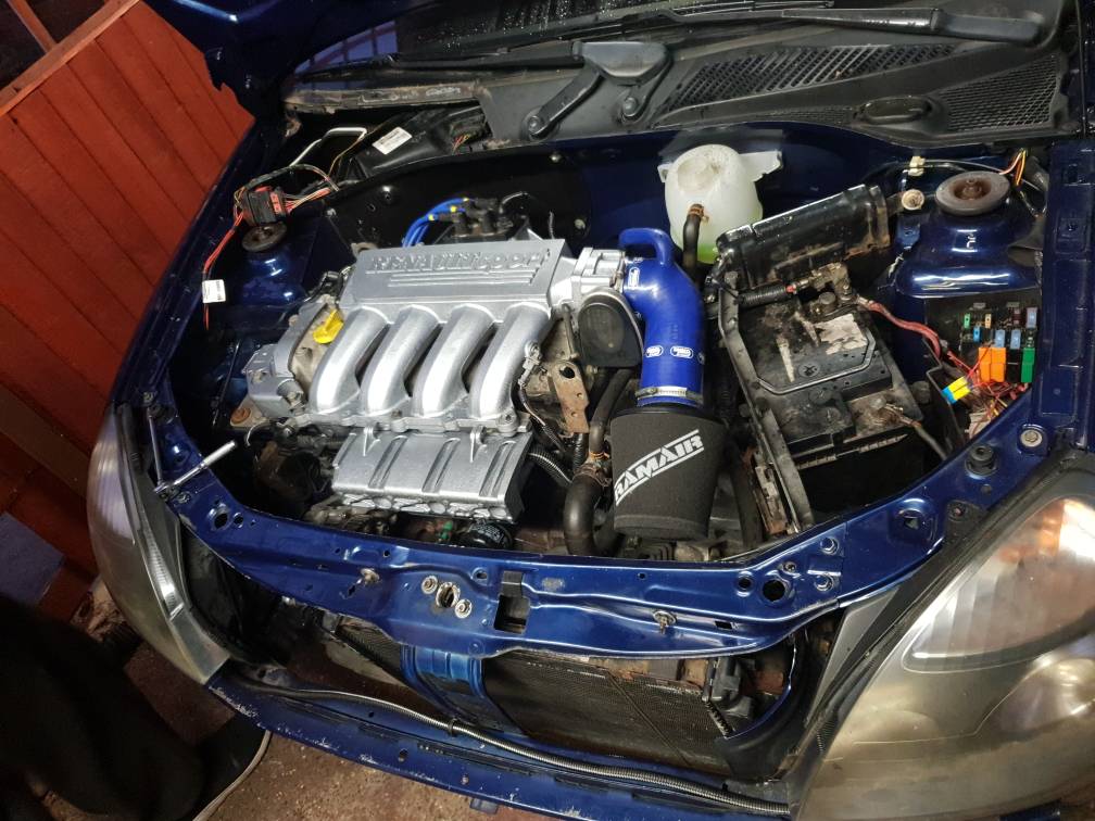

This airbox on the 2nd photo, seems like a mutch better system than stock.
Sent from my Redmi Note 5 using Tapatalk
Krarl
It’s just a 60mm offset filter banged onto the end of the MAF sensor haha. People say that it gets too hot there above the turbo but it made zero difference but made some lovely whooshy noises on boost haha
  Clio II dci
Well, i'm looking for a system that replaces the default stock airbox because the design on it is crap, i'll see what i can do... but that system with a proper sized airbox would be good no?

I was gonna make a custom one like a bucket intake (ph1 style) and have a cold air feed but then I realised it’s a retarded idea as it’s only a 100bhp diesel and just decided to slap a Ramair filter on there for more noise

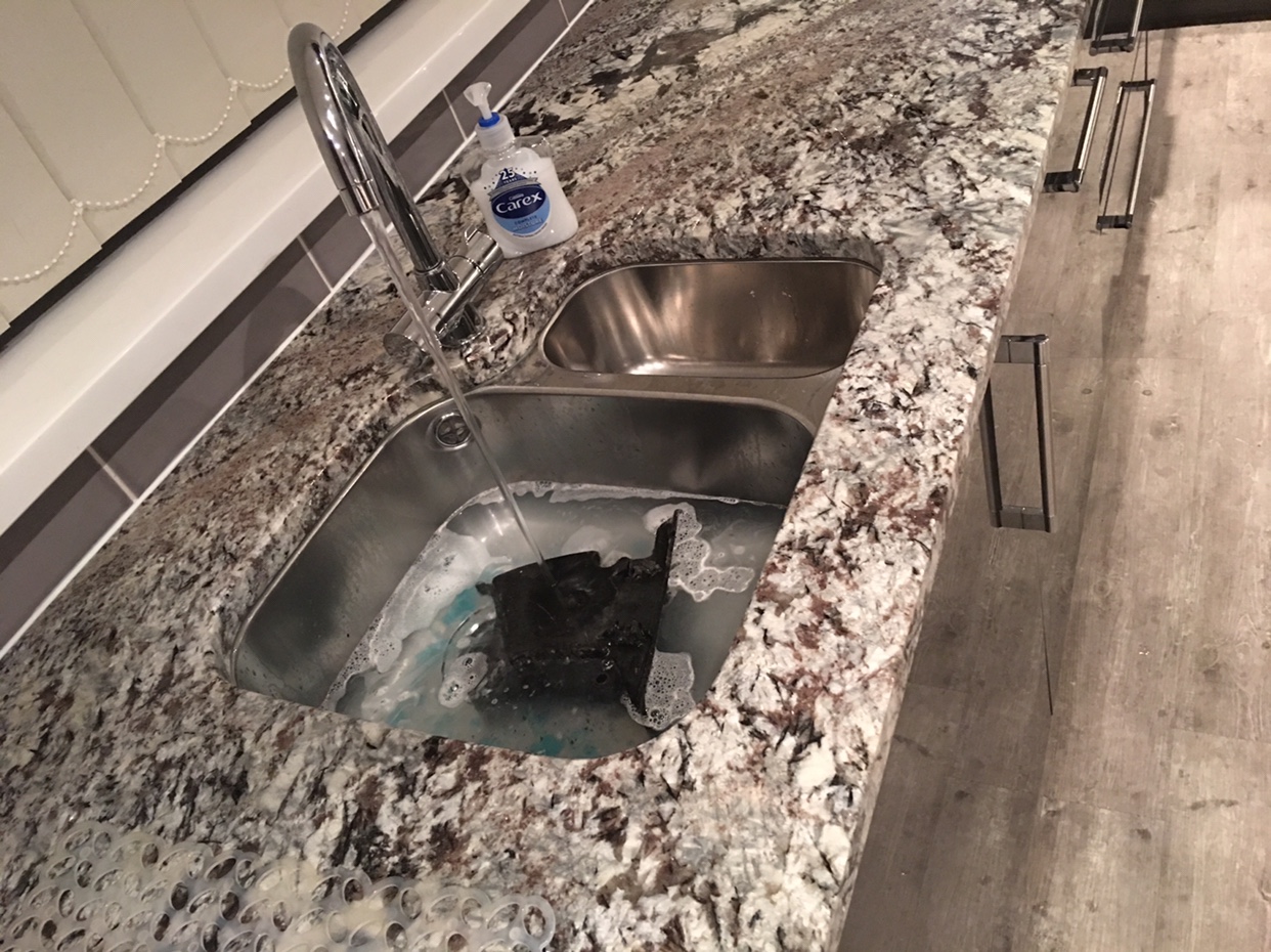

Just got an RS Tuner for when the car is eventually running in 2023 and one thing that’s been on my list for ages which is a lower cambelt cover. Mine has started to open up a bit and I’d rather have a good one without any openings
My Mrs didn’t even bat an eyelid that I was washing it in the sink

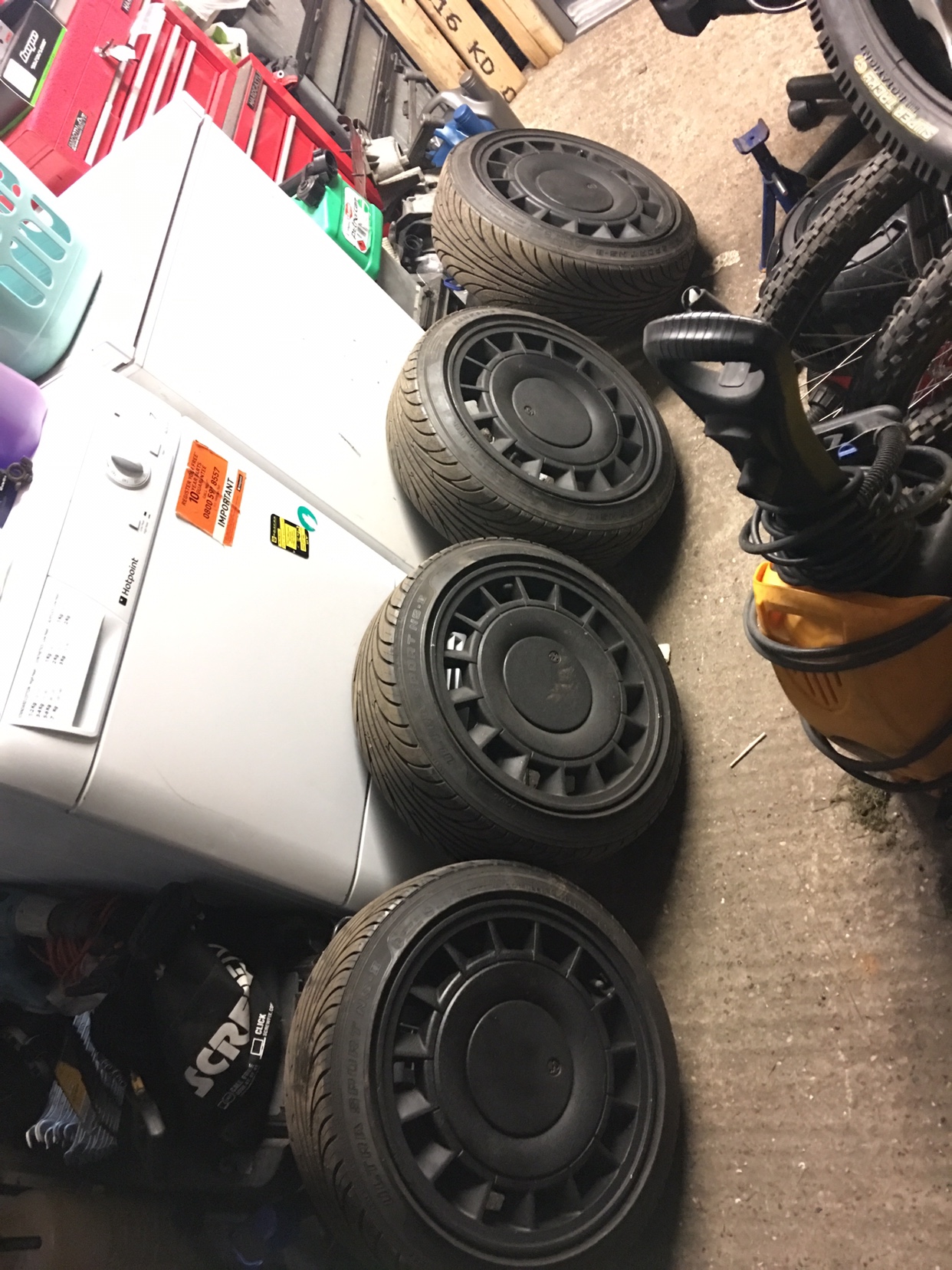

Also got another set of wheels, finally found some turbines not at the other end of the country or for £500
Still have all the original metal Centre caps and bolts too

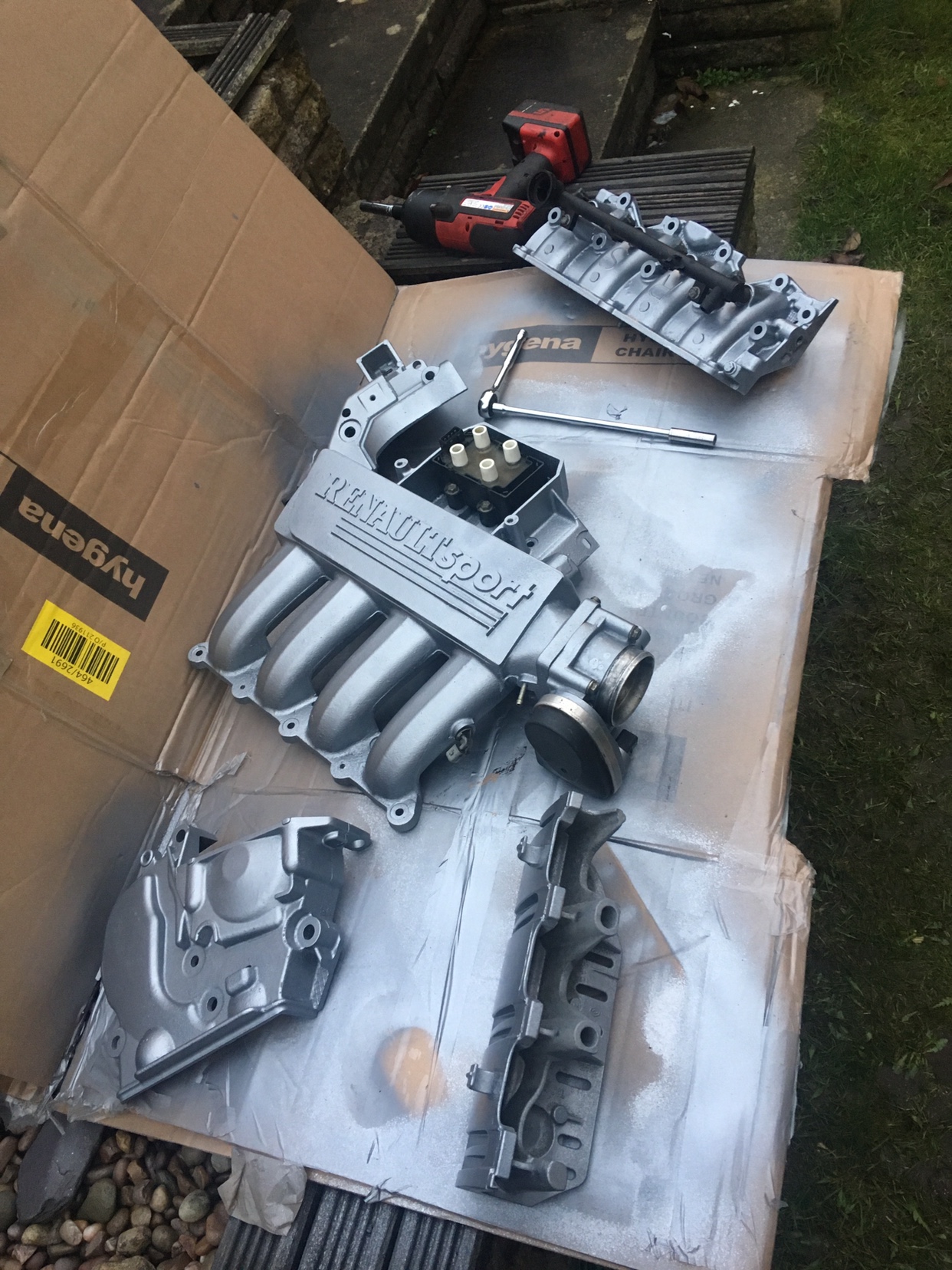

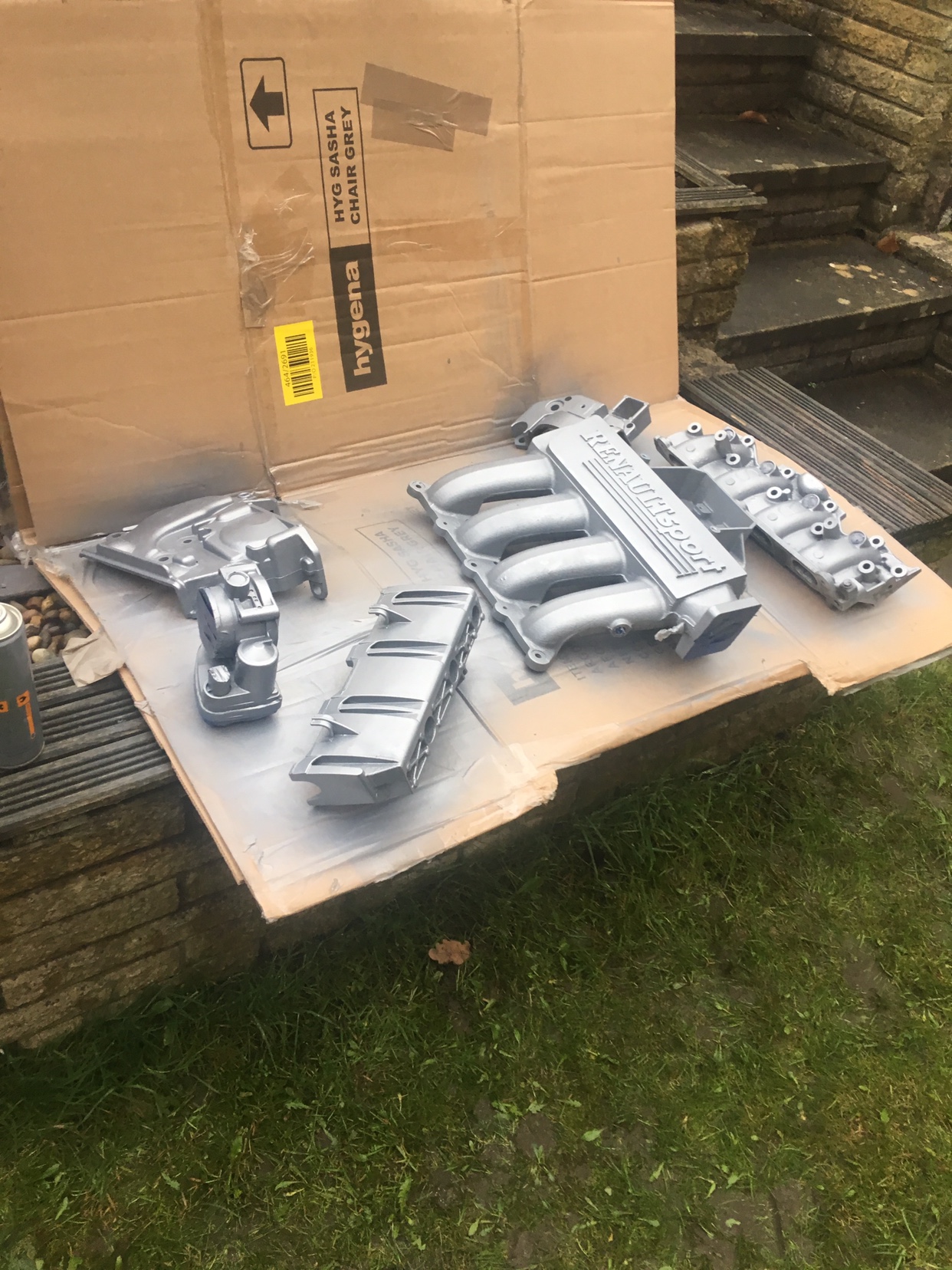

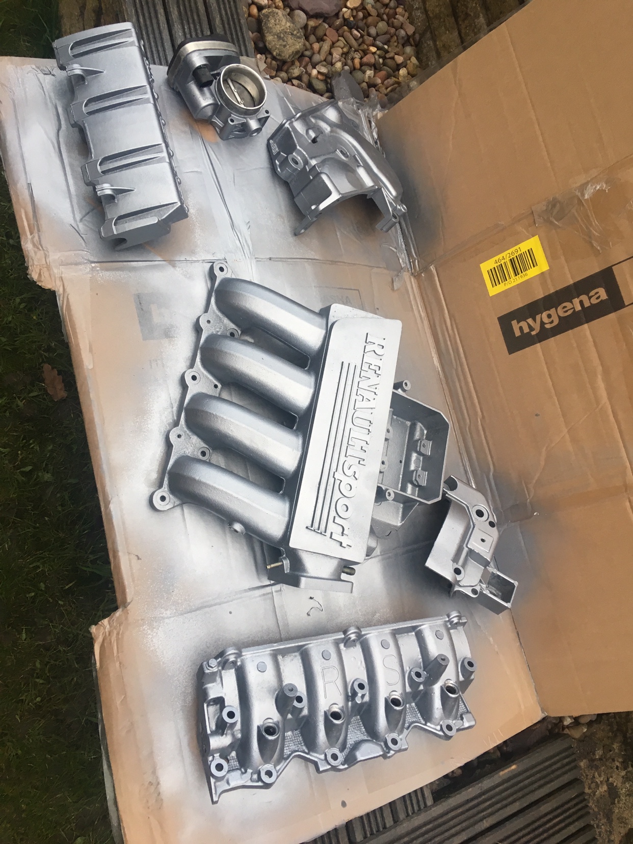

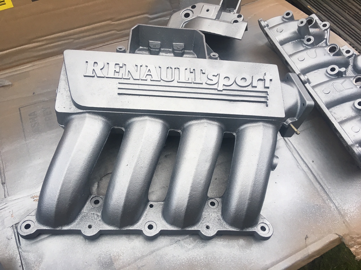

And then I was inspired by @Louis with his painted inlet and I’ve been meaning to do mine for about 3 months.
Sprayed all the Ali parts up with silver, not sure what colour to do the letter or I might just leave it
Not the best paint job but it was freezing outside and I couldn’t be arsed going the full mile because the bonnet is only gonna get shut on them anyway
Will look better than grease covered and oil spattered crap. Might pull my finger out and do something with the car at some point, too much to do and the weather is putting me off. Plus I have to drive to my parents to do anything because being a r****d I decided to pull the engine out there instead of doing it at my house[emoji1750]‍[emoji3603]

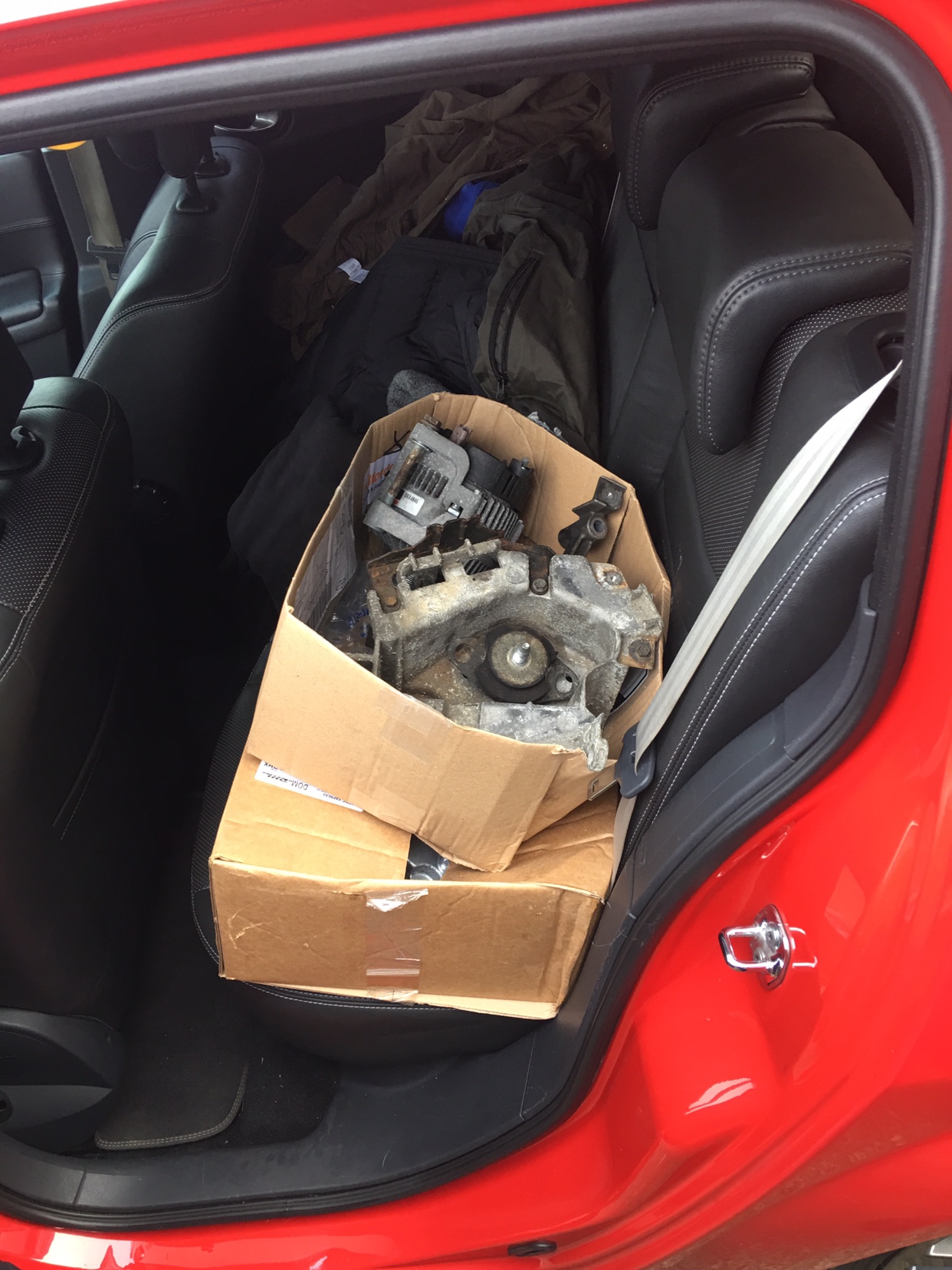

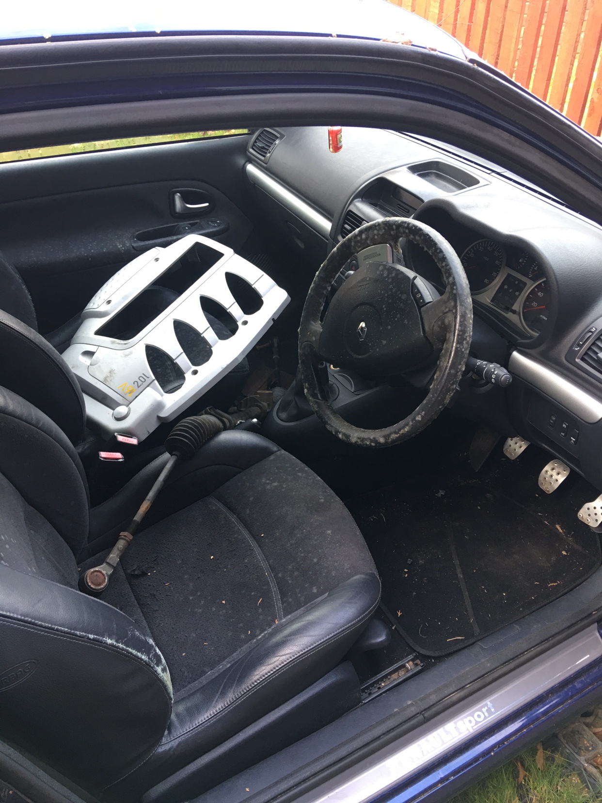

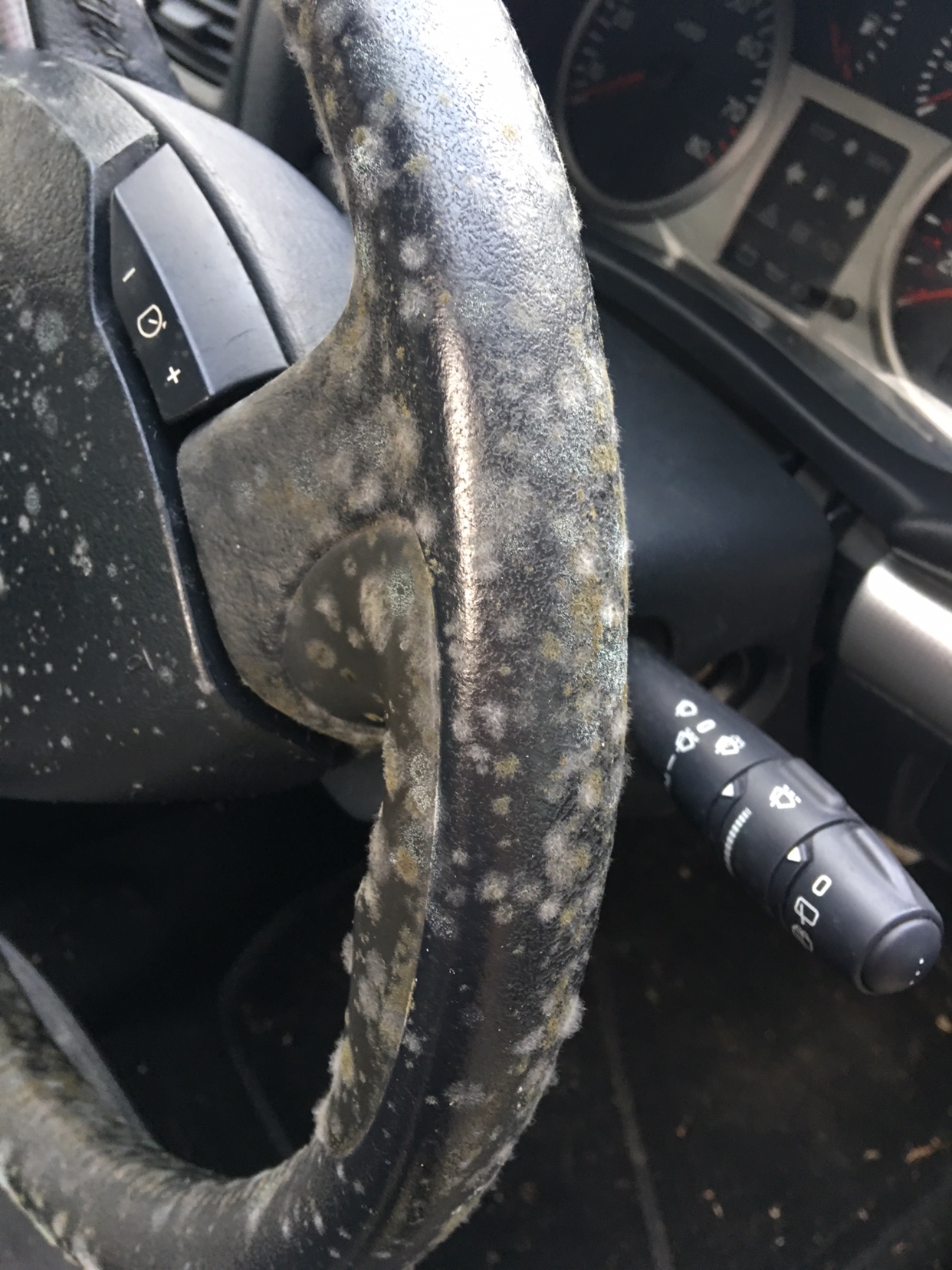

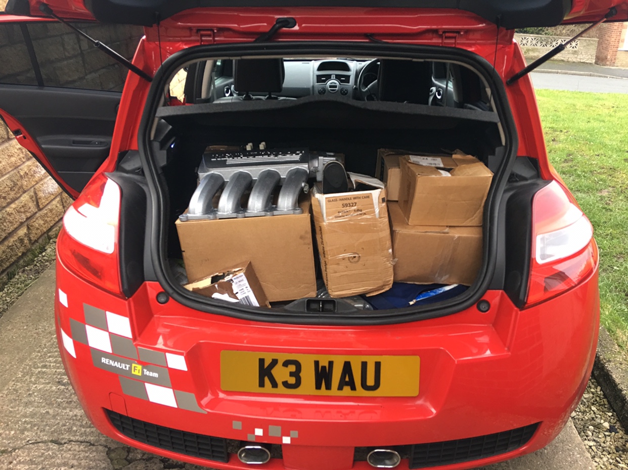

Loaded the Megane up today with boxes filled with Clio parts. These boxes are only half of the things I have for the 172
It just shows how long I’ve not touched the Clio for by looking at the steering wheel, gip
Good job I’ve got a 197 steering wheel cause that’s rank lol. Finally pushed it from its resting place and onto the drive to get some s**t sorted

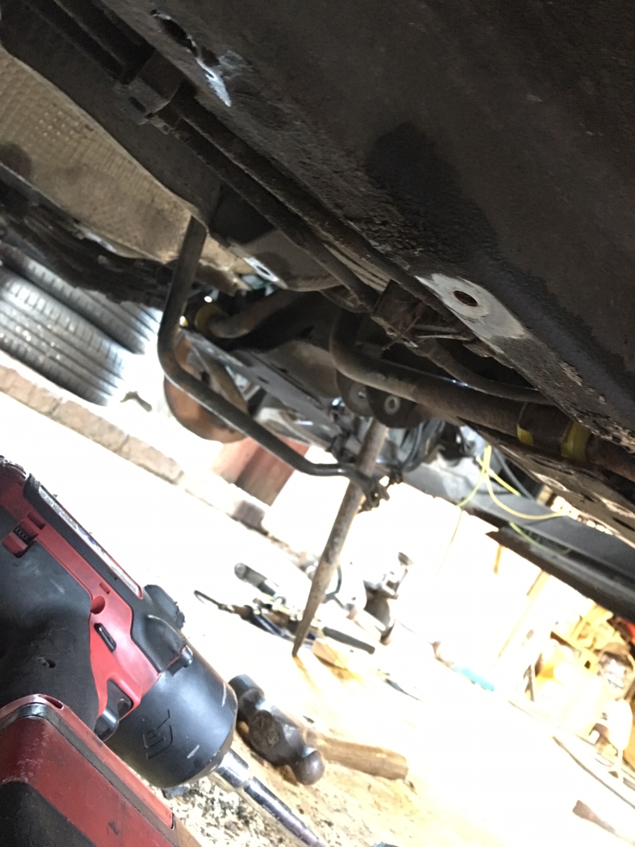

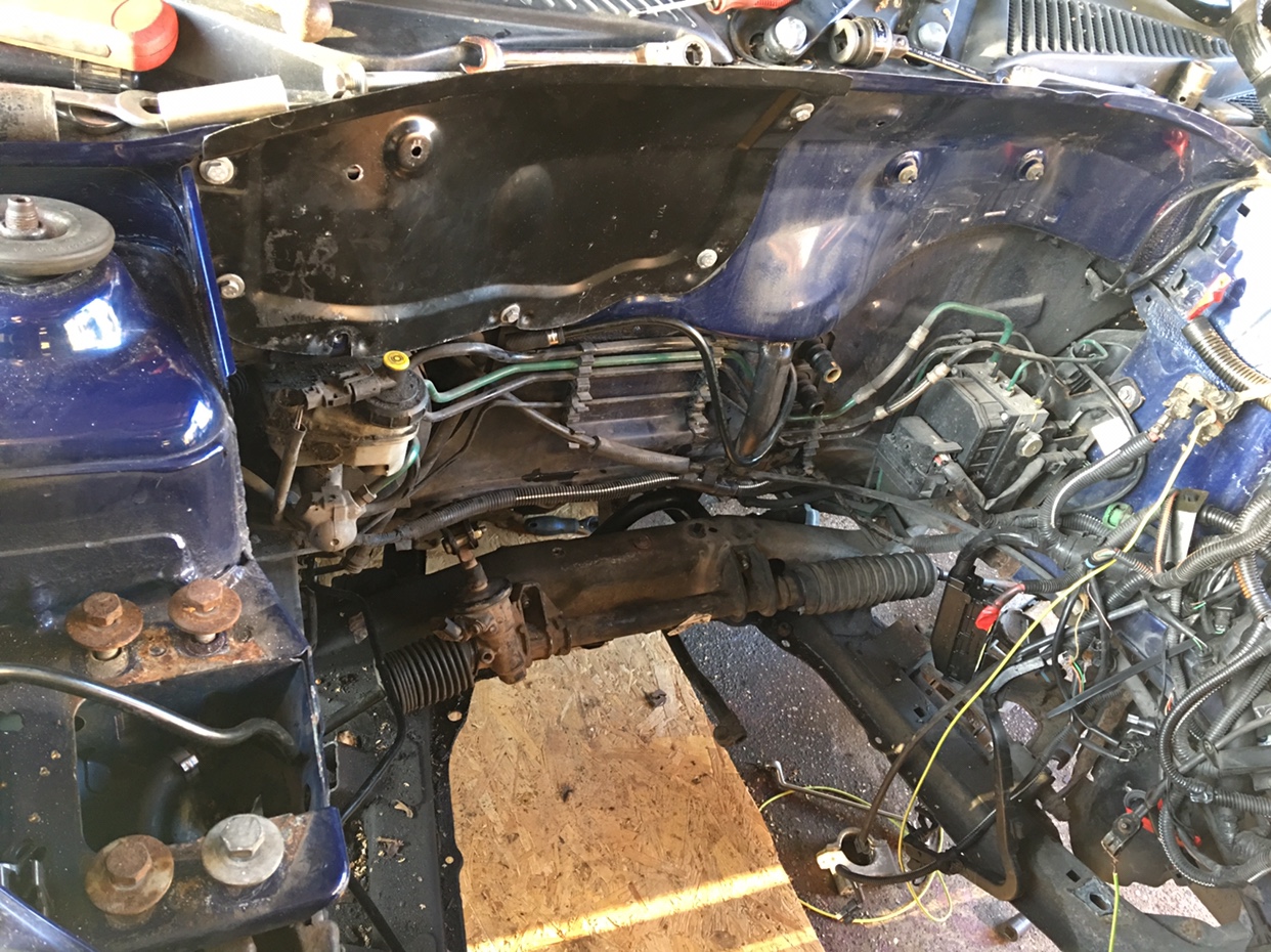

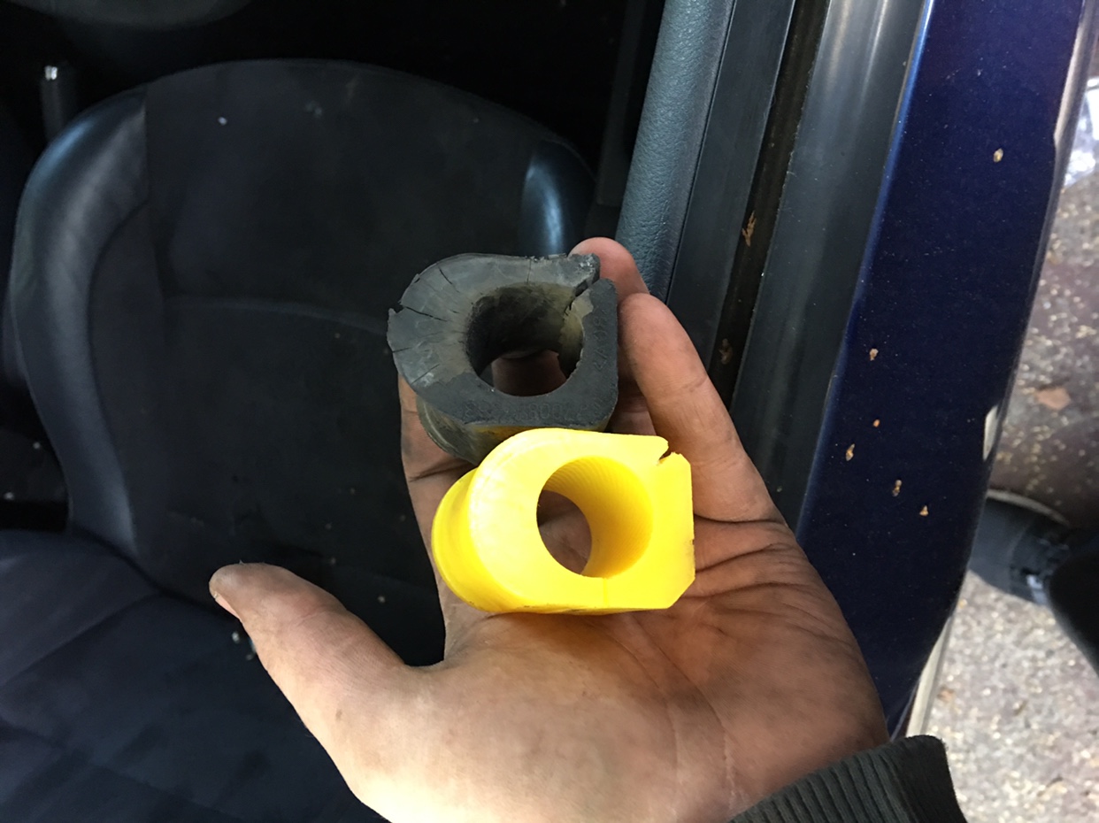

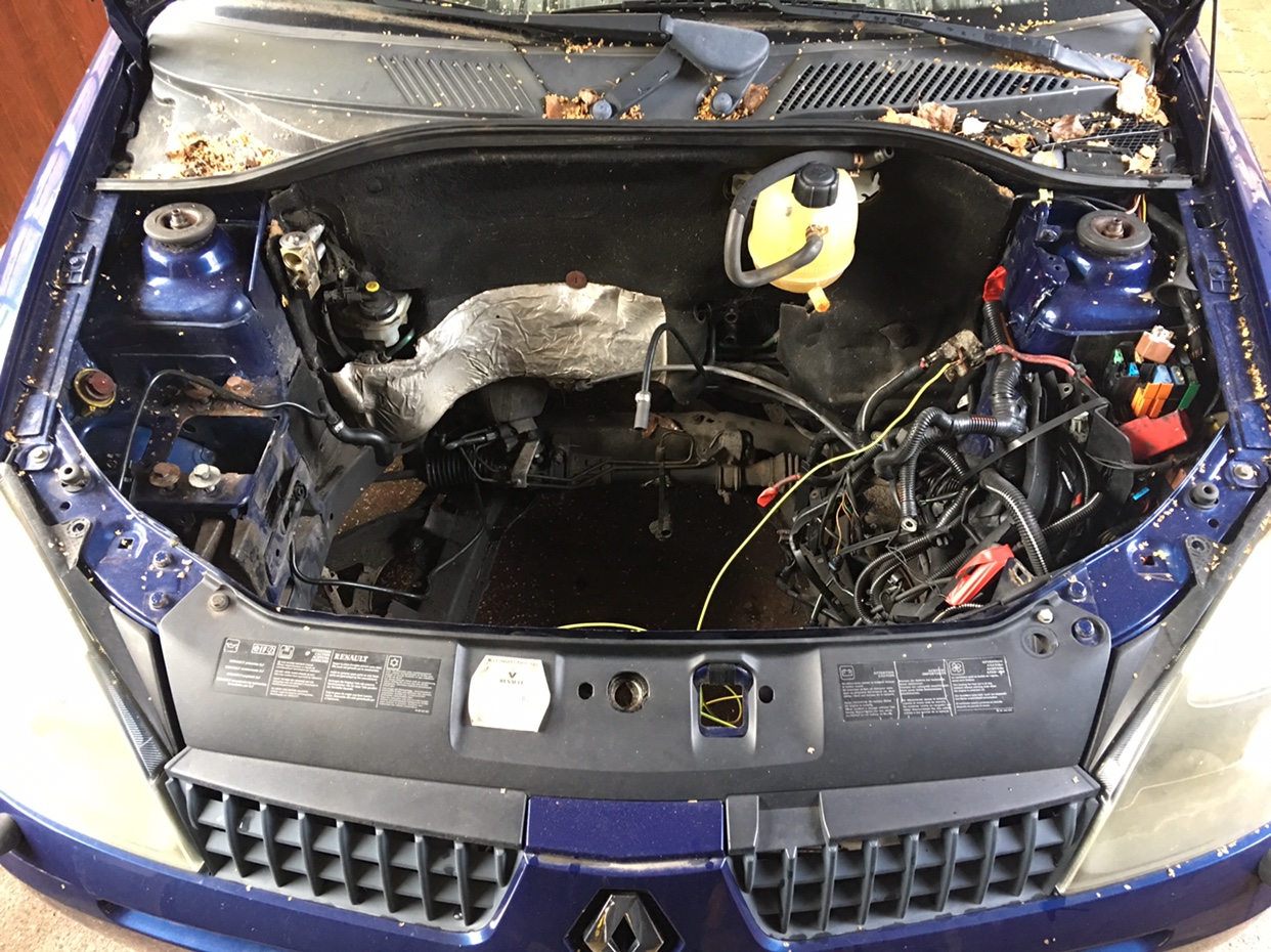

Only managed to get the old rack off, put the cup bulkhead panel on and put some polybush arb inner mounts on.
Before
After

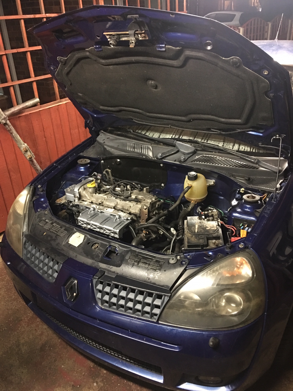

Tomorrow I’ll probably jetwash the bay down and clean all the s**t off. Dress up my engine with the inlets, HT leads, cup alt setup, maybe paint the block, stick the new clutch on and bolt up the gearbox ready for Monday. Gonna give myself 3 days off and hopefully on Monday or Tuesday I’ll have a car down on 4 wheels and that starts! Shock

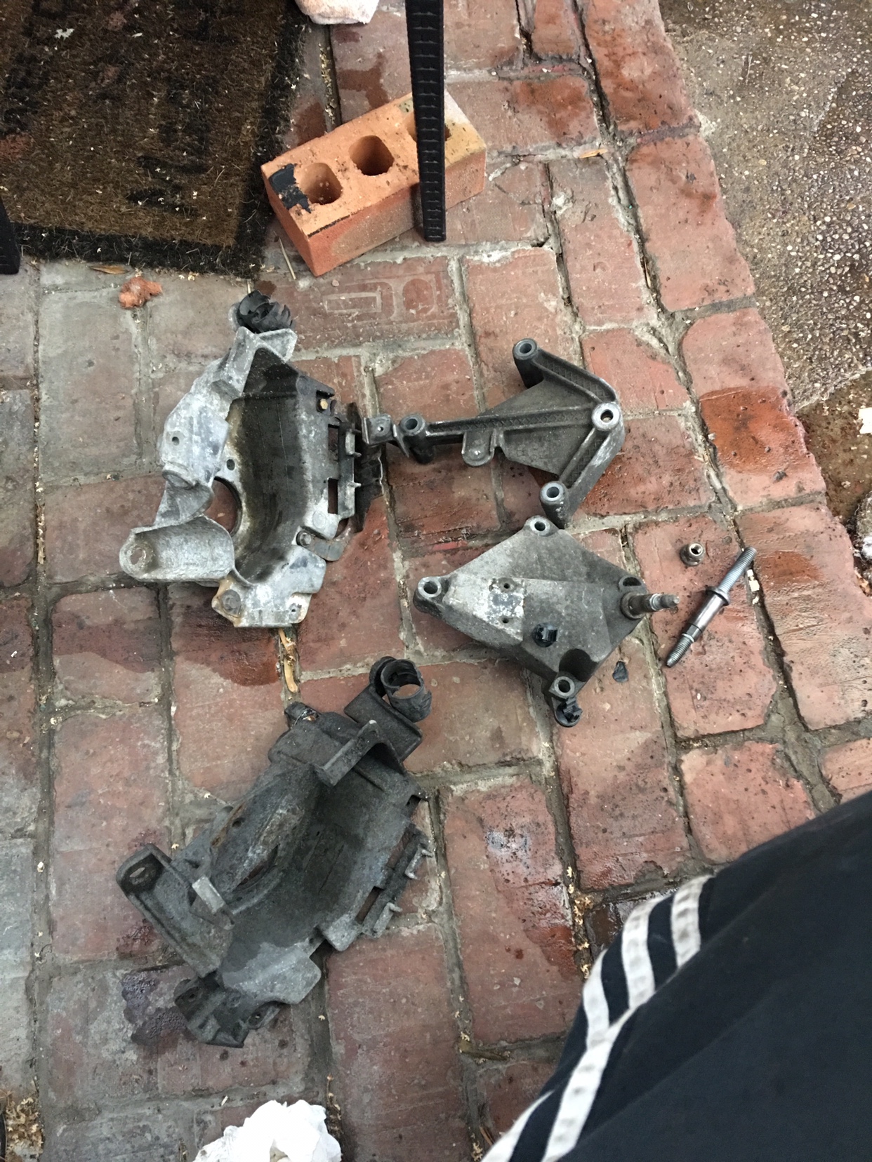

Put together the gearbox mount, what a faff, couldn’t for the life of me figure out how to do it[emoji23] Big thanks to @JamesBryan and @STEVE.M as I’d probably still be scratching my head if not[emoji23] I was also missing a small spacer from underneath so had to use a few washers to space it up
Decided to use the dCi spider mount as they’re a lot more robust and less prone to snap like the petrol ones

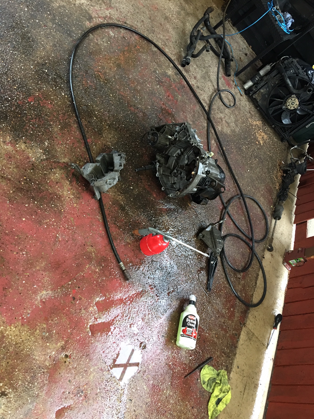

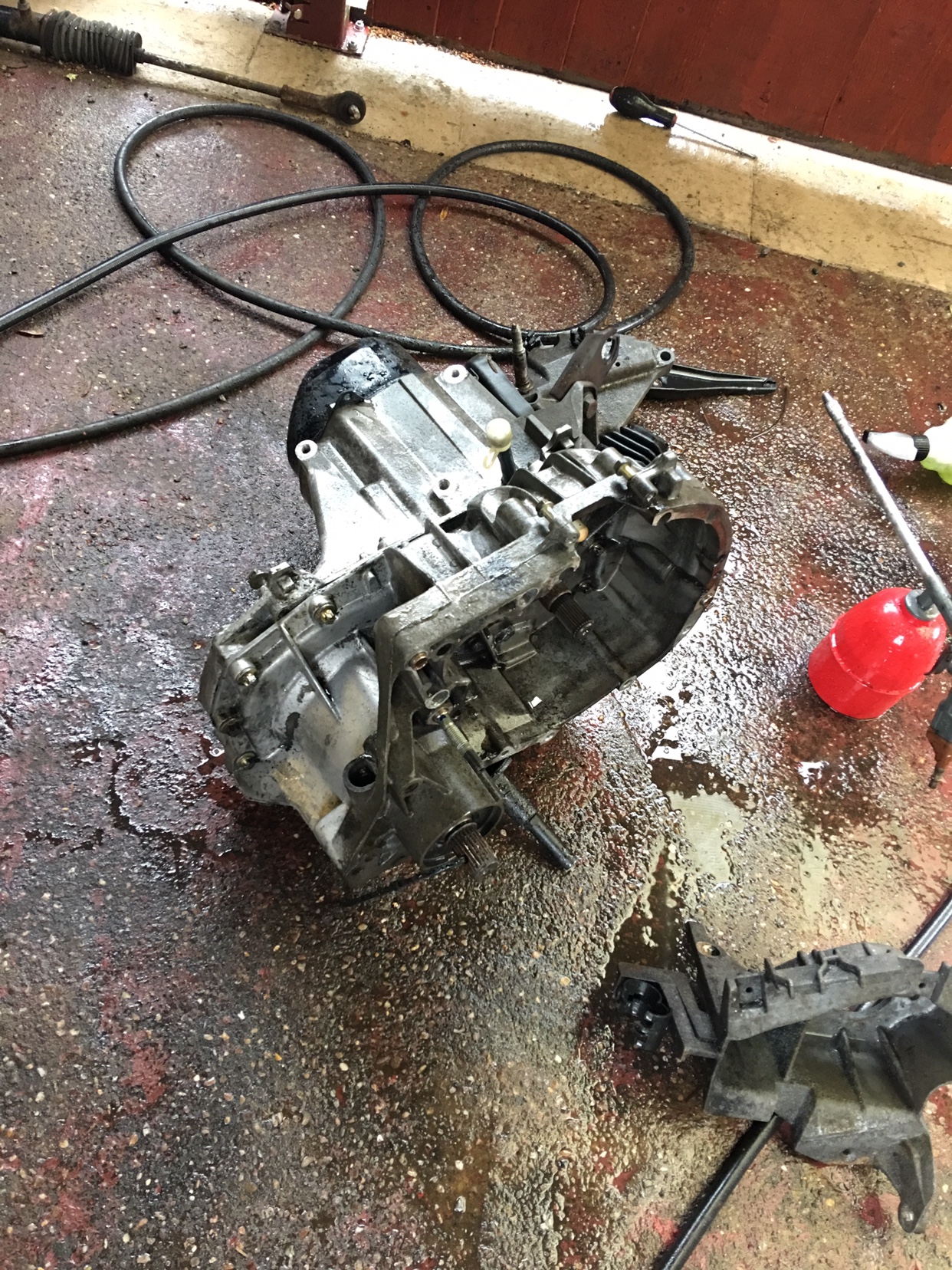

I washed the gearbox down just because it was covered in all sorts of s**t and it’d been sat in my bunker for 6 months[emoji23]
Came up alright for a 90p IKEA pot brush, washing up liquid and some V-Power in a can sprayer

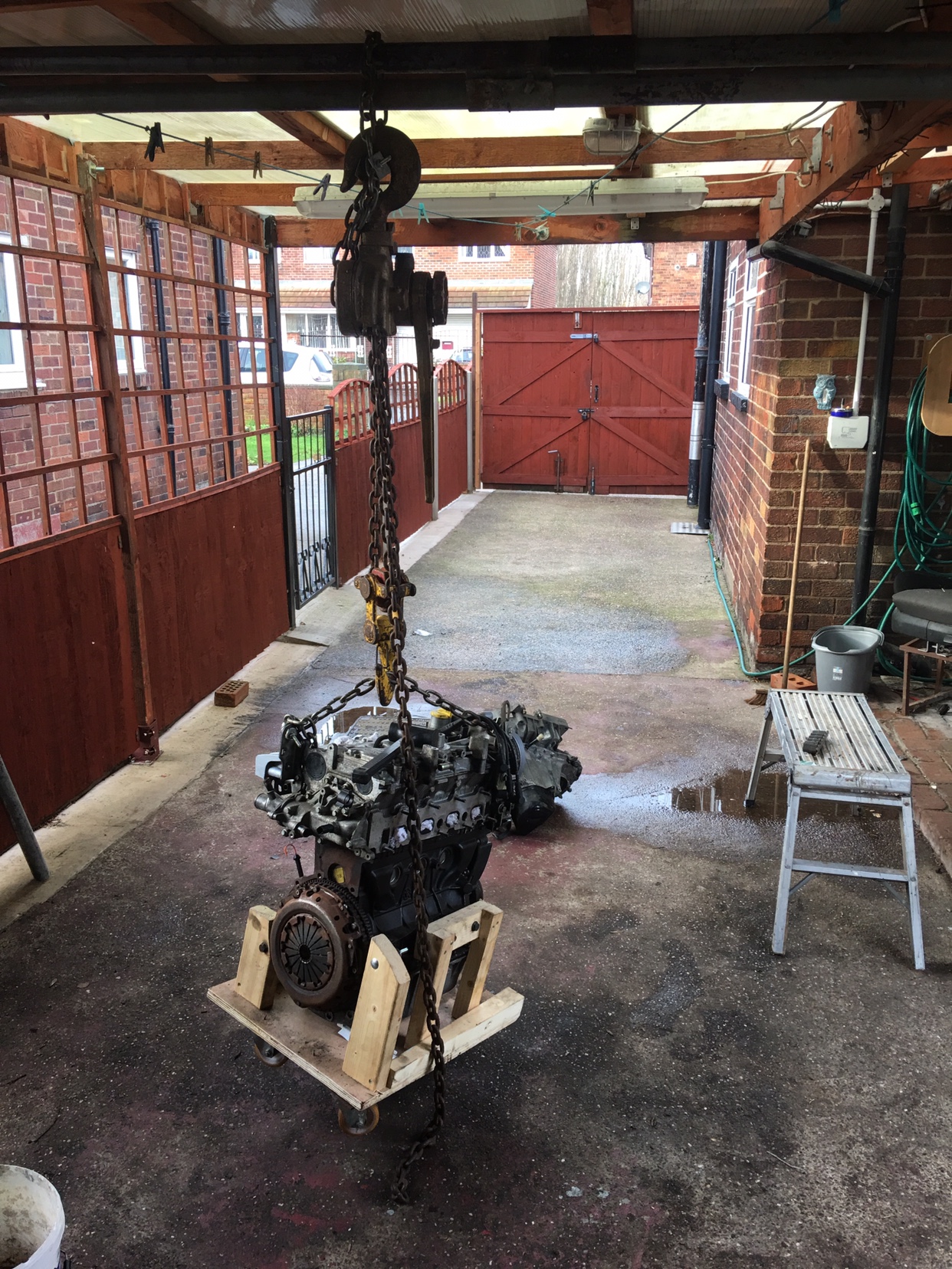

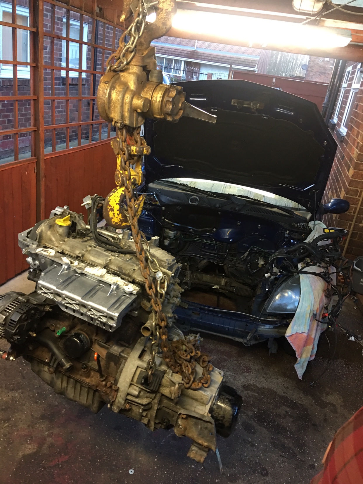

Then yesterday I got up mega early, drove to GSF to pick up a new release bearing and went to my mam and dads to get started. I set up my scaffold first which is a pain in the arse doing it alone. Then I test fit my cup alternator setup, didn’t realise I had to use the 75A cup alternator with the threaded bar instead of the standard 172 item, it should be able to cope with EPAS anyway.

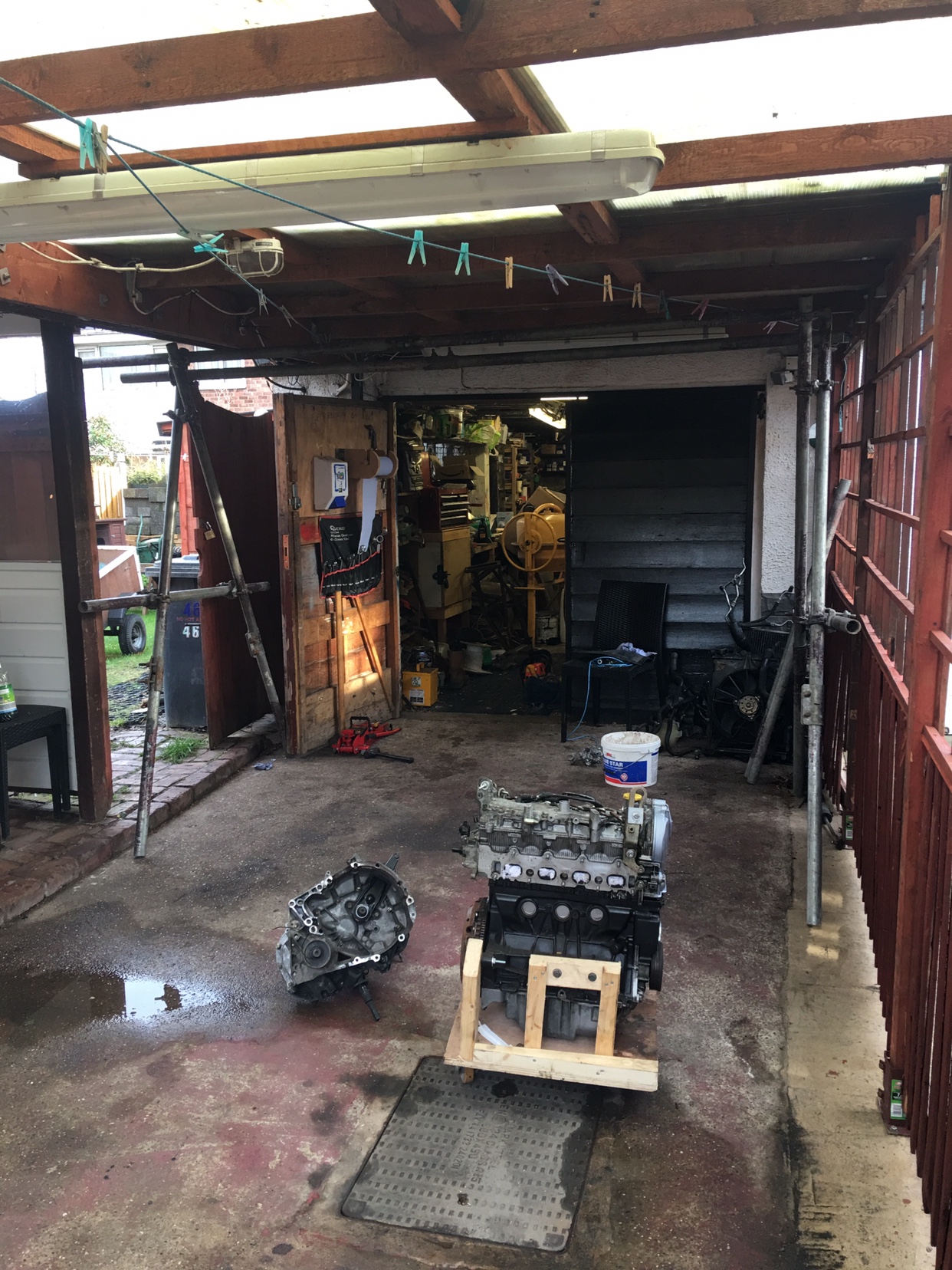

I’m not posh enough for an engine crane and plus this scaffold will easily lift a car without folding. Tried and tested! My lifting gear is more than capable too, never had an issue lifting anything but by god is it f**king heavy! I reckon that scaffold setup weights around half a tonne[emoji1750]‍[emoji3603][emoji23]
Engine then met gearbox, I hope they don’t try and kill each other
I found all the bolts for everything and even the dowel that decided to back itself out of the block. Me and my dad then set out to put it in the car
And the day came, it went in! Been a long time coming

My initial plan was to just build it into a track car straight away but I miss it being on the road. So now my plan is getting it up and running, MOT and tax I and then I can just crack on with smaller jobs like braided lines, wishbone bushes, outer arb bushes, fitting my rebuilt rear beam and a metric f**k-tonne of other stuff to go with it
It actually looks sort of like a car now, the old overflow bottle is going, I need to pick one up from GSF today before anyone asks[emoji23]

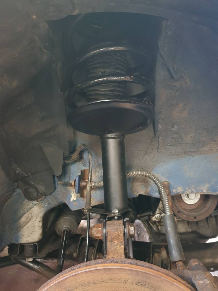

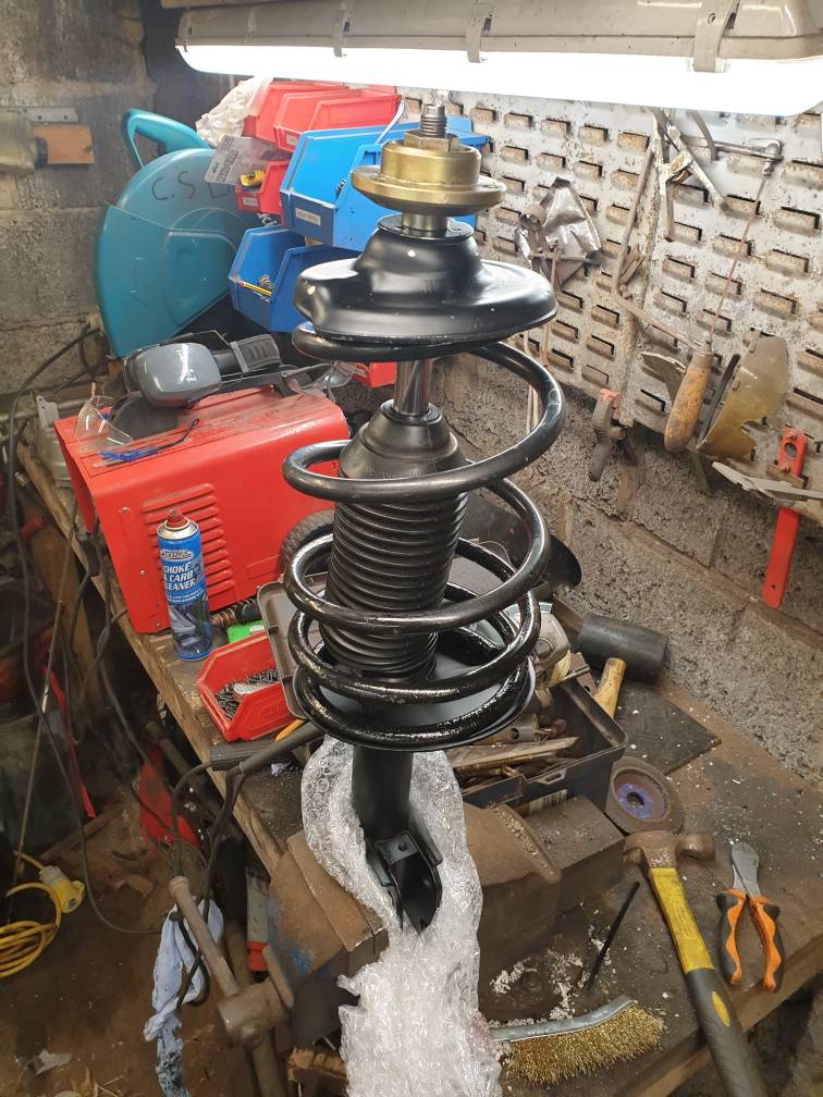

So today I just decided to stick my new cup shocks, solid top mounts and cook sports on

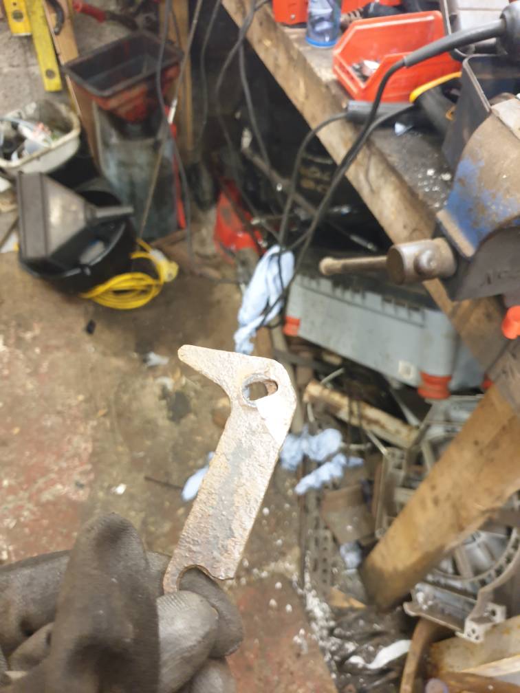

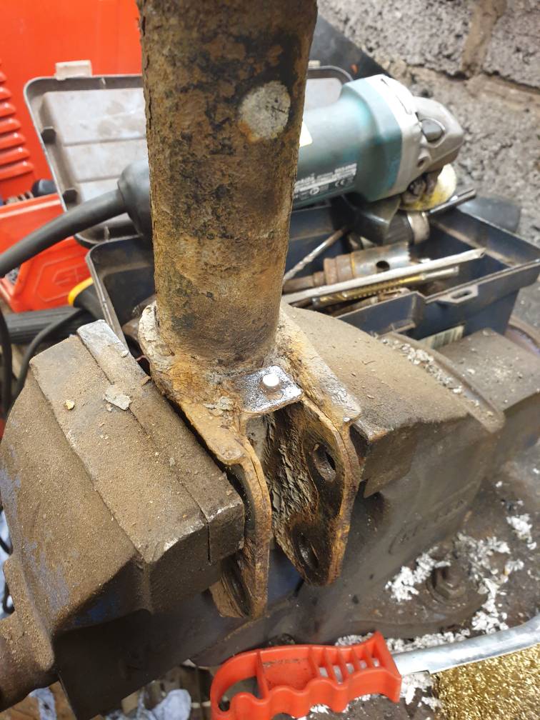

Straight away the old shock gave me issues so I tackled it the best way I know... take the grinder to the fucker

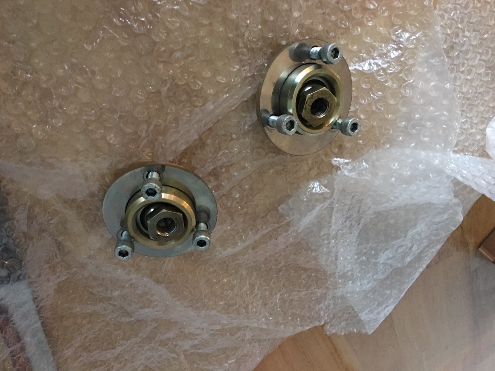

Then I started building up the new cup shocks, cooksports, new top hats and PMS solid top mounts. @OssPoop the cooksports are actually being used after buying them like a year ago[emoji23]
Instead of using the s**t Renault bump stops and dust boots I used some spare Polo 6R ones I had from when my sister put coilovers on her car. They're 10x better and wont split in half after 20 seconds. I cleaned them out and put a slit in then then cable tied them tight around the shock.
Fully built up shock minus the ABS line bracket which I took off and sprayed with some satin black

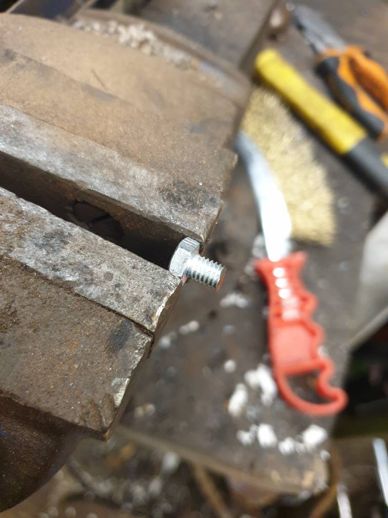

Then I cut down some new bolts instead of using the w**k torx ones
Under the car when fitted up

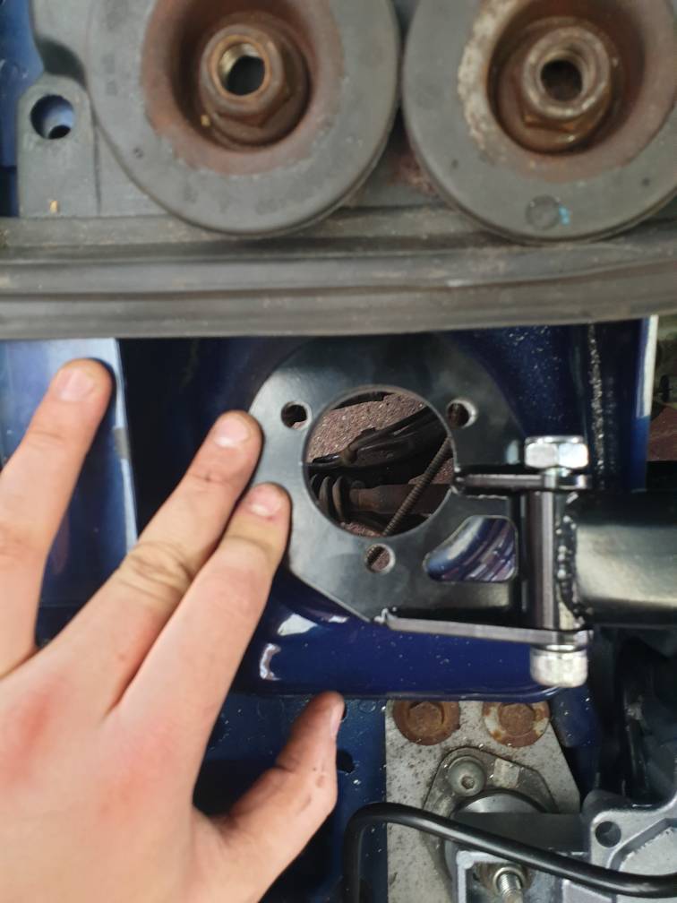

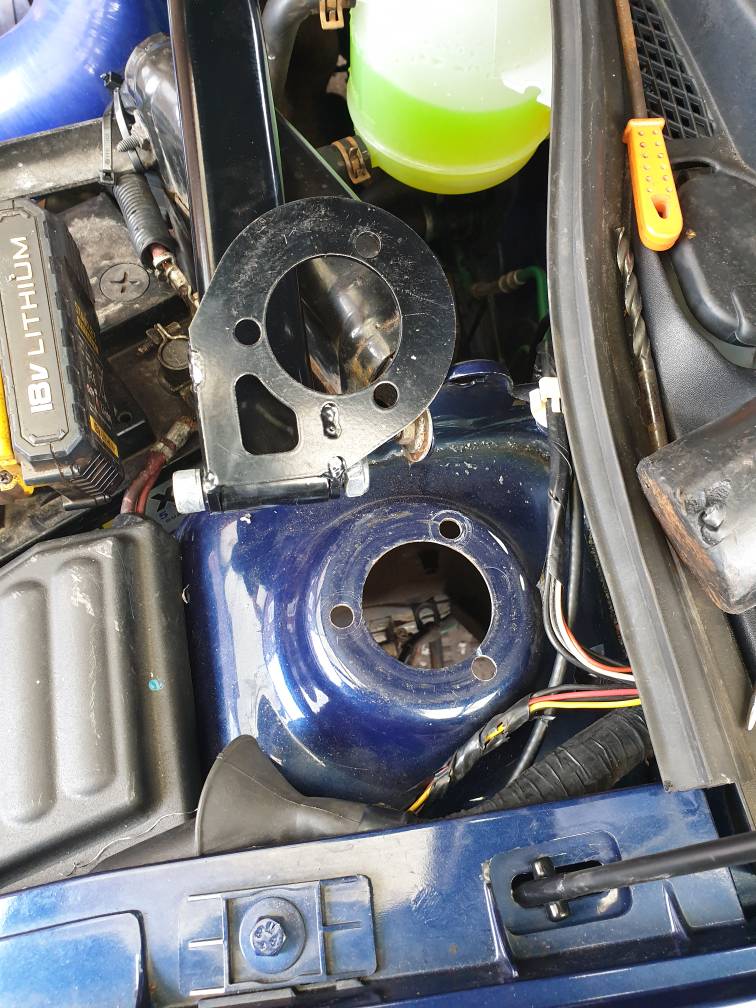

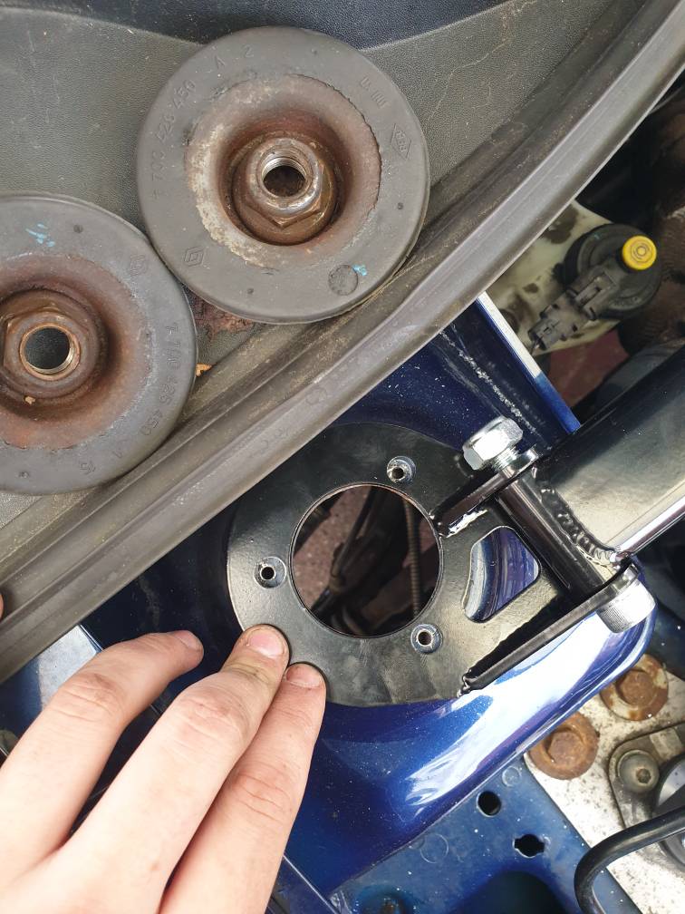

Drilling out the holes in the tuttets for the PMS solid top mounts was nervy, marked it out about 3 times before drilling a pilot hole, then I checked it twice again and then drilled it out to 8mm
Then I drilled out the other side

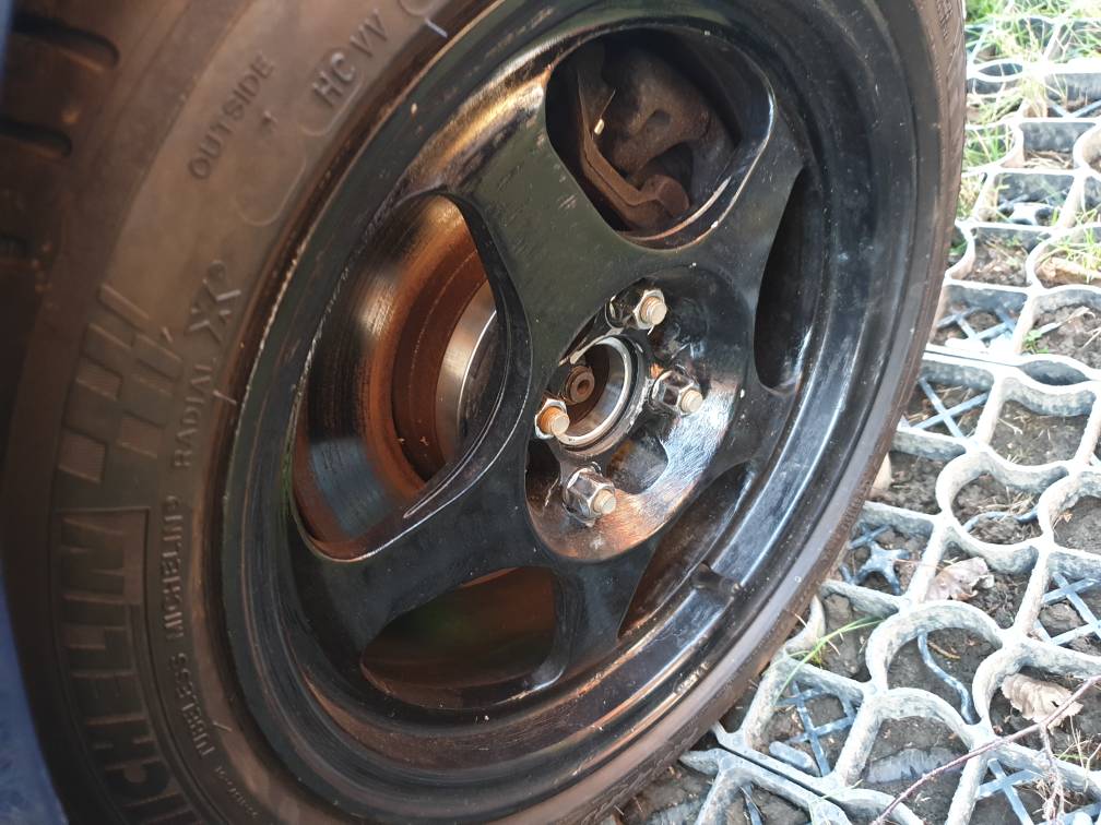

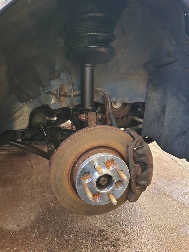

Decided to stick in my wheel studs and PMS spacers that I picked up for £12 just while I had the wheels off
