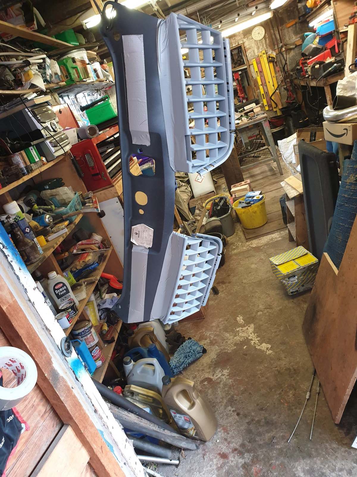

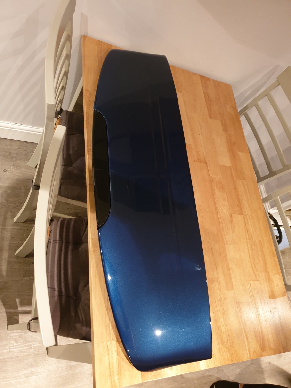

I sold my unpainted trophy rep spoiler and got one that's already put together and painted in Monaco?
I'll probably fit it when it's got MOT because I dont want it sat about in my dads garden under a tree with it on and my 3rd brake light works so I cba messing yet?‍♂️?

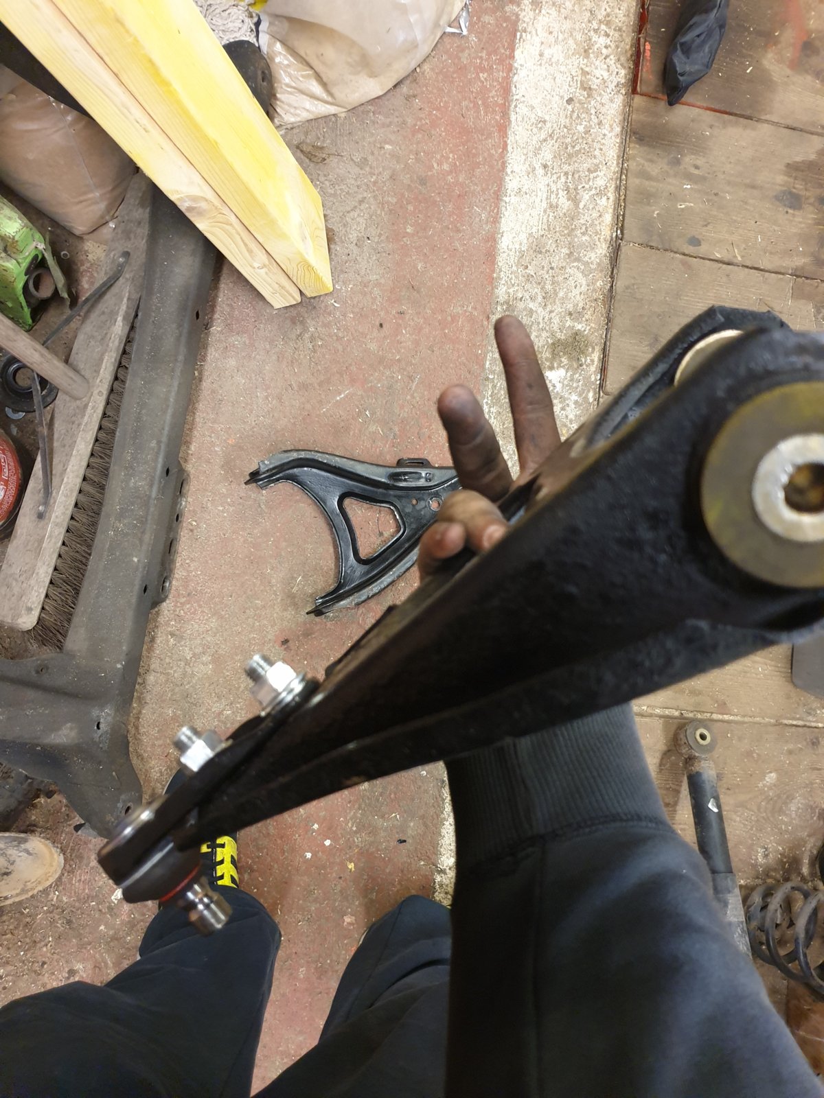

I replaced the wishbone on the passenger side 2 weeks ago for Strongflex yellow 90sHa ones... well, I only did one side bevause the other side is going to be a c**t to get off as the inner part of the wishbone Bush has seized to the bolt.
I bought some dirt cheap Powerflex black bushed arms for the time being, as I dont know which f**king way the bushes need to be on the Strongflex ones?
As you can see I was really pleased when doing the strongflex ones, I couldn't swear properly because I'd twatted my fingers when pressing out thebold bushes

And then I was in an even worse mood when I did this
1411490

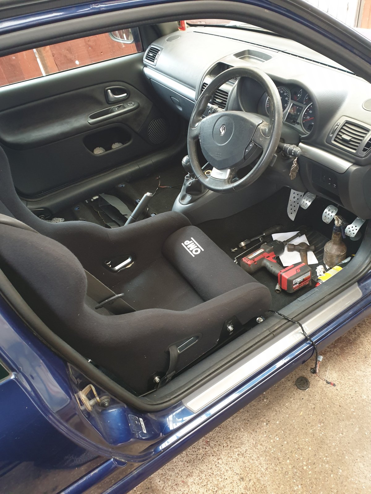

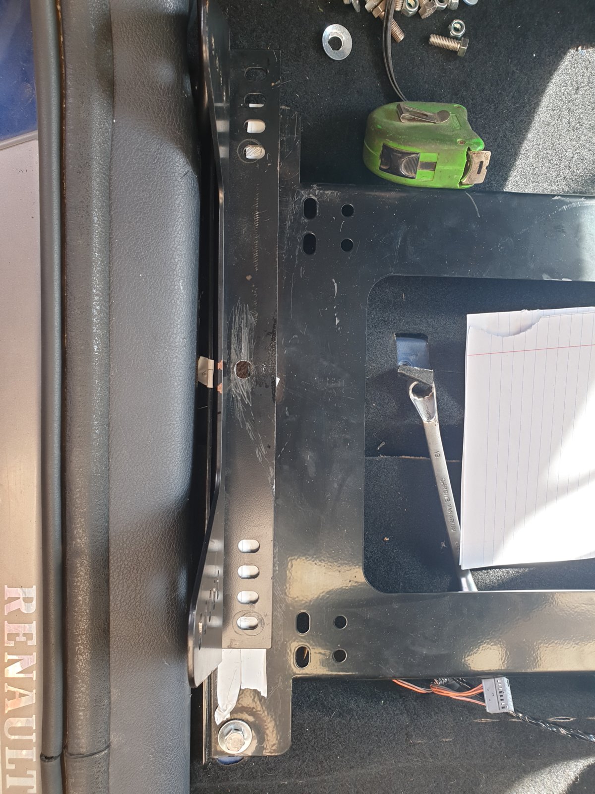

Started mocking up my buckets. I found a few bits wrong/annoying
Firstly, because in a fat c**t I have to get XL seats. Because they're XL they dont line up with any holes on the subframes??
1413134

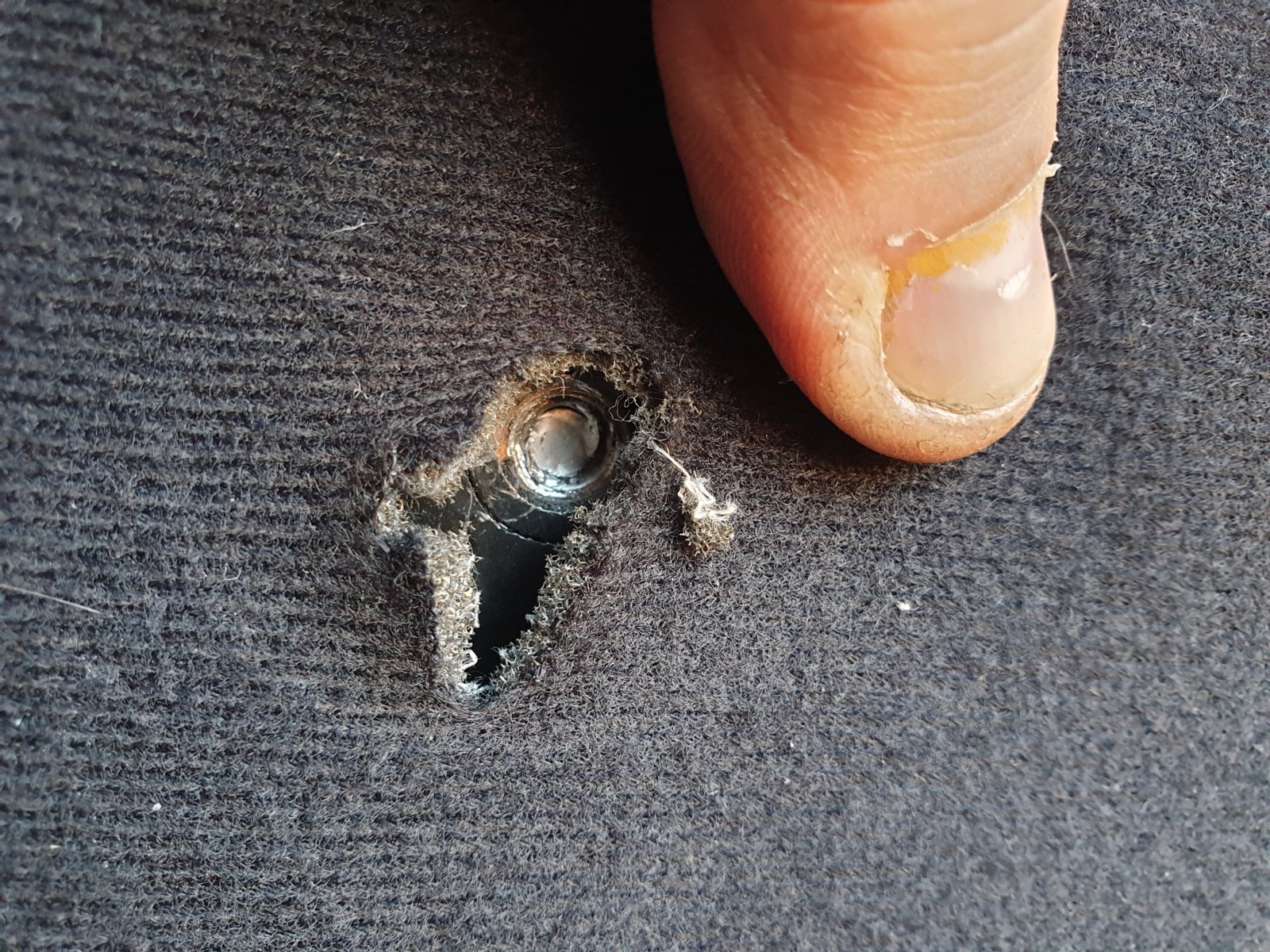

Secondly, the previous owner of the seats failed to mention the part where he snapped off one of the mounting bolts in the seat. So yeah, cheers
1413135
And annoyingly it's the one I wanted to use as the drivers seat as it's still in FIA date until 2022 and the other one runs out this year and has a heat gun burn mark on it
Never the less I needed to get one in there to love the car about for the time being. It's a tight squeeze when I placed the seat sort of where I wanted it
1413136

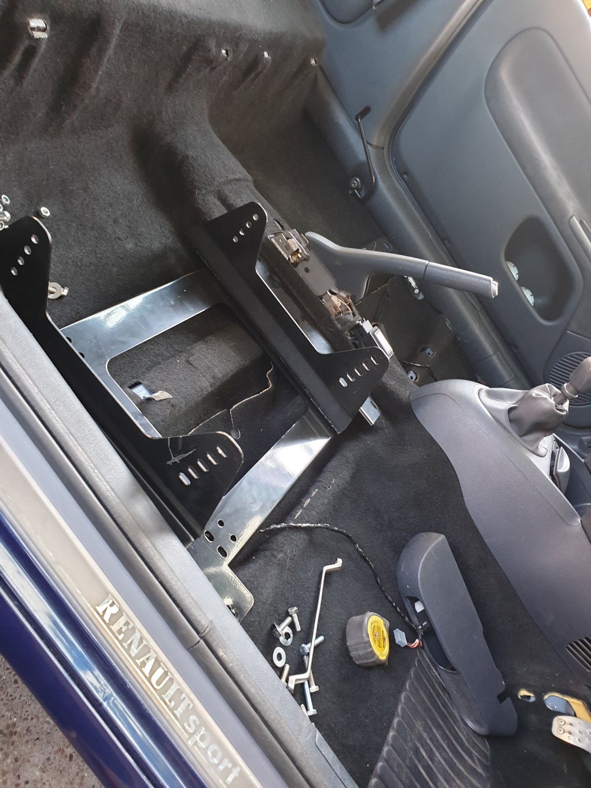

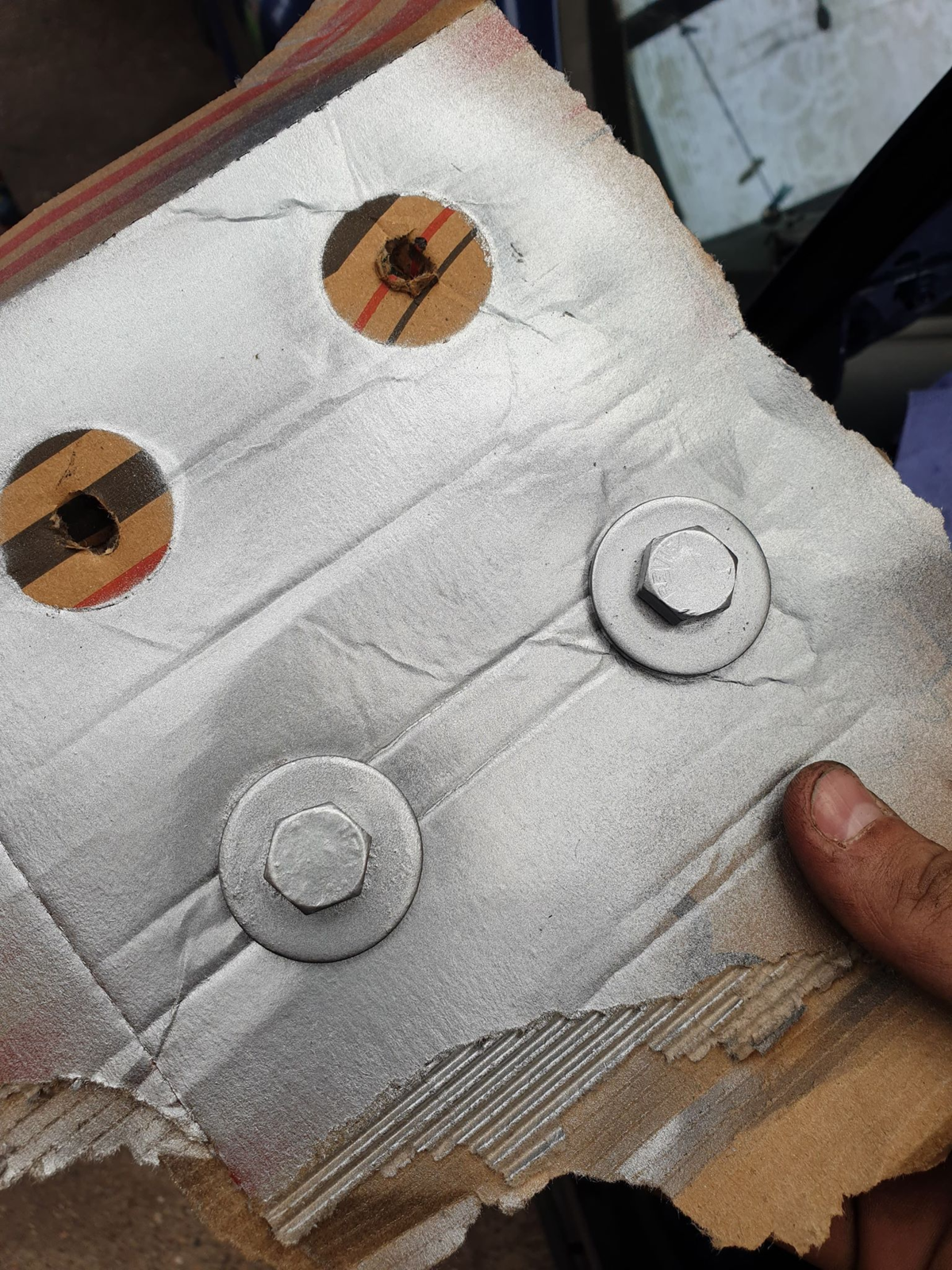

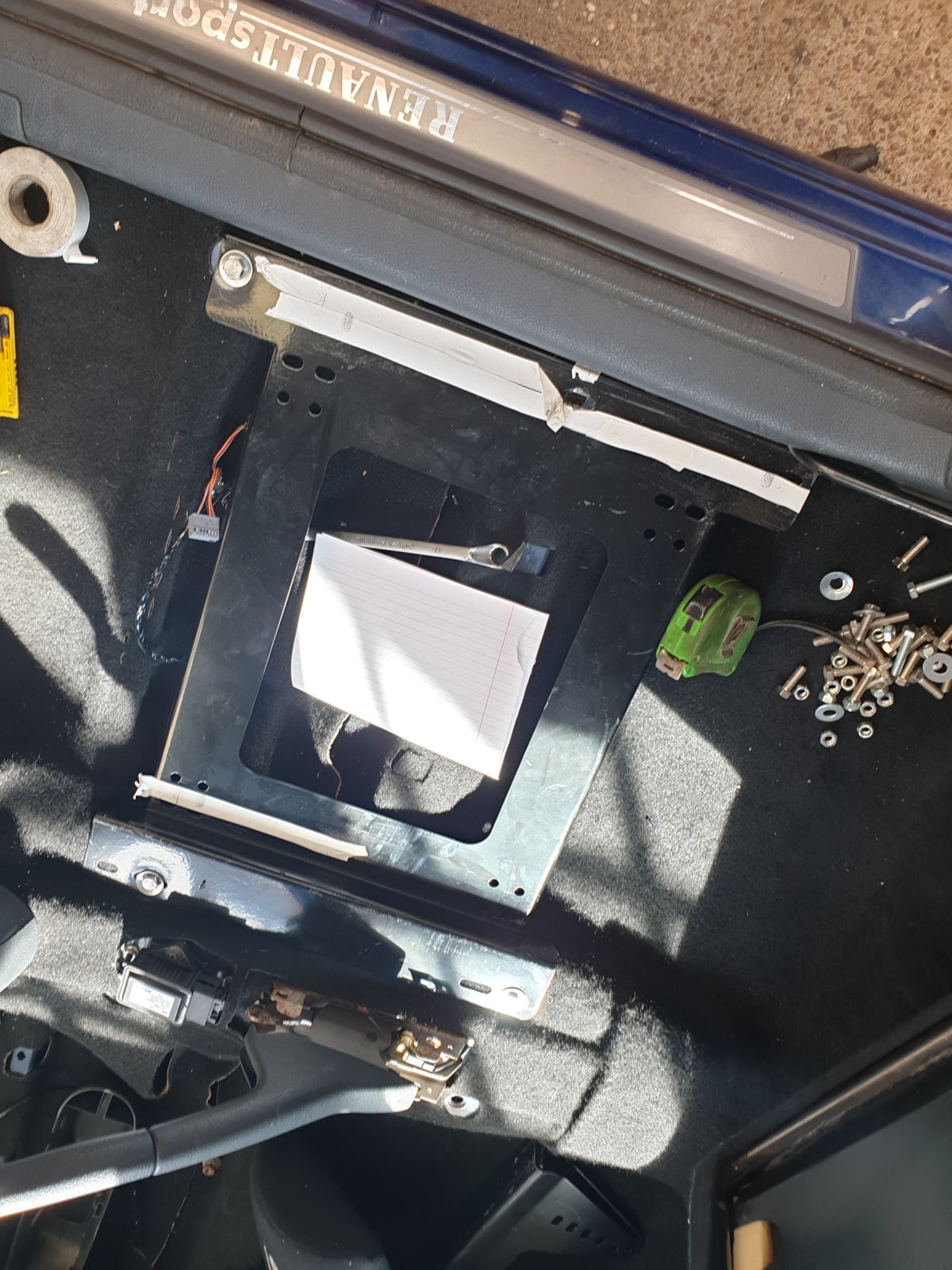

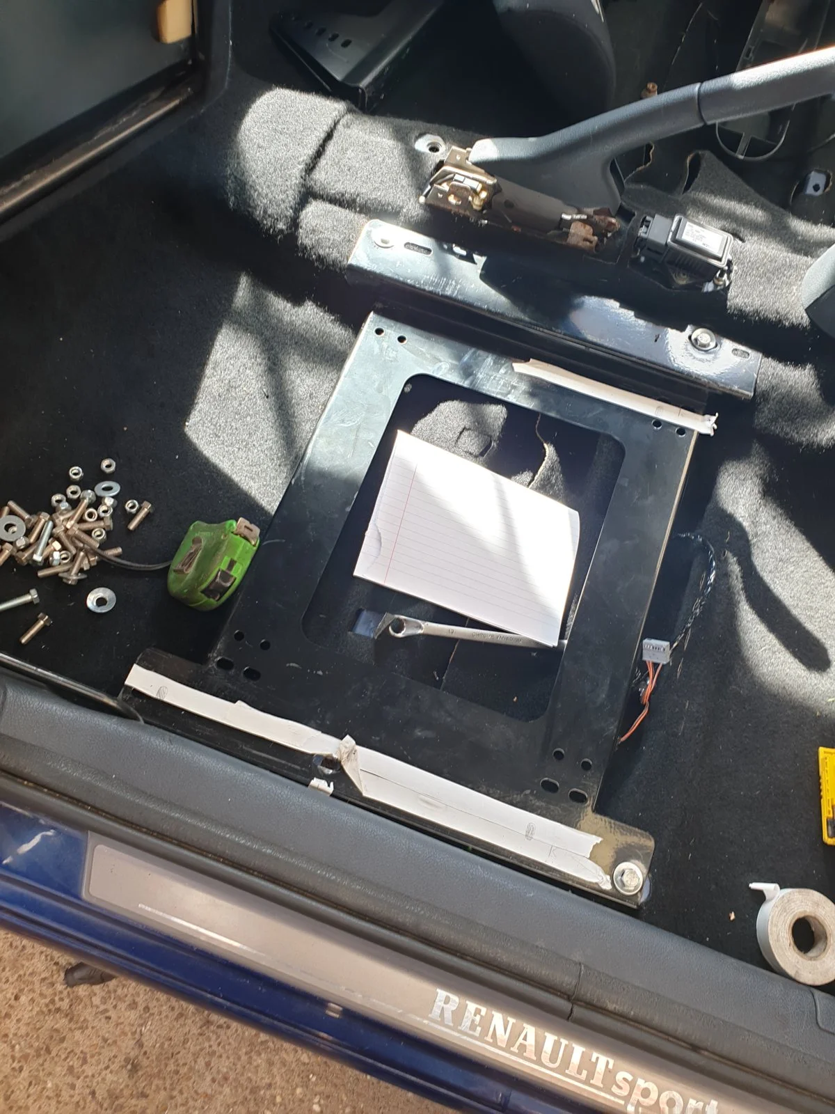

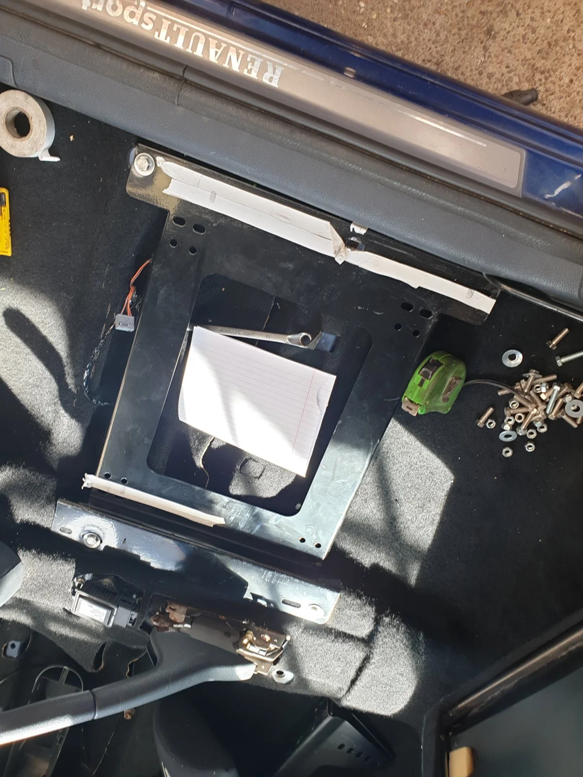

Started out by laying some tape and marking out a few places where I need to mount the side mounts to the subframes
1413138
Measured 3 times and then pressed on by drilling holes all over the shop?
This hole goes through the sidemount, subframe and then uses the existing but underneath as the bolt would make the subframe rock if not.
1413139

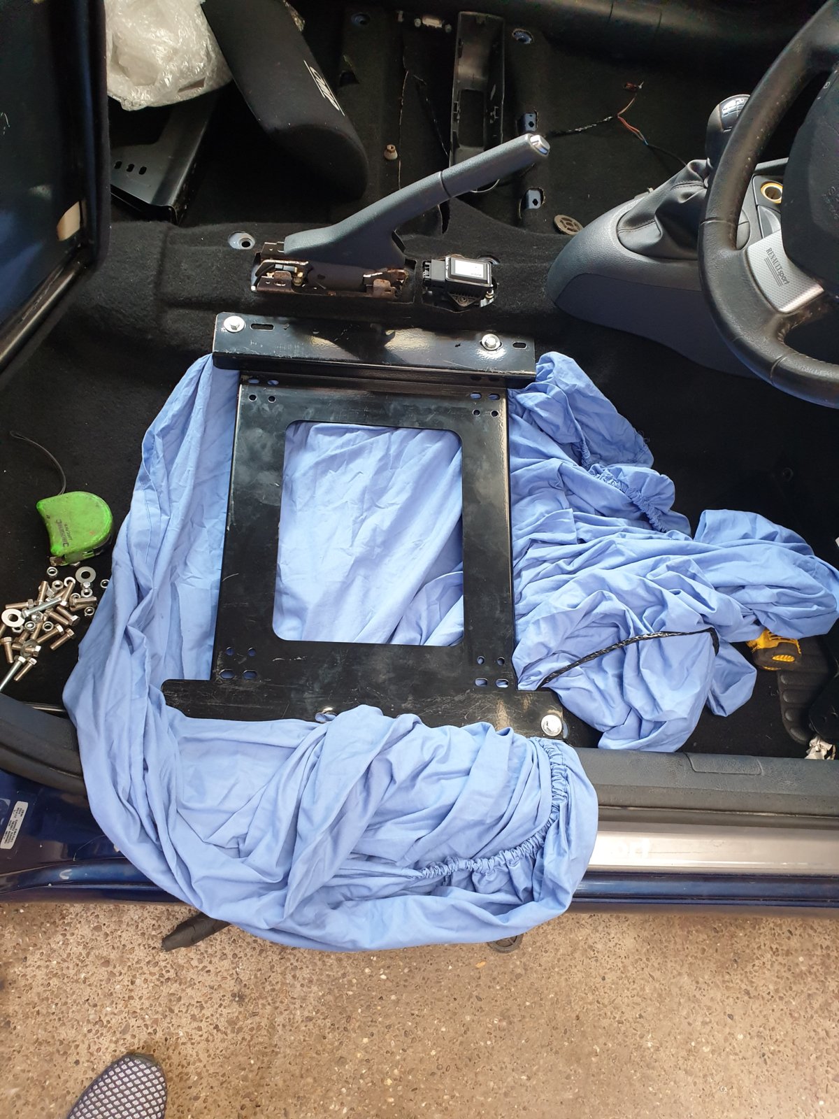

I'd just hovered it and I couldn't be fucked to remove the subframe again so out came an old sheet?
1413140

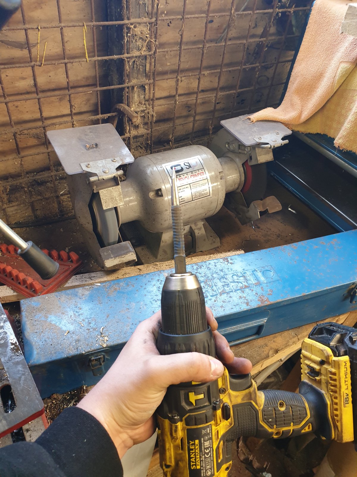

Then my punch started enjoying me so I stuck it in the drill and sharpened it on the grinding wheel. Now I dont have to worry about it sliding all over when I'm trying to stamp a point!
1413141

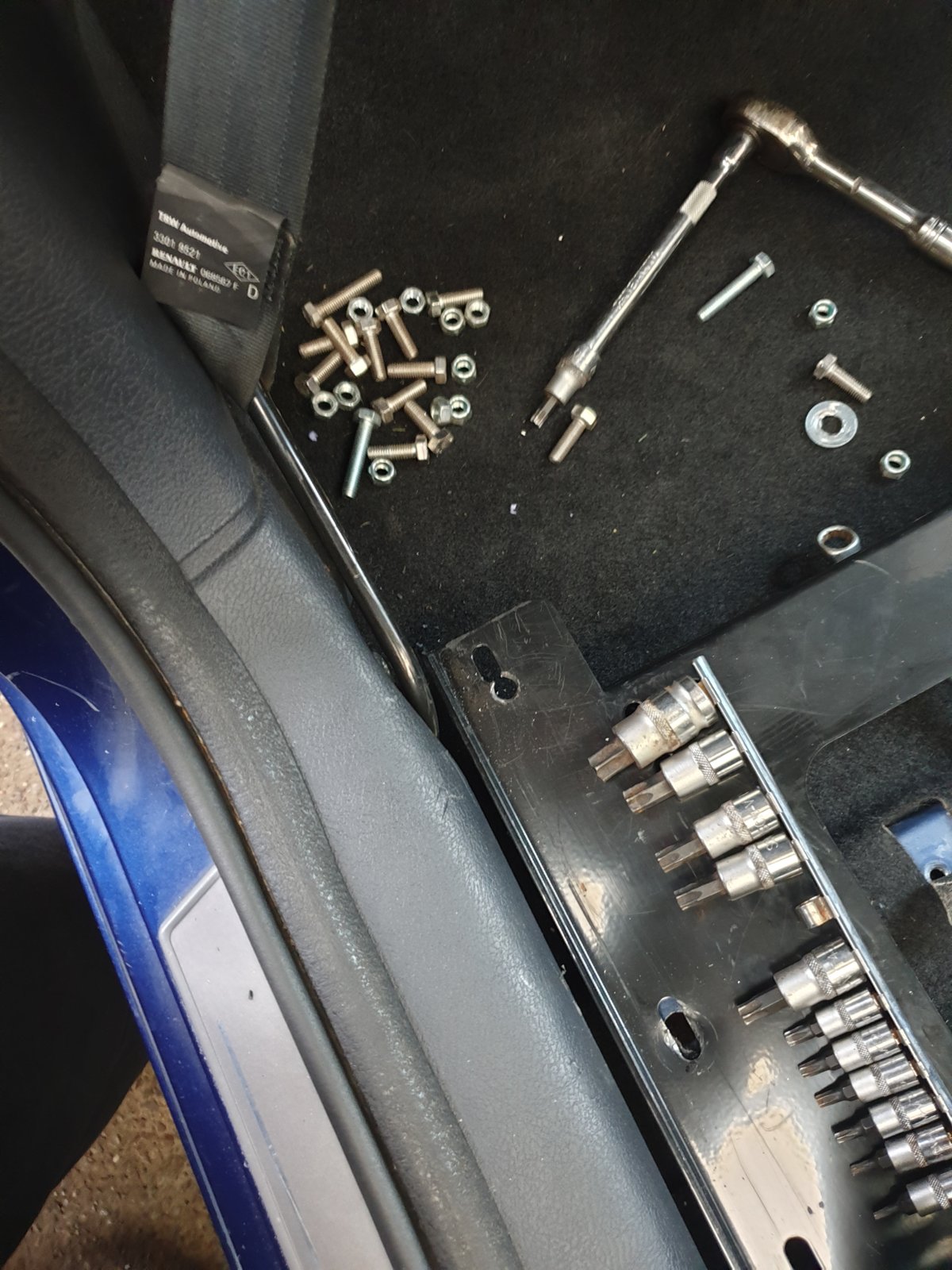

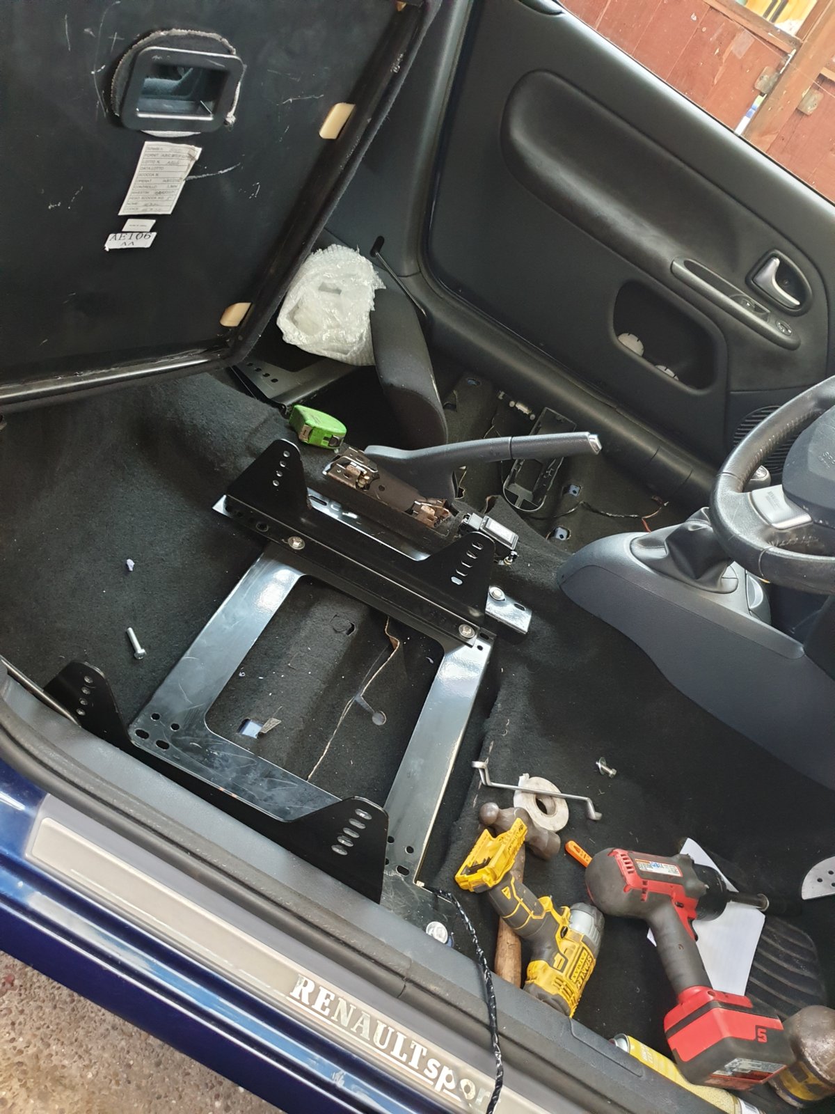

Got all my holes drilled and the sidemounts in place... I messed up at this point too. I spent 10 minutes bolting everything down like this...
1413142
Then forgot that I'd not stuck the seatbelt in!?☹ doh
1413143

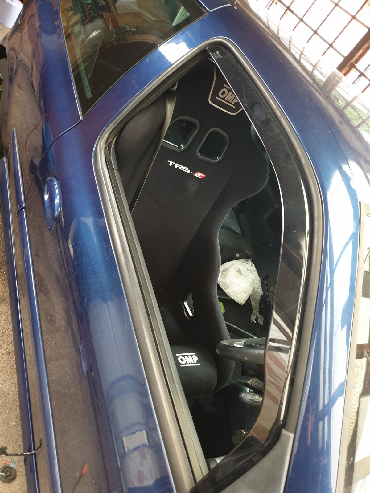

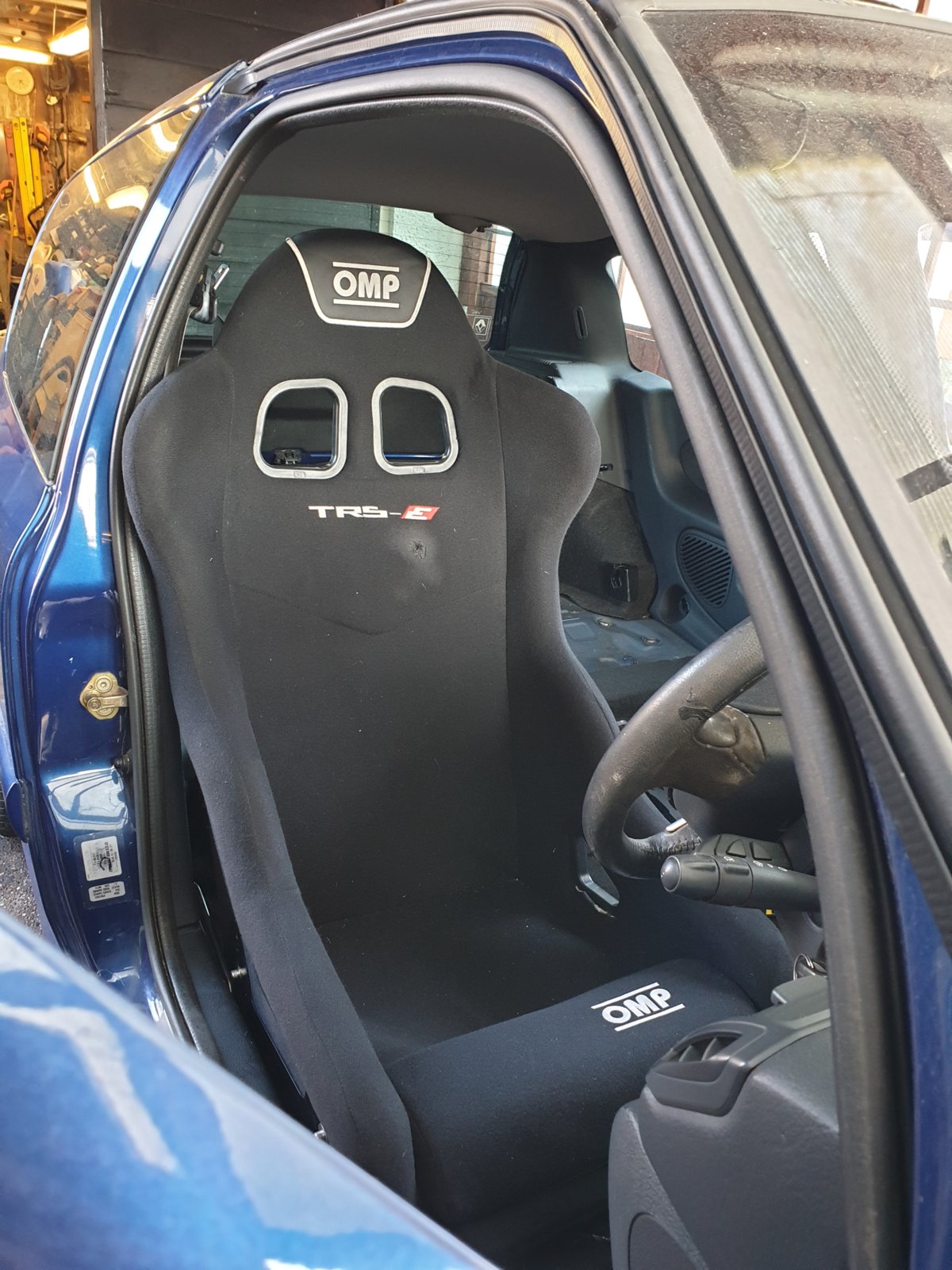

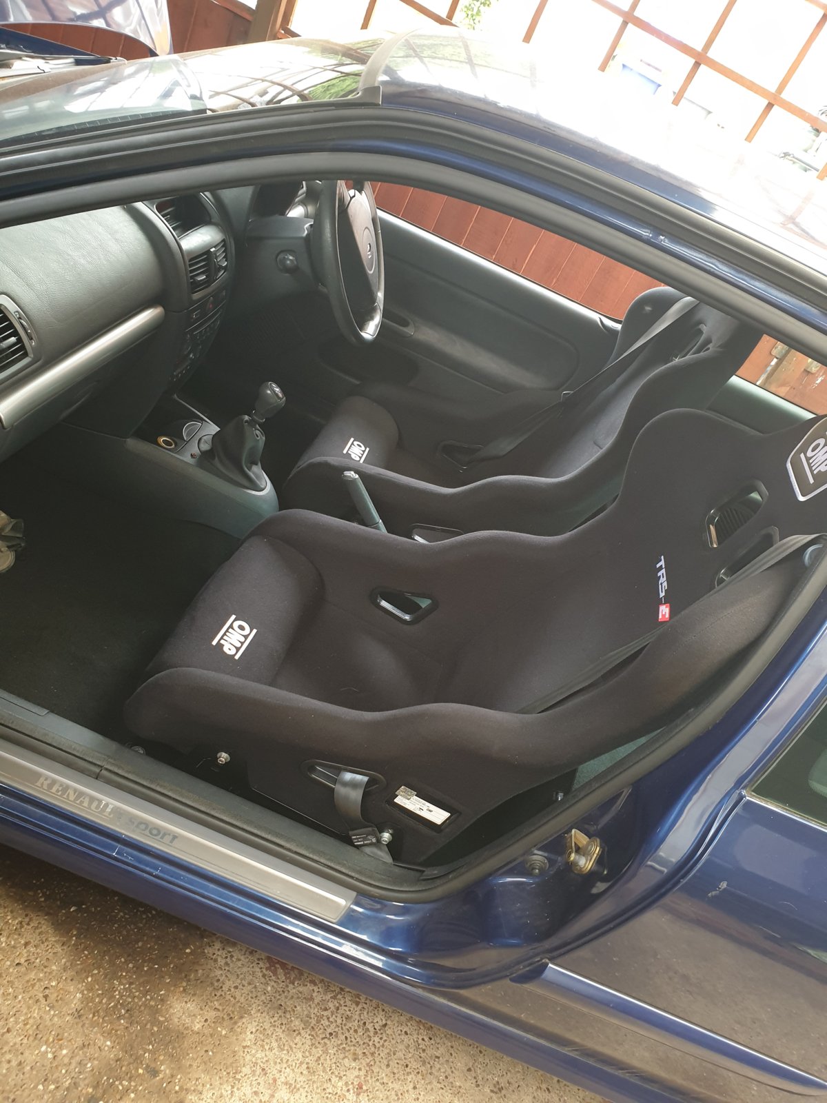

After all that I got the seat in and I'd raised it and brought it a little more forward than I first anticipated but it feels better for it...
Pics of the finished article!

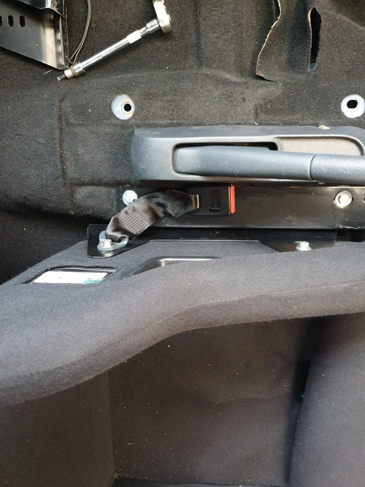

1413144
The door does shut and it doesn't come into contact with anything either!
1413145

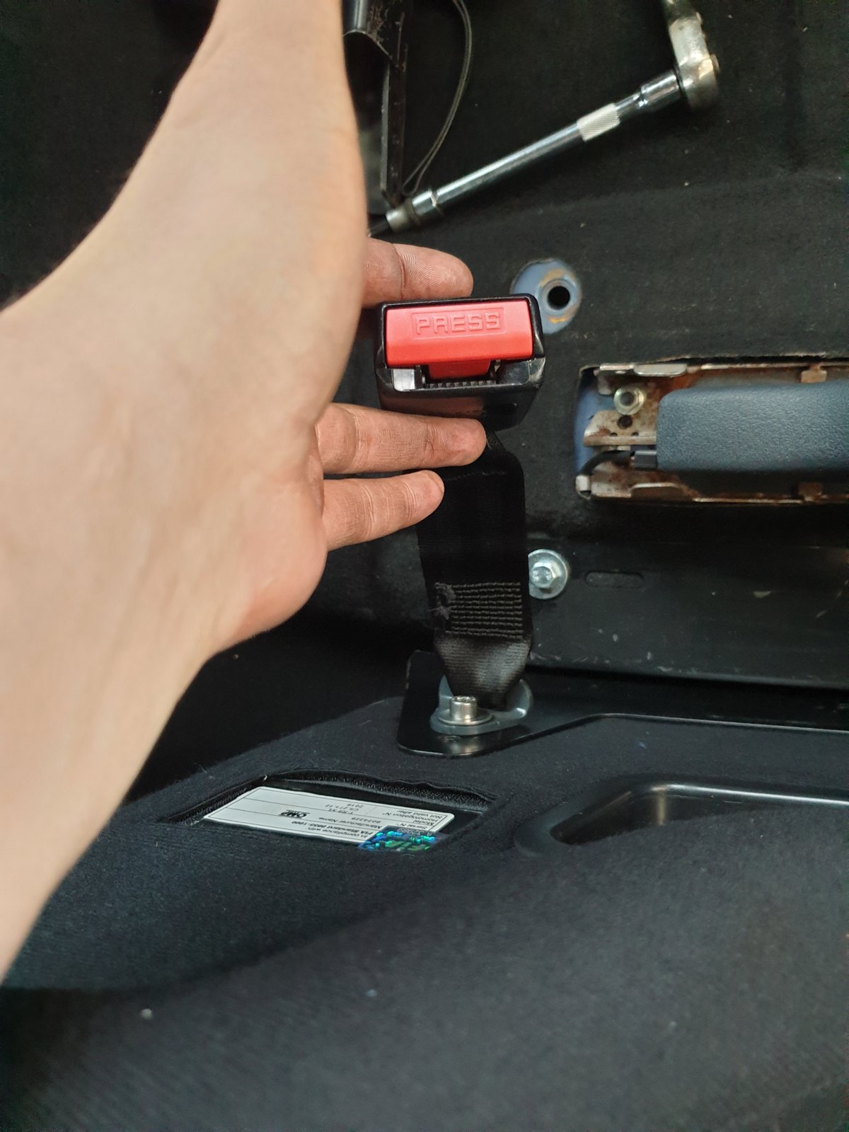

Pug 206 seatbelt, I may bolt it to the floor though!
1413146
1413147
I'll get some more pics when I get the other seat in and carpet the rear floor out next week.

Looks like my subframe! Ive been drilling holes non stop since I got it, I settled on using spacers to raise it up so it was flush with the lip, then drilled lower holes in the side mount to bring it back down, did this so I could put it left more central with the wheel. What a hassle though..
Nah I seem quite comfy in it tbh. The ledge on the door card is sort of in the way but driving at 9 and 3 its sound? Its my own fault for being a whopper lmao
Fair enough! I made a door card as the ledge was too close for me, I would sometimes go to reverse and lock my arm between the wheel and the card and proper bend my wrist back it was not nice lol

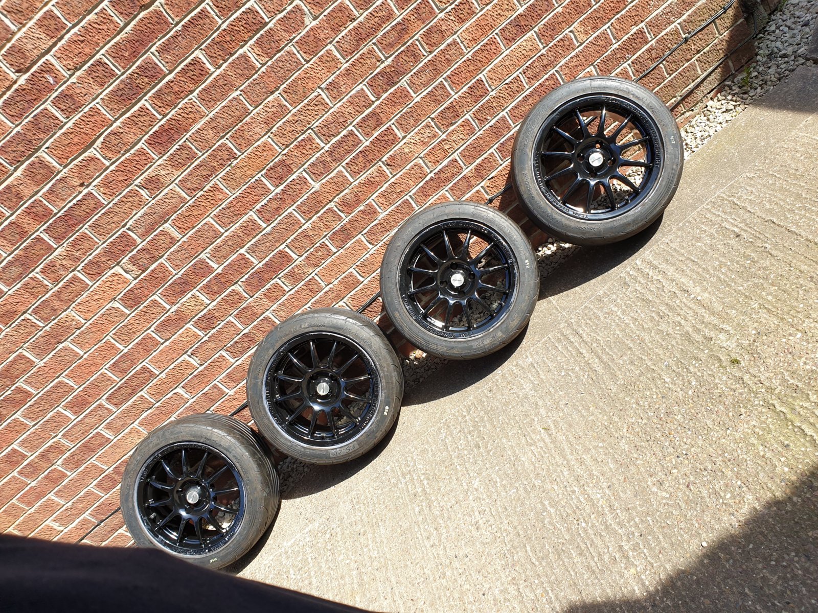

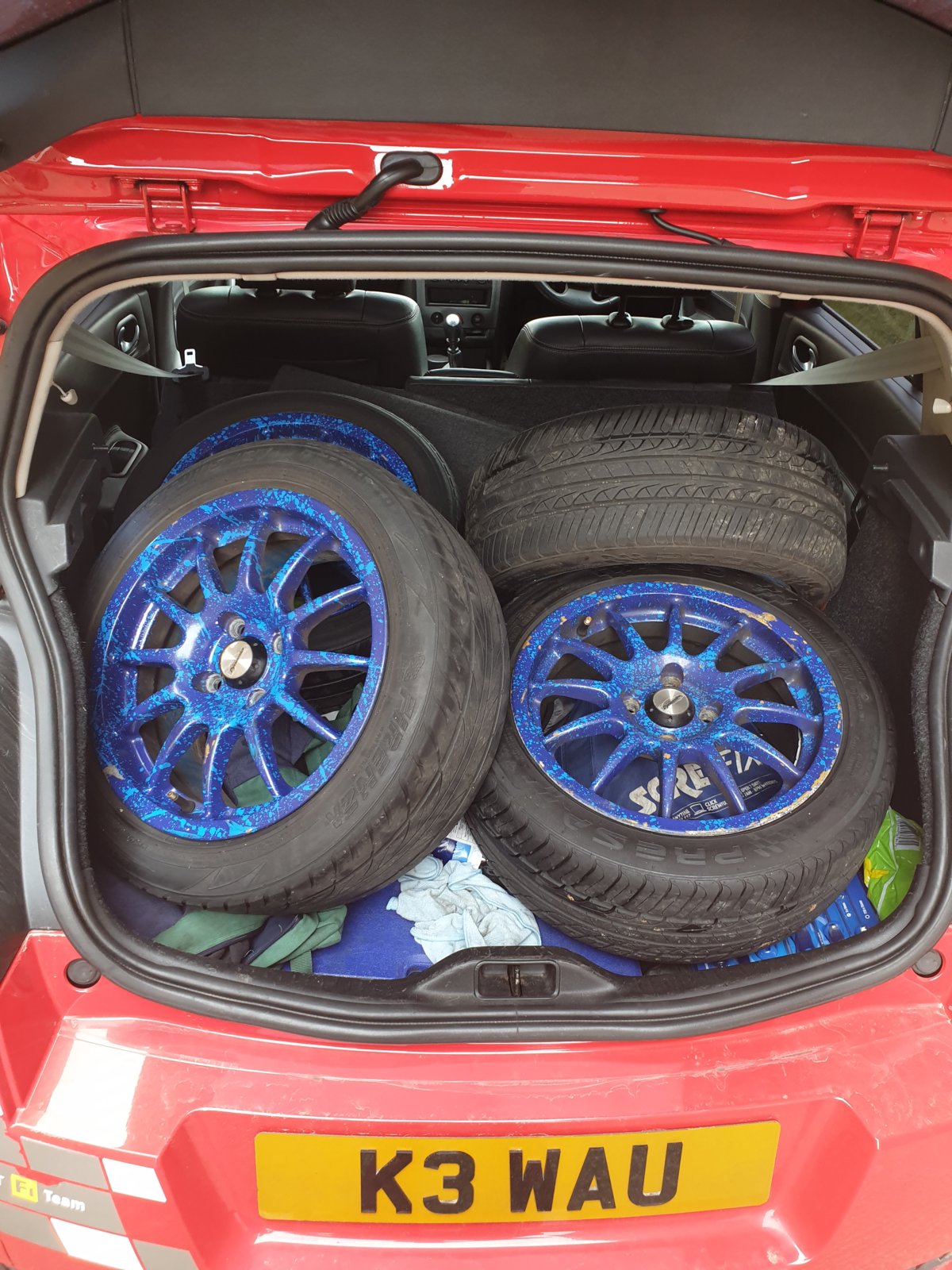

I bought yet more wheels... These are the last pair... honest

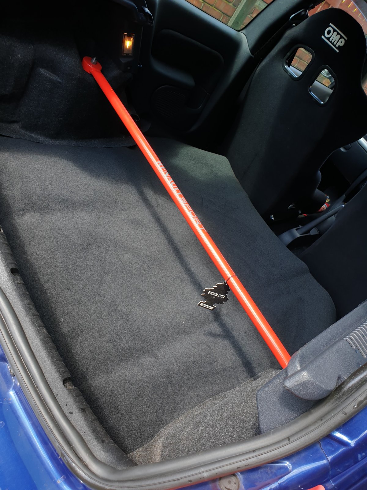

Then I fitted my buckets, had to drill out the old snapped bolt and I just nut and bolted it. I cleaned the rear out too because it was a bit grotty
1416780

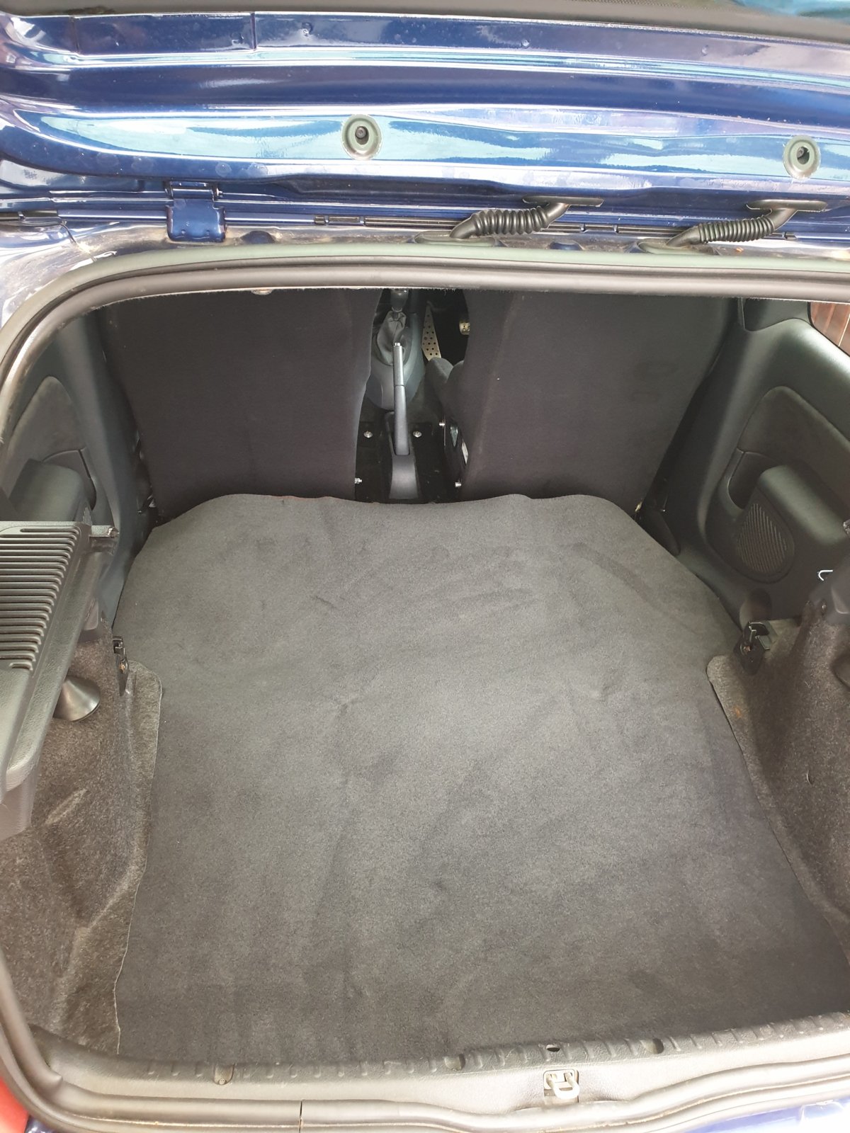

Then I cut some carpet, my mums kitchen floor is nice and open. She was out so she couldn't kick off at me?
1416782
1416781
Buckets look the part fitted, they're a squeeze because I'm using weird sidemounts. What a pain in the arse but they're in and they're not coming out now!!

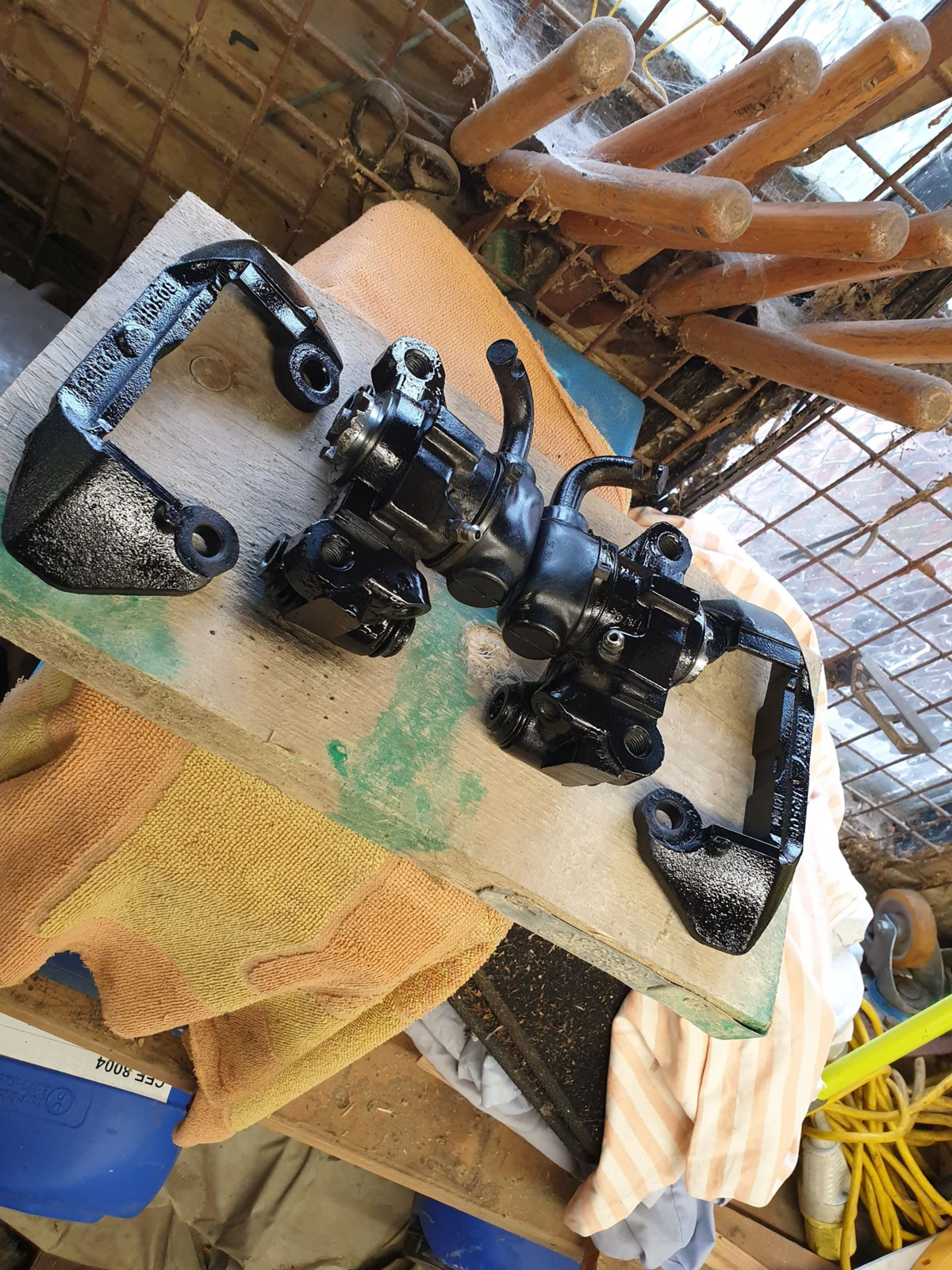

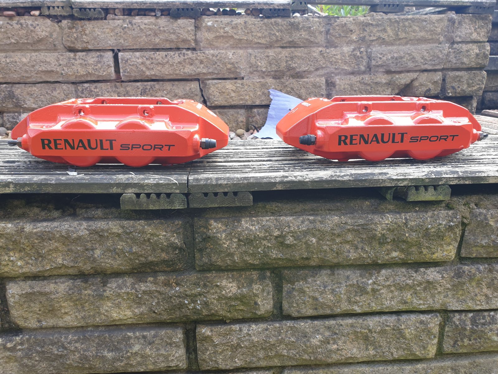

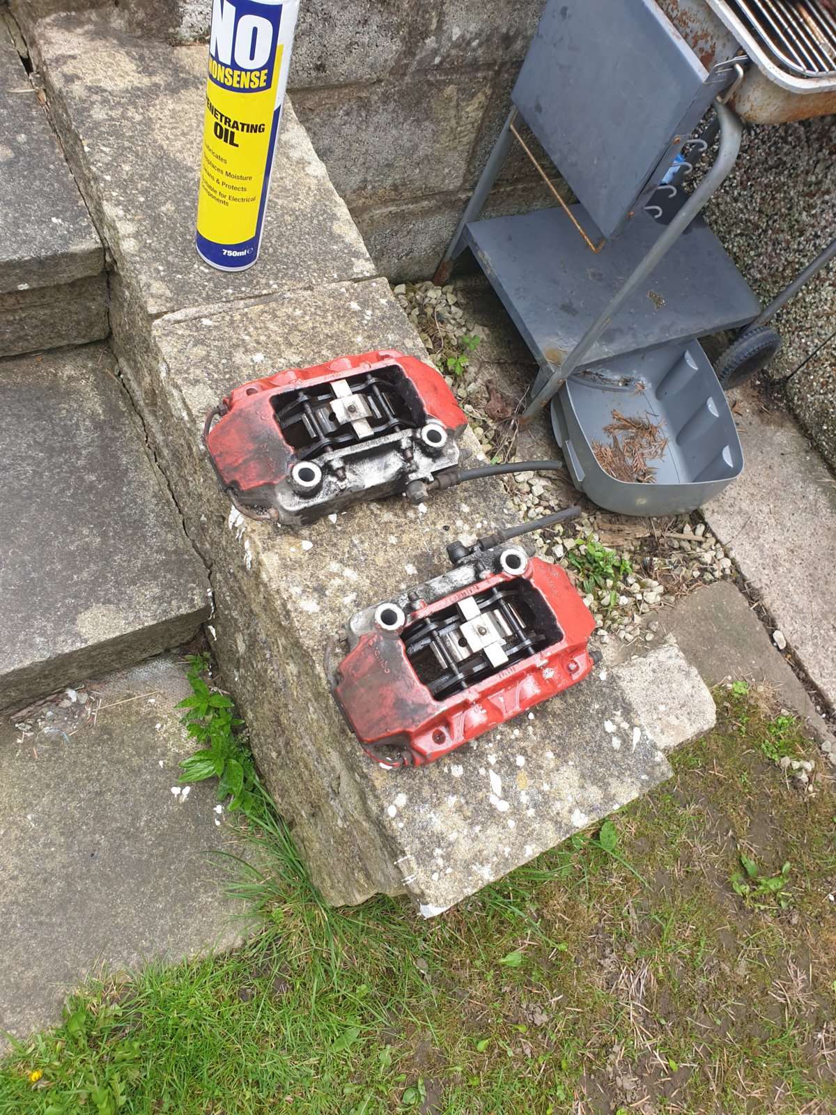

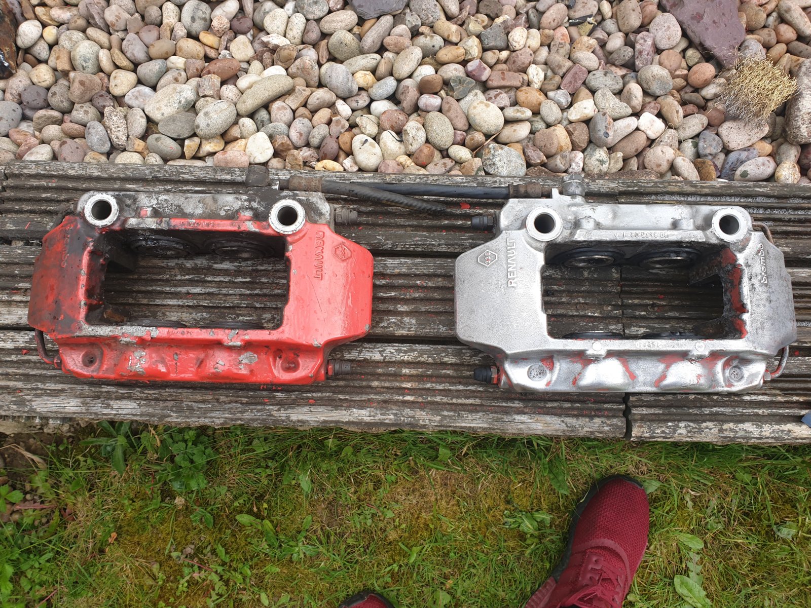

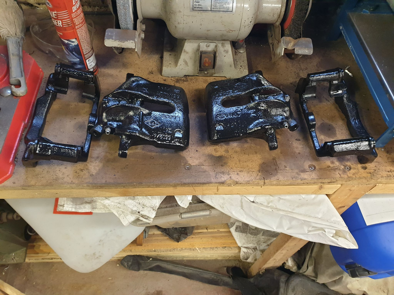

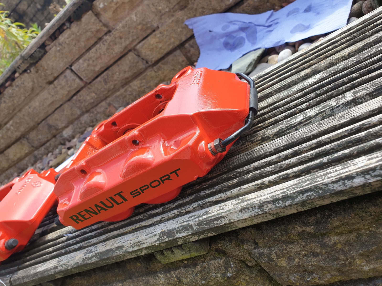

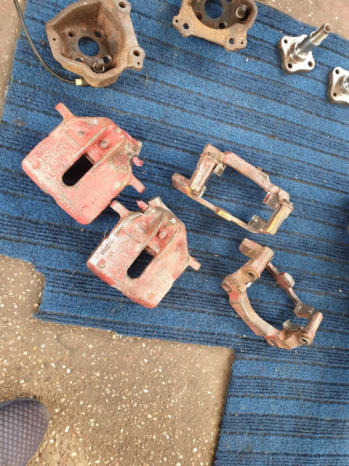

Started cleaning up a set of Brembos I had in the garage. Might as well chuck em on the Megane and then the Megane ones can go on the Clio?
1416885
They'd definitely been painted by a licker and the car they were pulled from wasn't well looked after either.

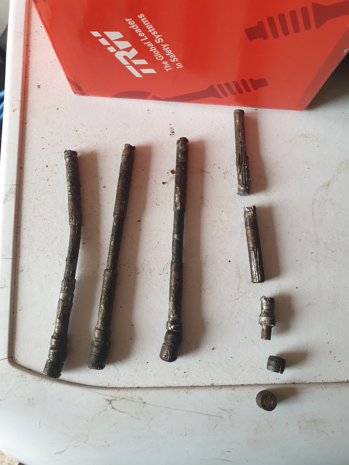

I fought with standard Brembo pins that were bent and full seized into the calipers?
1416886
Yeah my best advice for Brembo users is use grease and get Mr Pink pins. The standard ones are f**king s**t for daily driven cars!

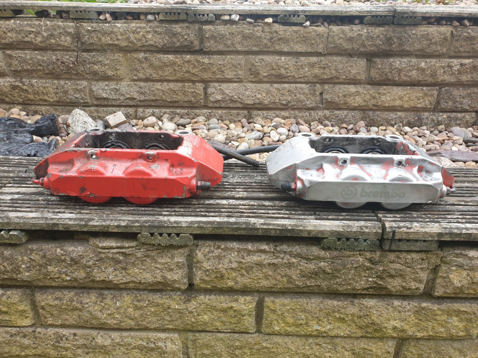

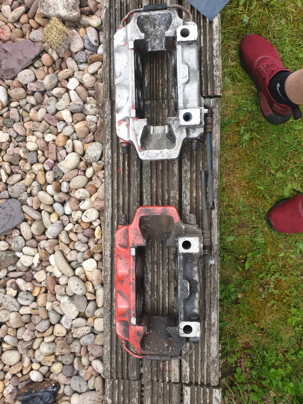

Some quick before and afters. I used some brass wire brushes on an old drill and then a bit of 240 grit wetpaper. Out of all the paint slopped all over only a few bits actual stuck properly?
Before Vs After pics
1416887
1416888
1416889
Then it started raining so I came inside to watch Mr Robot and sulk because I wire brushed the inside of my leg and it stings like a b**ch!??

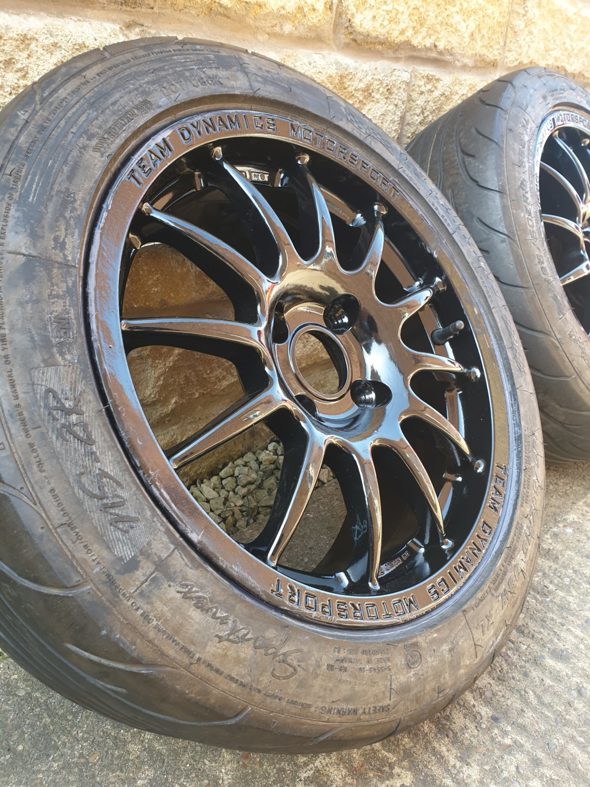

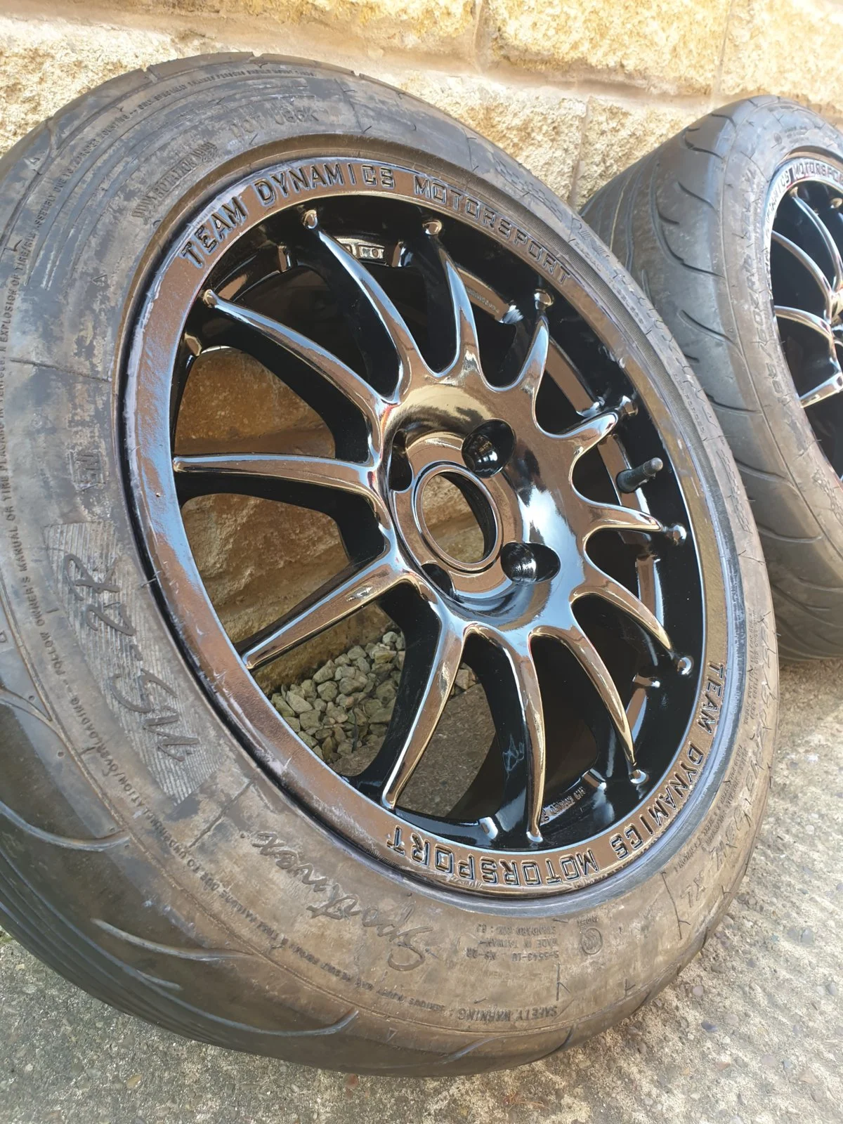

Got my TD's back from powdercoating and got my NS2R's (100 compound ones) put on and marked them up with what corner they need to go on so I dont have to do any thinking? Cheers to @dann2707 for recommending the place, the finish is decent and for the price I paid I wont complain one bit!
1418339
1418351

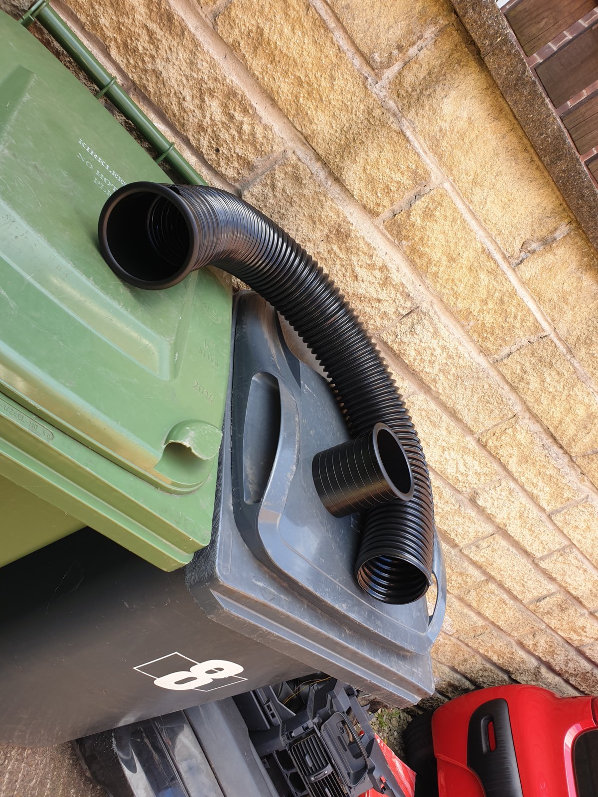

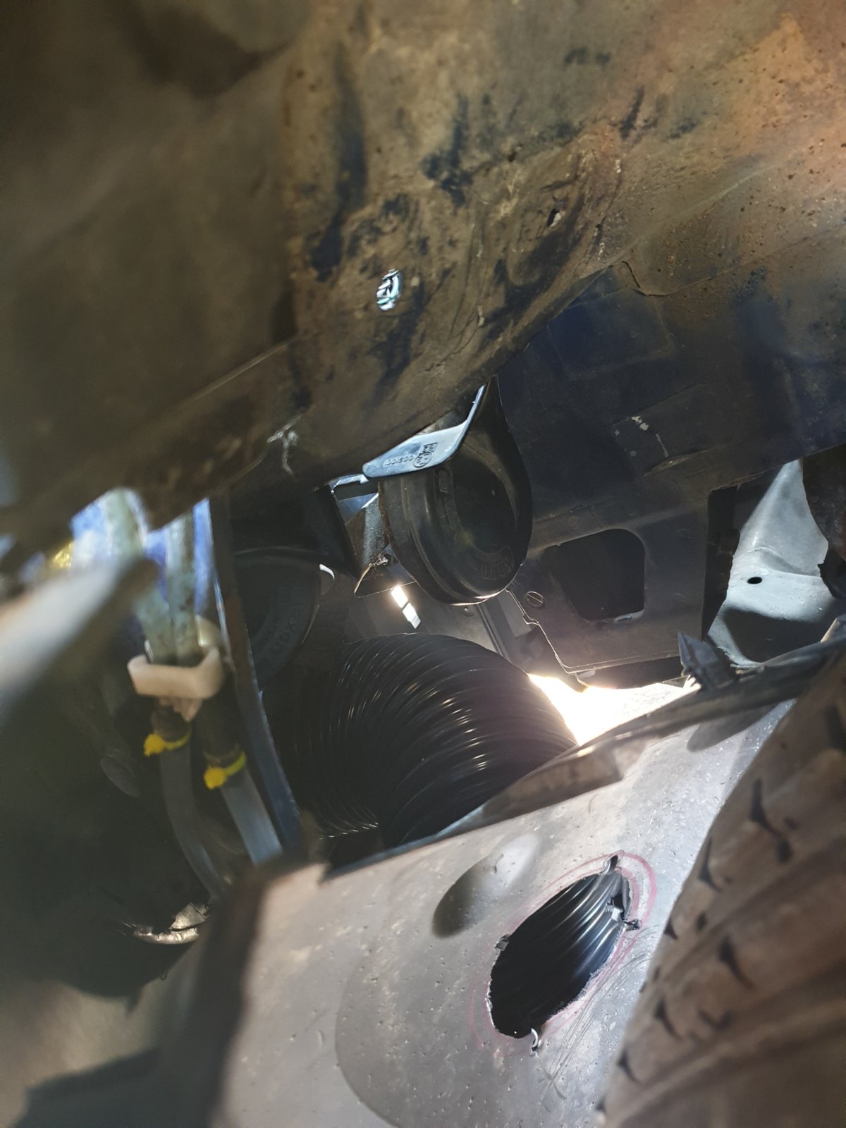

I've mainly been doing bits to get it into an MOT bay. This included putting the horns back in and bending the f**k out of the bracket so they clear the 100m brake duct
1418341
Some people will moan they're not pointing at the brakes... they do... a bit
1418346
Good enough for me and should provide plenty of air. Worst comes to worst I can bend up some deflector plates

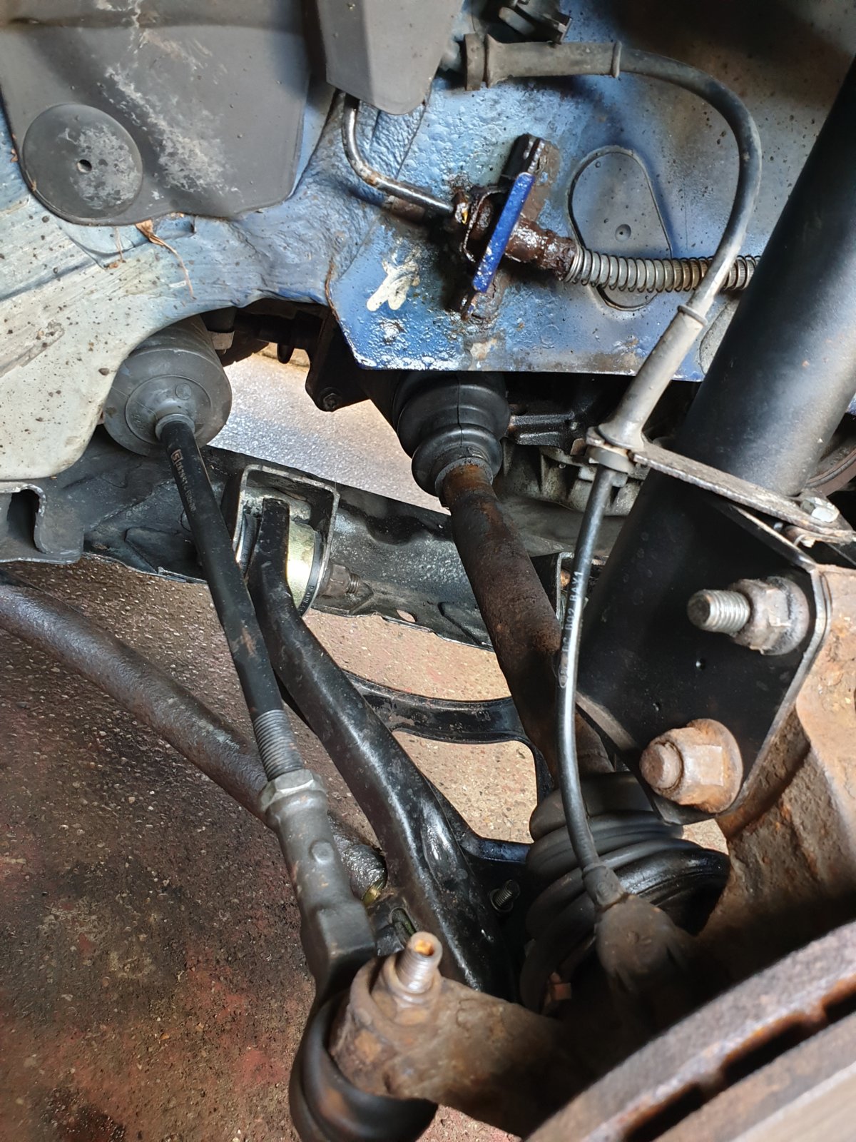

Chucked on the polybushed lower arms, I had some strongflex bushes I'd pressed into some arms but I wasnt sure about how they go in. Some black series arms came up for pittance so I got them instead and put them on. The strongflex yellow bushes look the exact same as the powerflex ones if anyones wondering
I made up some new washers to stop the bushes splaying out under hard braking.
1418347
The OS was a pain as it was the original balljoint and wouldn't come lose for love or nothing! It looked like the car had been at the bottom of a b*****d lake for the past 10 years! After laying on the floor for 15 minutes holding a blowtorch against the bottom of the hub and getting the bolt hot cherry red it finally just tapped out really annoyingly easily?

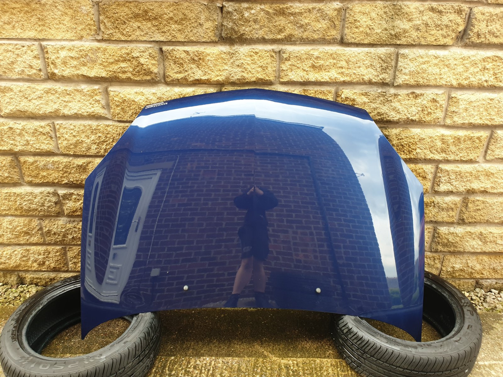

Got another bonnet to throw on that's in better nick than my other one. I thought it was mint but when I got it home and cleaned off all of the dust I found this
1418349
Wounded. Still 10x better than the rippled one on there now and at £30 I'm not losing out on anything!

Ps. Some finished pics of the calipers I was refurbing above
1418352
1418353

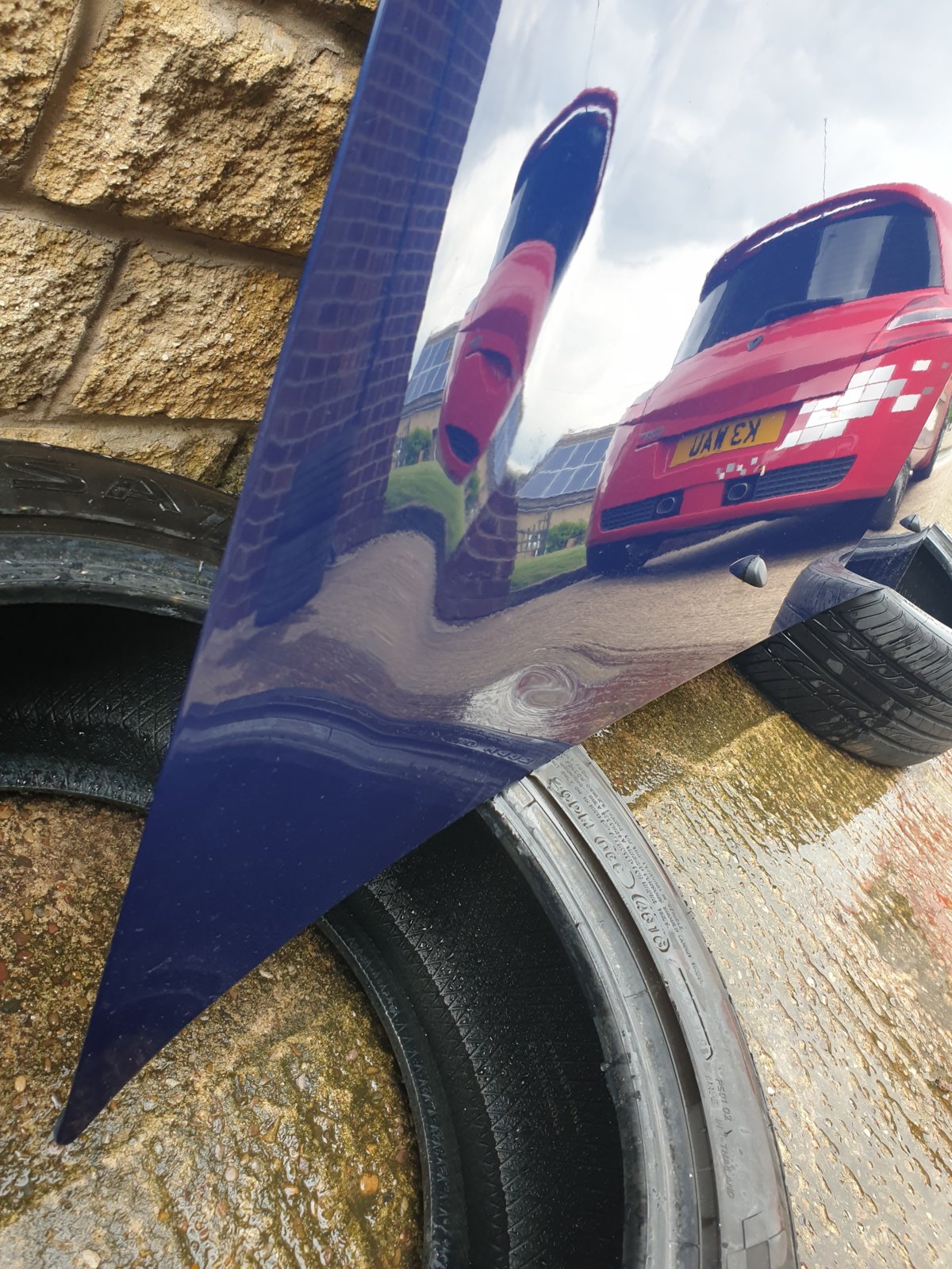

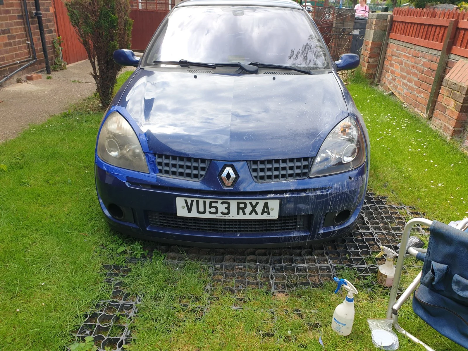

Did one of the most satisfying jobs you can possibly do to a Clio. I wet sanded and polished the headlights
Before
During
After
Makes a right bloody mess mind! Sat there hand sanding for about 30 mins each headlight with 800 grit as they were deeply oxidized. Then I moved through 1000 grit, 1500, 2000, 2500 and 3000 before sticking on a wool pad and some heavy cut on the DA. Then finished it off with an orange Hexlogic pad and Plast-X then some PBW glaze as I ran out of ceramic coating and I think clear coat just seems to take away a bit of the clarity.

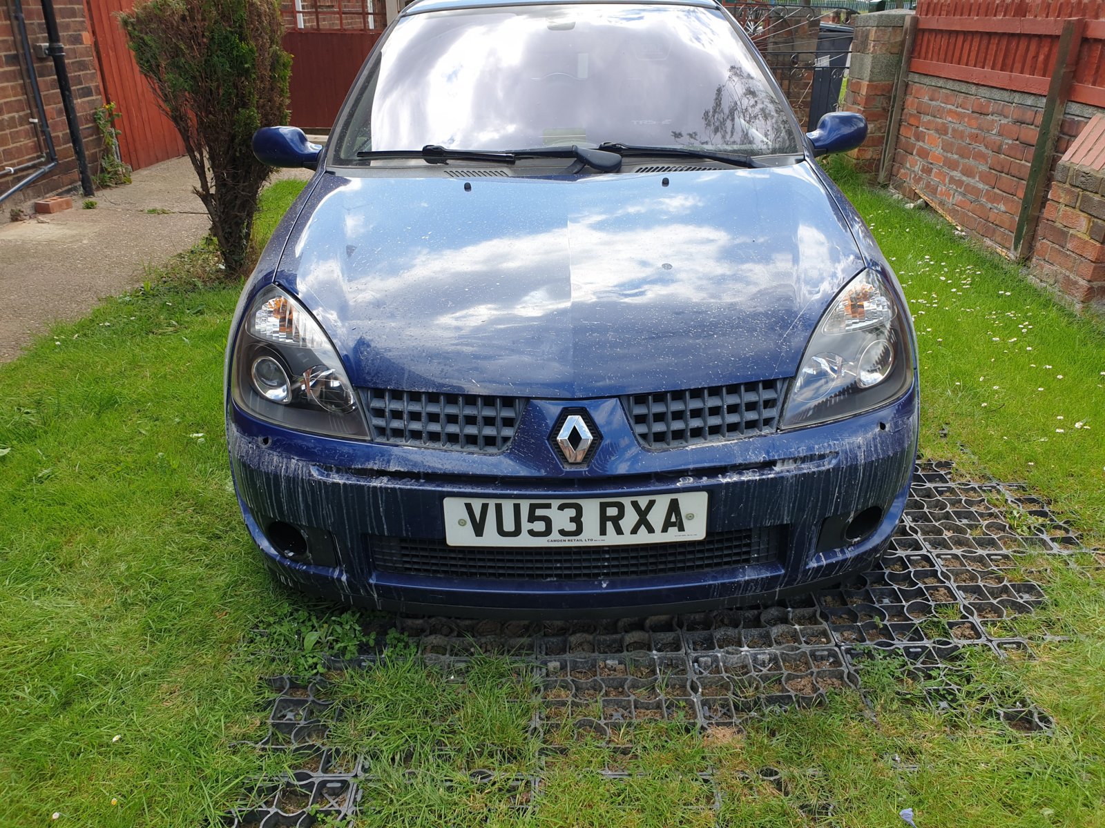

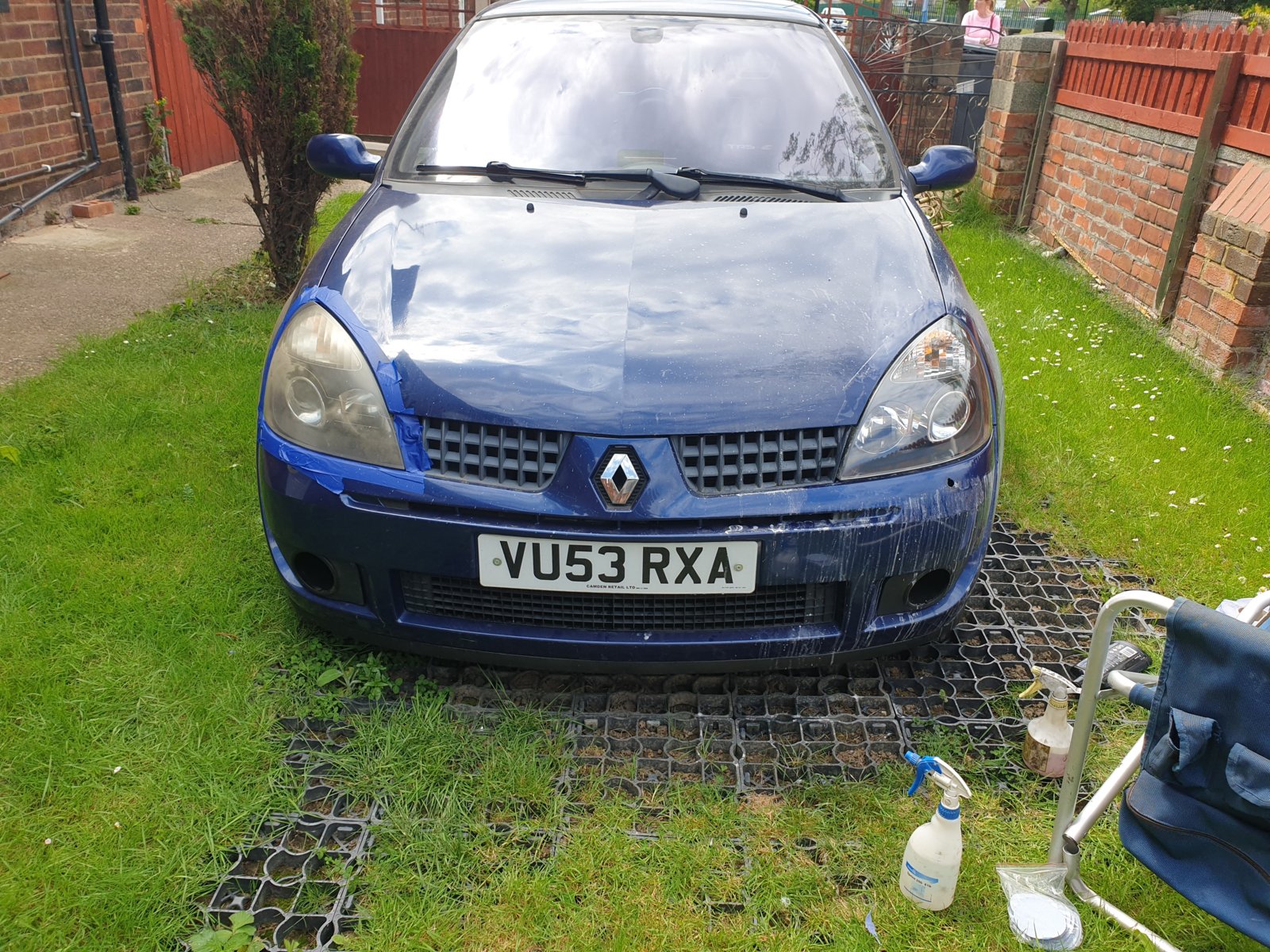

Owned it for over a year and gave it it's first wash? Was only a quick one bucket wash, the paint is shocking so I'm hardly gonna inflict more damage to it.
Then I took it for a drive around the village for 15 minutes, the tracking is way out as it pulls all over the shop, the brakes need cleaning up as they were less to be desired, the ABS light and Airbag lights are still on too. Although, I realised yesterday that I removed the rear belts so that may be why my resistors aren't working?? Pulled onto the drive after giving it a bit of a tickle and steam was pumping out the front grill, I flicked up the bonnet and started panicking like mad!...
Turns out it was just water sat on the top of the rad evaporating off from where I'd washed it, phew!

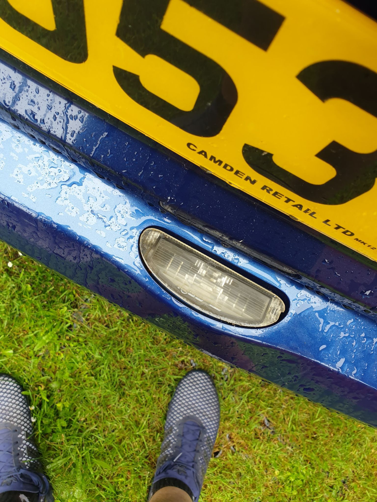

I then installed the rear air freshener holder
1419586

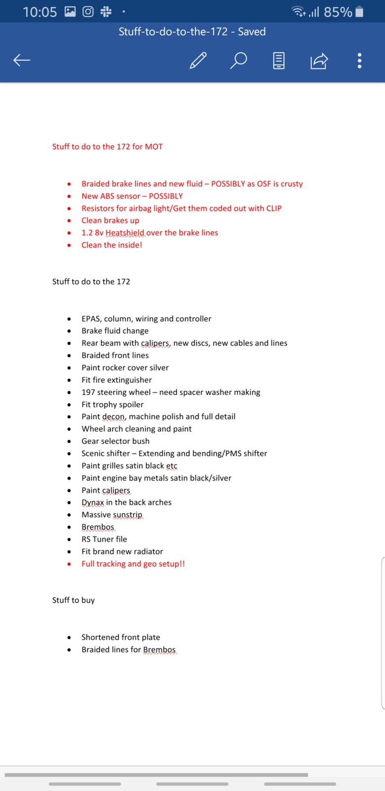

I've got all the stuff I need to do, down to one sheet of A4 too!?
1419590
If anyone is willing to offer a hand then you're more than welcome and will 100% be repaid in beer tokens. I've spent a year building it on my own or with my dad and now it's just got to the annoying bits to get it "finished". I say finished, it probably wont be because I'll blow something up on it, lose my rag, then spend lots of money making it better?

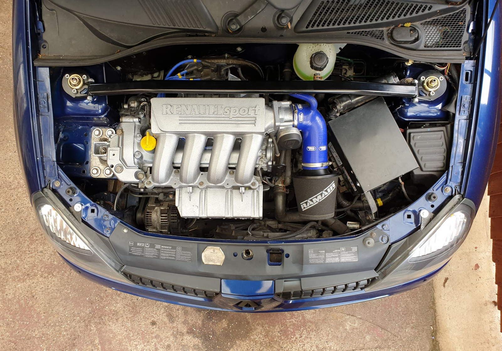

Right then, massive update with the blue c**t
I've been trying to cross as many jobs off my list as I can so I can get the dickhead MOT'd and drive it a bit before CSF. I DO NOT want the maiden voyage to be the trip to Blyton, I'm already paranoid as it is!

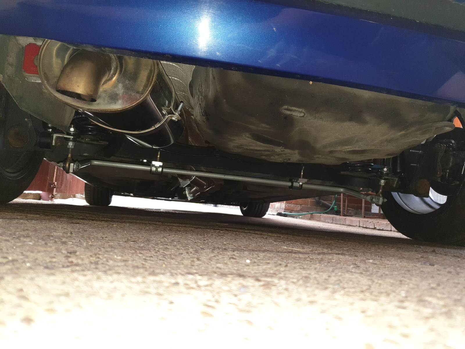

So first jobs were to put on my painted rear beam with black series bushes along with the Whiteline RARB, braided lines and some 10mm stub spacers
I freshened bits up here and there as I don't fancy taking anything off in the near future which started with painting the calipers, cleaning off the stub axles, sticking in new hardware for the ABS sensors as the torx headed ones are just cuntish! I did all 4 calipers because it made sense

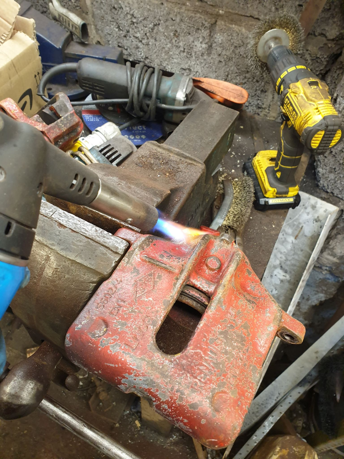

Stripping and cleaning... The ONLY way to remove bleed nipples is to first heat them to approximately the same temperature as the sun and then use an 8mm socket!

It took me and my dad a whopping 25 minutes to completely remove the rear beam, it took me 4 hours on my dCi last time! Then again I didn't own an impact gun and that took the majority of the work away, so glad I bought it now as it saves so much time on jobs like this
Everything back on the car
1422781
All mounts on the car are now polybushed/solid apart from the centre exhaust hanger

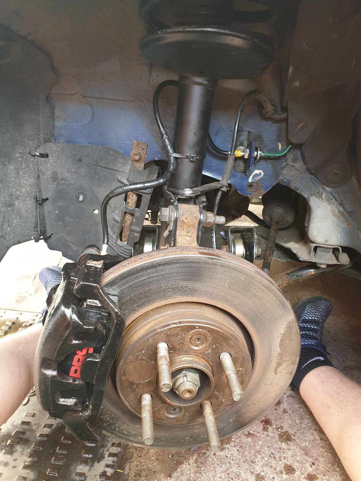

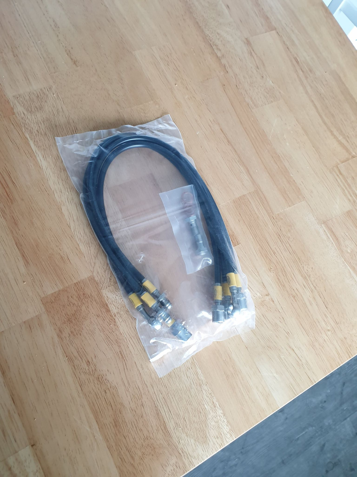

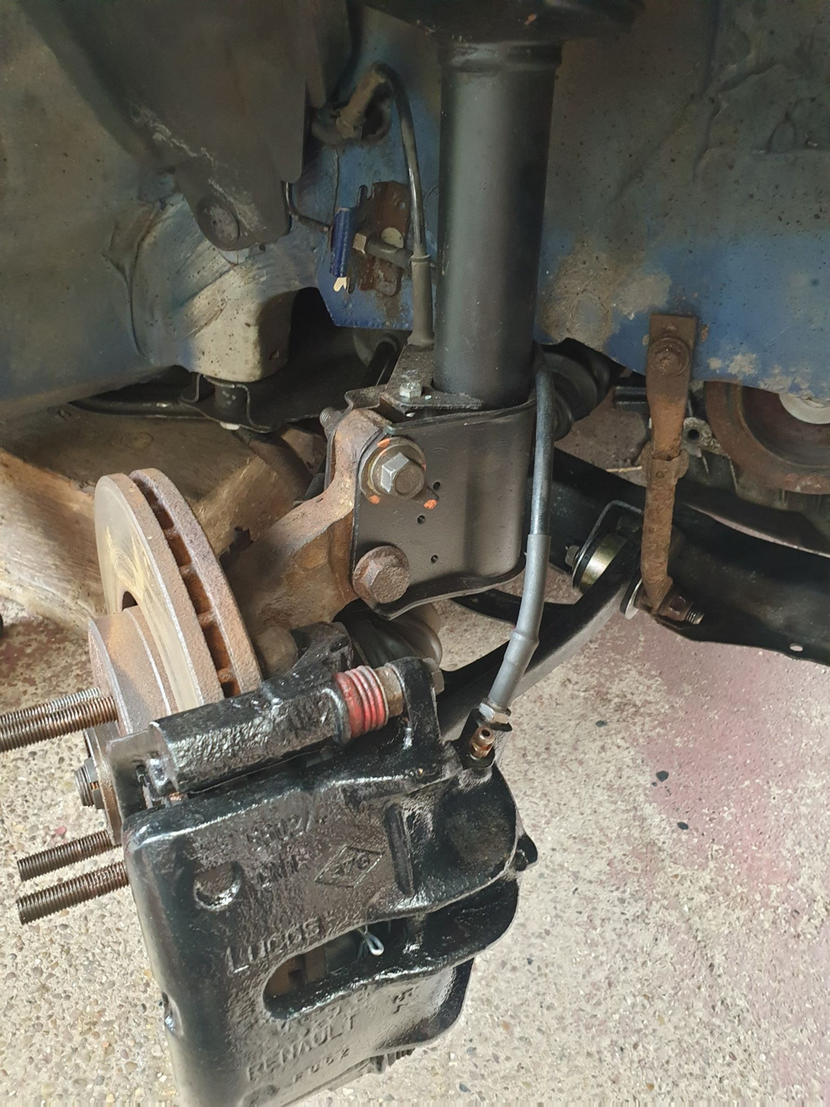

Next job was to do the front brakes, I bought some braided hoses and I stuck them on with the painted calipers, stuck some fresh PBS pads in, bled everything up and then checked lock to lock...
erm... Is that supposed to happen?! I think not! (Goodridge hoses for anyone wondering)
1422782
Brake line is a bit short and when giving it welly on full lock it pulls on the backside of the shocker. All in all a bit cheesed off as I had to order some more
A few days pass and new lines arrive
1422783

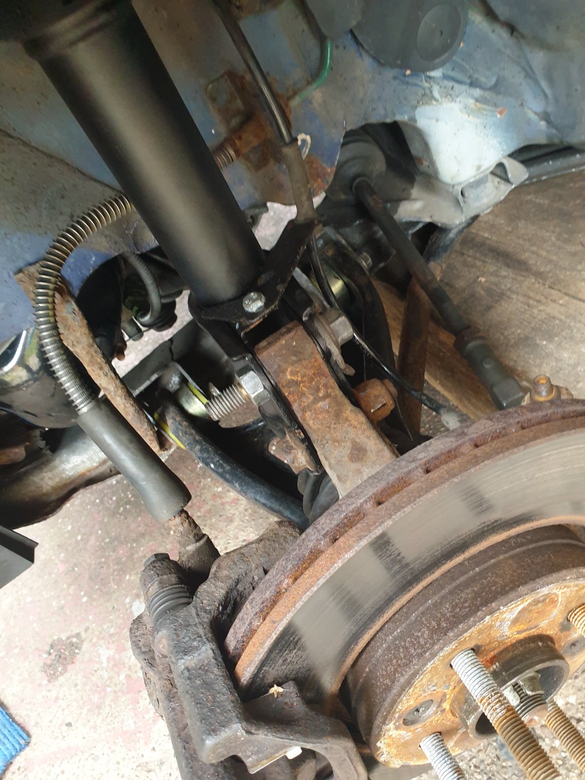

I bought them too long... Before I even measure them I knew they were a bit too long!
Oh well I'd rather them be too long than too short, I bought some banjo type ones for when I go to Brembos too at £65 delivered for the lines and fitting gear next day I can't grumble.
Fitted them to the car, cable tied the 'excess' out of the way and added some thick poly sheathing and tape to areas where I think there may be minimal contact/rub. Nothing catches with the wheel on but I'd rather be safe than sorry (I know a lot of you will have a quick chuckle at the f**king state of em)
Pic of the other side
1422784
Got everything bled back up and flushed out with ATE Type 200, took it for a quick spin and it brakes a lot better, tracking still needs doing so it leaves a lot to be desired in terms of handling but I can't hear any rubbing/knocking so at least I haven't left anything loose after spending a year of building this t**t!

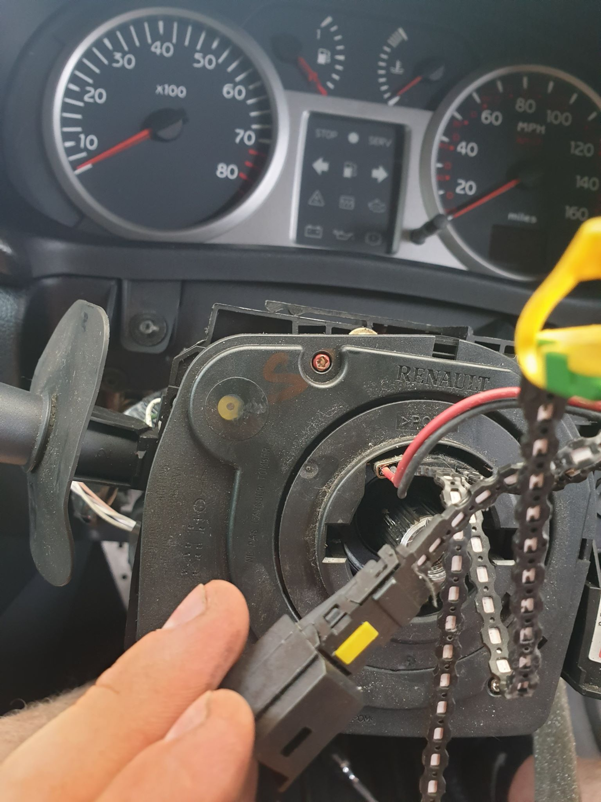

I then moved onto the task of removing the ABS, airbag and other lights from the dash so I broke out my RS Tuner that I completely forgot I'd bought. It didn't have any modules though so I had to buy the code for them (of which I made a right f**king hash job of) at the small sum of only £75 *gulp*. Oh well I'm getting desperate now and it will stay by my side for many years to come, I hope
So I cleared the codes from memory (there were about 25 DTC's just in memory) and set out to getting rid of the lights, I was sat there chasing the same codes for about 15 mins when it clicked to me... I was getting codes for the calibration of the steering angle sensor, when I put the dCi rack on I span the steering wheel like a f**king windowlicker so it knocked it out of whack. 10 minutes pass and now I have it in the yellow and I've fixed some more issues as the volume buttons were fucked on the stalk so I picked one from my stock bin and swapped it out ?
1422793
1422794
The ABS and traction lights both went off but the airbag and service stayed on... hmmph weird... I then turn the steering wheel and the traction light comes back on... Oh f**k offfff:rolleyes:? I'm now wondering if disconnecting the battery for 30 mins will stop it from being a shitbag or if the angle sensor is just shagged

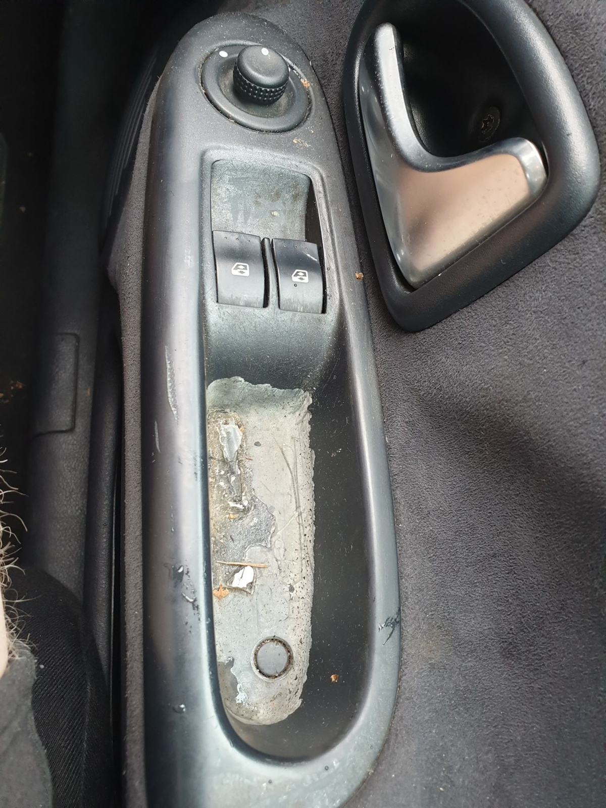

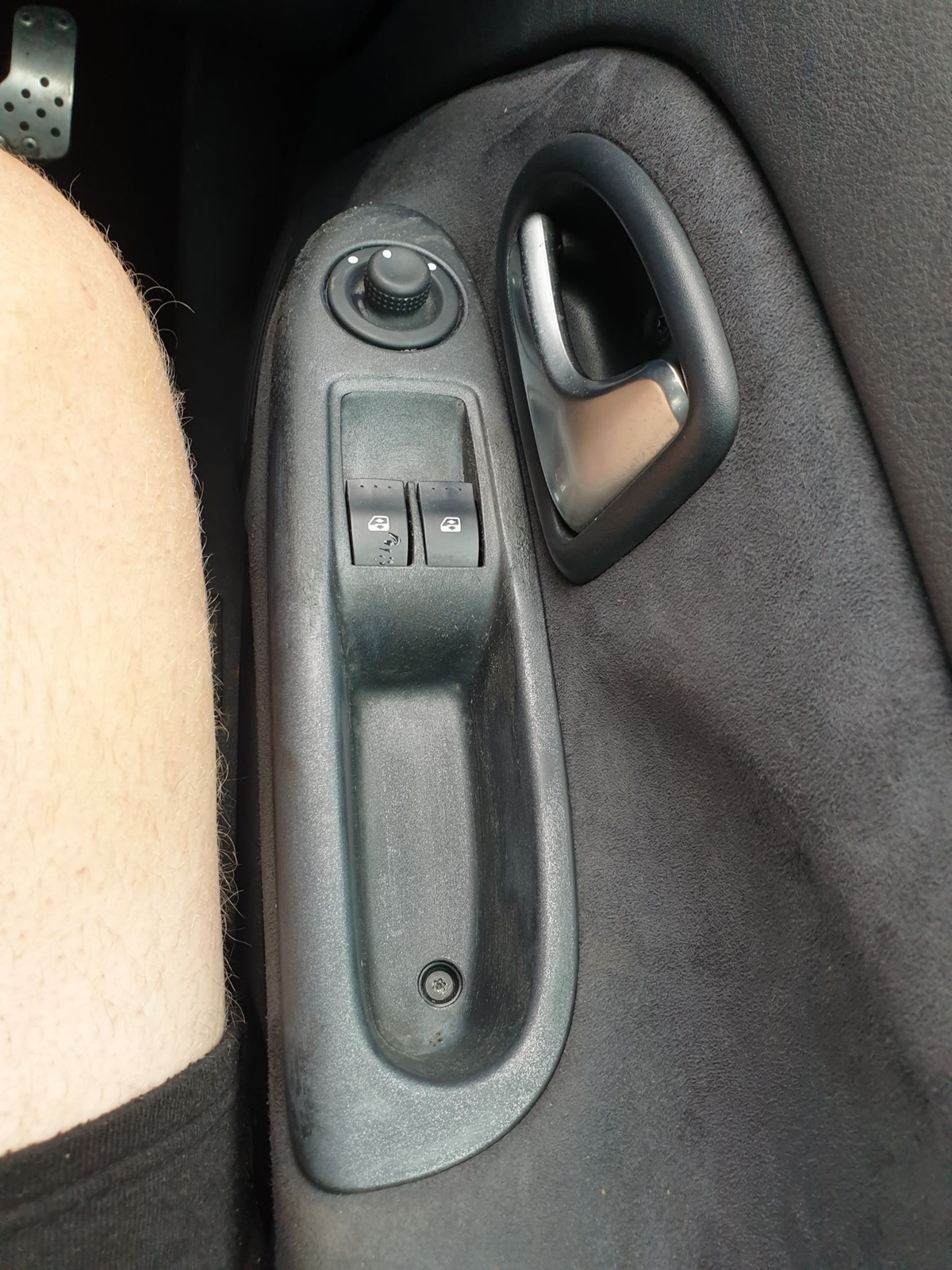

I replaced the drivers side interior door handle as this door was on my old 172 as well and had the most gross s**t in the part where you pull
Before
1422787
After. Nice and clean and I know I won't get syphilis from it anymore
1422788

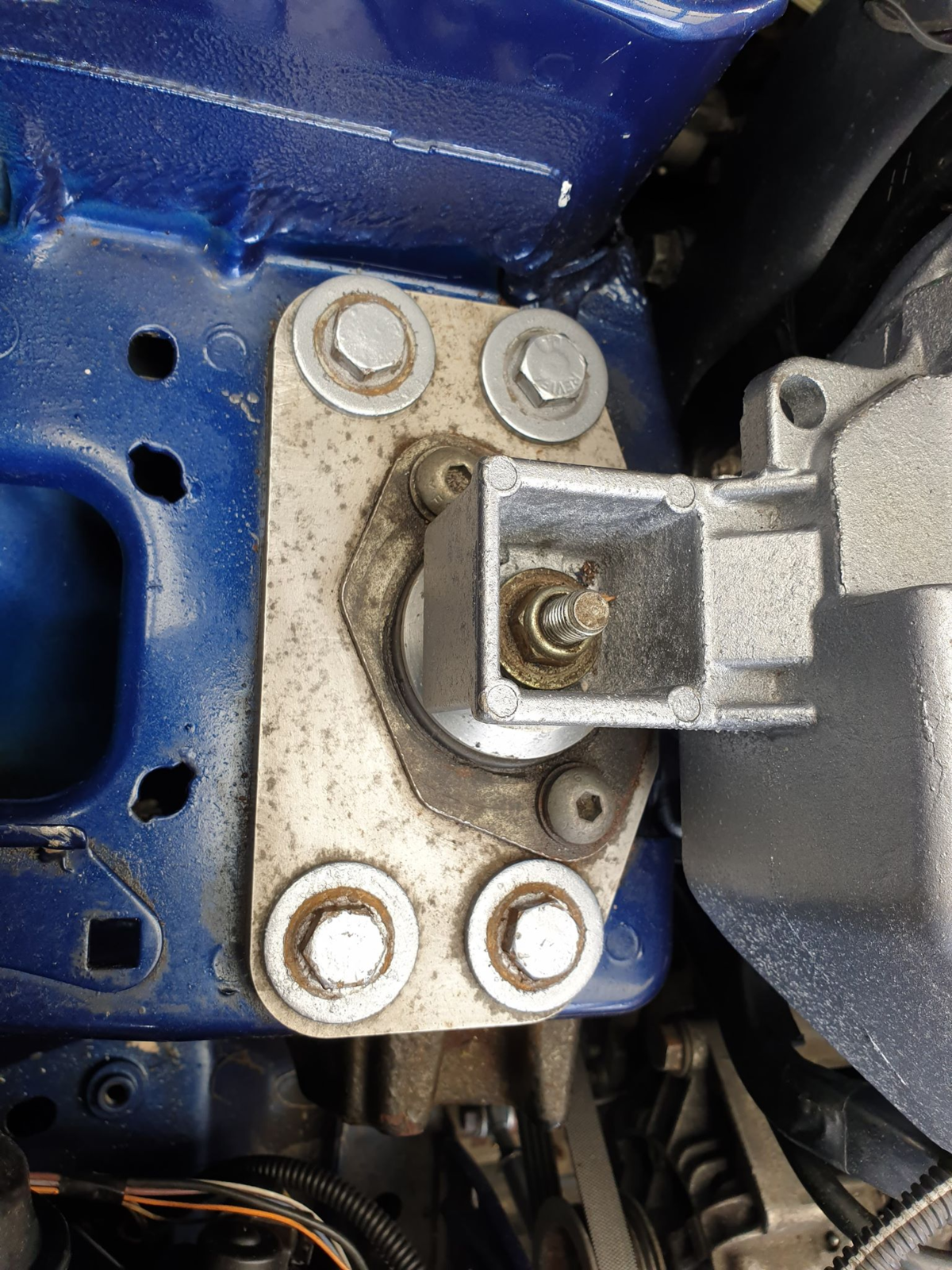

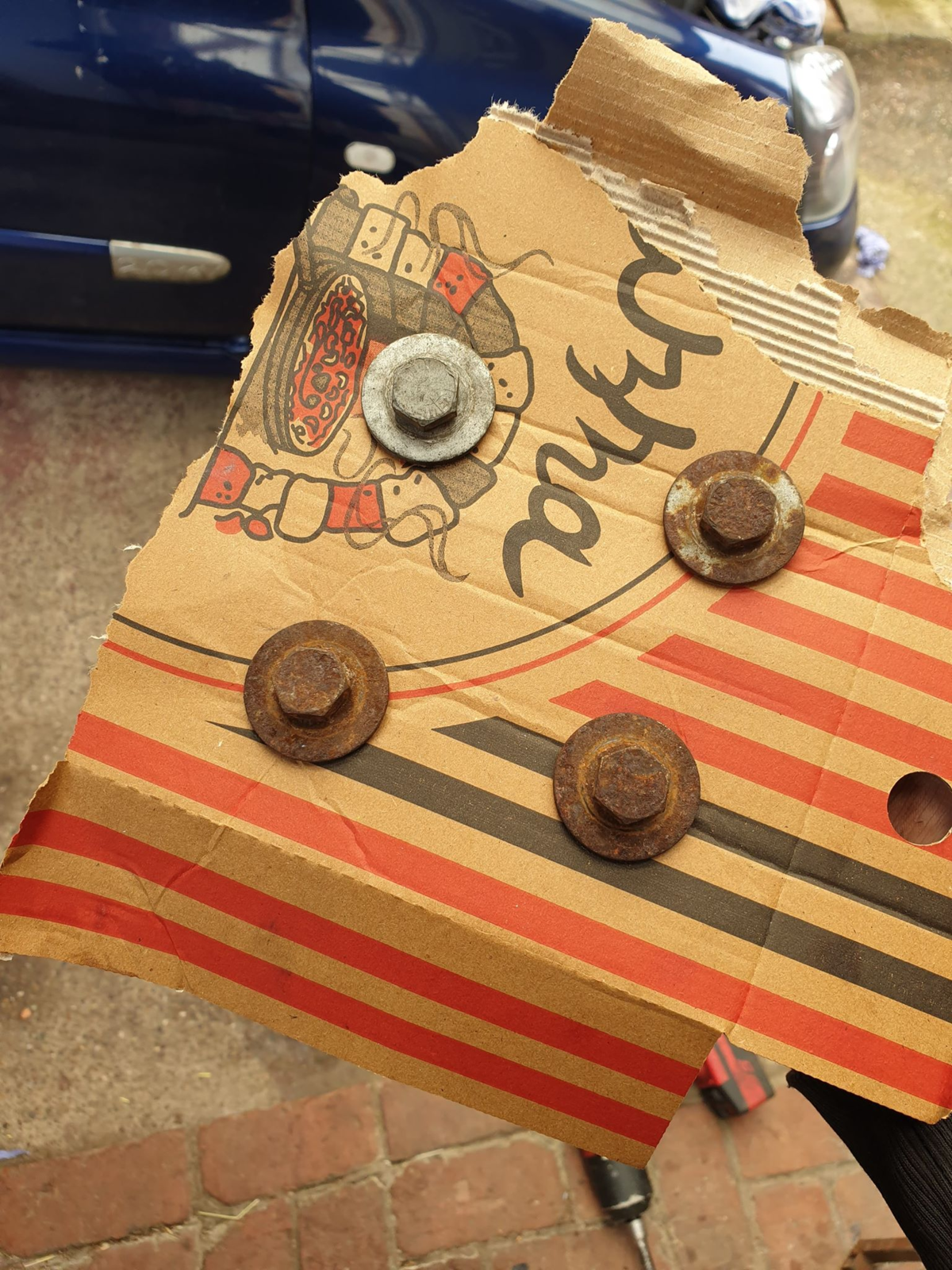

Painted the scabby engine mount bolts
1422799
I got them all nice and pretty
1422800
Then ran them down with the ugga dugga and fucked them up again
1422801
Everything cleaned up now
1422802

Not keen on the zip tied flexi hoses mate, id go back to standard hoses that fit properly. I too had issues with braided flexis catching the strut on full lock on the Kangoo, decided not to use them in the end and stayed stock.
