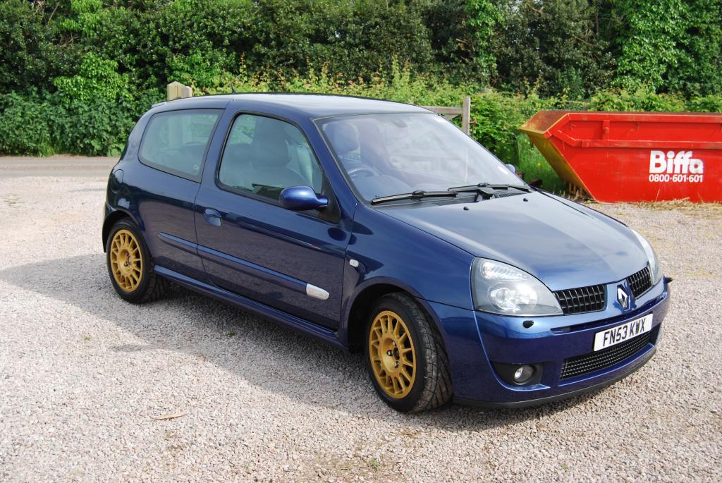

Hi and welcome to my Monaco progress. I picked up the car a few weeks ago and love it. It needs a few things doing to get it right, but all in all ok.
The Clio is my third car that I have owned, and definitely the fastest.

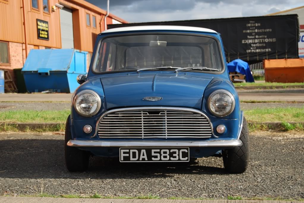

My first car was a 1965 Mini. Gutted to have sold it, awesome car!

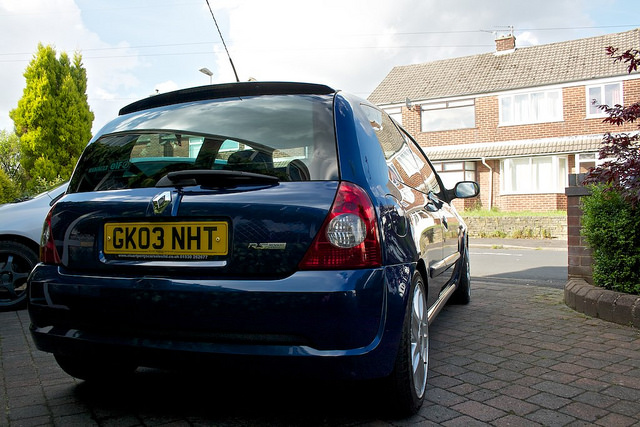

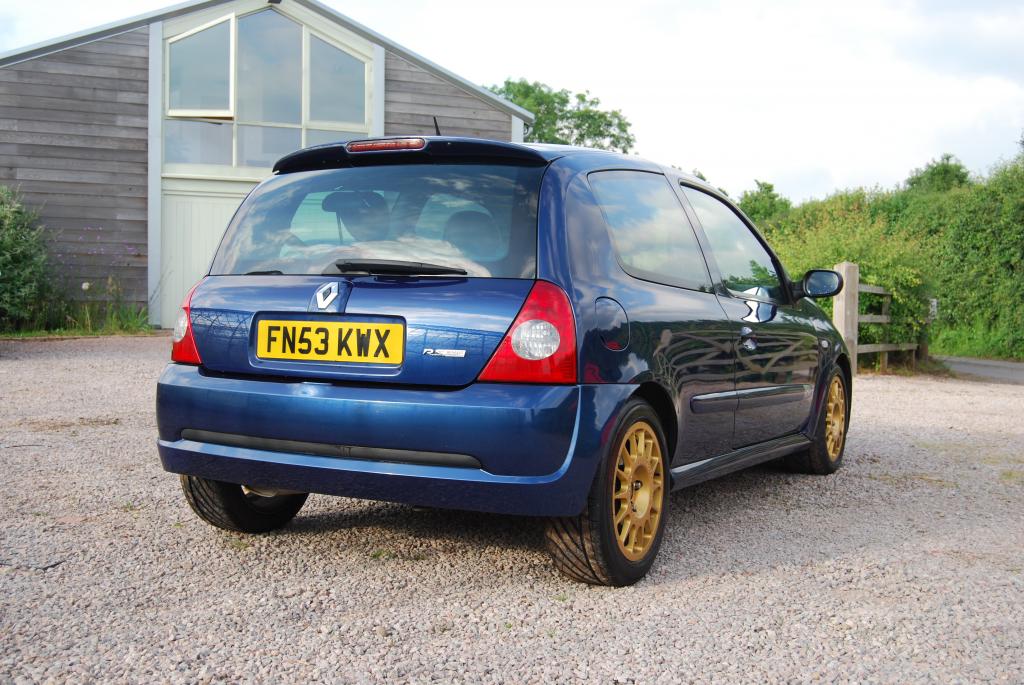

And here is my Clio.

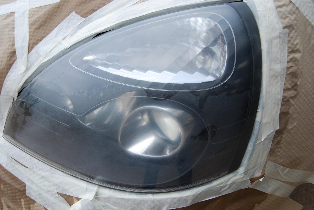

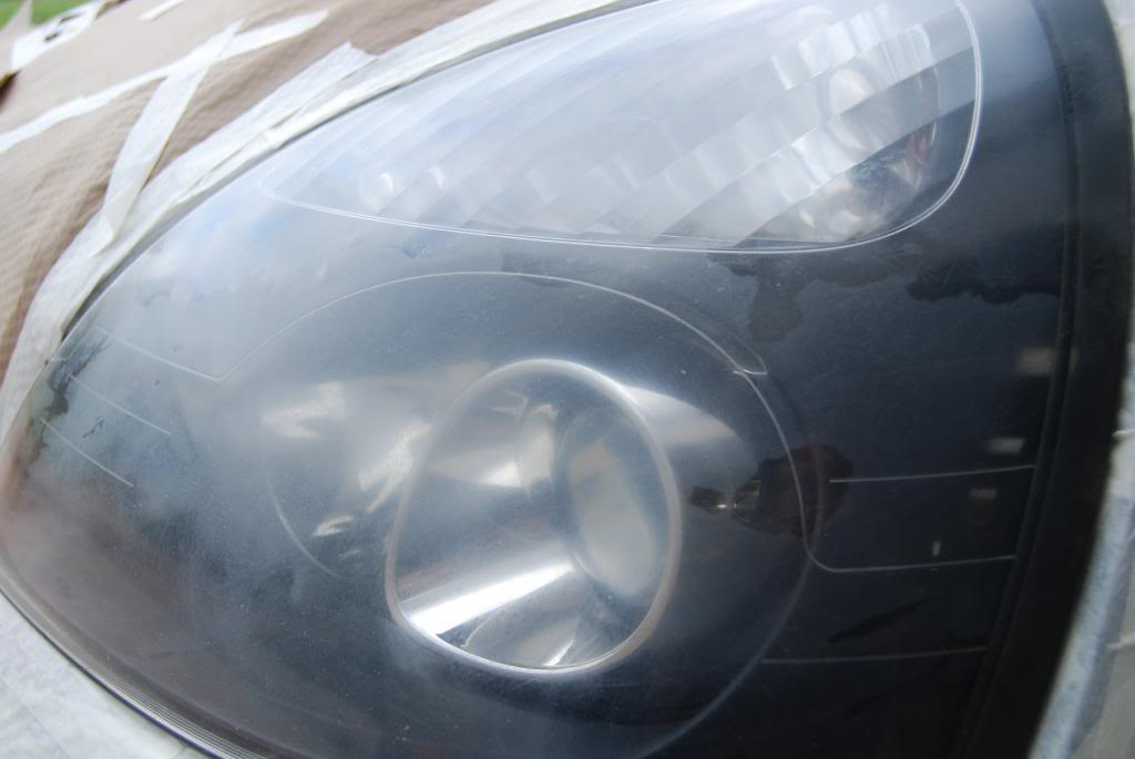

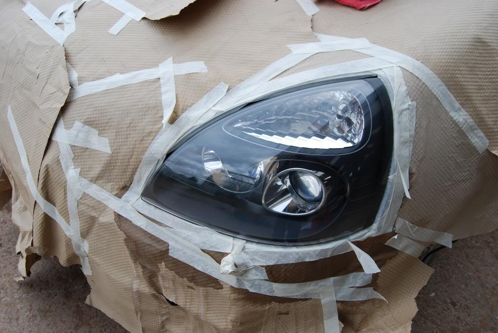

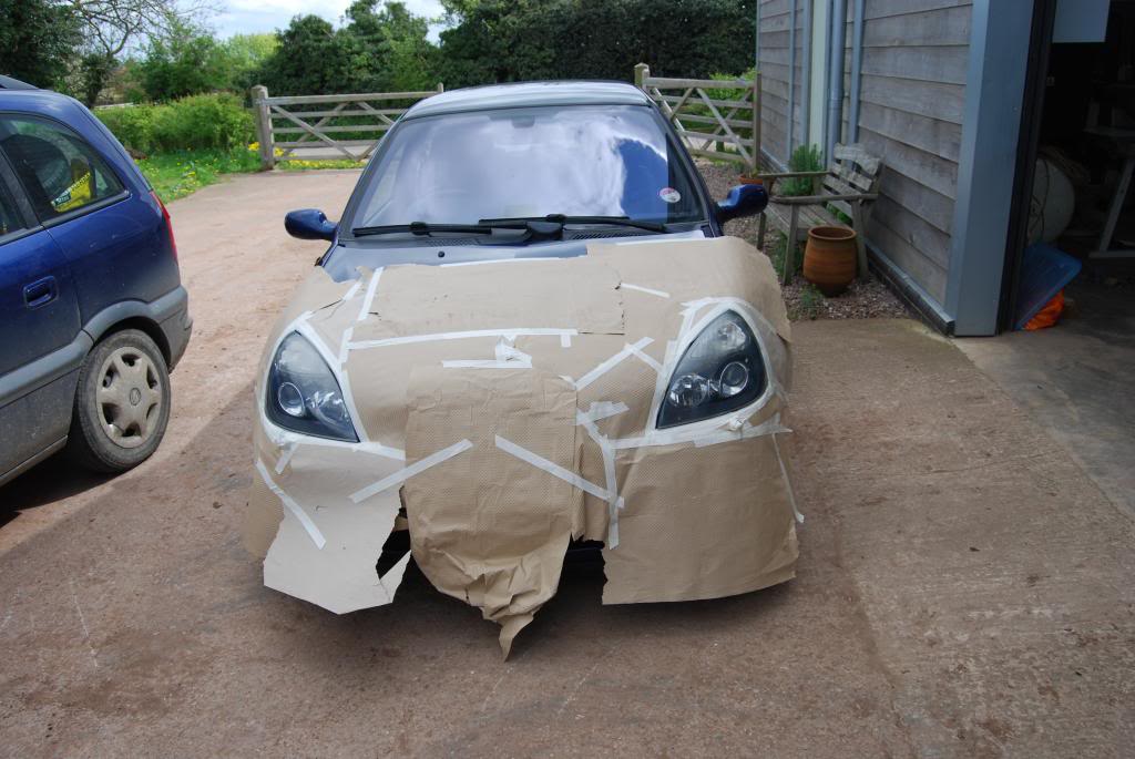

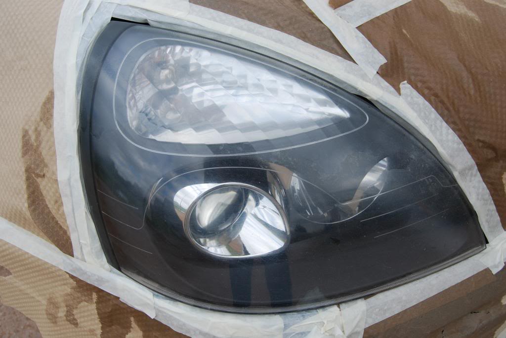

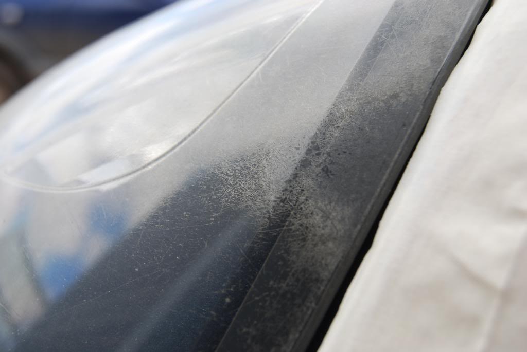

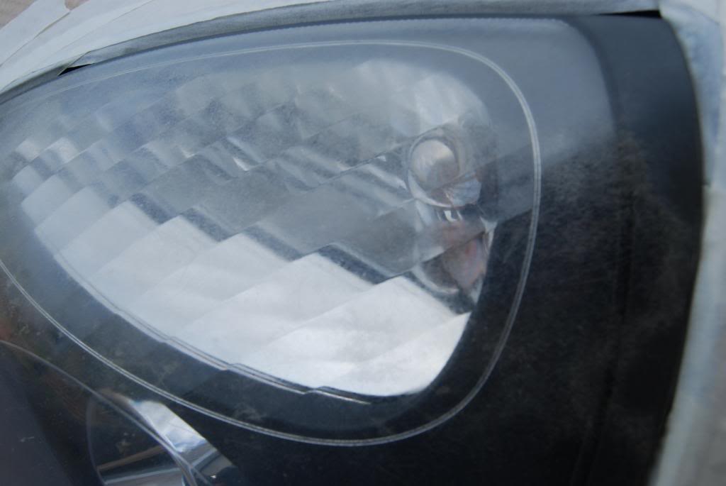

The first job was to polish the headlights which were pretty foggy. I used the Meguiar's headlight restore kit from Halfrauds.
As you can see they were pretty bad..

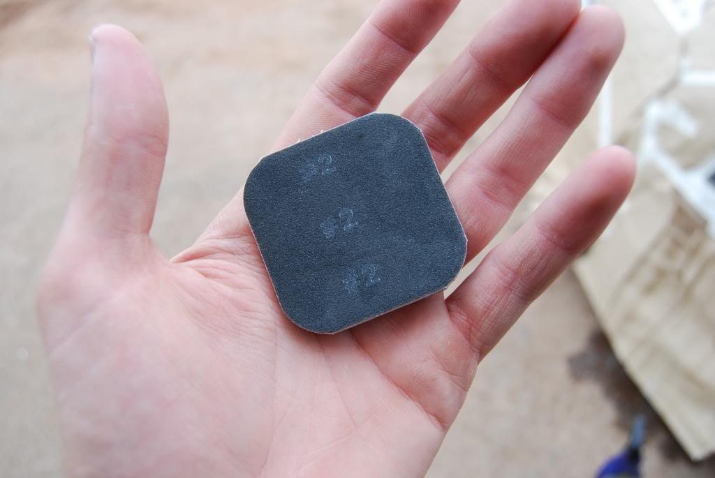

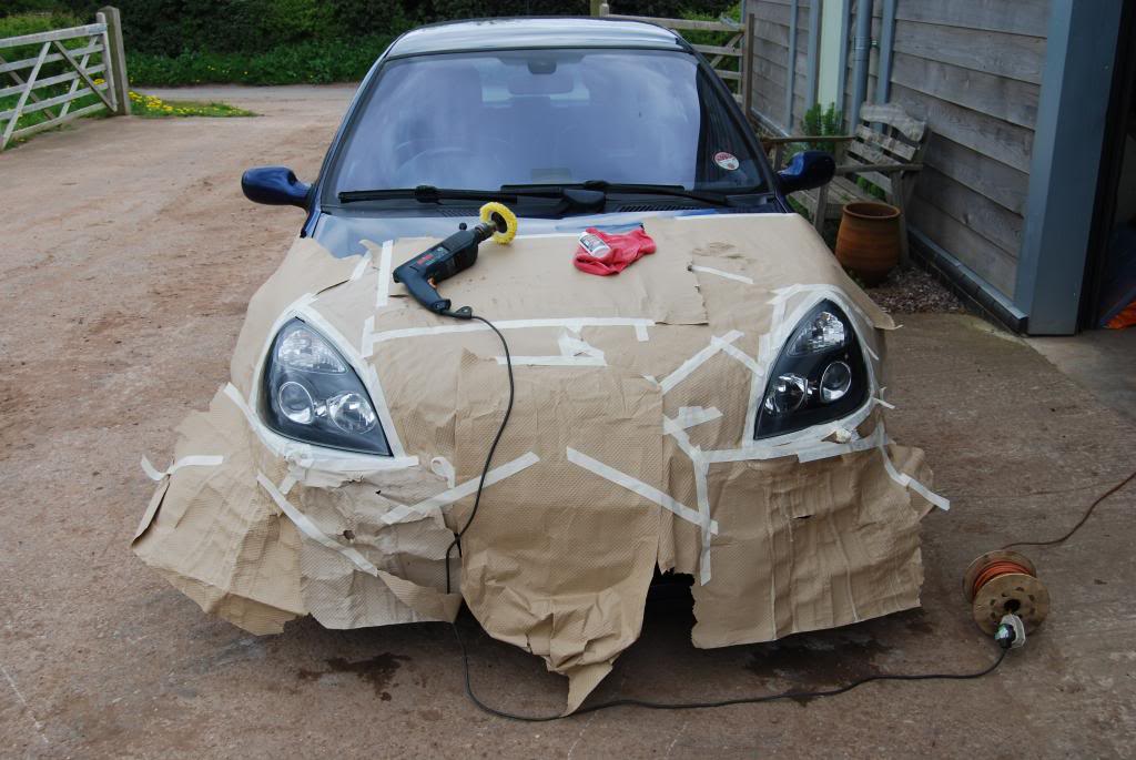

So I went straight to wet and dry paper... Supplied are 4 Pads working from 1800 grit to 2800, some polish and a mopping wheel
I then moved on to polish them with the mop...
They came up well, however not as much as I would have liked, so I bought some more 1200 and 1500 grit wet and dry and repeated the process, with much better results

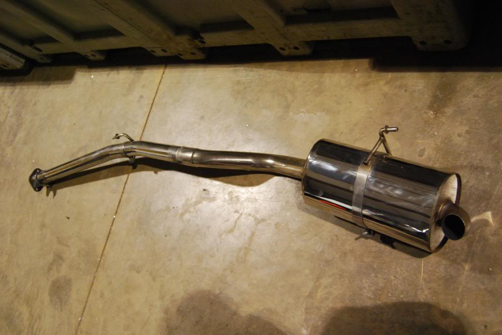

New wheels today. Went down to Surrey to go and collect them, and a standard exhaust. The KTR stealth exhaust will be up for sale shortly...
Going to refurb the wheels, thinking an anthracite/titanium colour. I am also looking to lower it and put some spacers on.

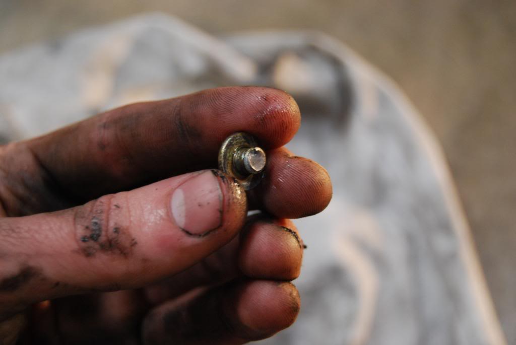

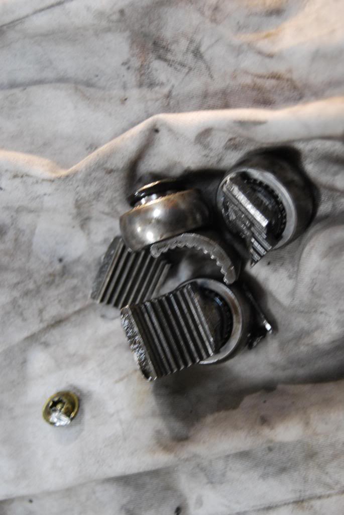

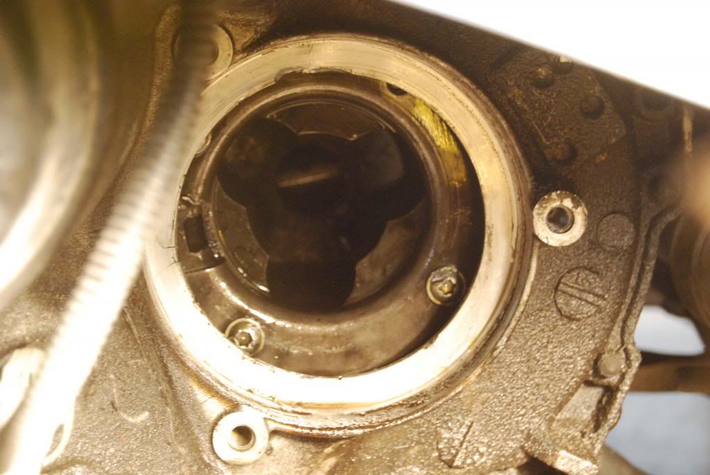

All plain sailing until yesterday. Driving home and passed a car in the lane at low speed, put it into first and nothing. no drive. Still unsure if im going to have to take the gear box off. Some advice would be great! Definetly a new Drive shaft. I thing the box also may be a JC5 130, but still unsure.
It has been an expensive month. After fitting the new drive shaft, the car was still leaking oil. on closer inspection, it appeared to have cracked the gearbox casing when the joint exploded. So I have fitted another gearbox, and it is back on the road.

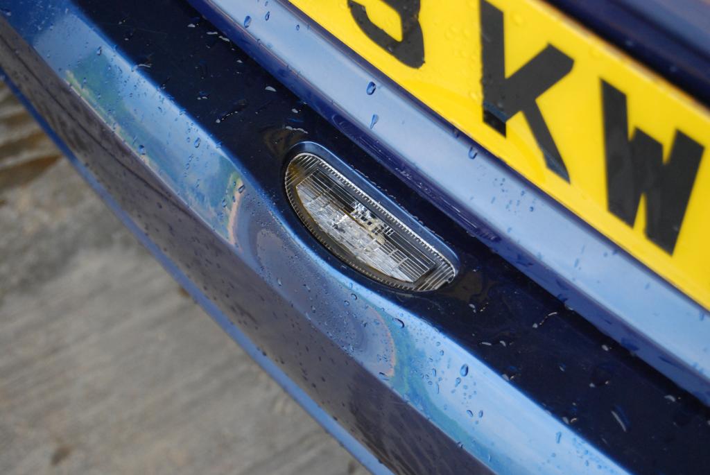

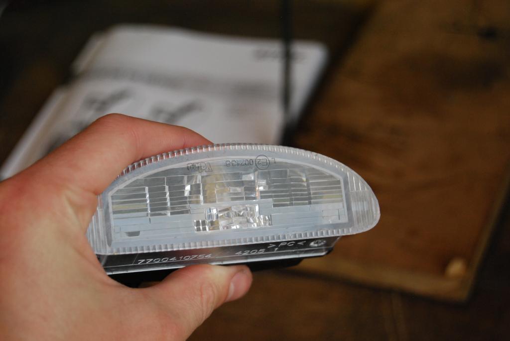

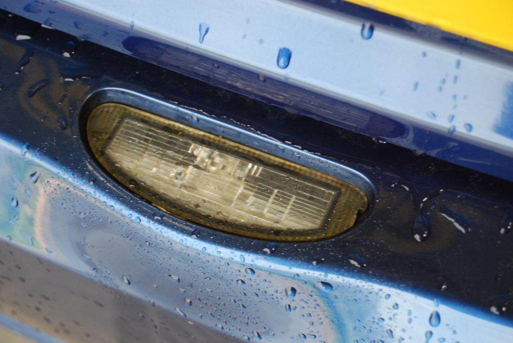

A new number plate light

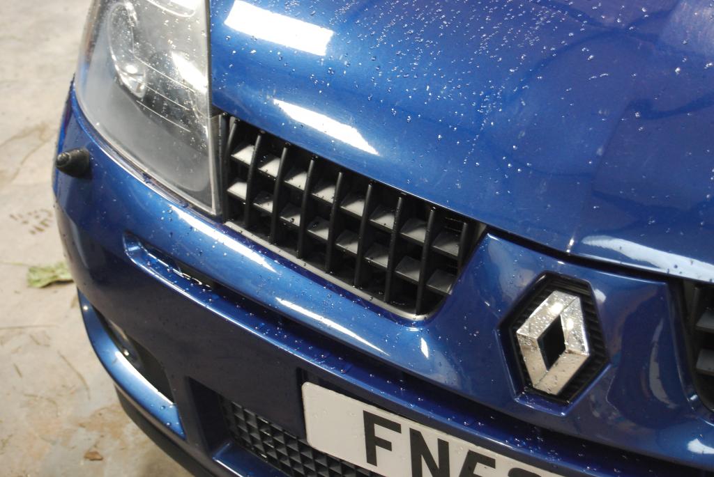

I also painted the front grille satin black

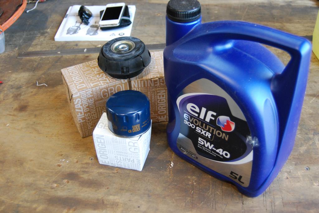

and changed the top mounts and did an oil change
and replaced the KTEC supersport Stealth exhaust for a OEM one.
The Ktec is now up for sale.

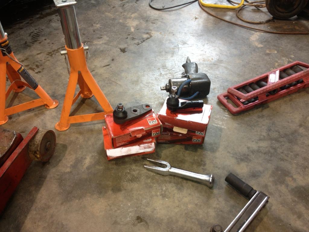

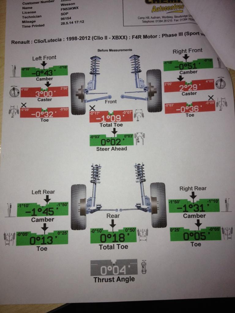

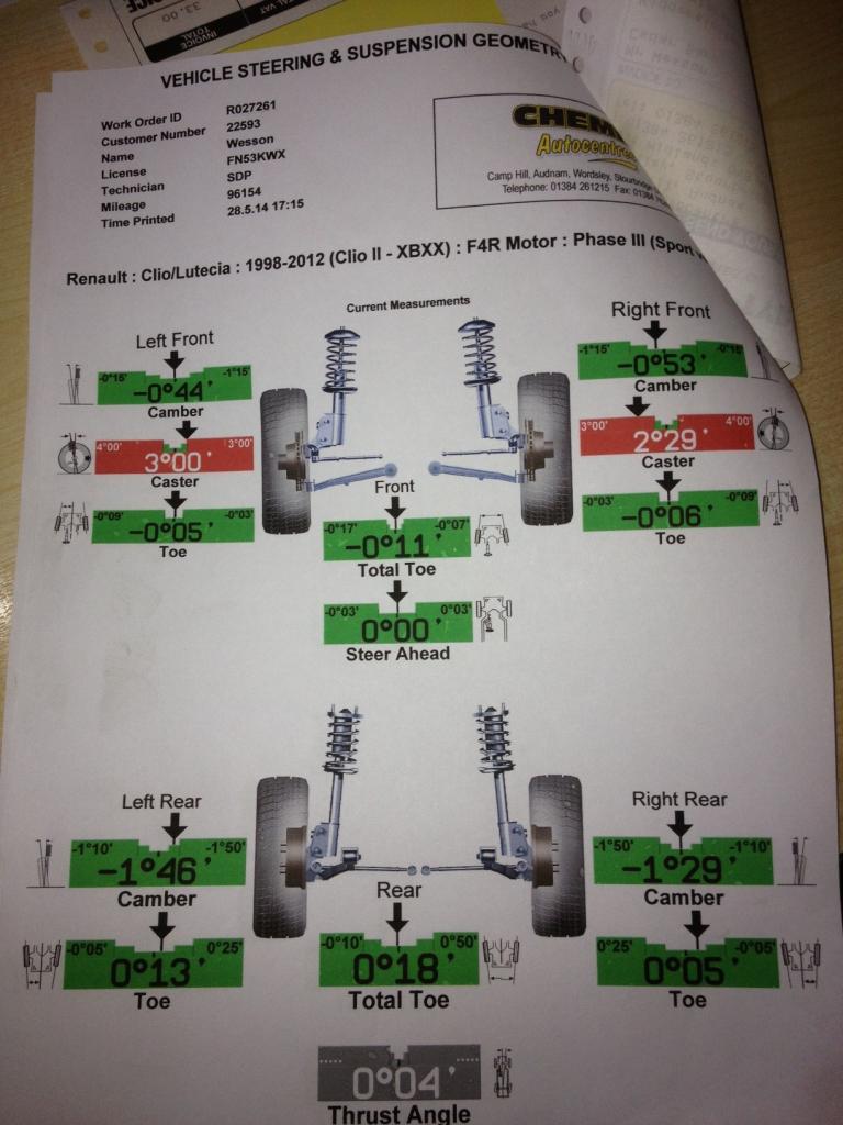

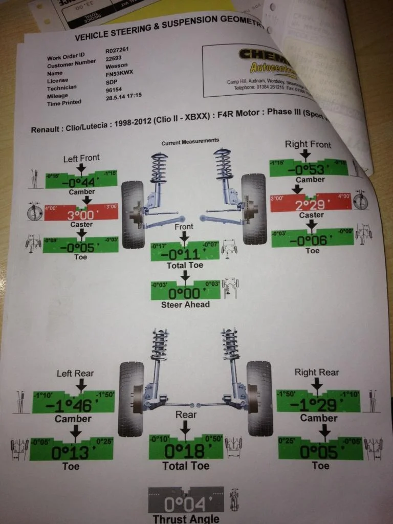

Tonight I fitted new ball joints and track rod ends.
And then had the wheels aligned at Chemix in Stourbridge
Before:
After:
Bit rainy at the moment, but im sure it will be handling much better!

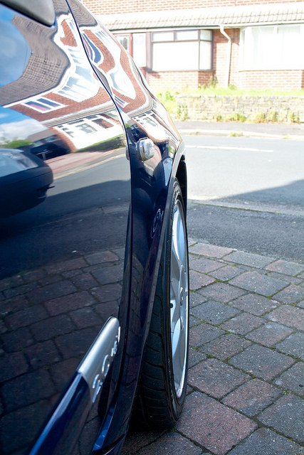

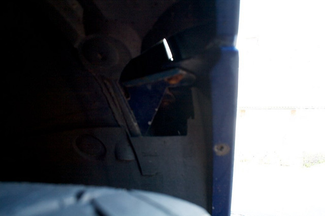

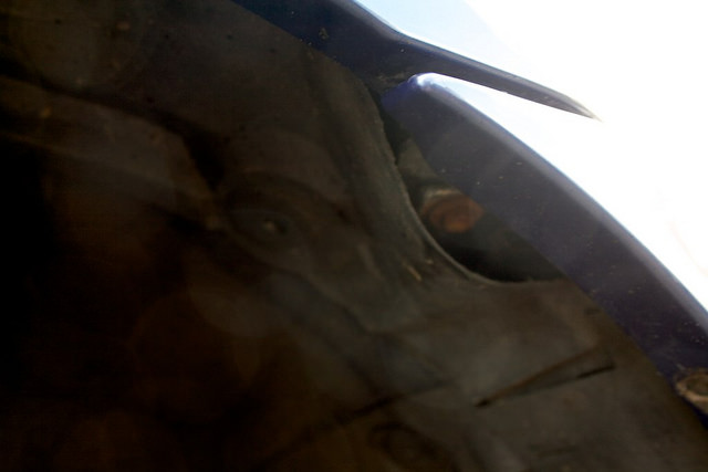

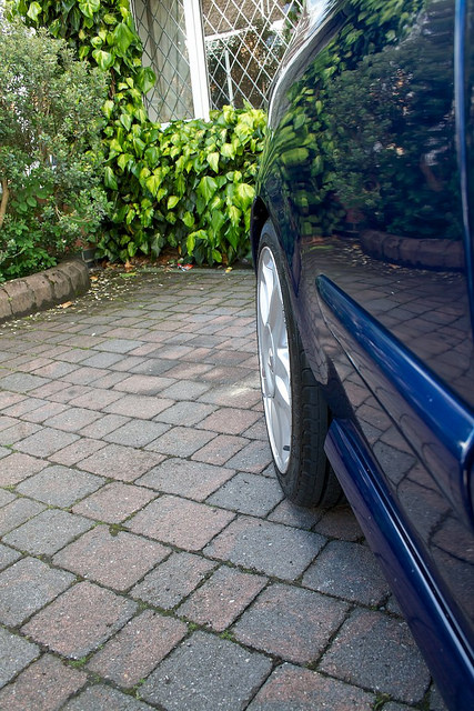

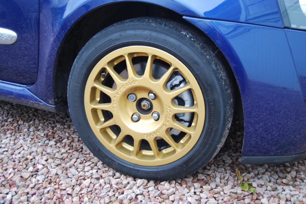

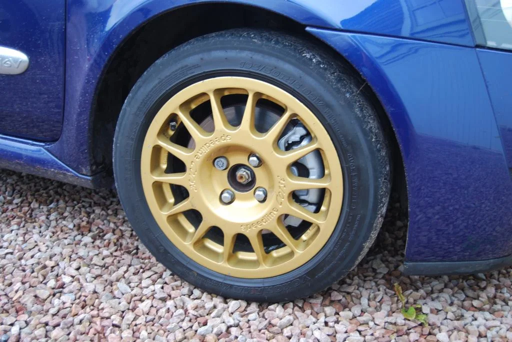

No idea what ET the standard alyum wheels are but I'm running 15mm on the rear and 25mm on the front. The fronts I needed to remove the part of the arch liner that sticks down to allow access to the arch/bumper bolt.
This bit here:
Offending Arch Liner Section by welshname, on Flickr
Voila:
Removed by welshname, on Flickr
And the wheel/spring/spacer combo:
Rear Fitment by welshname, on Flickr
Front Fitment by welshname, on Flickr
Monaco 172 by welshname, on Flickr
Monaco 172 Rear by welshname, on Flickr
