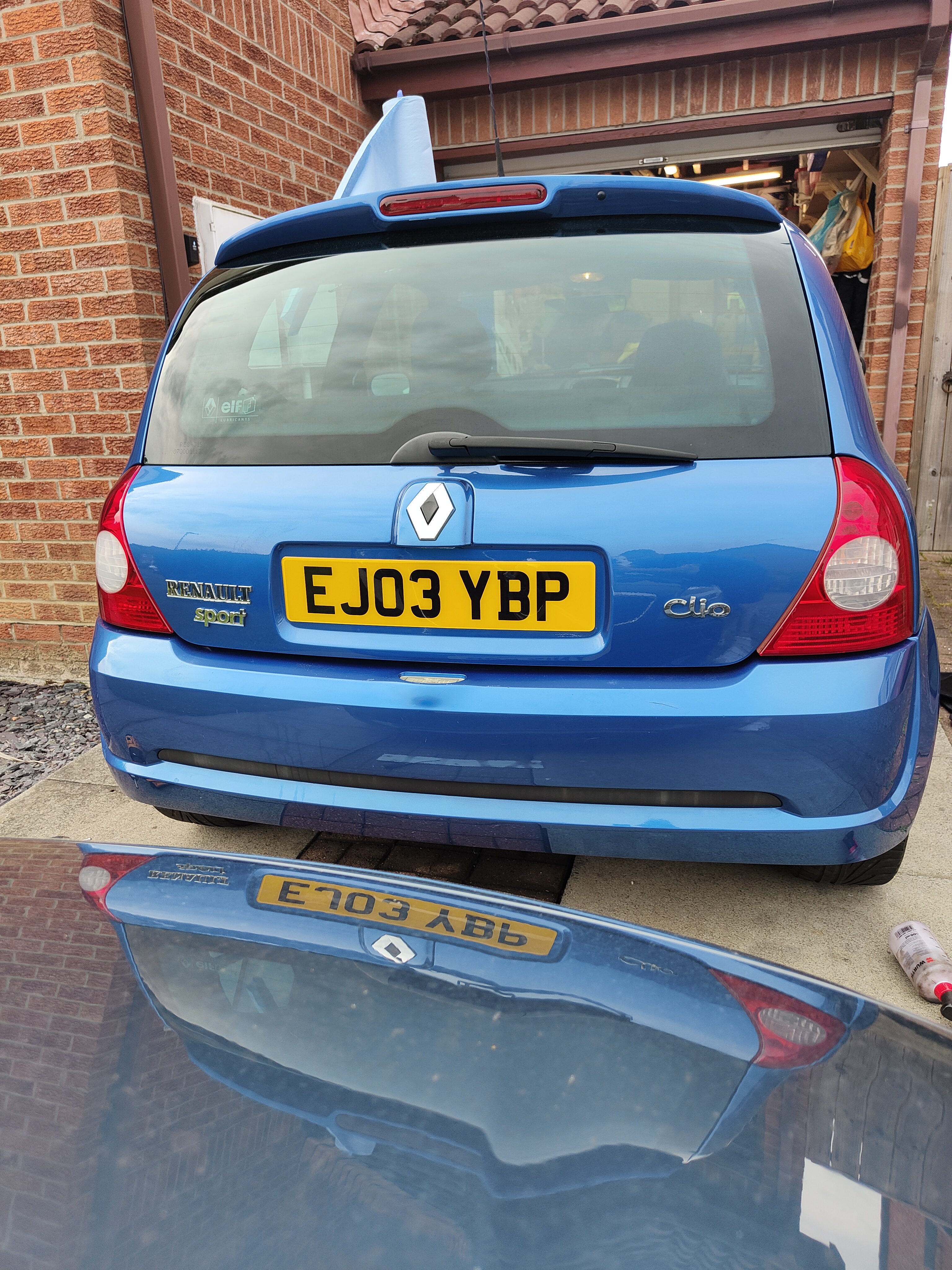

I've recently bought a Mondial Blue 172 cup as a weekend toy, it's a solid car that's clearly been loved by it's previous owners (last owner was a CS member and had it for 10yrs) but as with all things, age and miles take their toll so the intention is to carry out a bit of a rolling restoration while keeping it fairly standard.
I've had it a few weeks now, first job was to give it a deep clean, clay, polish and wet vac the interior, the inside looked clean but the water that came out of the seats was vile :sick:
then put some fresh plates on it, and touch in a load of little stone chips etc
then put some miles on it

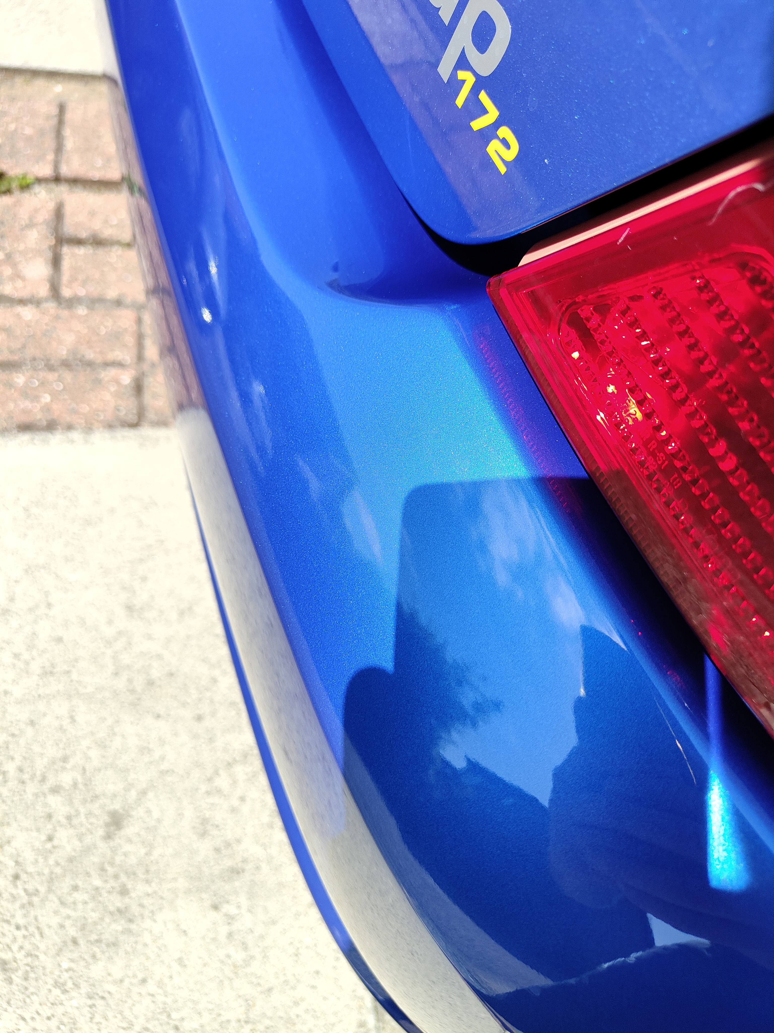

I've had it in the bodyshop this week to get the rear bumper, side strips, door bullets and original gearknob insert painted to tidy it up a bit

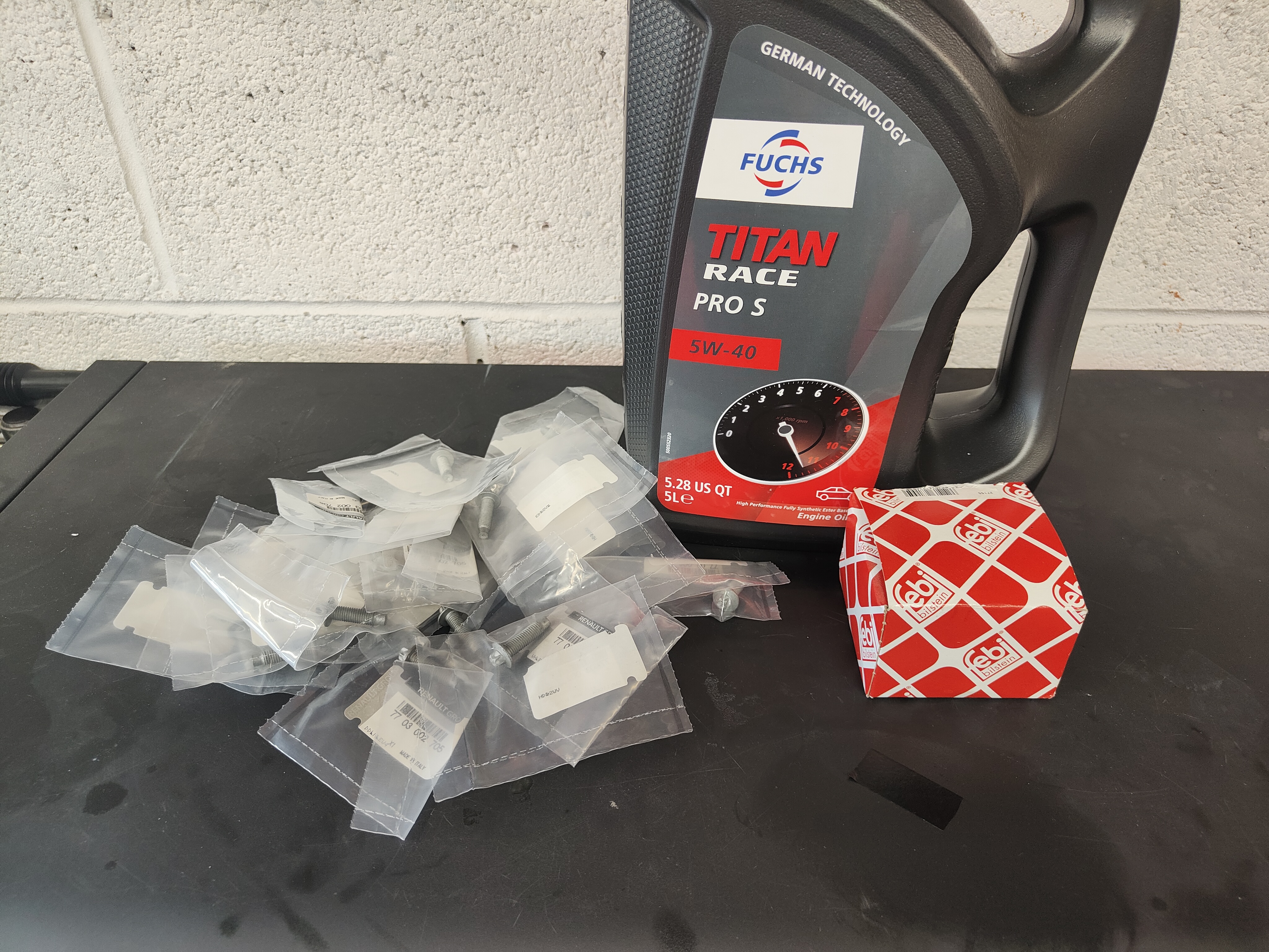

That's it pretty much up to date, I've got a load of service bits to fit - engine and gearbox oil, sump gasket, selector seal & bush and a whiteline rear ARB

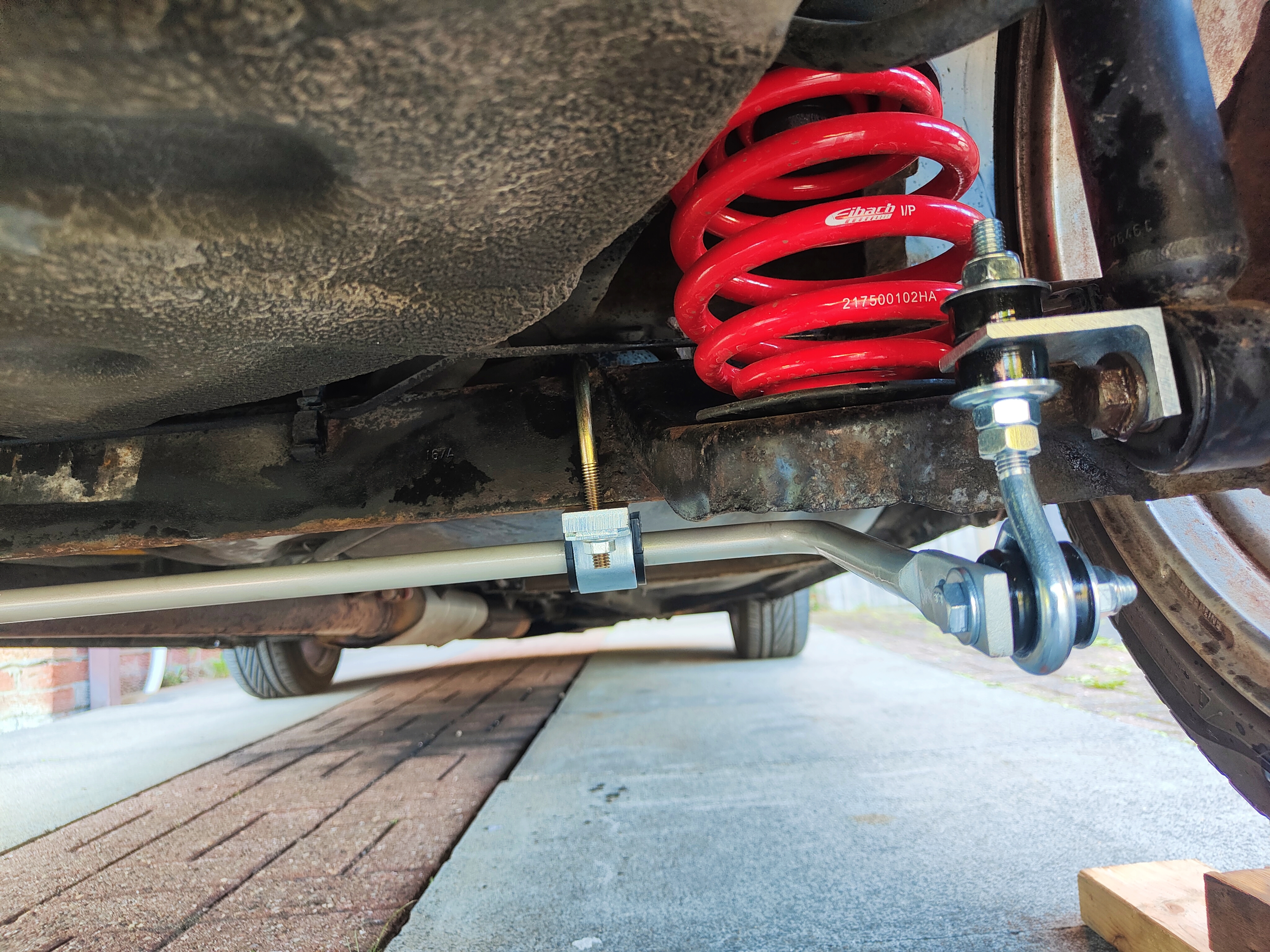

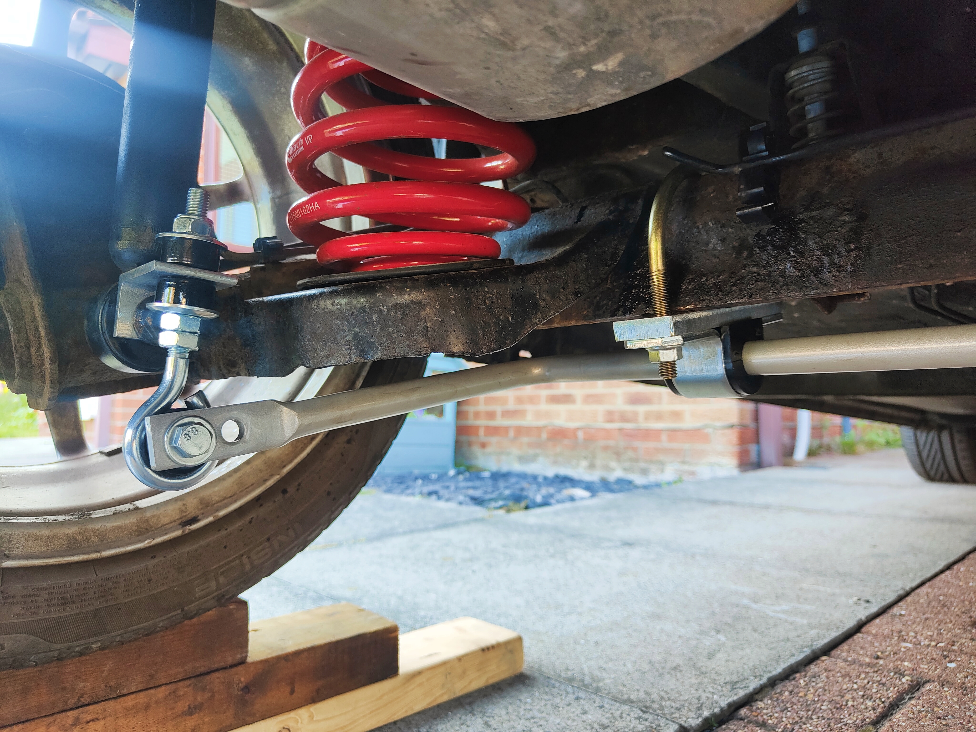

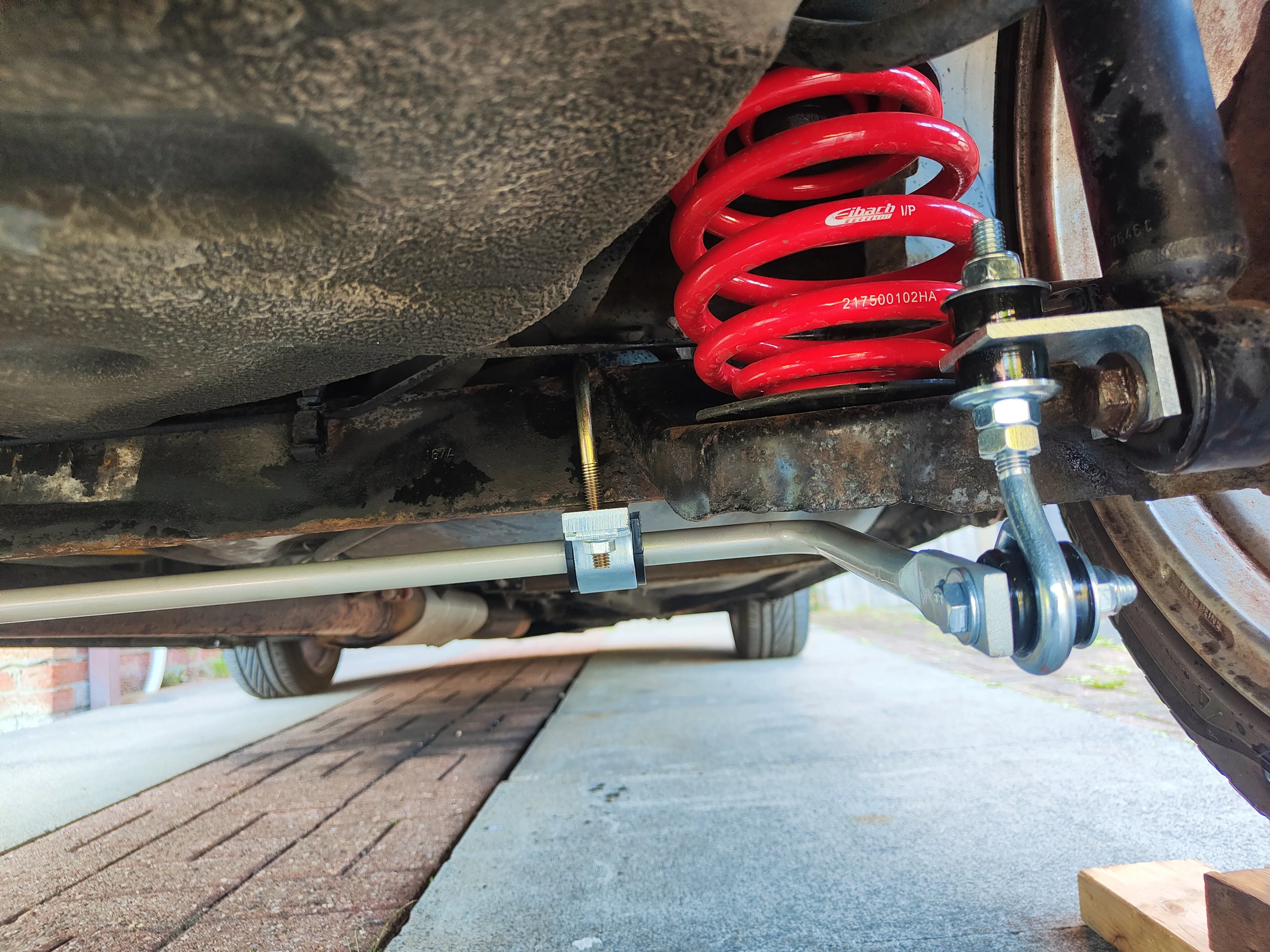

Fitted the whiteline ARB this afternoon, rear beam is a bit scruffy but it's fine for now, I will get round to getting it blasted and powder coated at some point but for now I've given the beam and the ARB a wipe over with some ACF50.

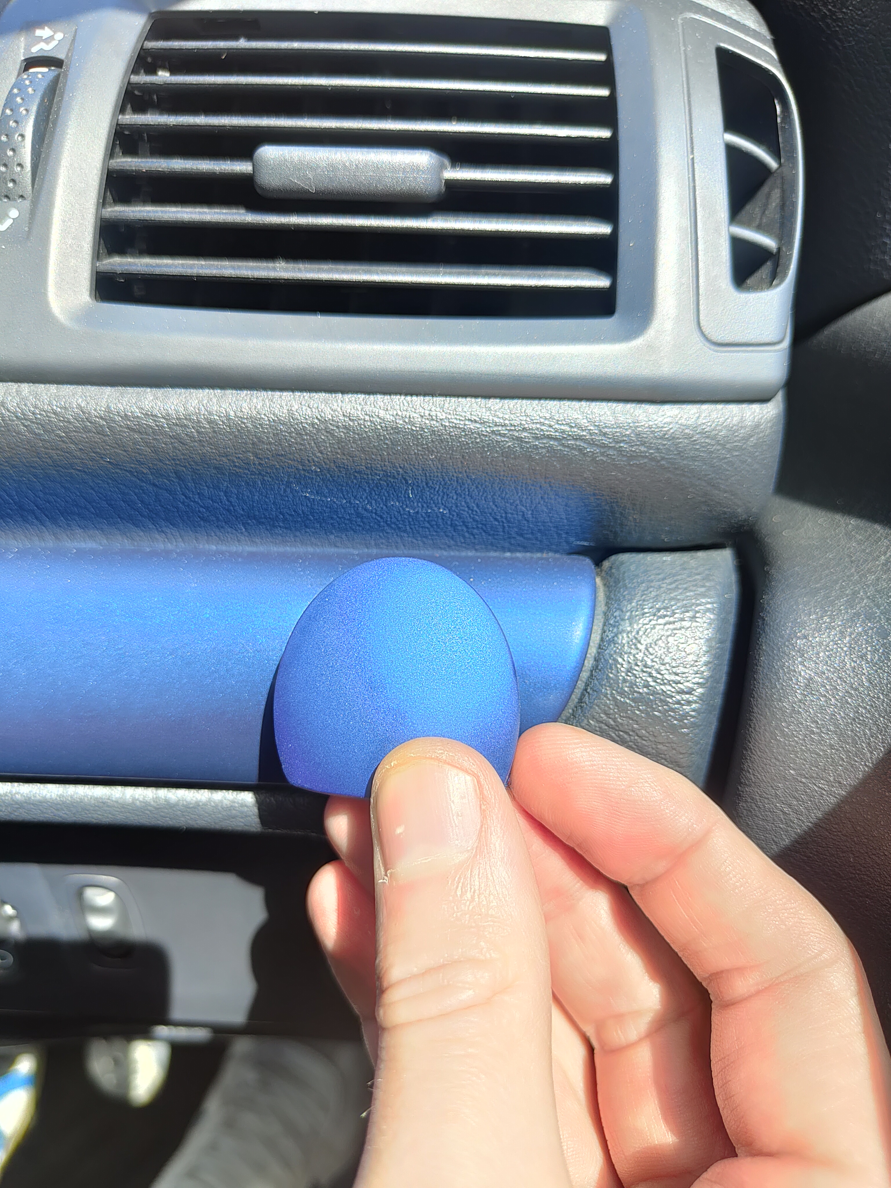

Cleaned off the awful sticky remains of the soft touch coatings with some isopropyl alcohol too..

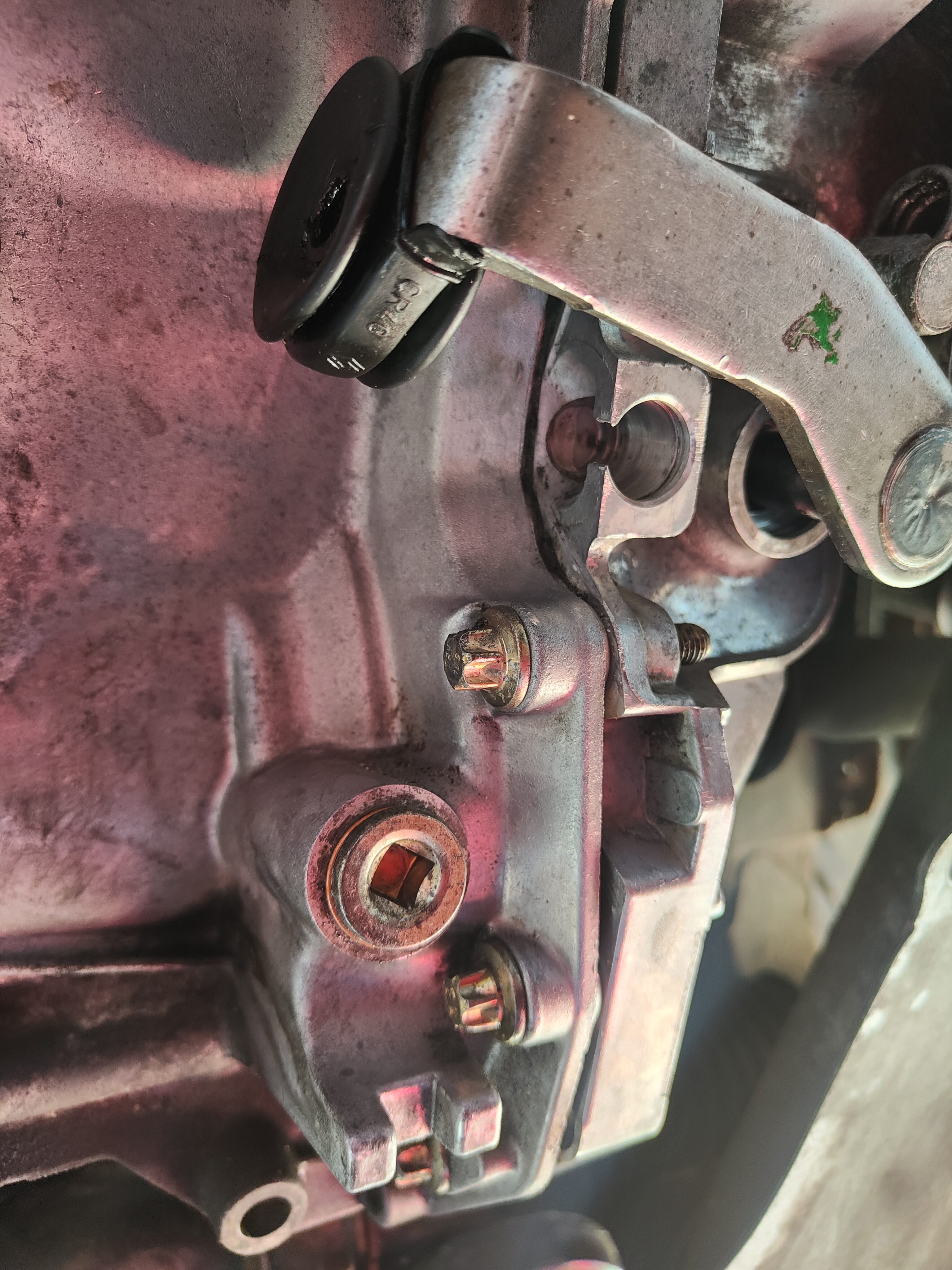

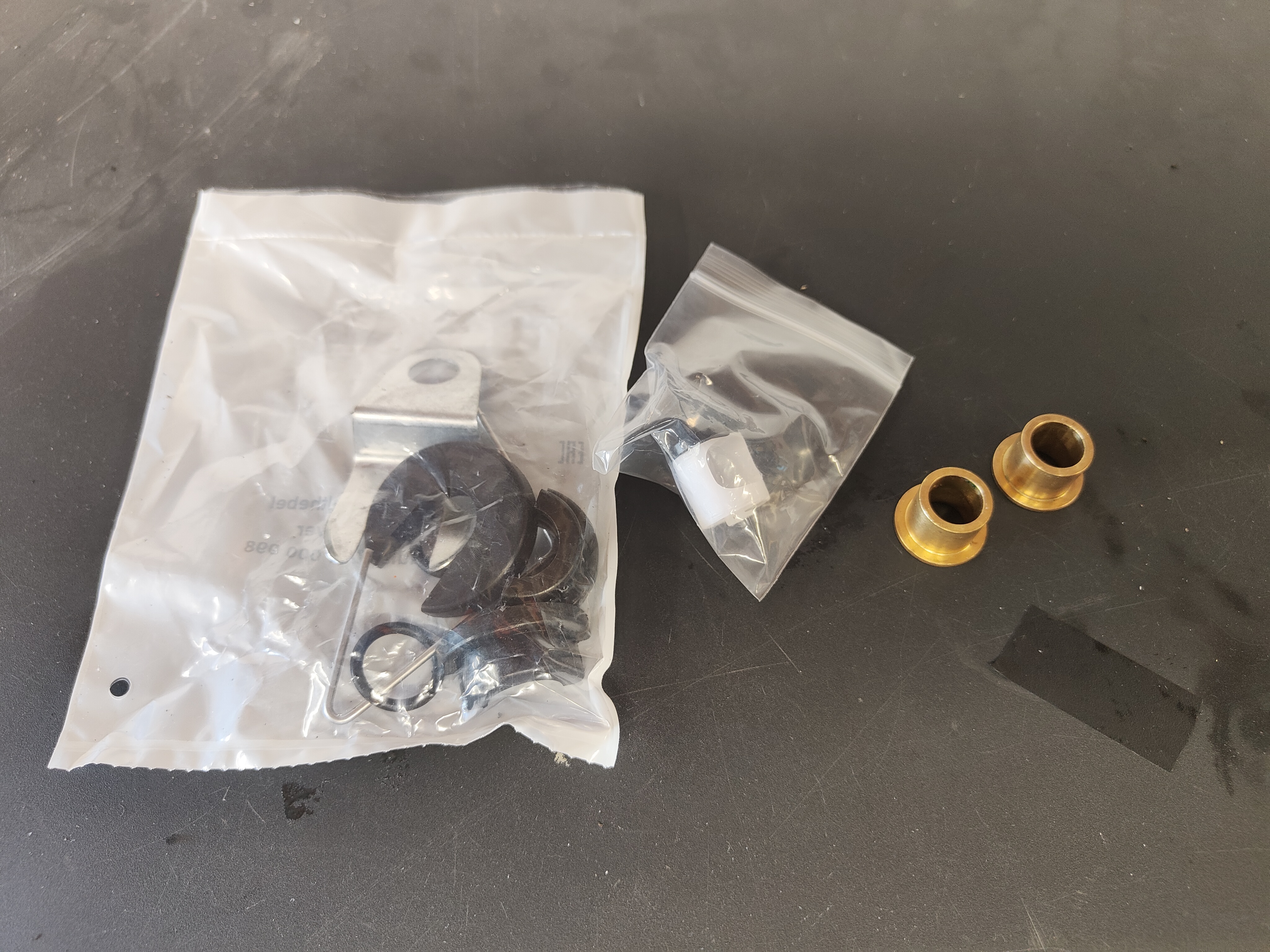

Off work for a couple of weeks so decided to get a couple of jobs done, the previous owner had mentioned a leaky selector seal and weeping sump gasket when I bought it so I knew what was coming...

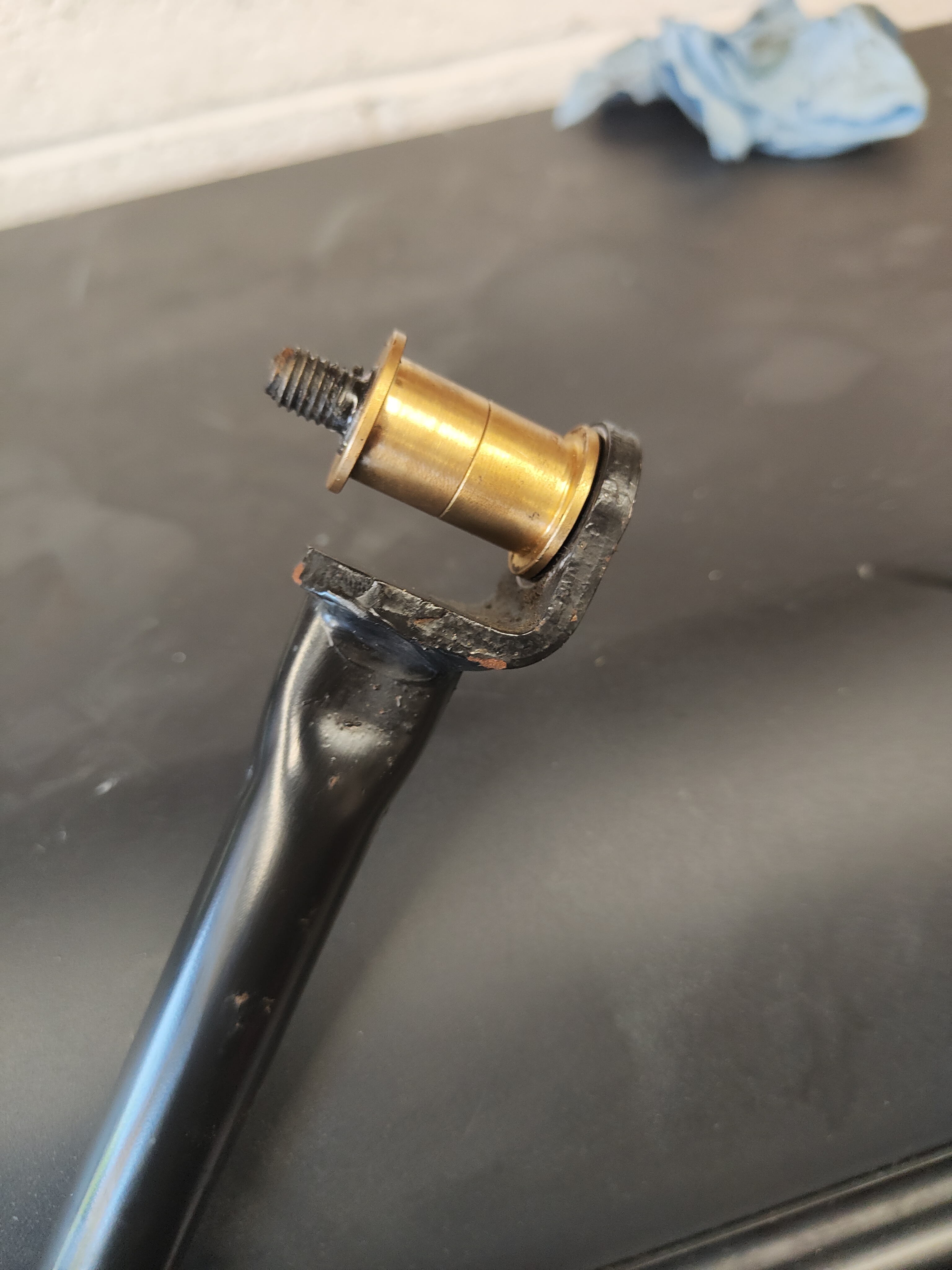

Bought a Febi split seal kit (I know...) And some brass bushes
Got the Jizer out and cleaned off the grime, took it apart and went to fit the half moons of the seal and they were tight.. very tight, even without the O rings. Attempted to put the kit in anyway but they were simply too big, got them knocked in eventually but the selector was so tight it wouldn't even move 🙄. Removed it and ordered a Mapco kit to see if that's any better.

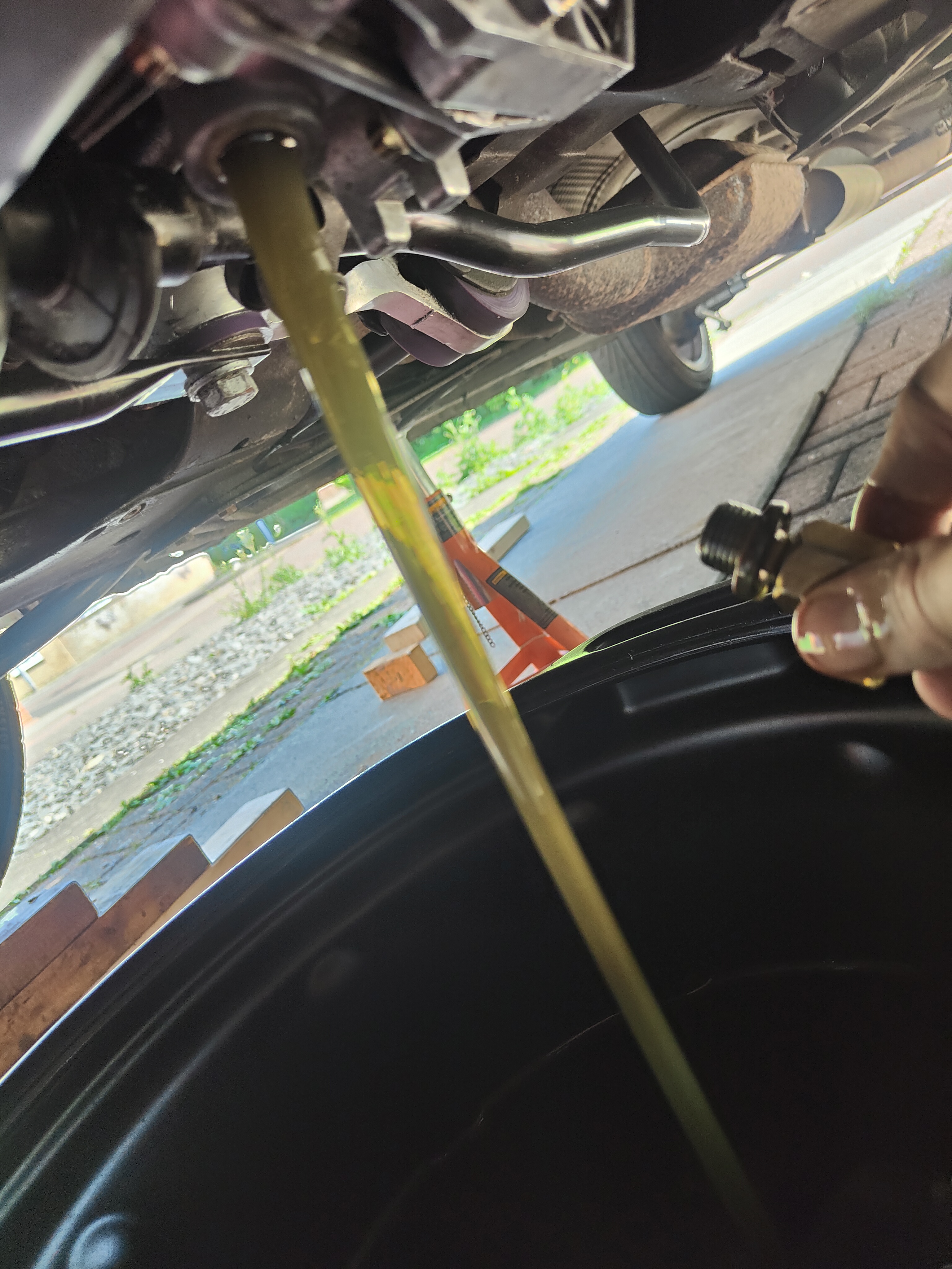

Don't worry.. it gets worse. I drained the oil and it's full of brass. The box has been a bit whiney on overrun since I got it so I'm not really surprised.
It's just going to get a new seal and fresh oil for now, but I'm looking for a used box to get rebuilt with a LSD. Obviously I'm less than delighted after 1000 miles of ownership but these things happen.
Fitted the brass shifter bushes while I was under there too

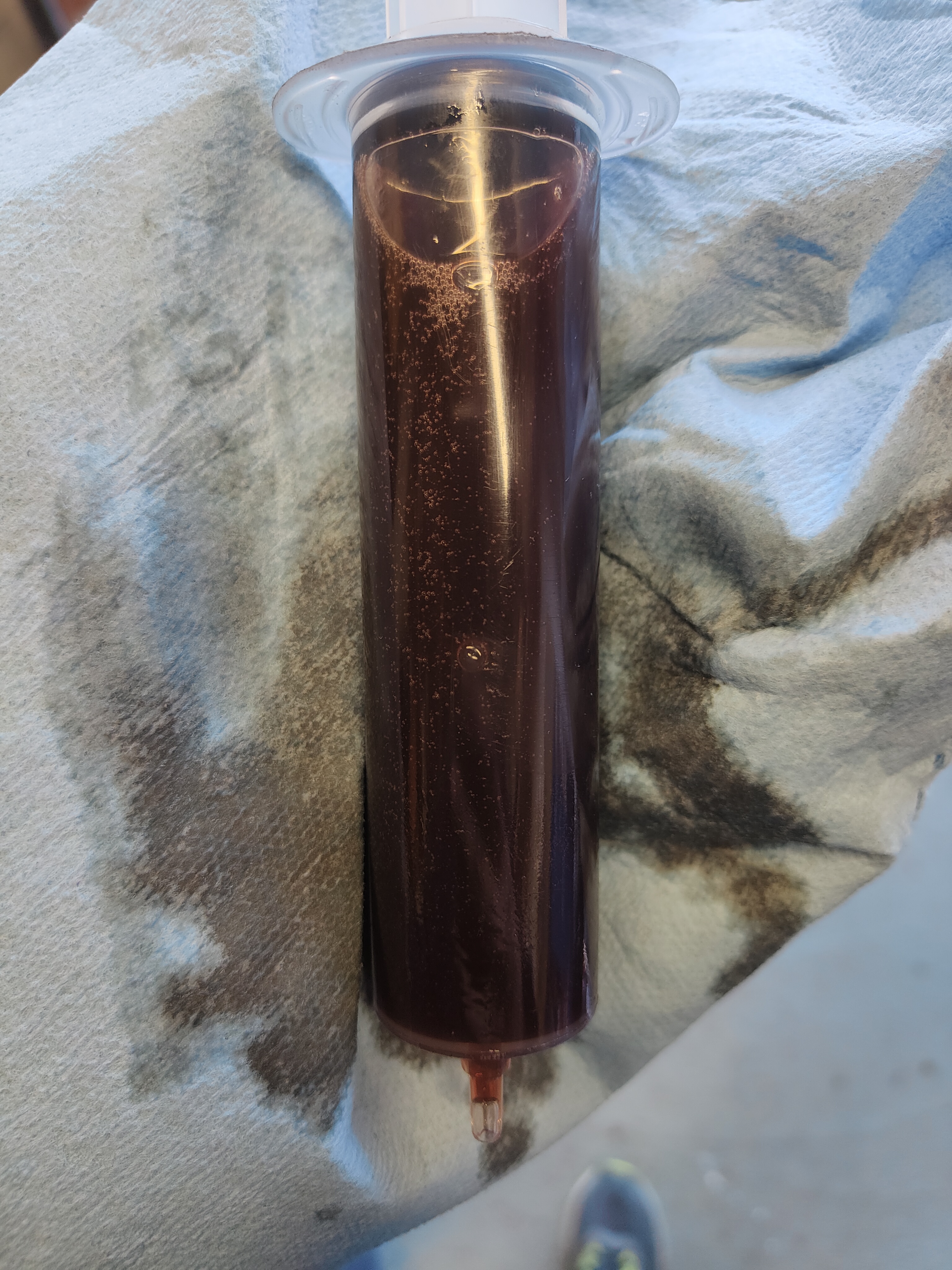

And flushed the PAS fluid with a couple of litres of MOTUL Dex 2 ATF as the old stuff was well overdue

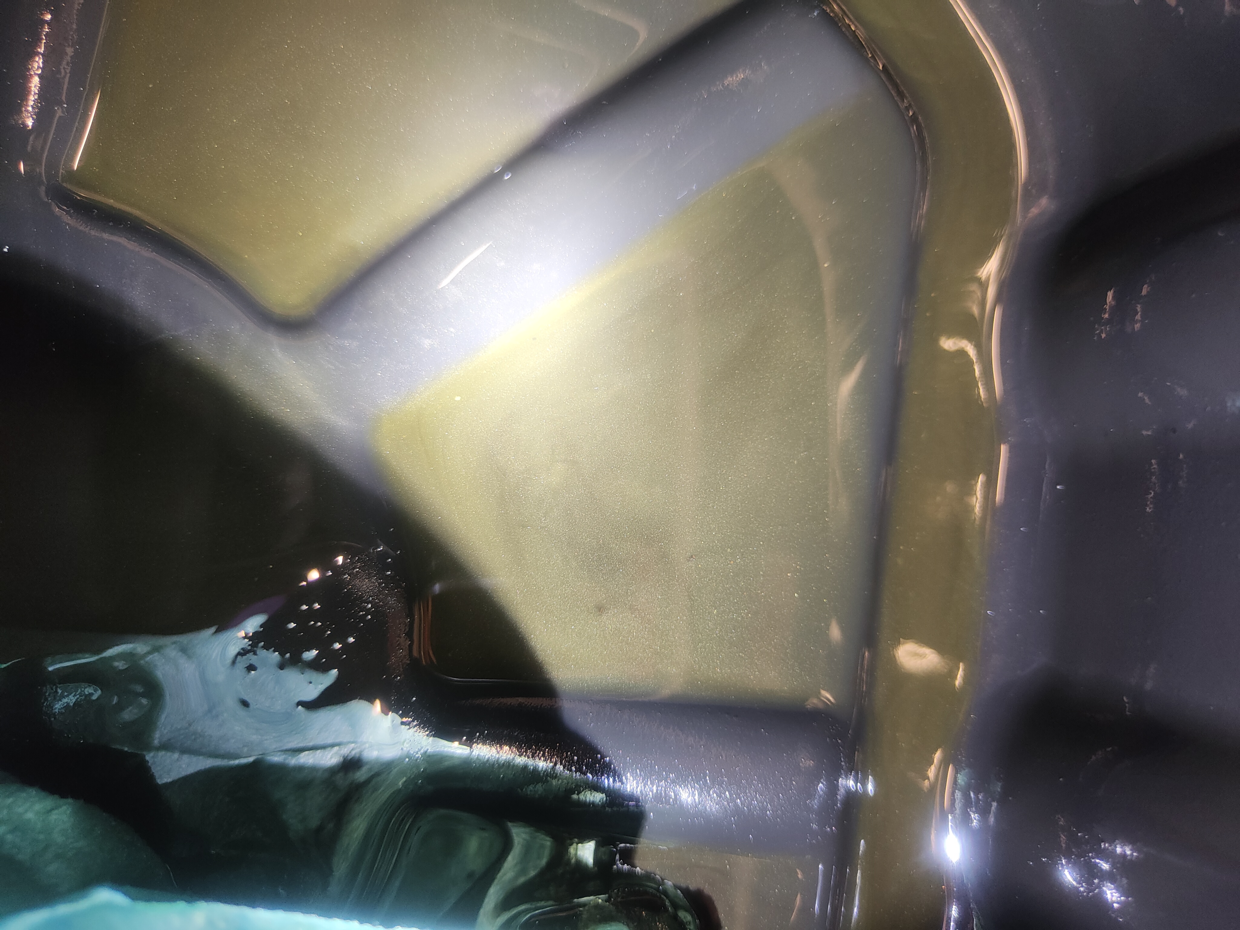

That's the old gear I sucked out of the reservoir to start with, not the worst I've seen but it smelled burnt.

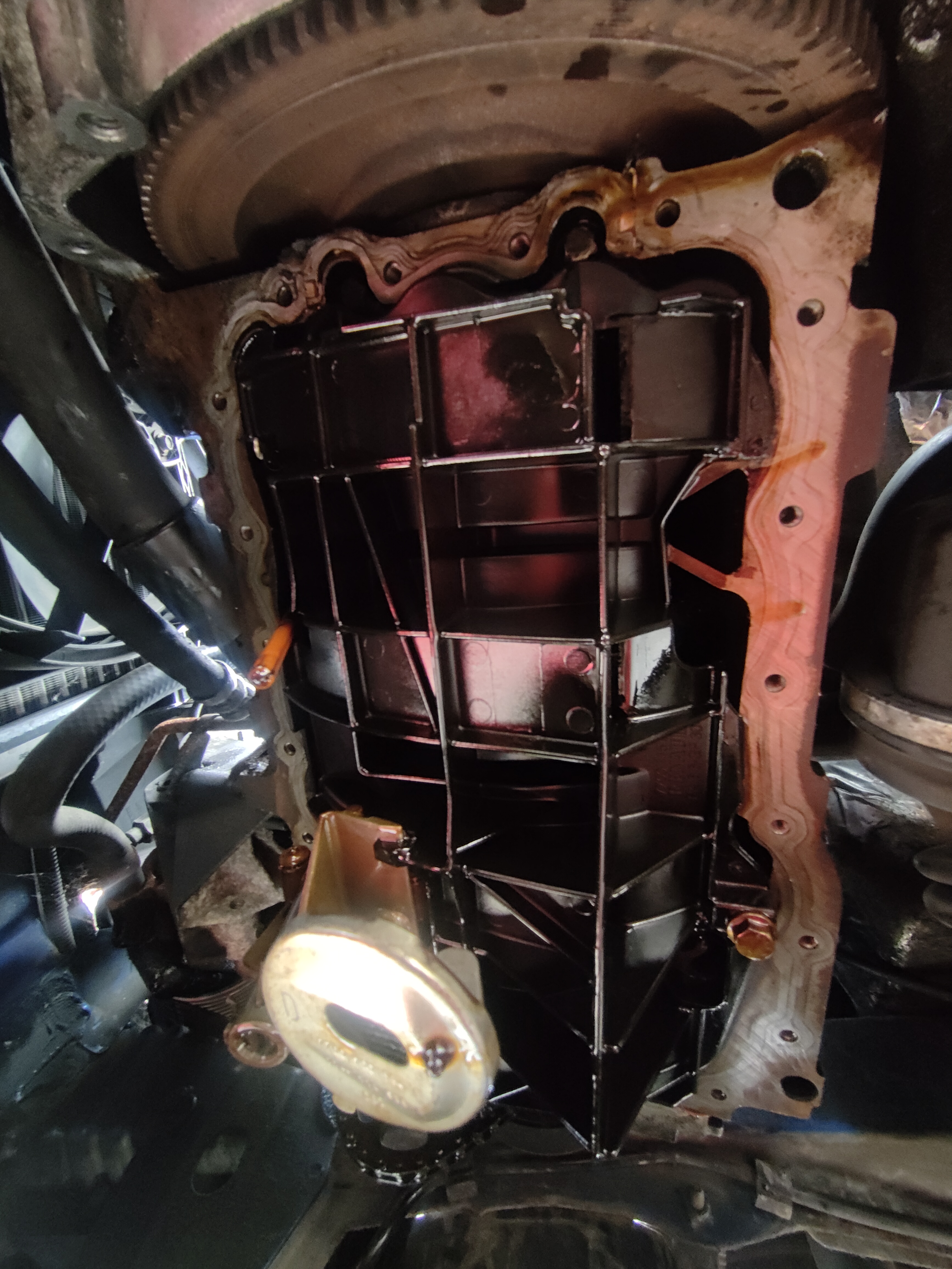

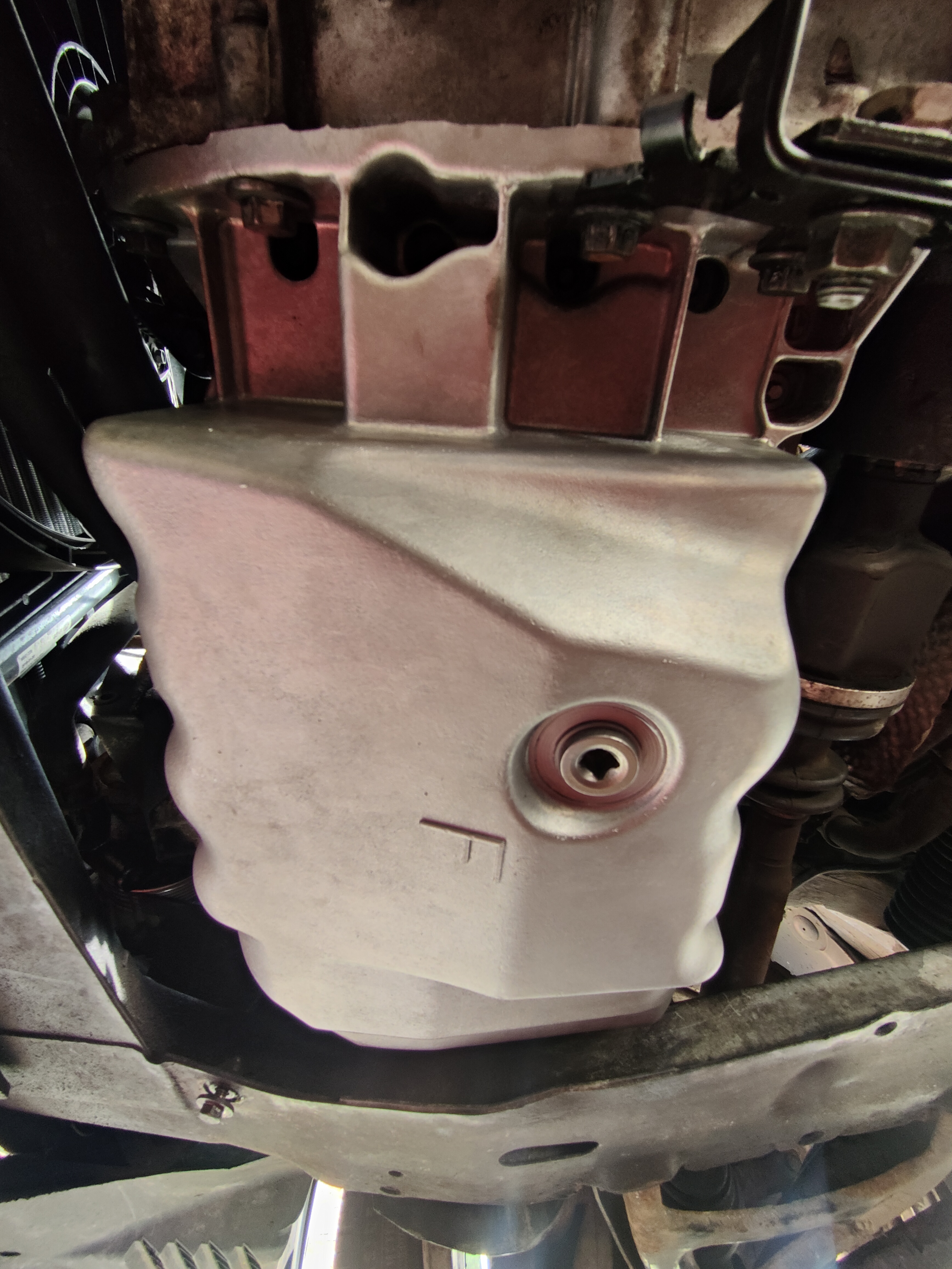

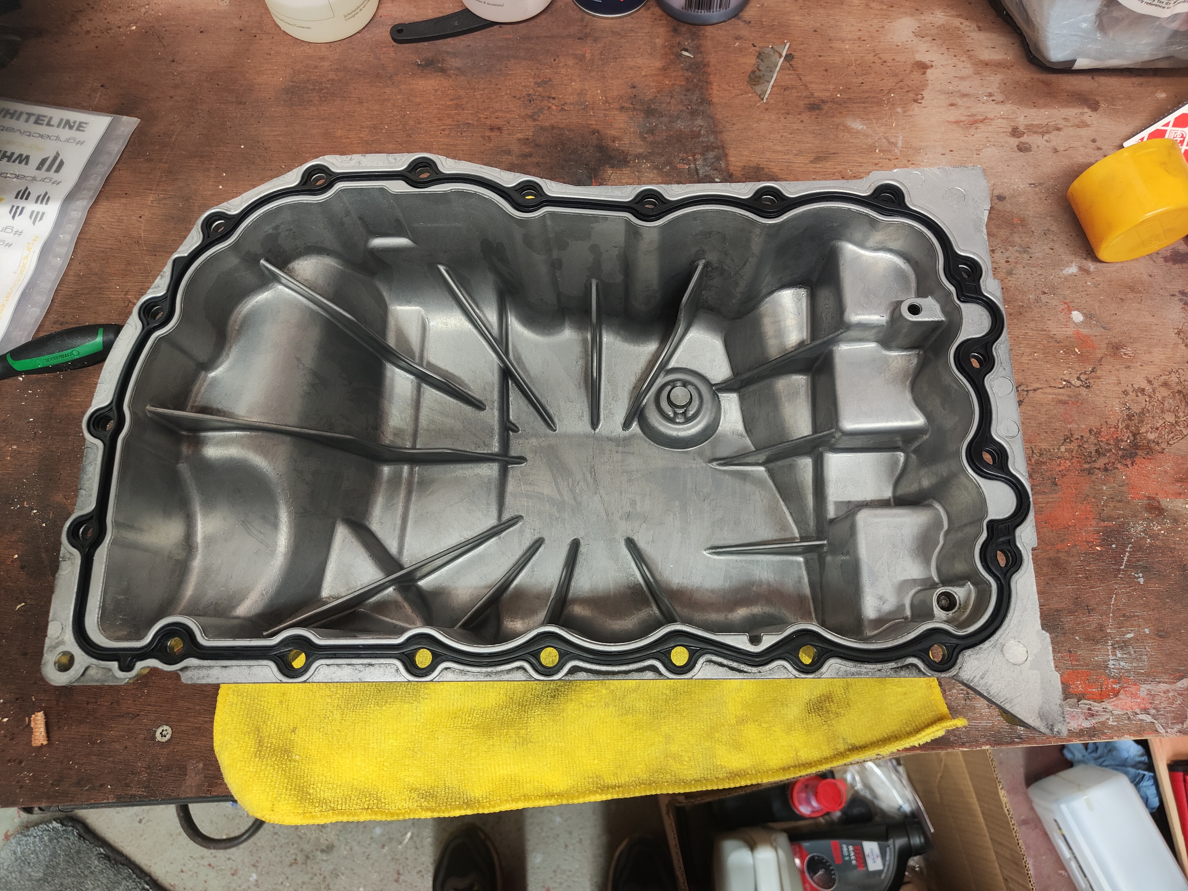

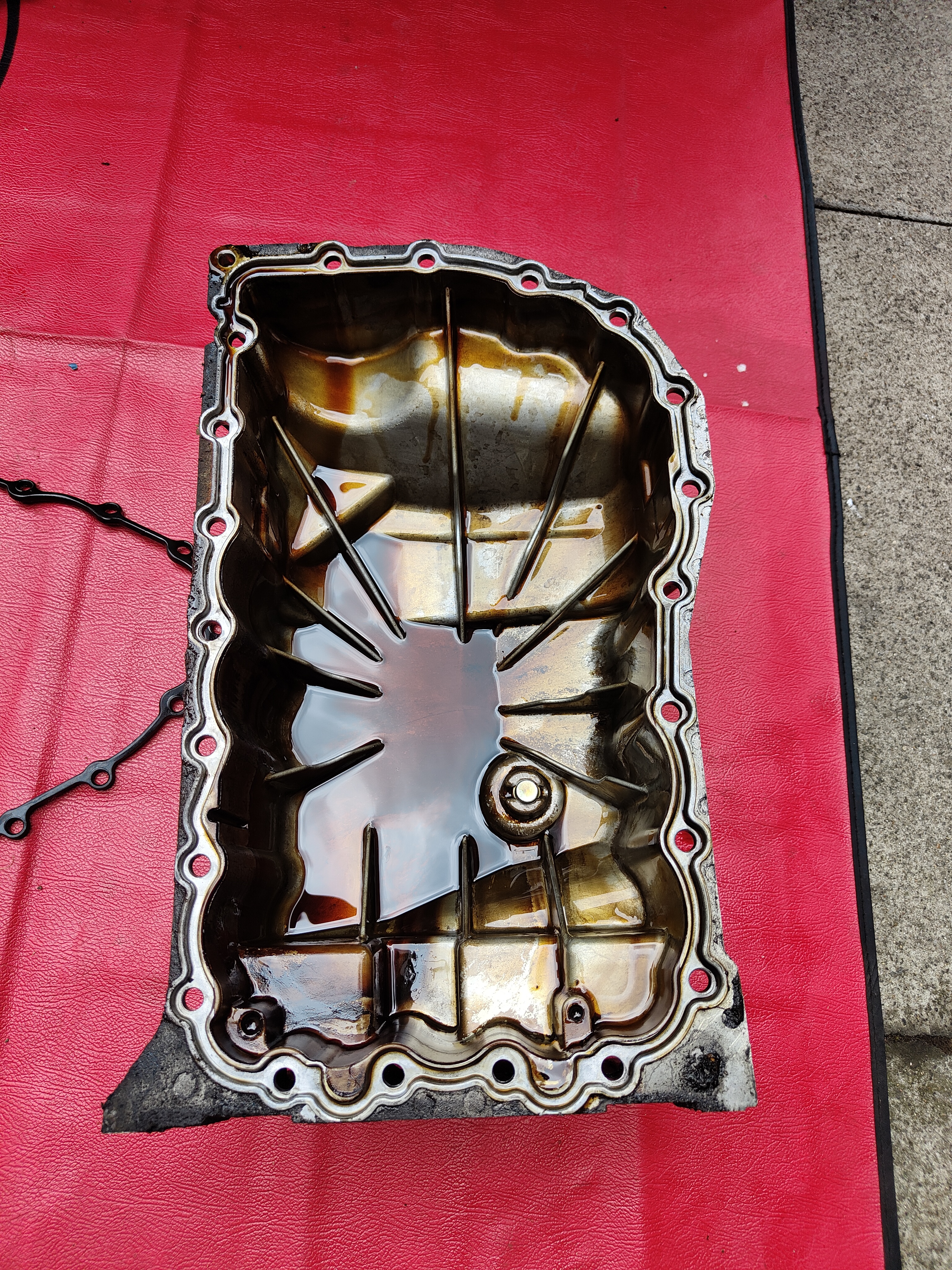

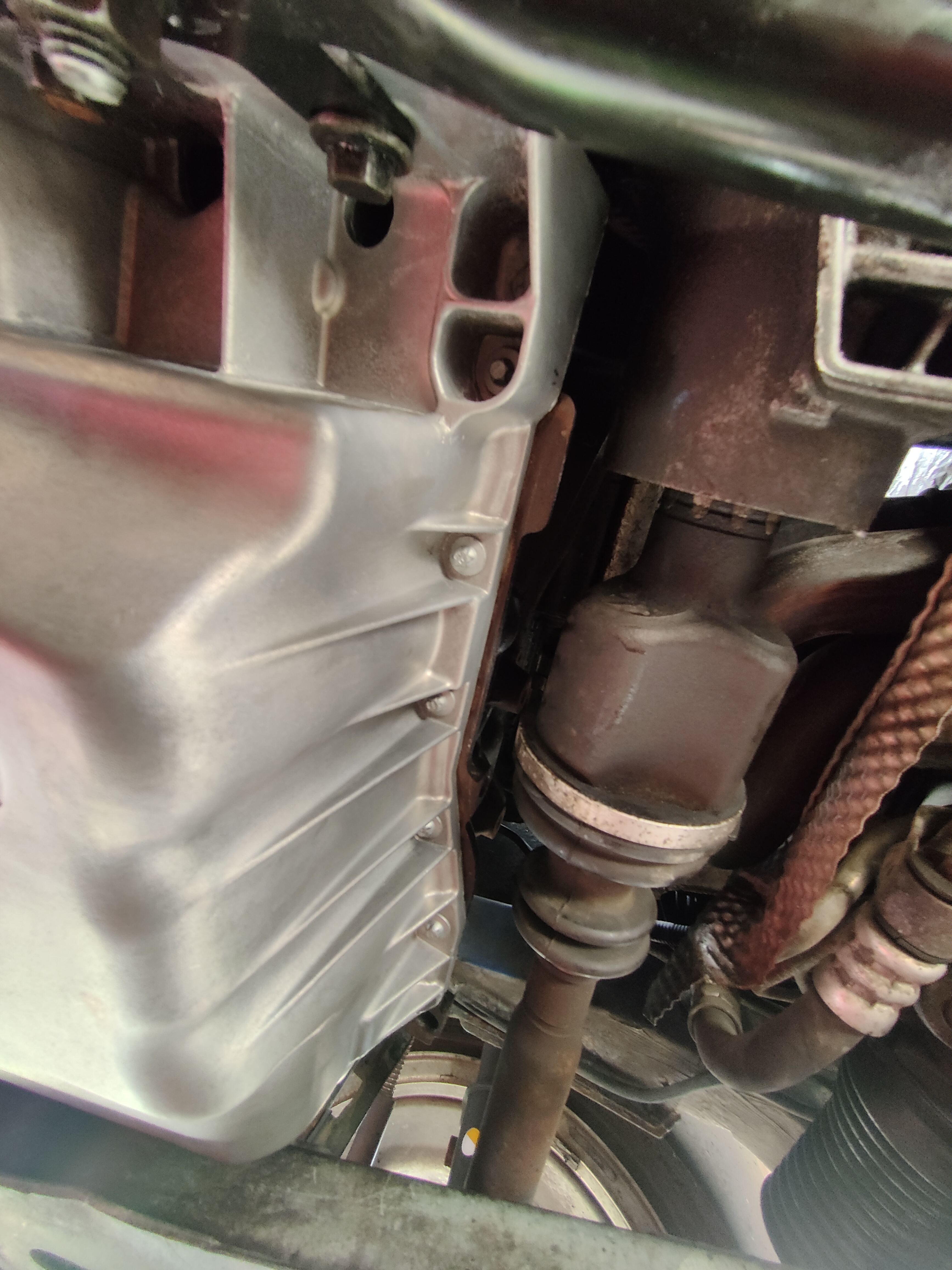

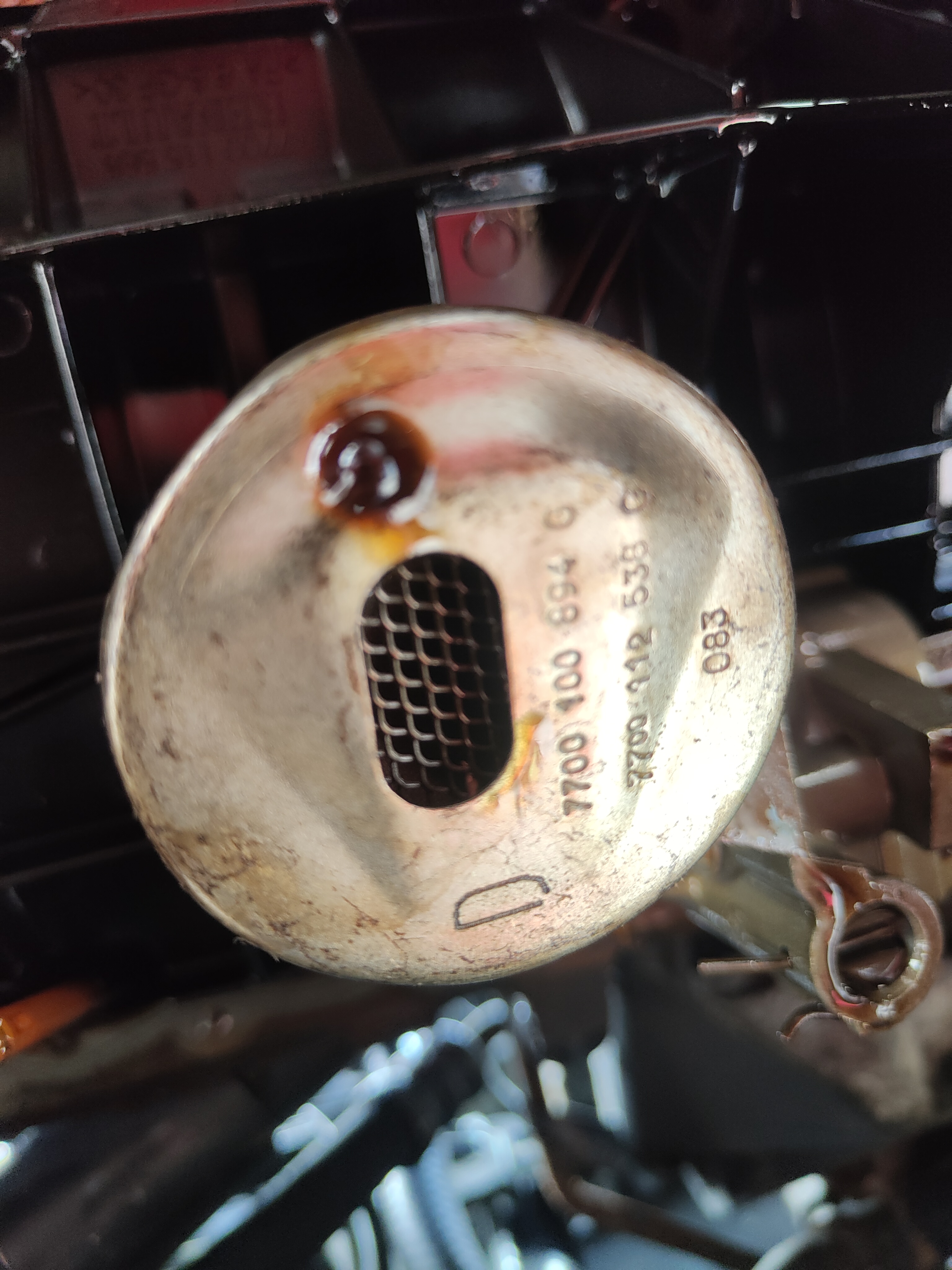

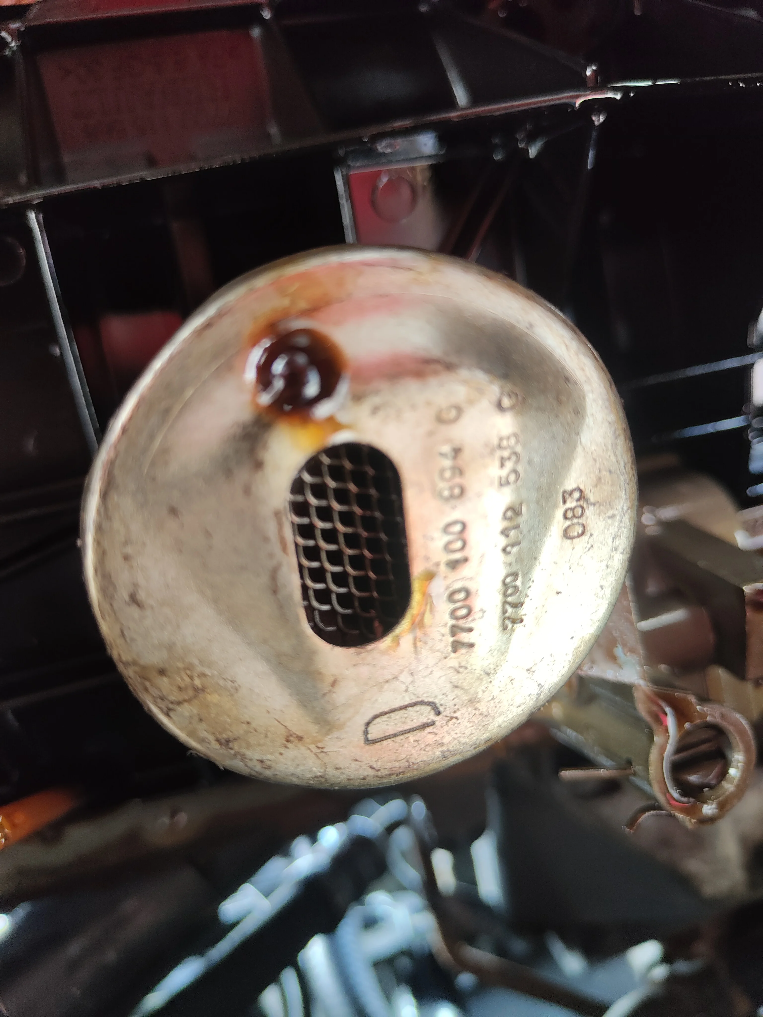

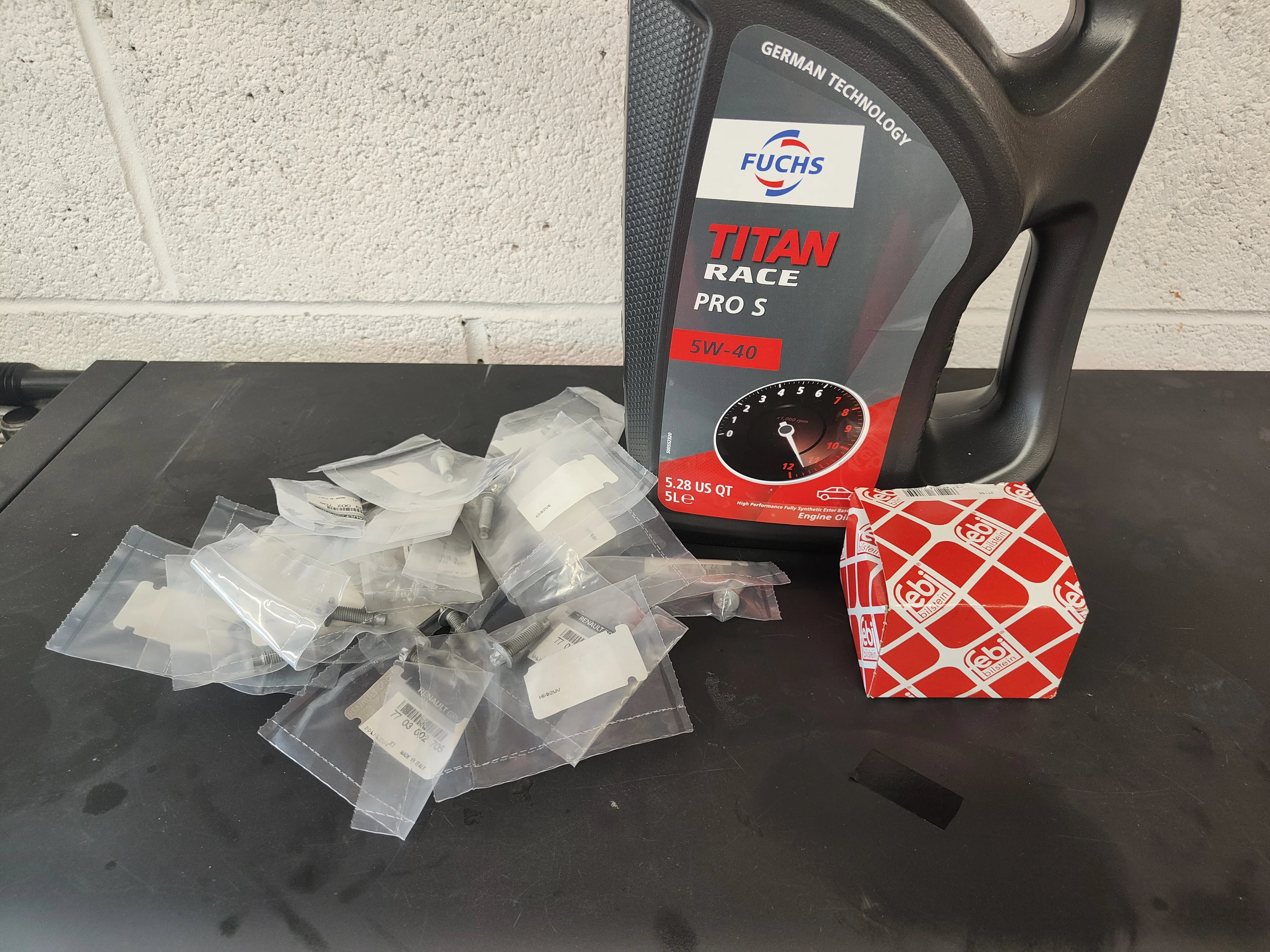

Today was a bit better, jacked the engine up, drained the oil and removed the sump to change the gasket
Sump came off easily with no nasty surprises this time.
New oil, filter and sump bolts to go in.
I started to scrub the grotty sump with Jizer and scotchbrite but quickly got bored and took it somewhere local to get vapour blasted while I waited, much better. New Victor Reinz gasket fitted too.
Mating face on the block cleaned up nicely (after this pic..)
And sump refitted with bolts torqued to spec.

The Mapco/TND selector seal kit arrived today, loads better than the Febi kit, in that it actually fits.
Got that fitted straight away and refilled the gearbox with the correct amount of Millers 75w/80 gearbox oil.
Drove it to the gym this afternoon, everything feels fine. The box still has a very feint whine when coasting, something I'll monitor for now.

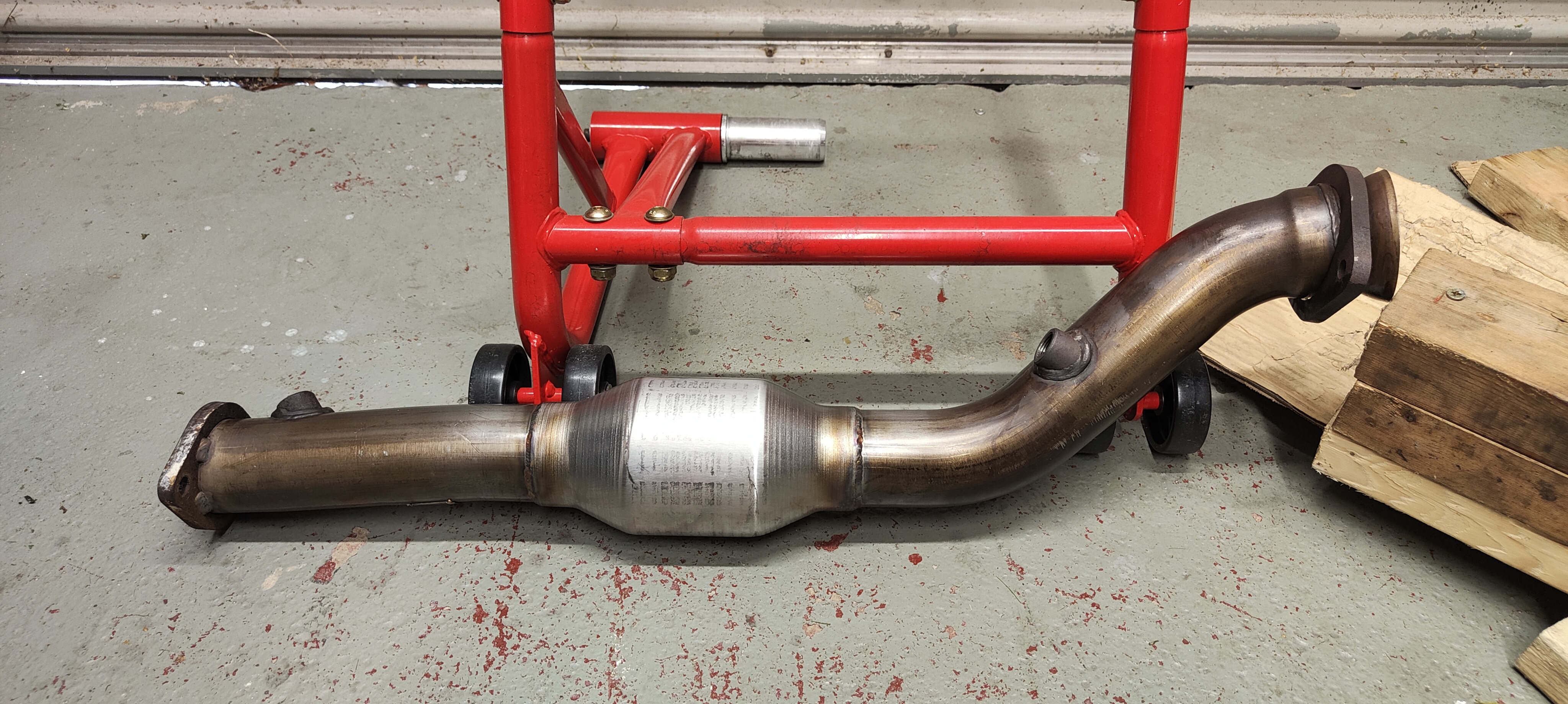

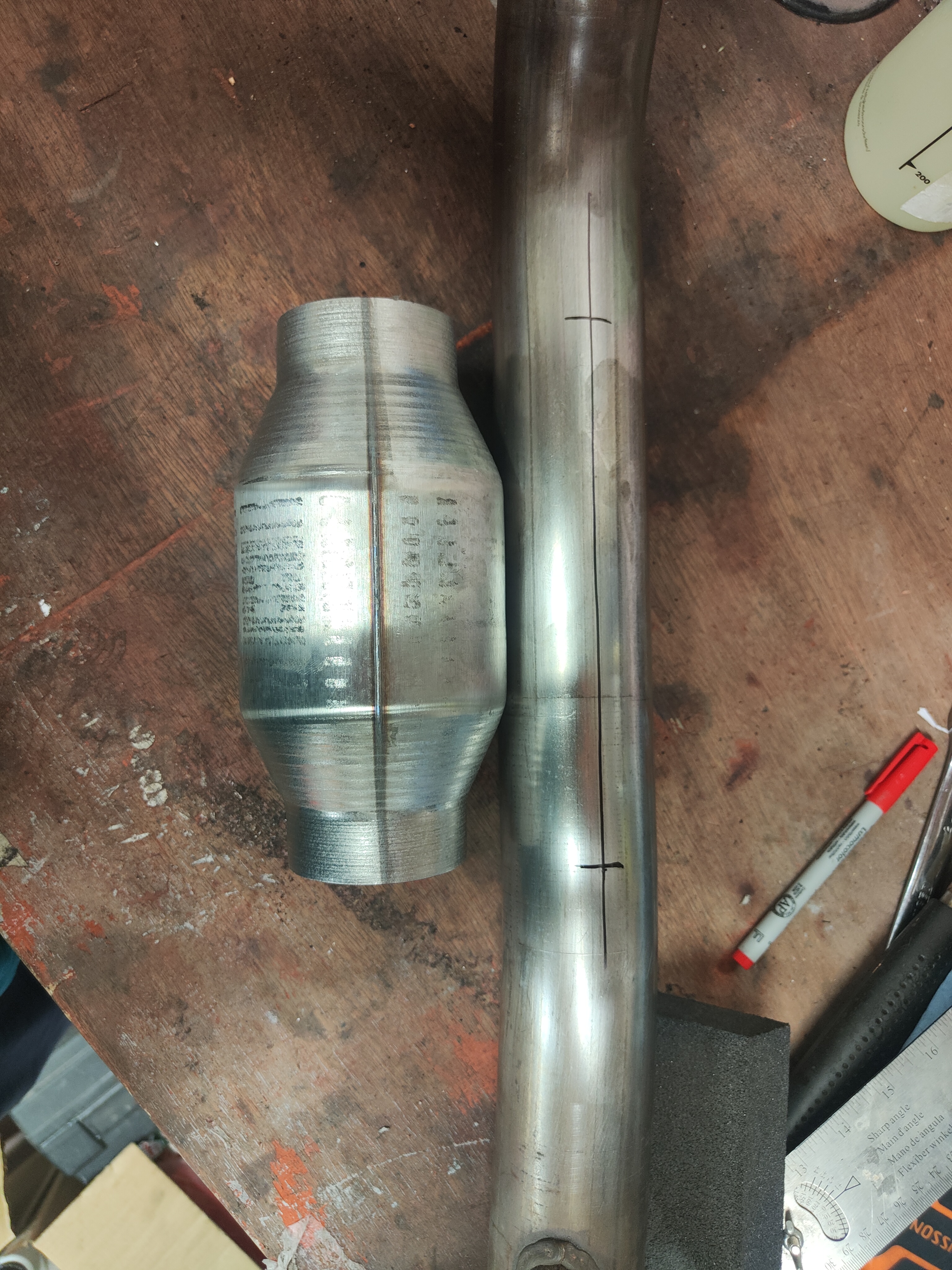

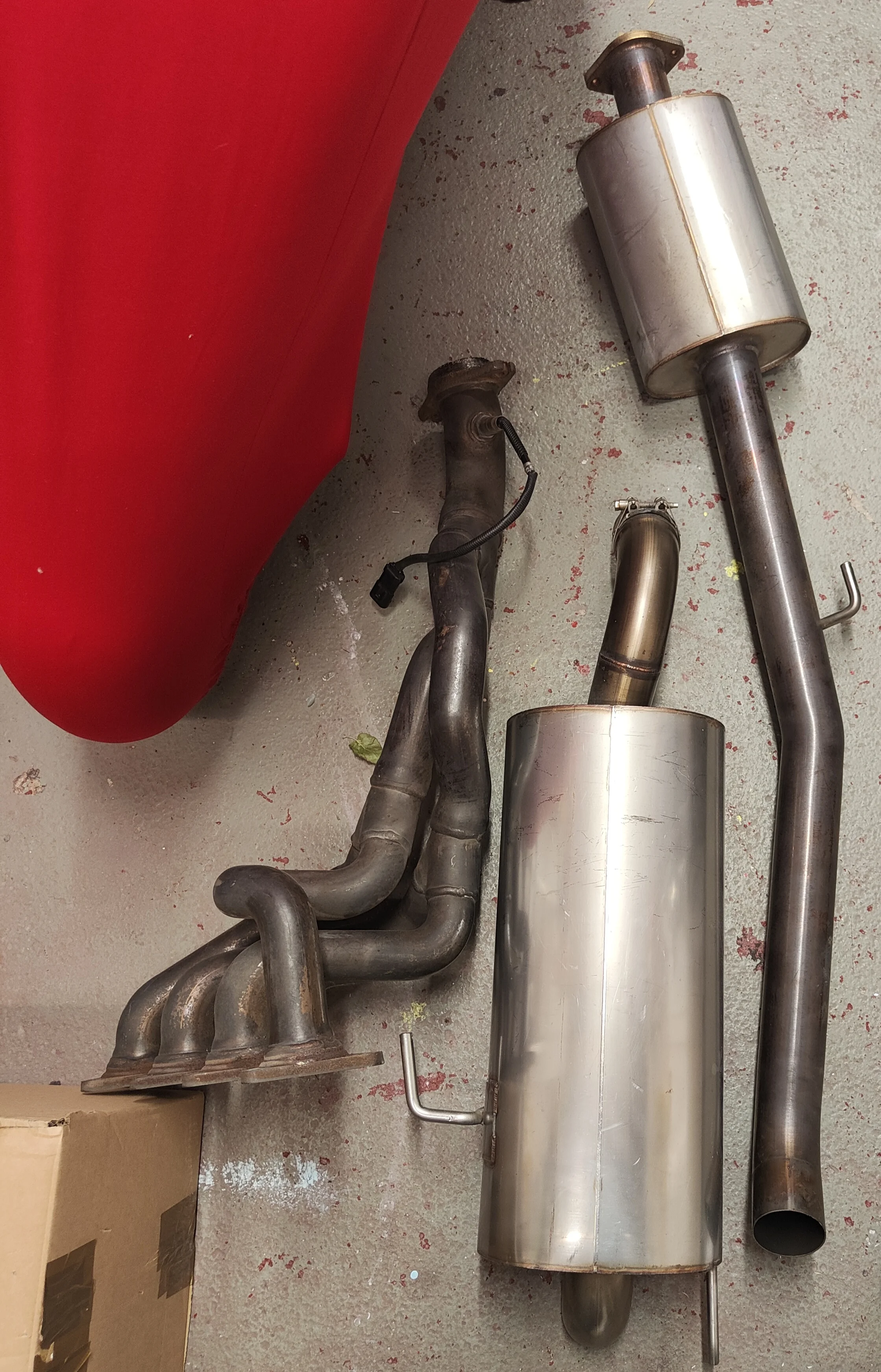

Good news, a little while back I picked up this lovely BTB exhaust & 182 manifold.

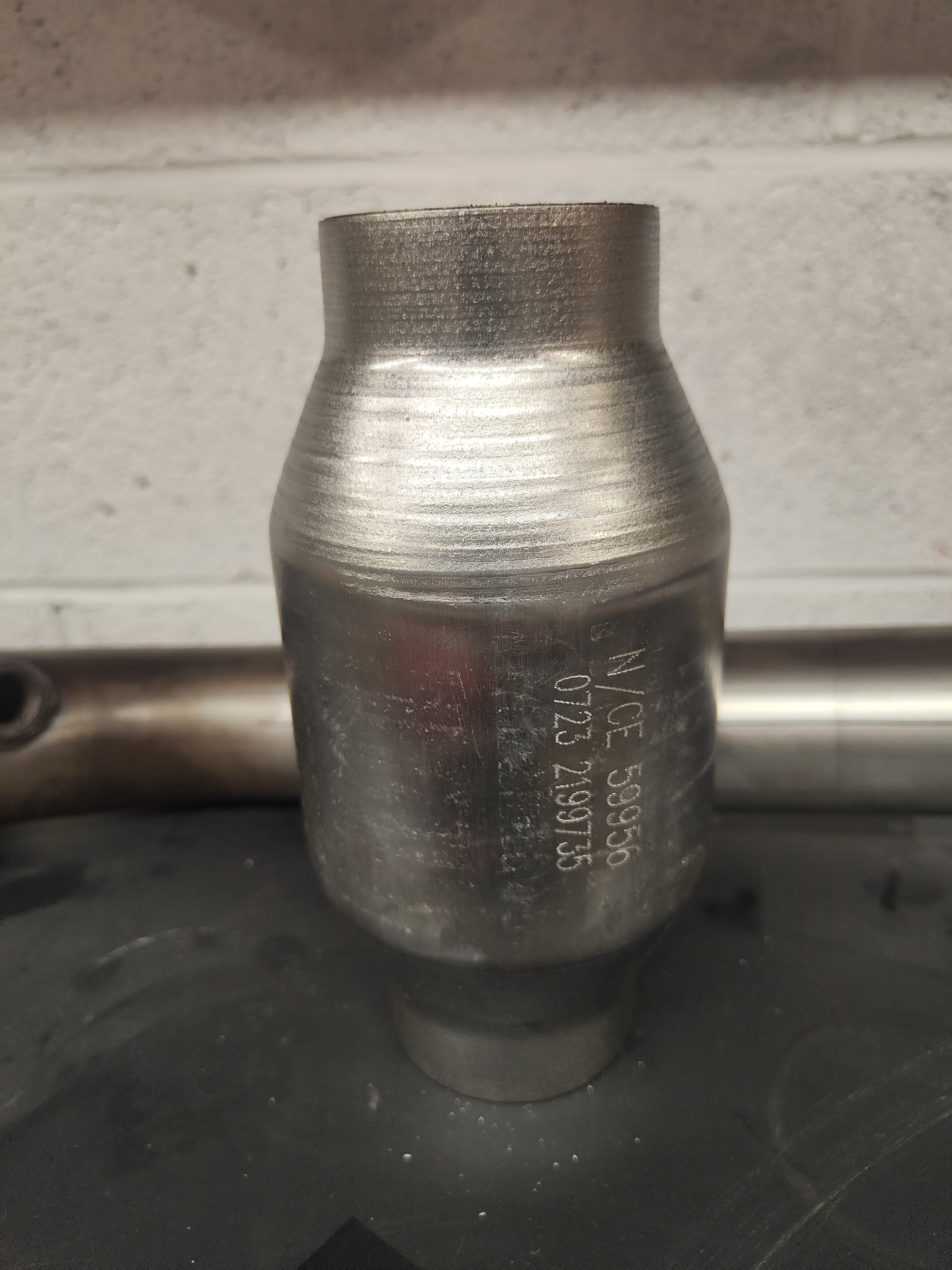

I then spotted a 172 Milltek decat pipe on eBay, thought it would be a good idea to buy it and get a magnaflow sports cat welded into it
I could have stainless MIG'd it myself, but there's a lad local to me who TIG'd it together for less than it would have cost me to get some more stainless mig gas.
I'm really happy with that, I've chased the lambda boss threads out and stuck it in the corner of the garage for now.

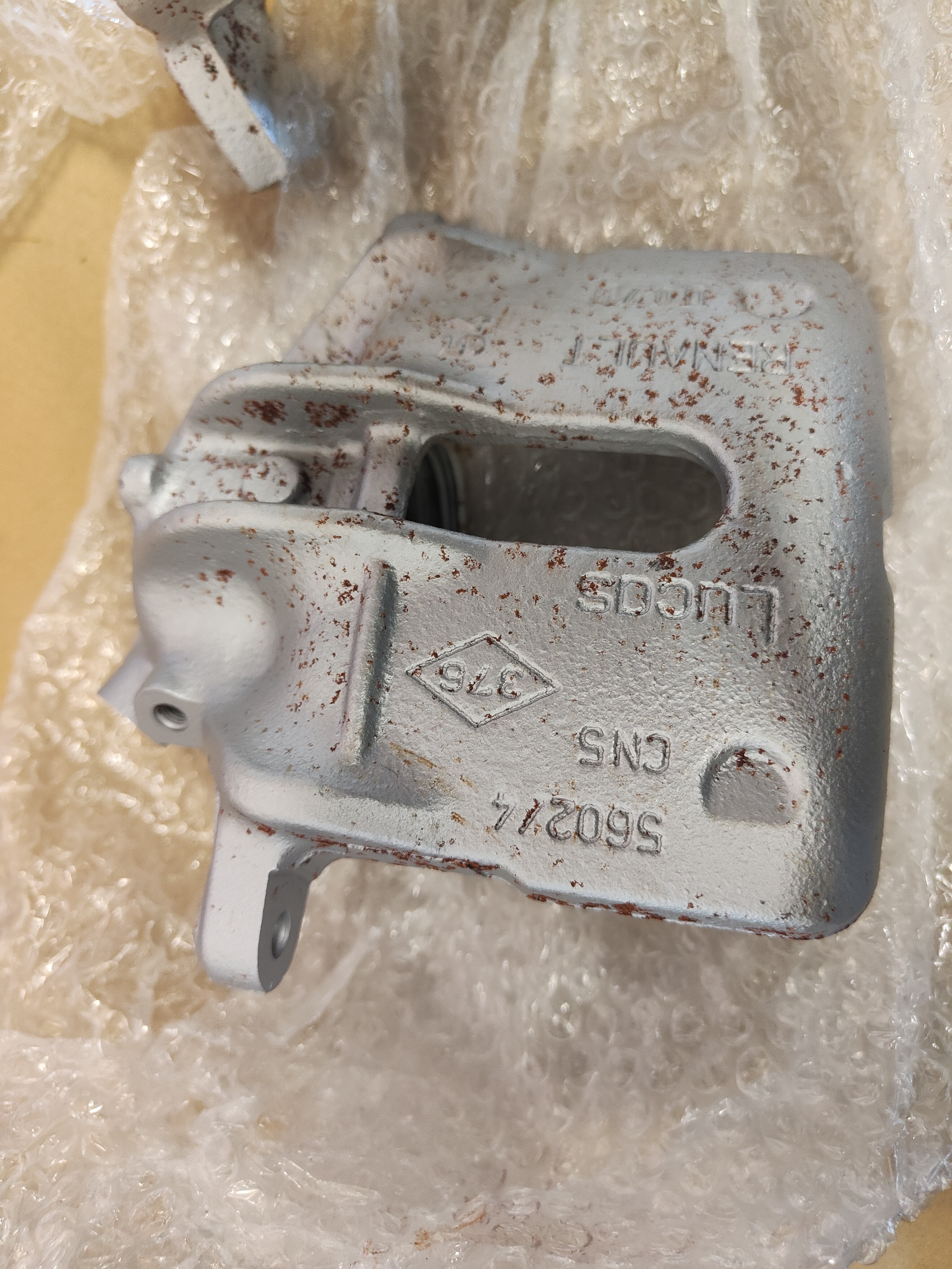

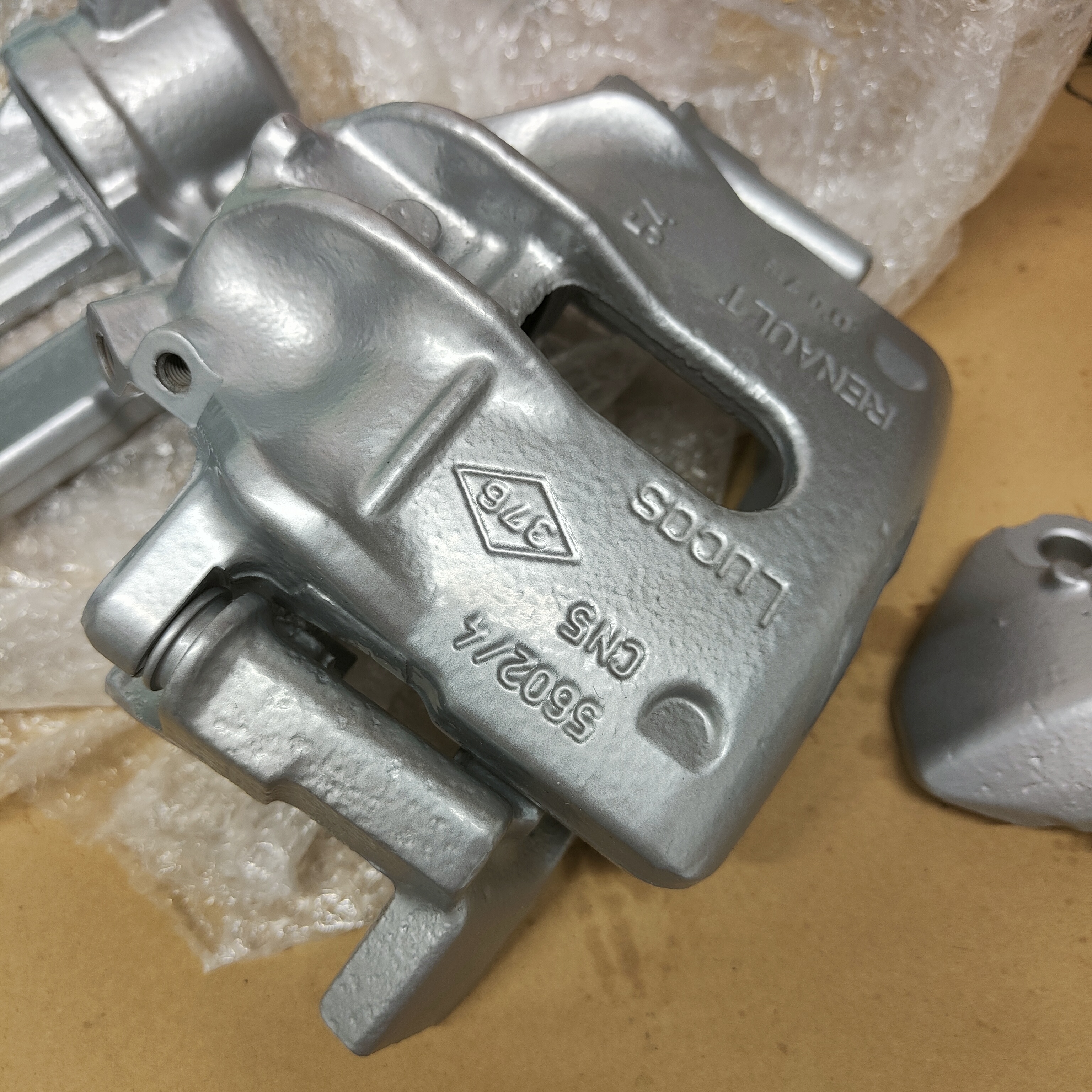

Got a spare set of front calipers off being blasted and cerakoted this week too...
there's still loads left on the shopping list, bushes, engine internals, discs and pads etc, I'll chip away at the parts list and maybe make a start on it after the winter

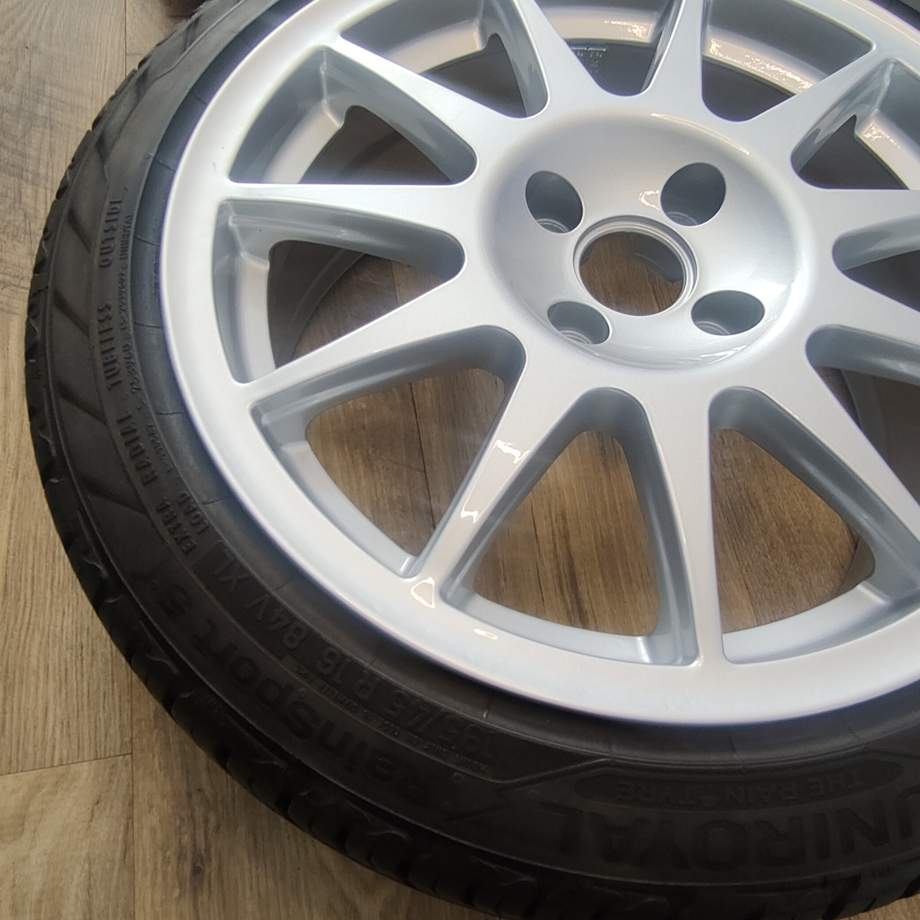

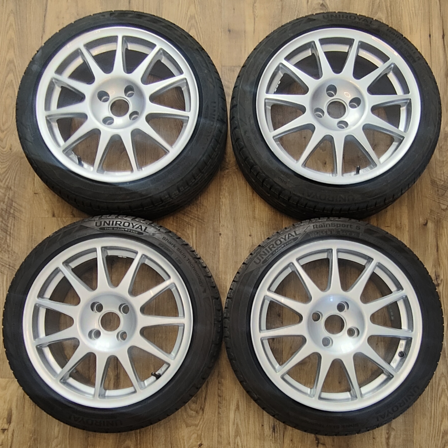

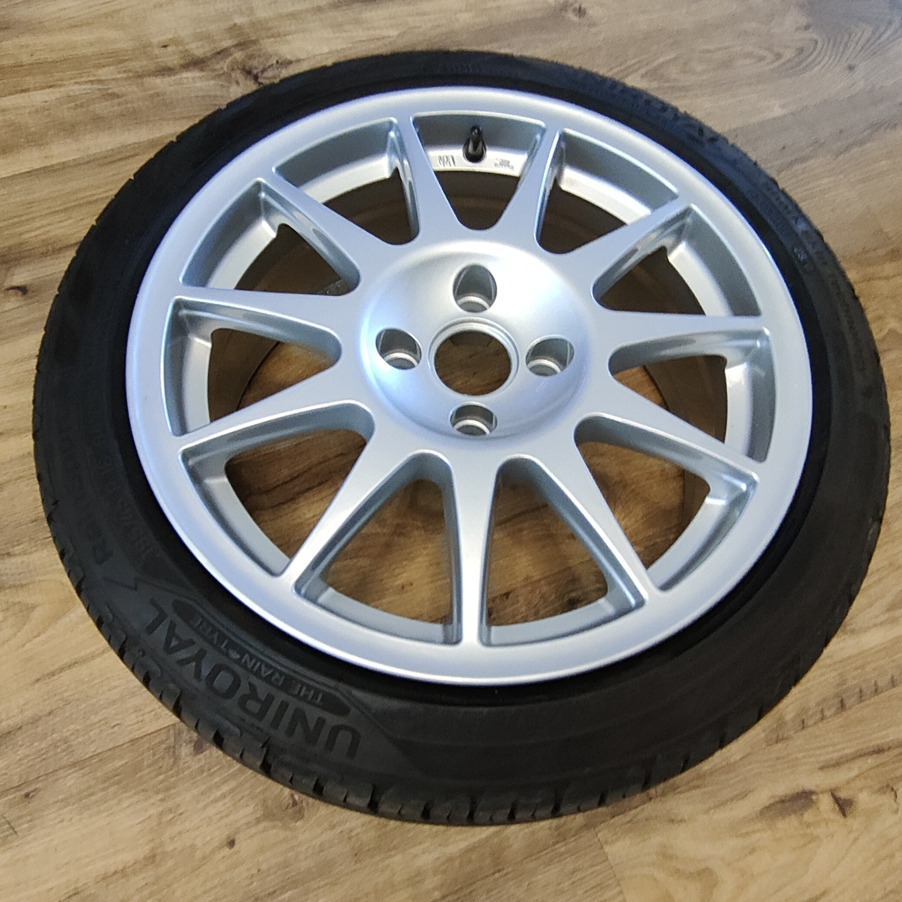

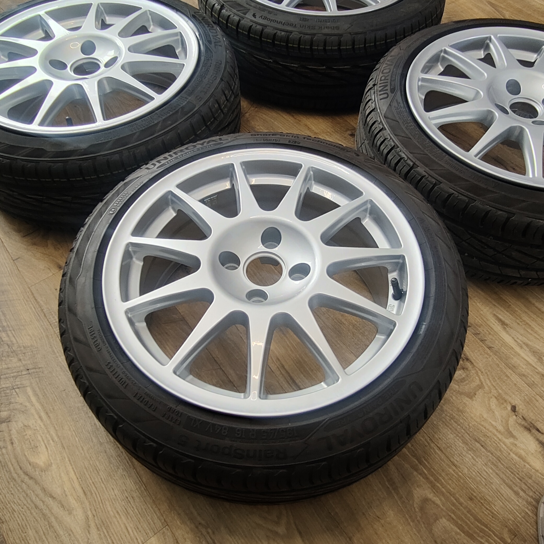

Got my wheels back from powder coat yesterday, gave them a coat of Gtechniq C5 today so I can get them back on and get the car off axle stands over the weekend.
Spare calipers are back from Cerakote too, so I'll get them built back up at some point

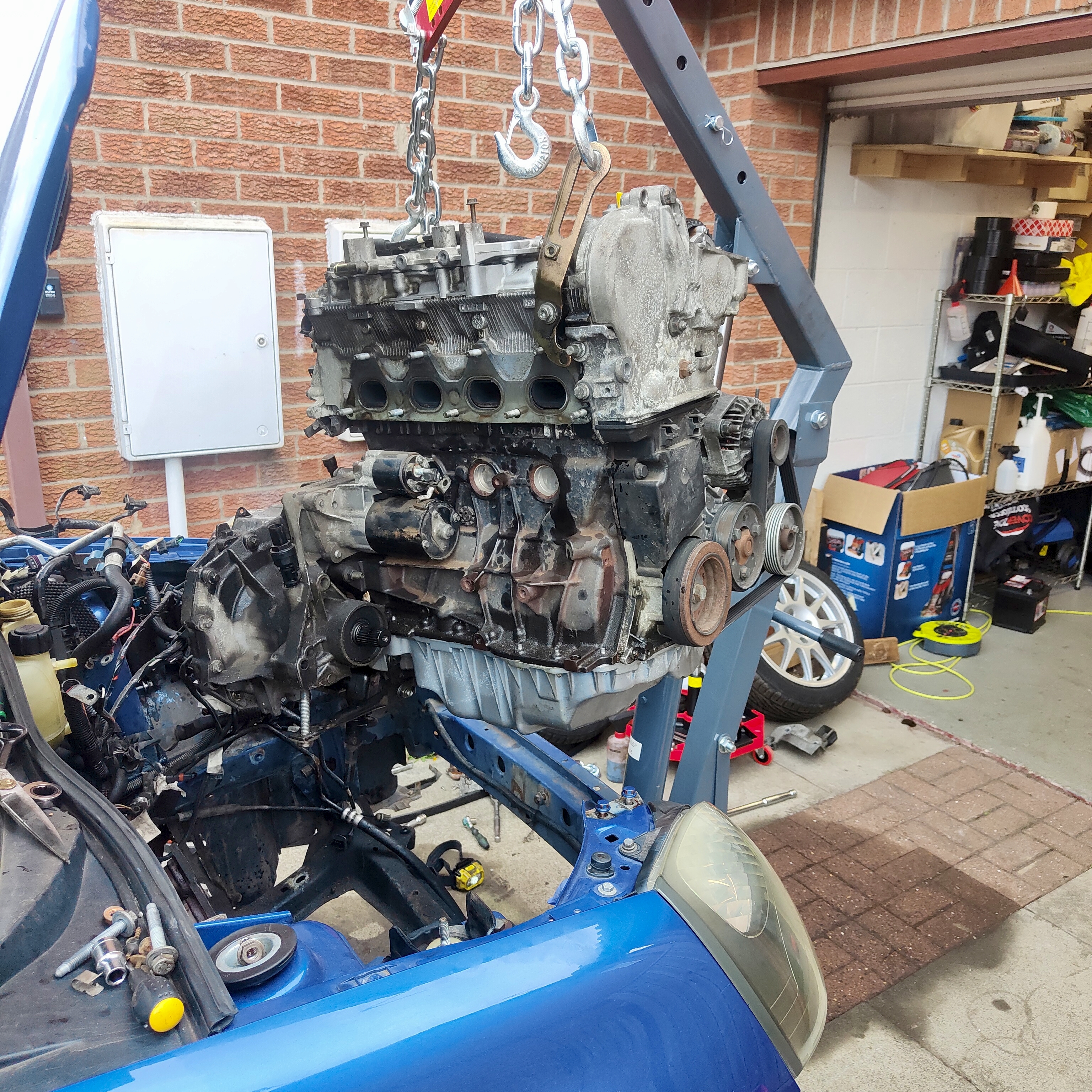

Progress on this has been slower than glacial drift, due to being at sea for nearly 200 days last year, then back straight into winter.. I've run out of excuses and with four days at home for Easter I've got the engine and gearbox out

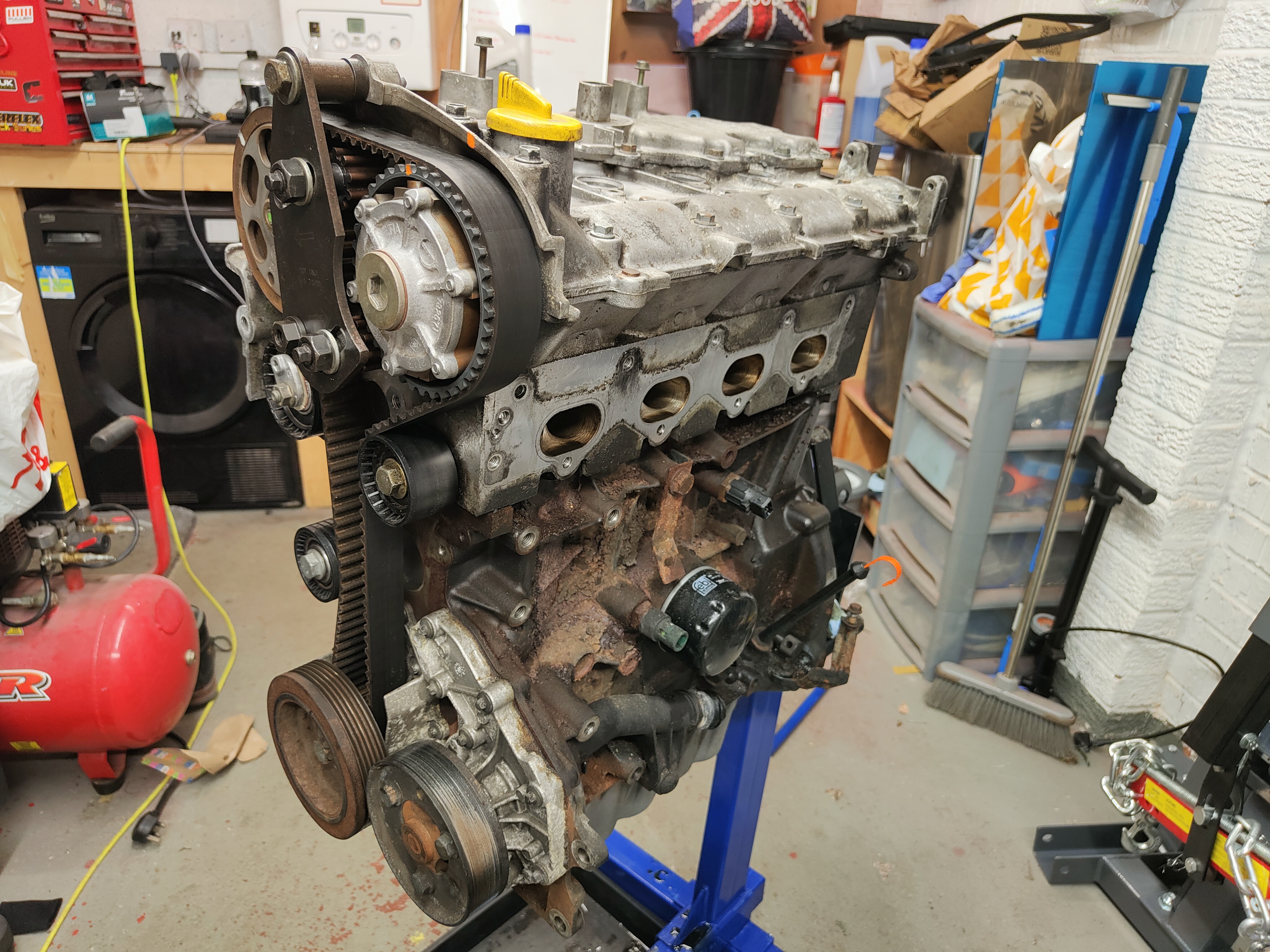

Took about 5hrs all in, first time taking the engine out of a 1*2 so fairly content with that.
I've just left the engine hanging on the crane in the garage for tonight, plan for tomorrow is to tidy tools away, get the gearbox off and the engine onto the engine stand.
Next time I'm home I'm going to Jizer and jet wash the engine bay, get the subframe and bottom arms off ready to send a load of stuff out for cerakote/powder coating

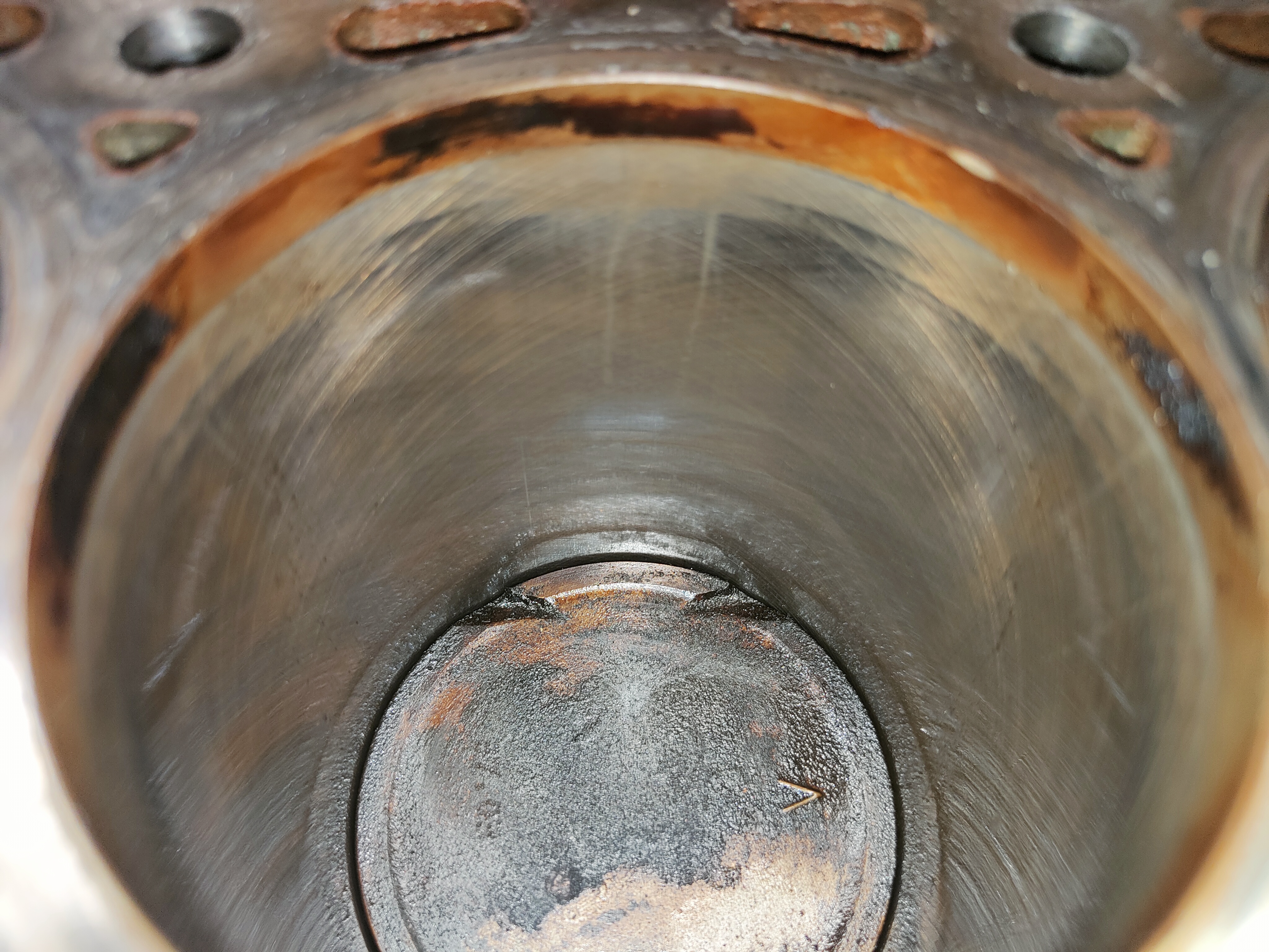

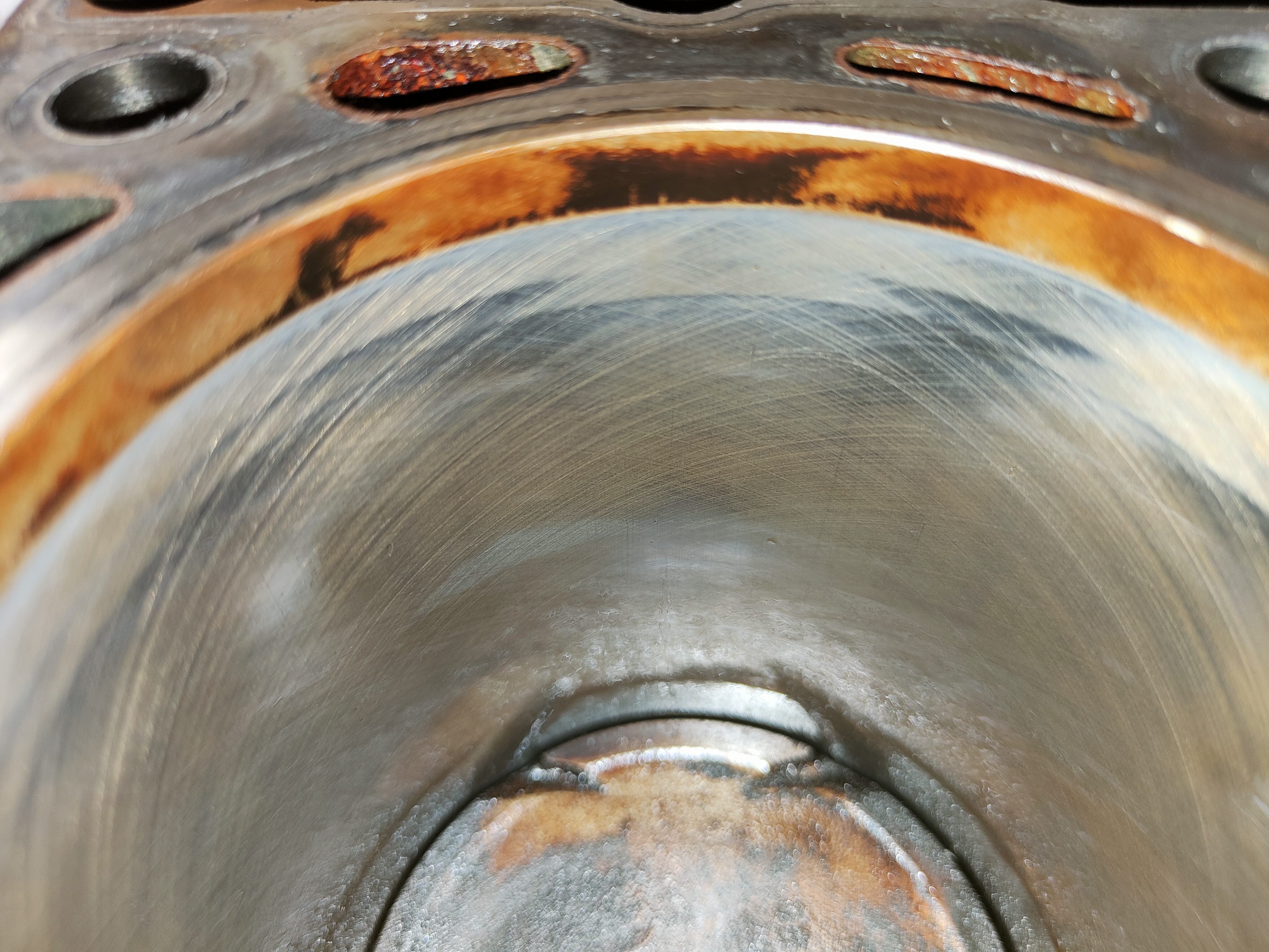

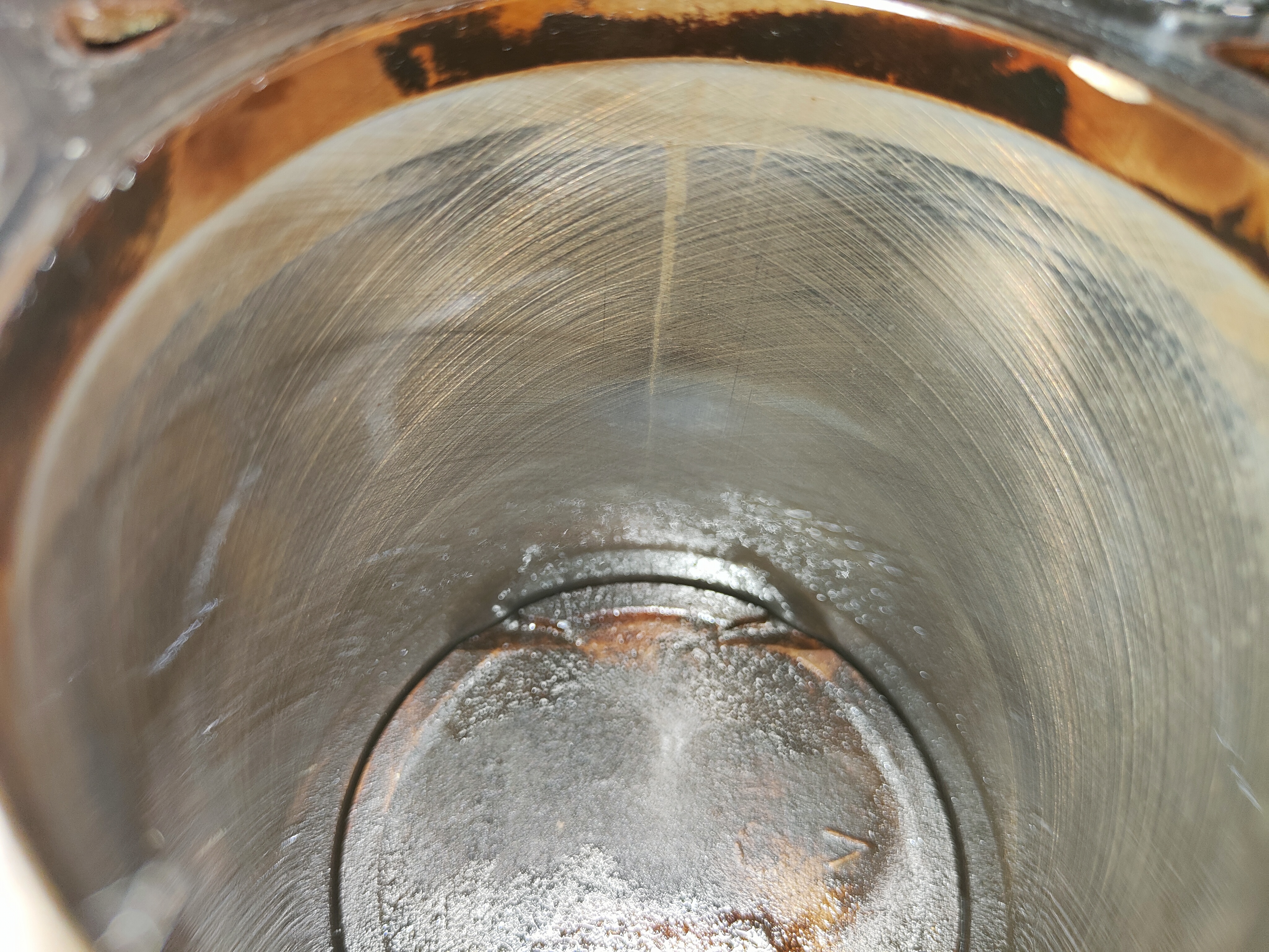

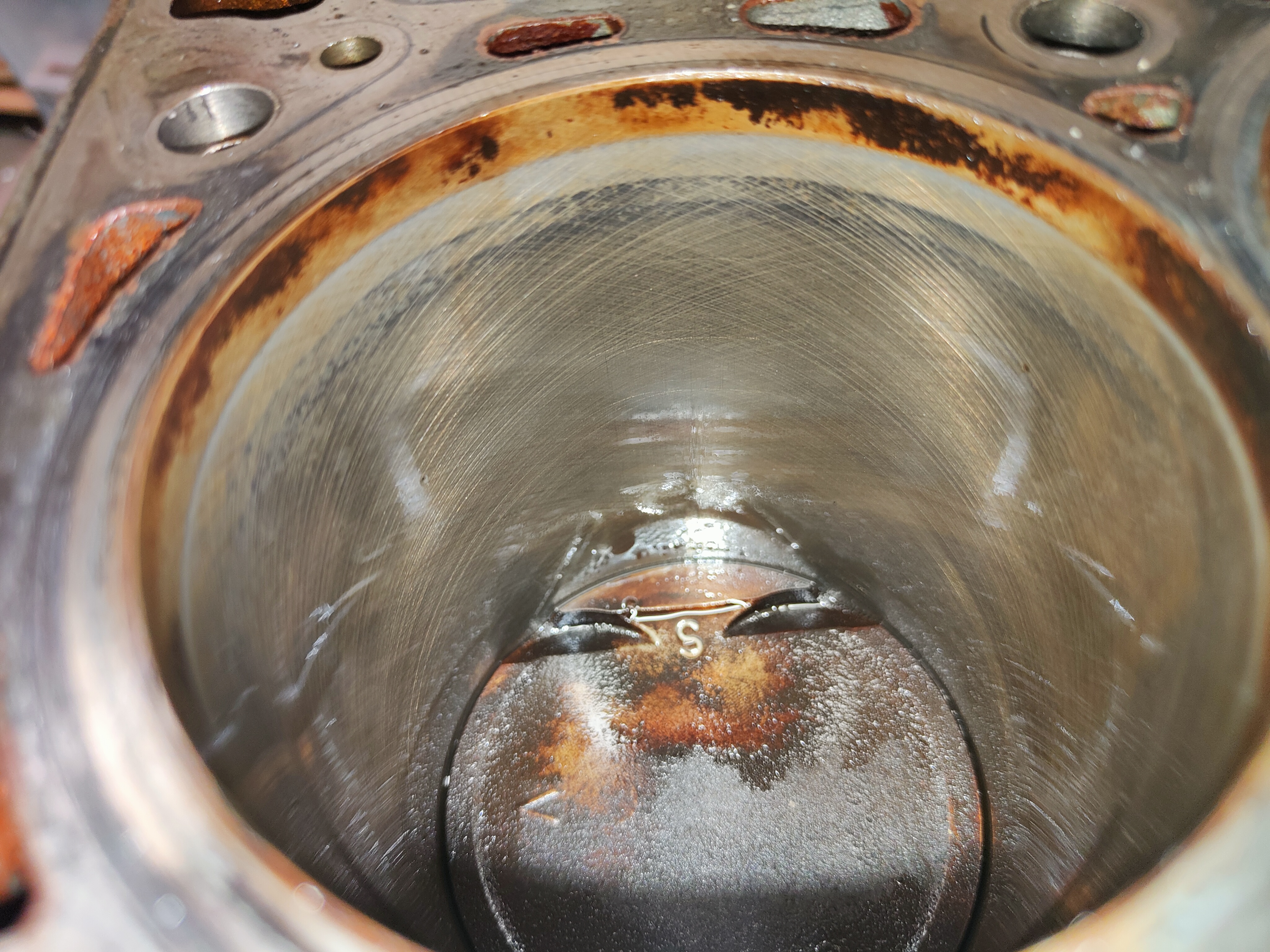

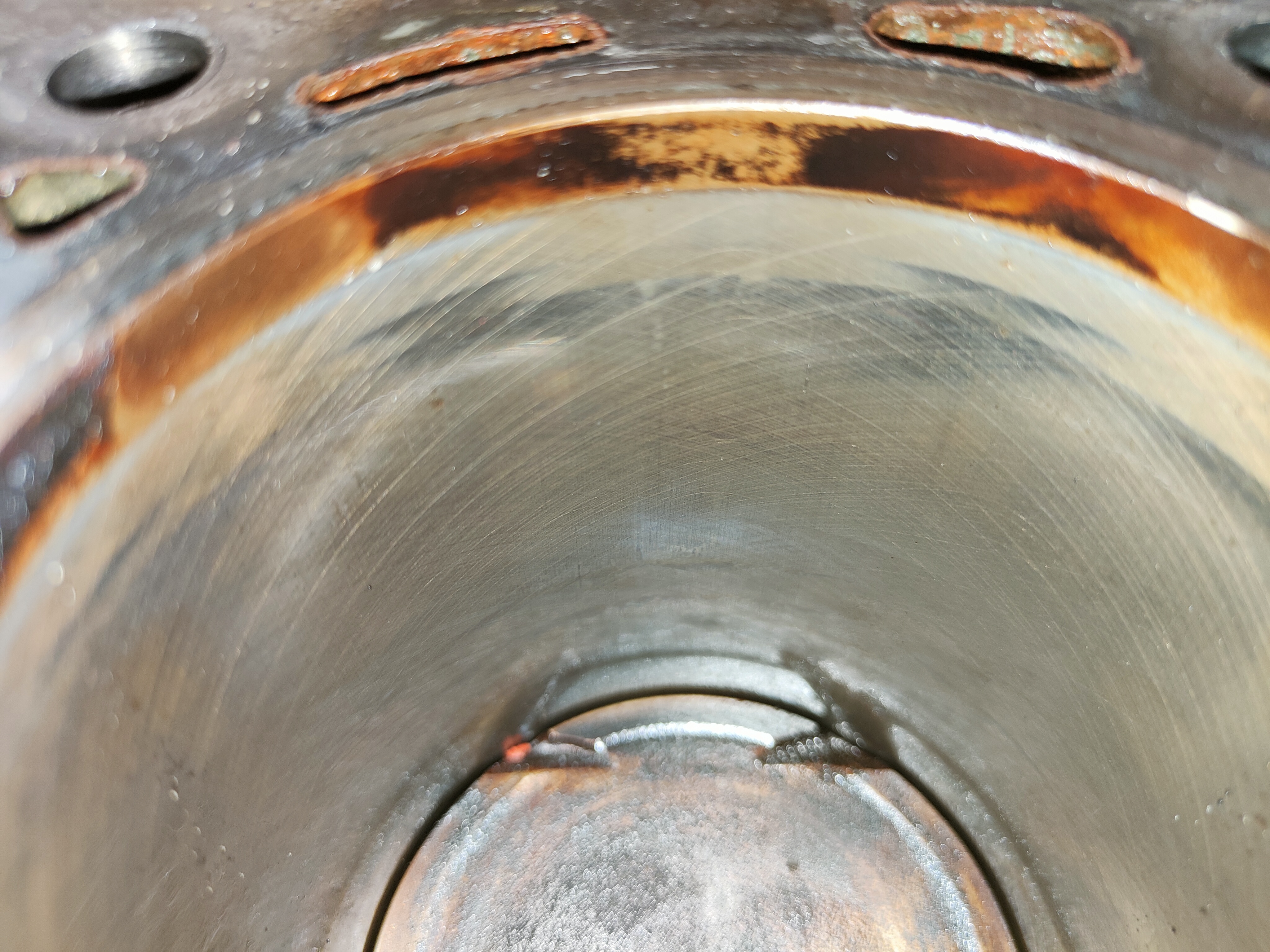

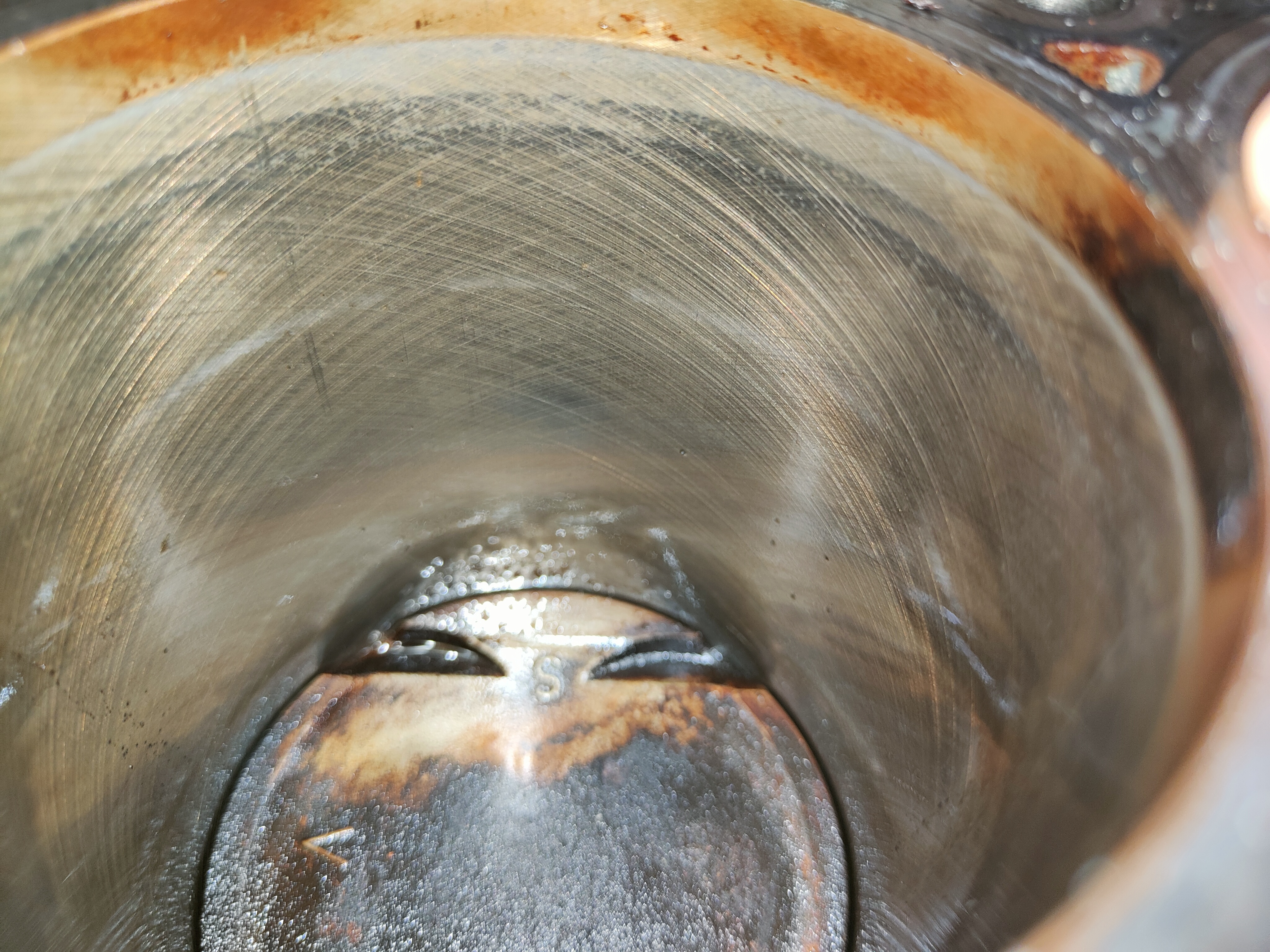

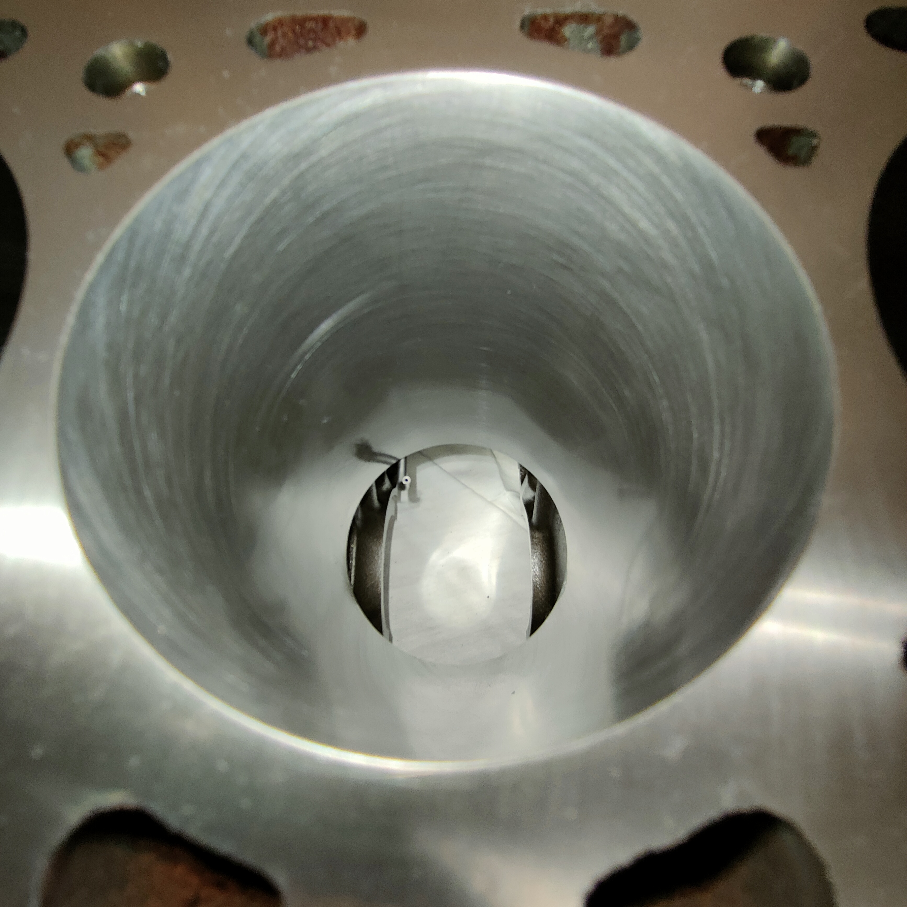

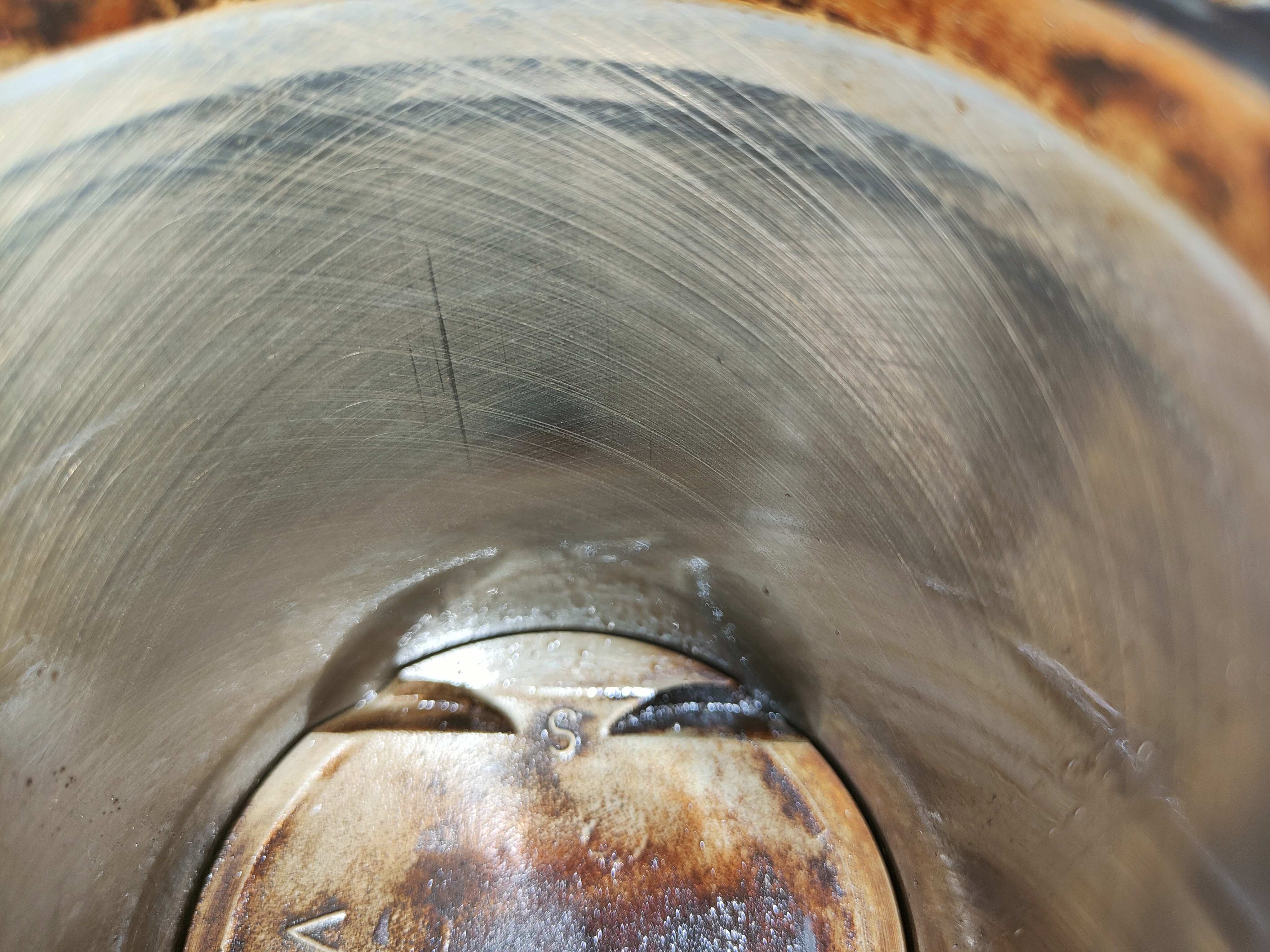

I'm fairly happy with how it looks, there's a couple of light vertical scratches in the bores but you can't feel them with a finger/nail, I'll measure the cylinders once I've stripped the bottom end, hopefully I'll get away with a hone and new rings.

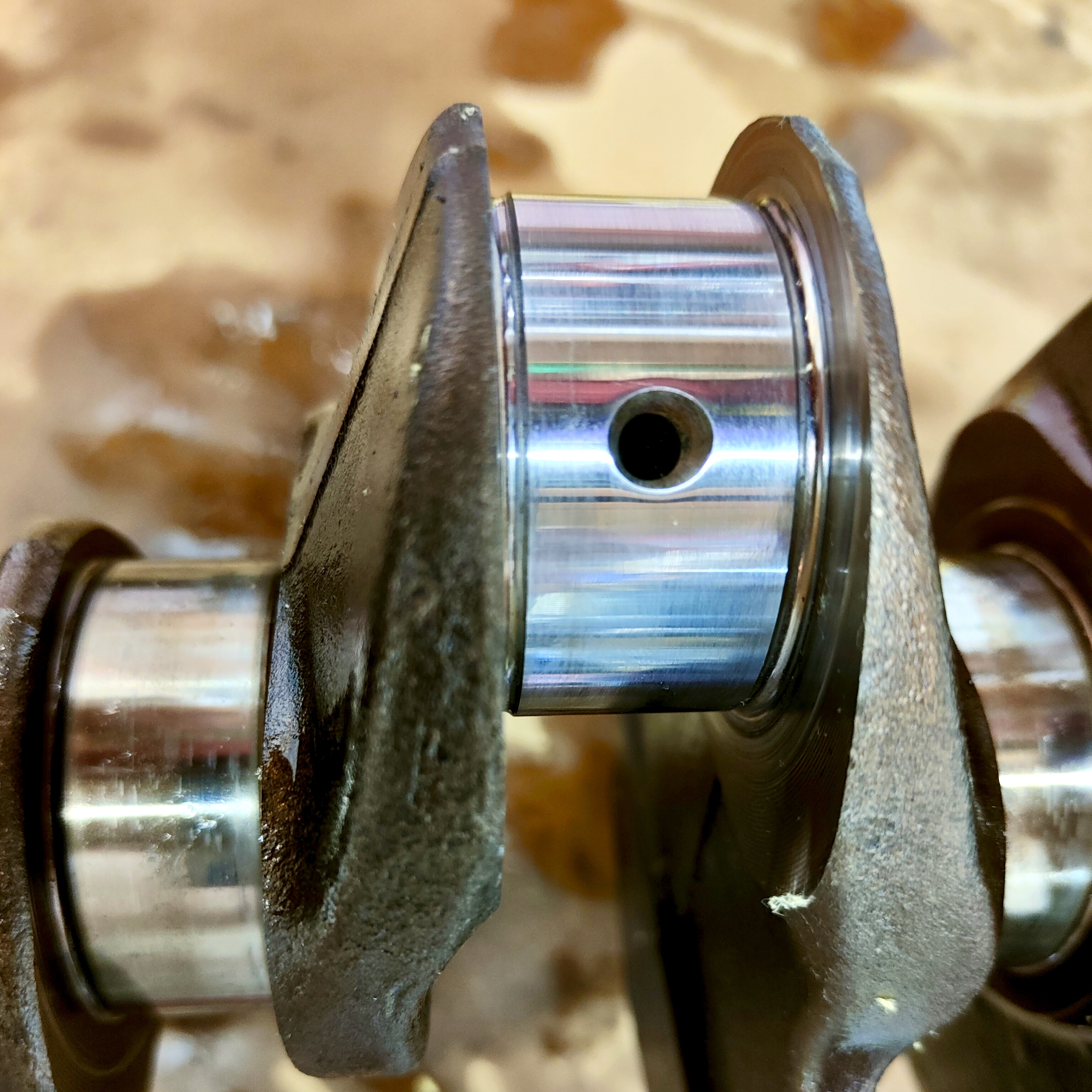

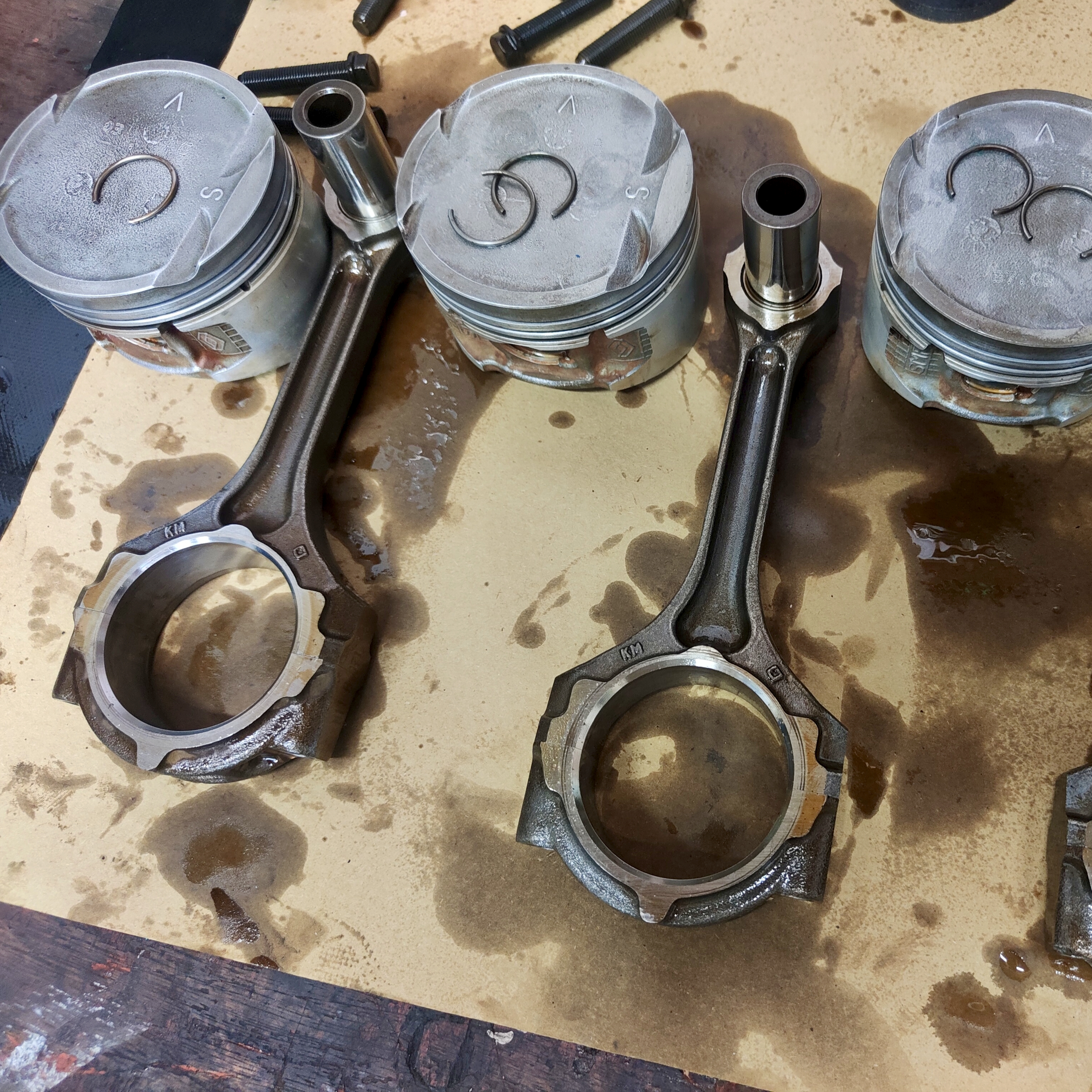

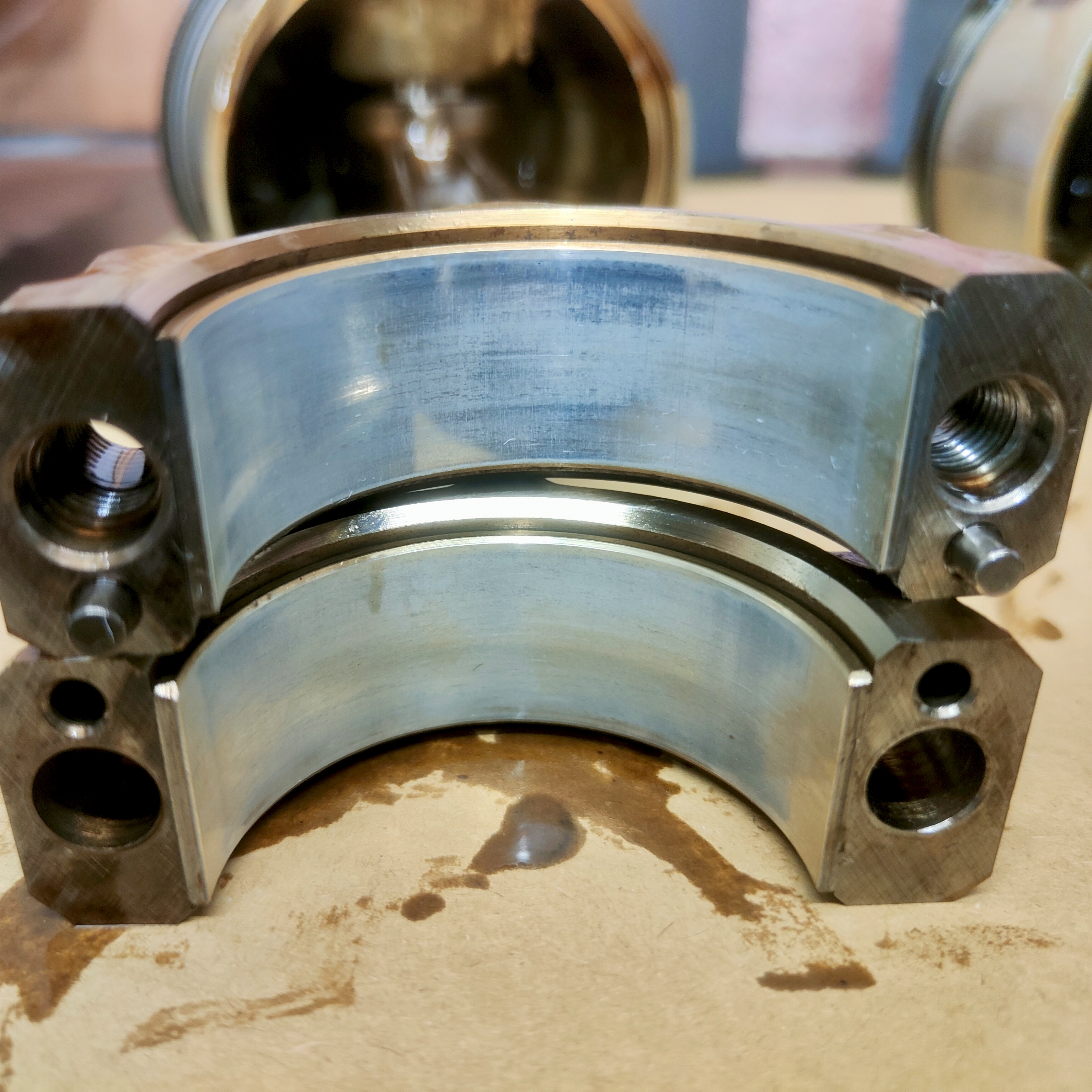

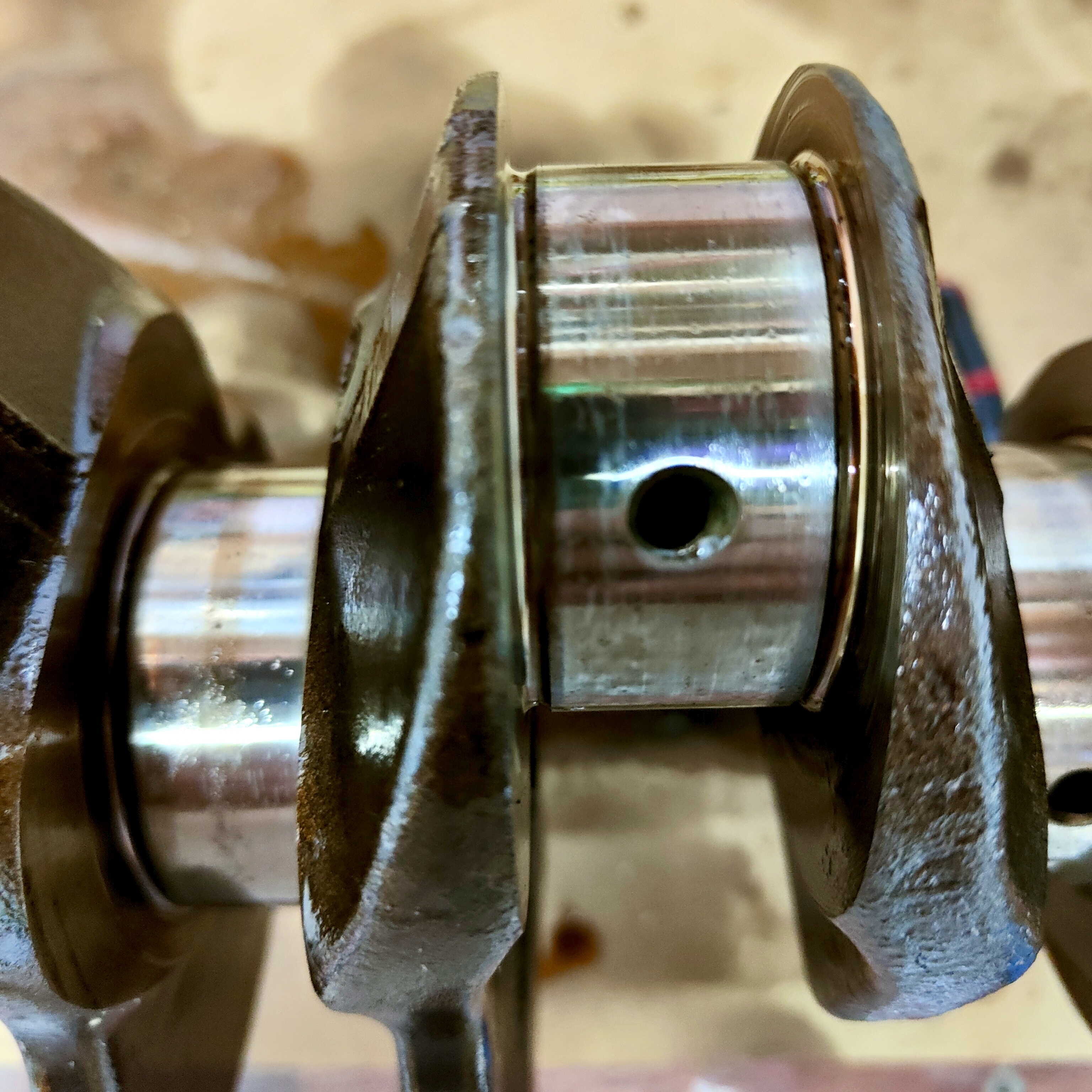

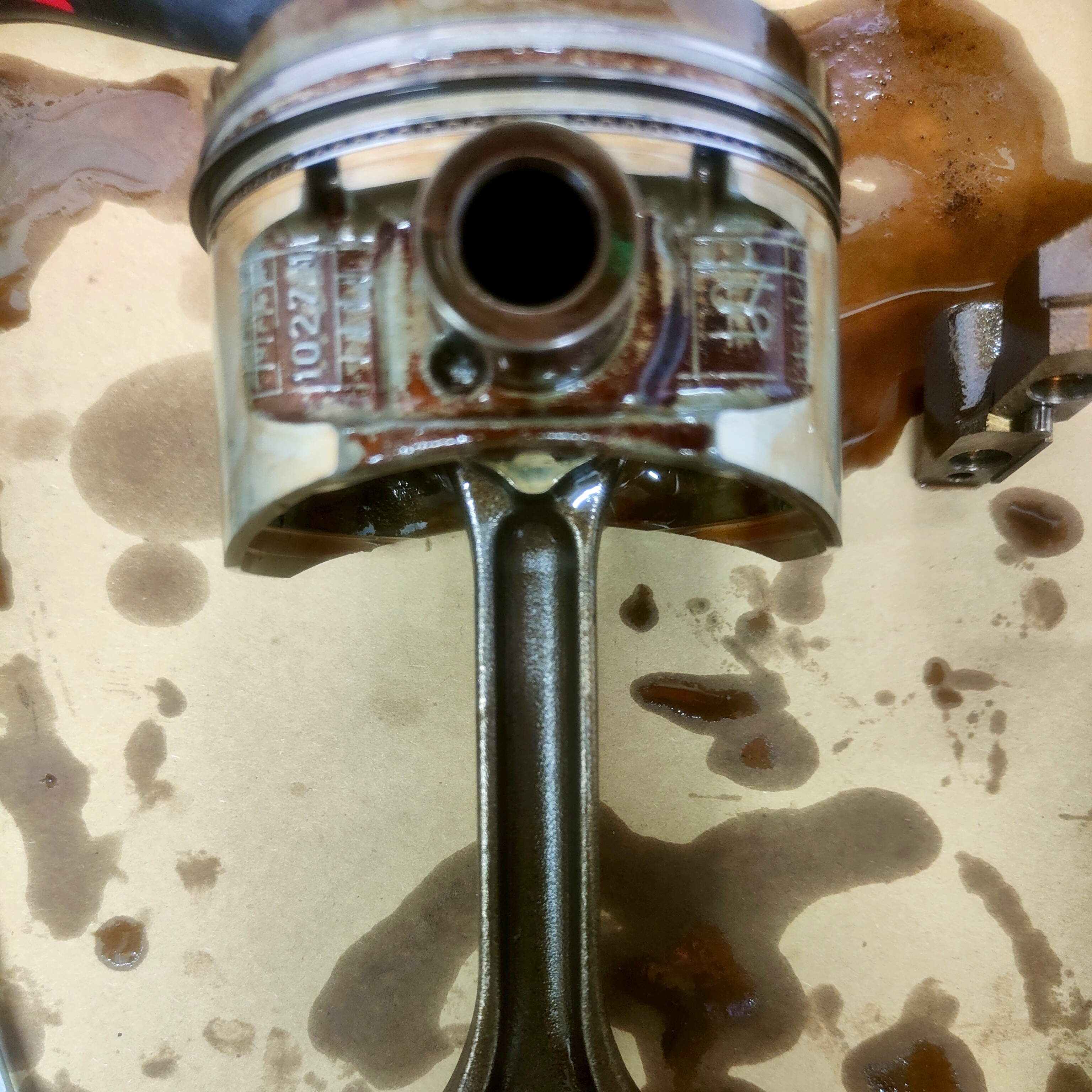

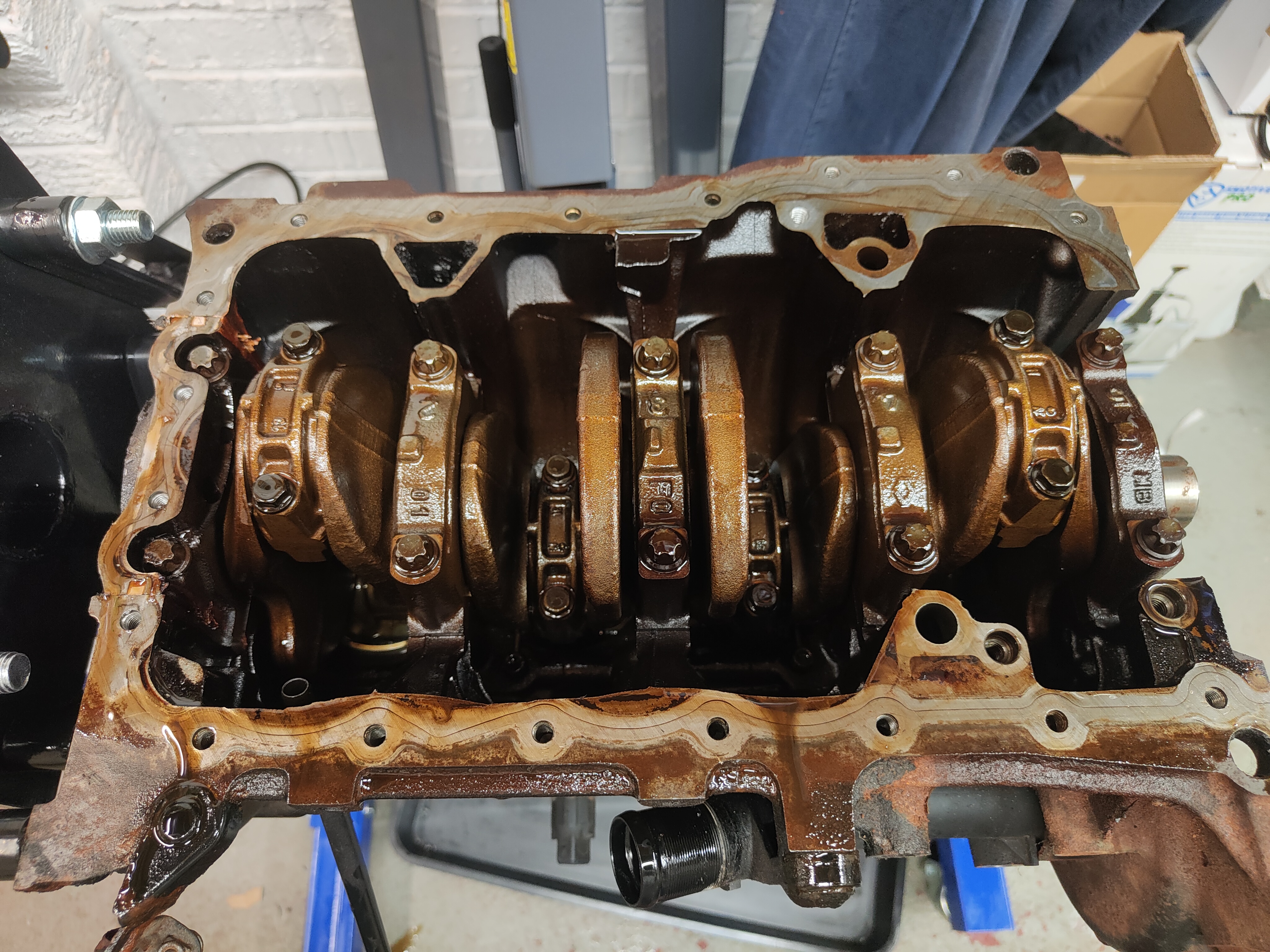

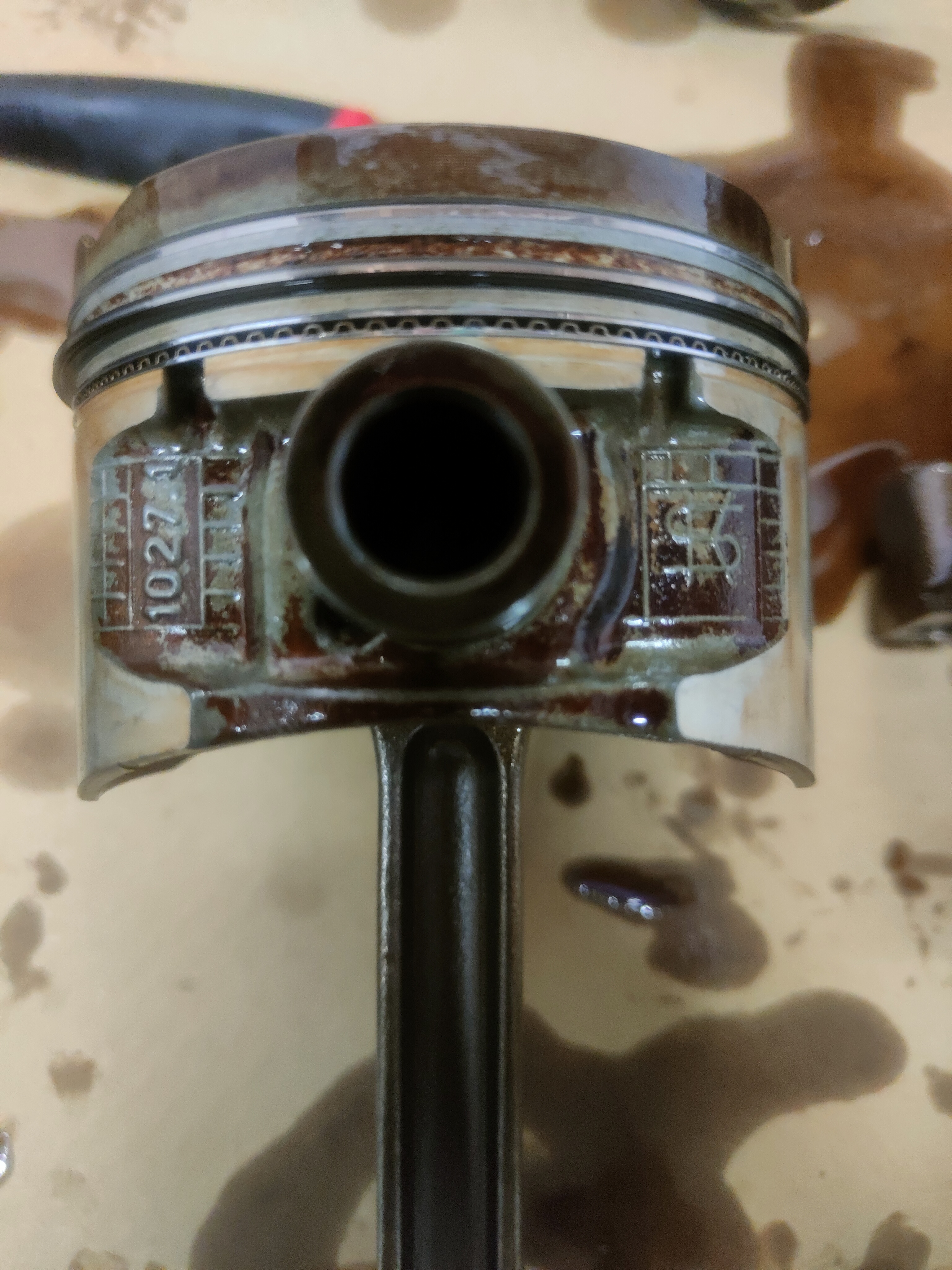

Got the bottom end stripped today, no horror stories, the bearings show minimal wear and other than a bit of oil varnish it's all pretty clean, got the crank polished and pistons and rods cleaned.. annoyingly I've managed to lose a gudgeon pin circlip so if anyone has a dead 1*2 bottom end they can take one off I'd be eternally grateful..
Everything has been covered in acf50 for now and will get a thorough final clean before assembly, still waiting on some wossner valves arriving before I drop the head off for refurb and porting, and the block for a deck, hone and hot tanking.

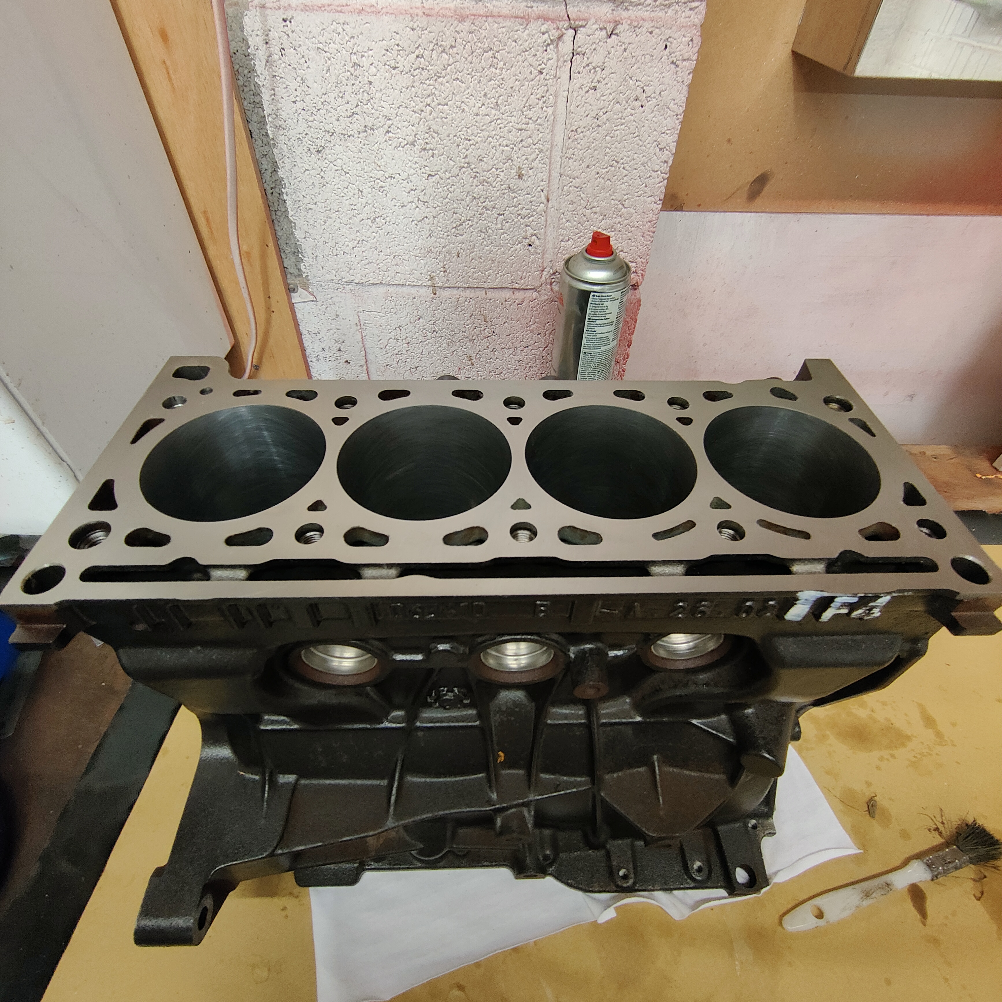

I've measured everything and crank and ordered some KS bearings and Hastings rings. The paint for the block has arrived too, I've gone for a dove grey, not OEM but I don't like black engine blocks and a nice light colour makes finding oil leaks easier.
Spent the day in the car today picking up parts of the Clio

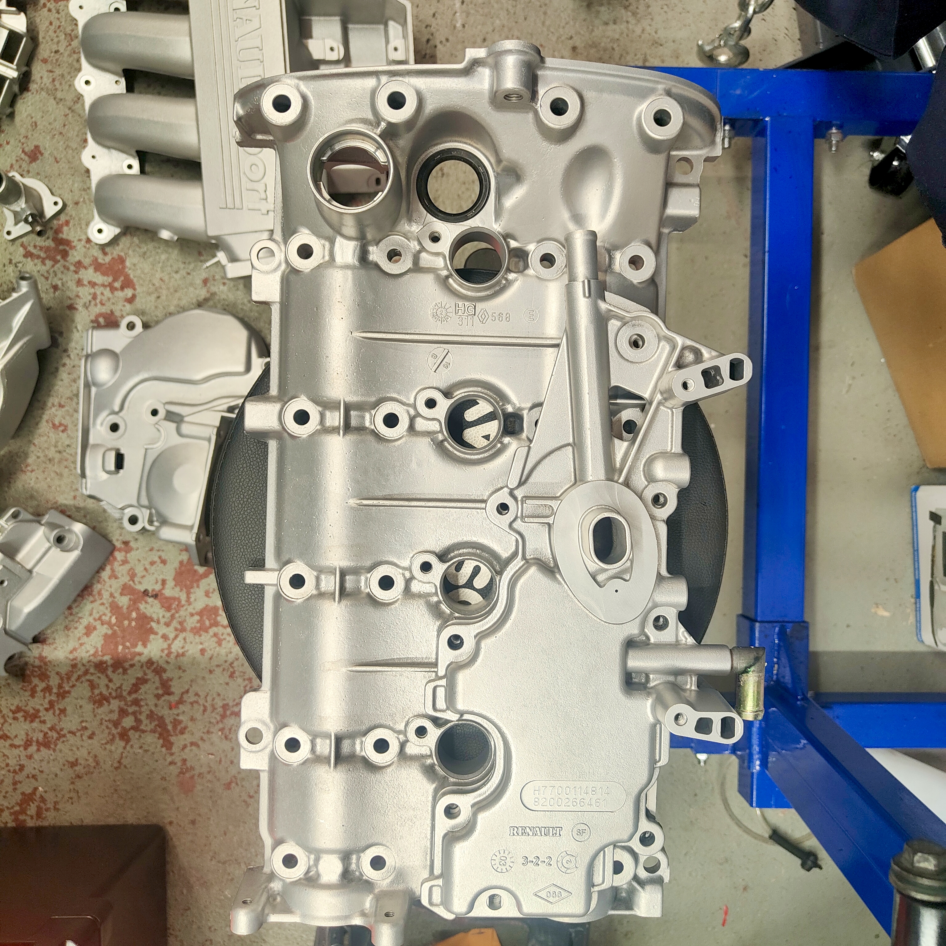

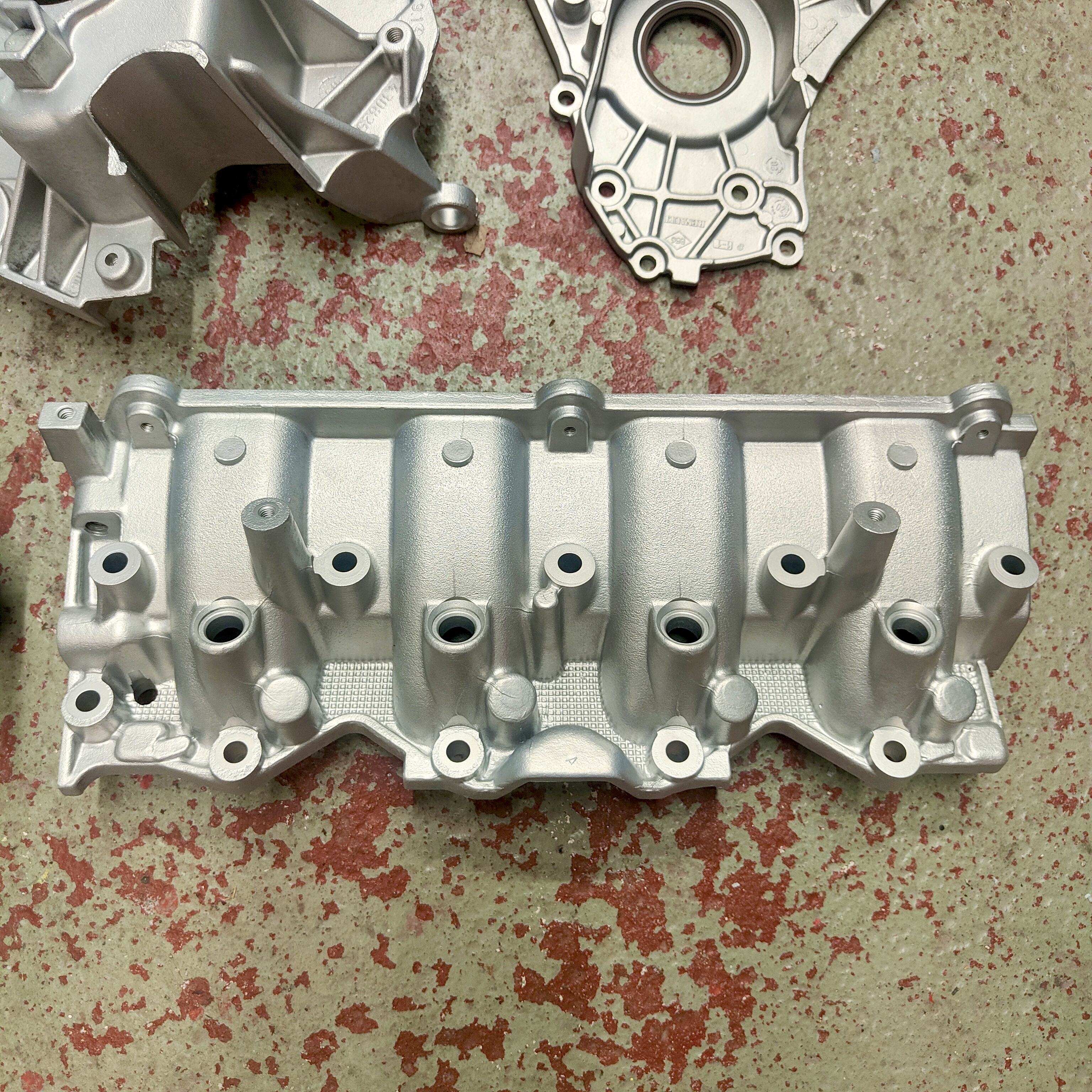

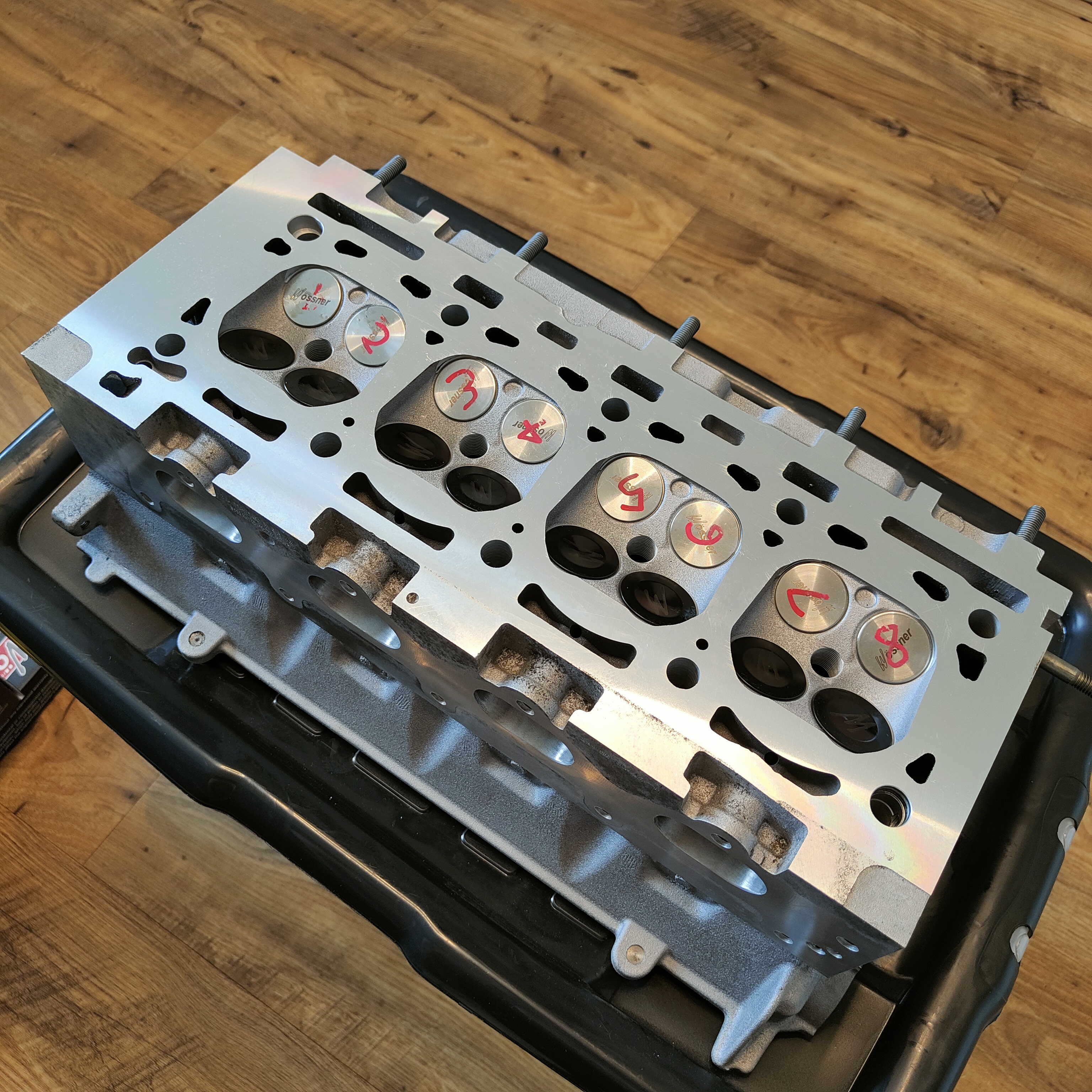

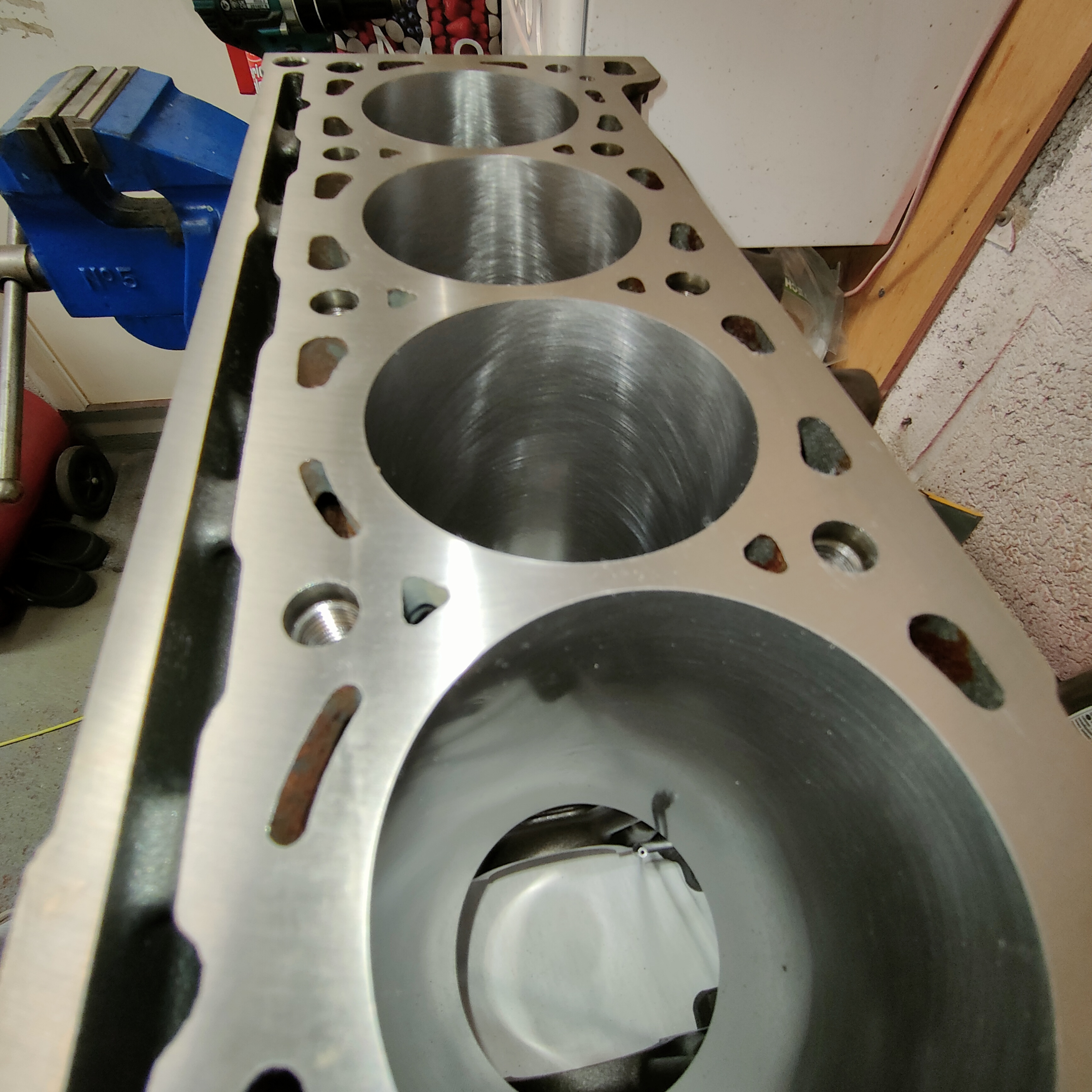

The block has just been decked, honed and new oil squirters, ready for a new coat of paint next.

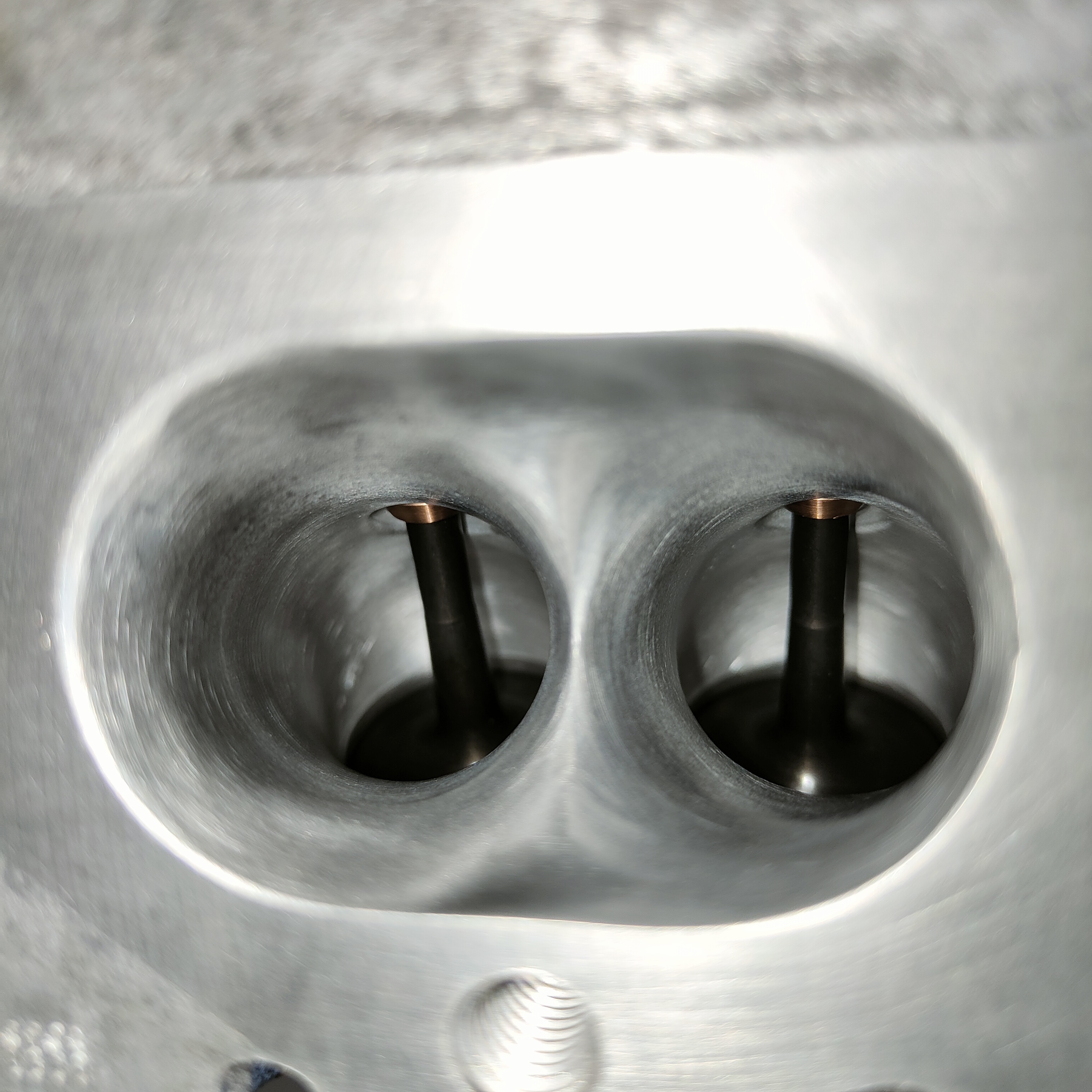

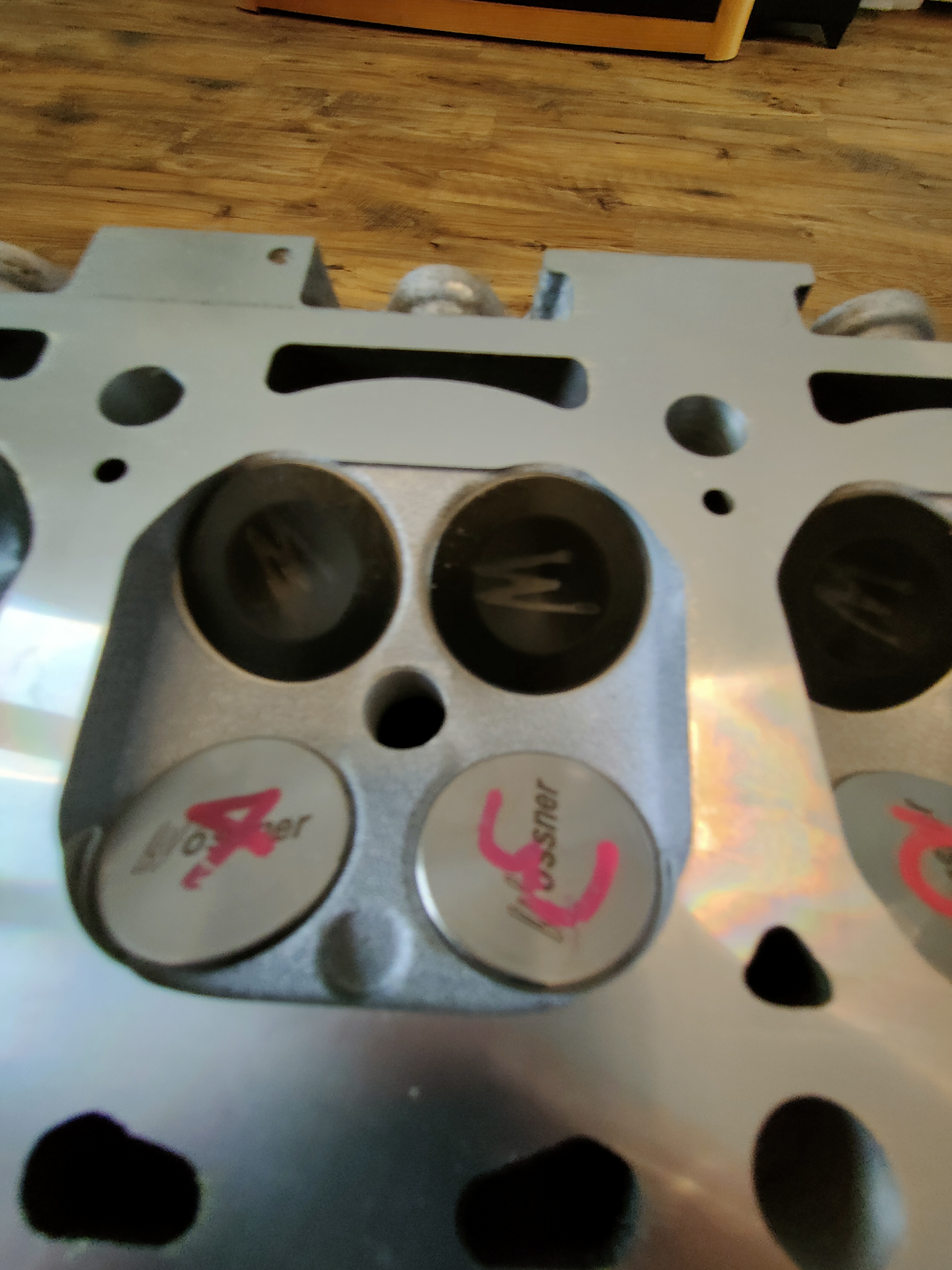

The head has been refaced, new guides, some port work, wossner valves and cat cams springs, I've got a set of 421 profile cams to go in there too.
Next stop was to collect my gearbox from @NorthloopCup who has replaced bearings, seals, some worn out parts and fitted my Blackline diff.
Block needs a hot soapy wash and prepping for paint, then I can start getting it built up over the next few weekends when I'm home.

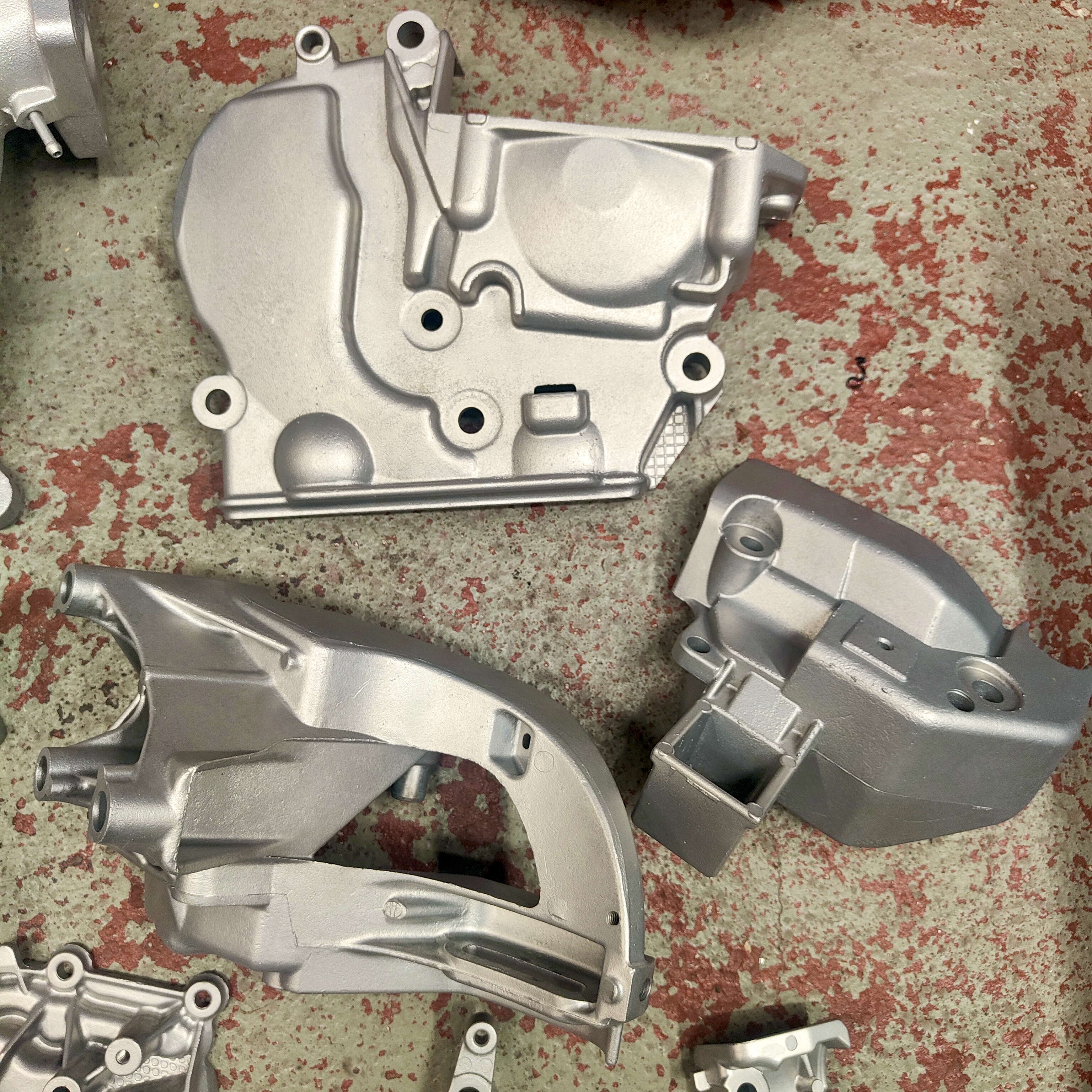

Who did the vapour blasting looks a cracking job. Did you get the throttle body done as well?
No, I didn't really want it getting wet, I'll clean that with a brass wire brush.
It was done by a place called Durham Vapour Blast, he charged me £300 for the lot.

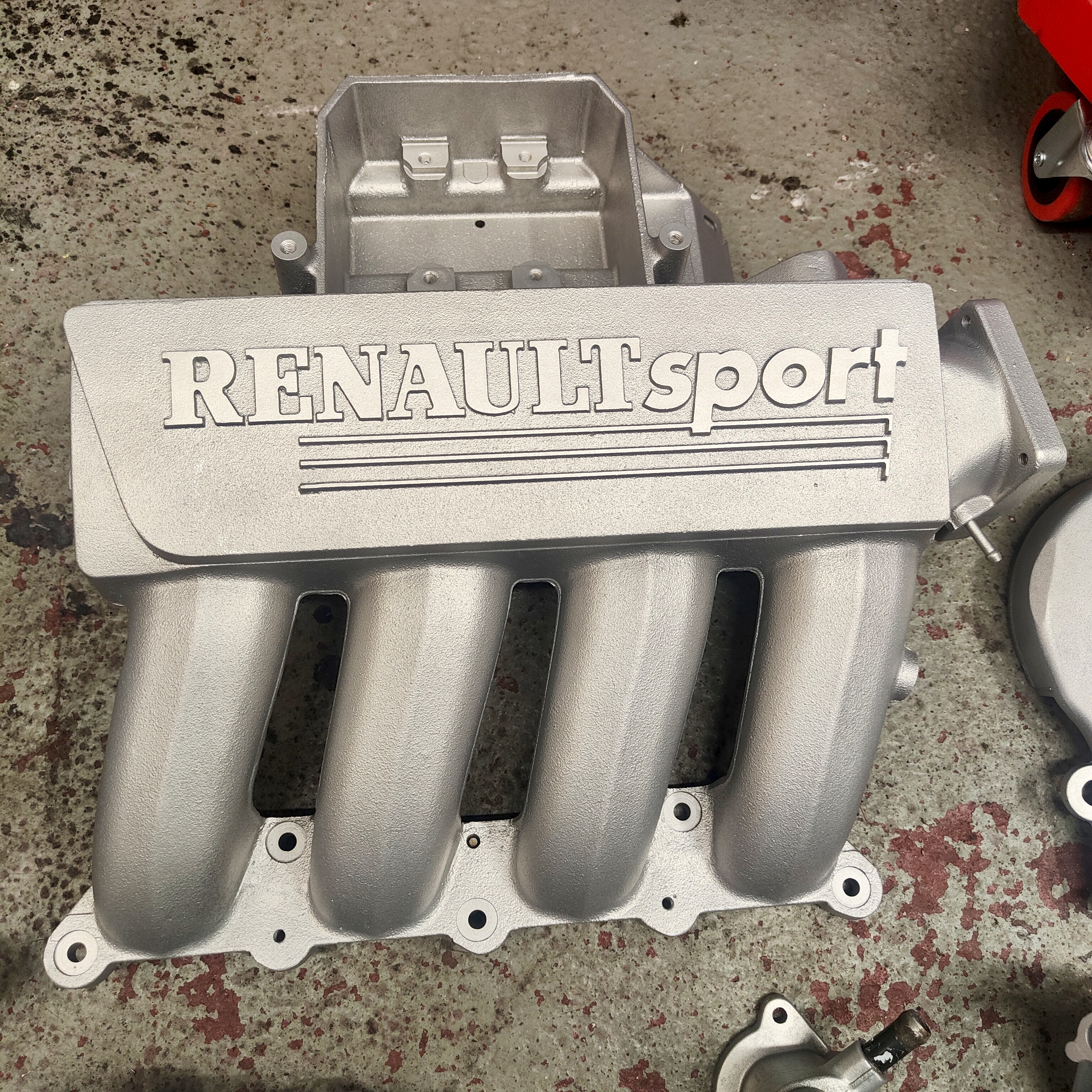

Vapour blasted parts look mega.
Give the cam cover and inlet a power wash off before fitting if you havent already, as mine had some left over white media residue on them that was very hard to see and quite a bit came off when washed.

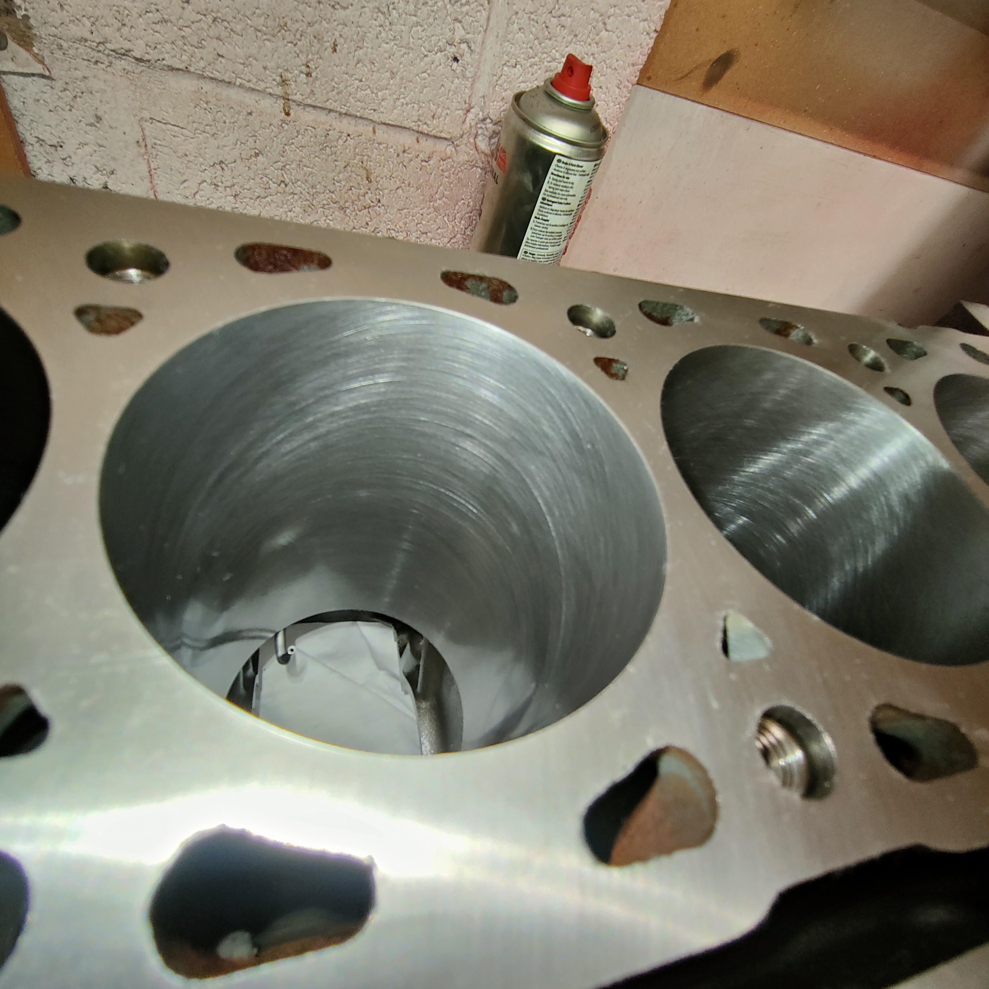

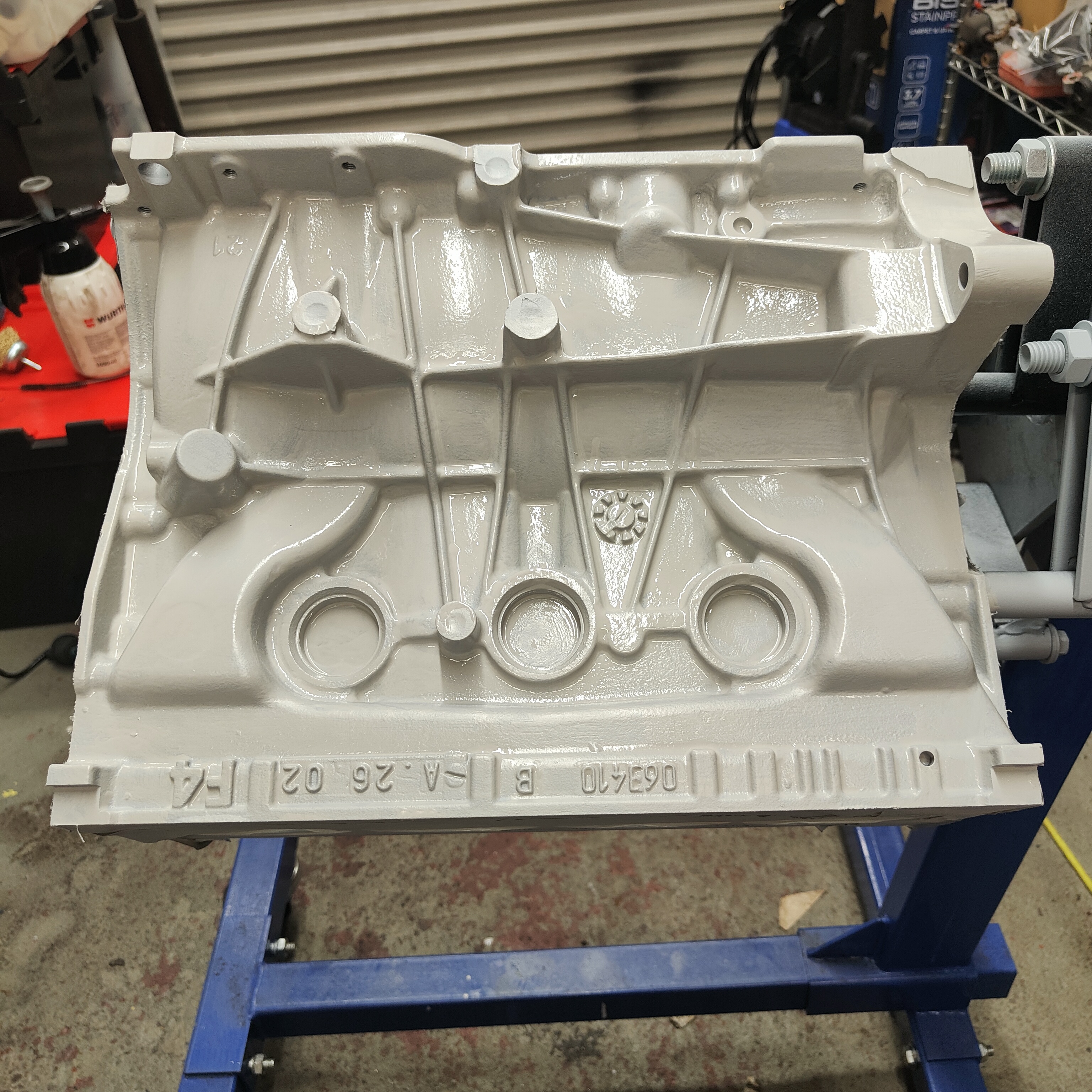

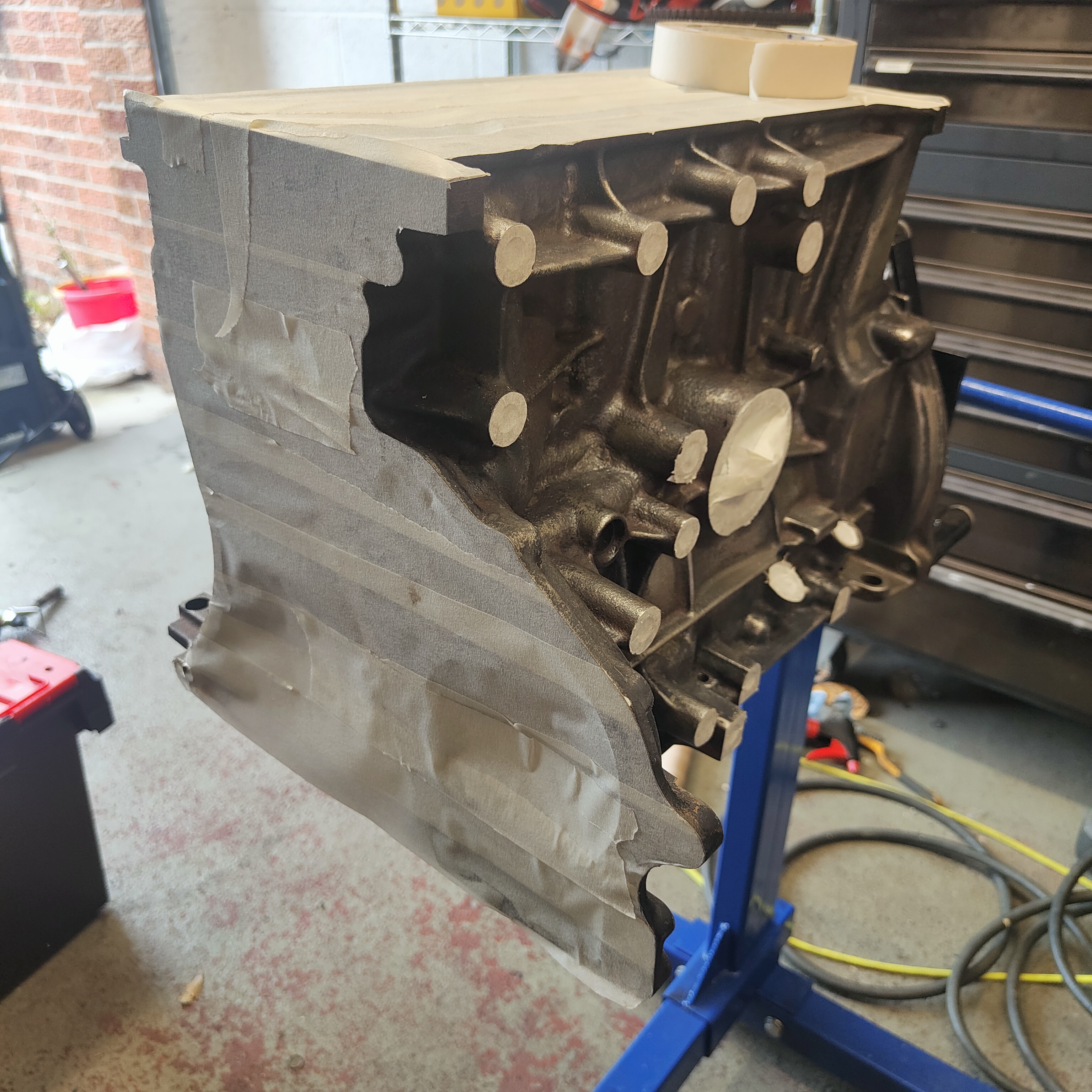

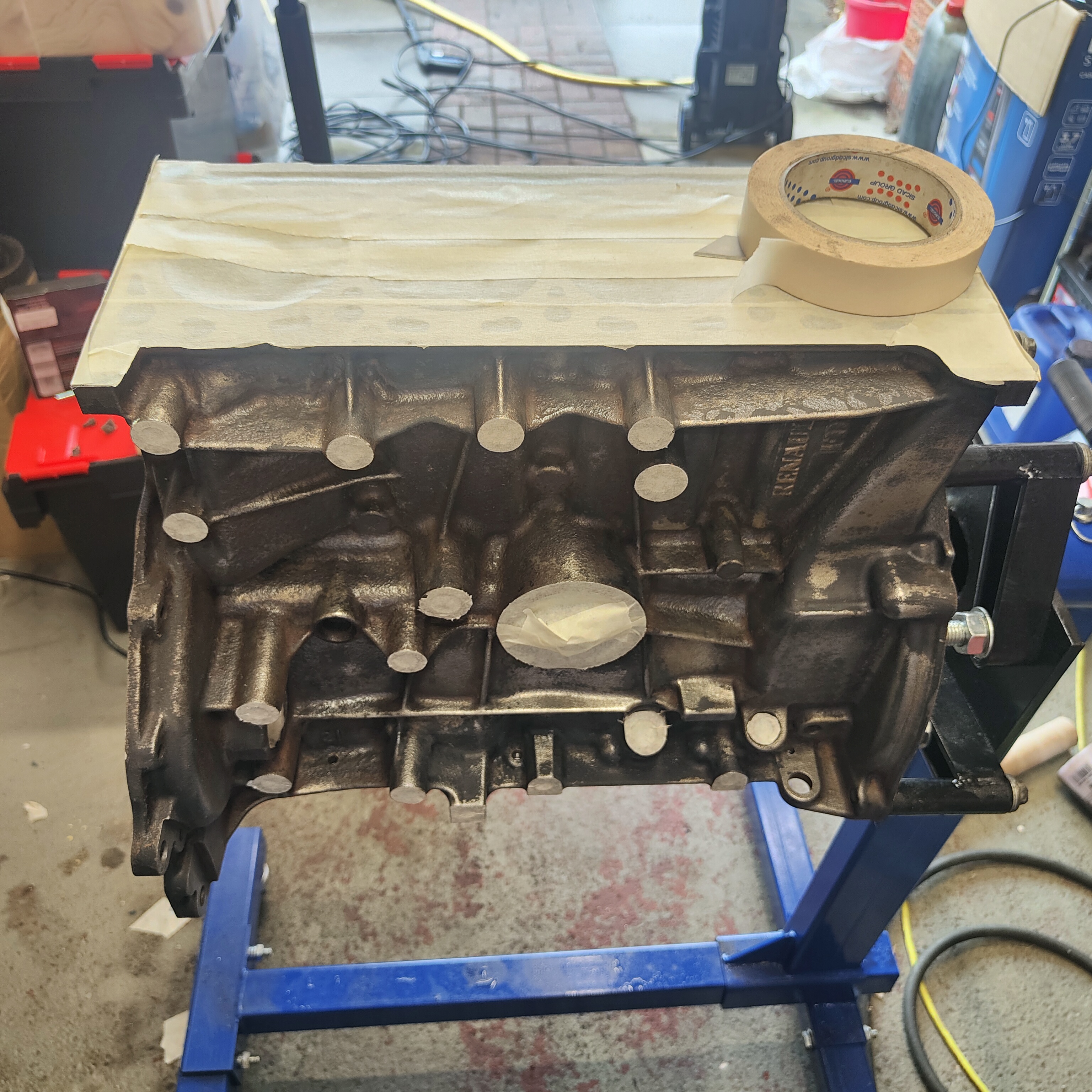

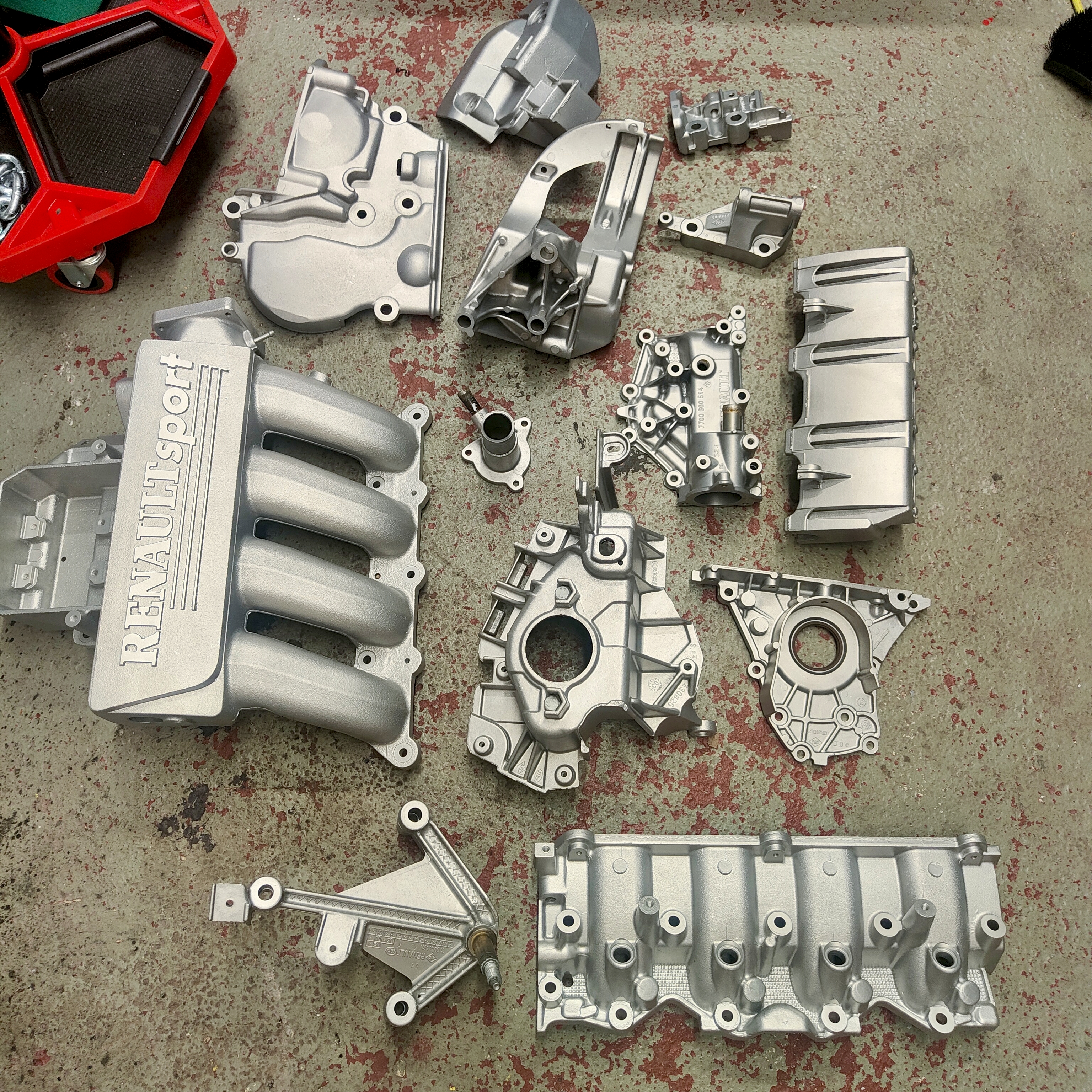

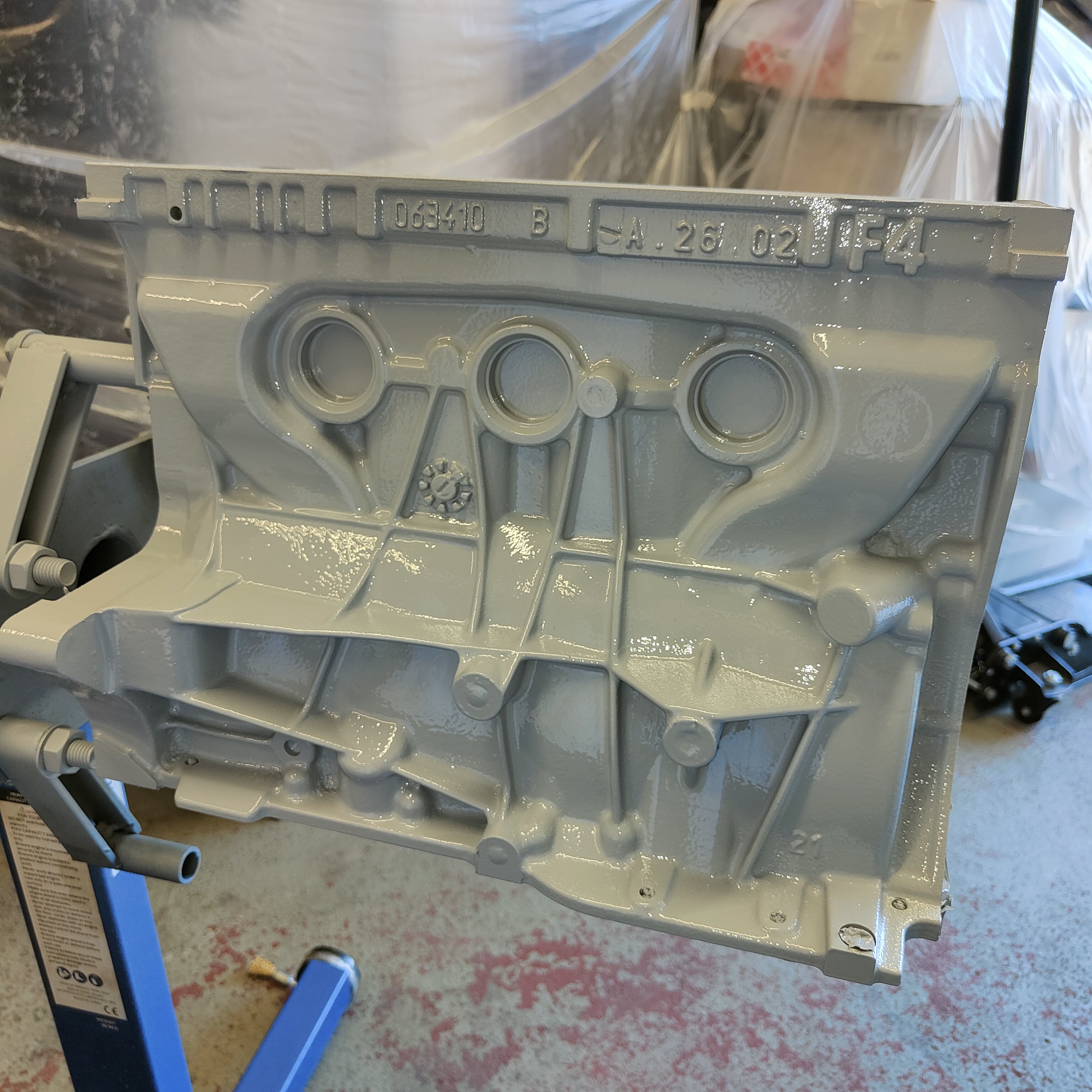

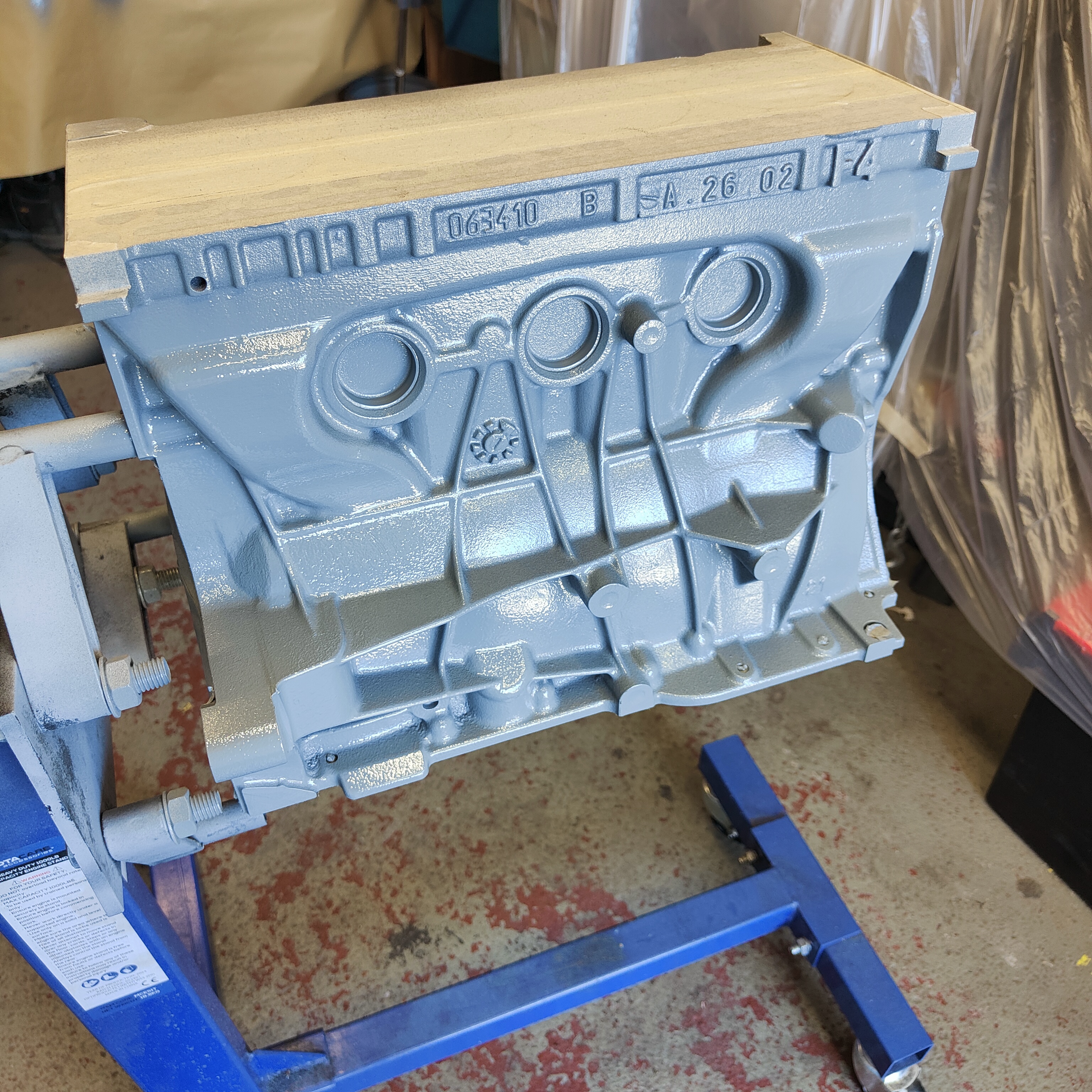

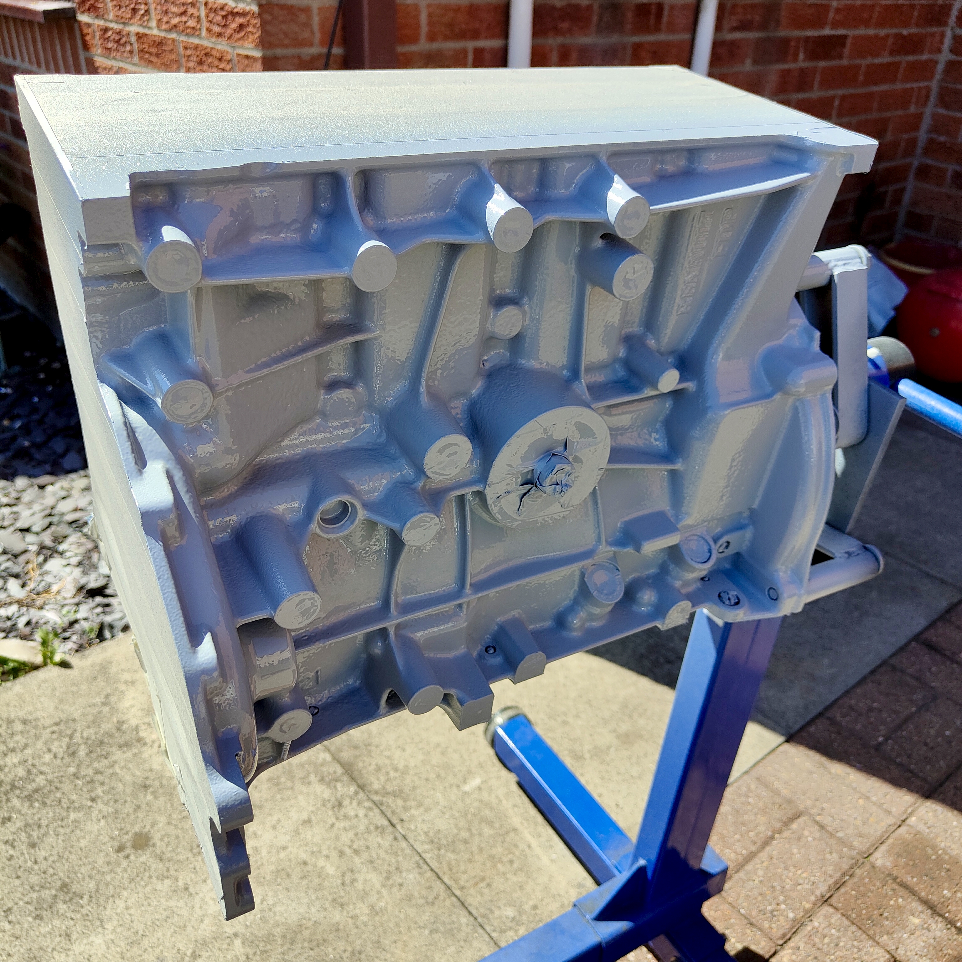

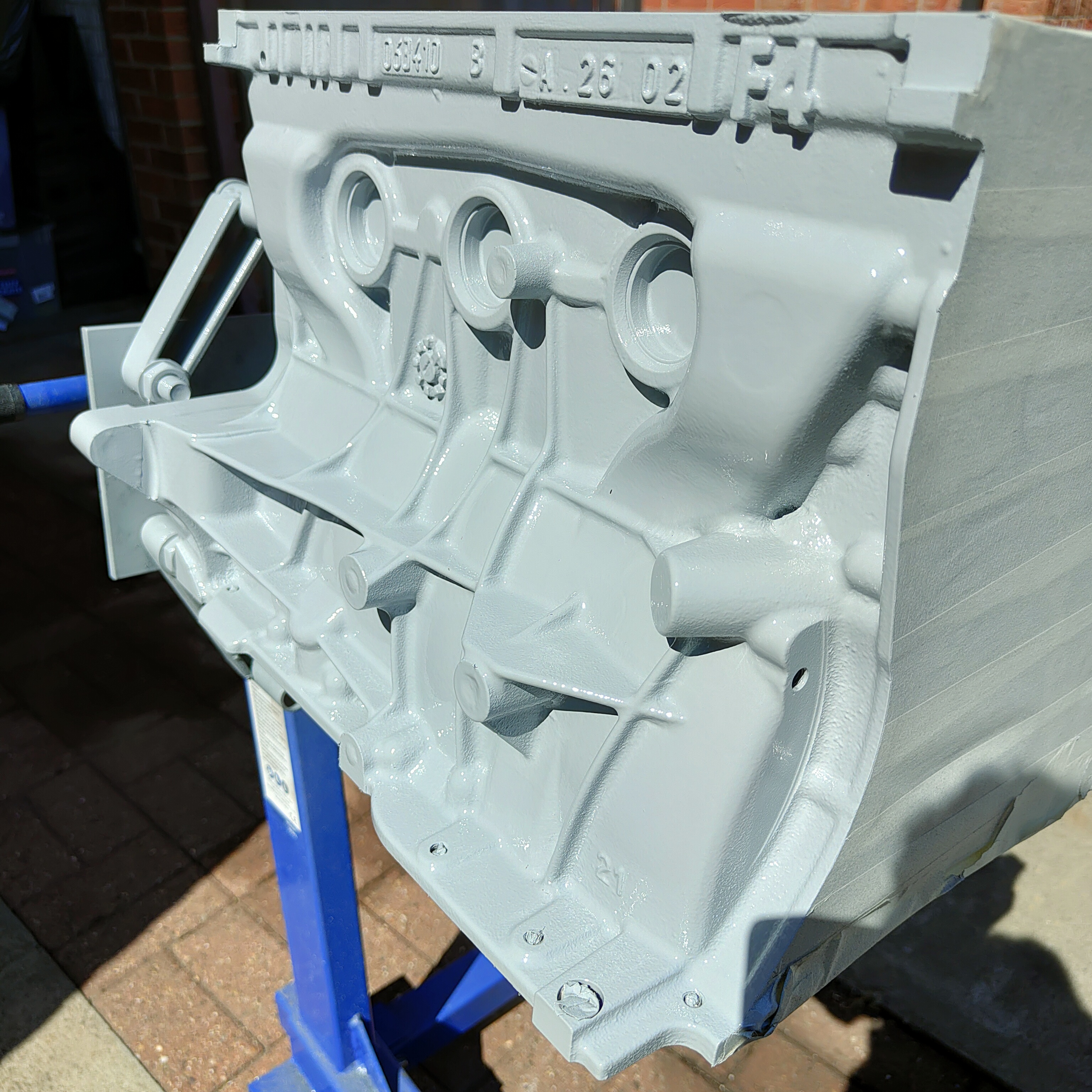

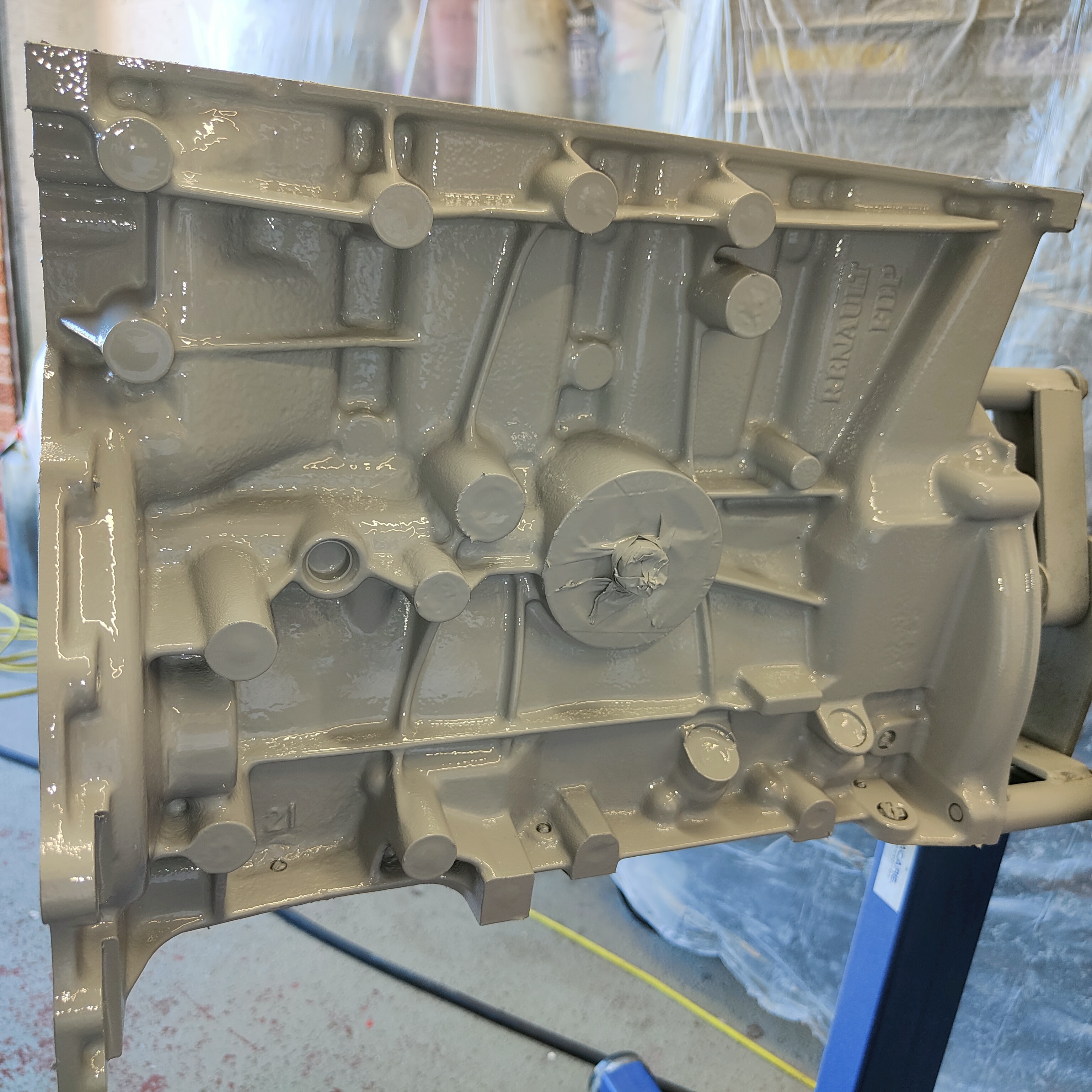

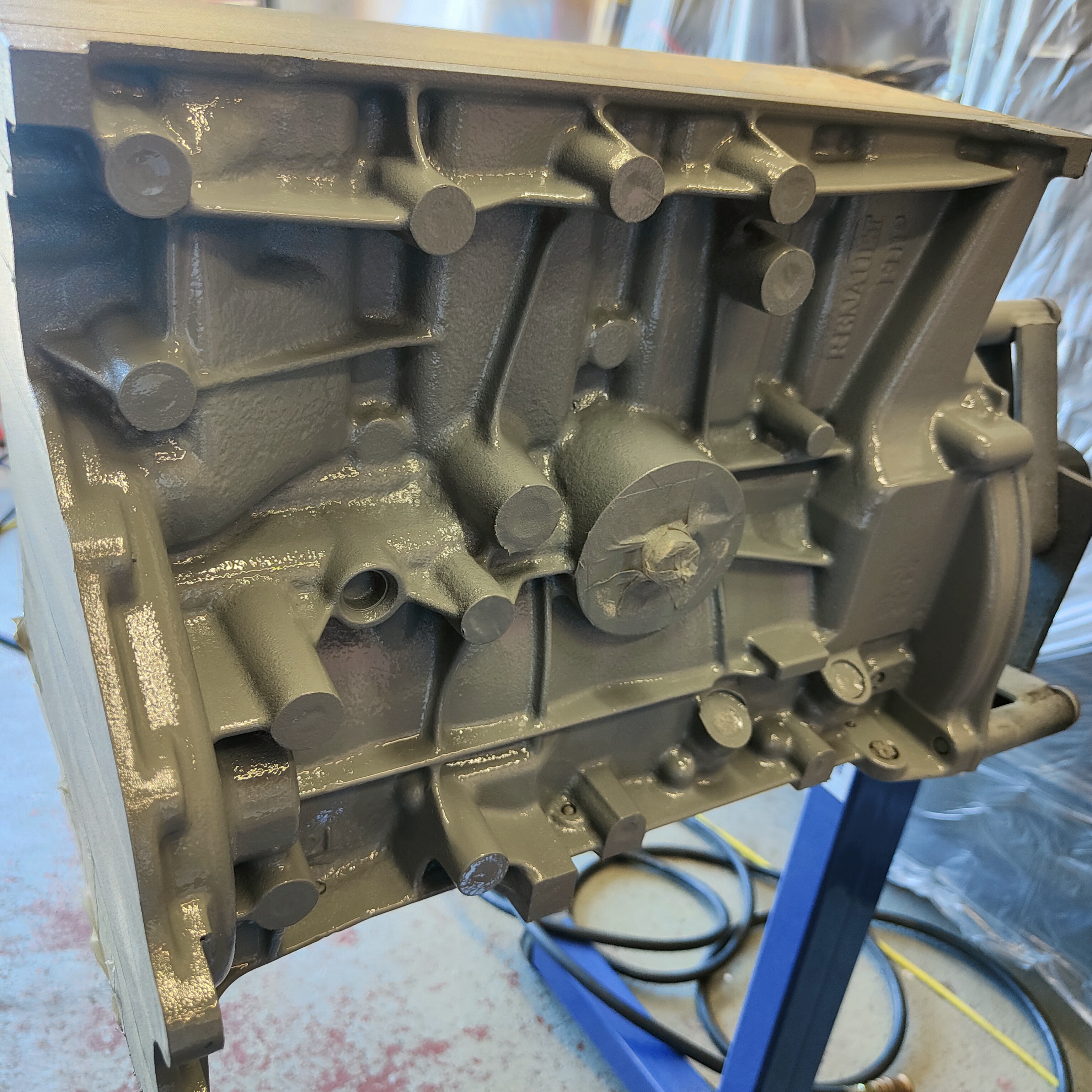

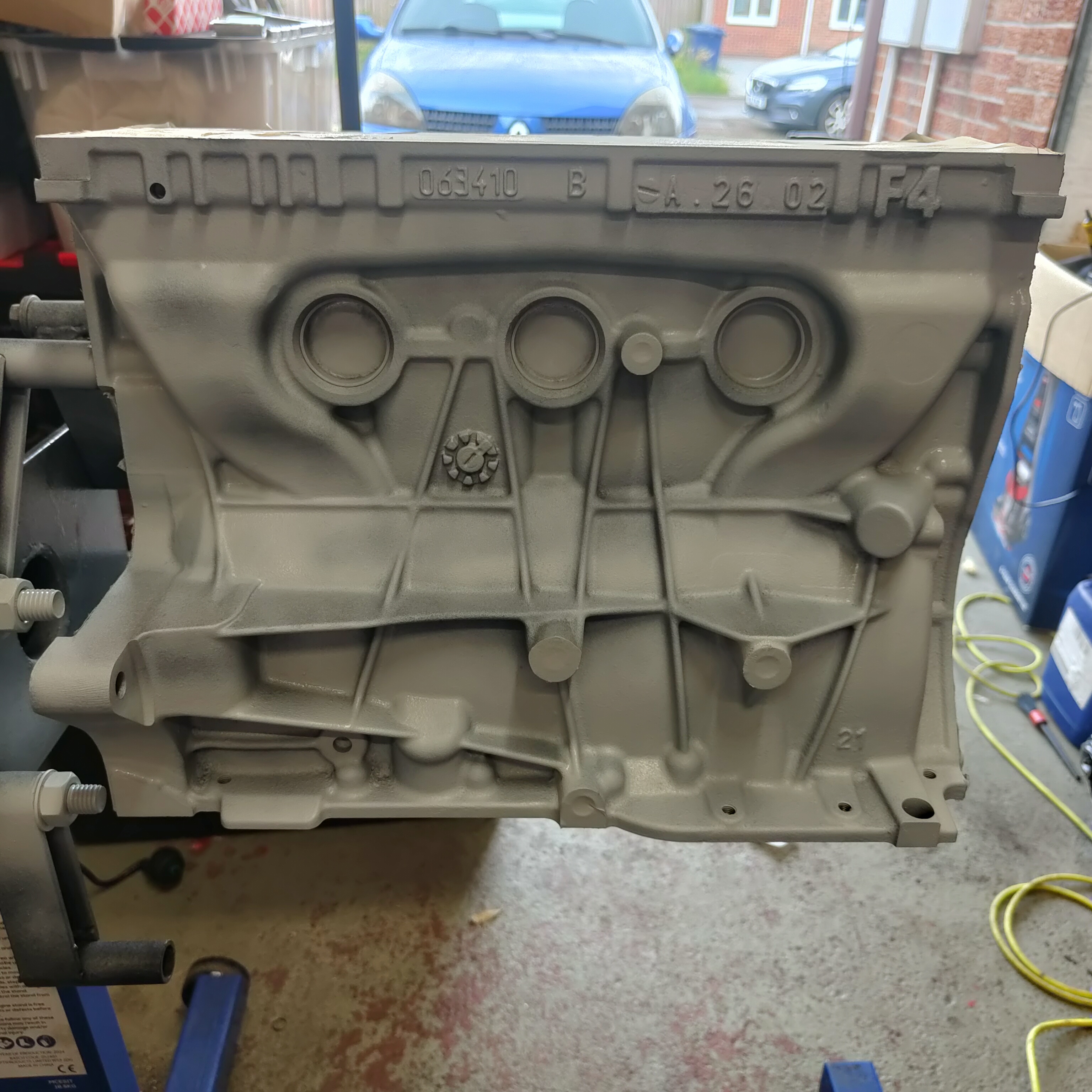

Got the block properly cleaned inside and out today, masked up and prepped for painting. All was fine until the paint started to dry and it was Matt.. I'd assumed the high temp engine enamel I'd bought would be gloss but it's not. It dried looking like primer.

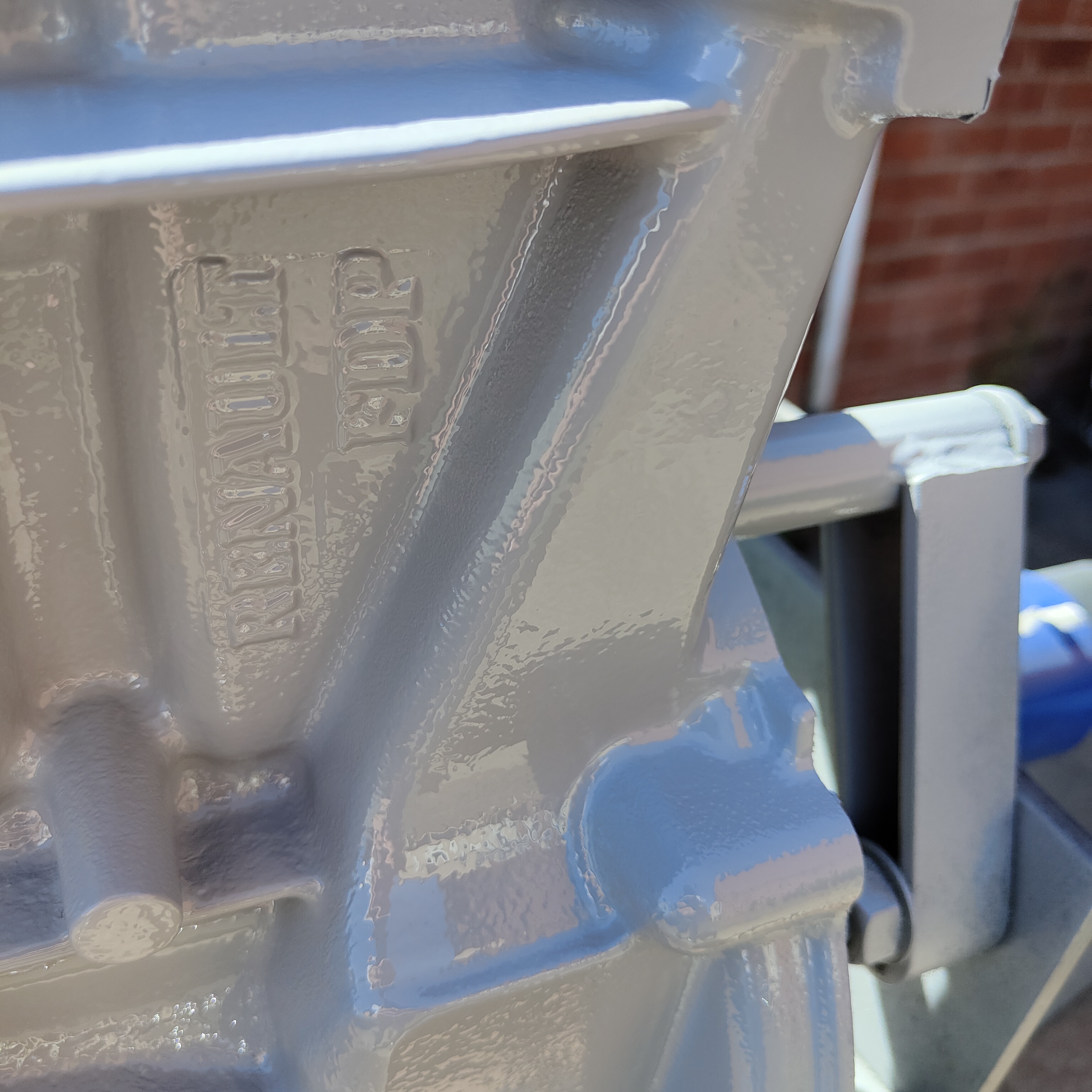

I absolutely hate it so I've just spent the last few hours wire wheeling it all off again, thoroughly disappointed but I couldn't live with it. I was trying to avoid spraying it with 2k because of the mess it makes in the garage but that's the way I'm going now. I've ordered a new mask and I'll try to get it done next weekend. I've got some black 2k and some Ducati red left over.. not sure what to use yet.
Round two of engine painting today, it's a pain getting the garage set up for spraying 2k but the results are worth it, I'm mega happy with it, exactly what I wanted first time round.
I've just cleaned my guns and shut the garage door, next time I'm home I'll unmask it, scrub the inside of the block out again and start building it up.

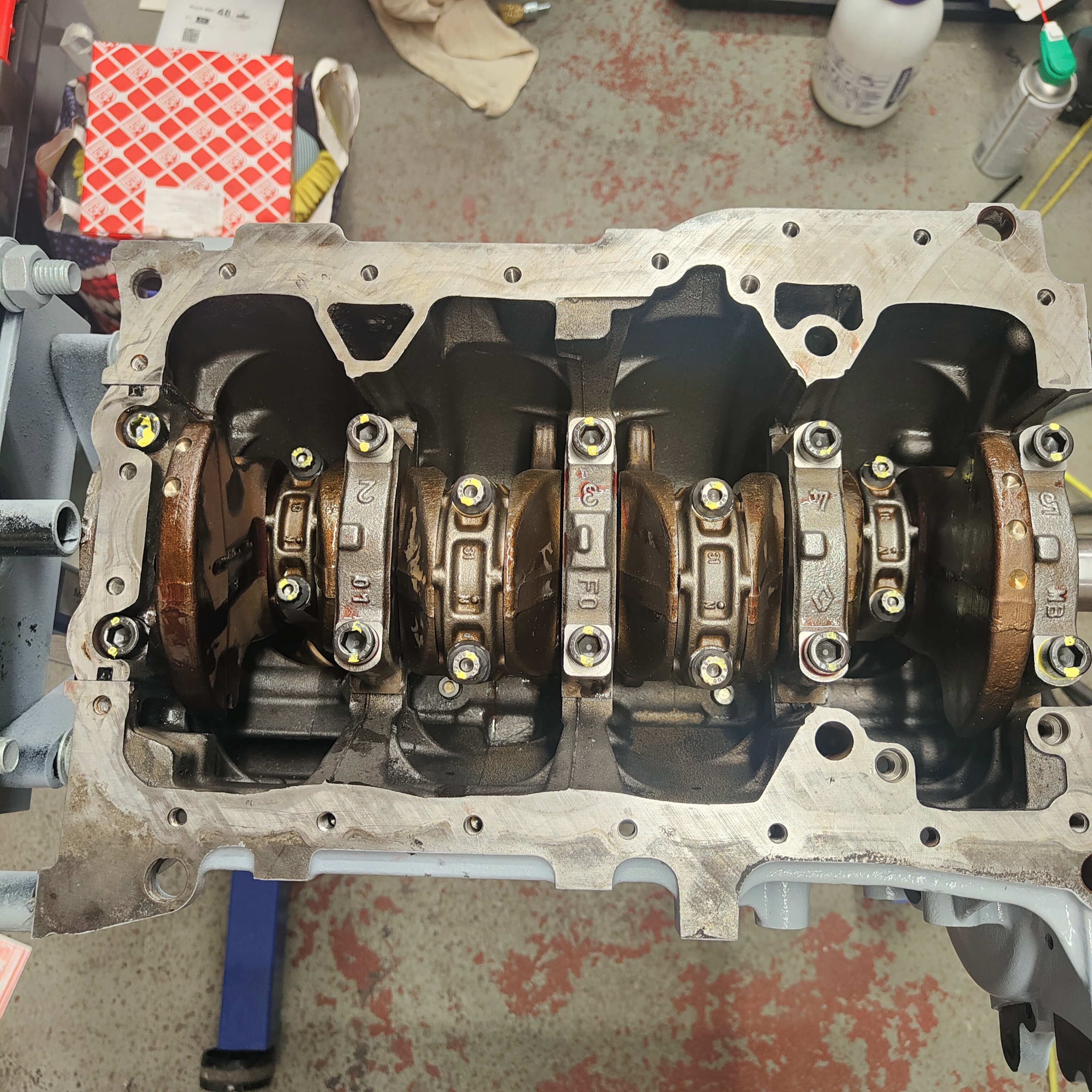

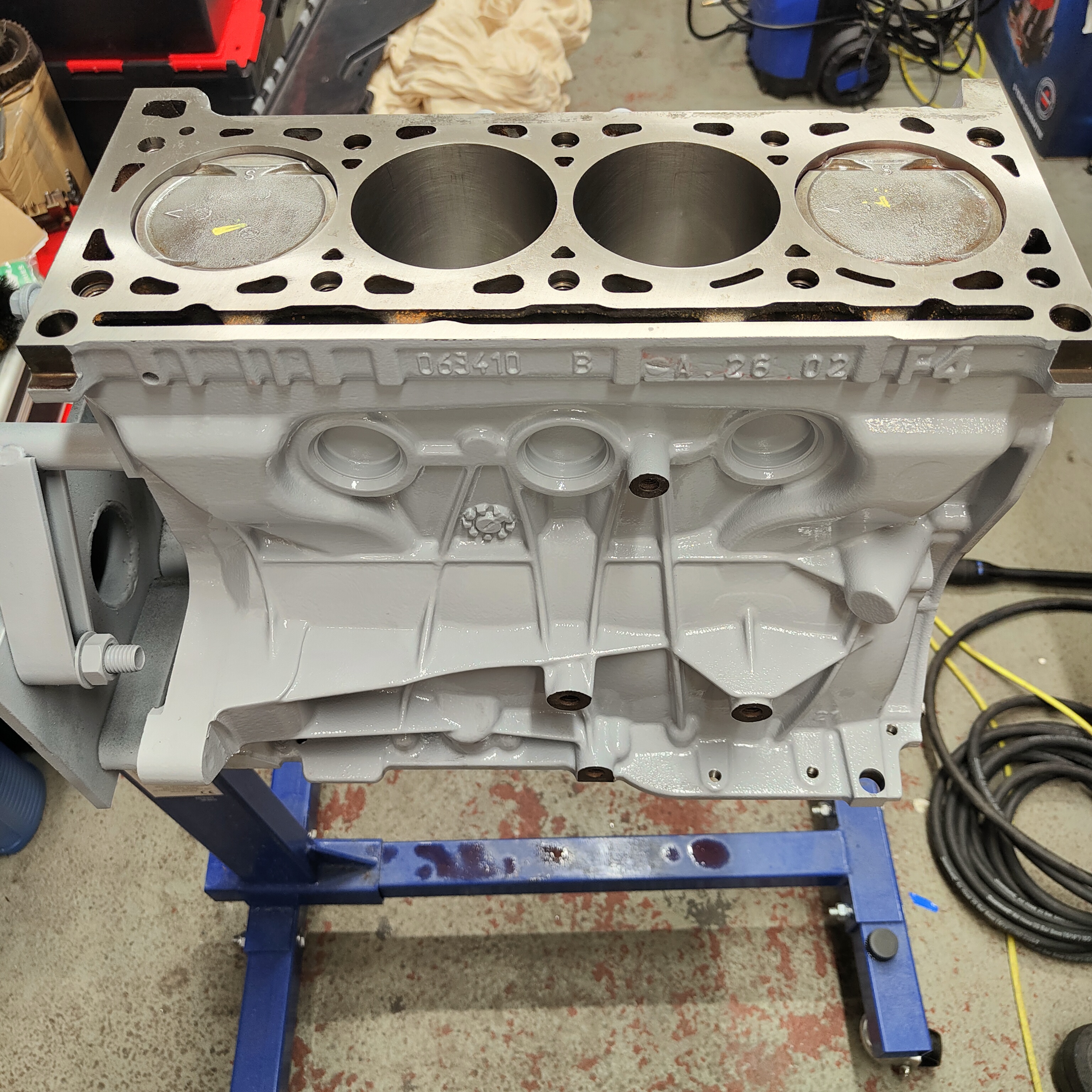

Started building the engine up this afternoon,

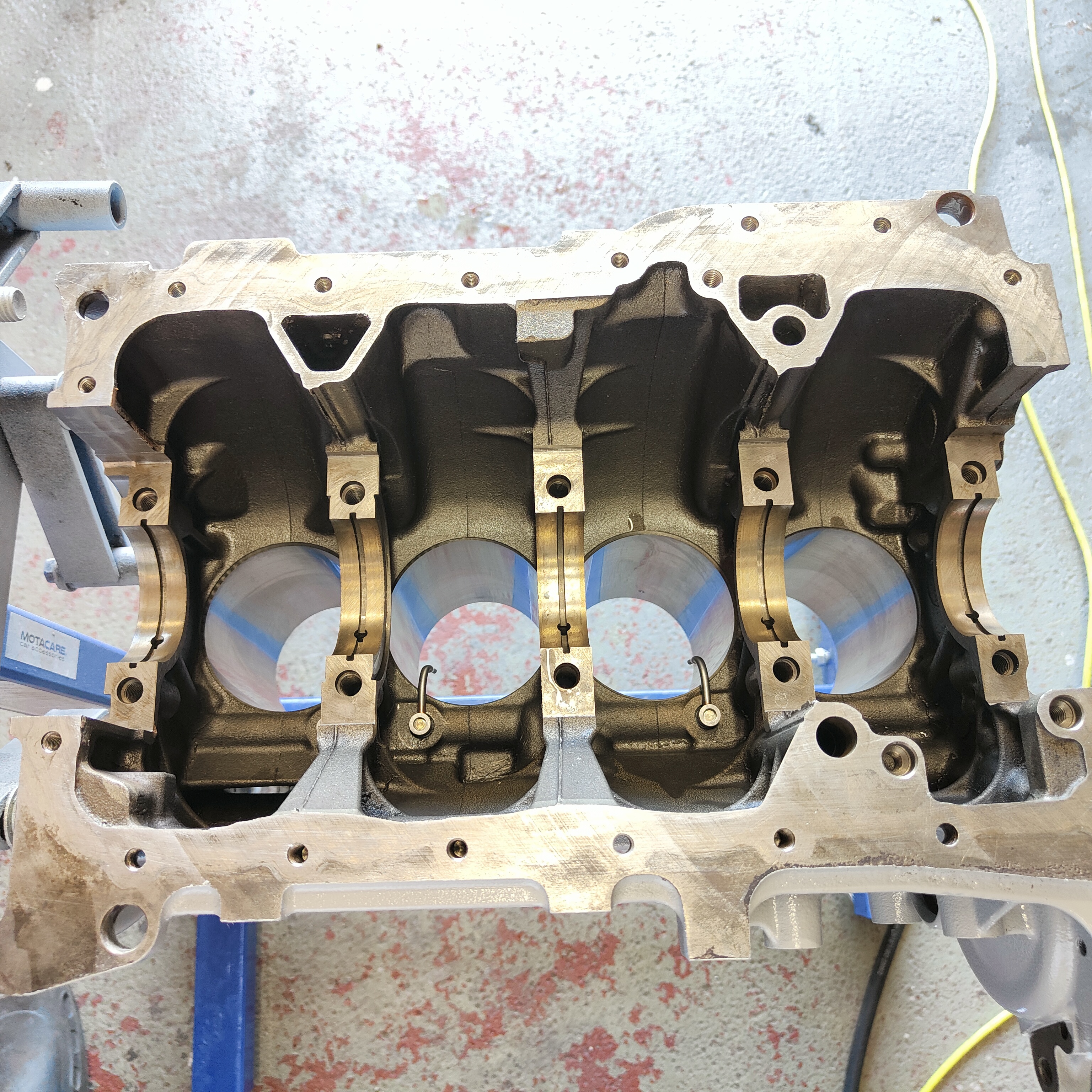

Got the block jet washed, scrubbed, brushed out the oil ways etc and blew it all dry with an air line

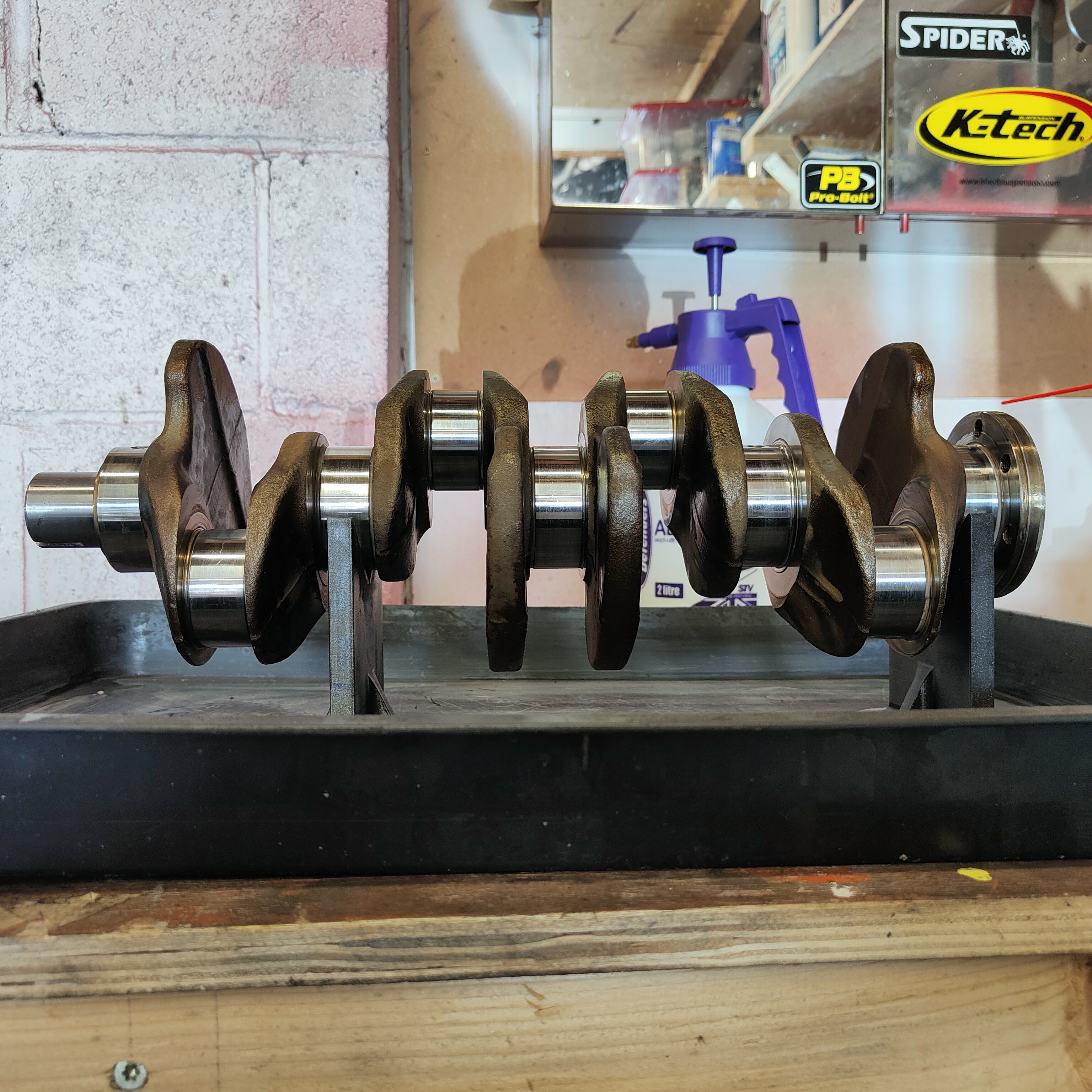

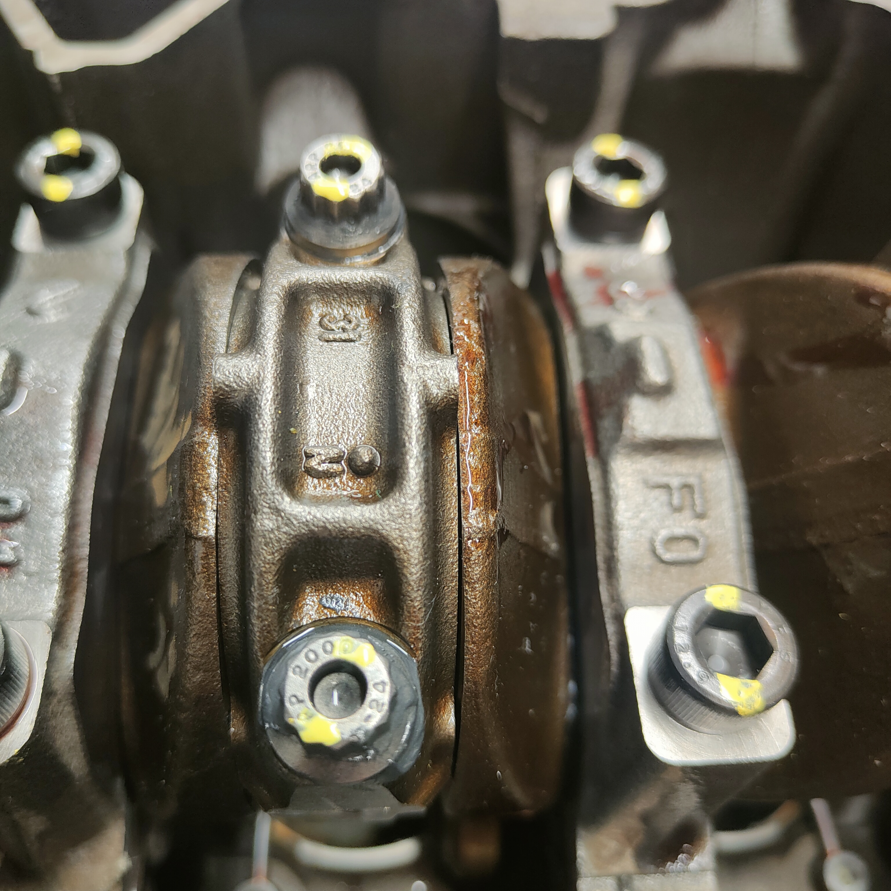

Cleaned the crank, brushed through and sprayed out the oil ways with loctite degreaser, cleaned the journals with IPA and measured them again.

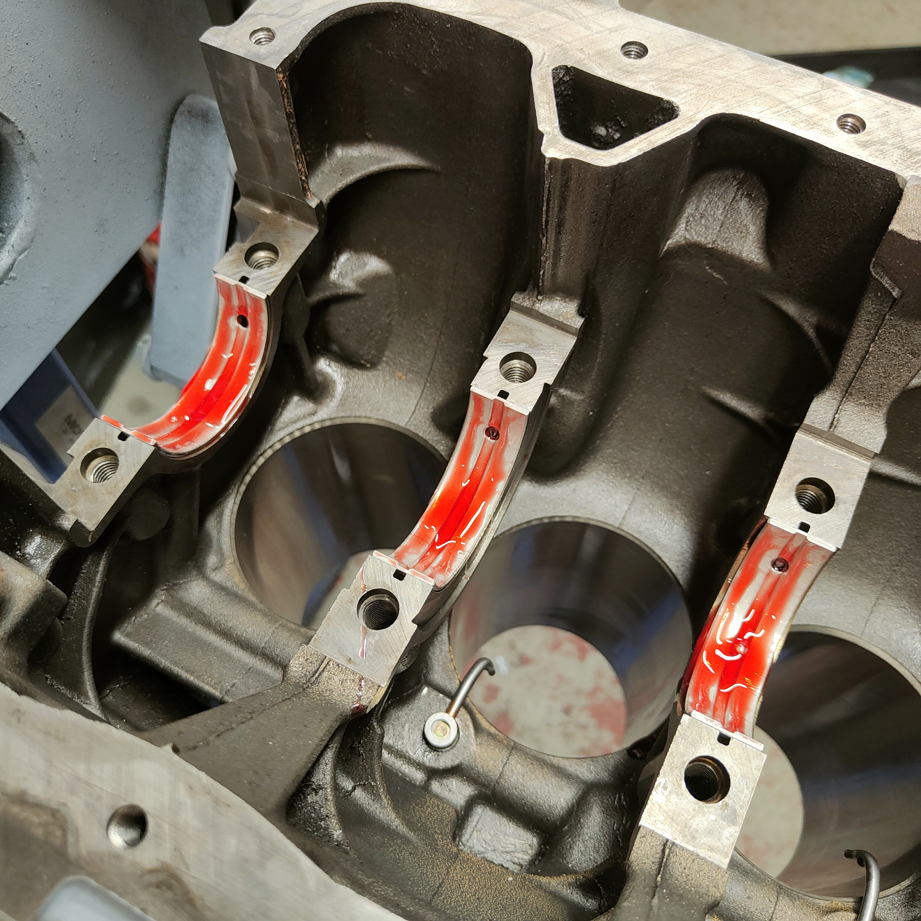

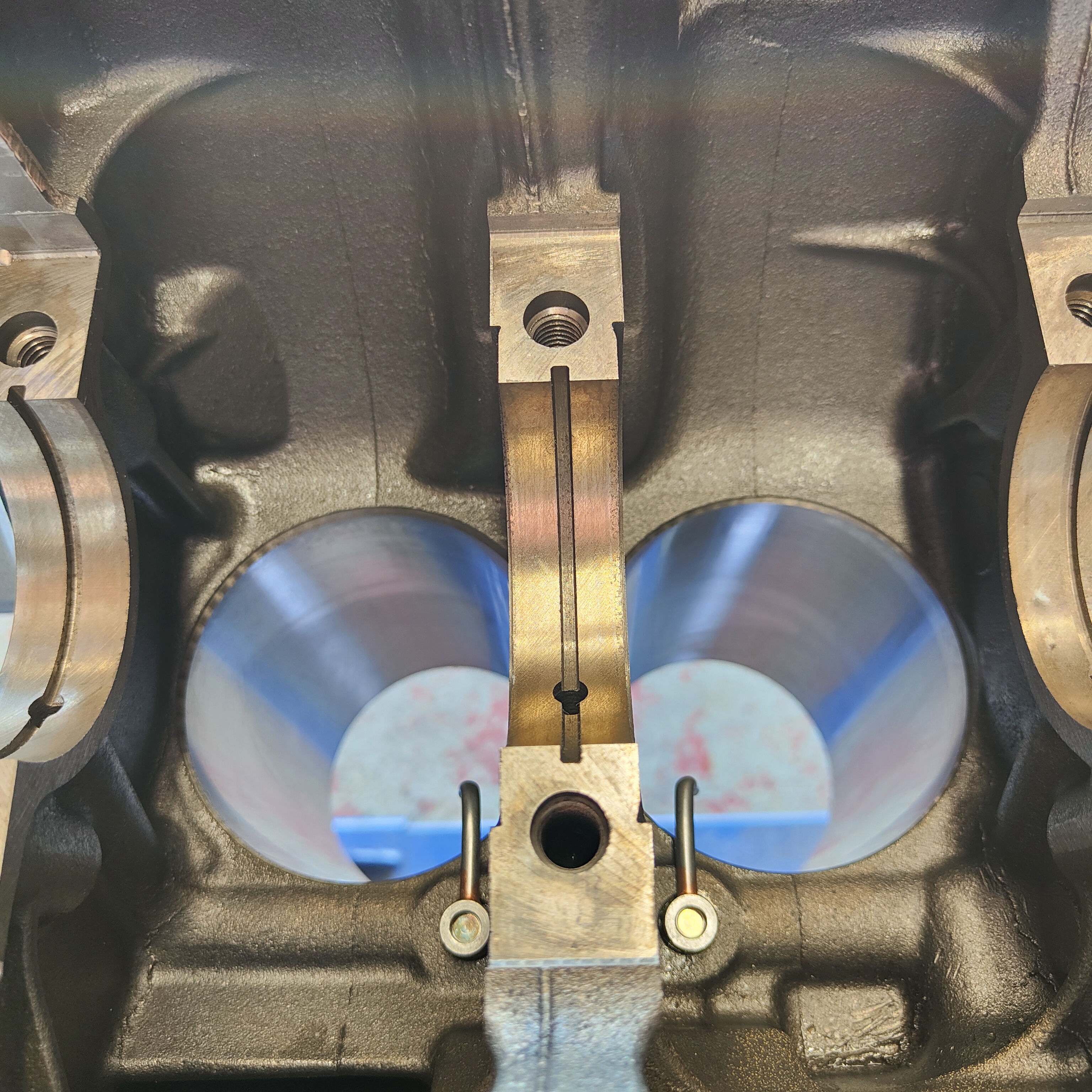

Dry fitted the bearings and measured the clearances with a dial bore gauge, then backed it up with plastigauge, checked the crank end foat then covered the bearings in assembly lube and fitted the crank for the final time.
Measured the ring gaps, big end bearings clearances, fitted the pistons to the rods and new rings to the pistons and then fitted the pistons into the block, backed up the measurements with plastigauge again then lubed everything up and torqued it all again.

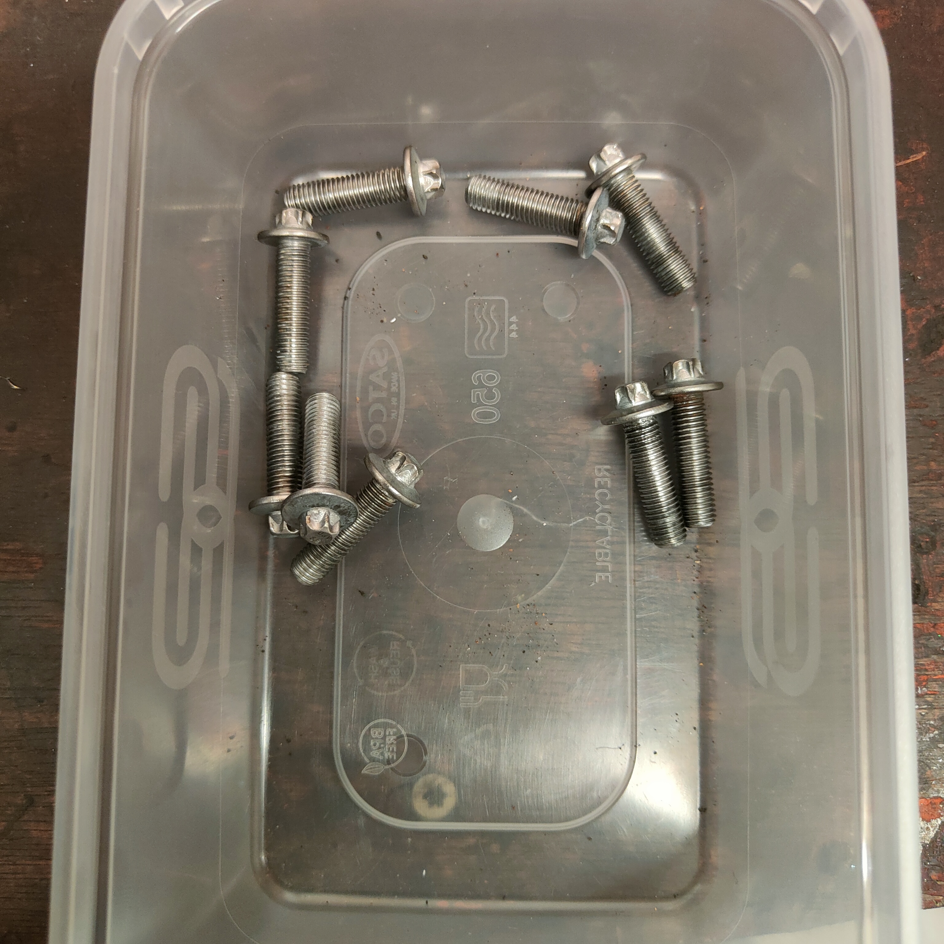

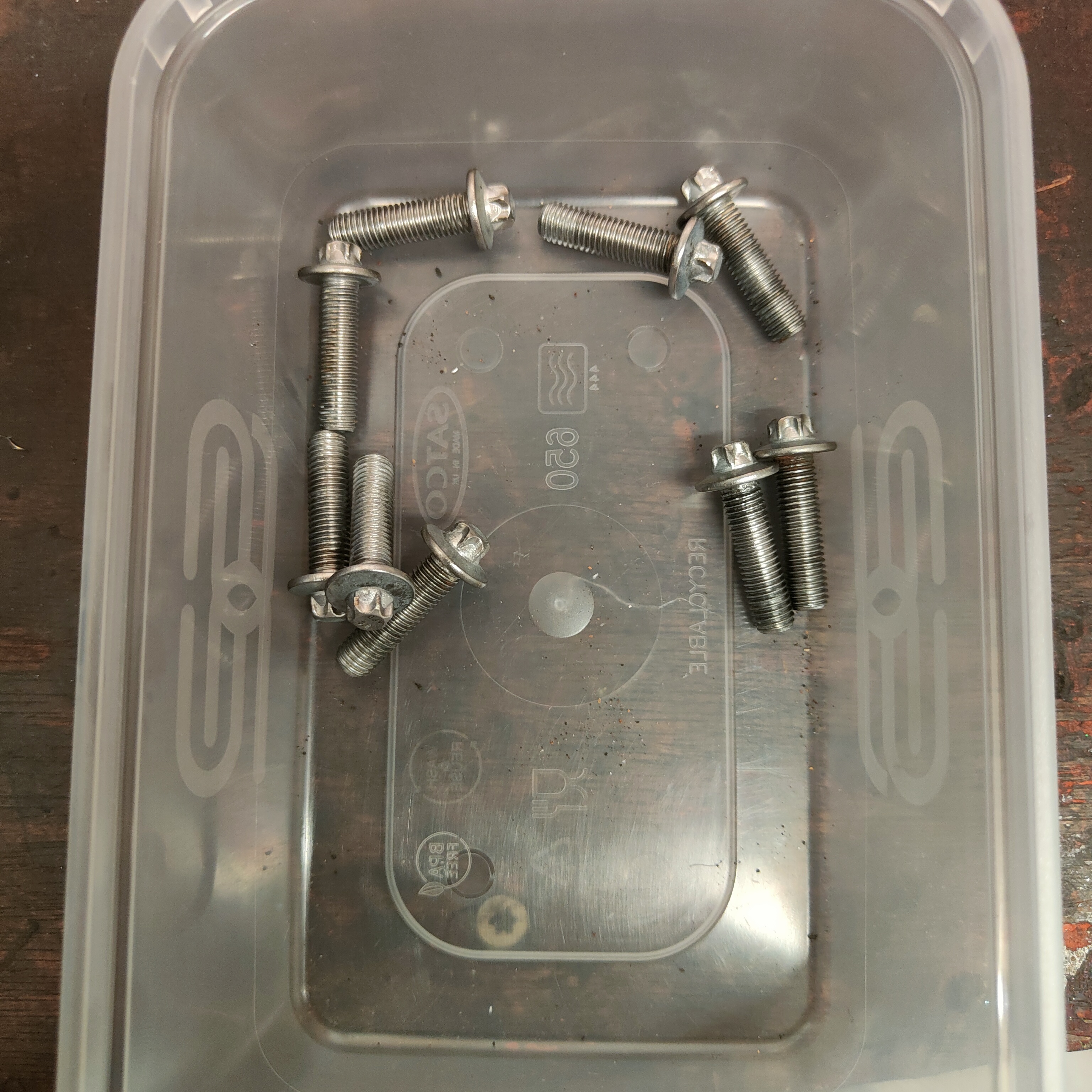

I'll try to get another couple of hours in there tomorrow before I go back to work, I need to buy a zinc plating kit and do all of the fasteners that came off the engine before I can go much further though.

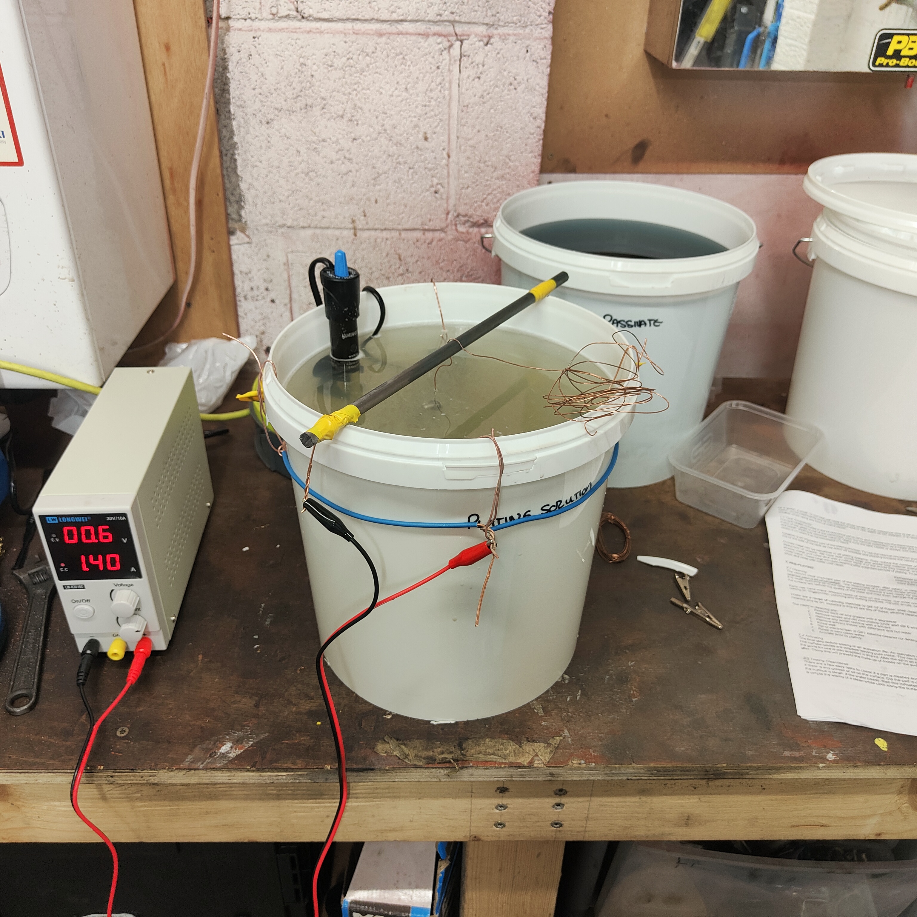

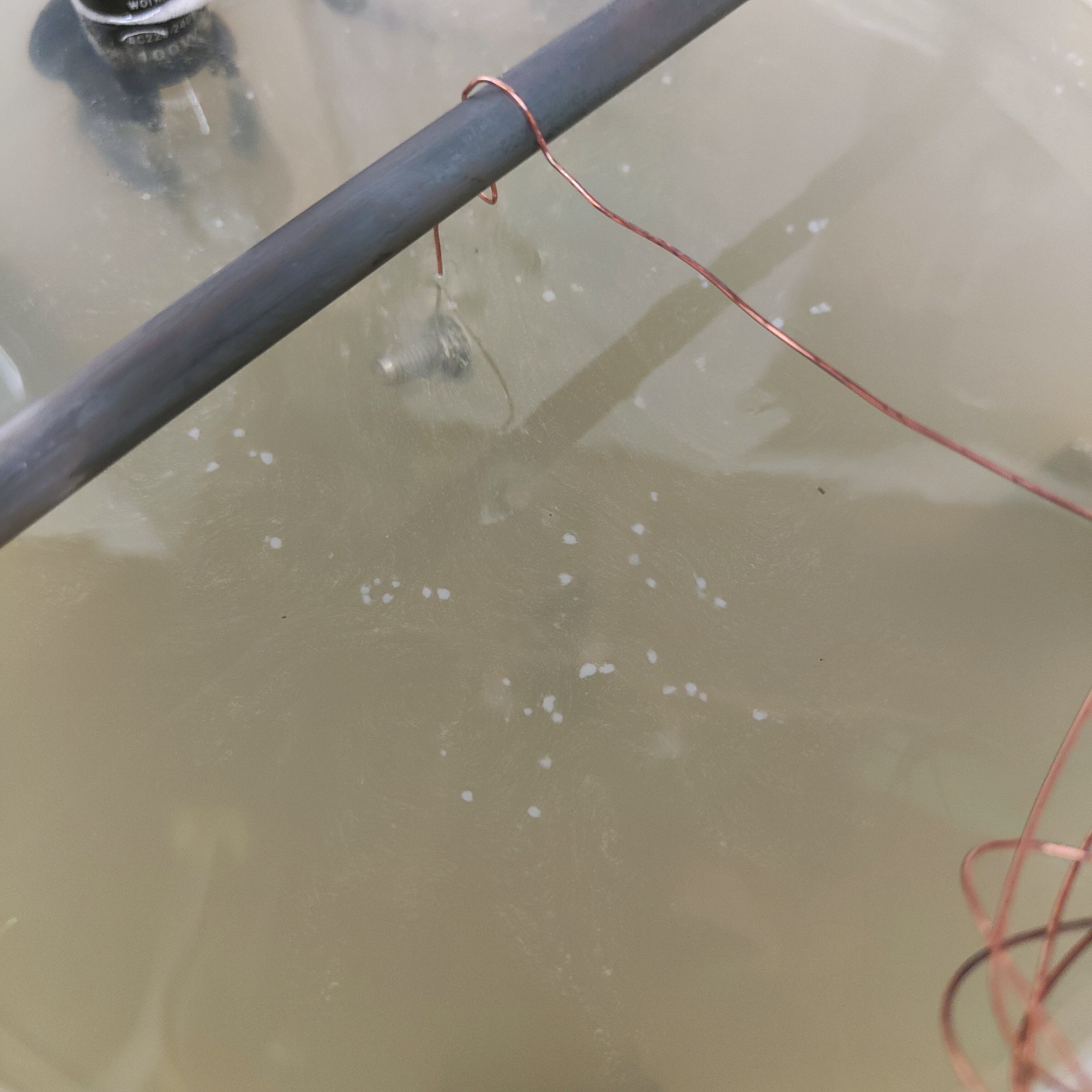

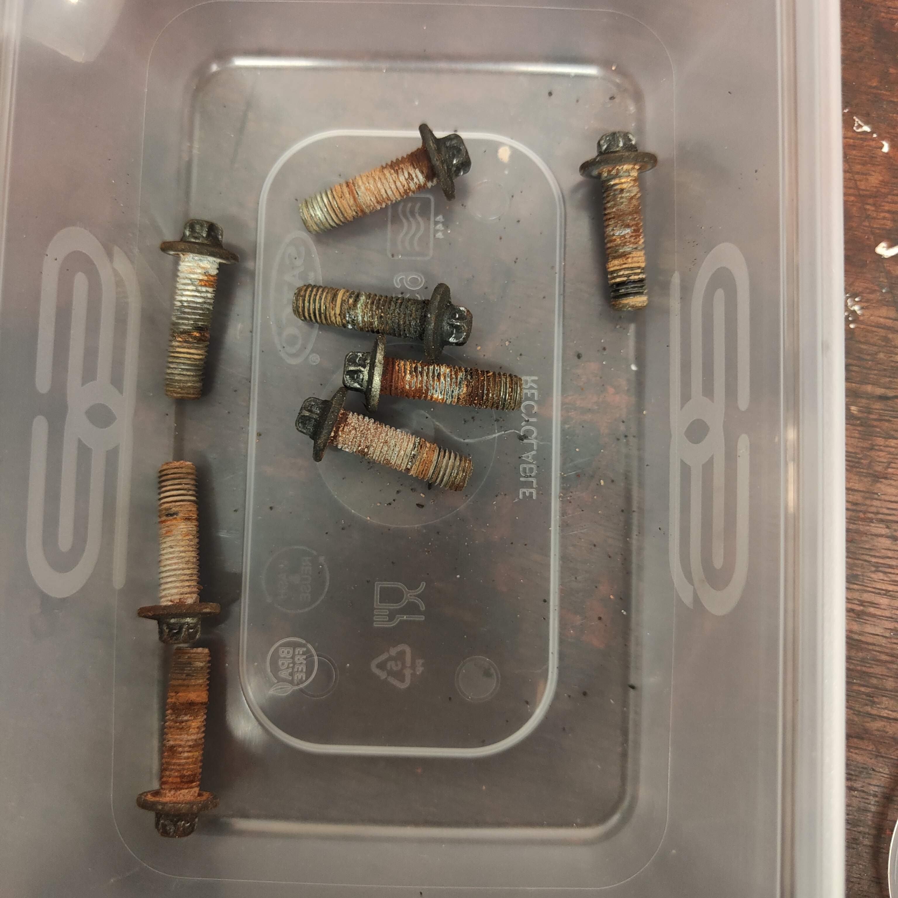

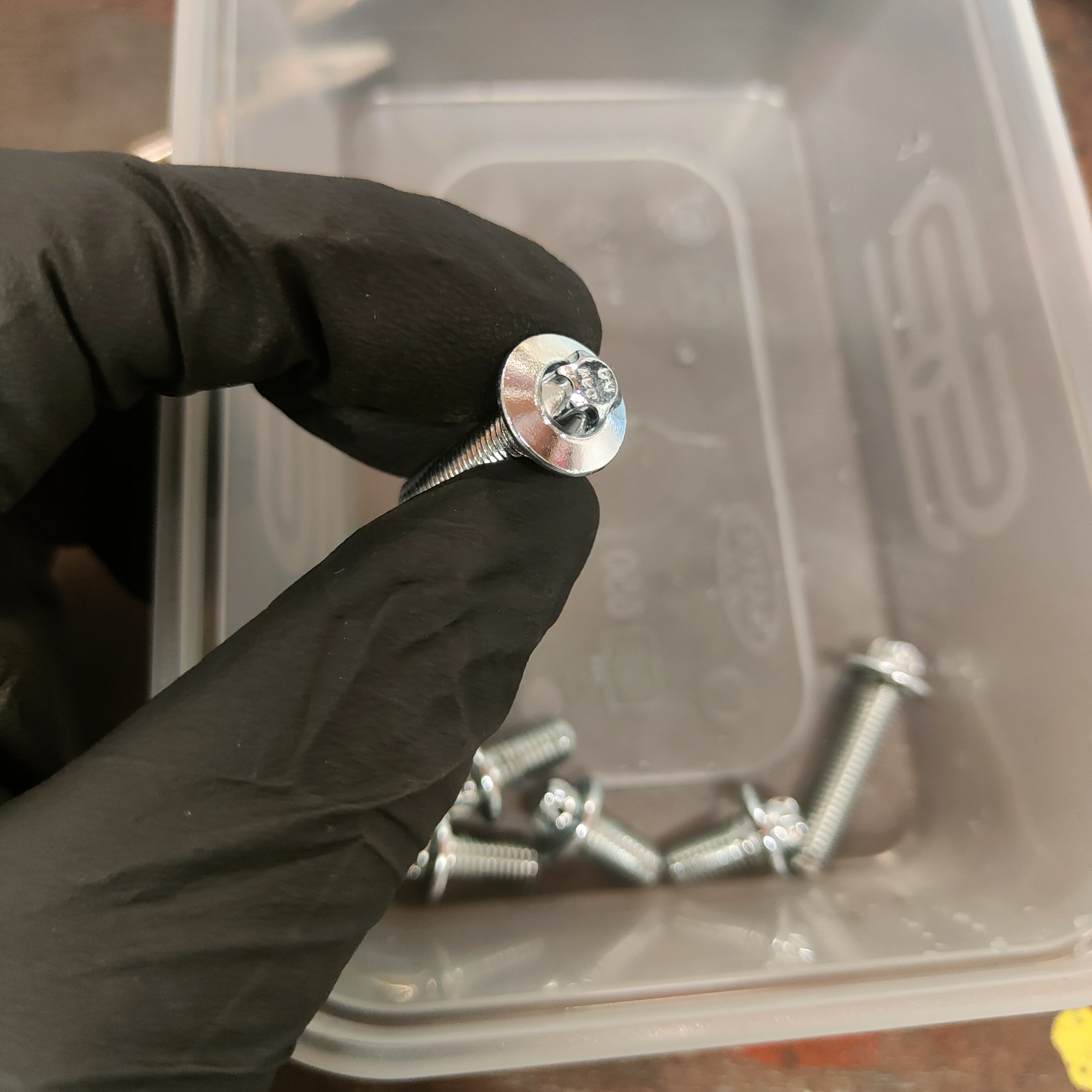

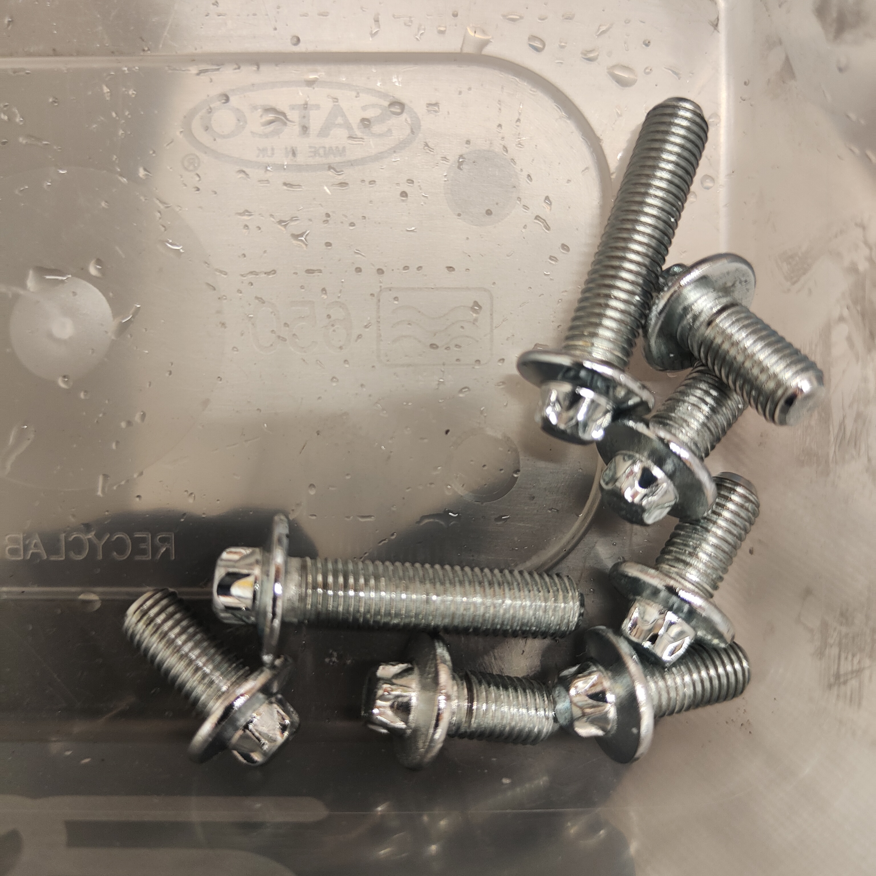

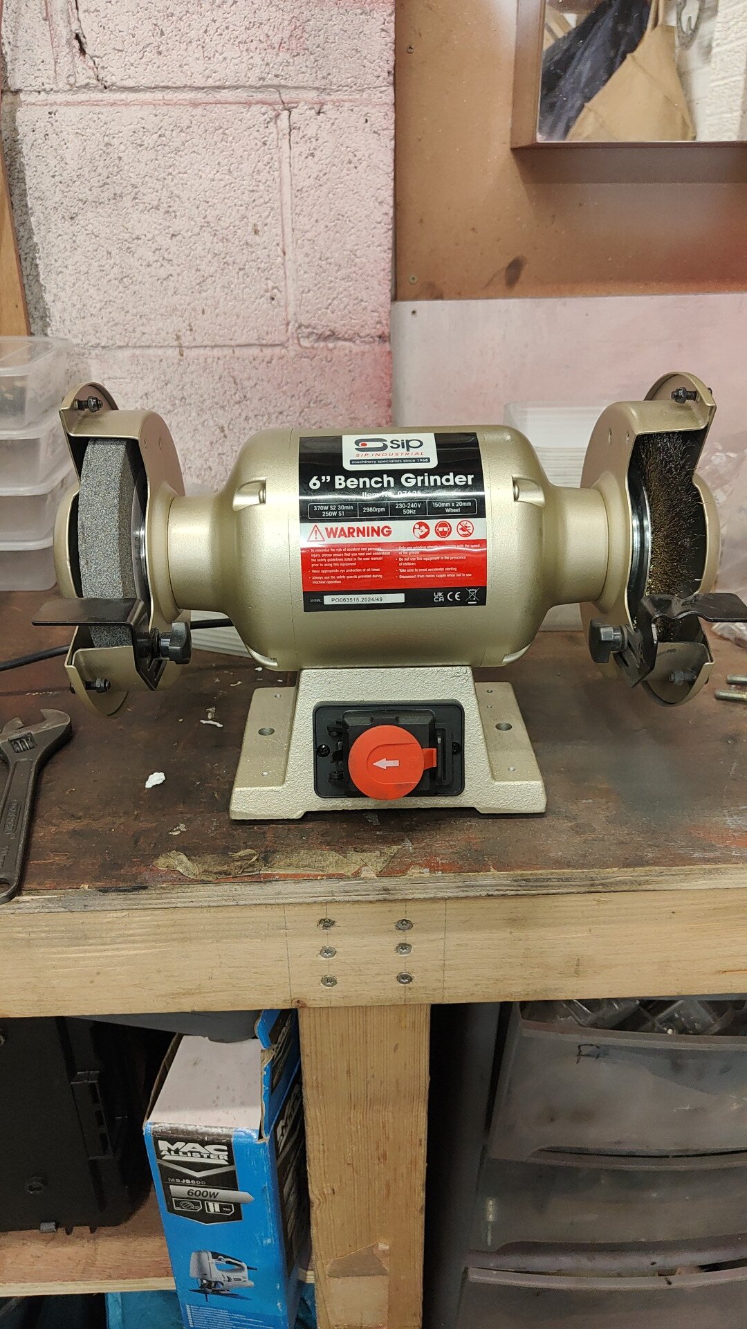

New bench grinder and zinc plating kit was delivered this week so I've started stripping all of the old fasteners and had a go at plating, never done it before but it's pretty easy, if time consuming.
Buzzing with the results, everything that comes off the car is getting re-plated, I'm away to work for a while now though so will have to wait until I get back before any more progress.
View attachment 1751640View attachment 1751641View attachment 1751642View attachment 1751643View attachment 1751644View attachment 1751645View attachment 1751646
Just be careful with hi-tensile bolts and zinc plating. You can end up with hydrogen embrittlement 👎

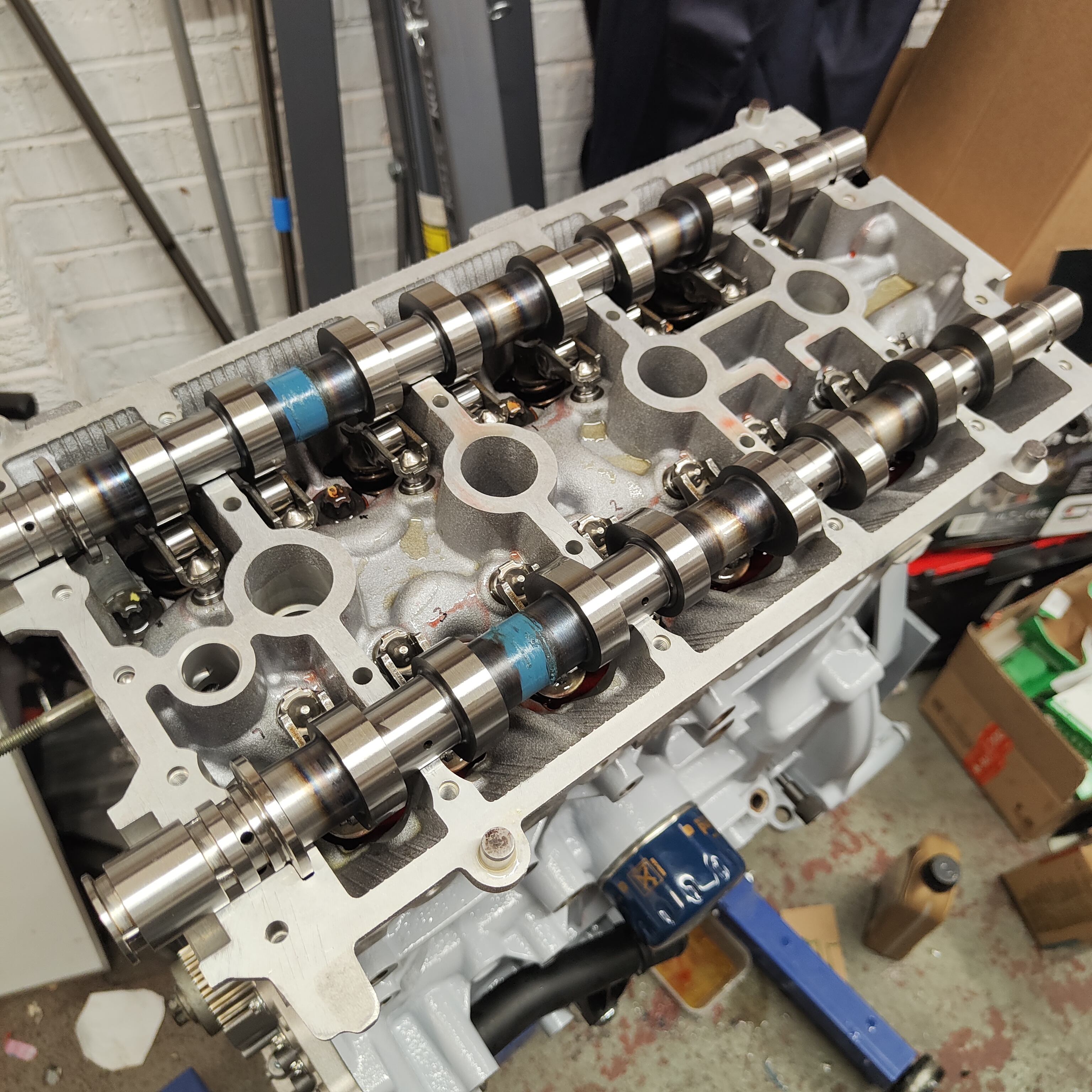

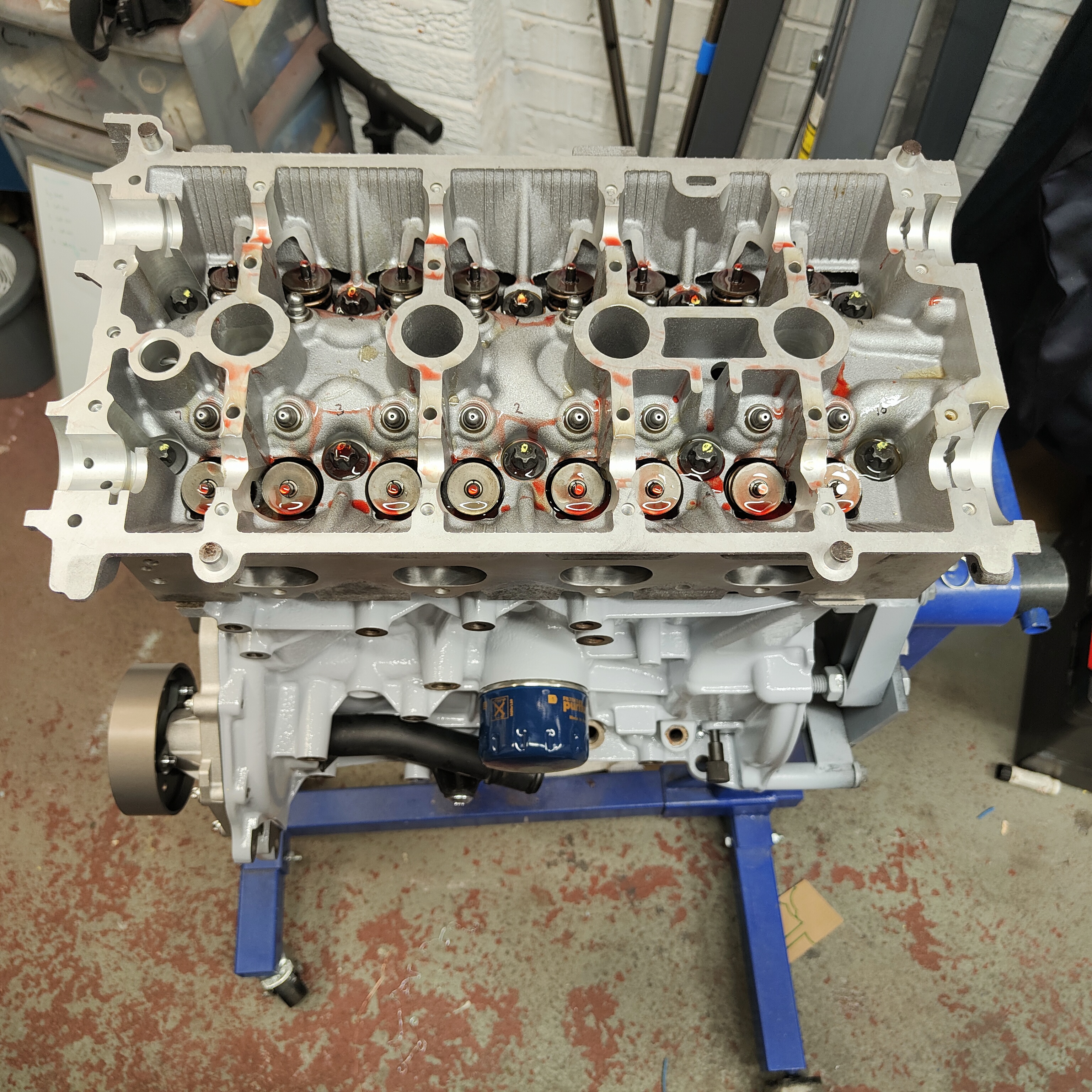

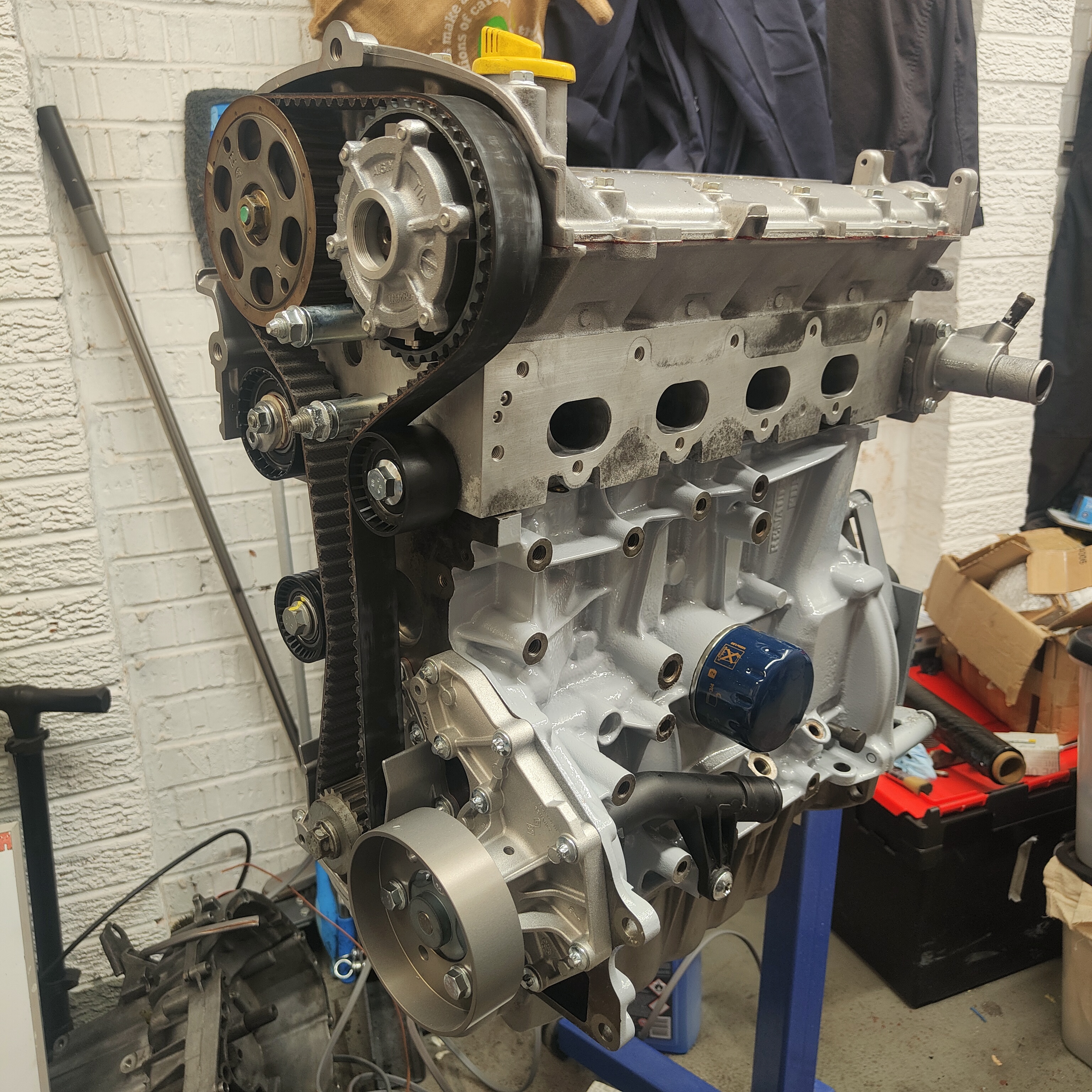

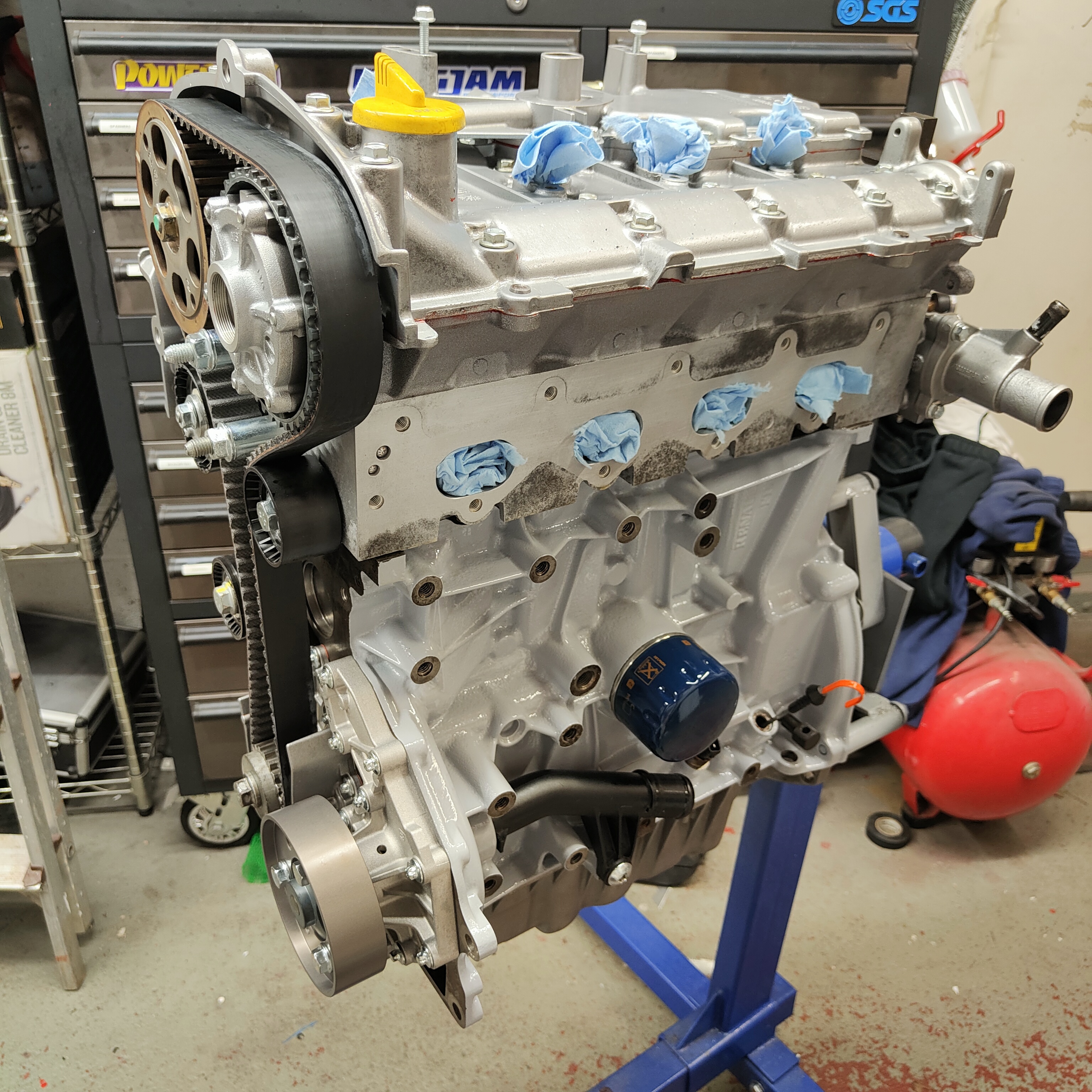

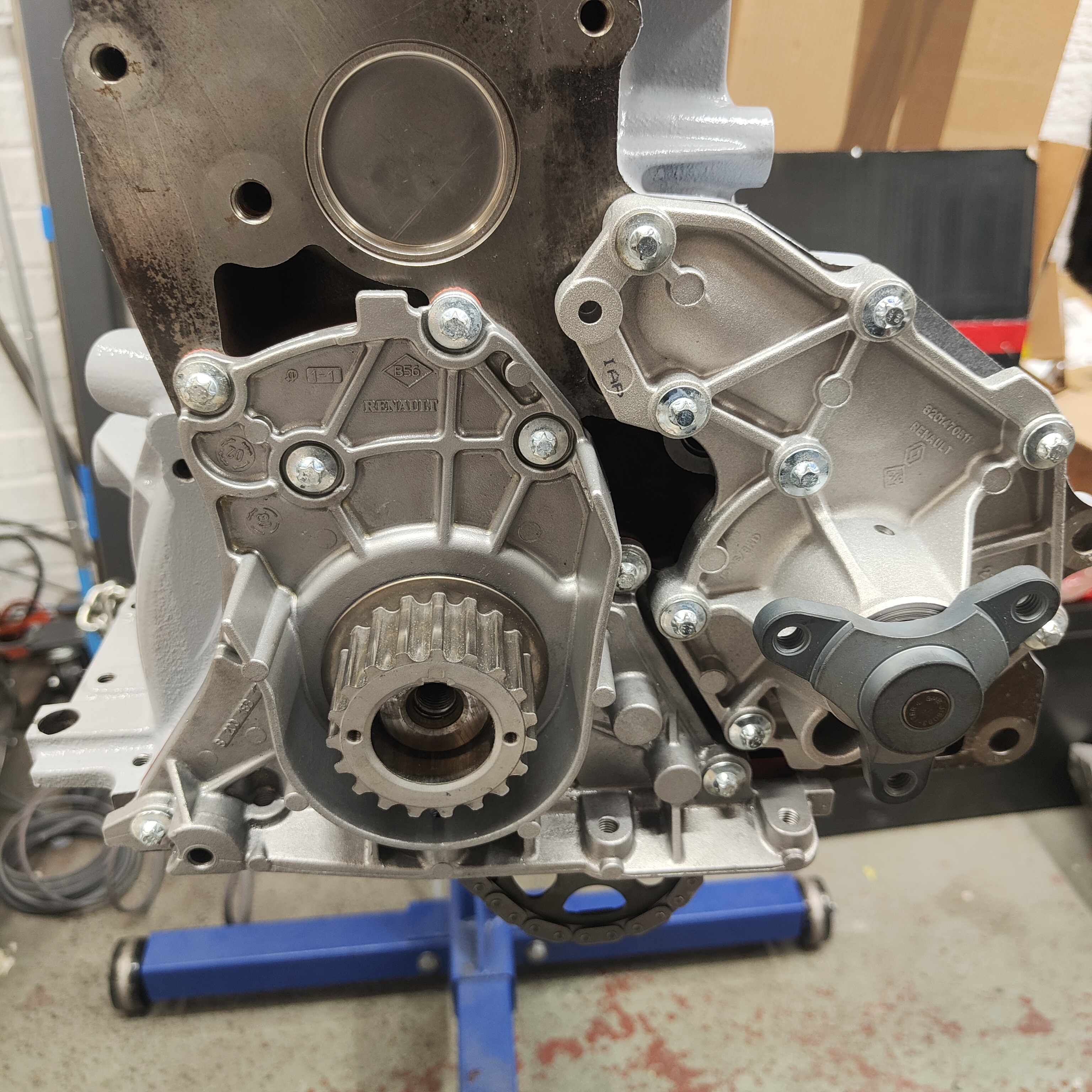

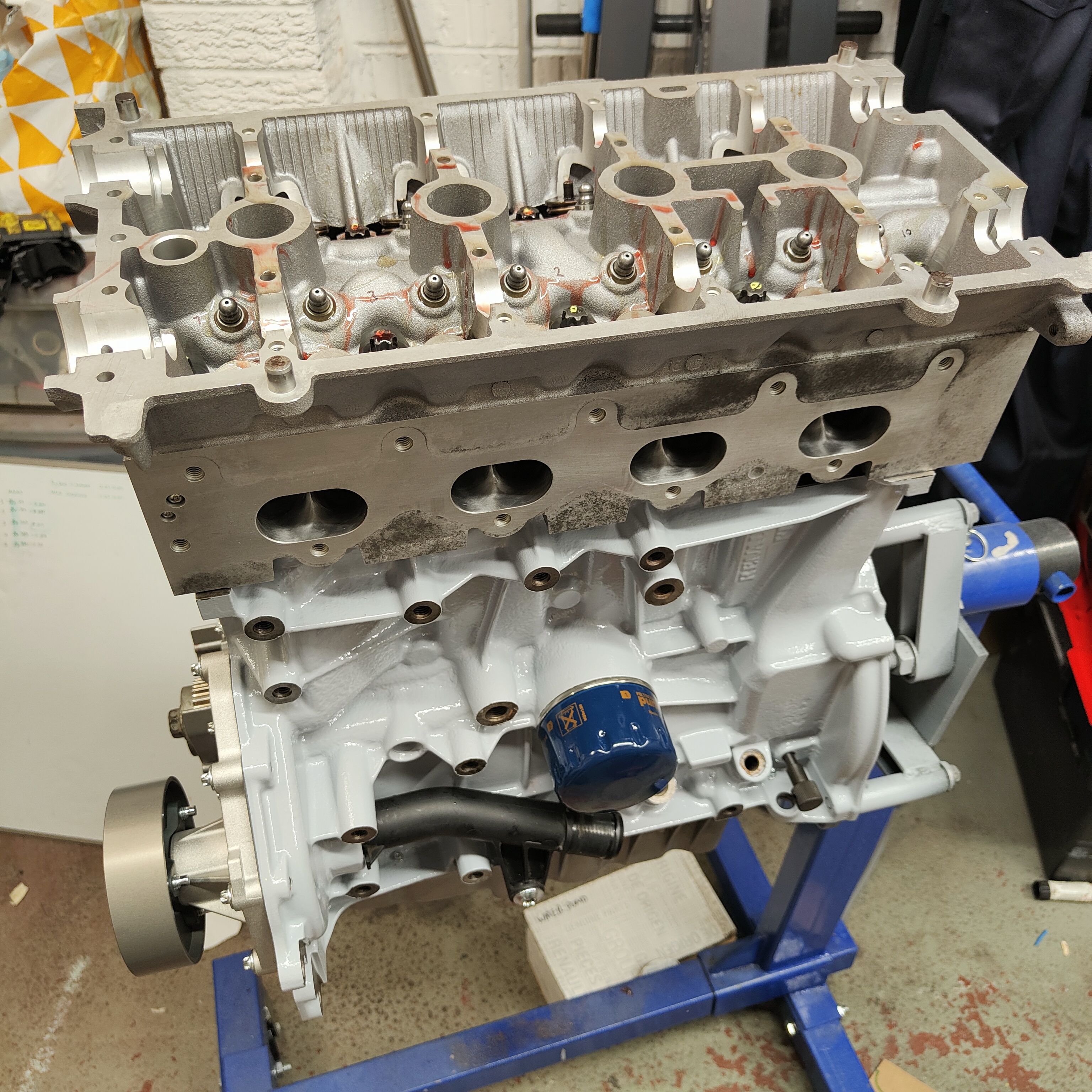

Had an unexpected weekend at home so carried on building the engine up,
Got the head on, new lifters, rockers, cams in, cam cover on, timed up with OEM timing tools. Unfortunately when turning over the engine by hand it's free to turn but the (new OEM) dephaser was making a weird clicking/popping noise. I'm sure it's isolated to the dephaser.. I've ordered another new one and new pulley nut/bolt and dephaser cap so I can try again next time I'm back.
