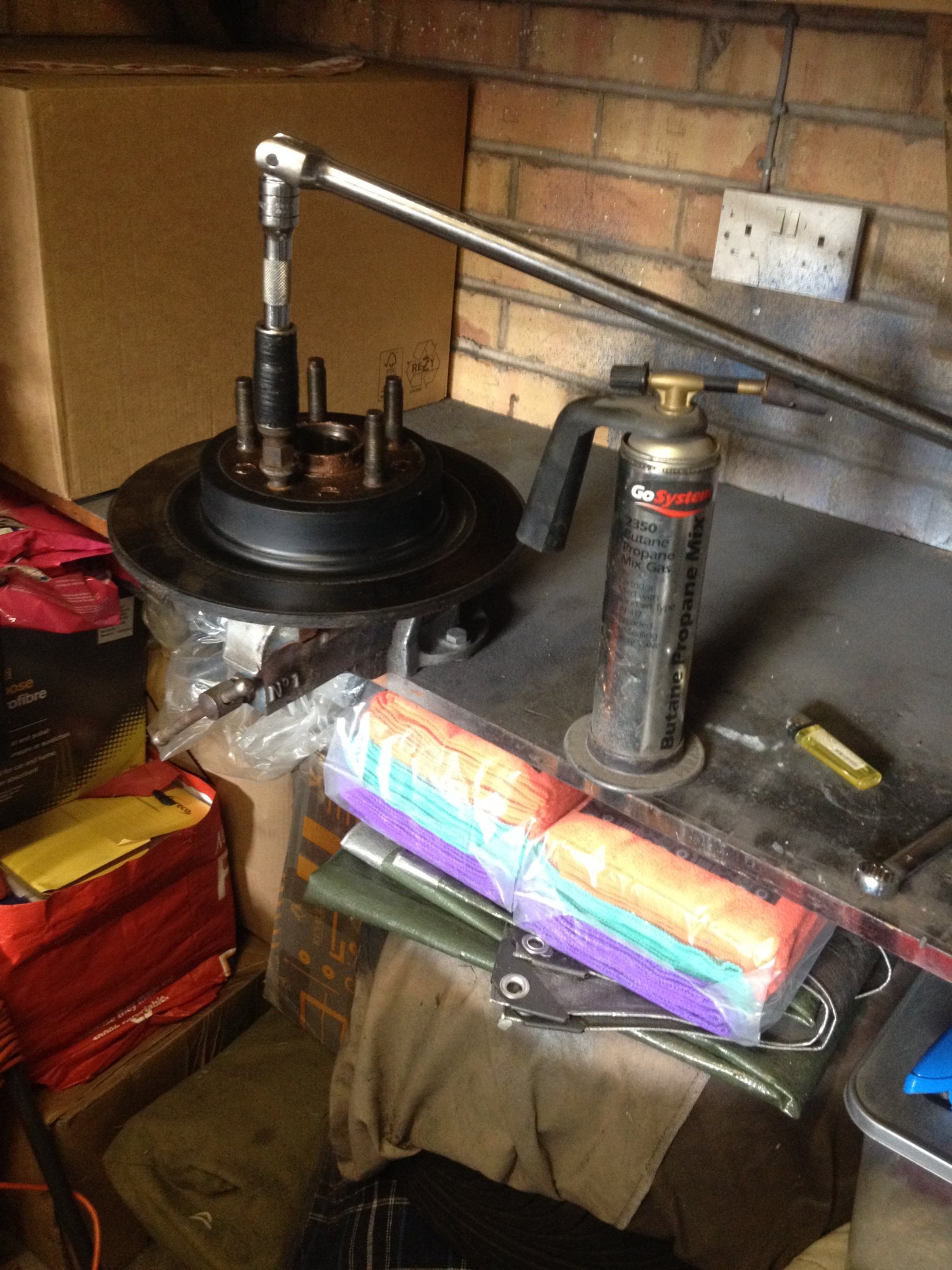

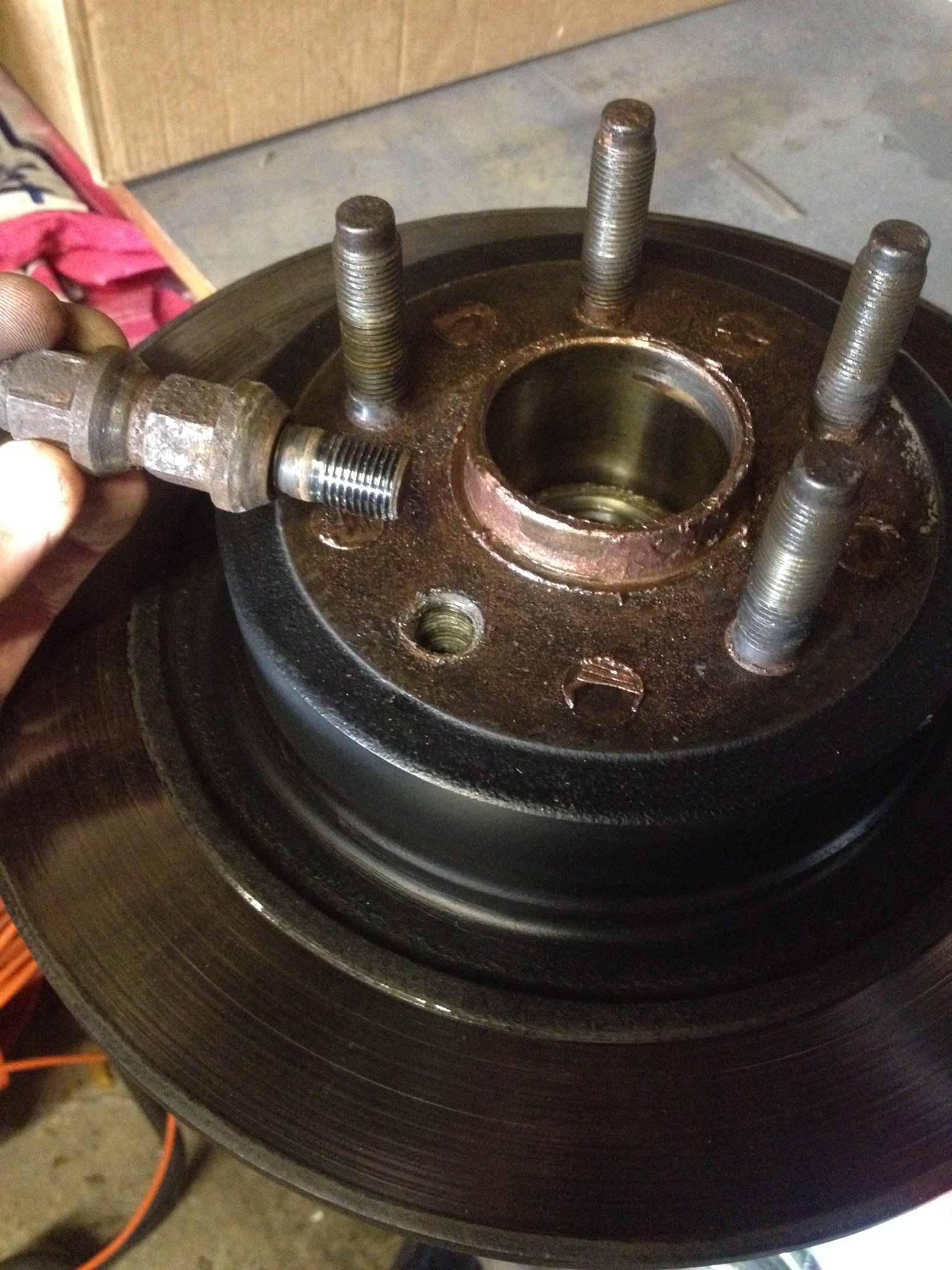

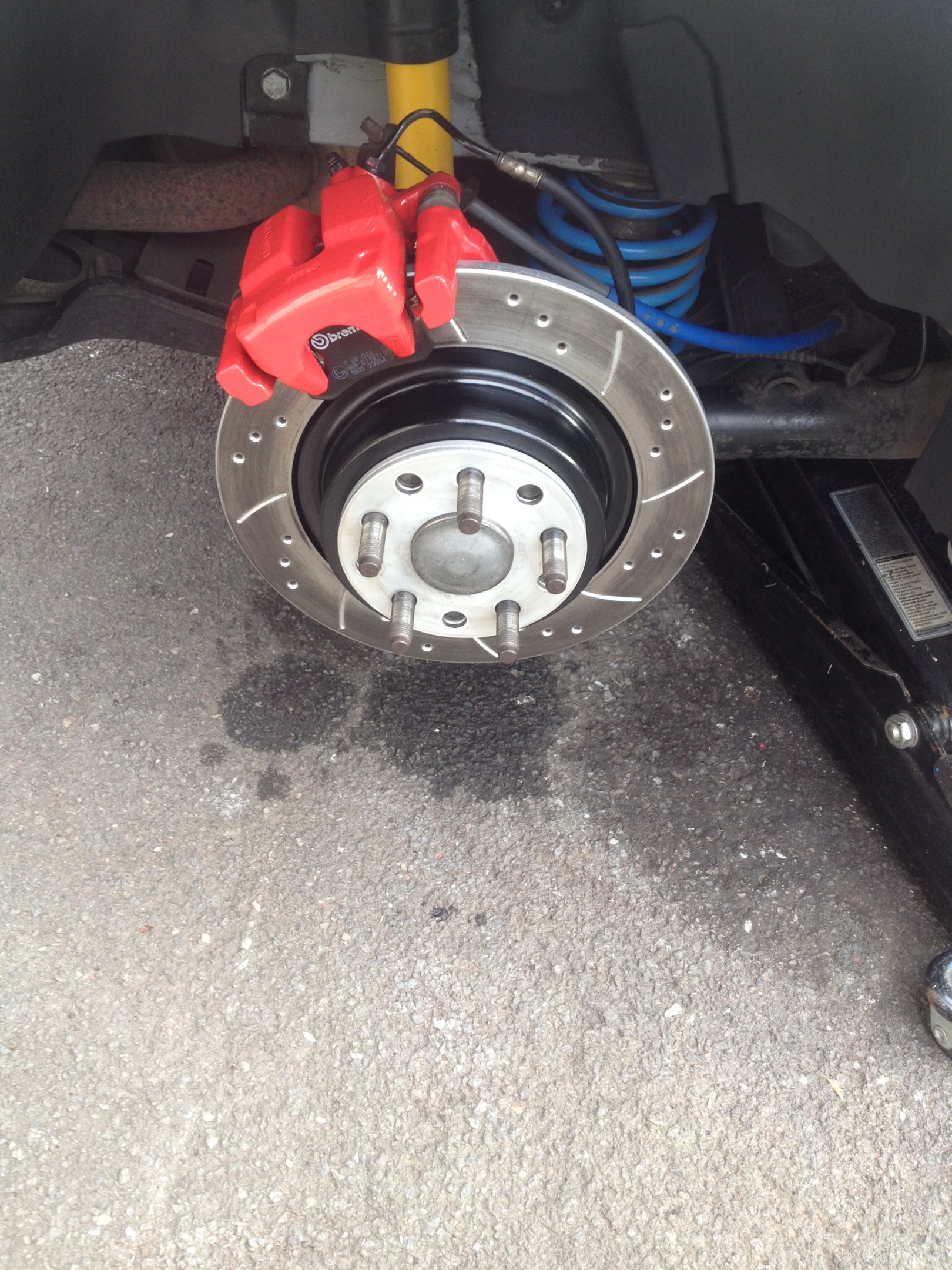

Finally got the rear brakes done :smile:

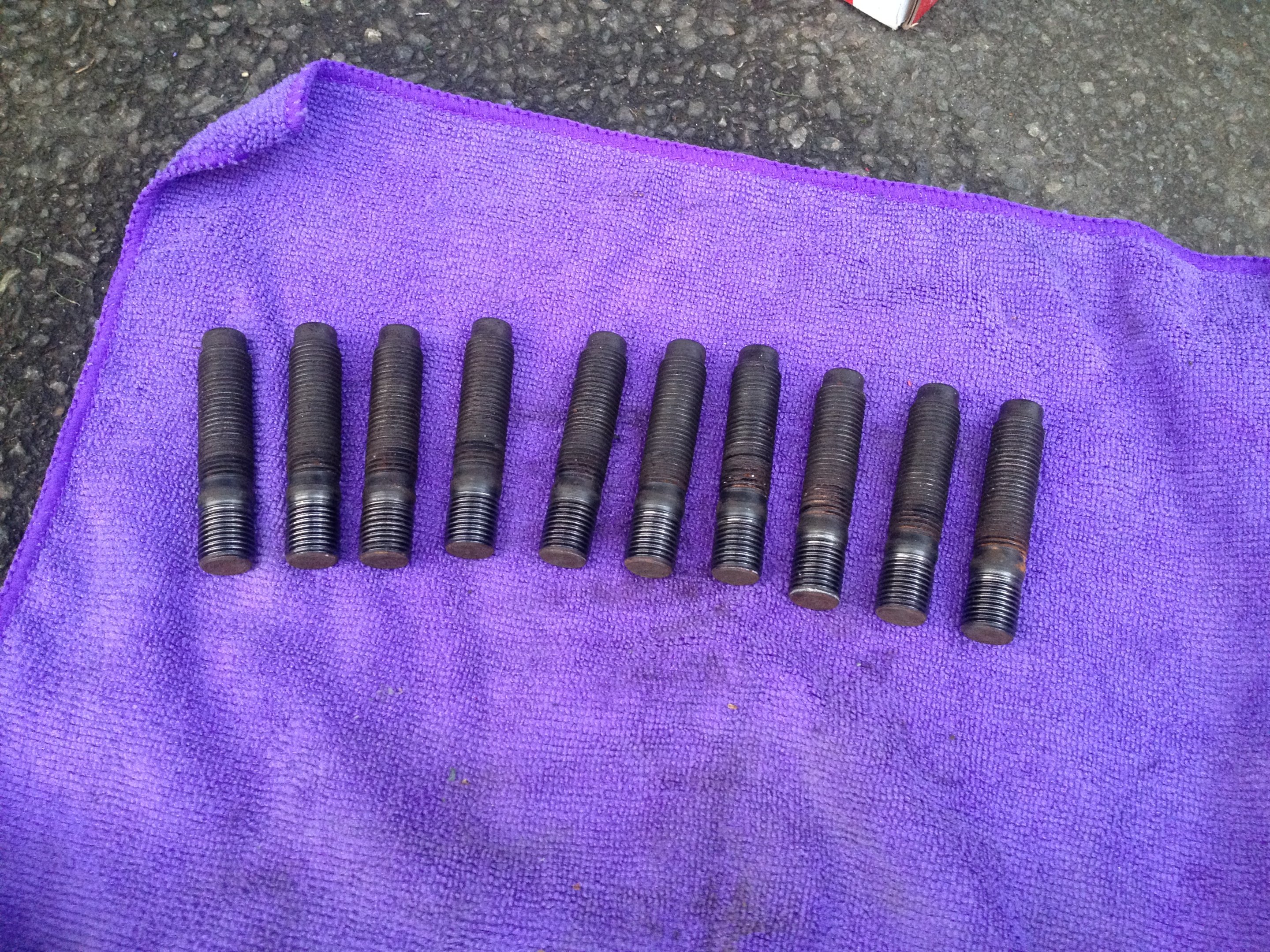

Slowed down by the stud conversion but wanted to keep it so carefully removed it to use again:
Start:
Tools required, the heat was deffo needed so glad I asked on here :smile:

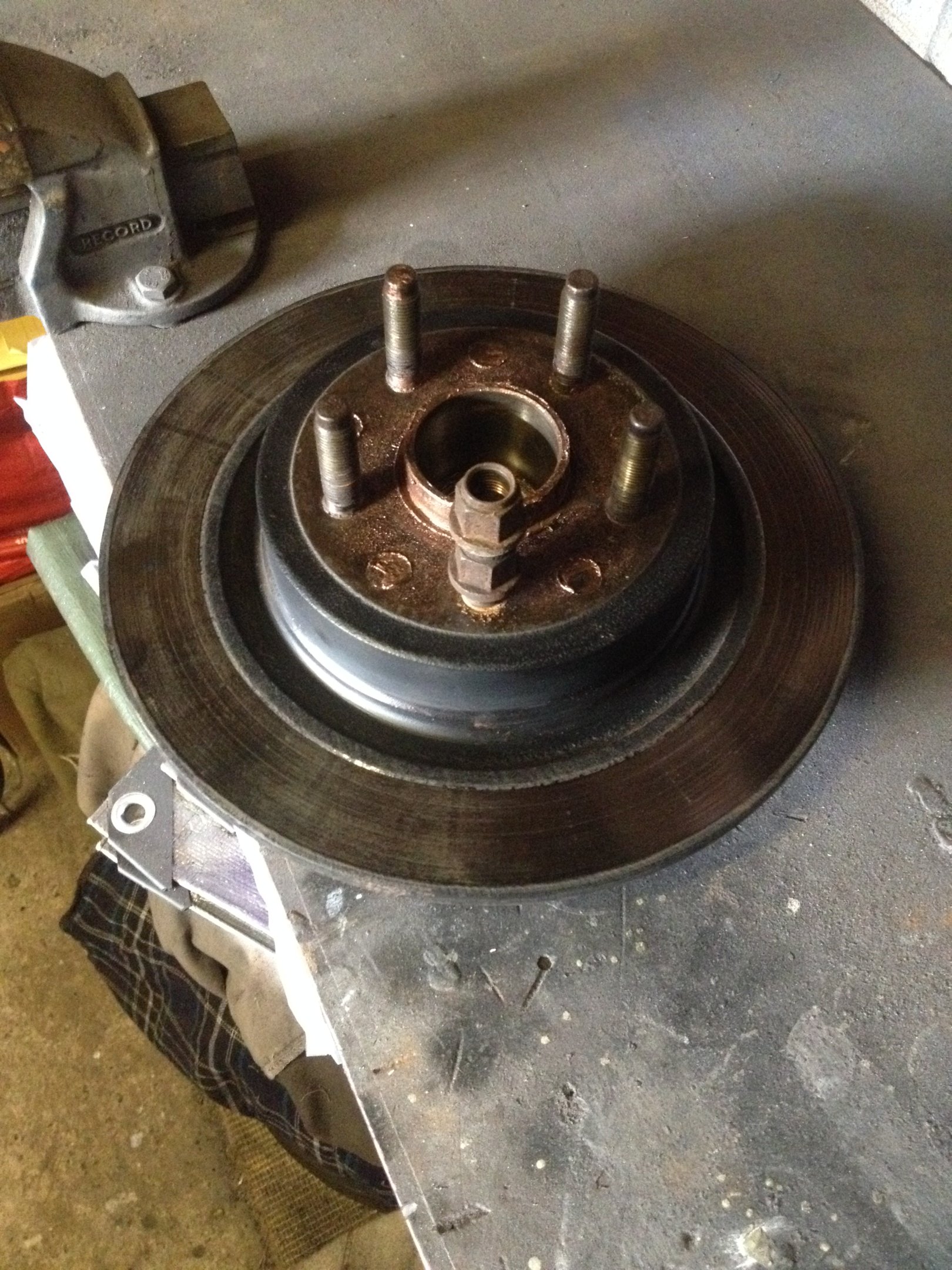

Studs removed:

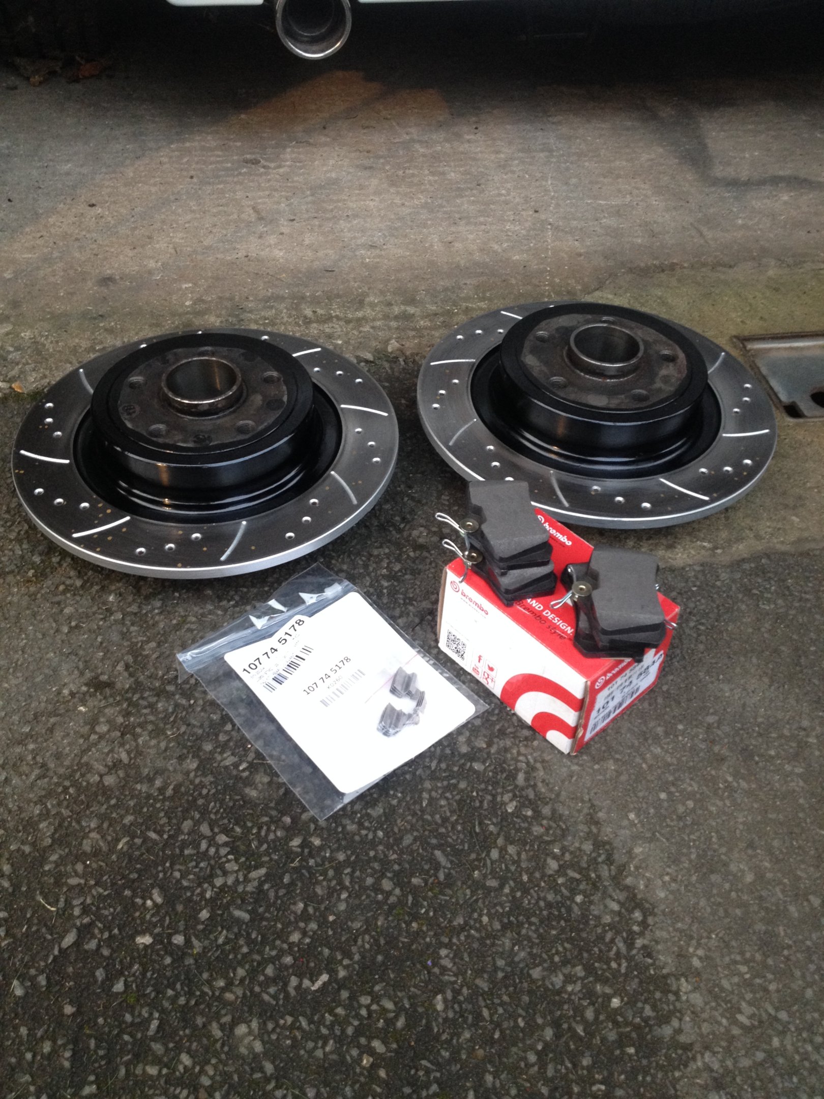

New shiney parts :smile: discs courtesy of my old Alien Green and @NorthloopCup (thanks buddy) gave them a new coat of paint :smile:
Stud conversion cleaned up and refitted:
Calipers given a coat of red hammerite and job done:

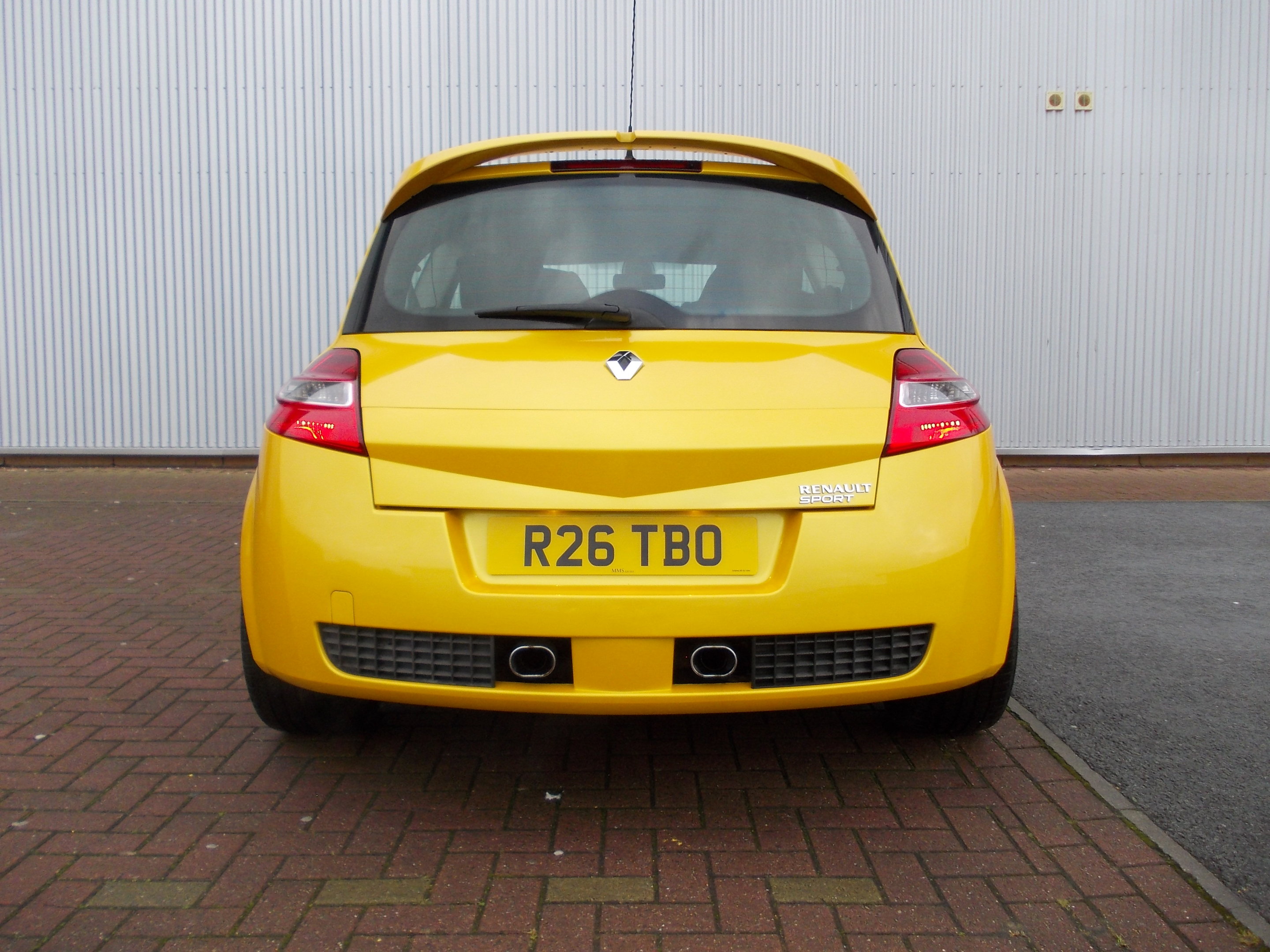

The car is standard except an induction kit and a r26r spoiler - which I am still not sure about the spoiler so don't be surprised if it gets replaced with a standard item!
