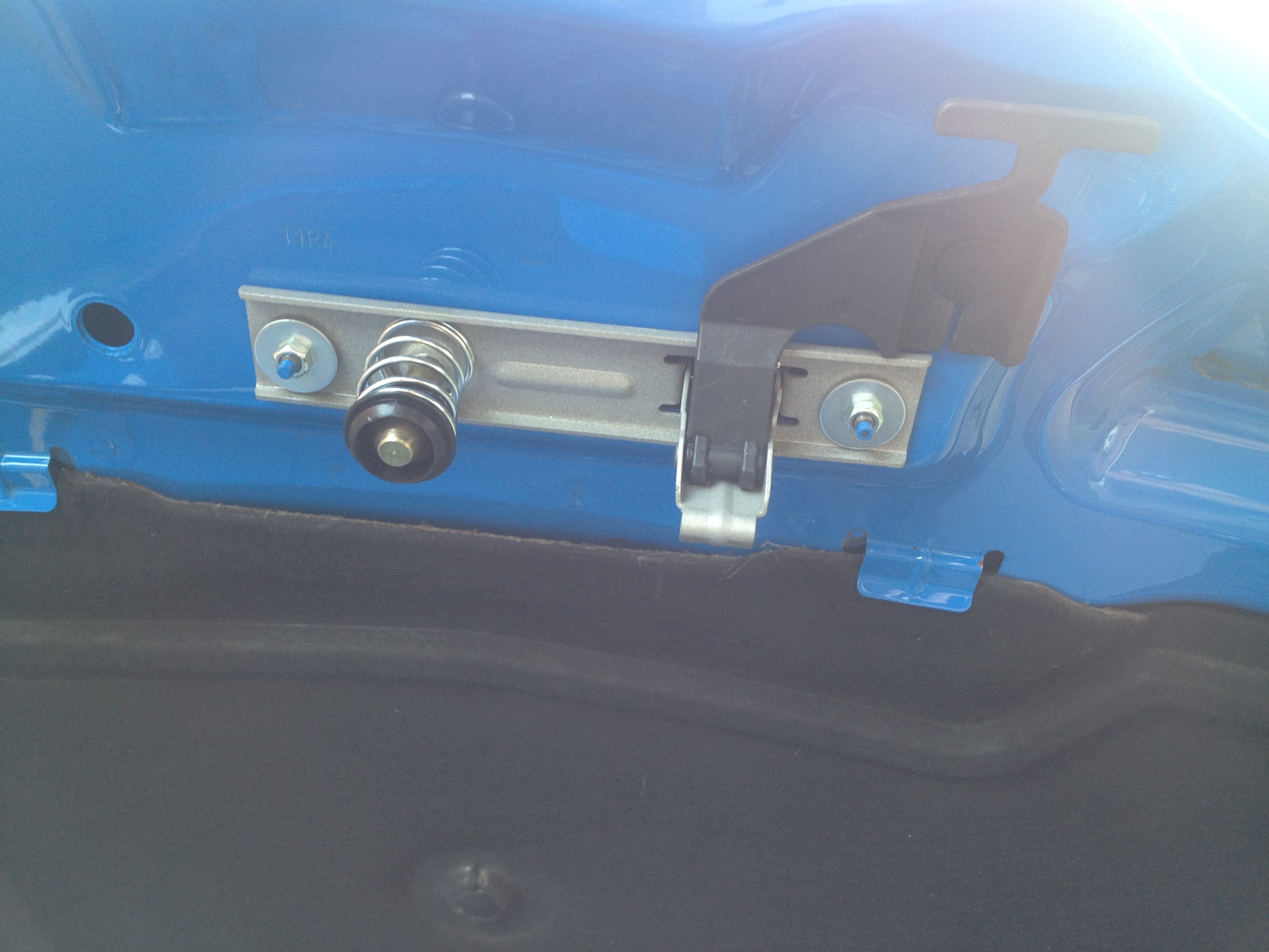

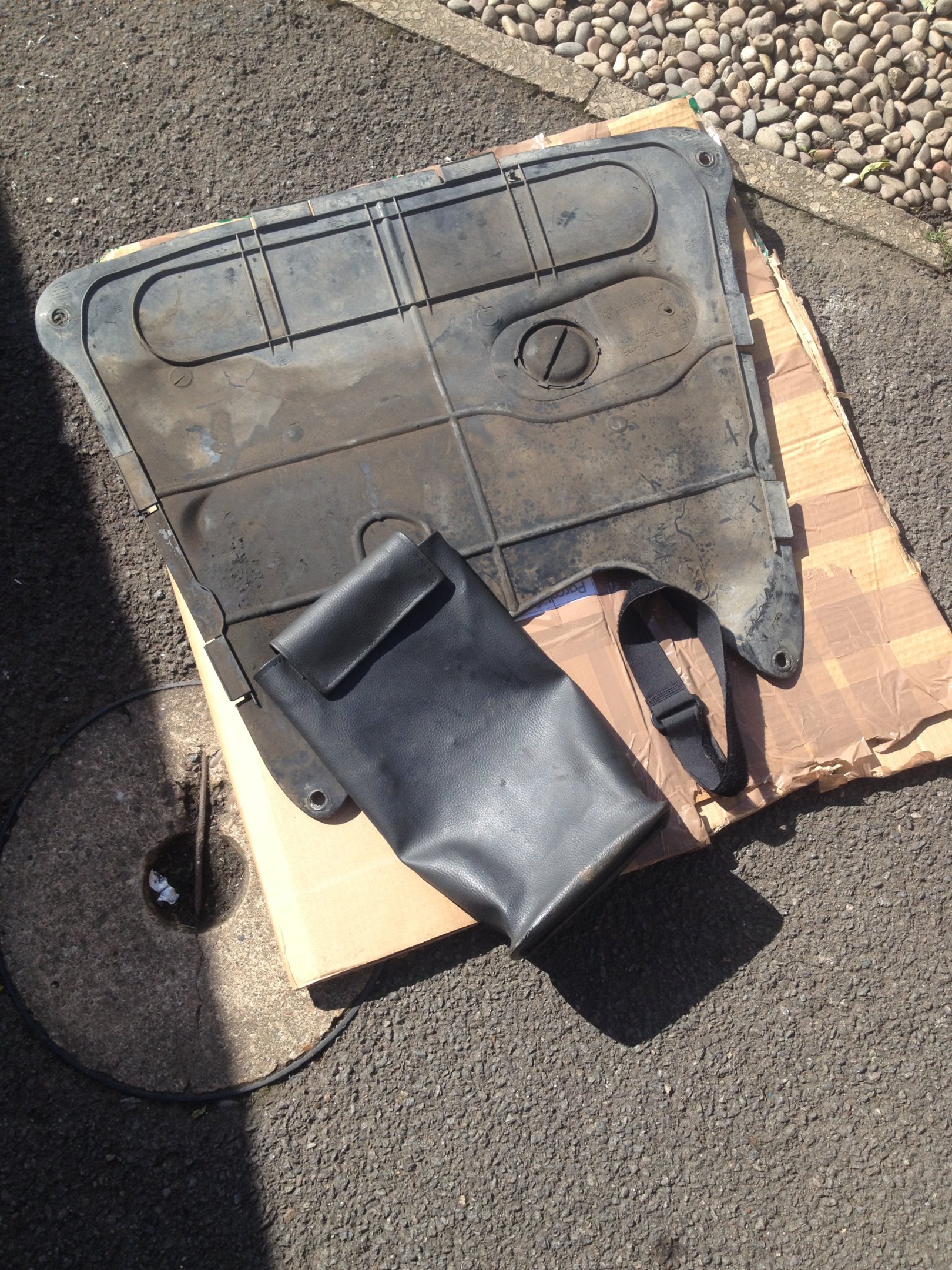

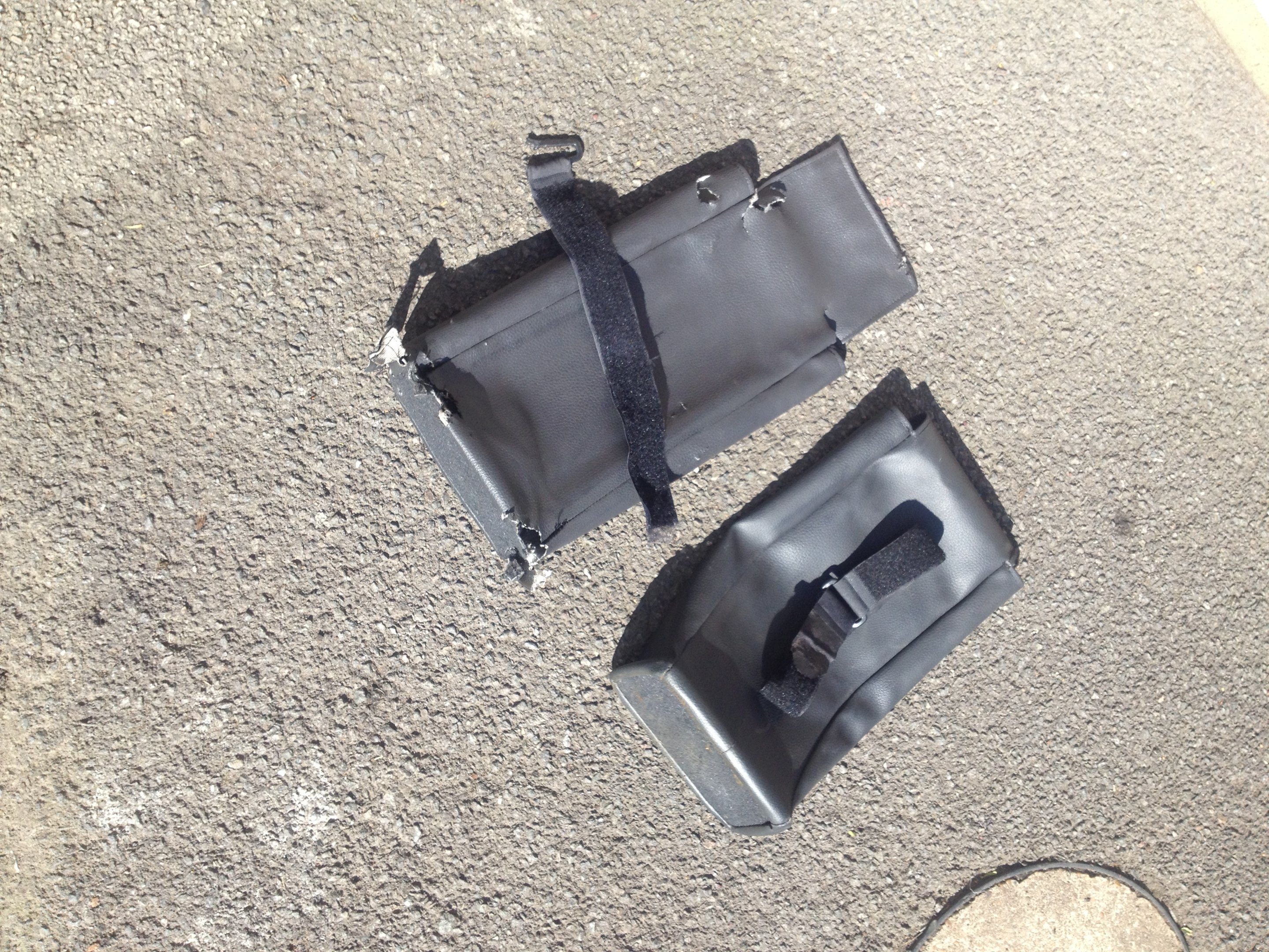

Replacement jack and tool bag sourced sourced from @super_ted (thanks mate)
Old v new

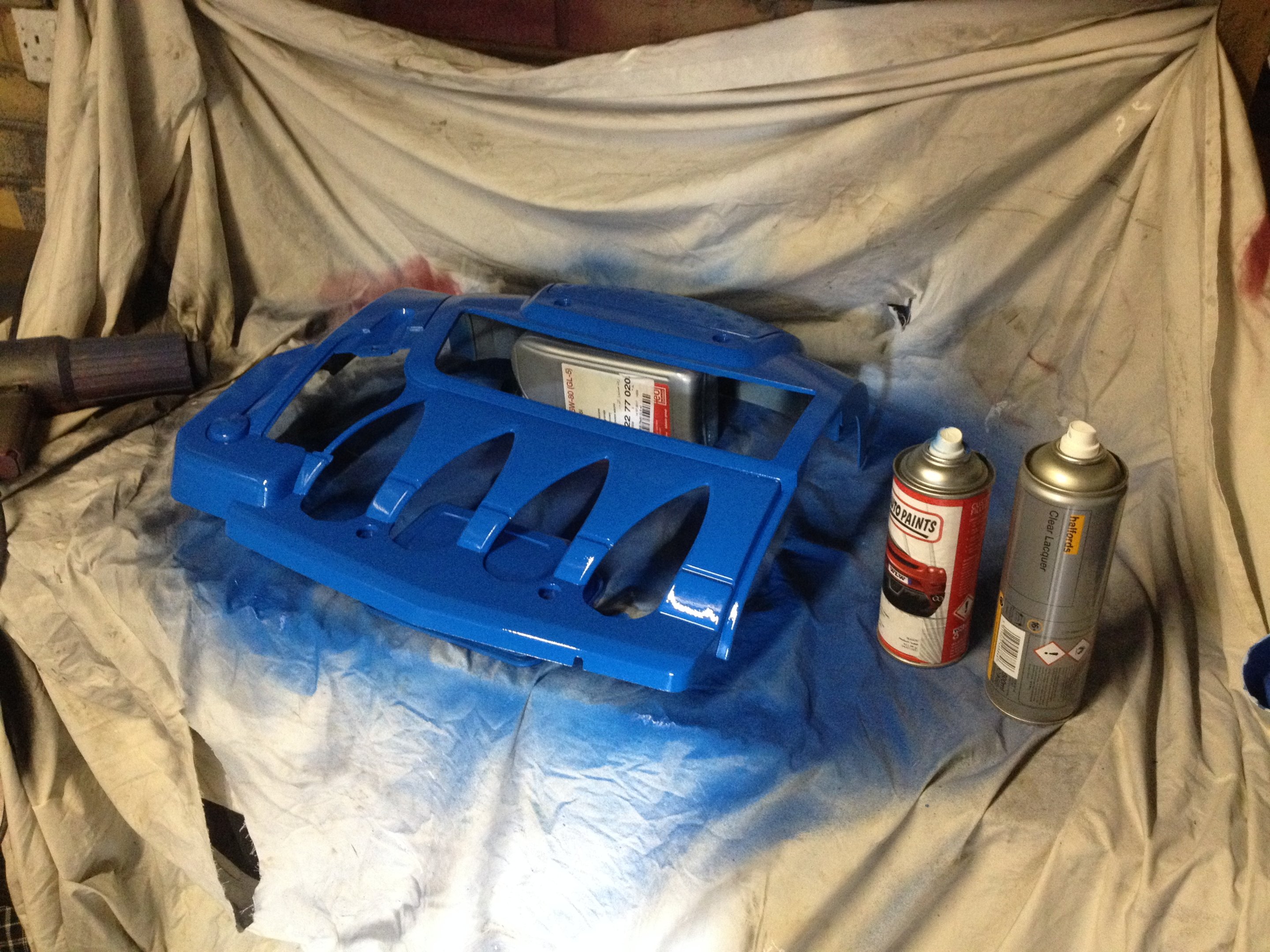

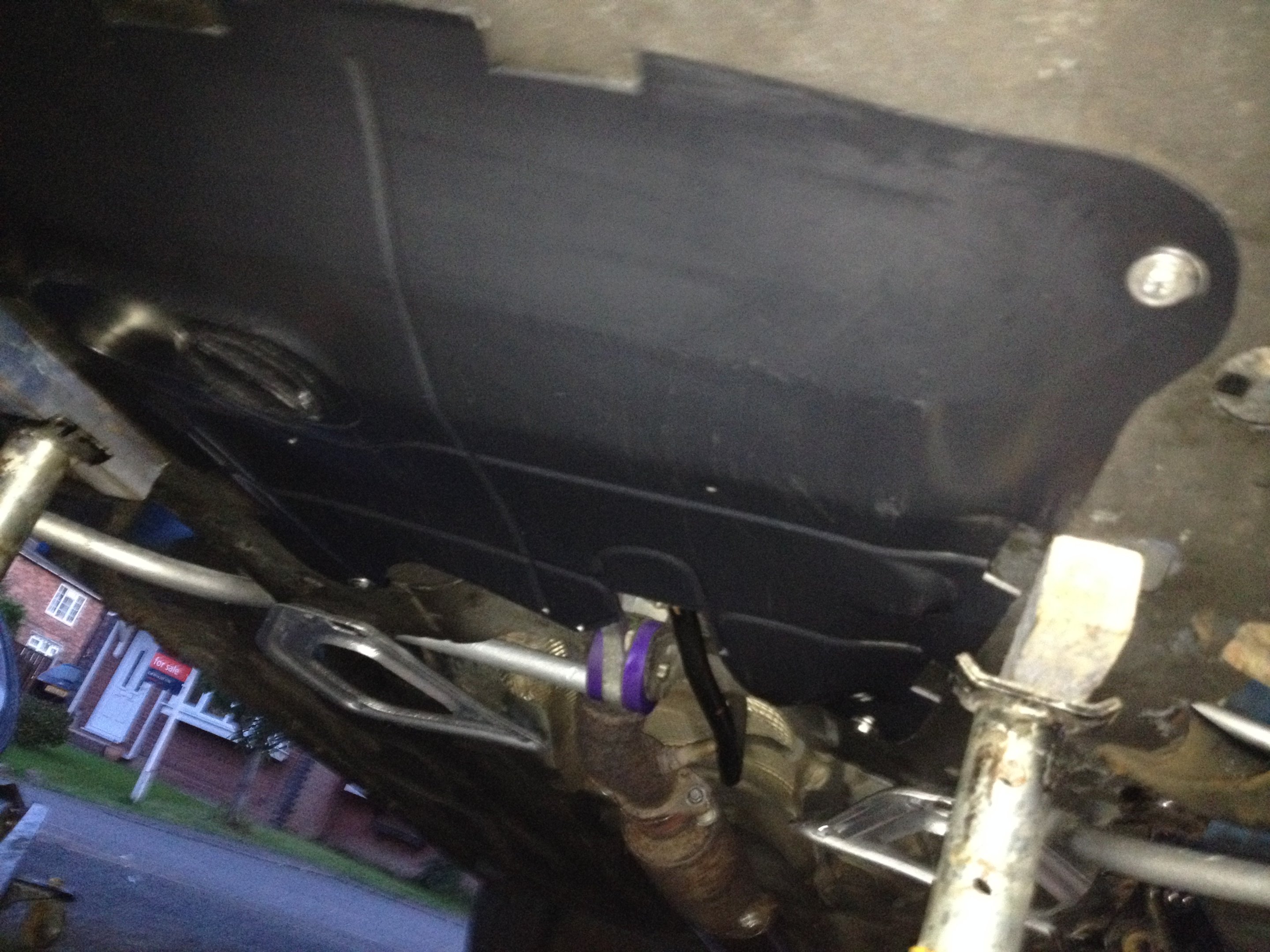

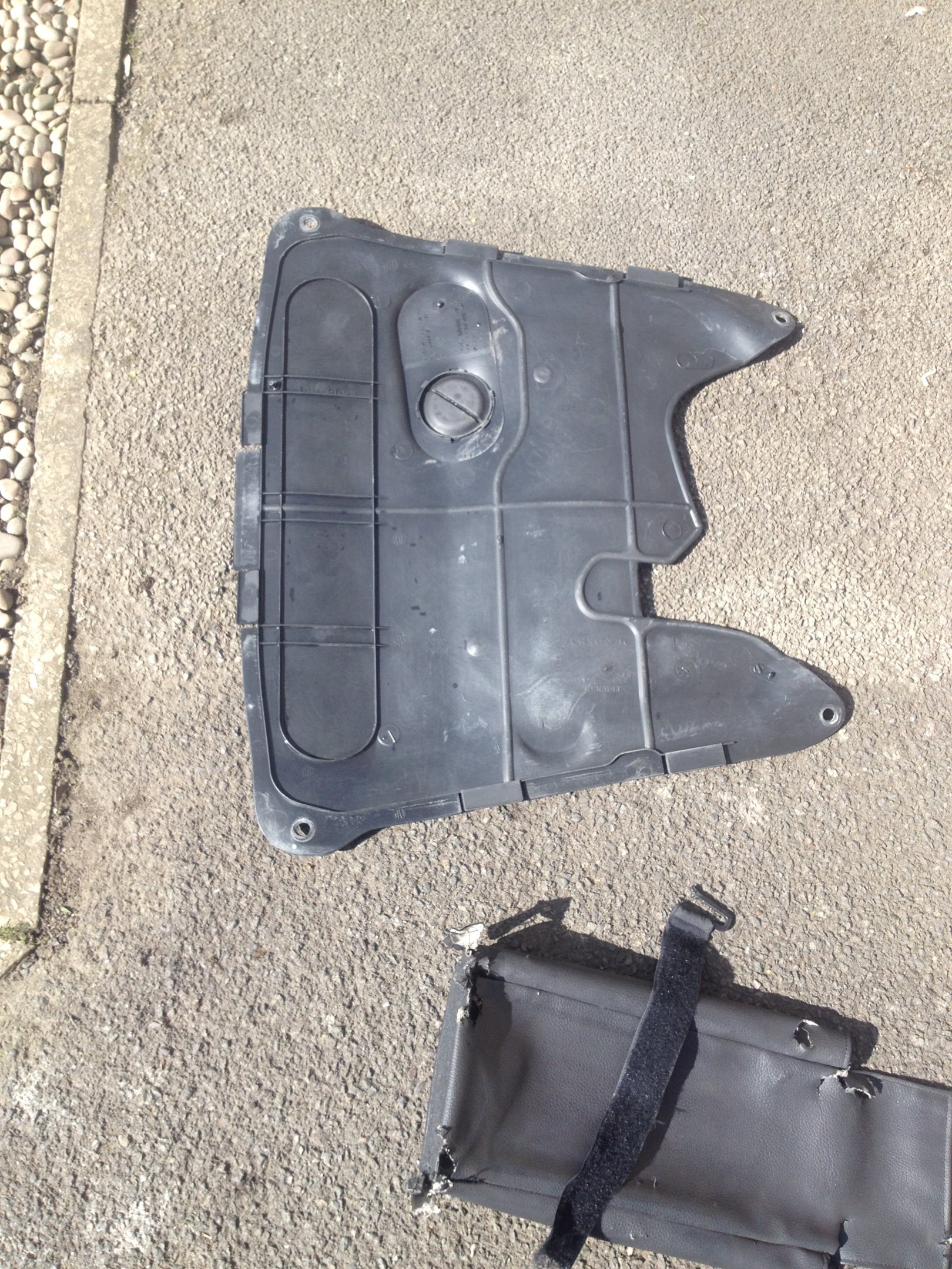

Engine under tray sourced from @Digger90 (thanks mate)
Cleaned up:
Fitted:

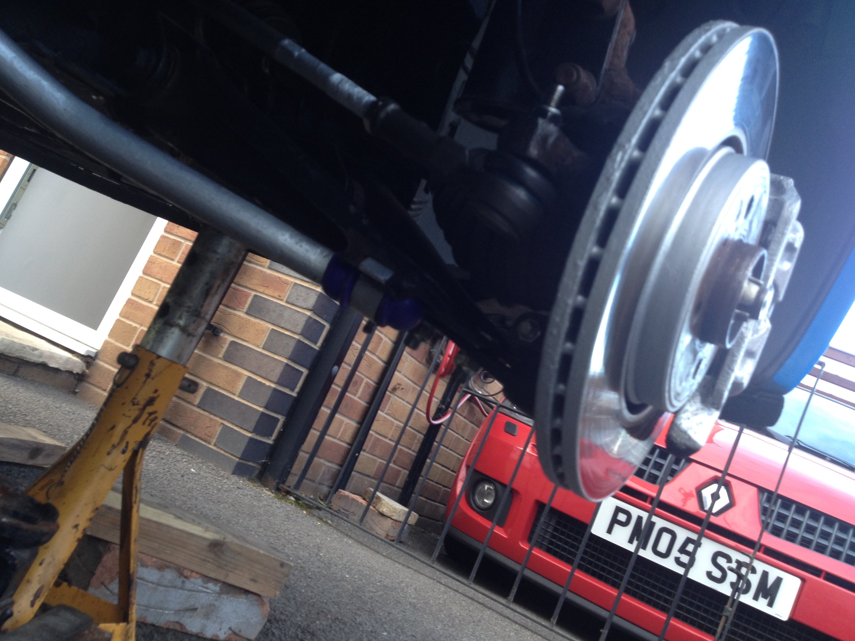

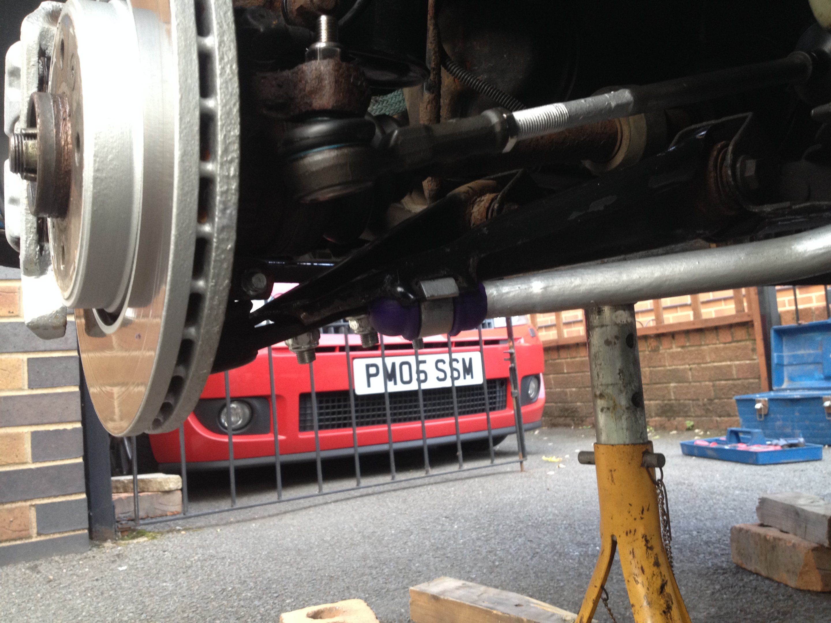

Outer powerflex ARB bushes fitted:

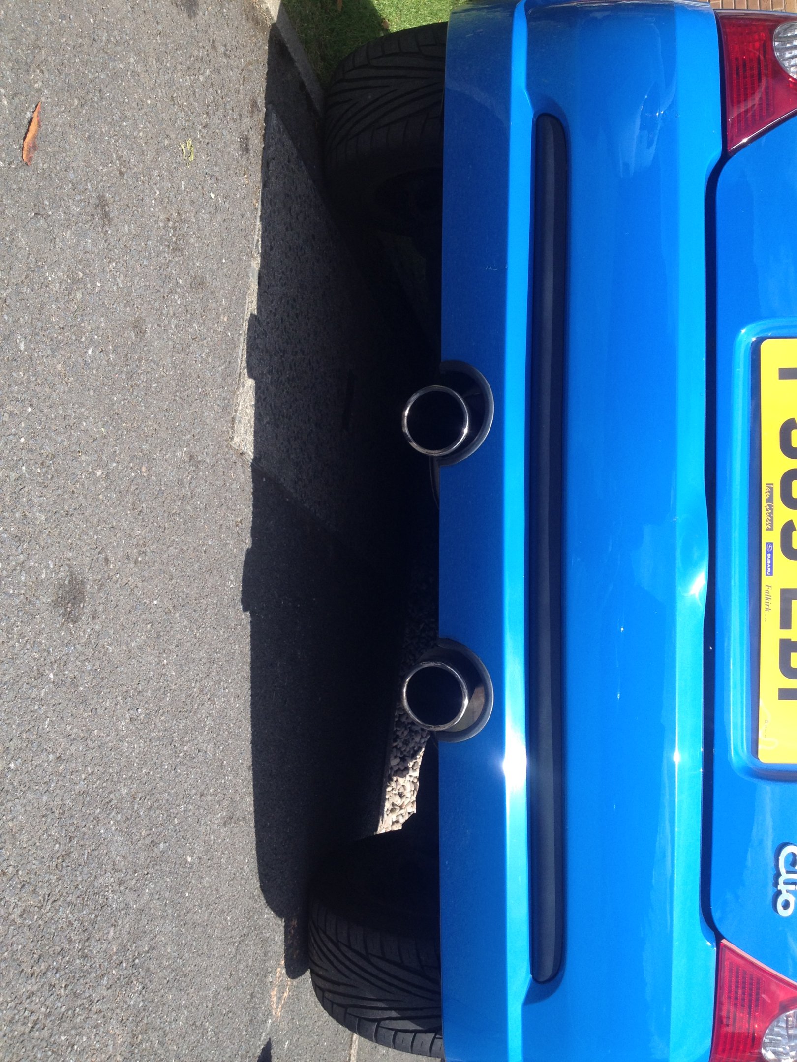

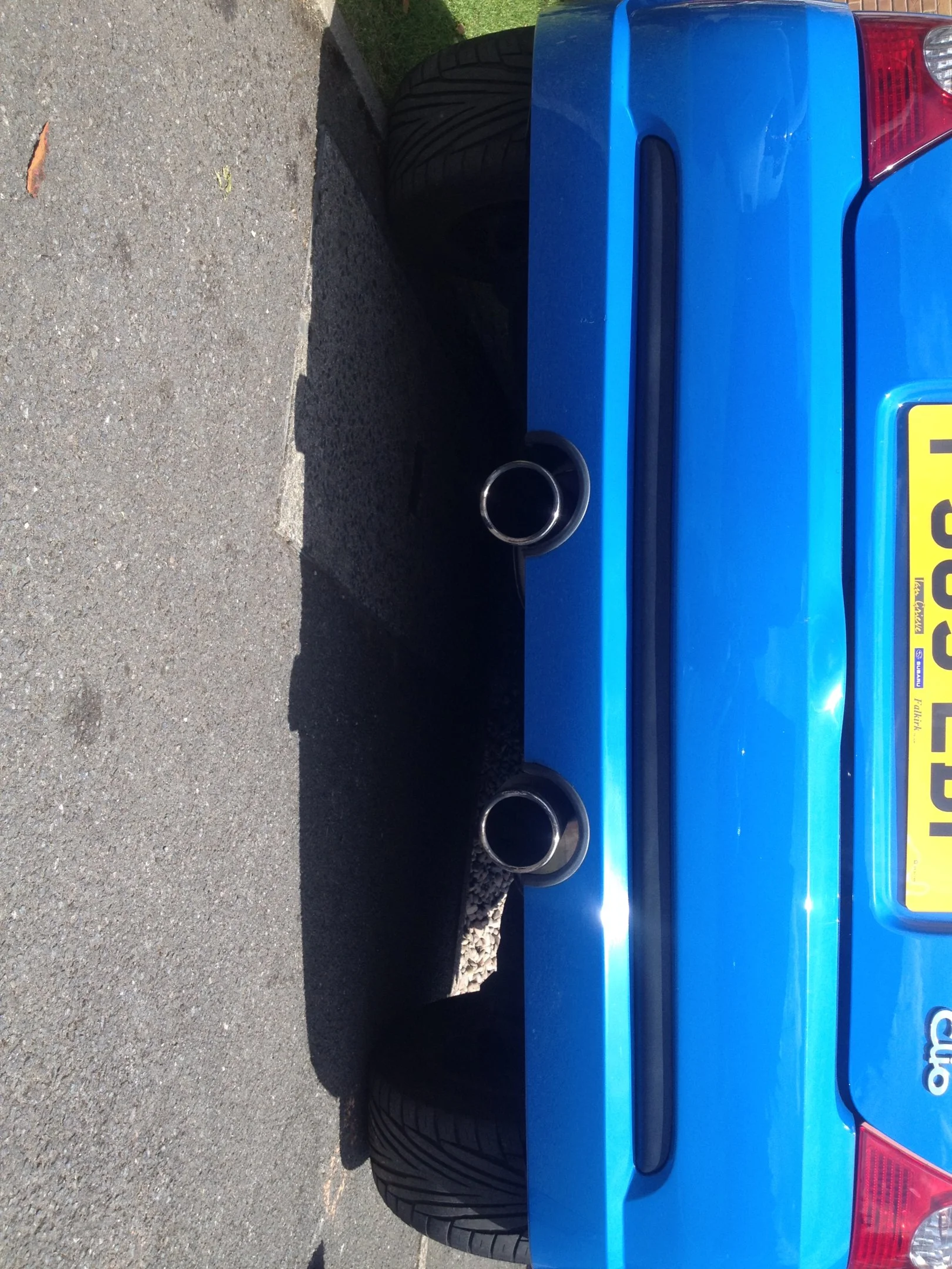

Really-aligned the scorpion exhaust at the rear (really does my head when they look non central/wonky):
Before
After

Tell me about it with the exhaust!! I've the same problem with my Milltek, had it fitted brand new, went wonky on one side......... had it re-aligned, job done..... now its moved a little again!! Just enough for me to notice 🙈
Nice touch with the tool bag, these are the little oem touches I like!
Thanks buddy. Yes these exhausts do my head in, the trophy needs slightly realigning again!
Yes the small oem touches make all the difference:)

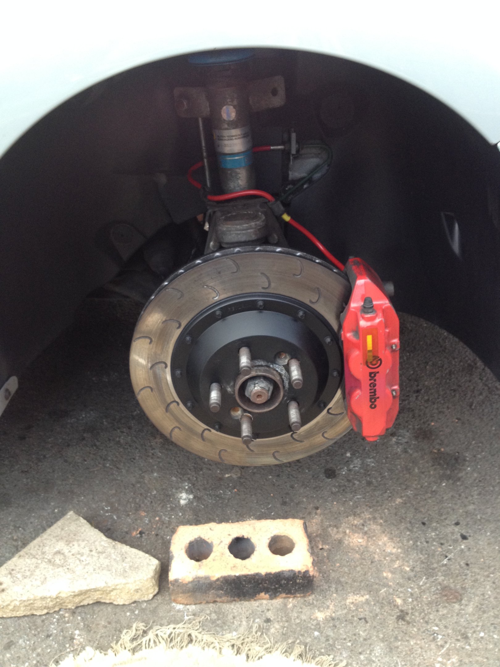

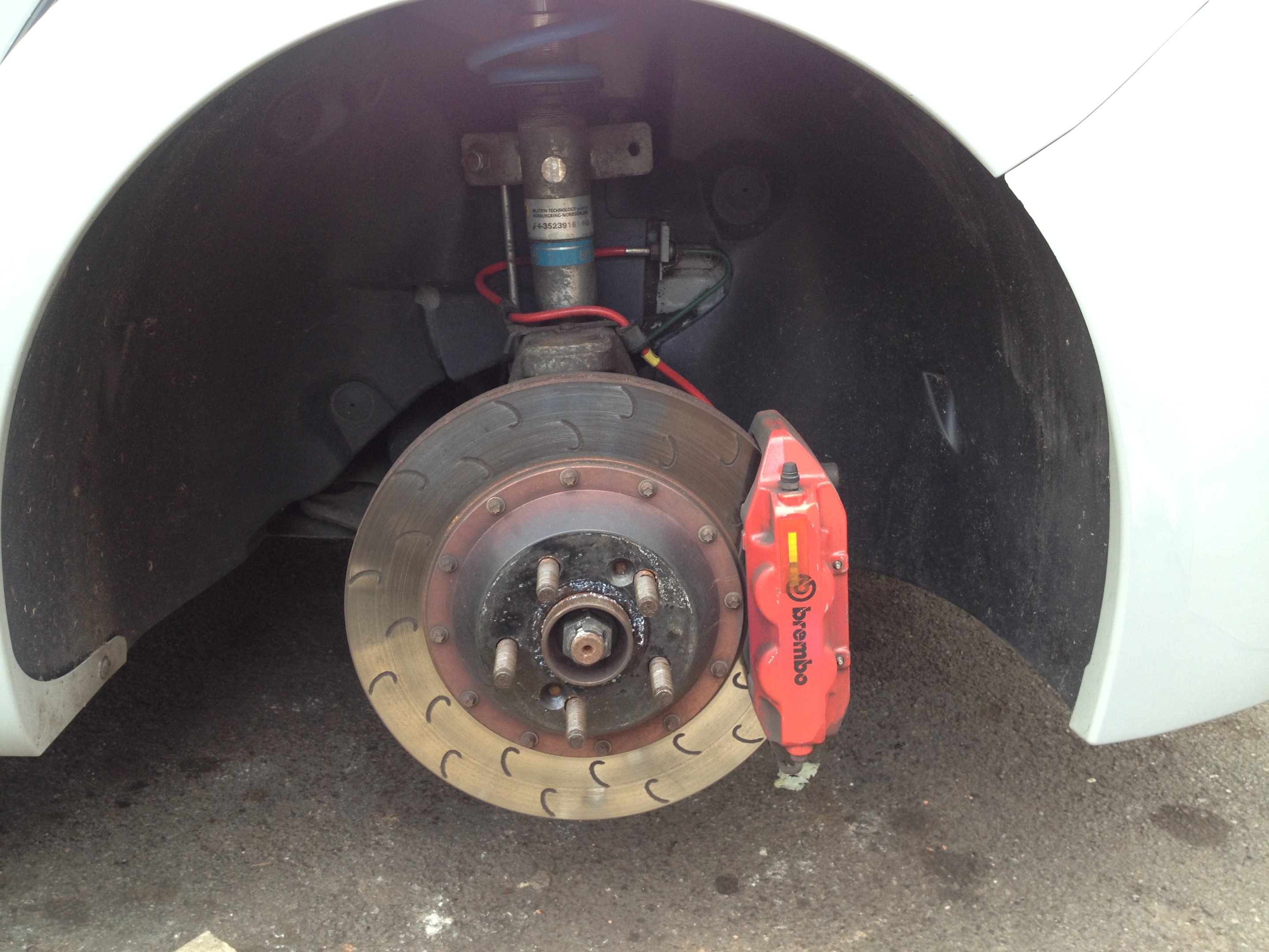

Also spruced up the rayland brakes:

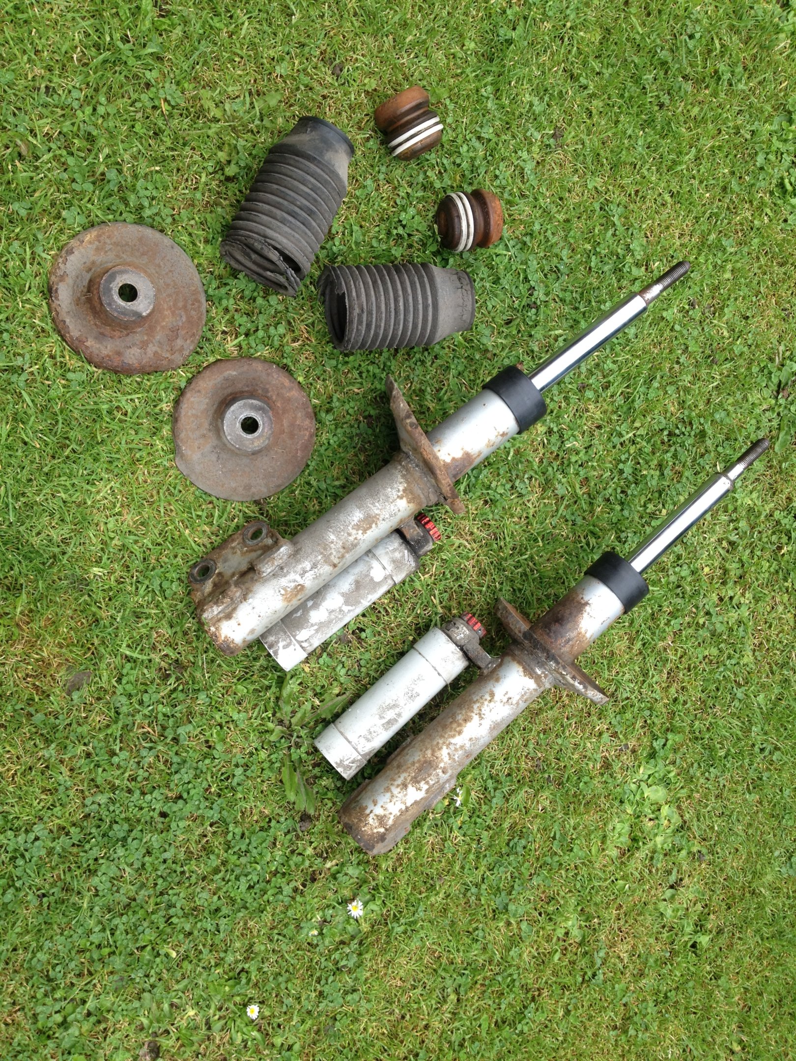

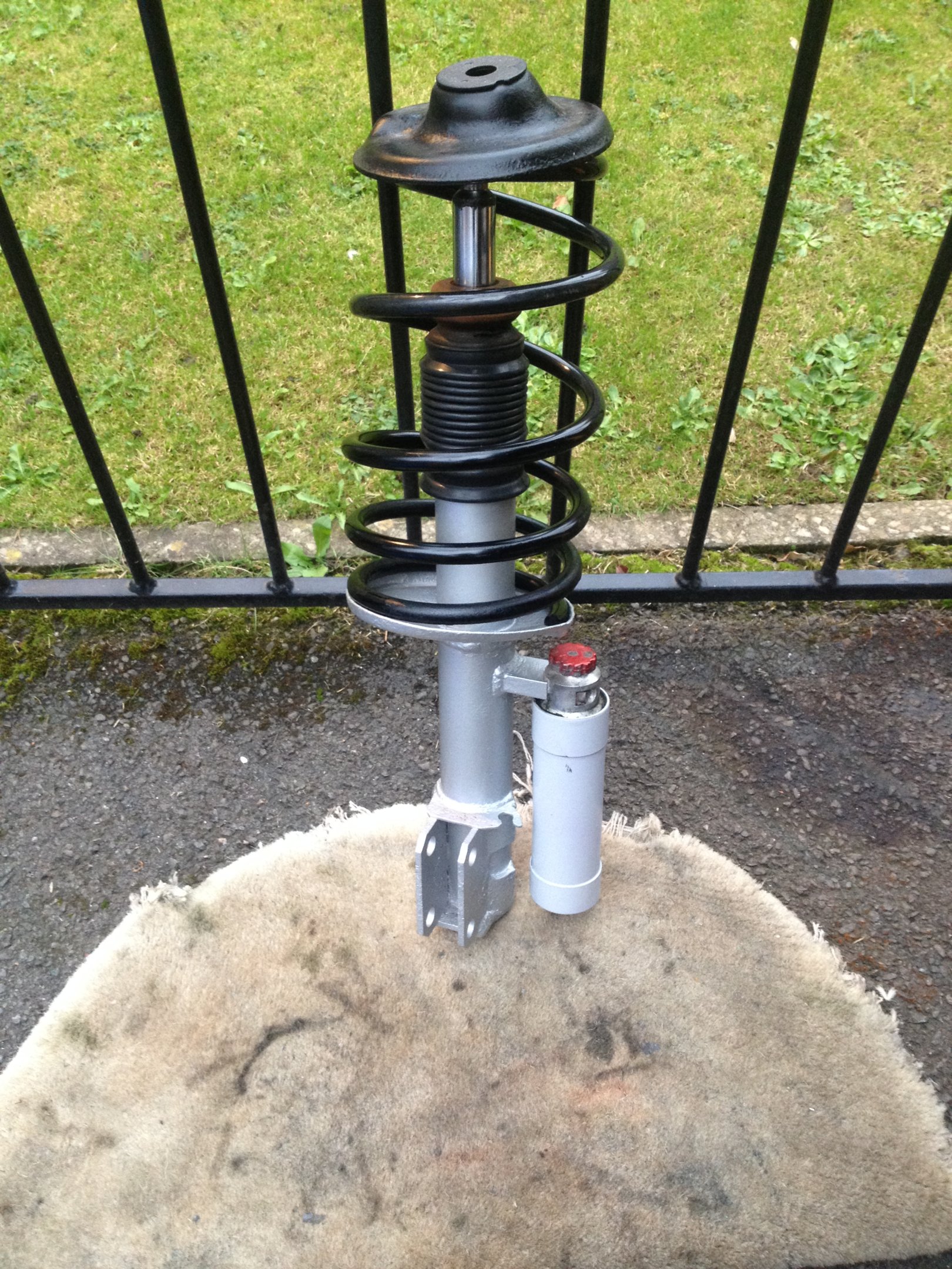

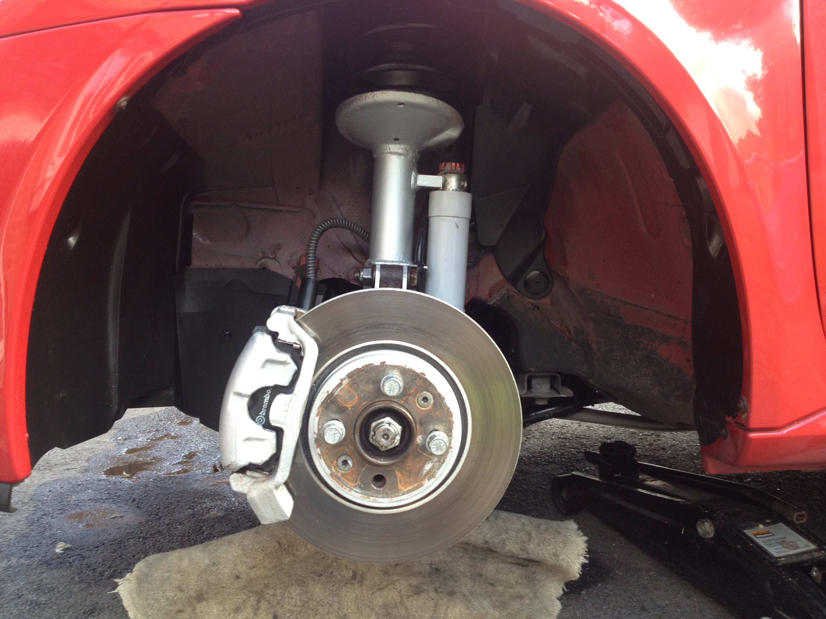

Finally got the Sach suspension back on.
BEFORE
AFTER

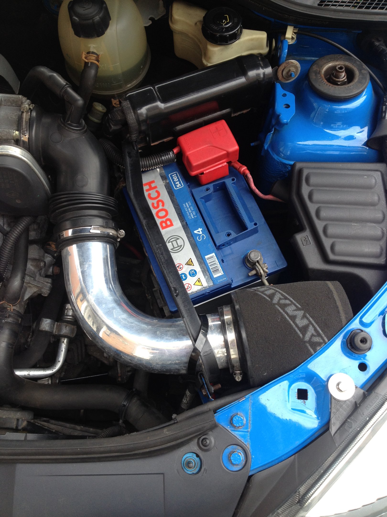

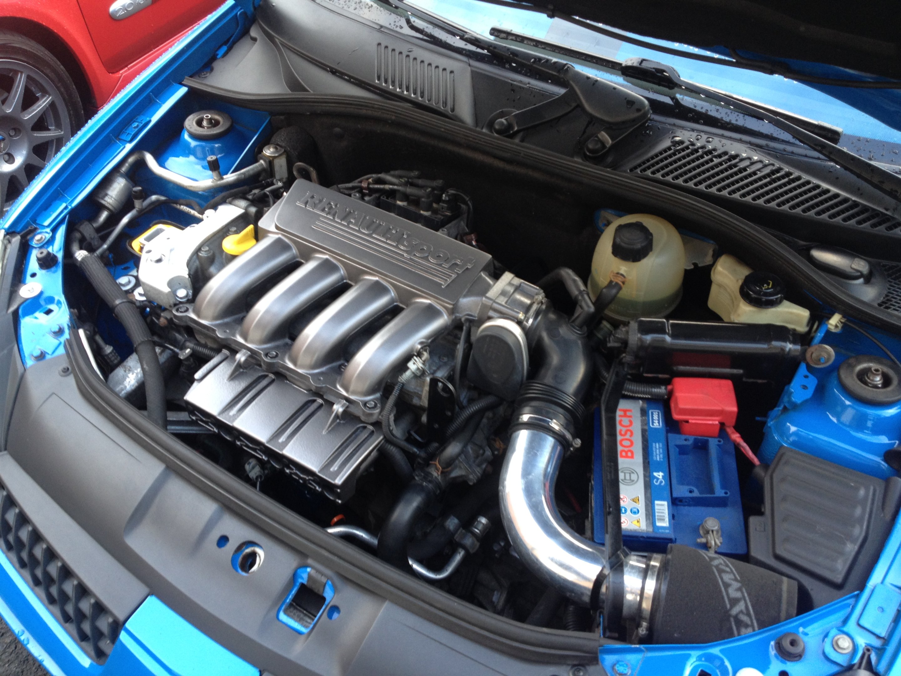

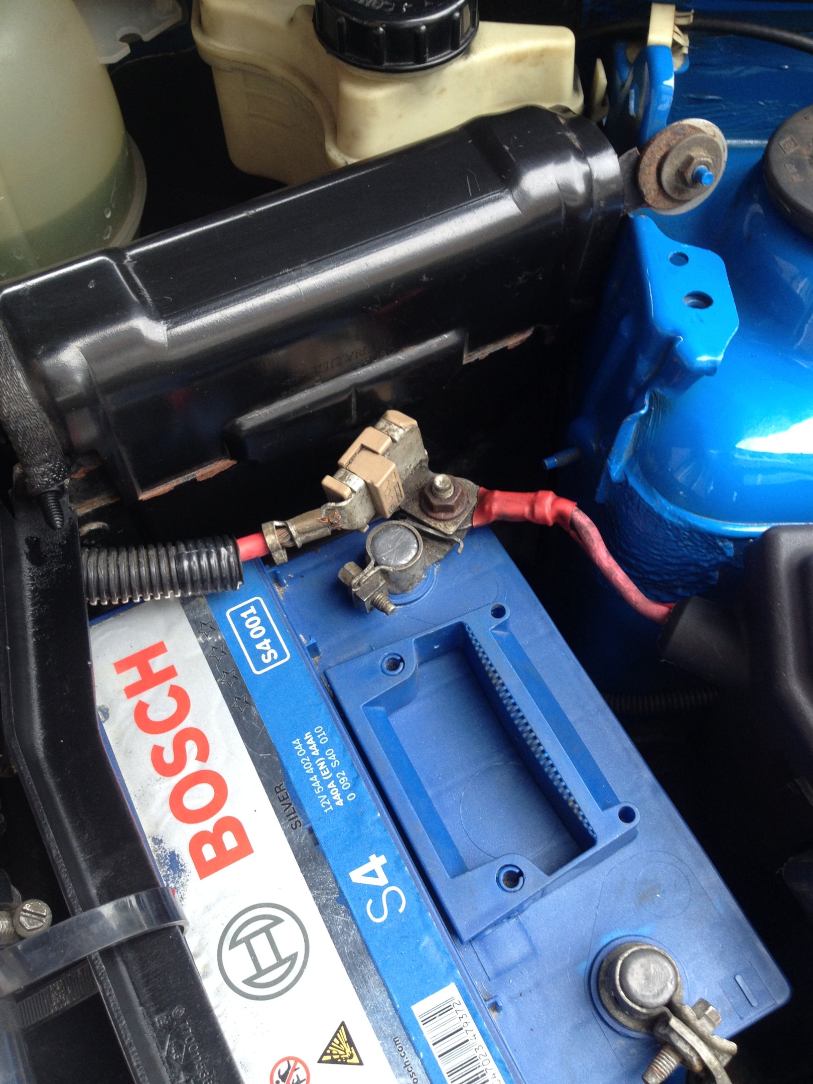

New positive battery cover and fatty induction kit for some asbo noise :)

Where did you get the Sachs done at? Think my brothers need doing thats all
Thanks mate.
Sachs were rebuilt a couple of years ago but hardly any mileage so still going strong internally but externally didn't look good so sanded them down and gave a few coats of silver hammerite.
Main issue was finding replacement gaiters as you can't get them and mind were split. I ended up using cut down MG steering rack gaiters.

Thanks mate.
No bother, just helping my brother look at options for his trophy. Fronts need doing so will start ringing round
mossyv6
  Trophy,V6,5GT,AG200
For a rebuild of the front Sachs you have 2 options mate.
1. BG Motorsport.
2. Cornering Force.
Both have good reviews but it seems Cornering Force are a little cheaper.
There was a chap on Clio trophy doing them and doing a cracking job but I think he has stopped now :( due to other work pressure.

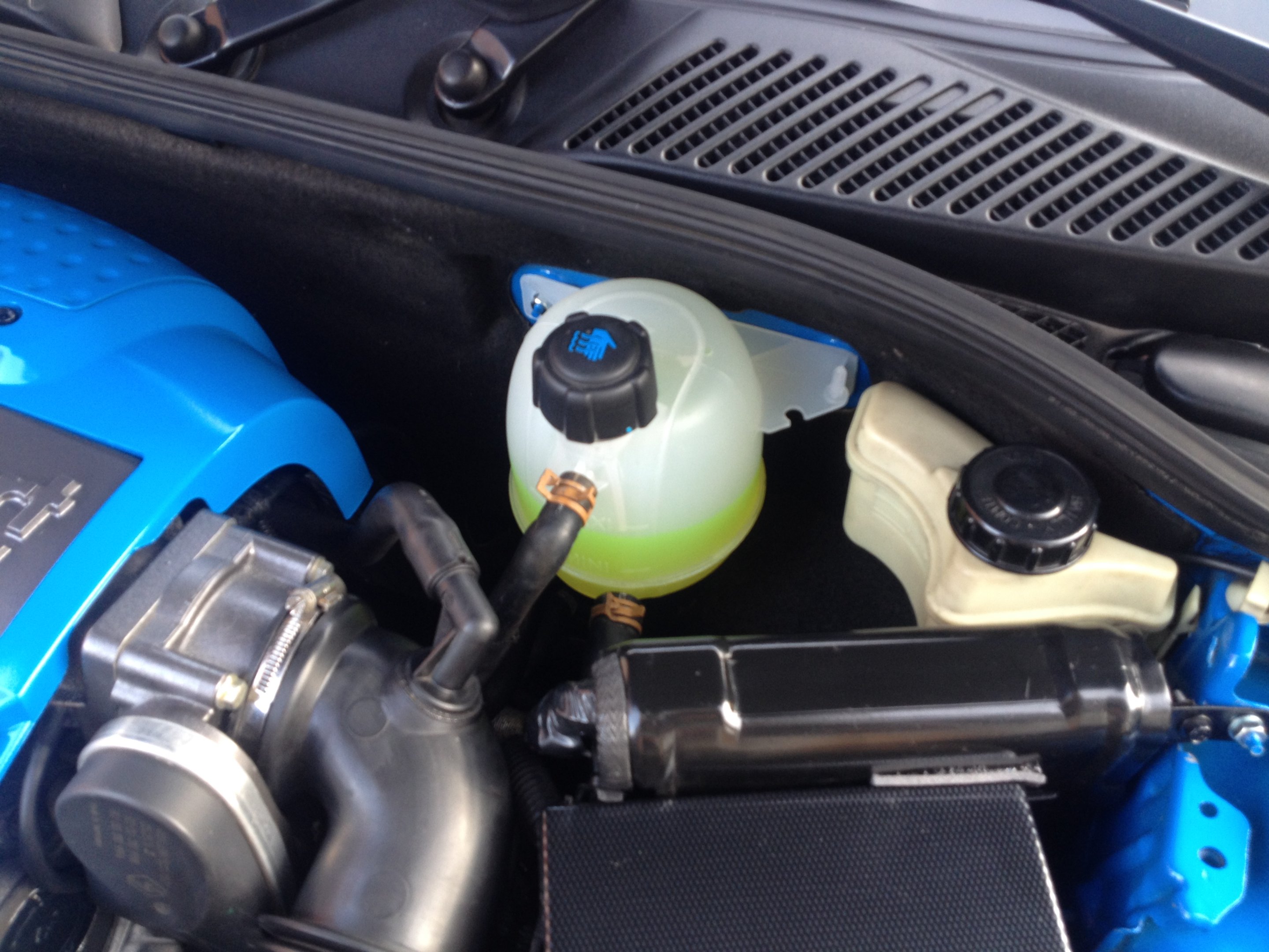

:fearscream::fearscream:

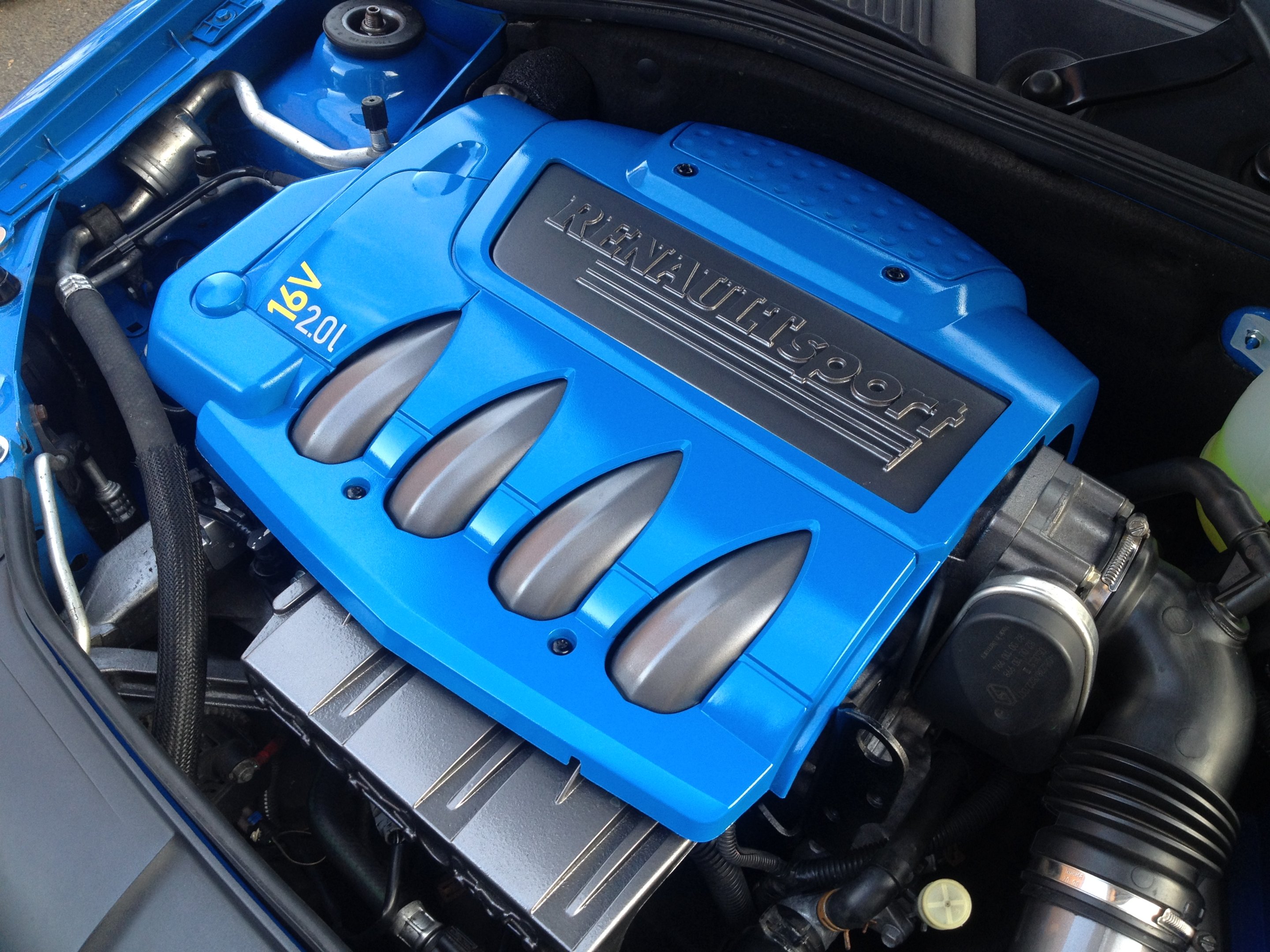

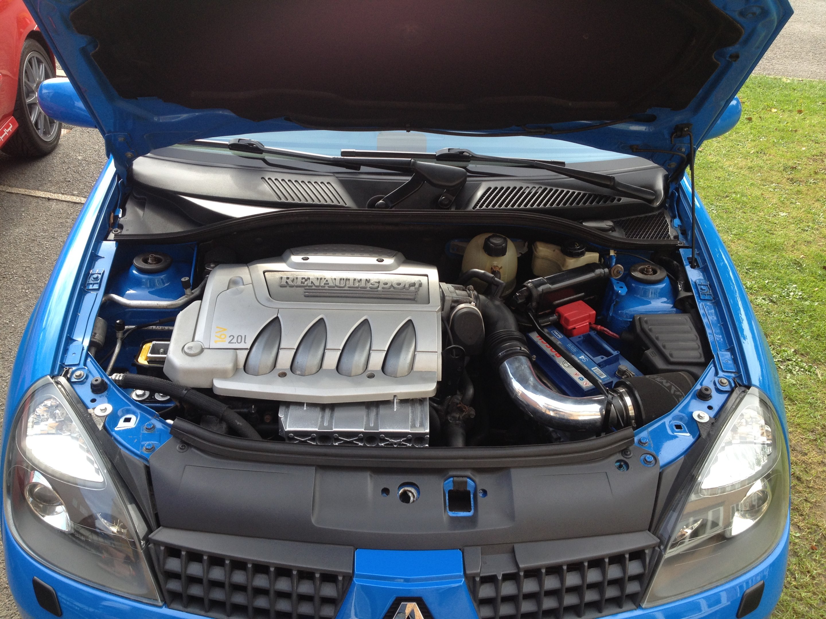

That engine bay looks awesome!! Nice touch with the bottle too, just had mine done too as had gone all discoloured!
Is that type-d you have in there out of interest? Green! Had my coolant changed when the car was at Engine Dynamics and the pinky red stuff got put in again which is what I had before. Unsure of the difference!
mossyv6
  Trophy,V6,5GT,AG200

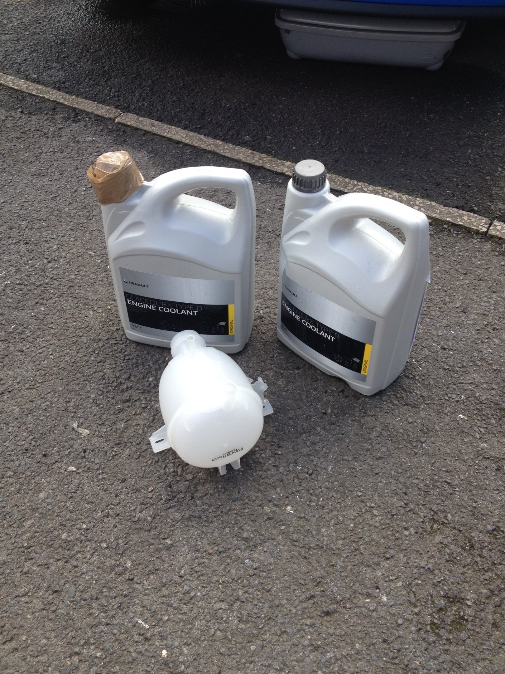

Thanks Steve, changing the coolant pot was a spear of the moment thing as putting it all back together and thought it just didn't look right/clean - onto Euro Car Parts website and one in stock for a tenner and just up the road from me :)
Yes it's Type D coolant from Renault - love the colour of this stuff :) I was really careful when changing it/flushing it through so I didn't discolour it with old brown coolant. I therefore pinched @bloke method with the dishwasher tablet and did a few laps of the village to flush it through :)

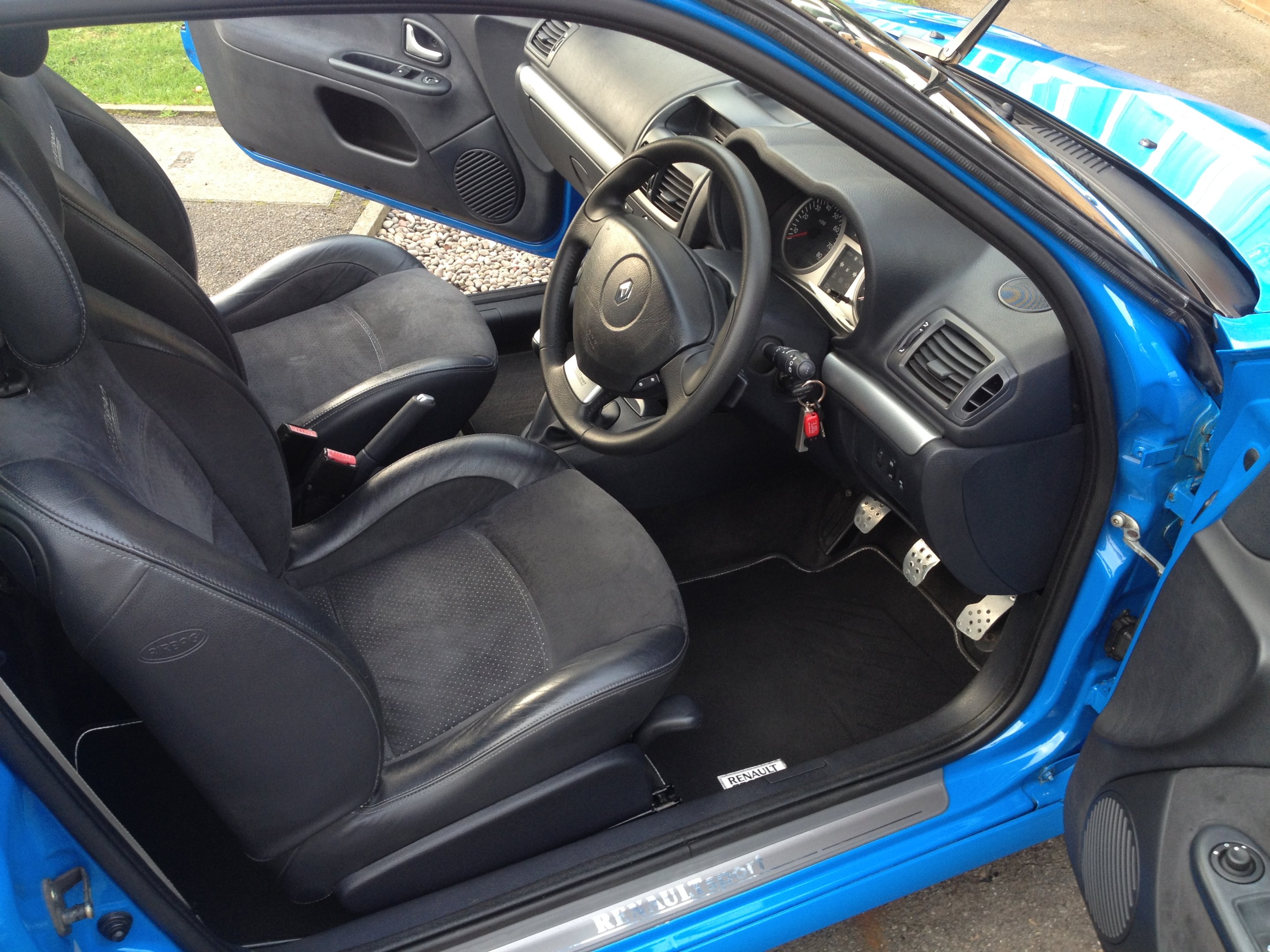

Interior spruce up.
Bought one of the lint removers, I was always a bit of sceptic but it worked really well and de-bobbled the chairs brilliantly :smile:

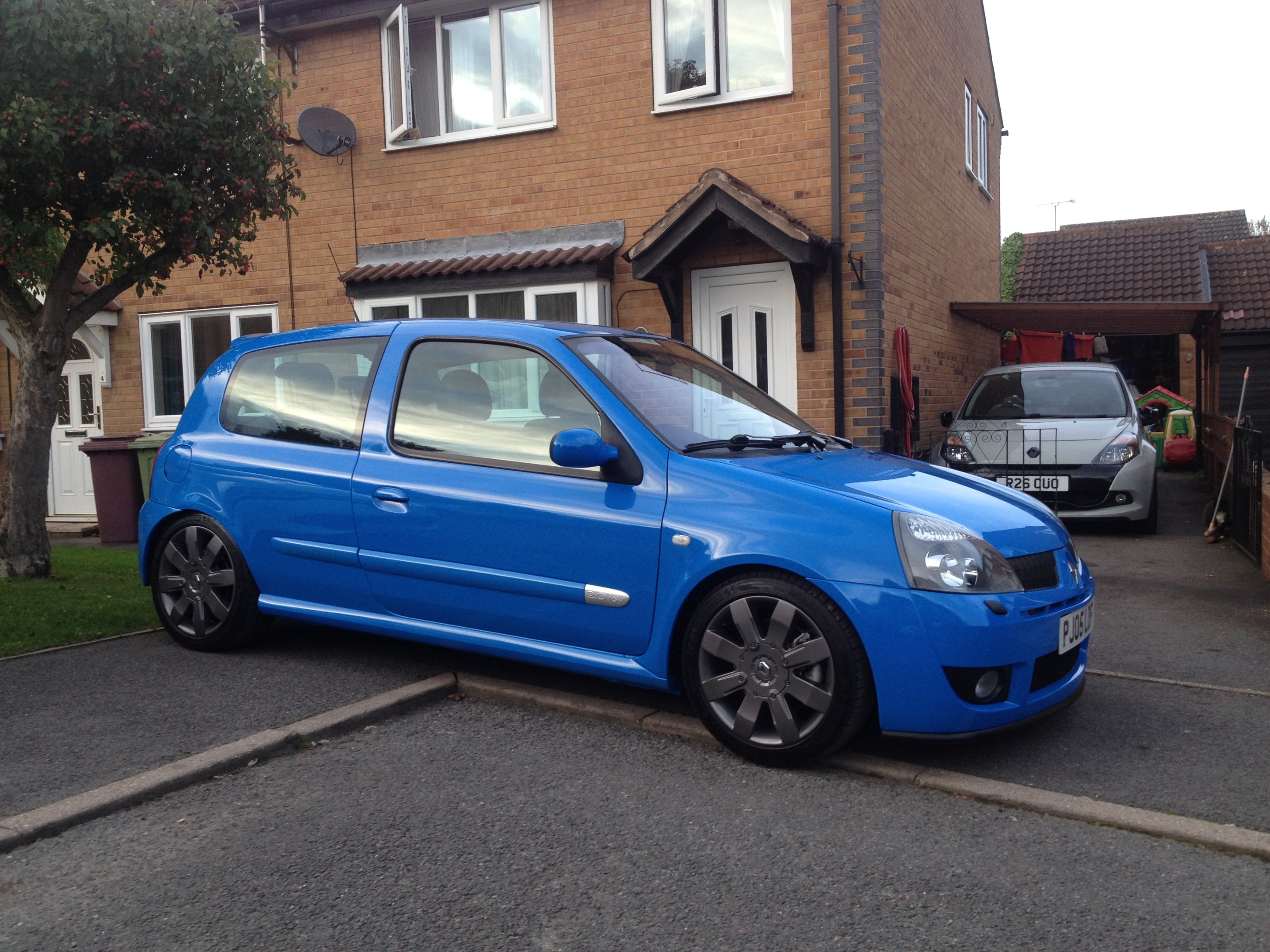

Exterior - wash and wax ready for the morning :)
That really does look very fresh and tidy..... good work with the bobbles too, have bought myself one of those a while back but keep forgetting to use it when the car is out lol!
