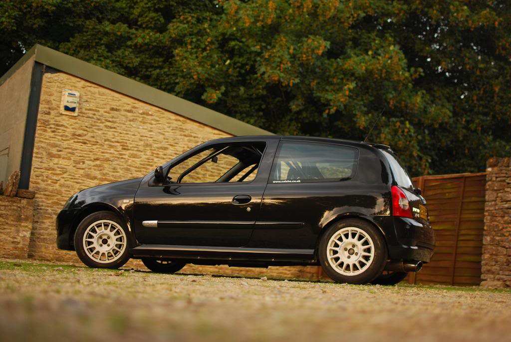

Correct for a road car at least! Mine handles like a beast how it currently sits:

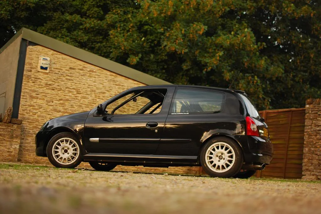

Here's how mine sits.
