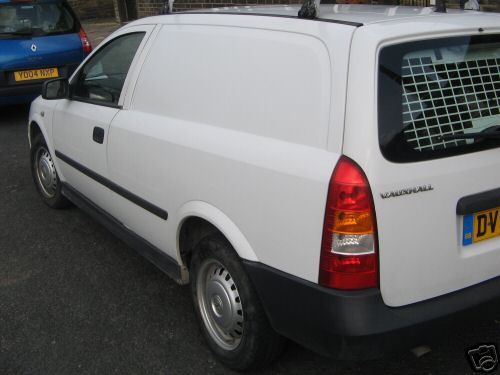

I wonder what they would do with this van.

nope cant fail at all as you can do what you like to rear side windows and rear as in fill it with metal if you want like a van
