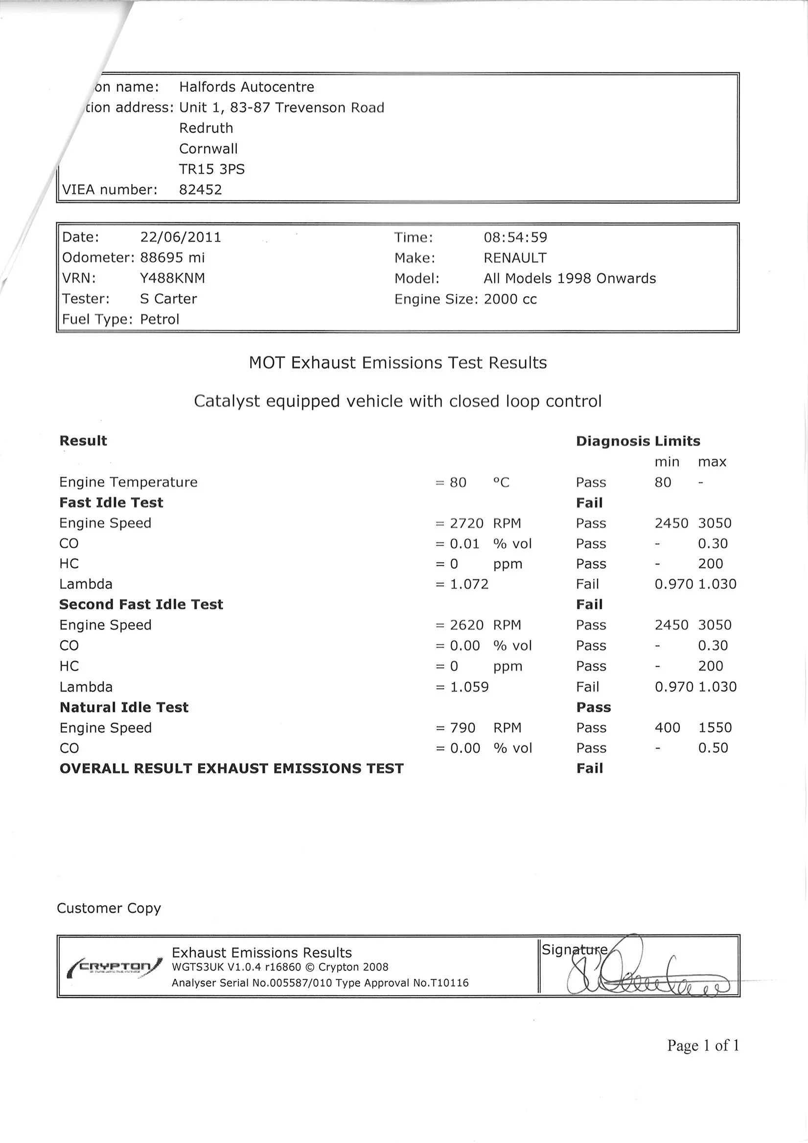

I purchased a PH1 Clio 172 Exclusive about a month ago and today thought I'd put it through a MOT to see exactly what was wrong with it.. unfortunately it's failed on one front, one rear coil spring being incomplete, a couple of holes in the exhaust system and the exhaust emissions (plus a couple of things I can sort).. the chap in the test centre said the emissions could be due to the holes in the exhaust, sound about right?

I've attached the fail notices..
