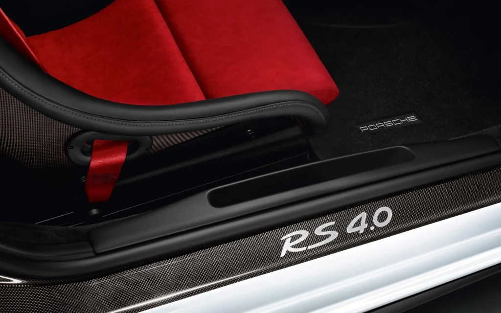

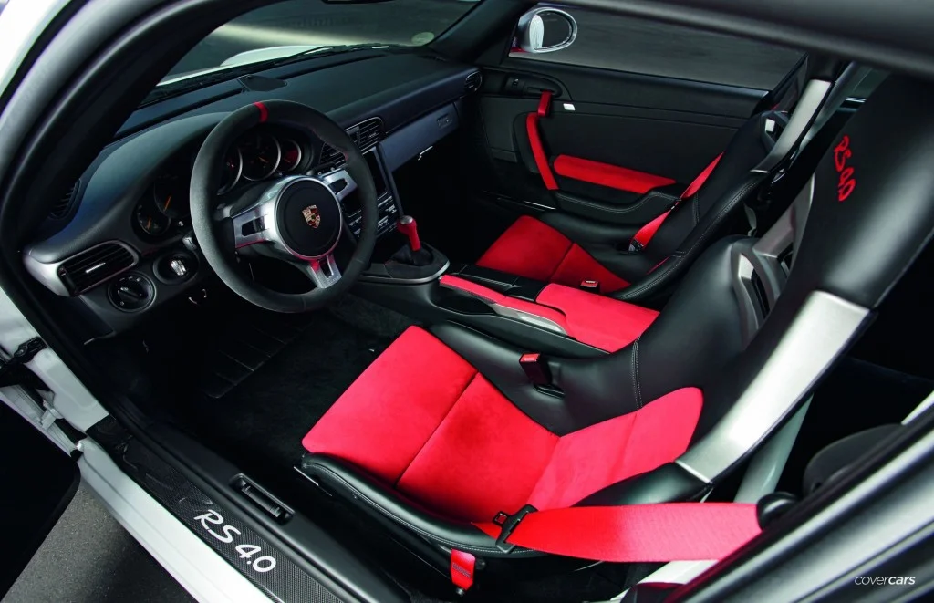

Hi,
found these on the net net, and thought it would be a good place for the lap belts in my cor (ie not having to drill the car)
Any opinions...i'm assuming porsche know what they are doing....
Porsche-911-GT3-RS-4_0-Limited-Edition-Door-Sill-Carbon-1024x640.webpPorsche-911-GT3-RS-4_0-Interior-Driver-Red-Carbon-Seats-1024x661.webp
This would mean the lap belts would move either with the seat, or not if mounted to the non moving part.
Sorry mate..the inner lapbelt, where did you mount it to?
