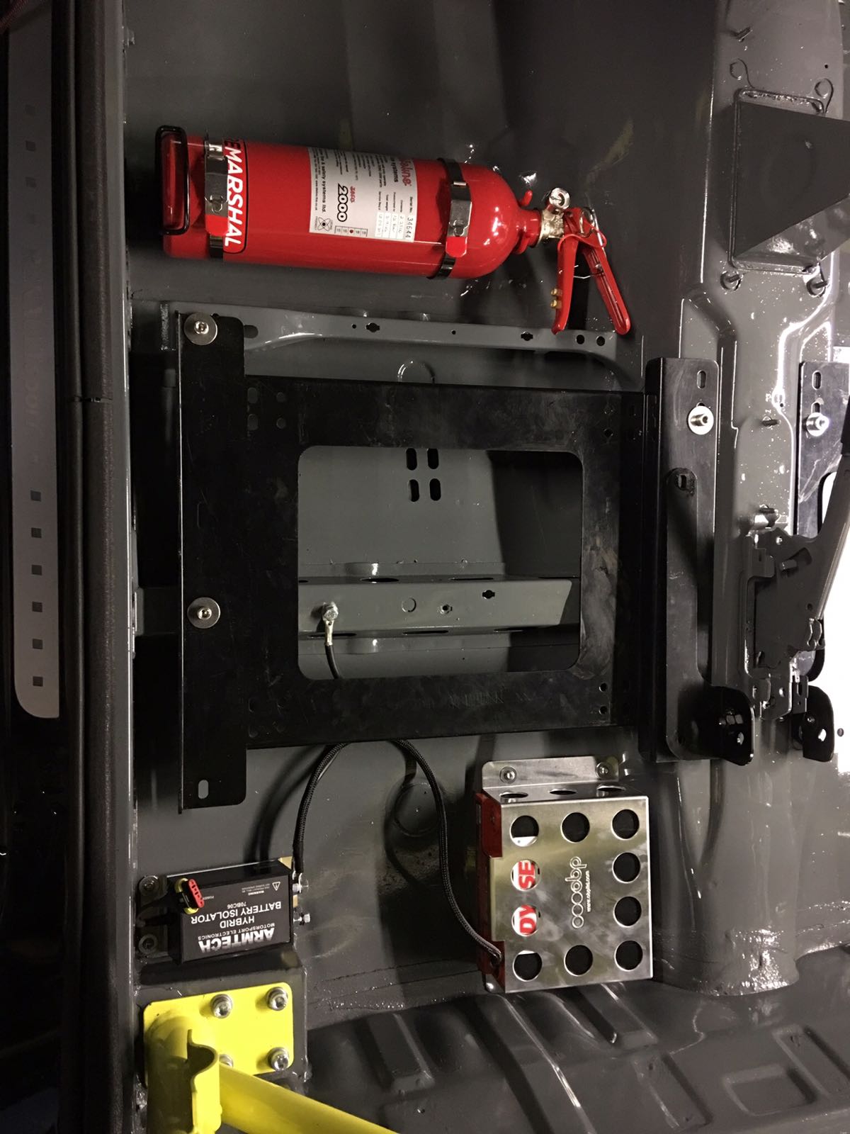

Armtech battery isolator is what you want. Install it near the battery then has a push button for inside and outside the car to kill it. The cheap cut offs won’t work with these as the alternator will keep the engine running. Really smart kit and looks way better than the horrible turn key style stuff.
