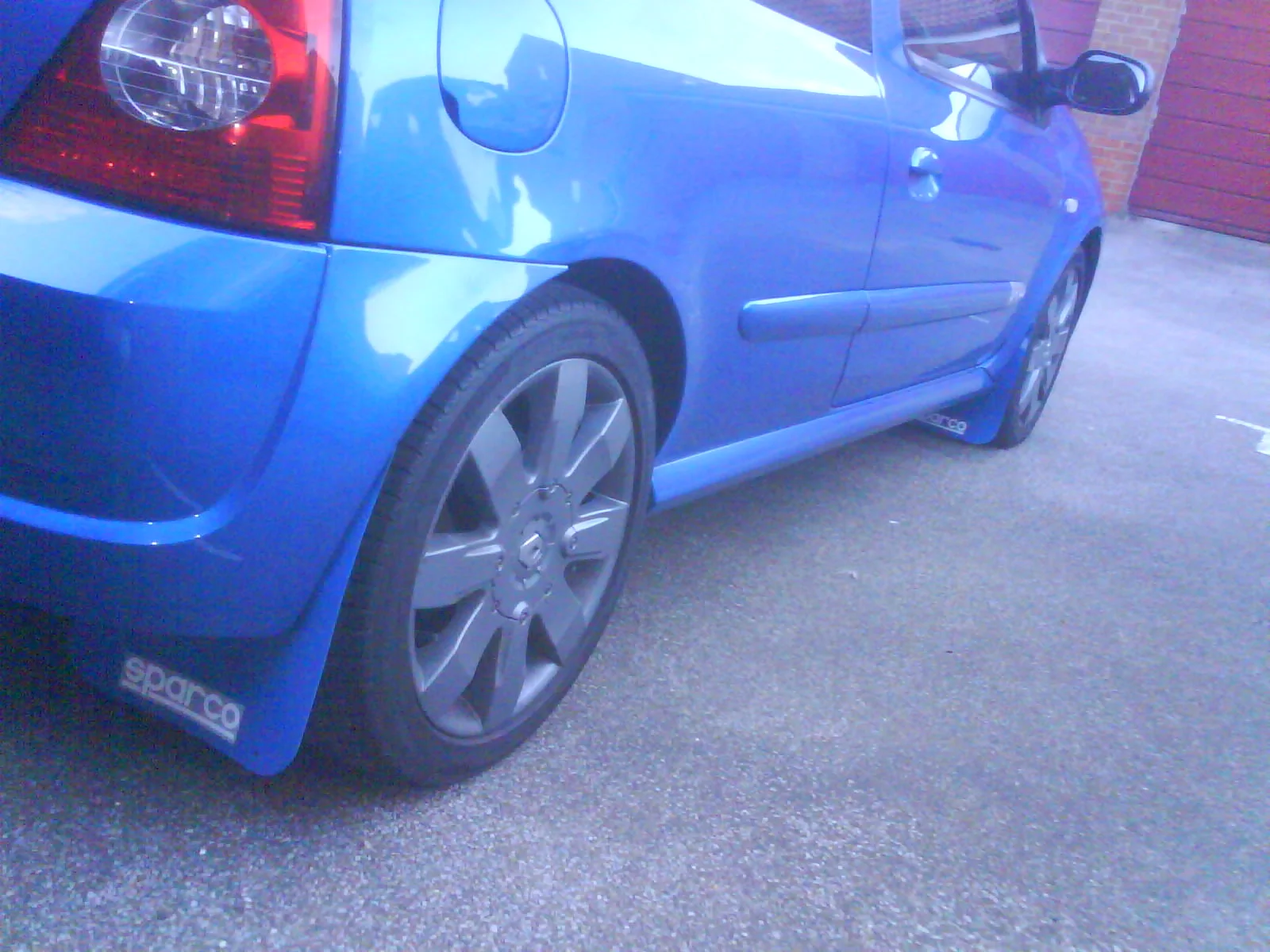

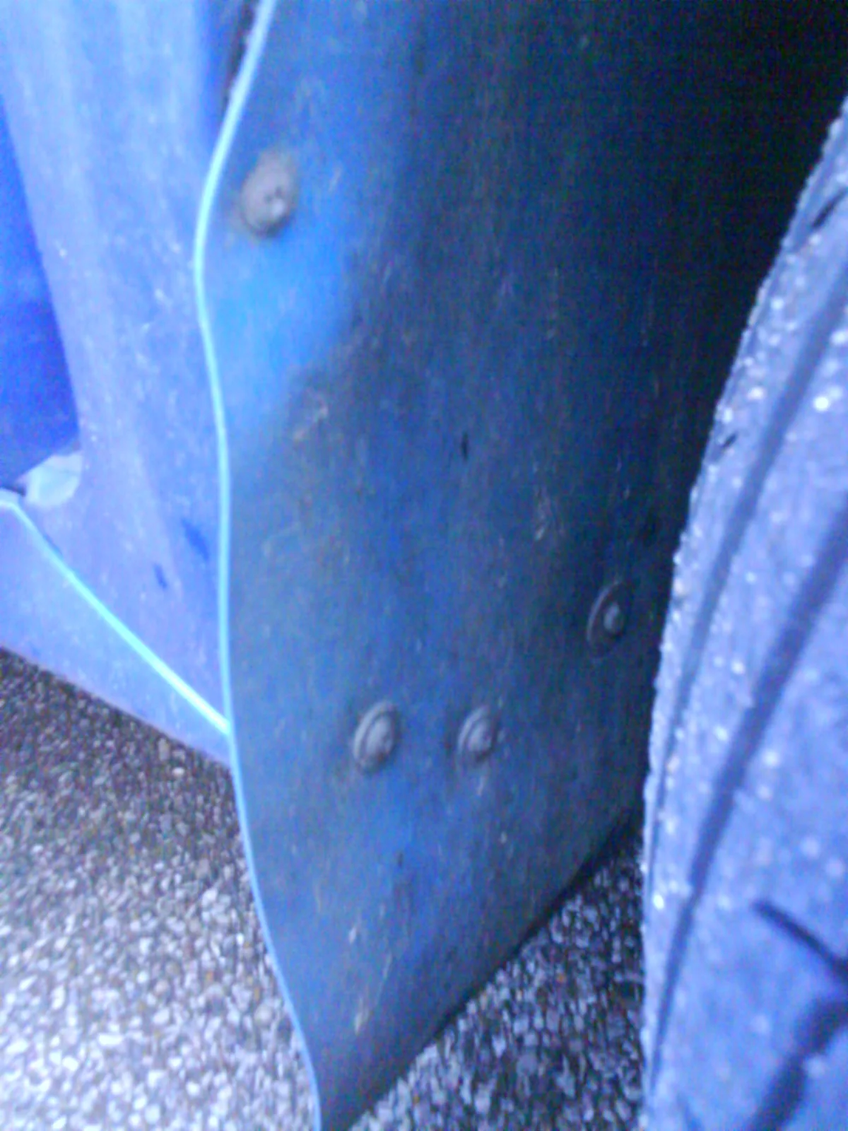

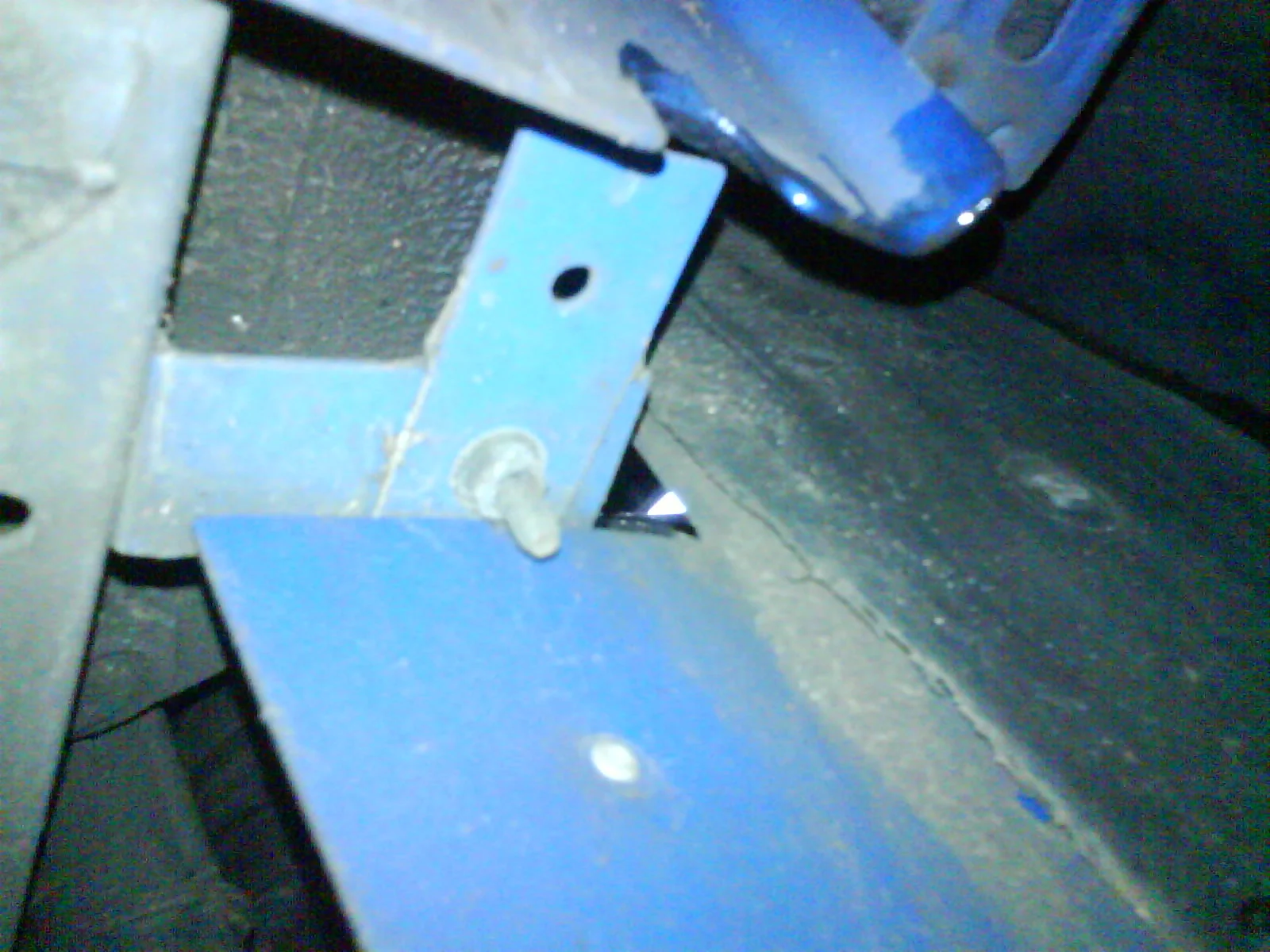

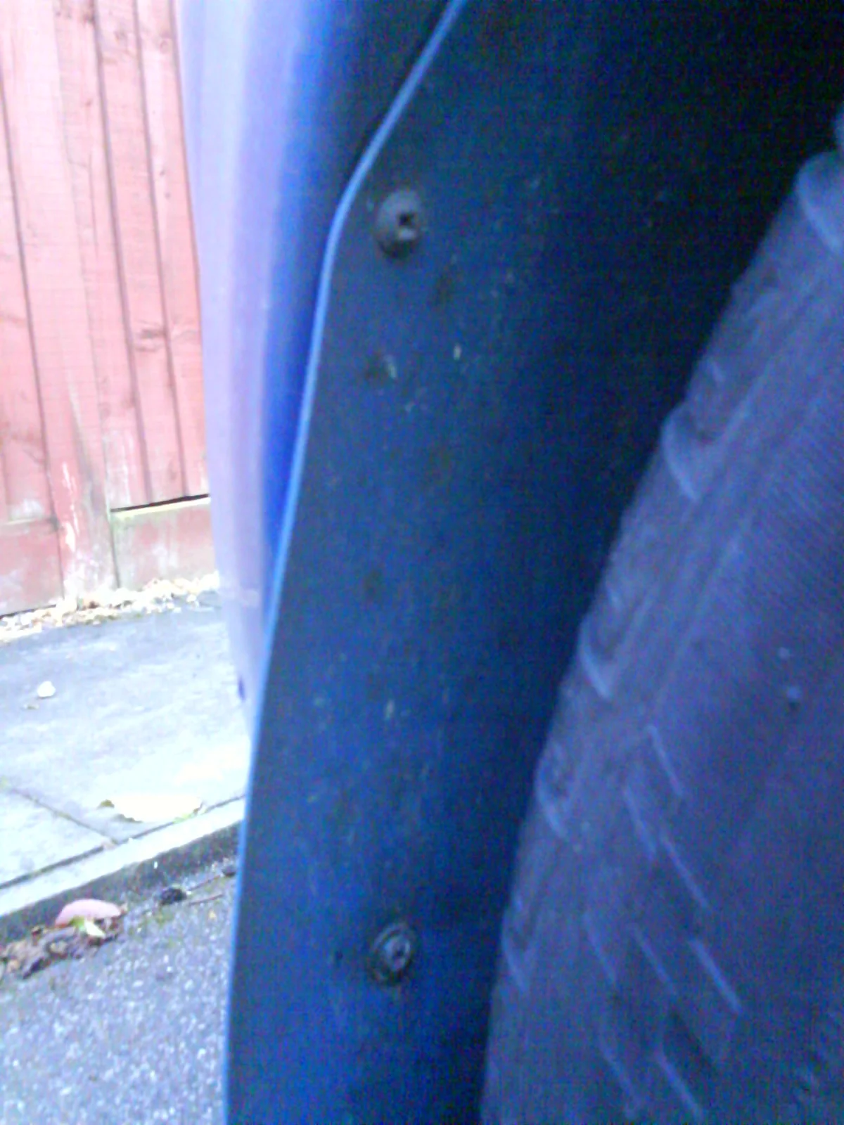

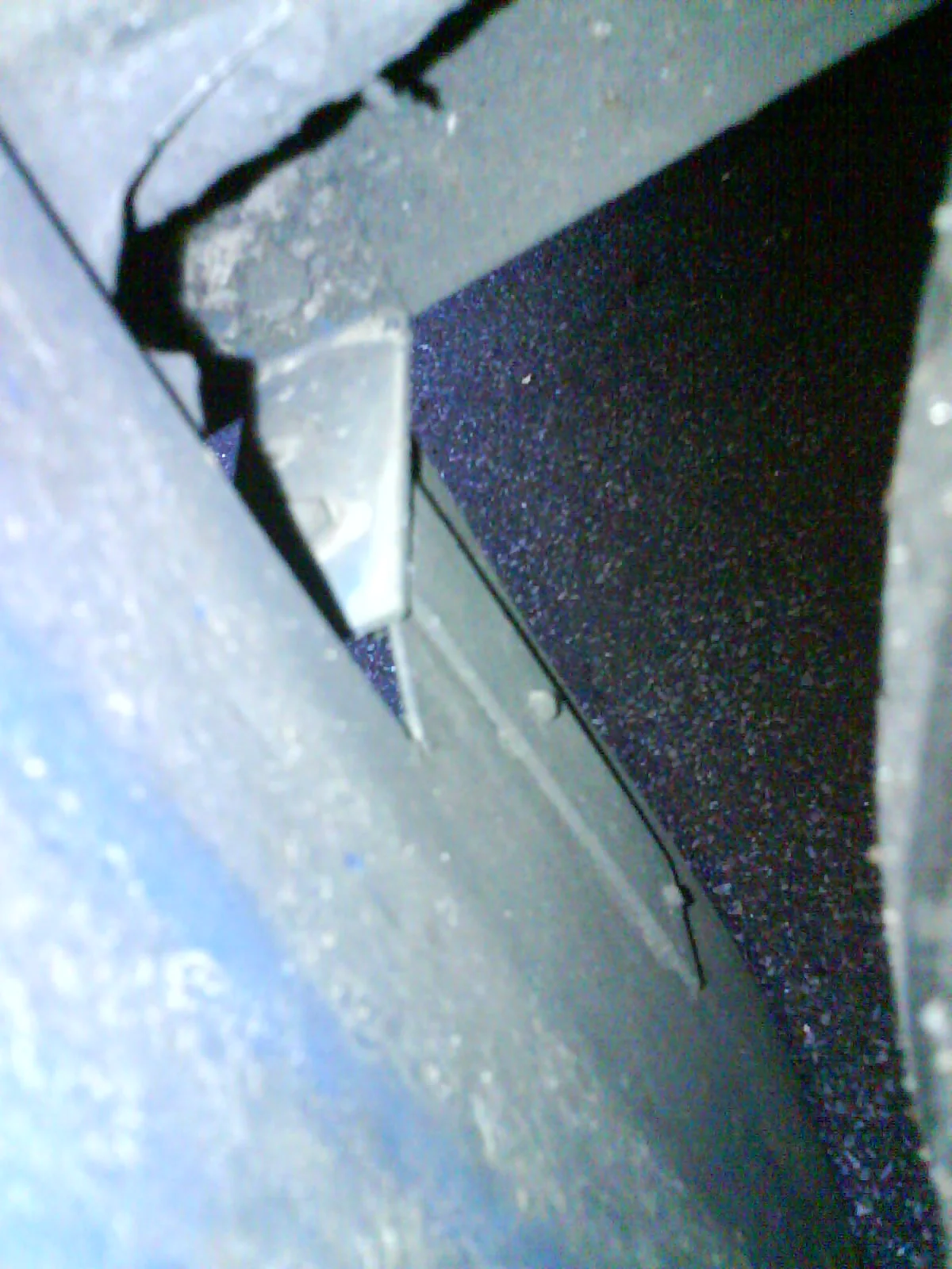

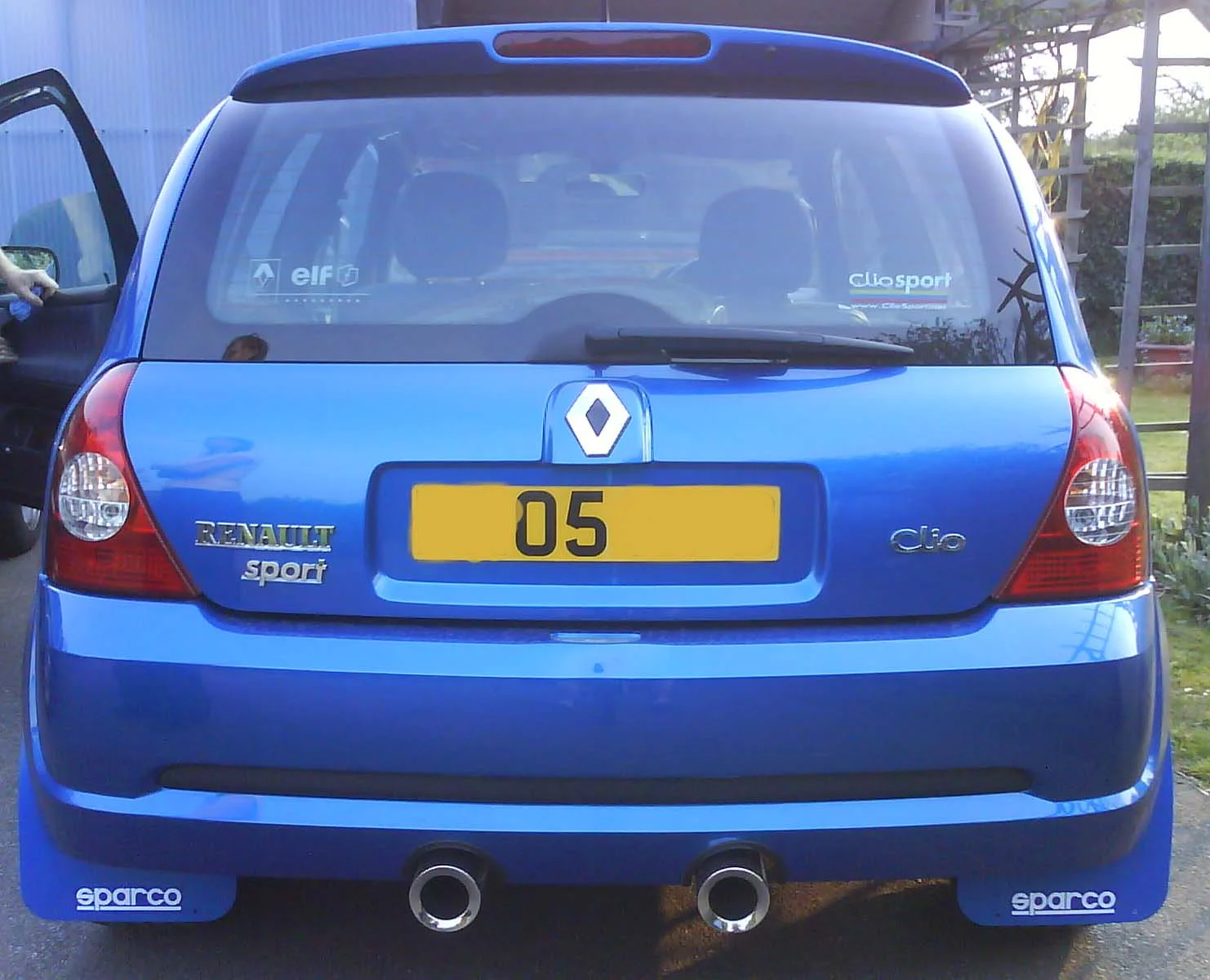

Good in the winter months as i found on mine, made them for driving up the forest tracks to the car parks of the wrc gb, protected the lower sills nicely, i made my own mudflaps from the same as those in your picture(ordered black but Demon tweeks sent me blue), made some alloy brackets and bought some sparco stickers from the WRC last year, i have now removed them for summer. here are the pics of what they look like. Will make new black versions this winter. Gary
Made these from scratch, cut silicone sheet to size, made aluminium brackets with the same contour of lower sill/wing. then used u clamps to fit with no scratching or chipping of paint, used clear protection film between body and flap .
