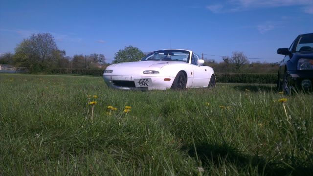

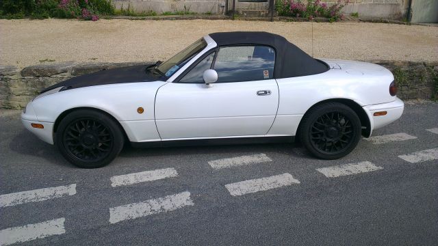

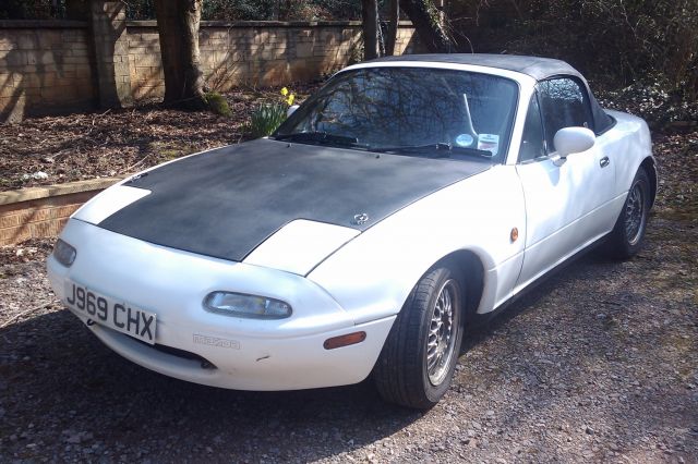

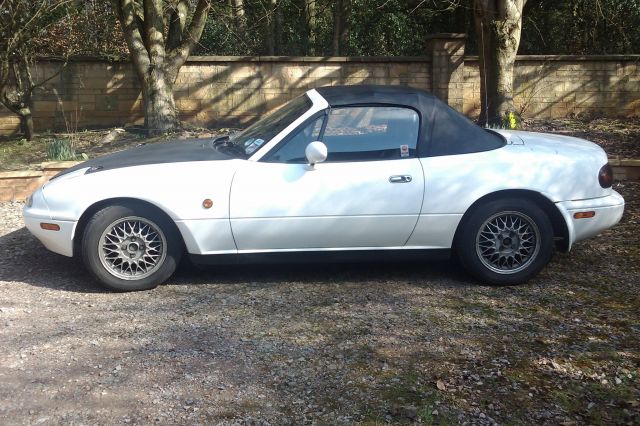

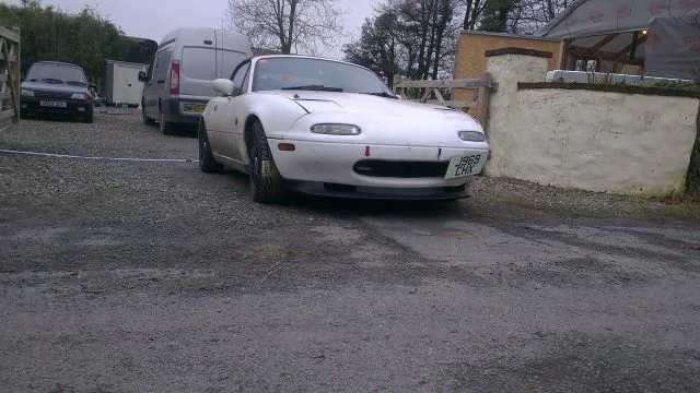

This one's a bit different though bought it from a mate for pennies after he needed to get rid for a new car.. and The title says it all really
Here's Pics of it how it arrived

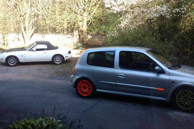

Naturally a shot of it with the Clio
And some randoms admiring it.. well I think they are :eek:
Not got any set plans for it really and it's actually a 3rd car so wont have lots of money to go JDM Yo!
I like the BBS it came with but they are only 14" so most of the tyres available for it are crap :( would like a nice set of 15's for it so can have proper size tyres!
Currently also on the look out for a decent bonnet!
It already has a silly loud de-catted Mazdaspeed exhaust which is fun with the roof down, and some cheapo lowering springs and thats about it..
I'm thinking of also trying to find a decent set of JDM Billies for it and maybe an LSD but for now just generally enjoying have a bit of rwd fun :cool:
Apologies for picture quality couldn't be arsed to get the proper camera out as it's filthy and it covers that up a bit :rolleyes:

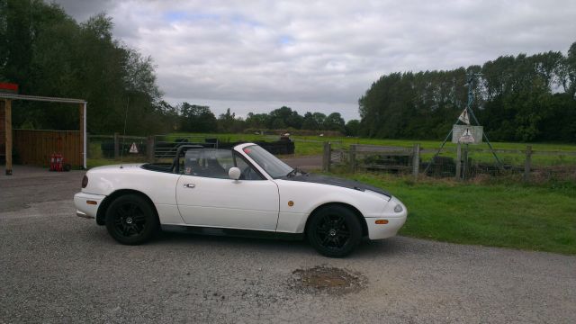

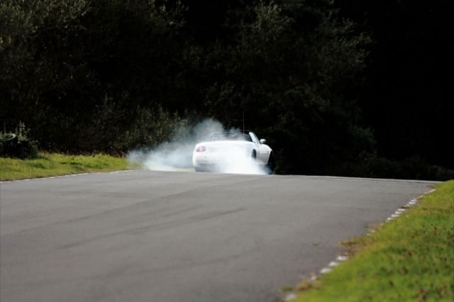

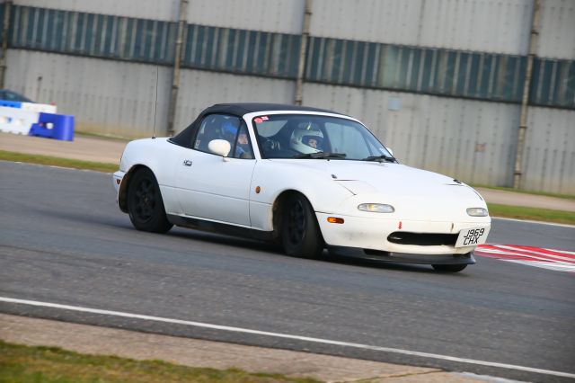

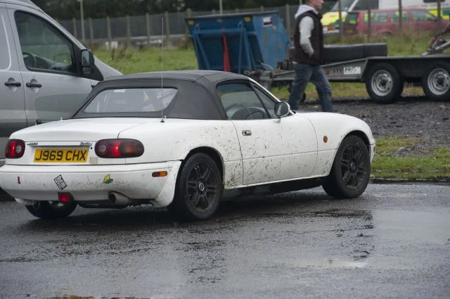

So not updated this thread in a while.. the 5hed has taken over the track duties from the now sold 172.
So it got used exactly as I bought it a few times (bar some cheap 15's with budgetastic tyres):
Around Castle Combe and the Burpspeed LLandow day
It even had enough room to go camping at Llandow:
It was great fun and made me realise i'd made the right choice of RWD over FWD for track fun.

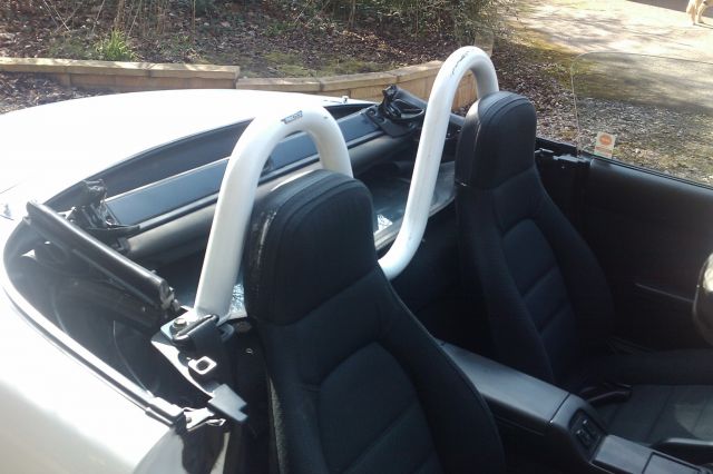

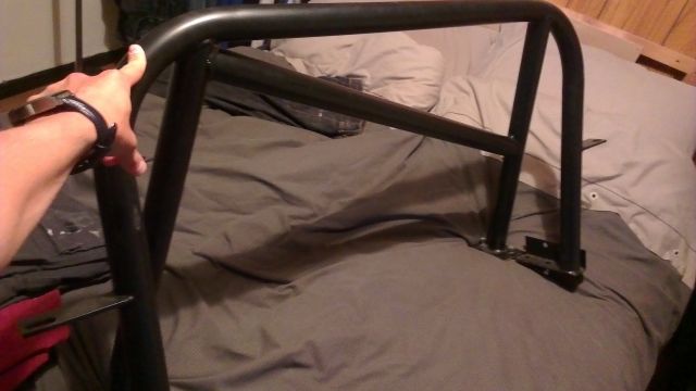

First things first safety:

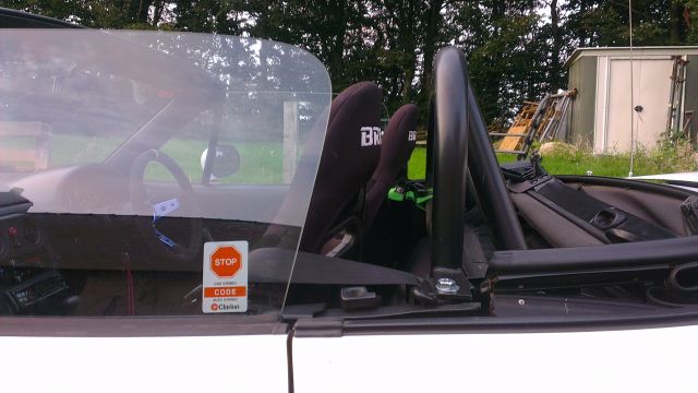

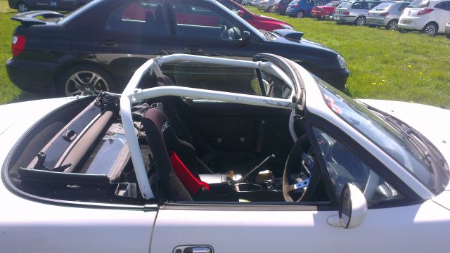

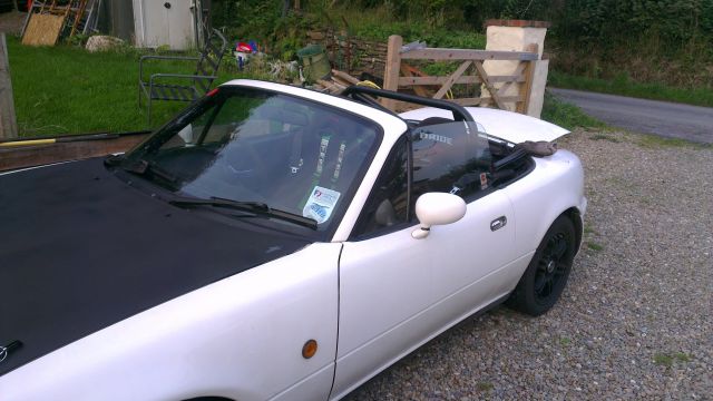

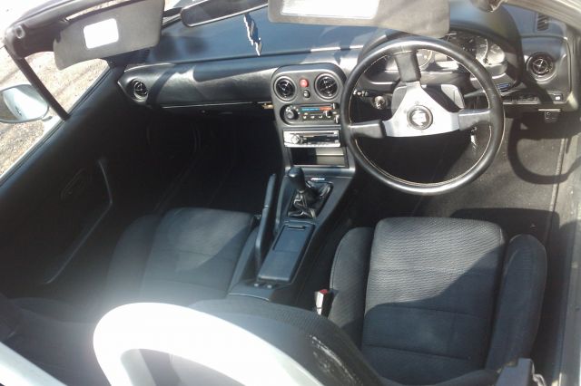

Bought a proper rollbar and got a harness bar welded into it as wasn't too keen on the bolt in types (bit of a nightmare too fit)

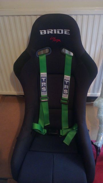

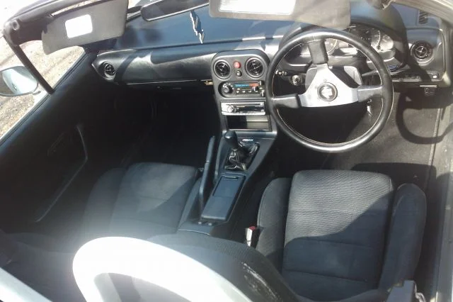

Added a deep dish wheel and a couple of buckets and some harnesses at the same time as the standard seats offer no side support whatsoever!
The buckets I fitted with some JBFabrications brackets which get the seats a lot lower than standard.

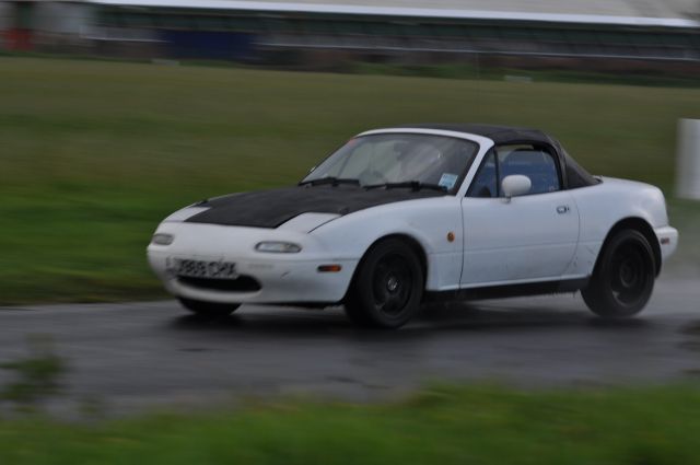

I then gave it a bit of a run out a Curburough with Fiat Coupe Club

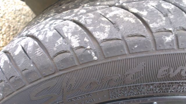

The tyres decided even a sprint day was too much for them

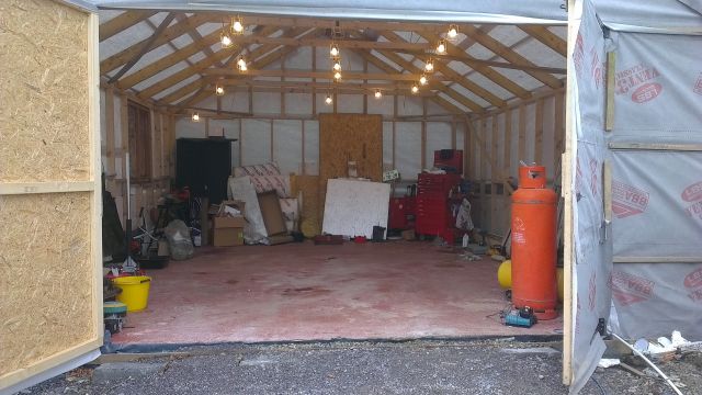

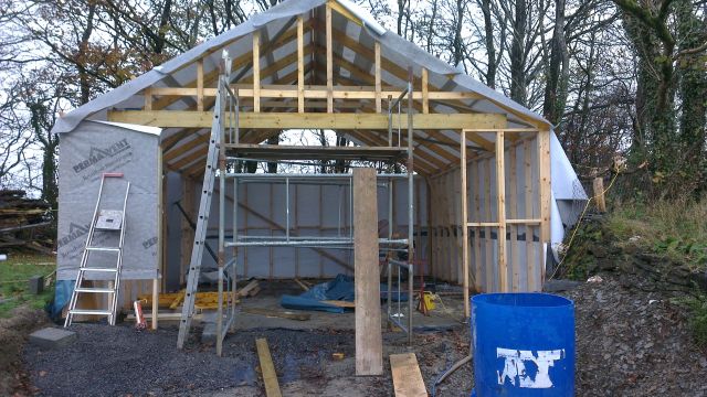

It was around this time my Dad and I decided to build a garage (which came in handy a few times)
Link for obligitary build thread here:
http://www.cliosport.net/forum/showthread.php?668160-Garage-Build!-On-a-Budget!

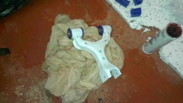

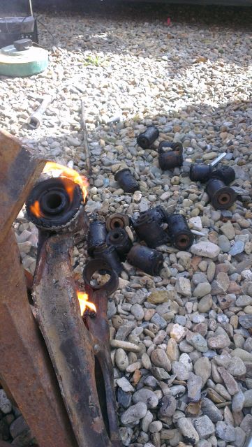

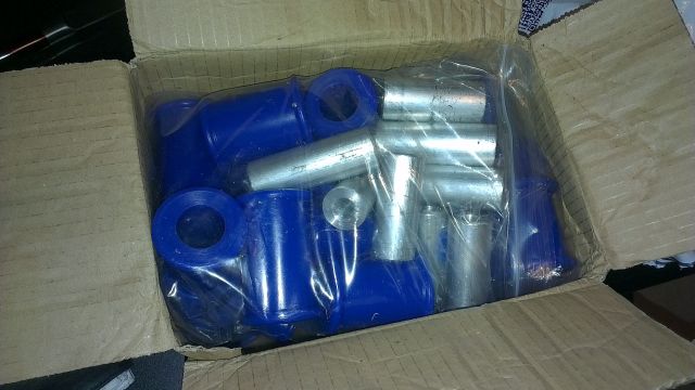

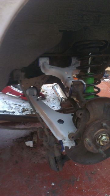

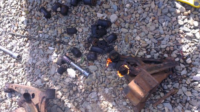

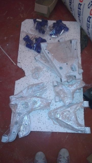

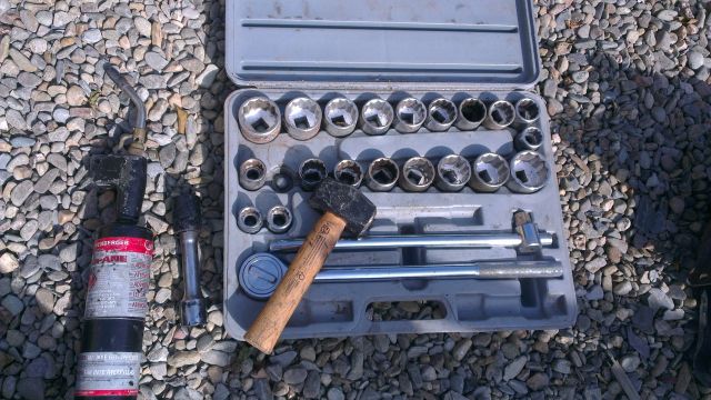

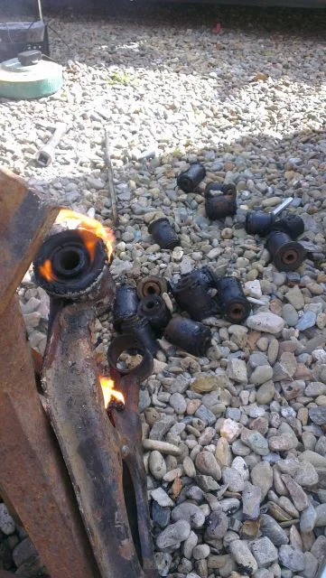

Firstly I bought a whole set of arms to polybush. Crap job removing the things!
Man sized tools
The bushes gave up the fight!
The arms then got sent off along with some Cusco uprated ARB's I had bought for a bit of colour before I installed the Polybushes.
They came back a little something like this:
The hundreds of bushes were then installed with a bit of "Red & Sticky"

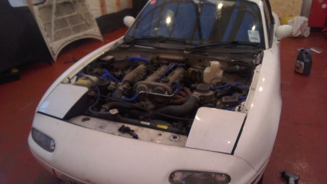

Then with a trackday at Bedford looming I decided I actually better get on with fitting parts.

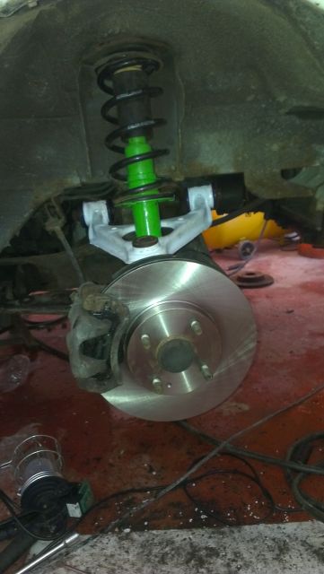

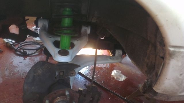

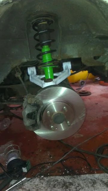

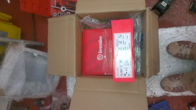

With a couple of days off work I fitted:

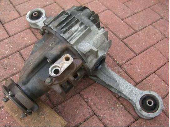

Torsen LSD with driveshafts and prop
Changed to 1.8 brake discs and "Rodders" pads
Mazdaspeed dampers with eibach springs
Cusco ARB's
Wishbones with polybushes
New Track rod end's
New ball joints
Upper and lower gearstick boots
Gearknob extender (stop me bashing my elbow on fast changes)
All fluids changed (gearbox, dif, engine oil and coolant)

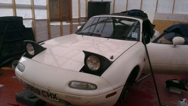

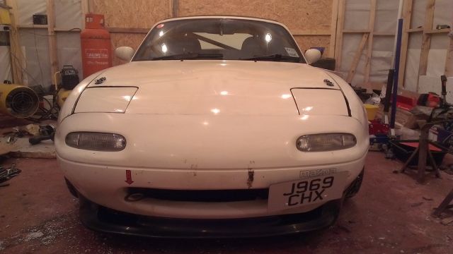

And some cosmetic stuff incluidng the right colour bonnet and headlight covers, Garage Vary replica splitter (PU instead of fibreglass) and offset plate holder.
Also bough a nice high lift low entry jack which made things loads easier:

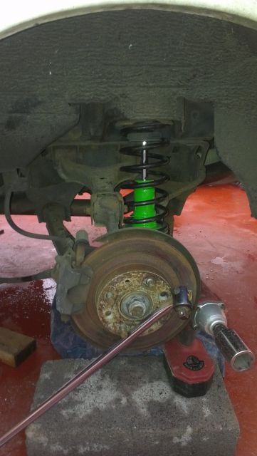

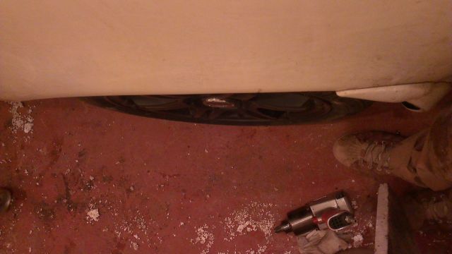

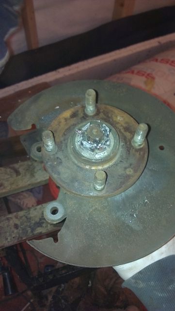

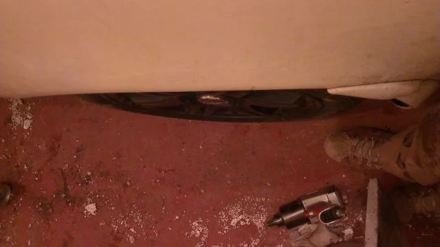

Naturally the old hubnuts refused to move even with a 900nm airgun and heat..
So mr angle grinder solved that eventually!

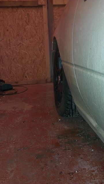

The car needed a wee bit of alignment before seeing the track
Camber and toe all over the place isn't ideal for track!

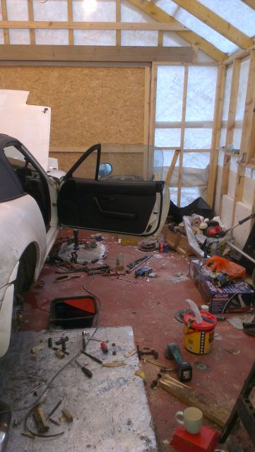

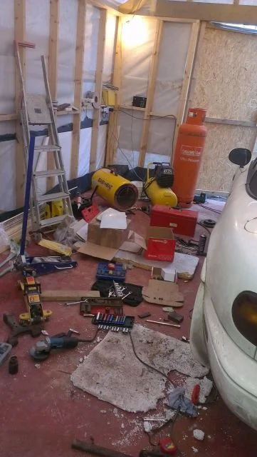

So after about 40hours work on the car over 2 and a bit days the garage was a bit of a state..
So the 5hed got kicked out on it's new Uniroyals ready for Bedford
And the garage got a bit of a tidy awaiting the roof to go on it a few days later

Wanna know the most annoying bit.. one of the front ones had a broken droplink bracket so had to fit the bushes to the old one, gutting :banghead:
