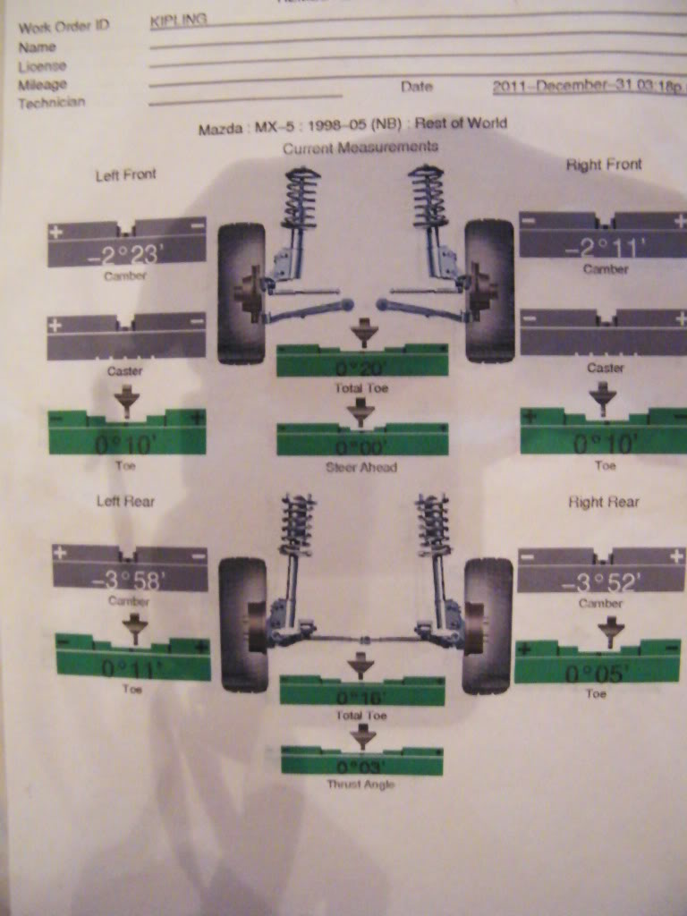

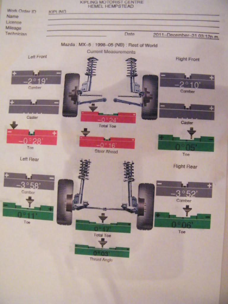

I got the tracking and toe in and out adjusted, need to get the wheels weighted also order a front lip today :D
when she went in
when she was finished

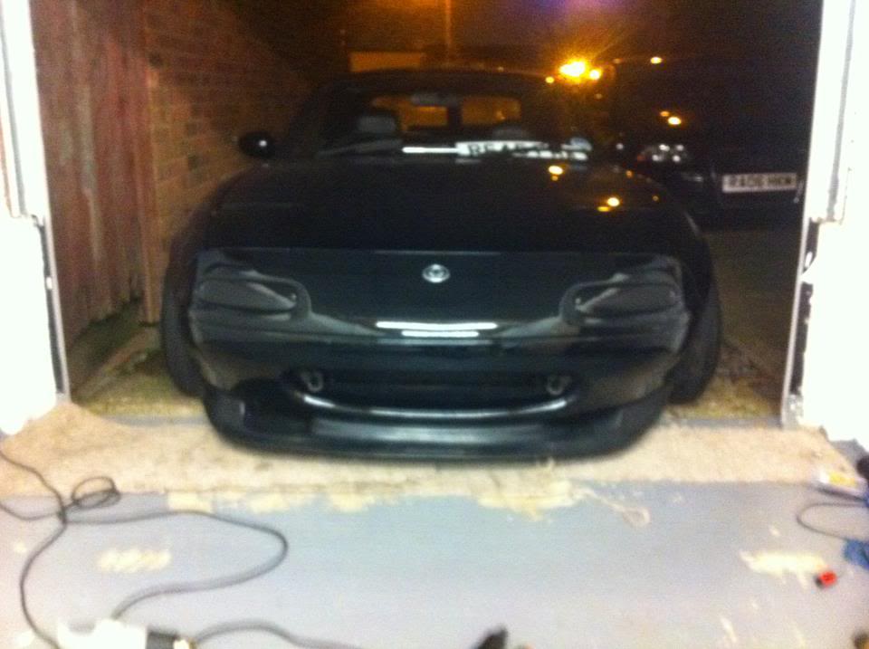

right fitted my garage vary "replica" front lip and before people start saying why did i go and get a "replica" lip there is a good reason promise :eek:
the real garage vary lips are made from a very stiff/hard plastic which mean they break all the time as with the "replica" is made from Poly urethane which will last forever and save me buying lip after lip:D
sorry for the crap pictures again.

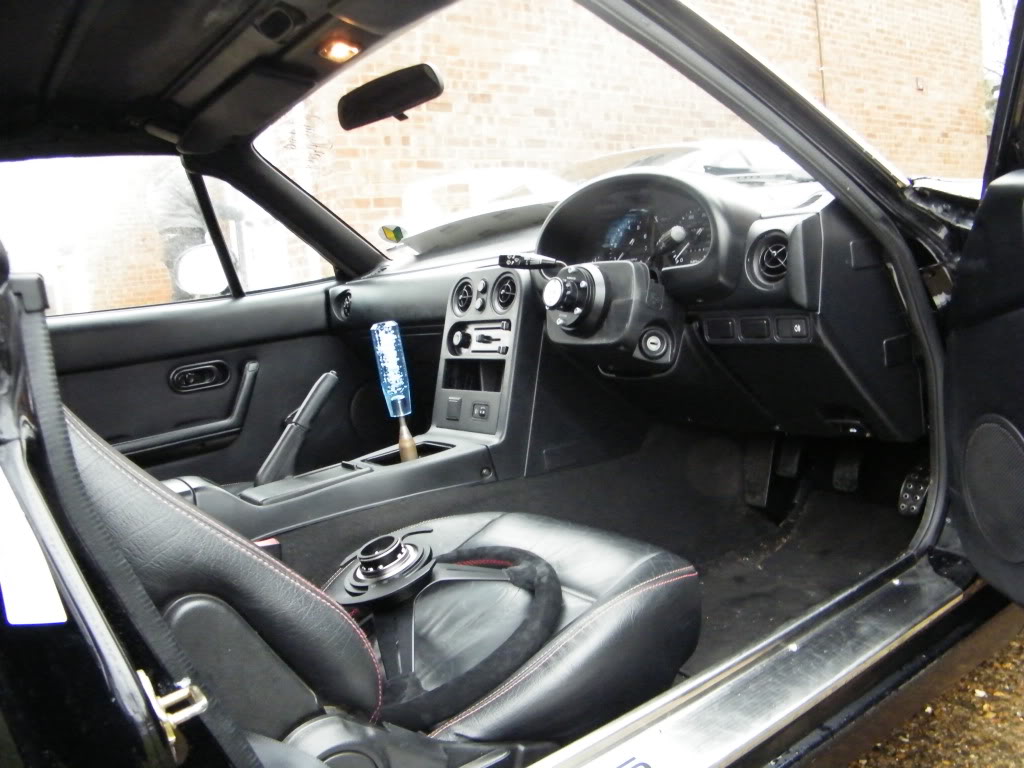

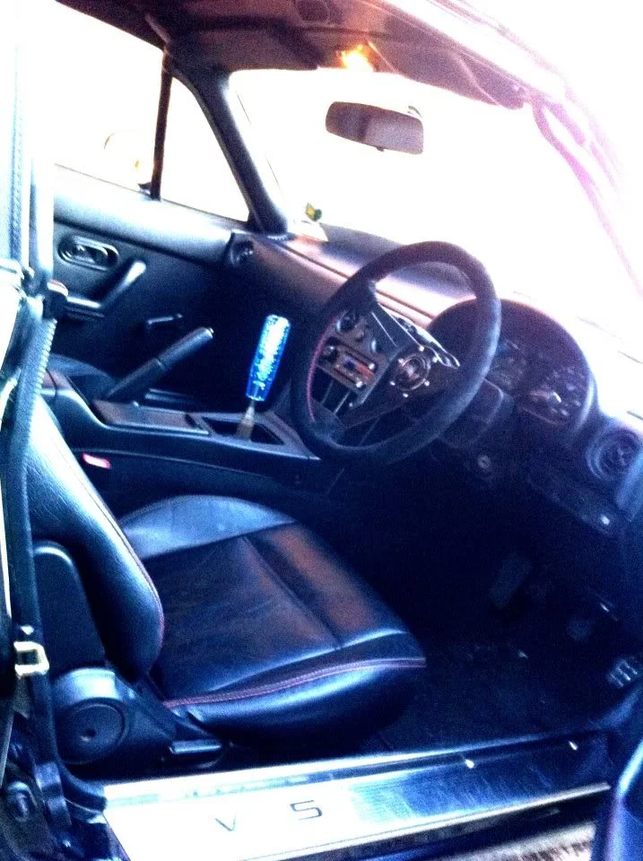

Sorry, this is probably already covered, but you appear to have stuck a sex toy to your gearstick.
Hixle
Hi Kiss Luke E****
  981 Cayman GTS
Looks brilliant. Not sure on the dildo gear knob, but otherwise looks great! I want one :dapprove:
That looks really great Adz. Awesome choice of mods! Makes me miss mine... but then I remember the ride quality LOL. How are you finding your coilovers? Bouncy bouncy?
