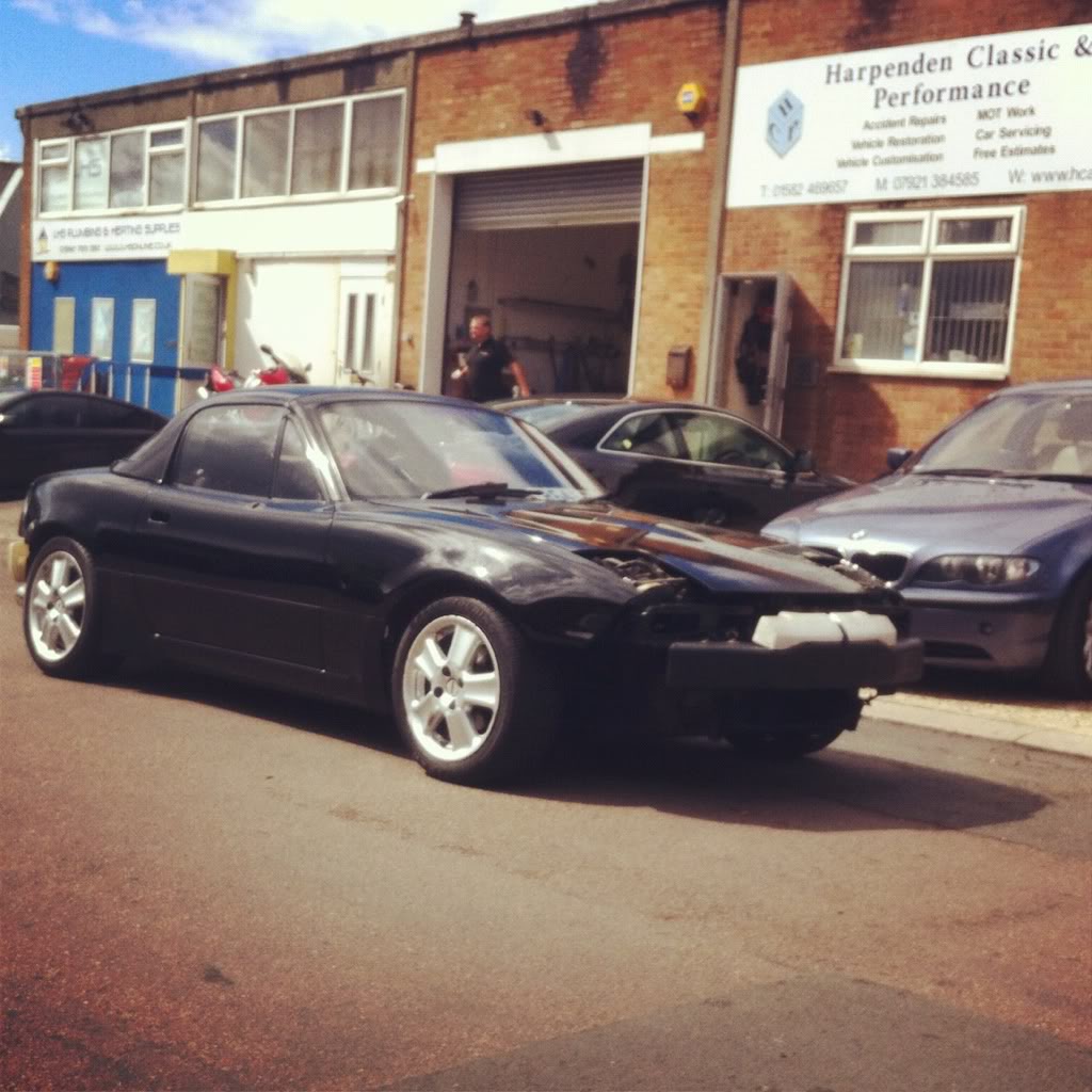

last picture of the mazda with shabby paint :D 2 weeks till she is back along with some more changes ;)

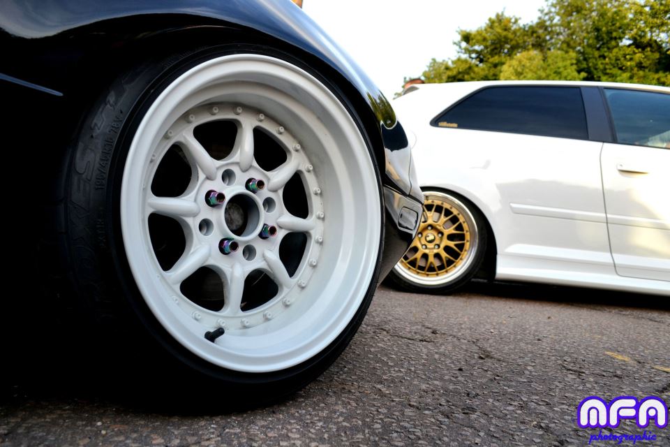

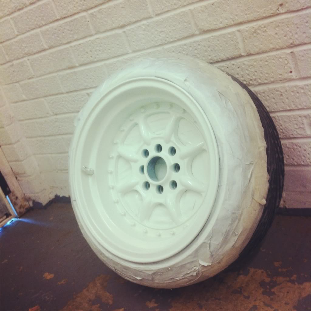

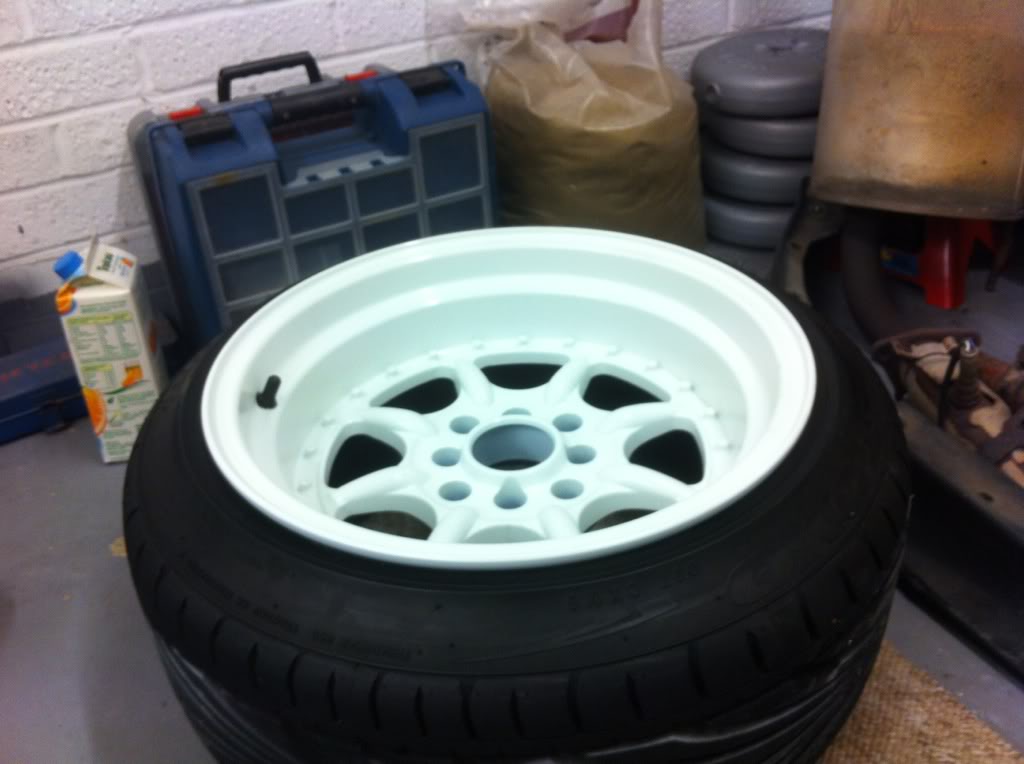

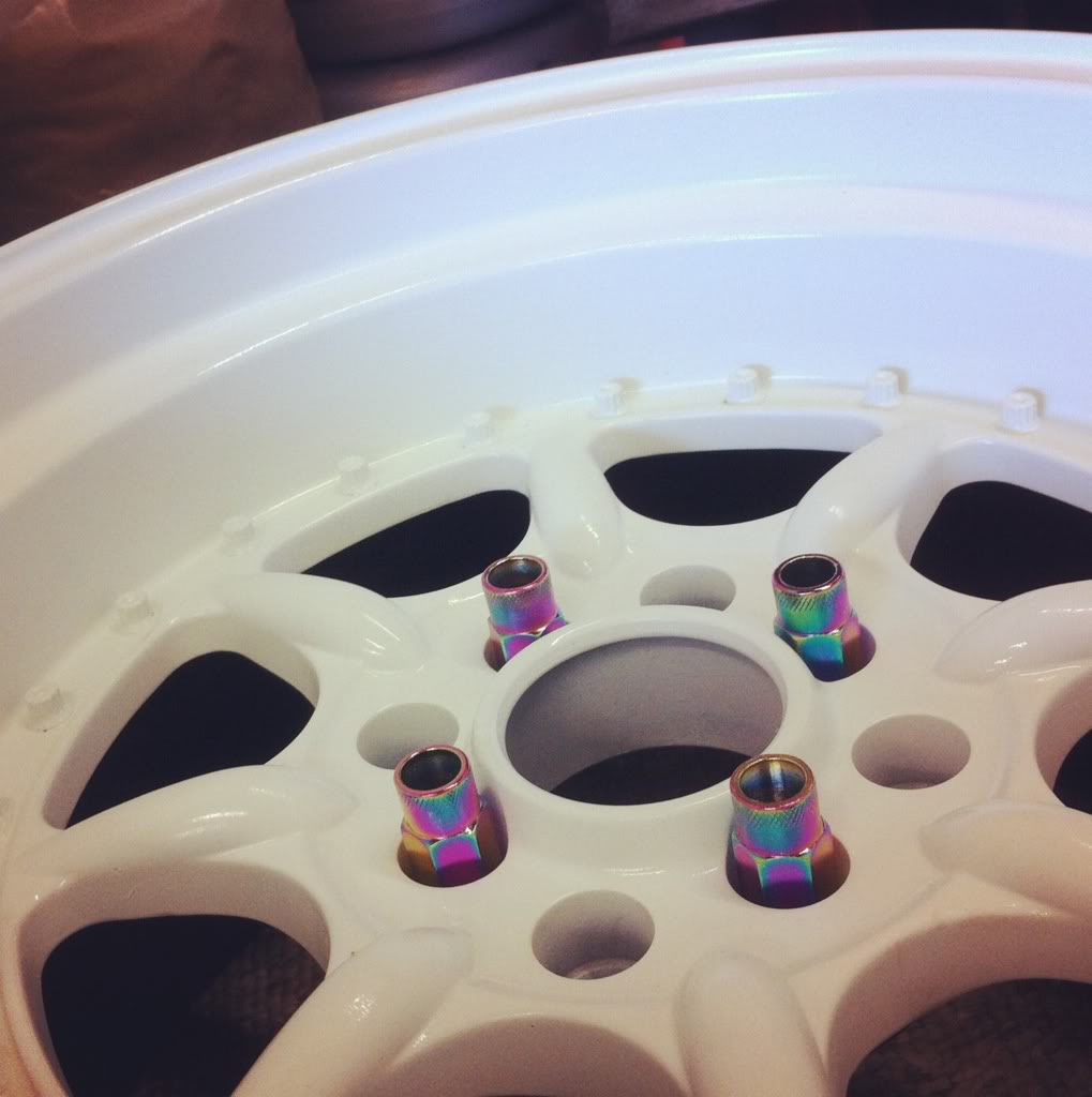

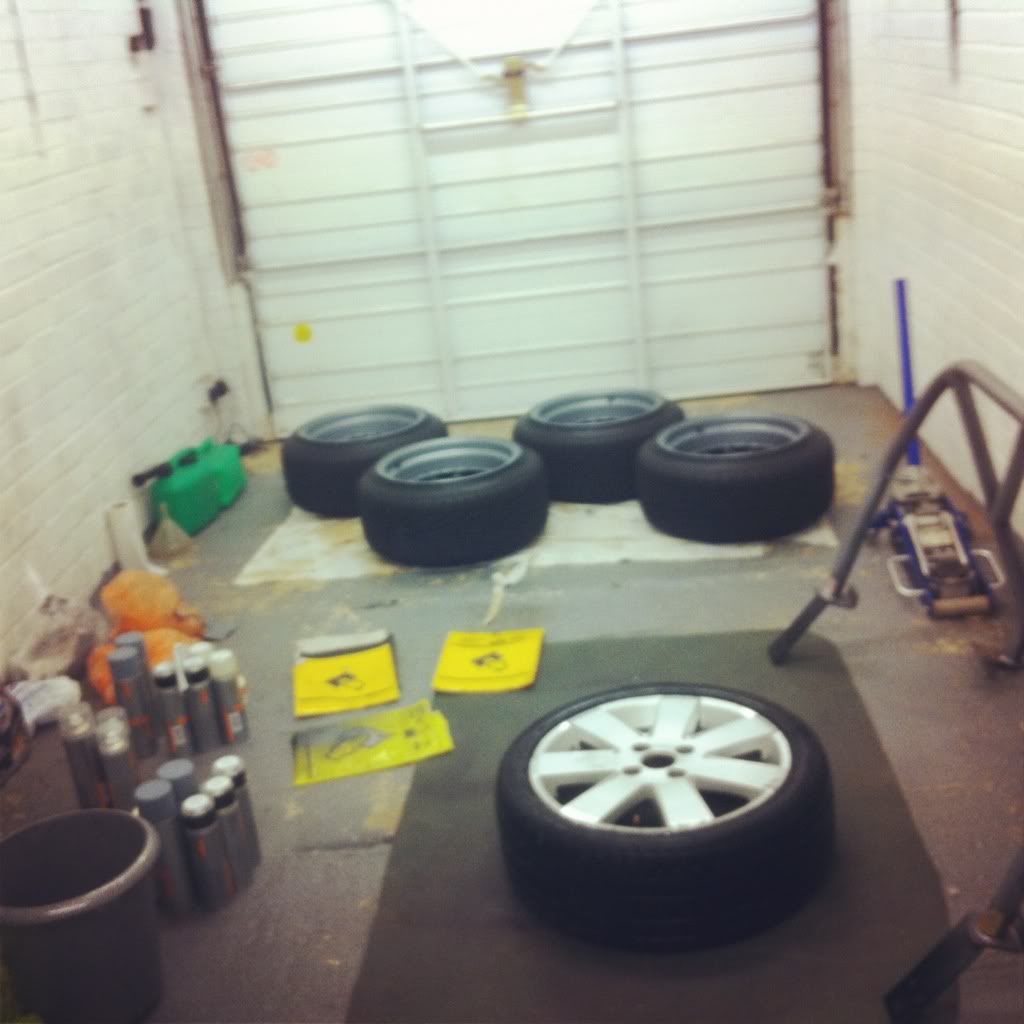

set to working on changing the wheel colour, so far ive only done one but i very happy with the out come
the work shop little small but will do :D
half way threw painting the one wheels
almost done just flatted back the lacquer now need meguiars ultimate compound to get rid of the orange peel
new tuner nuts thanks to drift works :cool:

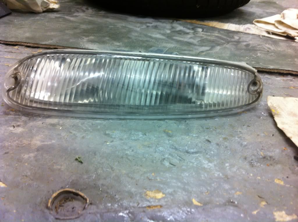

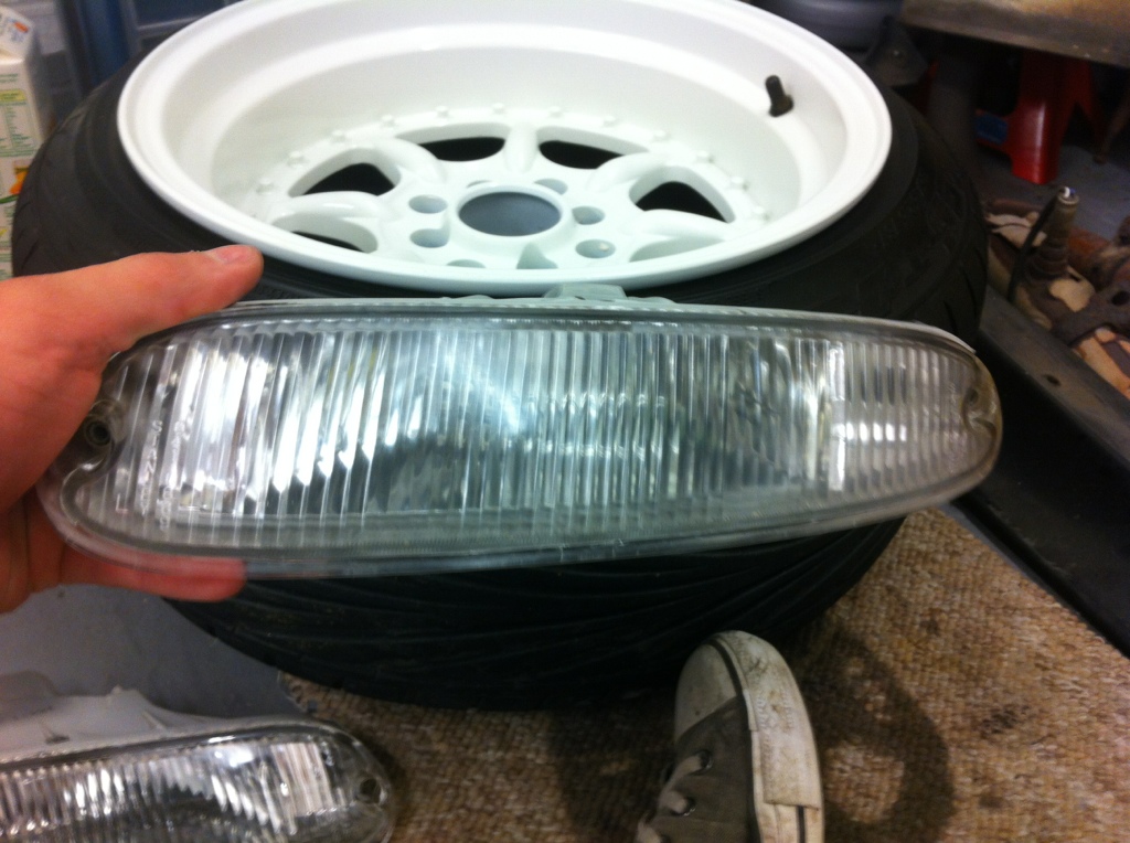

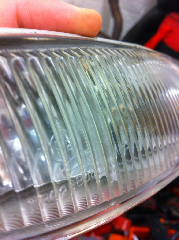

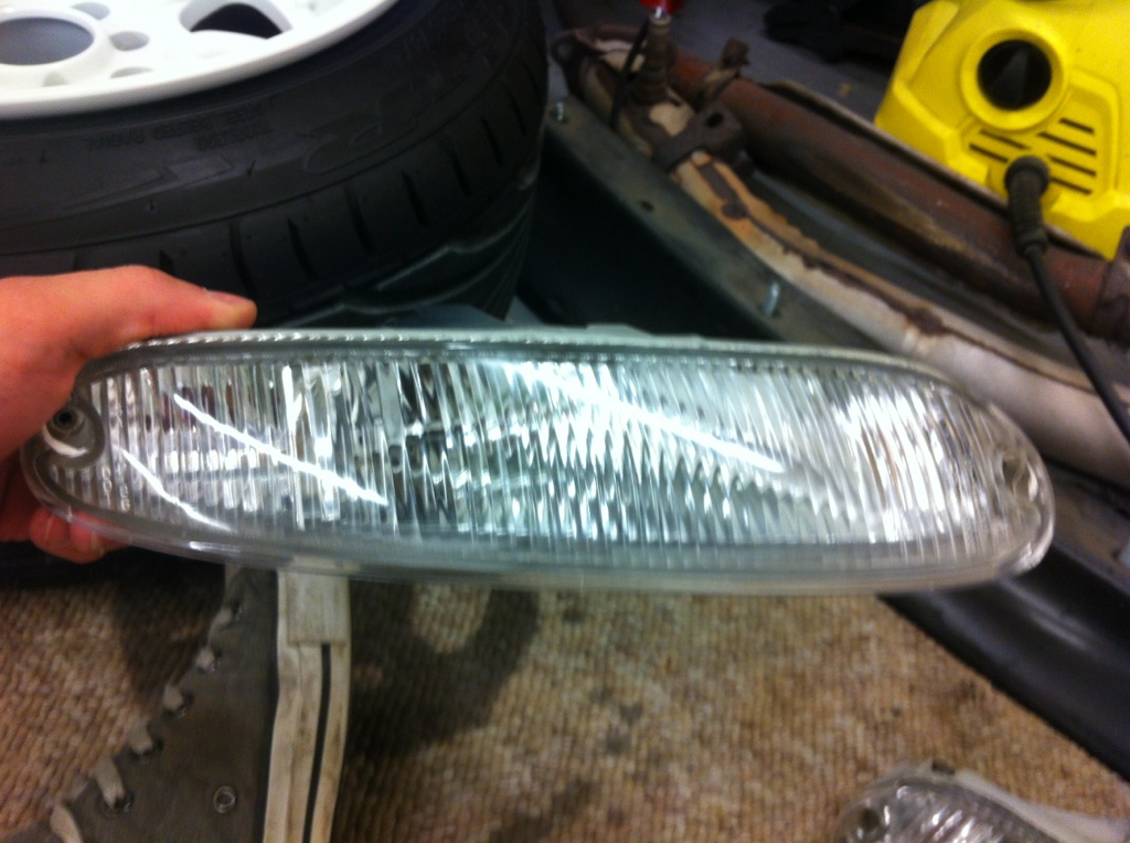

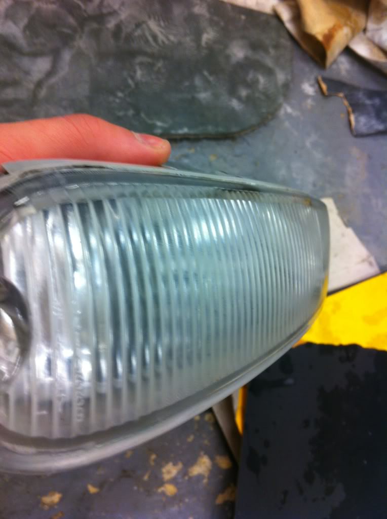

then set to work on my front indicators, had to spilt them and take the amber covers out giving a clean look :D
cooking the light in the oven on my lunch break while my mum was at work haha! 20mins at 80'c did the trick
then i got 1200 wet and dry and sanded over the front to take off the plastic writing on the front
with the writing
with out the writing

picked up some meguiars ultimate compound to finish off the indicators, they came out pretty well :D
one that hasnt been polished over with the ultimate compound
the finish product :D
very happy with the out come of a few minutes work

They've come out great.
When you get the car back, switch the indicators with the sidelights - USDM style y0
maybe if ive got time haha!

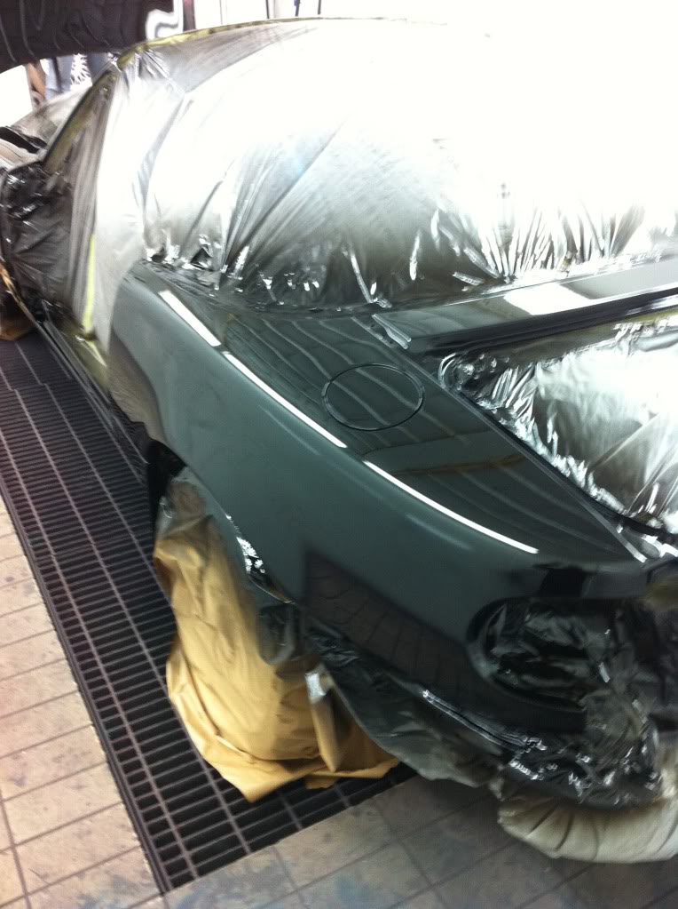

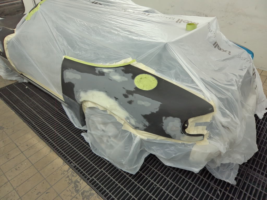

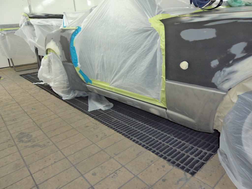

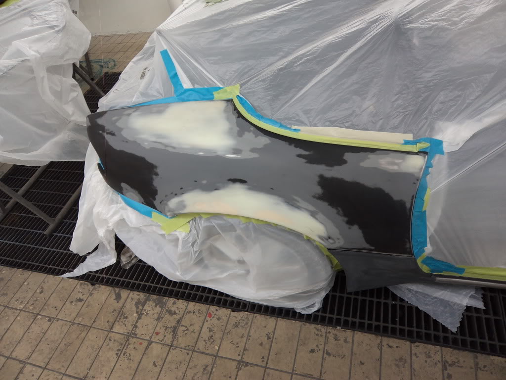

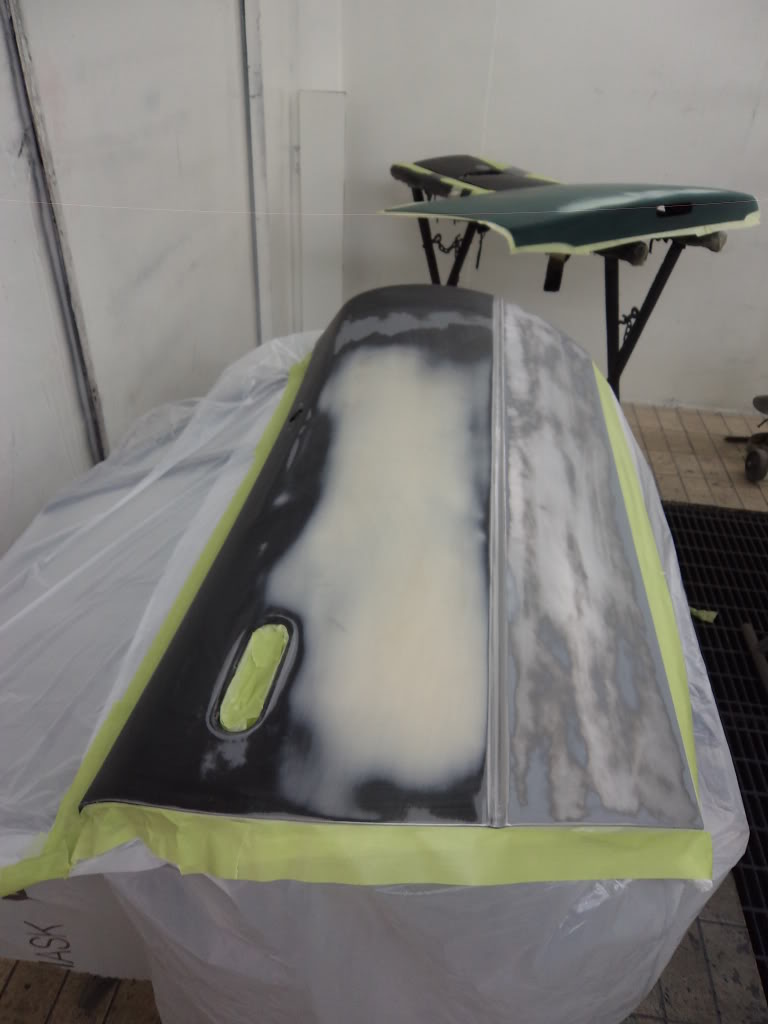

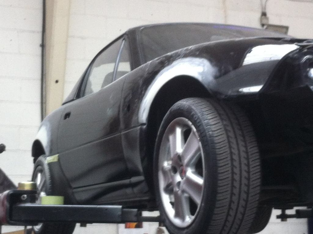

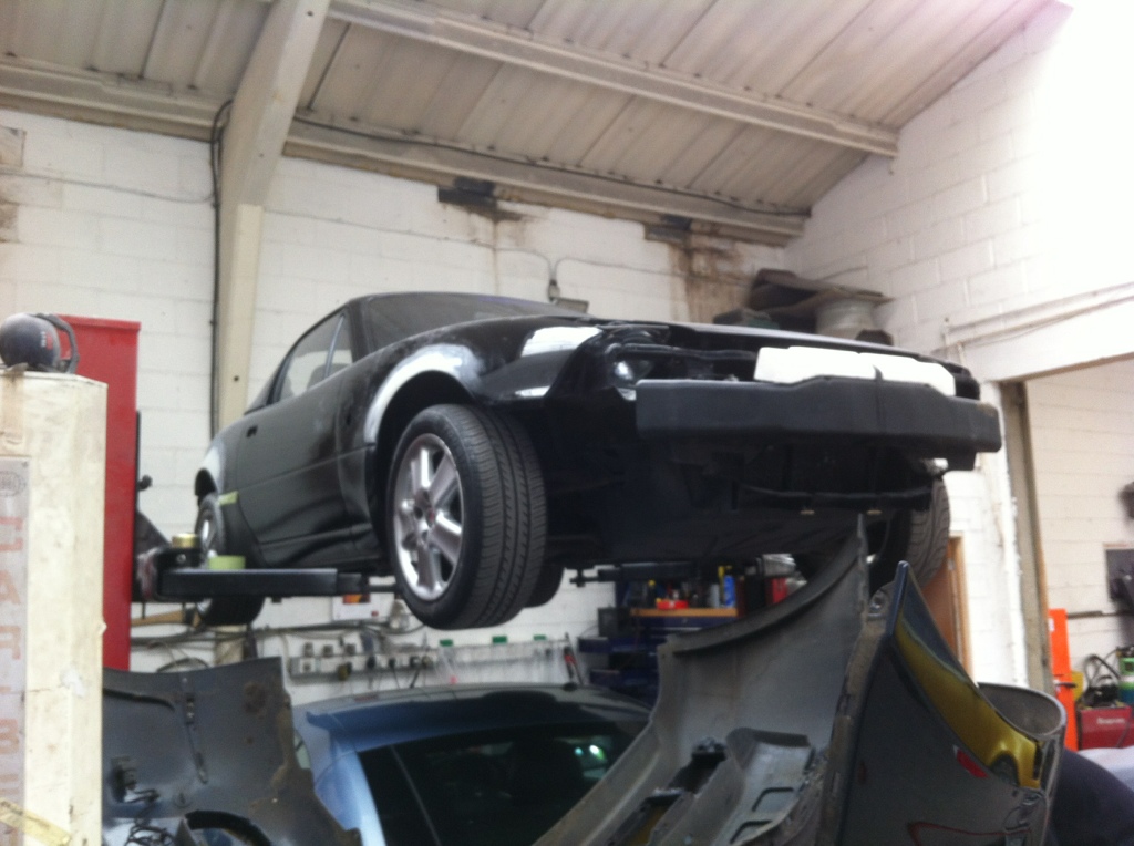

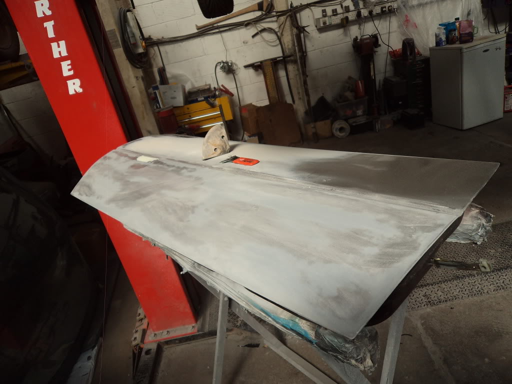

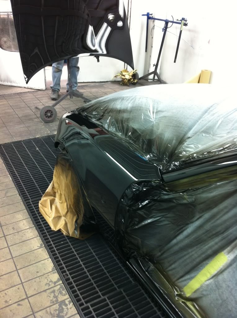

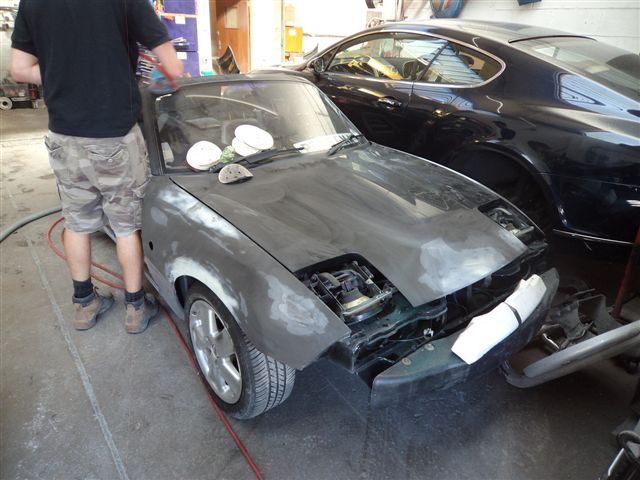

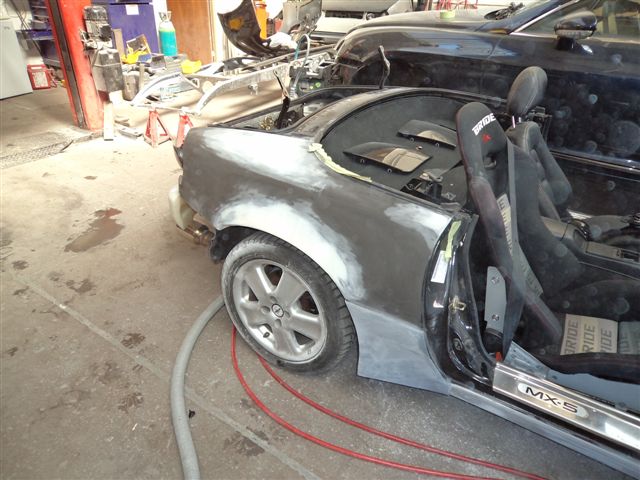

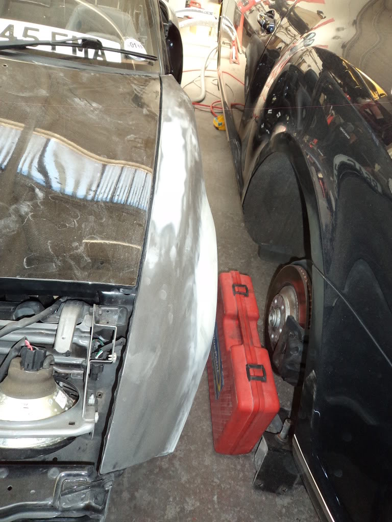

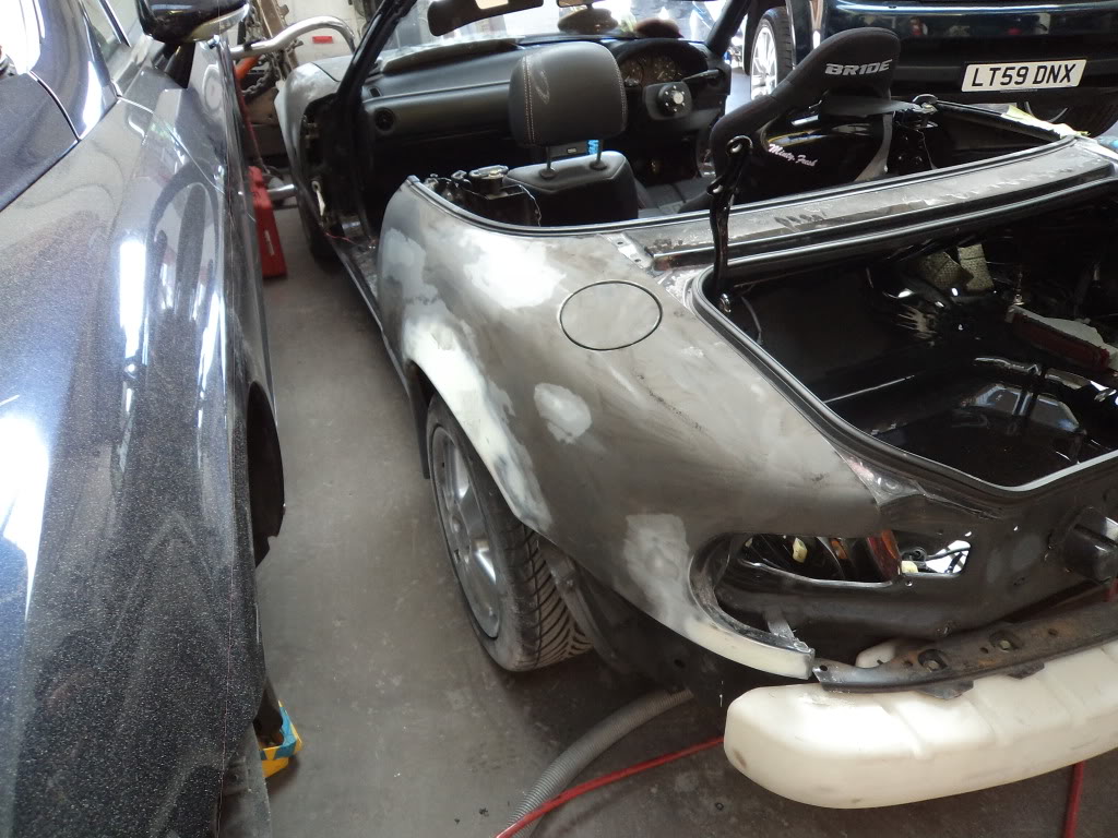

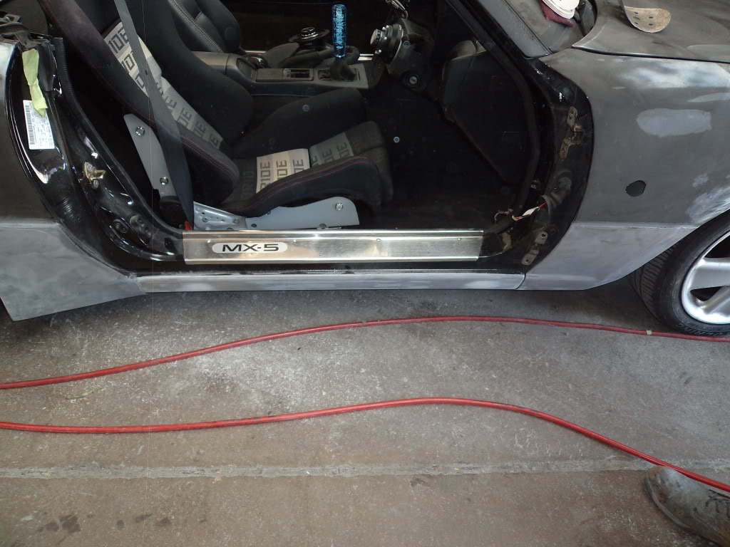

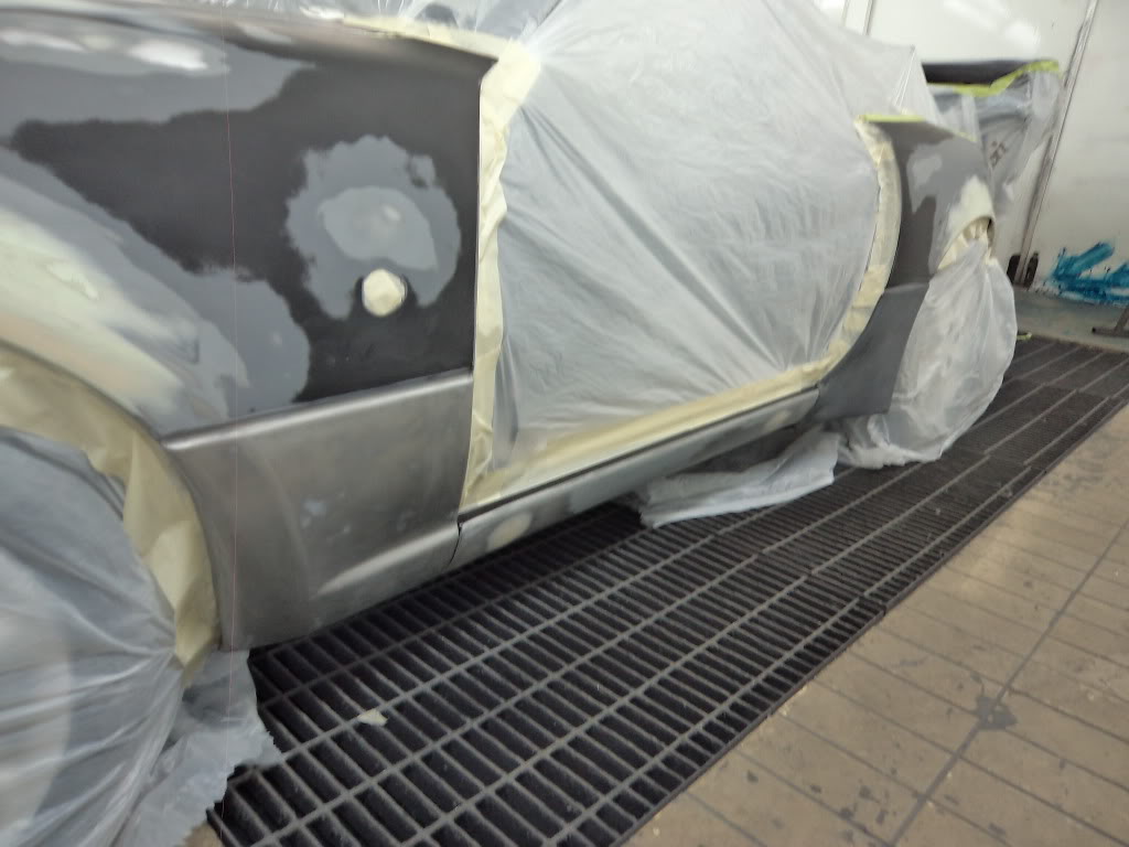

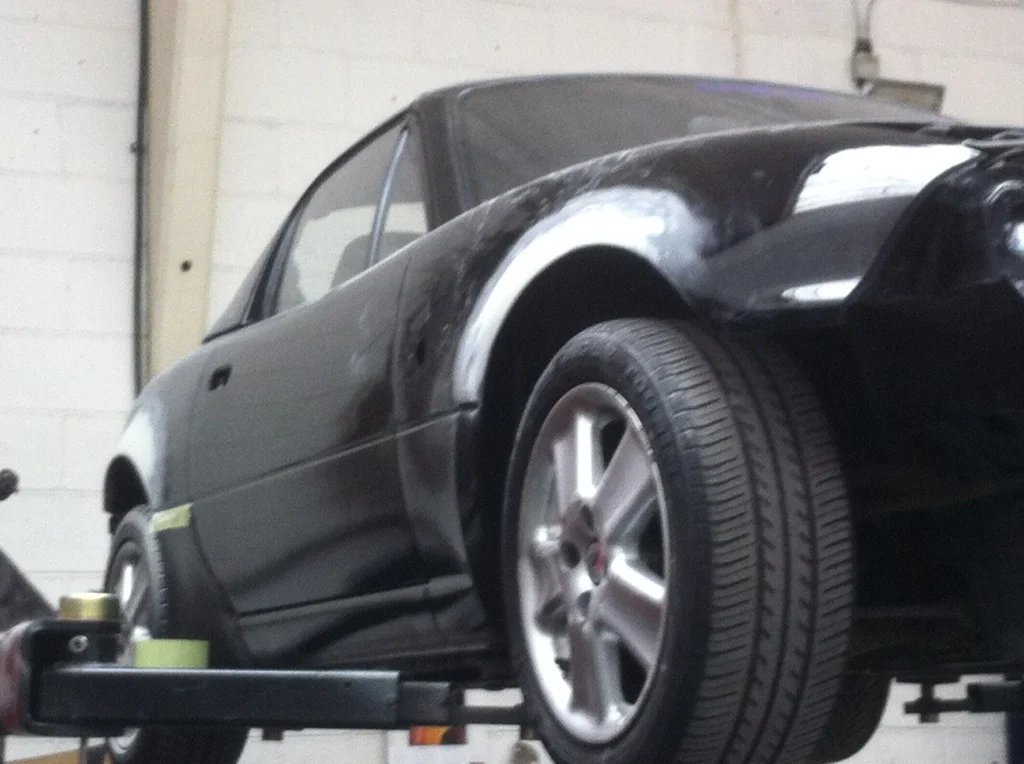

popped to the body shop today just to check how they are getting on :D

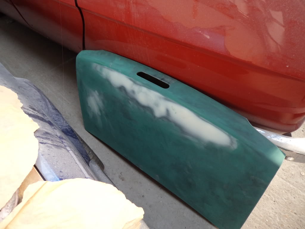

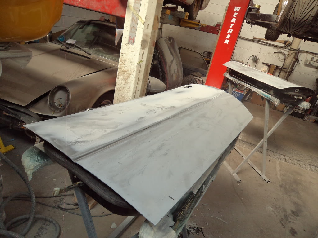

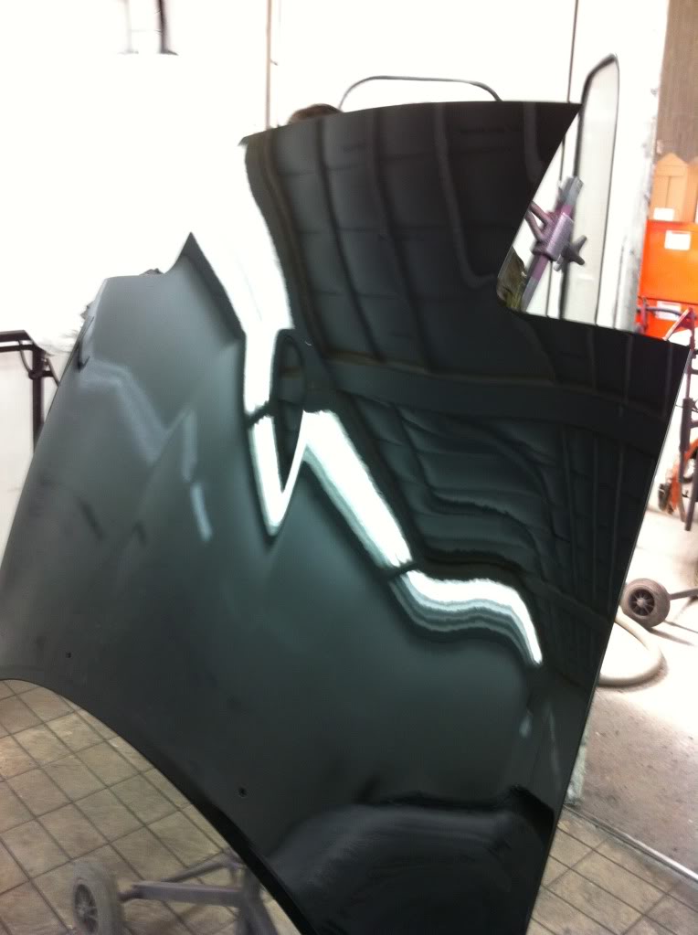

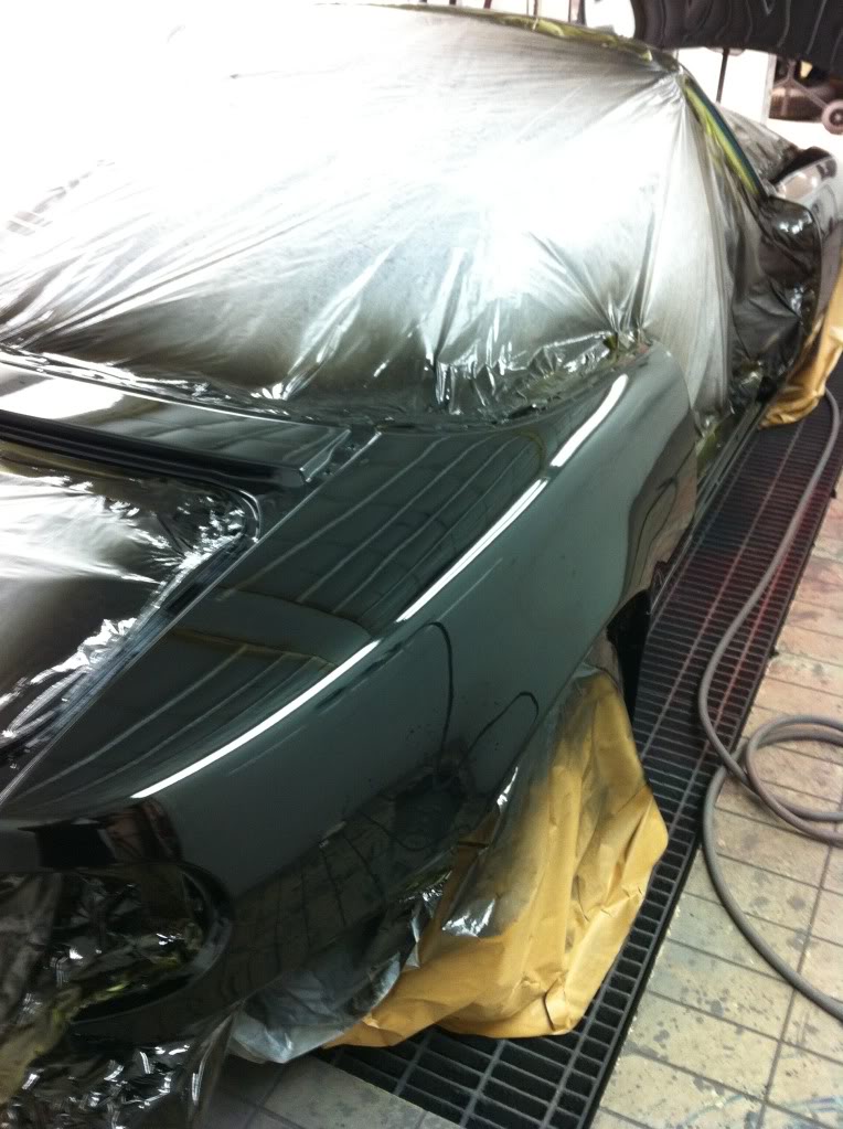

:eek: i now have super smooth arches all round :D had a few little issues with the rubbish boot lid i had so took a trip to the scrap yard and picked up a really good one.
more pictures will follow thanks to the body shop this is just a little iphone picture
  Disastra Coupe
Black again? I thought you were going for a completely different colour... Nice though, can't beat a a fresh coat of good paint!
Adz
  Work van
yup black again, thought it would be best to keep the colour oem as it makes life in the furture a whole load easier ;)

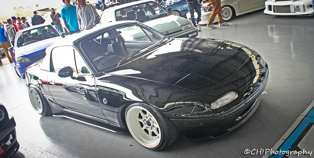

Forgive me for being 'un-scene' but how does it drive like that?
I'd imagine it drives like a dogs dick with the camber that mental and no suspension travel.
I'm not knocking it, because it looks fcuking amazing. I'm just curious.
Adz
  Work van
looks can sure be deceiving as this doesnt drive like a dogs dick at all, i would agree with you if i was still running my ta technix but as im running hsd coilovers with monotube dampers, fully adjustable ride height by adjusting the mounting bracket on the damper this means a very wide range of height adjustment is possible without affecting the spring pre-load or the damper stroke length. So whether you want sporty or totally slammed, you still get the full performance of the damper and to top it off 16 Stage damping adjustment :D
so long as you spend money on your suspension going low wont affect it just got to take more care around town ;)

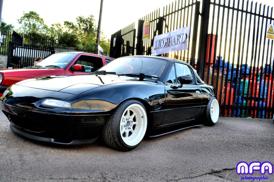

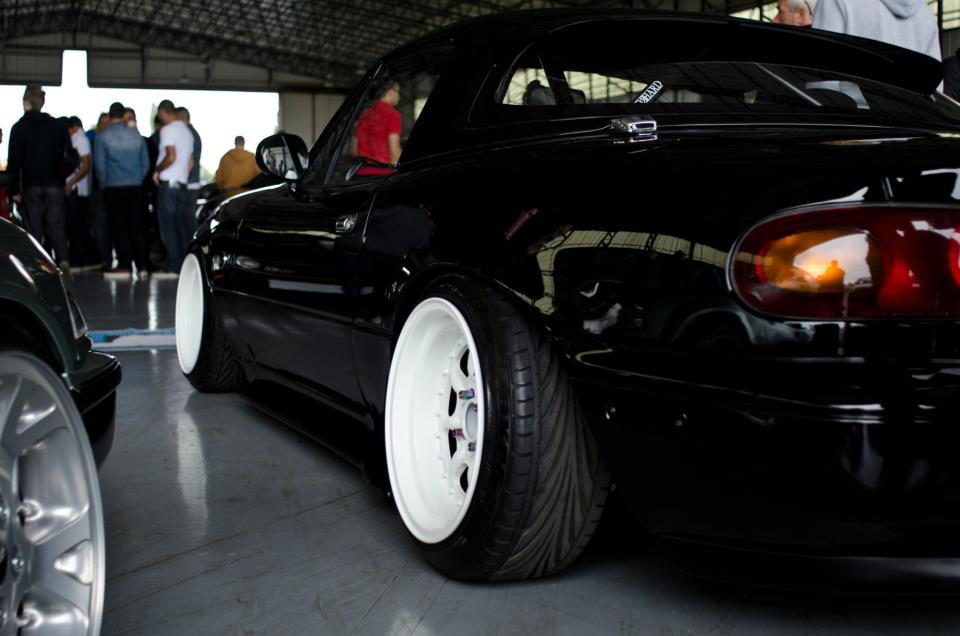

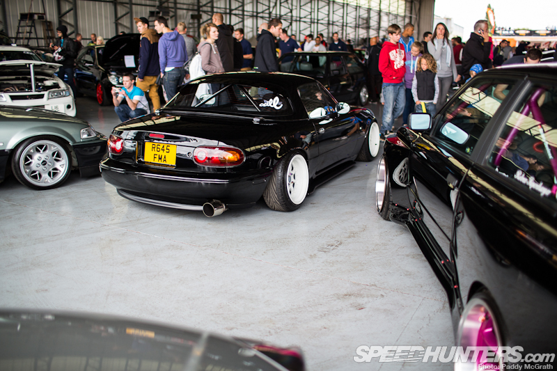

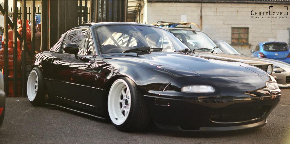

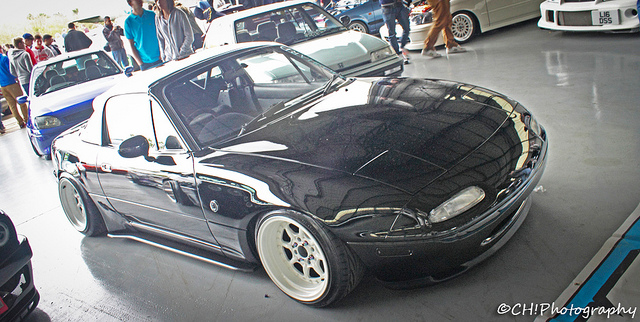

well it has been a bit mad over the last week getting the car ready for our Rollhard Rendezous bbq meet then players 6.0 but all went well :D
check out Ben Gaut | Photography on facebook link below for all the Rollhard Rendezous bbq pictures ....it was quite something :eek:
http://www.facebook.com/events/4722...493066777372306.116050.157772777568376&type=1
few pictures from both events, even made it on to speedhunters :eek:
Hi Adz, its ben i bought your clio off you remember? just thought id have a quick look whats going on and i must say when i saw the mx5 back in february there has been a few changes! the car looks great. You going to sell me this one aswell? lemme know you still have my number? obviously when u plan on getting rid
