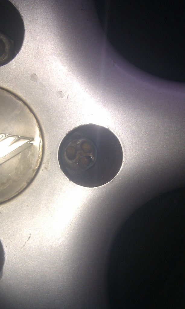

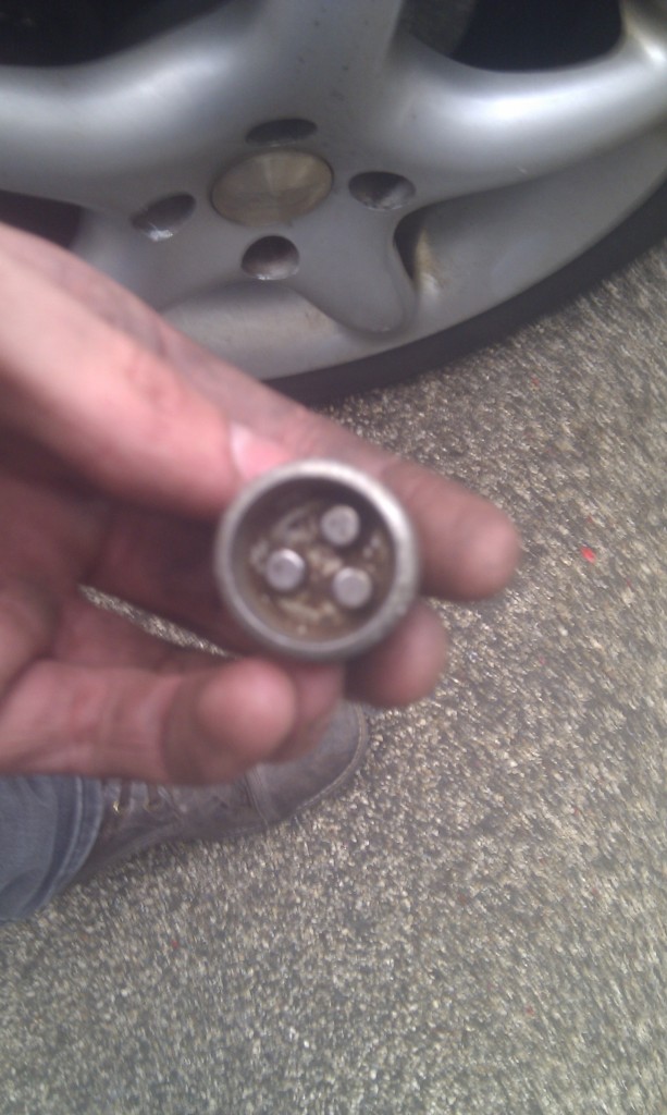

As you can see - it's just completely f**ked. Can't get a grip on it - the wrench ends up coming out towards you and so it's just rounding more and more.
This is meant to fit:
Any ideas on how the f**k to get it off?
I absolutely hate these nuts. They're s**te.
It's got like a sleeve on the outside of the actual nut that just spins round - plus there's f**k all space inside the hole. I know what you mean, but the nut itself is just round - not nut shaped.. if you see what I mean? lol
Ah f**k, spinning sleeves are a t**t. You need the other kind of locking nut remover. It has a metal insert that moulds to the lock pattern with a bit of persuasion, then you use an impact drive to shock it out.
Whoever invented anti-theft bolts needs f**king shooting - they're all made out of cheese and never work properly.
I'm going to buy a set of new nuts and just destroy the f**ker.
I don't really know what else to do. I'm not buying stuff if it might not work.. just going to buy 16x new open ended nuts - like it should have - and take it somewhere where they can get it out. CBA!

When that happened on my 1.2, I went to a garage and they got a MASSIVE breaker bar out and worked straight away.
Hello coilovers :D
Yeah, I bought a 24" breaker bar from Halfords tonight - it's not getting it undone that's the issue, it's trying to force the socket into the nut so it doesn't move whilst turning it - nigh on impossible. I'll get it sorted though! I'll pay a visit to the wheel specialists tomorrow like Gaz suggested - see if they can help me out.

That locking nut should work on that bolt on there.
Just needs a lot of pressure on it, it's obviously already warped, but if you press hard enough on the bar as you try to turn it, it should be fine.

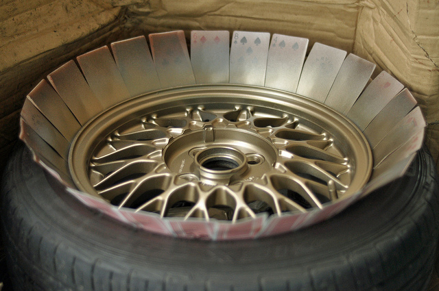

Nice idea with the playing cards BTW.
I think what's happened is the holes that the socket go into have sloped outwards as they've been damaged - so if you put any sort of pressure turning them (which you have to apply lots due to being over-tightened), the wrench naturally comes out towards you. Other than using a clamp which I don't have, I'm not sure how to get enough force pressed onto it - and just trying by hand is probably going to make it worse. Just going to let a big manly chap with oil covered hands have a go at it; I'm far too weak :(

You'll just continually f**k up the locking nut and it's key now it's started being chewed up
This. It's too far gone to just undo it.

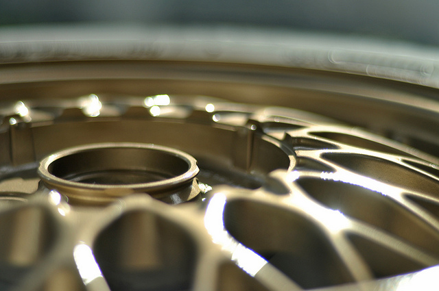

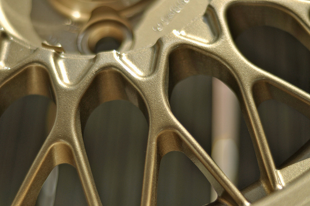

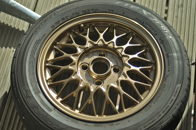

Took a few more pictures of the wheel to try and get across the colour and finish - really really impressed with the Rays Racing Bronze! I think it looks stunning tbh.
BBS Bronze by j0eyD, on Flickr
Finish by j0eyD, on Flickr
Shiny by j0eyD, on Flickr
Finish isn't the best/smoothest, but it's a damn sight better than the rotten old silver that was on it before. Much neater.

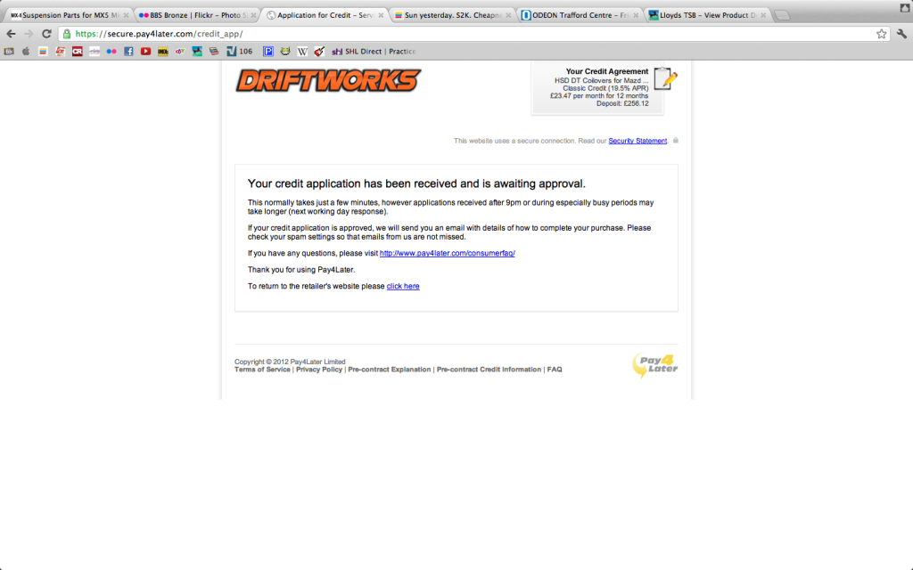

I'm going to wait until tomorrow to speak to them about "payment options". I'm hoping they will accept that I can give them £23 a month for the next 12 months, otherwise I'll have to wait a while longer!
After checking this: http://www.driftworks.com/shop/driftworks_finance_info/
I should qualify quite easily...

Just a idea but either get some chemical metal and chemical metal the locking nut to the bolt (you'd need to play the waiting game till it cures properly, but should/might work), or get a friend to weld another bolt onto the locking nut. Could be tight to weld but it would work.

Space is the only real issue; I can't even fit the standard wheel brace into the nut hole, so trying anything like that may prove tricky...
