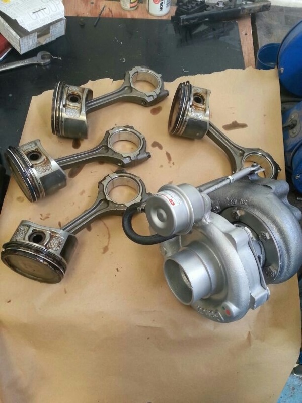

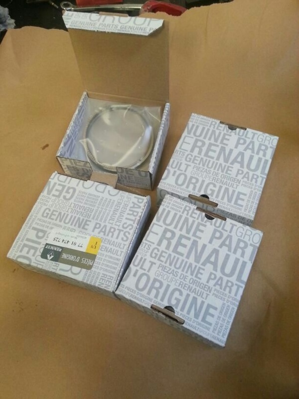

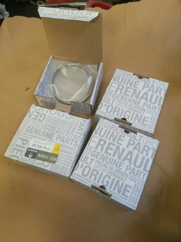

I bought the car as a low pressure turbo 172 cup running a very small amount of boost due to a weak actuator spring. It was rolling roaded at 210bhp, but still went nicely. The car had a PAS leak, and needed a new clutch so I sent it off to Fred @ BTM for the work to be done. Fred had all the manifold down pipe machined for me whilst the car was there as there were a few leaks around these areas and now looks the business. After getting the car back i discovered the turbo needed a rebuild. I spoke with my mate Andyrg who originally built this low pressure turbo conversion and we arranged to get the turbo rebuilt and have it remapped by his trusty mapper Andy Carr (www.teamcarr.net). After a few lengthly conversations we decided it would be rude not to make some adjustments to the internals. We decided on putting a set of F4rt pistons and rods in from a megane 225 in which i bought from Gray on here. This coupled with some brand new genuine renault piston rings, ACL Race bearings, ARP Rod bolts and a newly built GT28RS should give me a fairly safe 300bhp clio.
Once the car was sent up to Andy i had spoke with Chip about the turbo being rebuilt and after him recommeneding Vince @ CR Turbos, Andy whipped the turbo off the car and sent it off to them. I got a call from vince the morning after Andy had sent it and within 24 hours the turbo was stripped, rebuilt, and posted back to me. Absolutely first class customer service!
Next was getting the pistons and rods in. Andy noticed that the piston rings were well used so it was a good job we got some genuine rings from renault to put into the build. As we were going to be running more boost a fuel pump and pressure regulator set up was bought to work along side the new internals. Andy got a new megane headgasket so that the compression was the same as a megane and then had the car road mapped by Andy Carr. Andy put 4-500 miles on the car with a combination of mineral oil to bed things in and 10w 50 oil before having the mapping carried out and giving it full beans. Once the mapping started there were a few issues with getting the ECU to work with the 3 port boost solenoid, so for now Andy has put a manual boost controller on. Once up to temp the actuator spring is struggling to hold boost, so i have spoken with Andyrg again and we are toying with the idea of going with a 1 bar actuator, leave the 3 port boost solenoid and then finish the mapping off on a rolling road for a final figure. The other option is to get a new 7-8psi actuator and then play about with the ECU so that we can control the boost with the throttle like Chip has on his ph1 turbo.

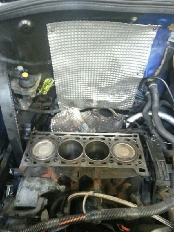

Glad to see my old rods and pistons went to good use! :) I was a little annoyed when stripping the engine down.. previous owner had left it stand with the plugs removed, meaning the elements had got inside and made things rusty.

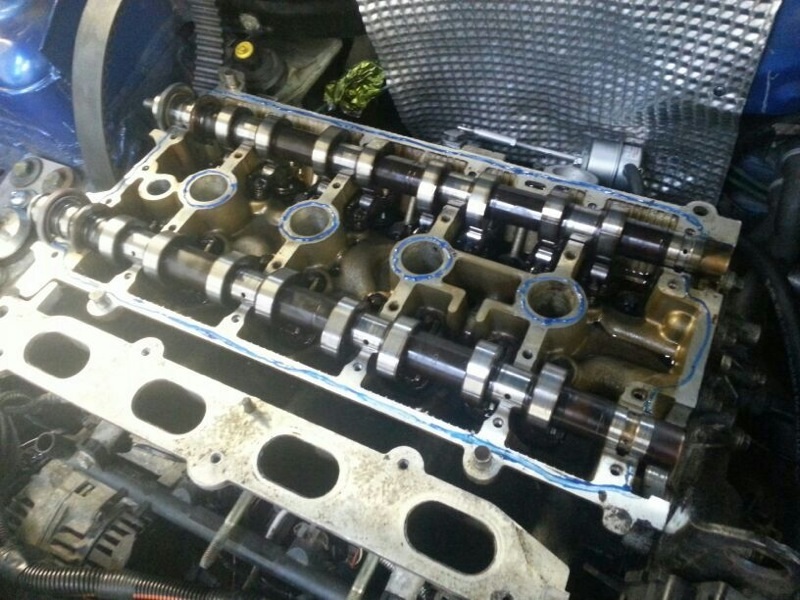

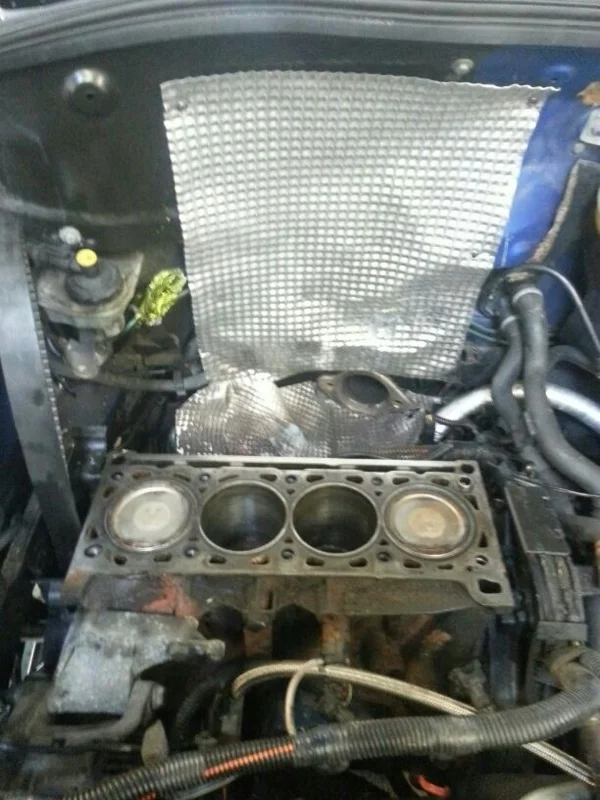

Few pics from the build...
Nice newly built shiney turbo and F4rt pistons n rods ready for installation

The dephaser is still on this jusy switched off and unplugged. We are fitting and Andyrg modded inlet pully once the cars ran in and all ossues have been ironed out.
