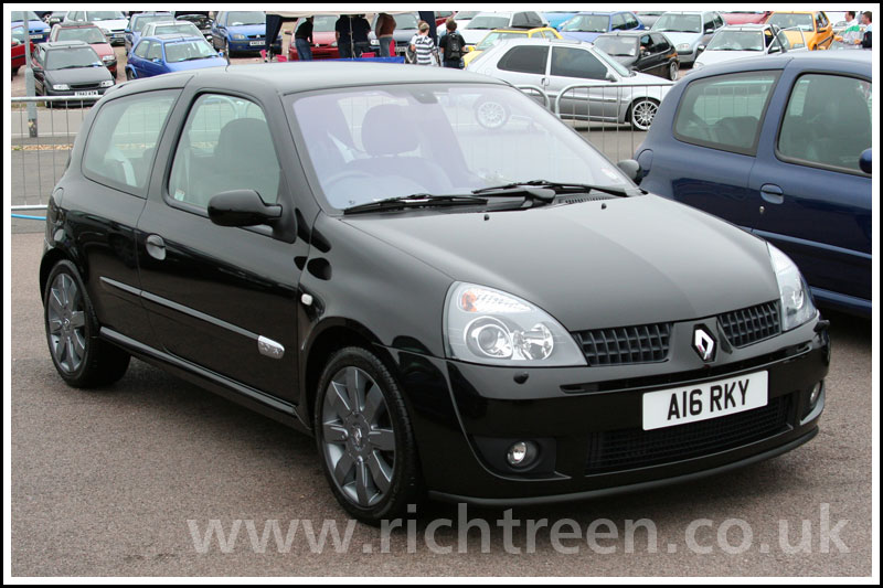

Only just noticed this: 5th picture down there's a silver clio in the background. Looks like someone has lifted the rear off the ground????
