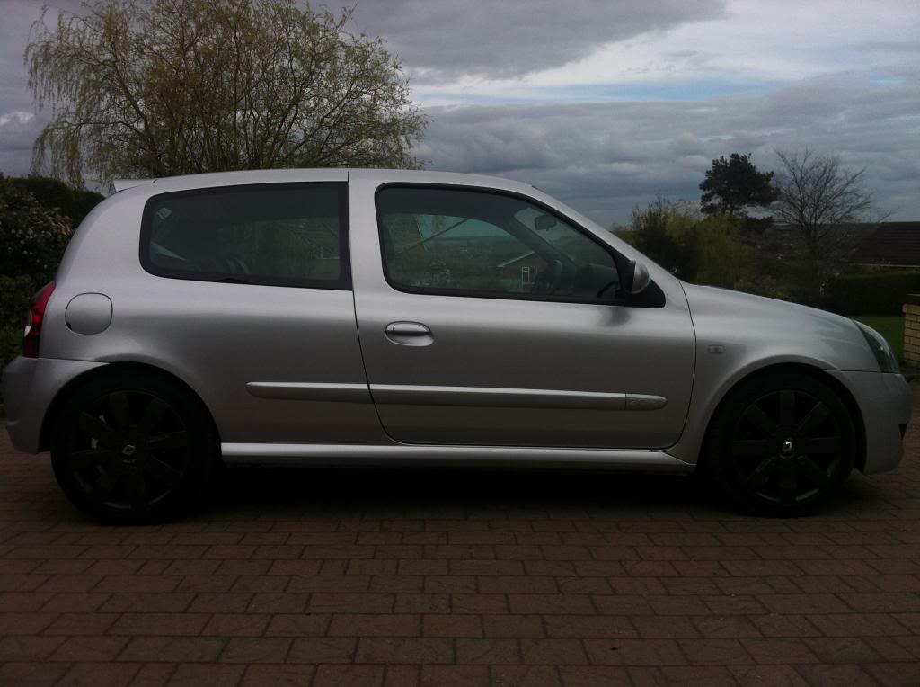

My very first project and very first decent car ive owned too lol!. Here goes

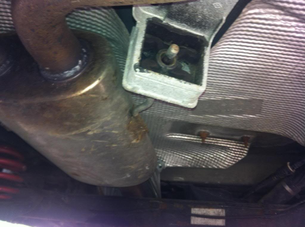

No idea what exhaust this is, looks like a full system to me but only uses 1 back box? Surely thats not right but change is a must :)

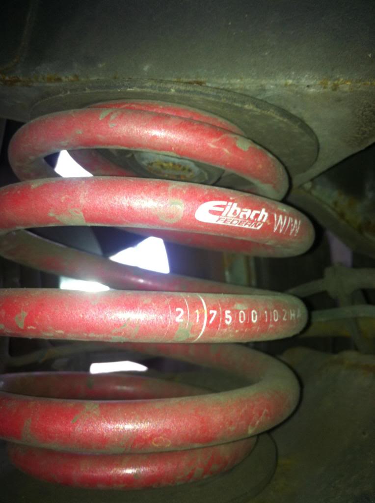

Eibach springs, now not sure how much they lower by. All i know is they aint very comfy tbh!
Massive gap!
Will be getting coilovers im pretty certain as im not happy with the height or the ride.

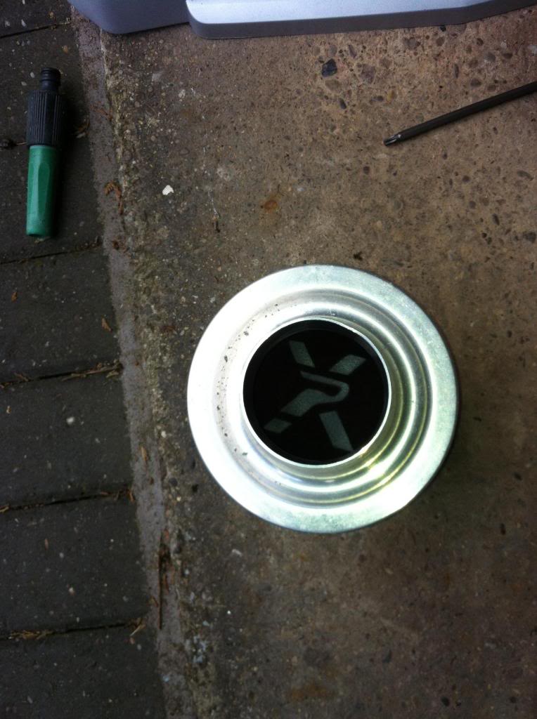

This air filter came with and im pretty SURE that its a piper viper but with no cold air feed. What you reckon?

I had eibach sportlines and thought they was very comfortable. Not sure what exhaust that is but it looks like a custom one. I actually like the tailpipes though :o
I also had a pipercross viper. Imo the best is standard with a panel filter. Have a search though as its been covered many times.

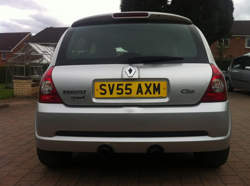

Your missing a front spitter so have you got a 182 with cup packs or a normal 182 with a cup rear spoiler? Reason I ask is if your thing of getting coilovers, cup packs have a different bolt spacing to normal 182s.

Well im comparing the ride to my old fiesta i had with CHEAP apex springs and the original old dampers and it feels almost the same to me tbh! Shame but i want lower anyway so its no matter.
Its a nice intake and i like it but i don think its a keeper, why do you say the panel is the best? Fact or opinion :P
Im still stumped also im not sure about the packs. Should it say this on any documents i will have for it?.. I havent noticed anything.
But i know its got the anthracite wheels and the spoiler. Maybe the splitter was taken off who knows.
Well one way to tell for sure is measure the hub bolt spacing. 54mm - non cup, 60mm cup & cup packs. Think it just says 182 on the docs but I'm not 100%.
Me personally I've had the viper, open filter and various other and find that the standard airbox with panel filter works best. Probably all placebo though!
The good thing is that sportlines normally sell quite well on here £60-80 depending on condition, sometimes more.

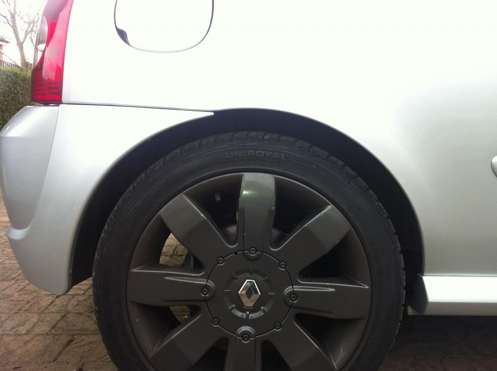

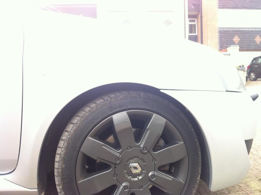

Can somebody recognize the colour of my alloys here? As i like them but im considering a full repaint to anthracite like Lawro had.
