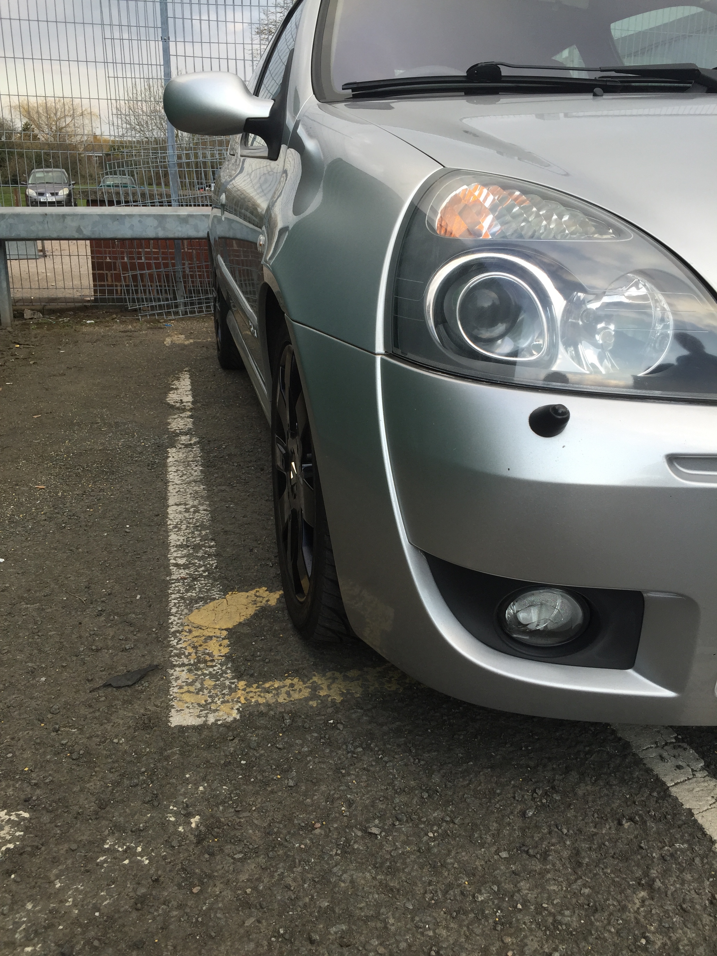

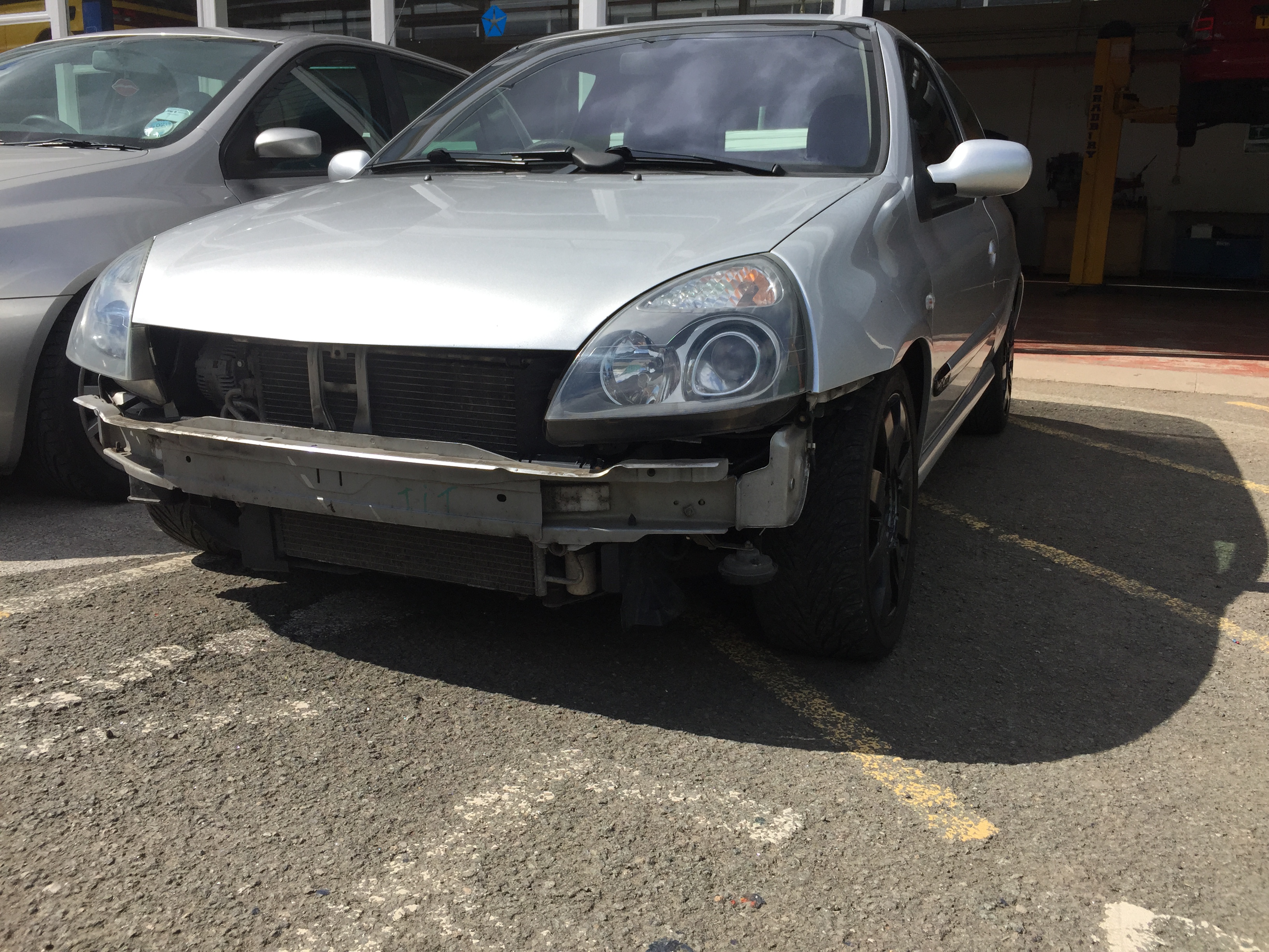

When i got the car back home :smile: i got the headlights sorted as they were cloudy. They look so much better really happy with the results.

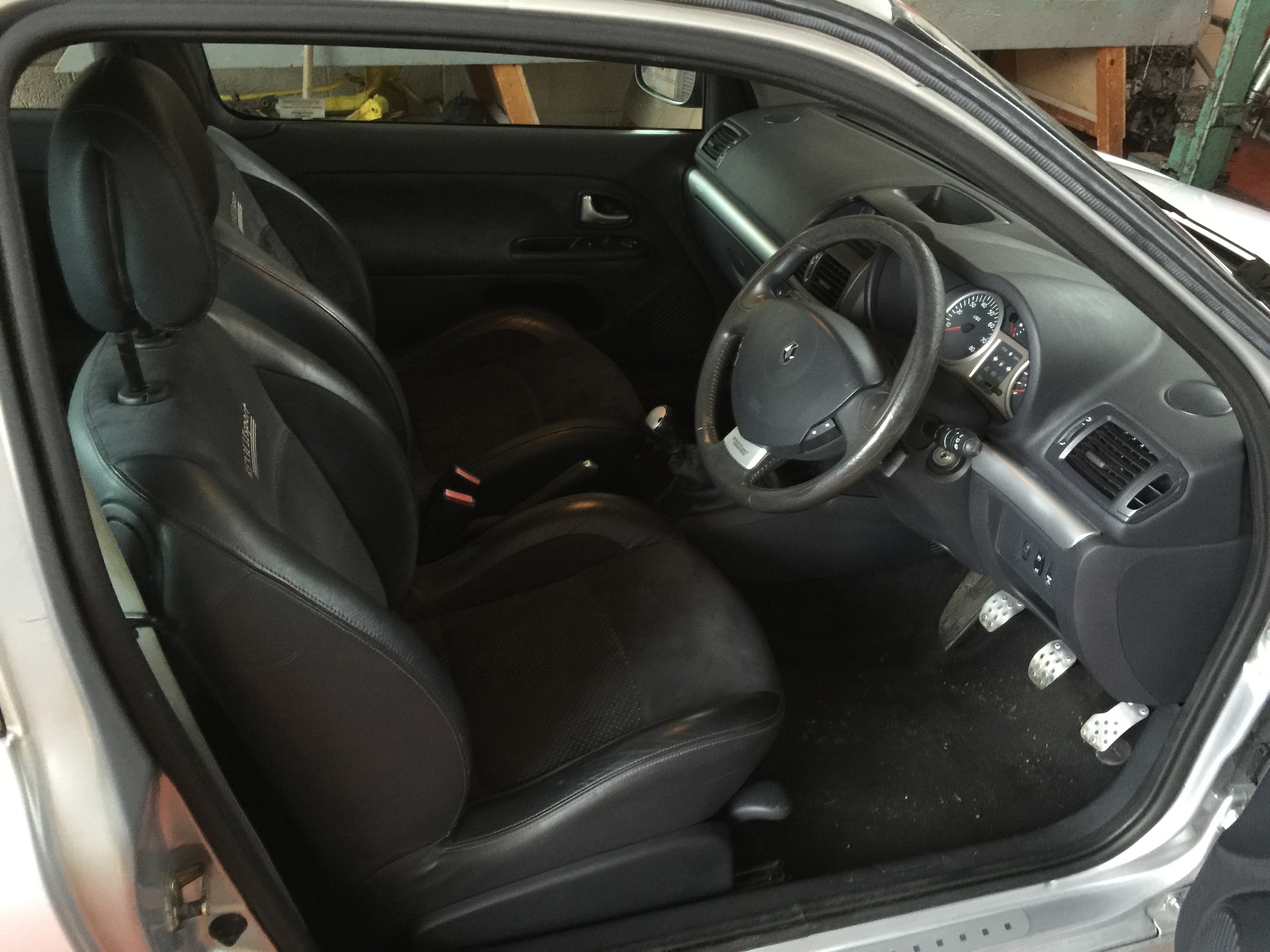

The interior was really nice shame it will all come out lol.

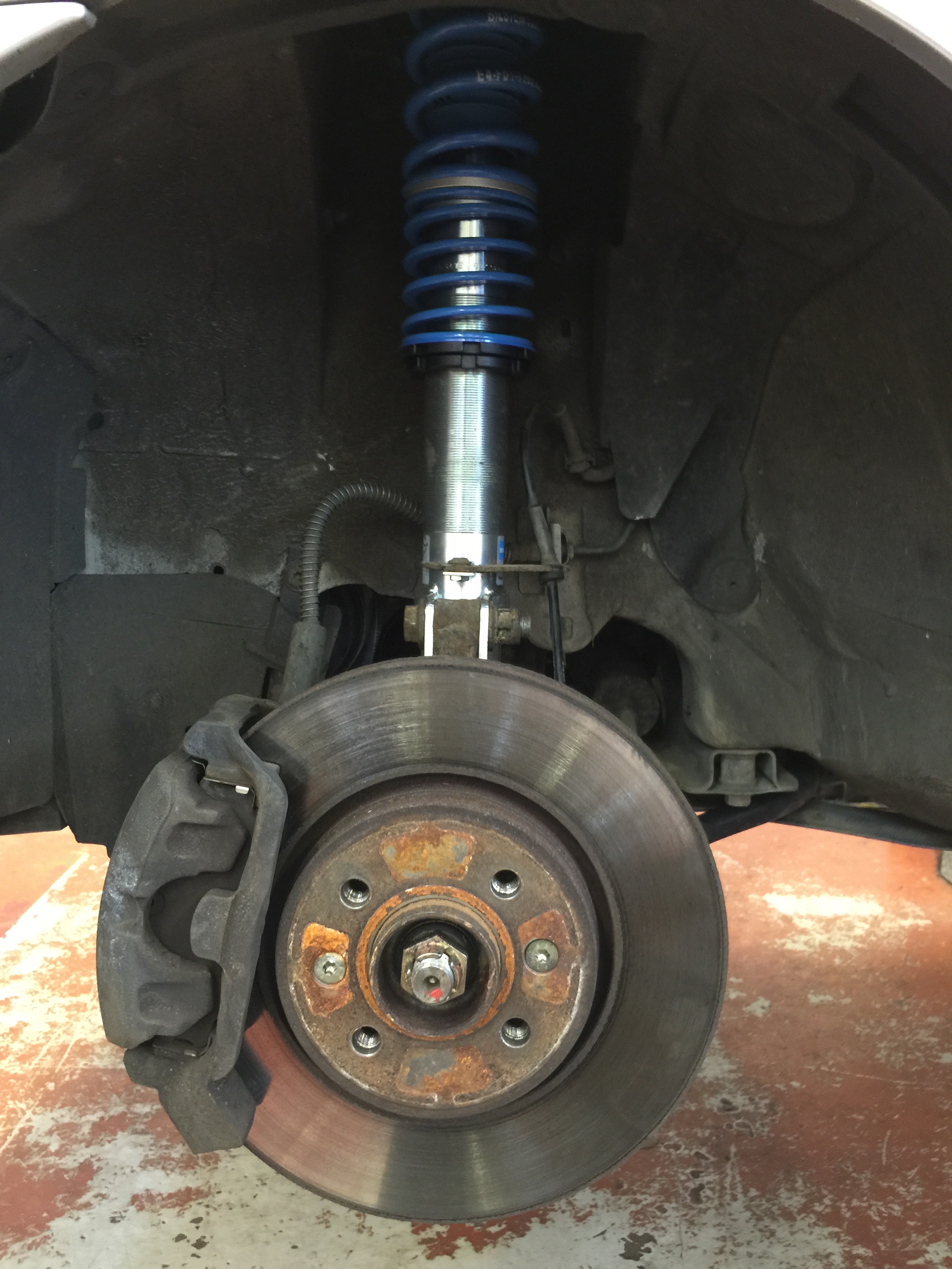

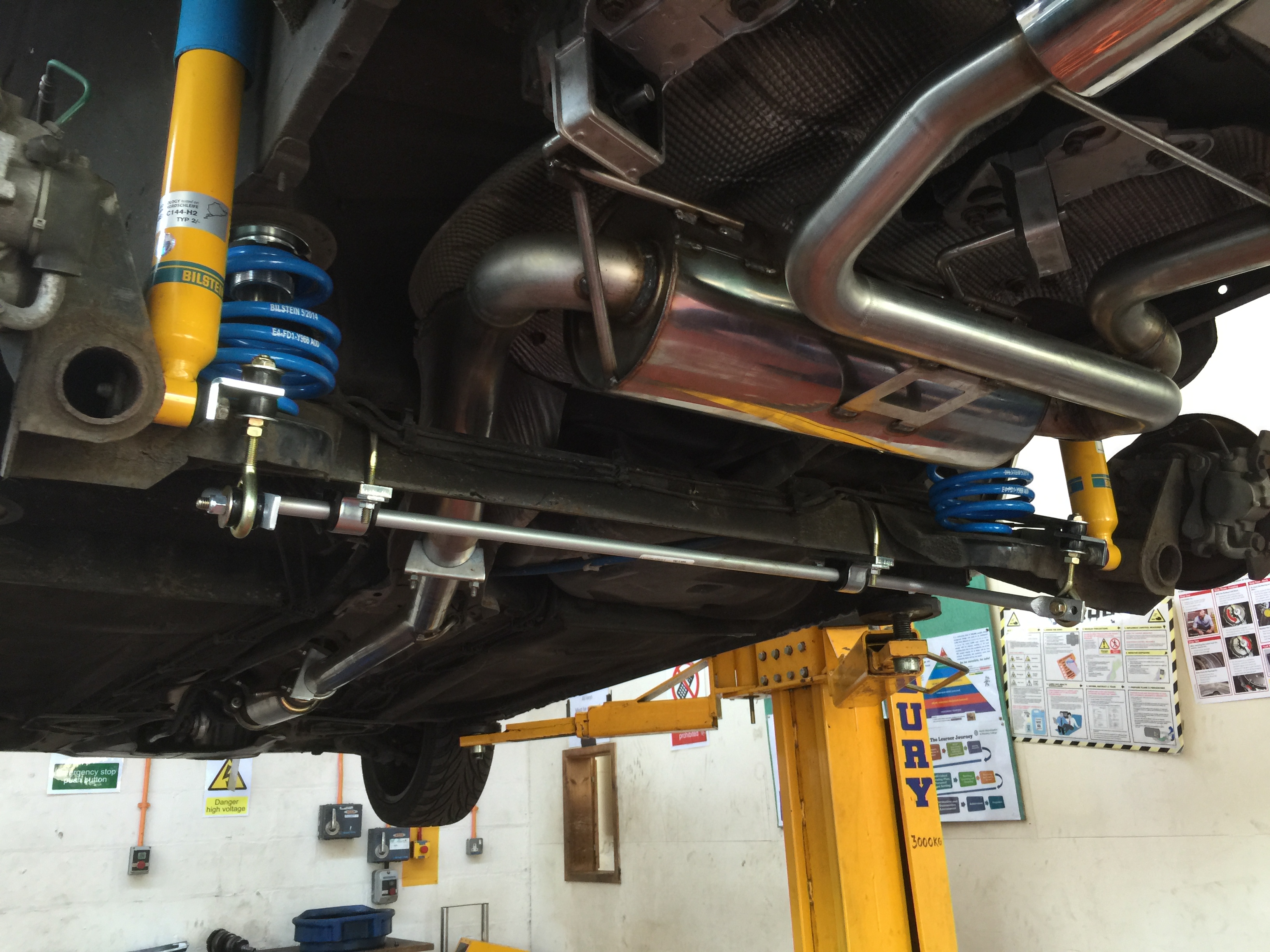

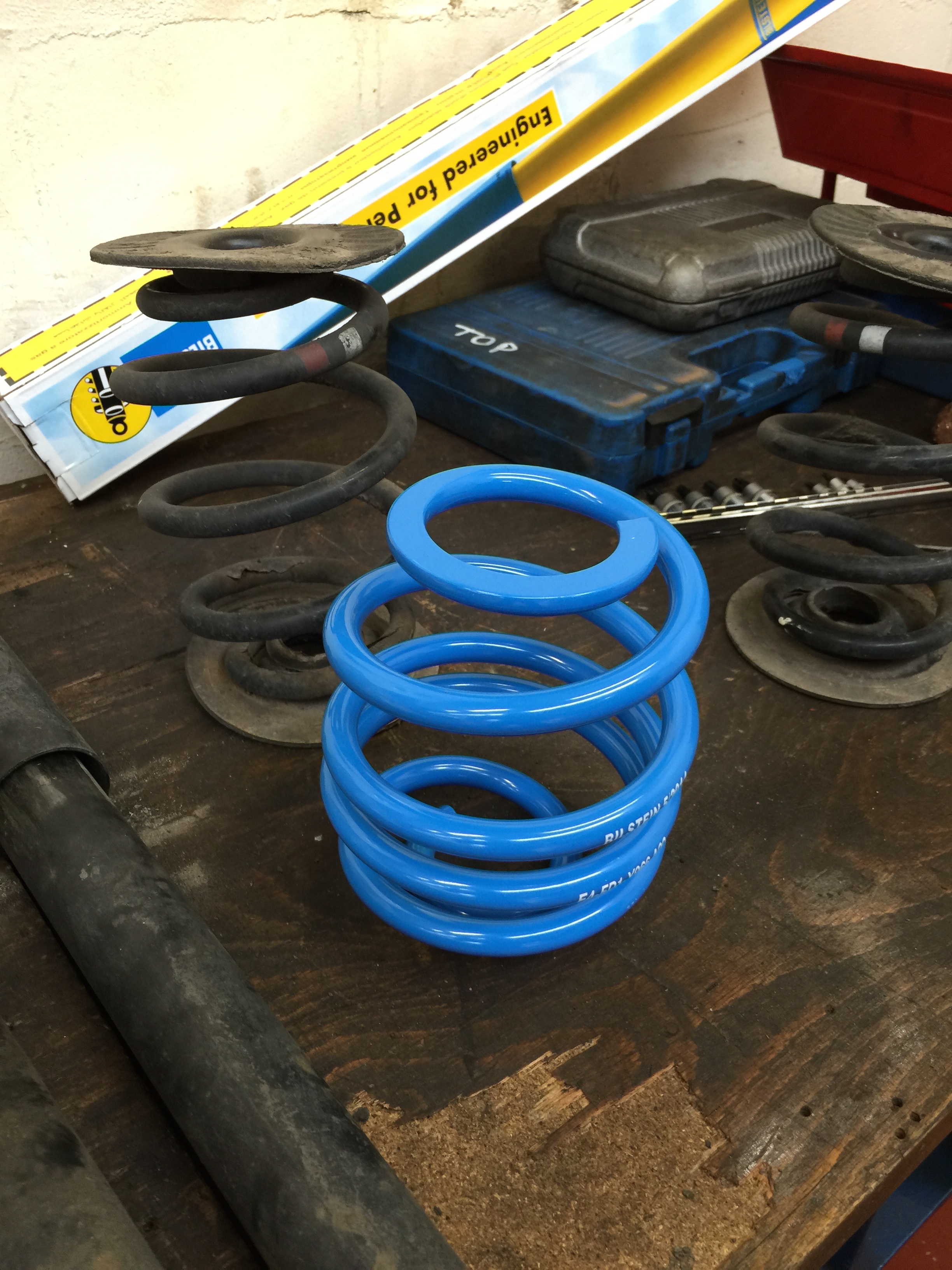

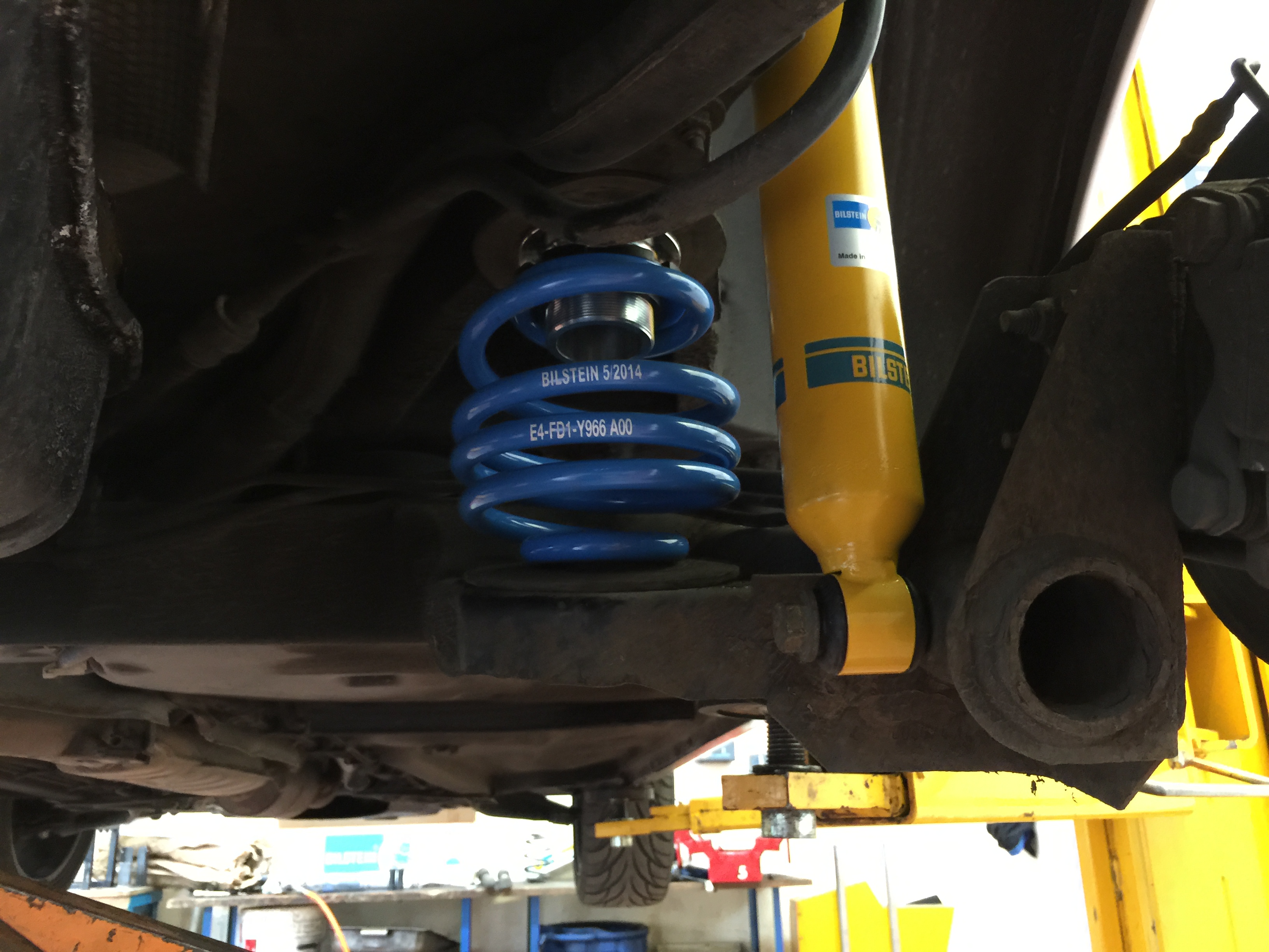

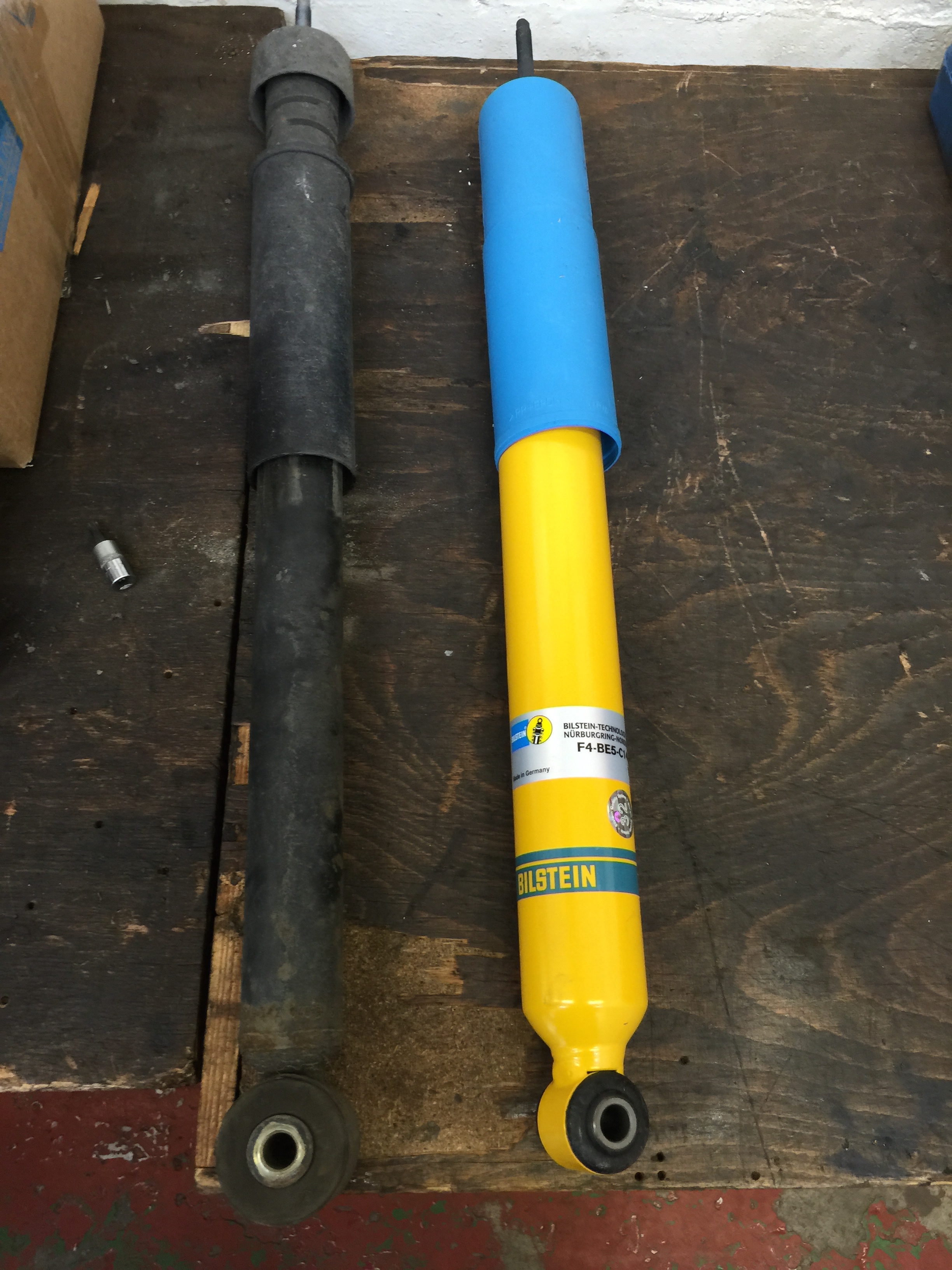

The first change to the car is the suspension i have gone for Blistein B14 from DS Motorsport :) really happy with them I would 100% recommend them to anyone. DS Motorsport was amazing sorting these out for me and would recommend them to anyone.

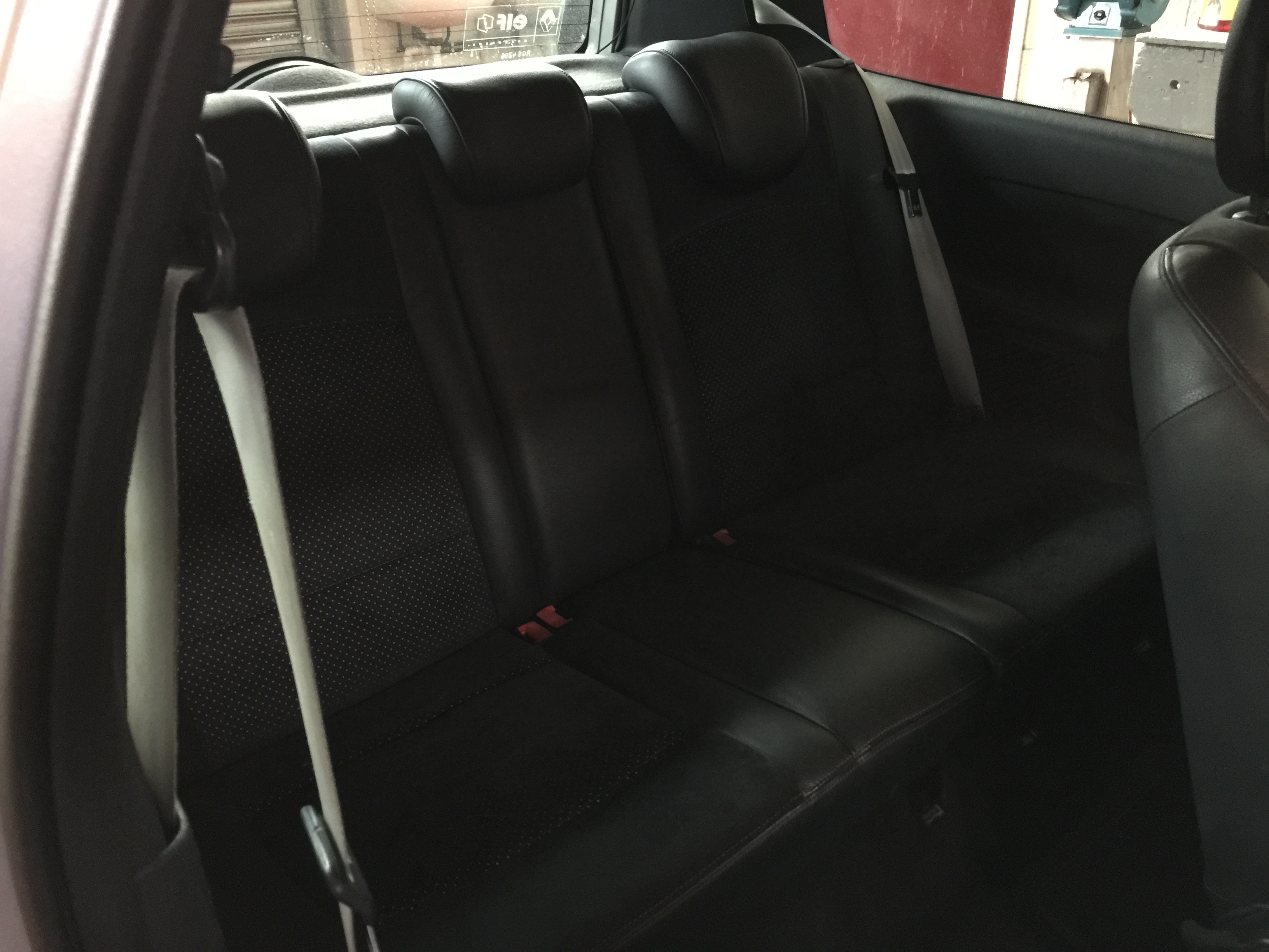

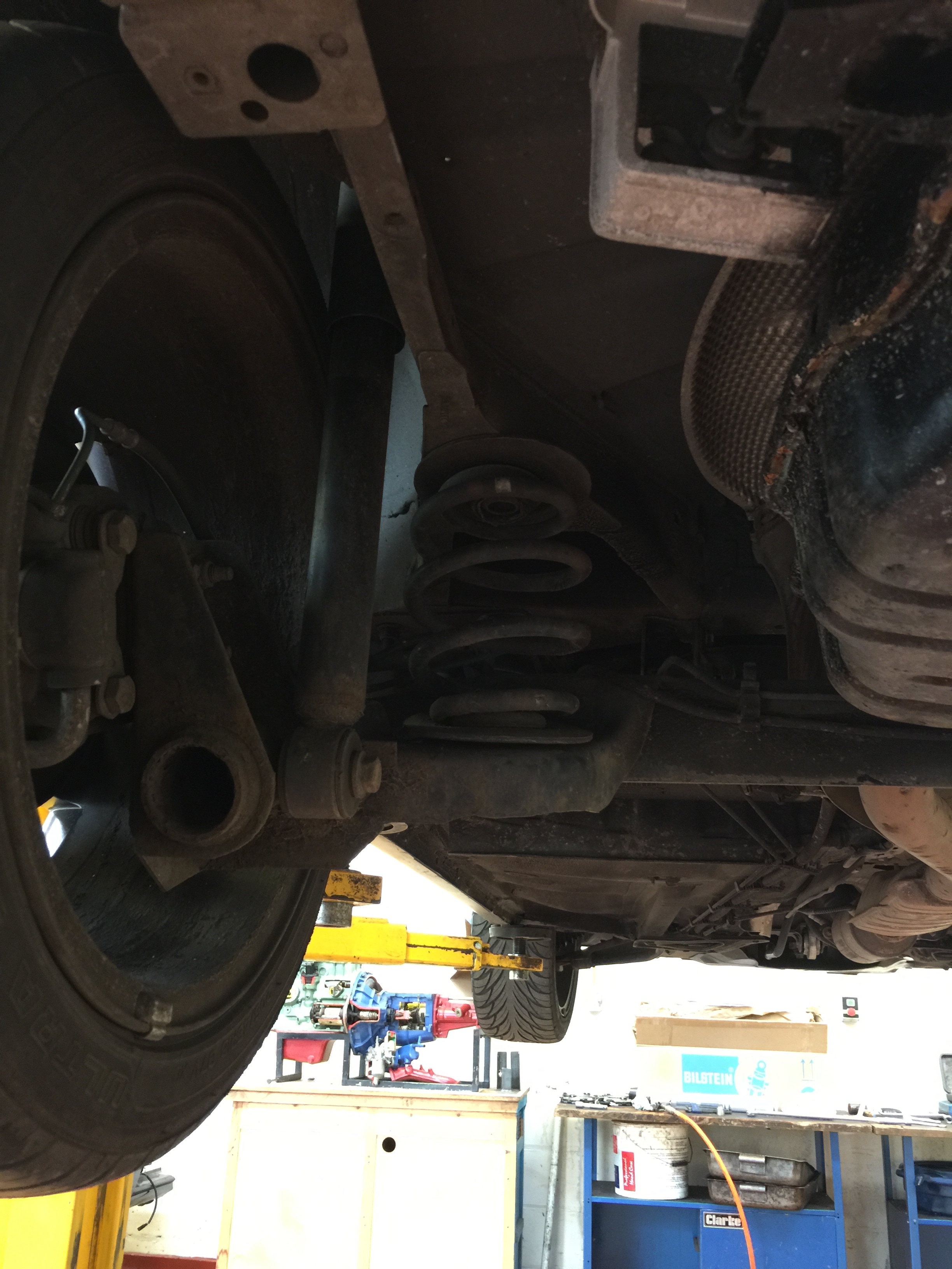

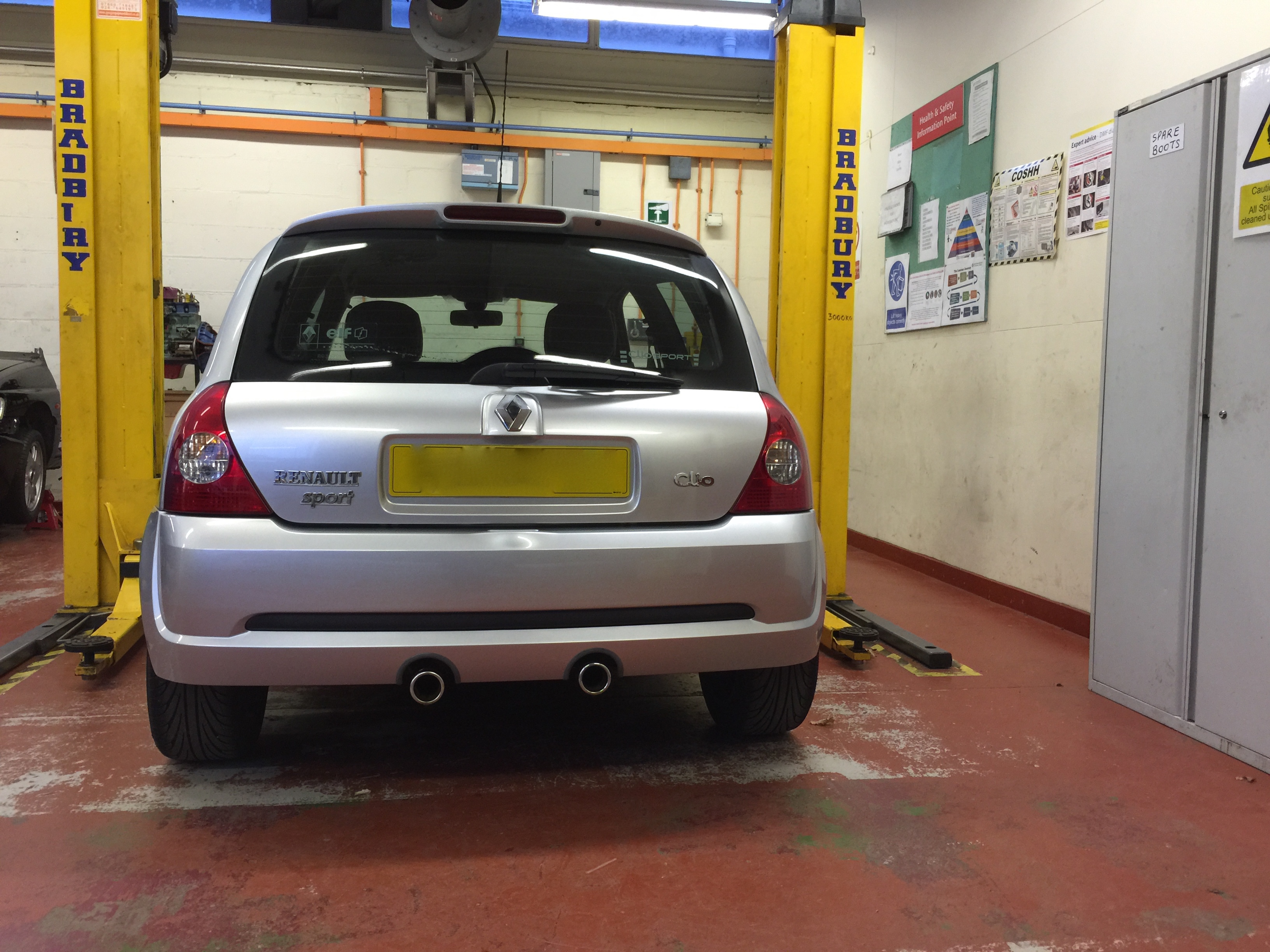

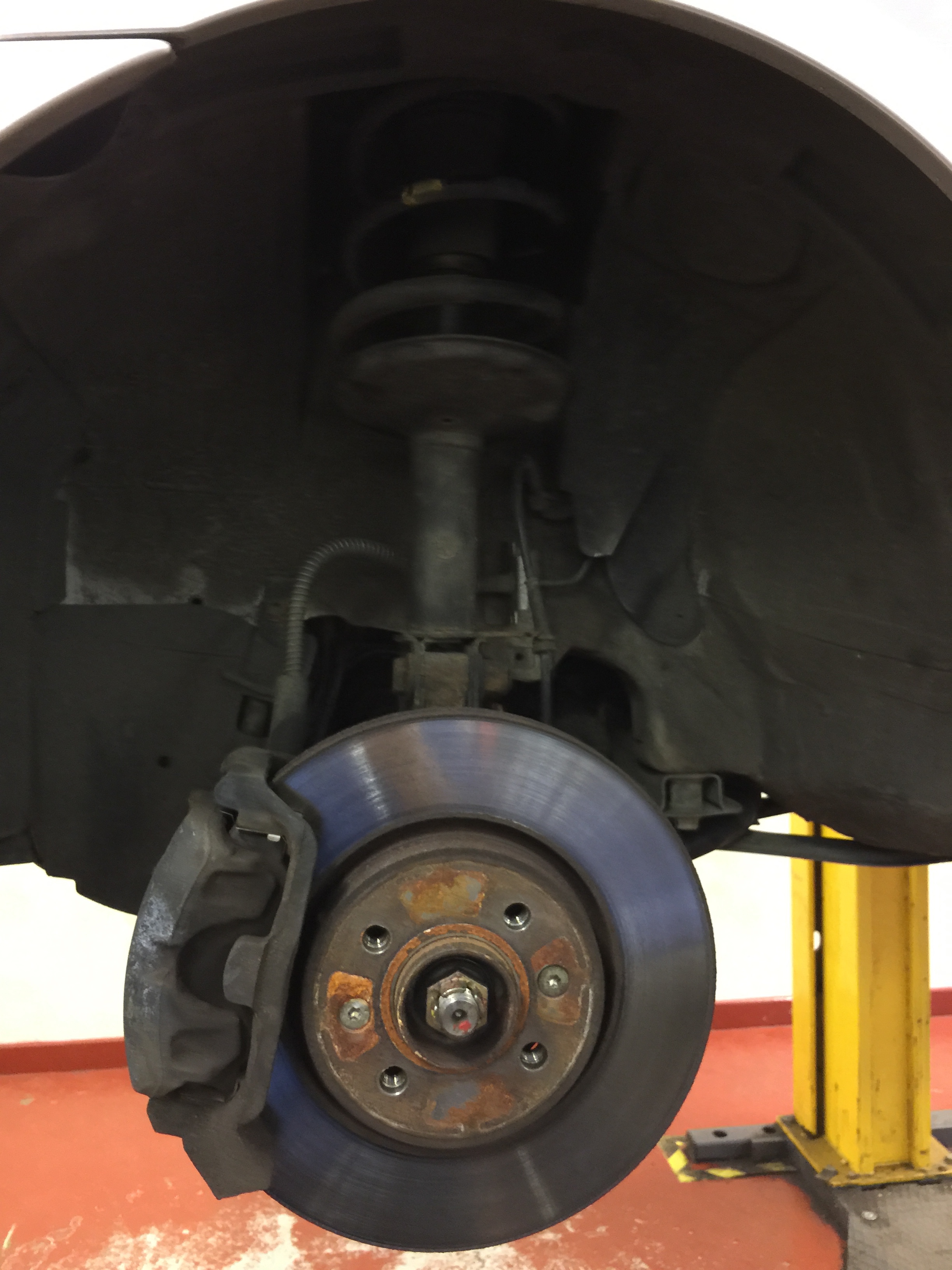

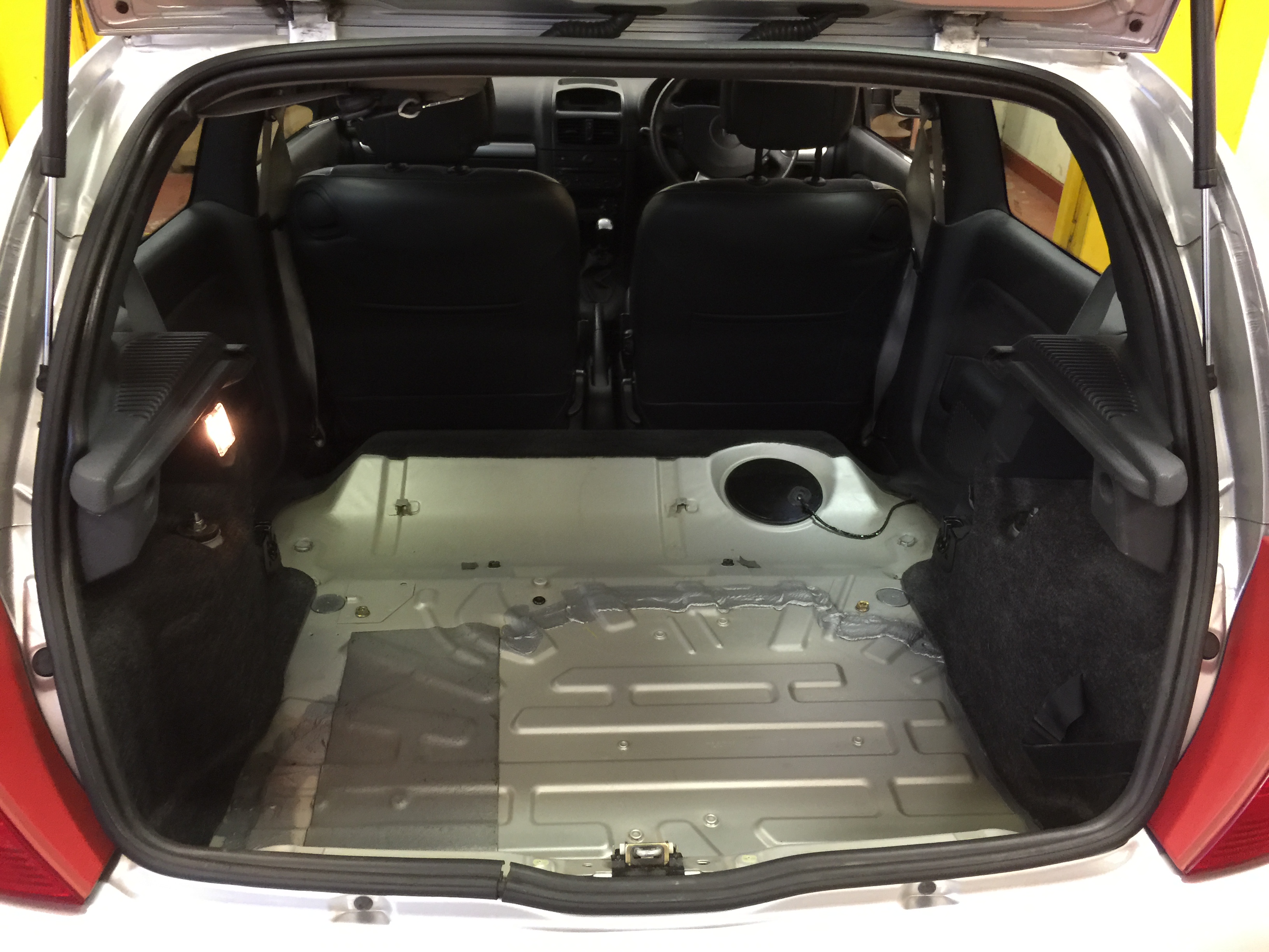

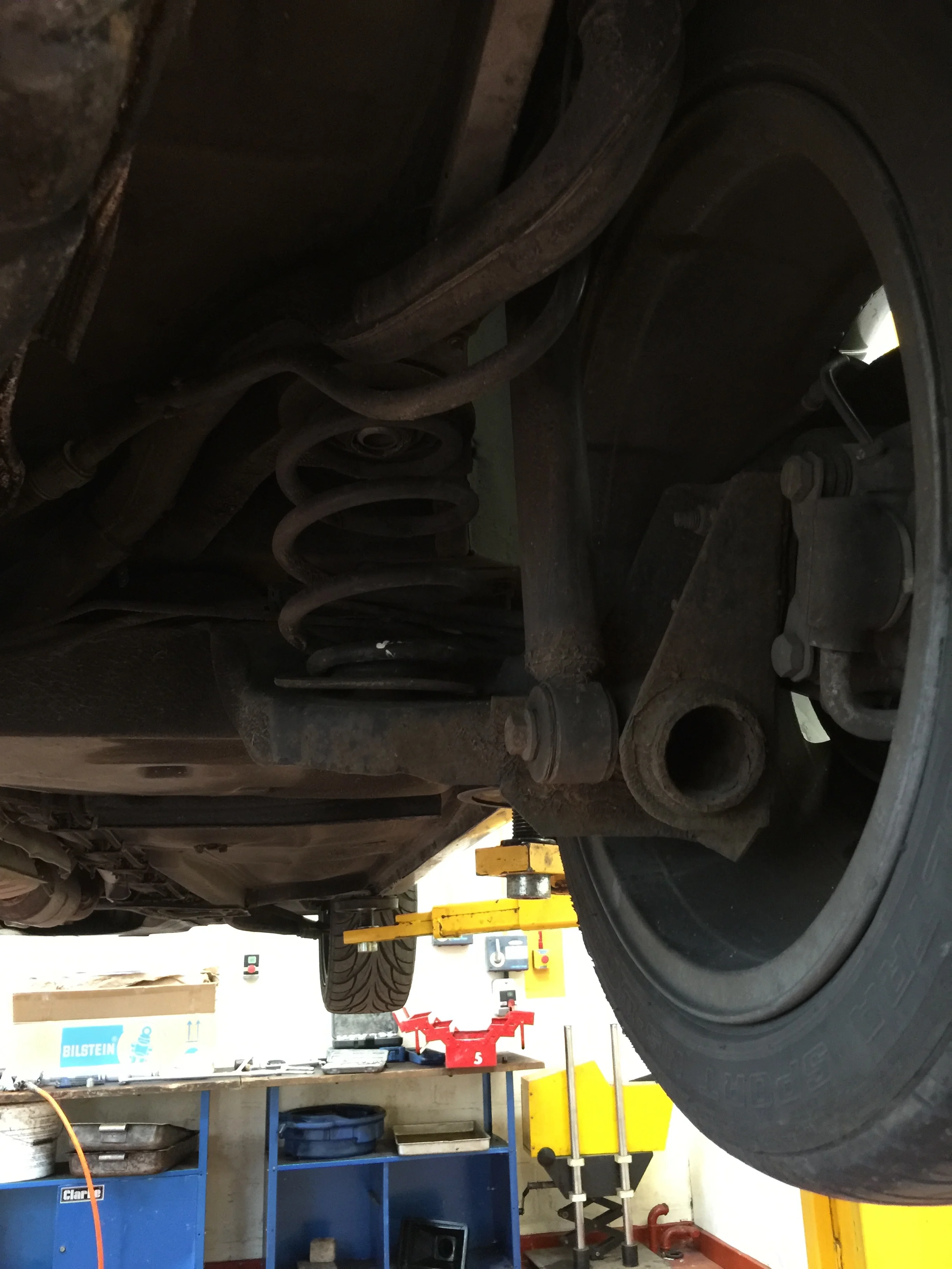

The car before i changed the suspension. I also had removed the rear seat before putting the new suspension on as well.

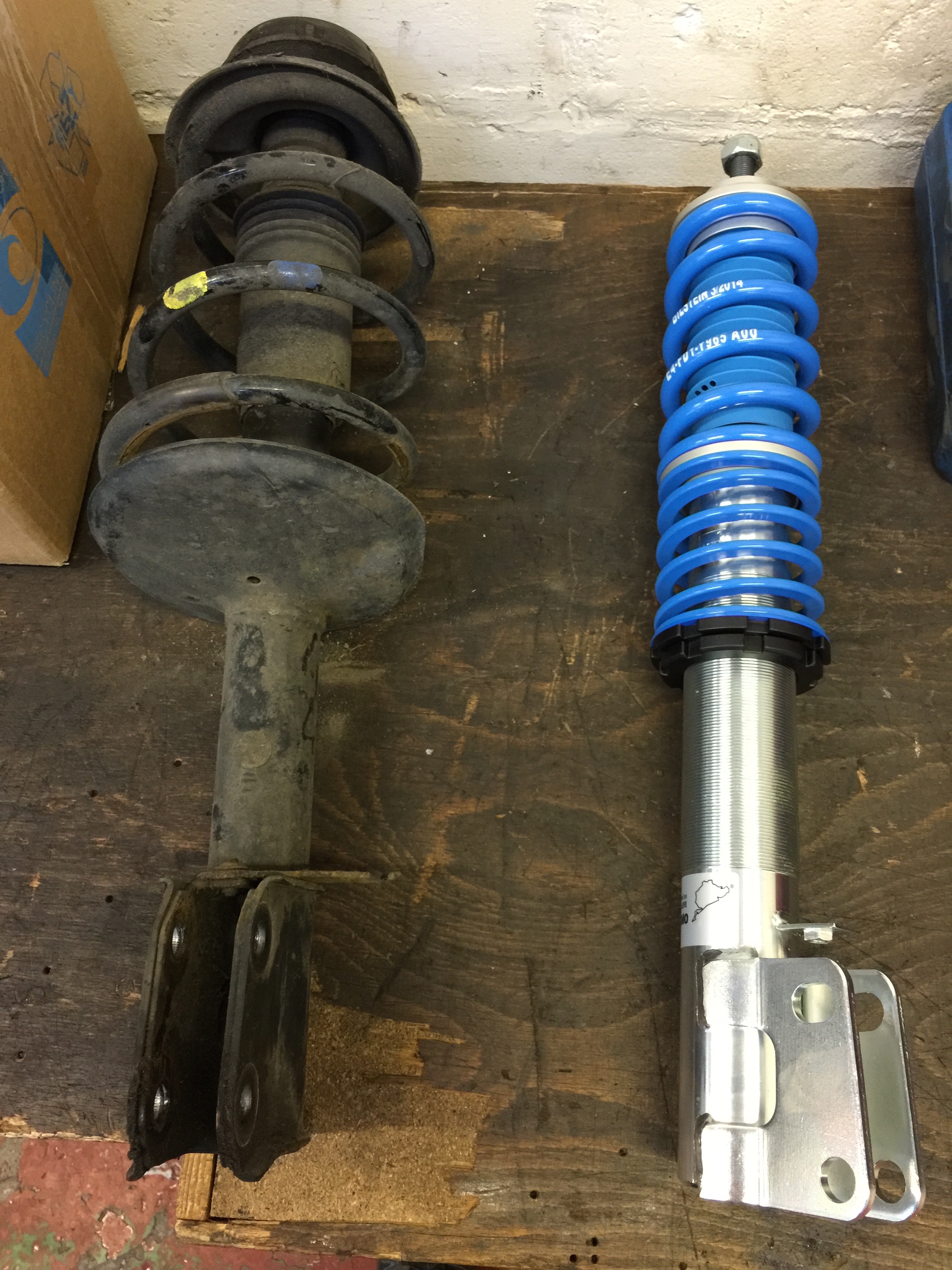

The before and after of the suspension. It was a nice job to do bar the allen key hole cracking on me (old suspension) forcing me to use an air gun and scrapping a good strut.

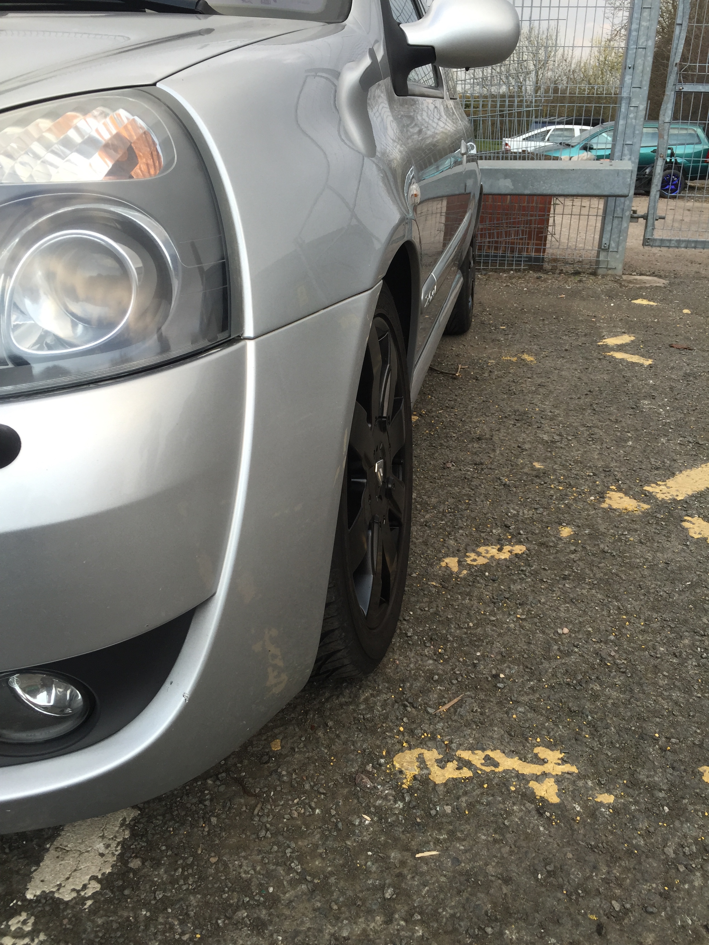

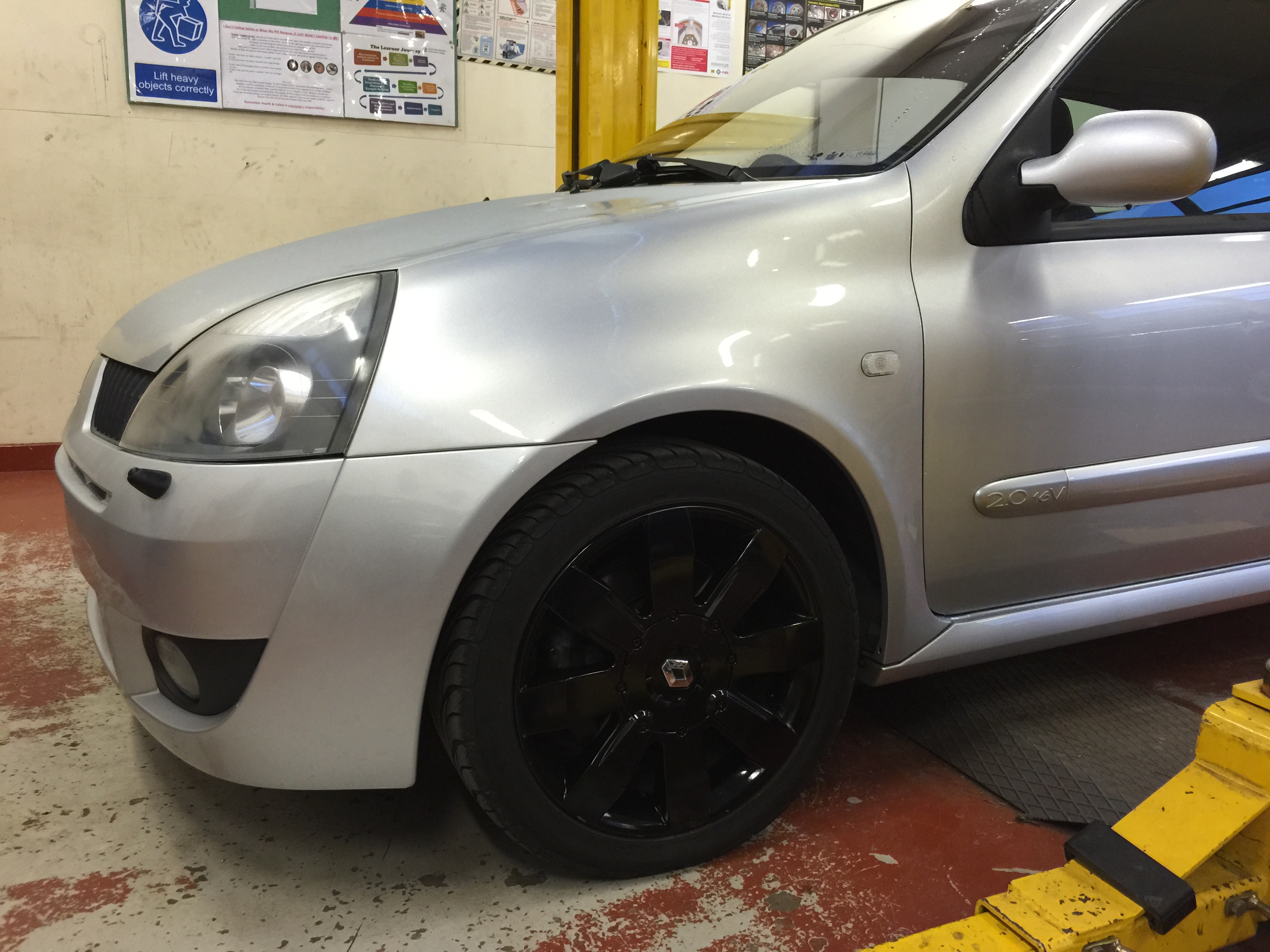

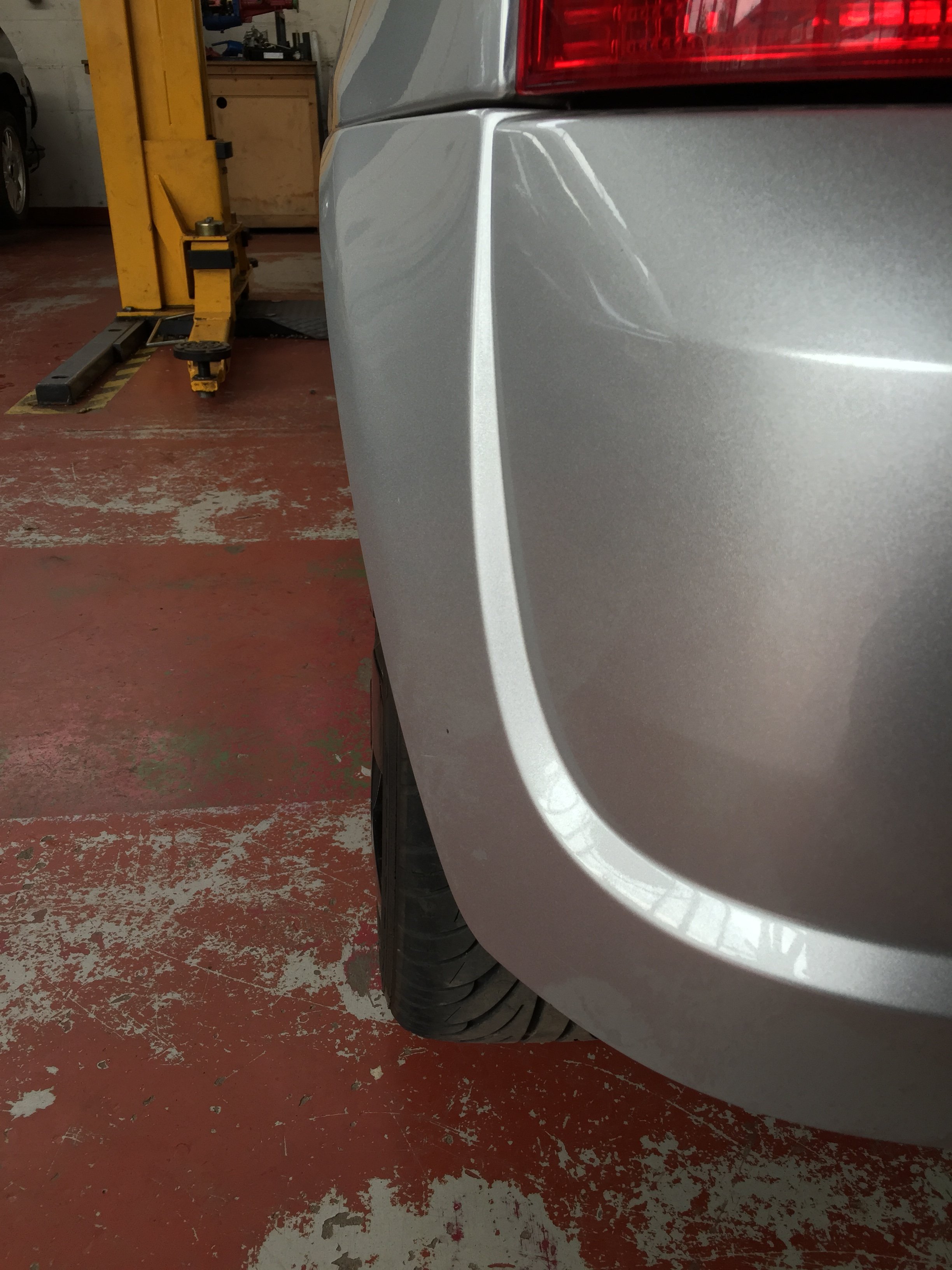

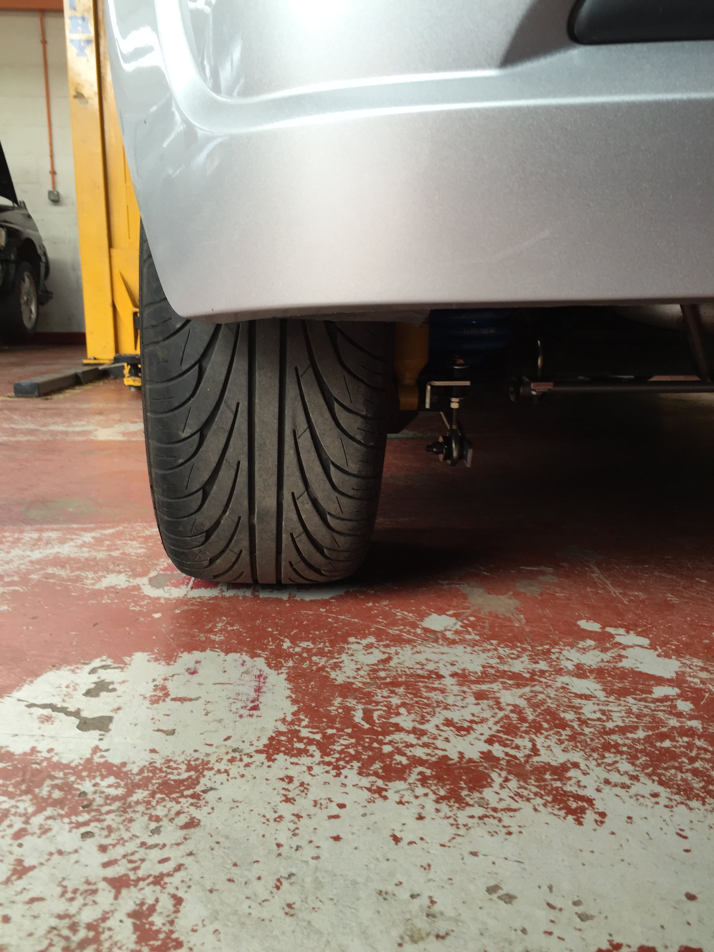

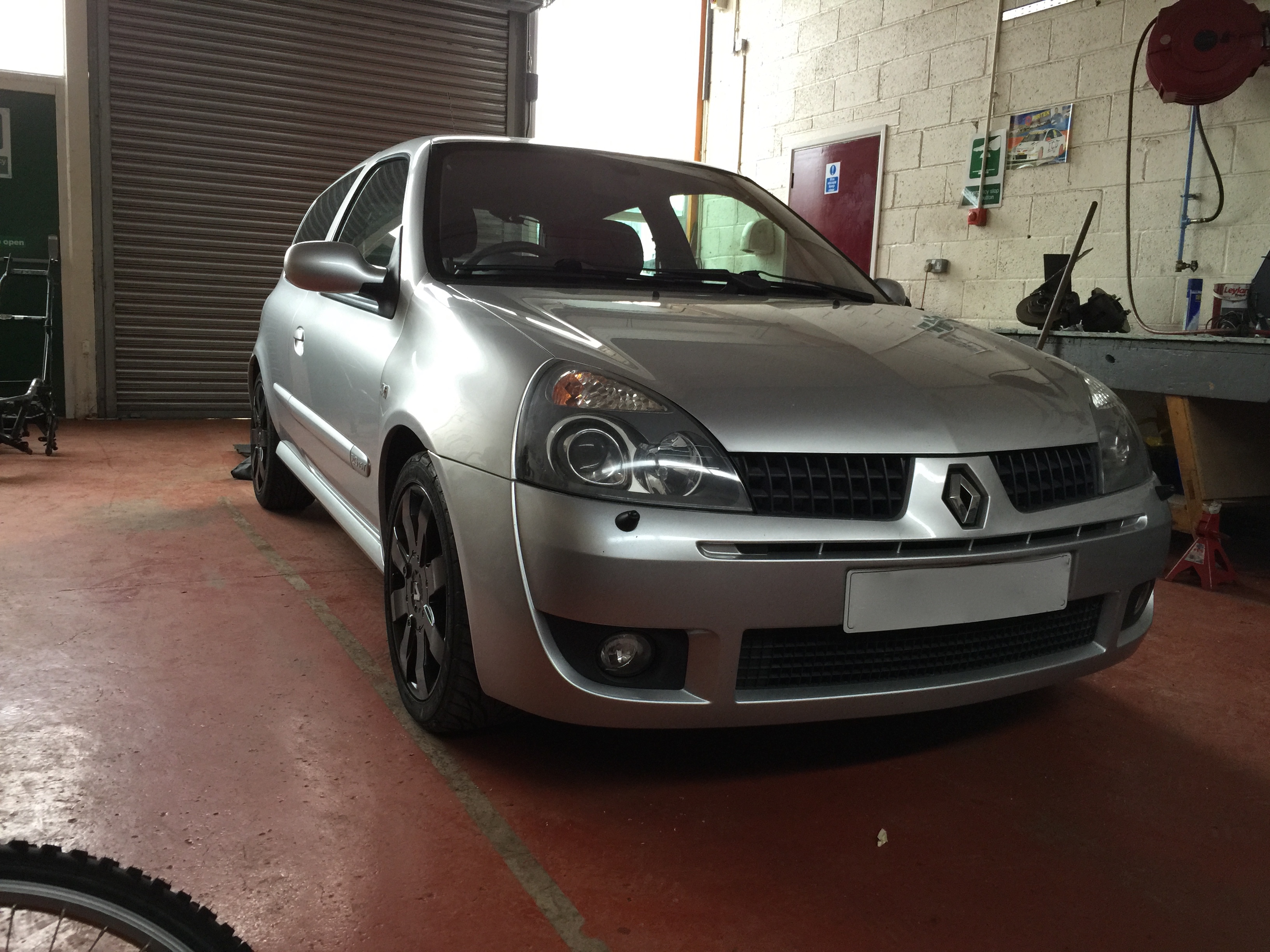

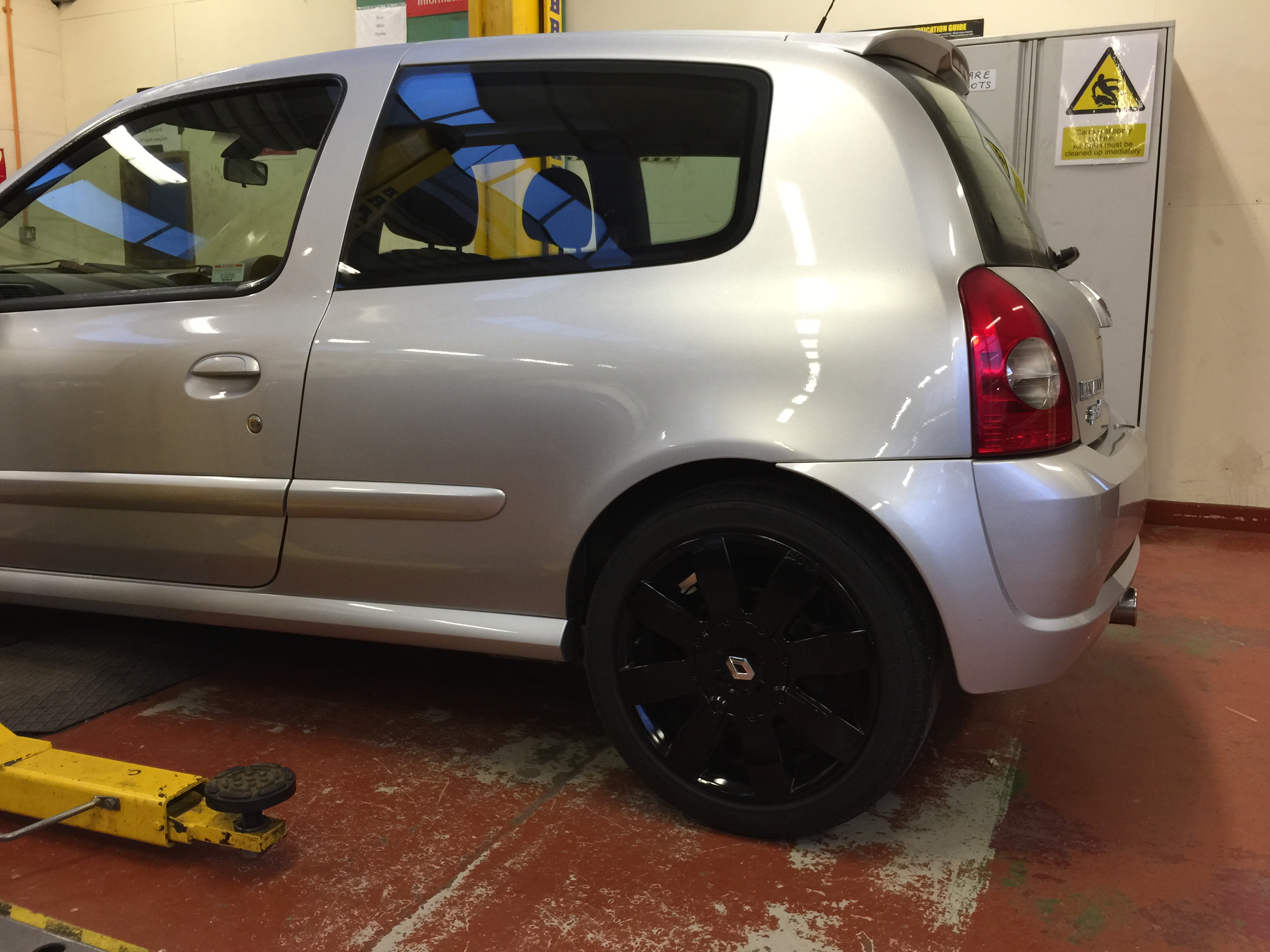

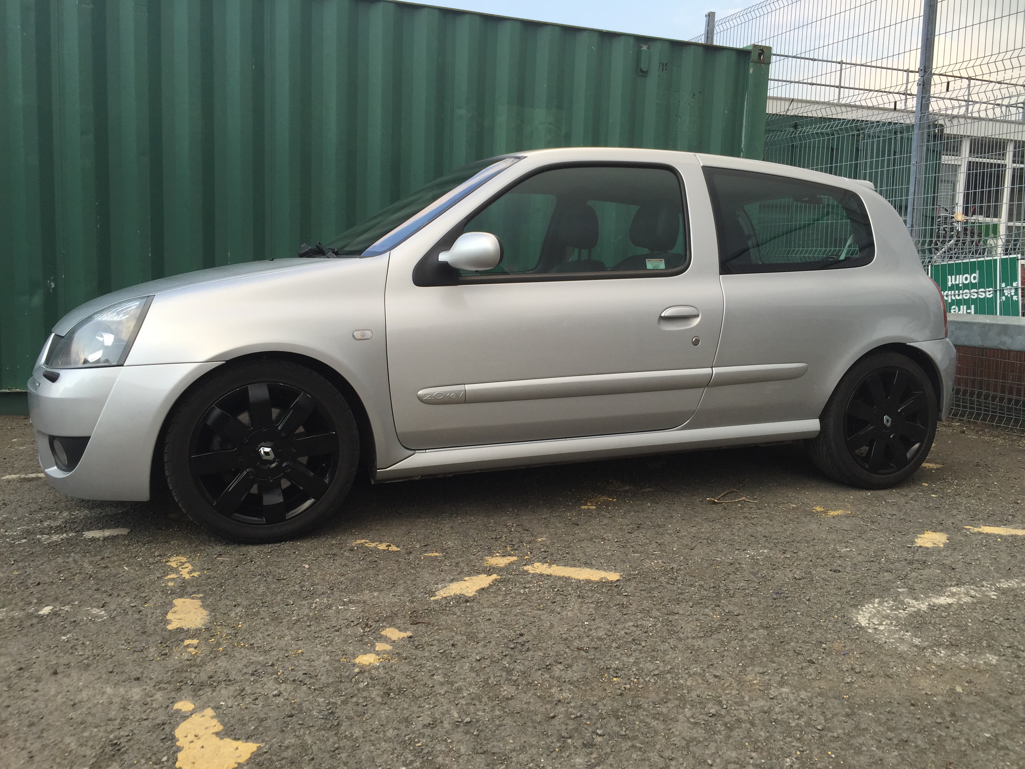

This is what the car looks like with it fitted from the outside. I need to set the car up as the camber and toe is all over the place (thanks to me lol) but even with it set badly it still handles so much better than before. The car will be going to DS Motorsport for the spring set up and camber hopefully very soon.
A bit too much camber once side lol

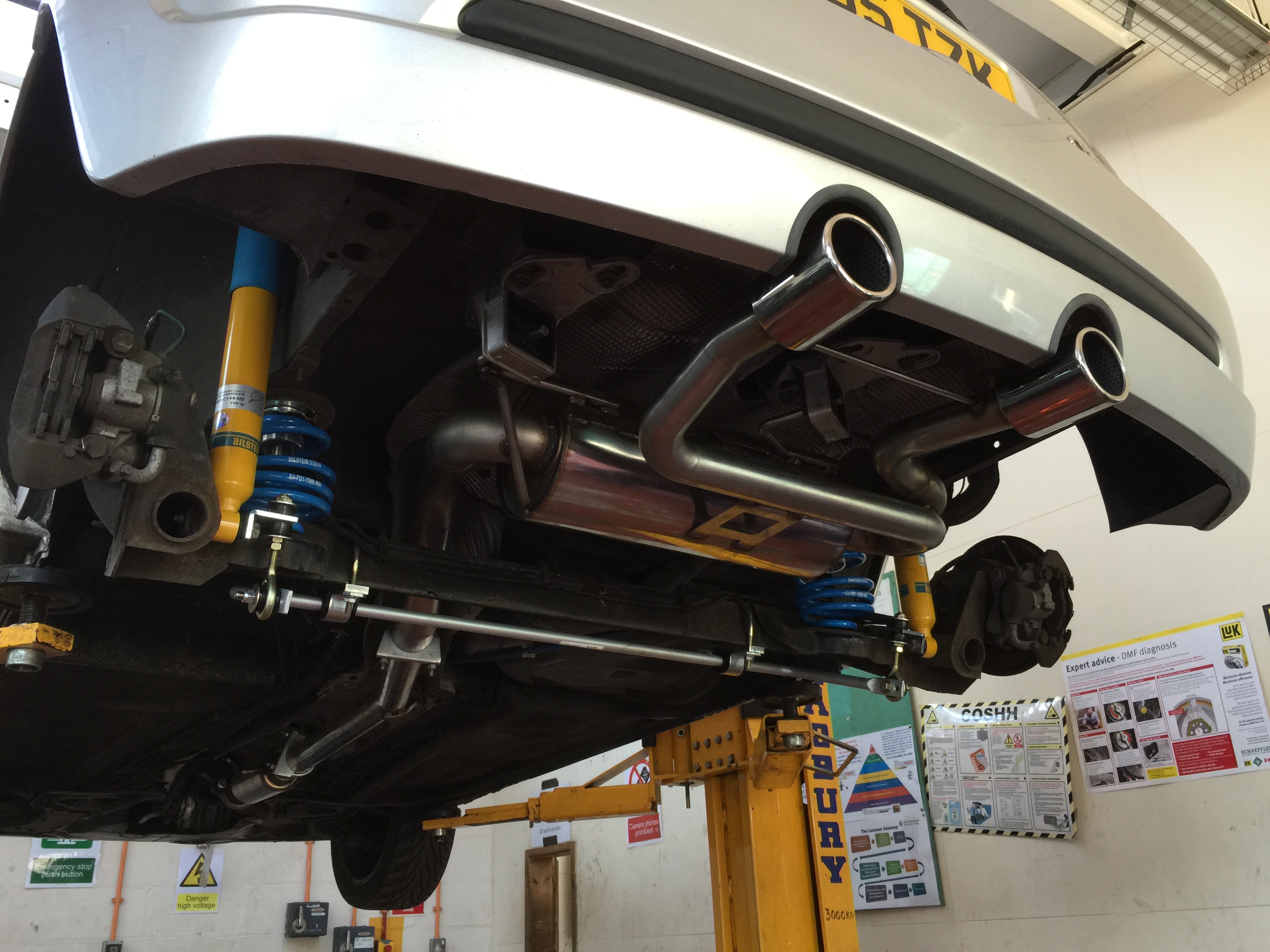

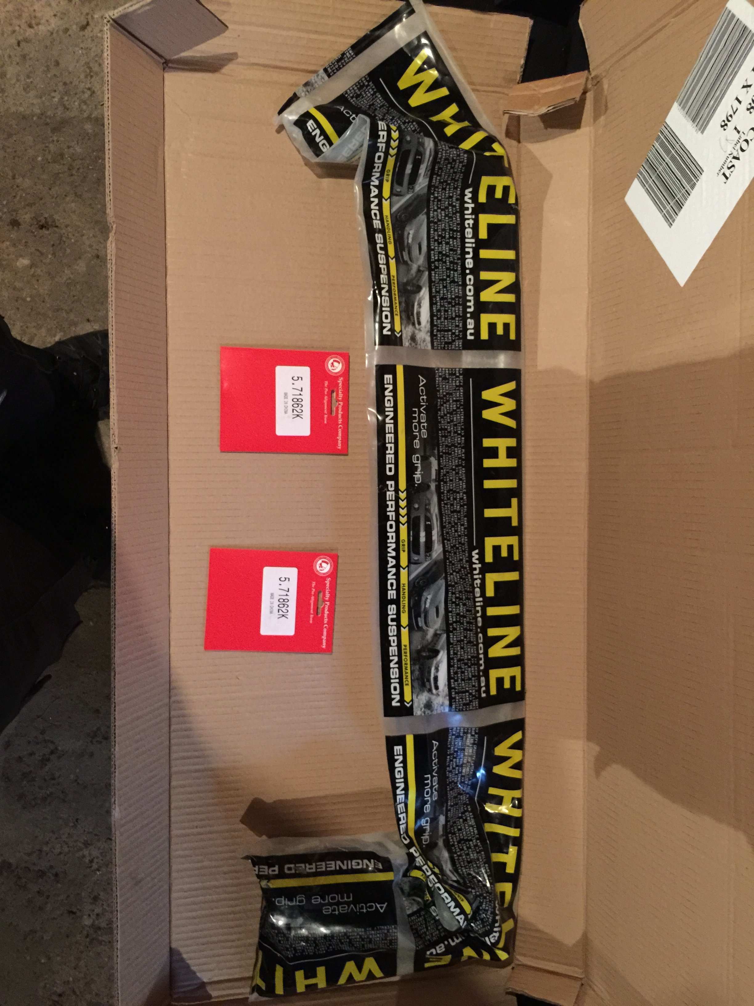

Sorry its been a while since i updated this been really busy at work. Once the suspension was changed i decided to go for a whiteline anti roll bar to stiffen the back up even more :)
After the anti roll bar was fitted i treated the car to a new exhaust because every track car needs a loud exhaust haha. I bought the k-tec ultra exhaust with silenced de-cat and no centre silencer and it sounds brilliant really love the sound it makes :)
I also added a pair of 1 degree camber shims as well for the back also while the hub was off i fitted new discs and pads on the rear. I went for the standard Renault discs (because of the wheel bearing) and ferodo ds performance pads which to be fair work really well together :)

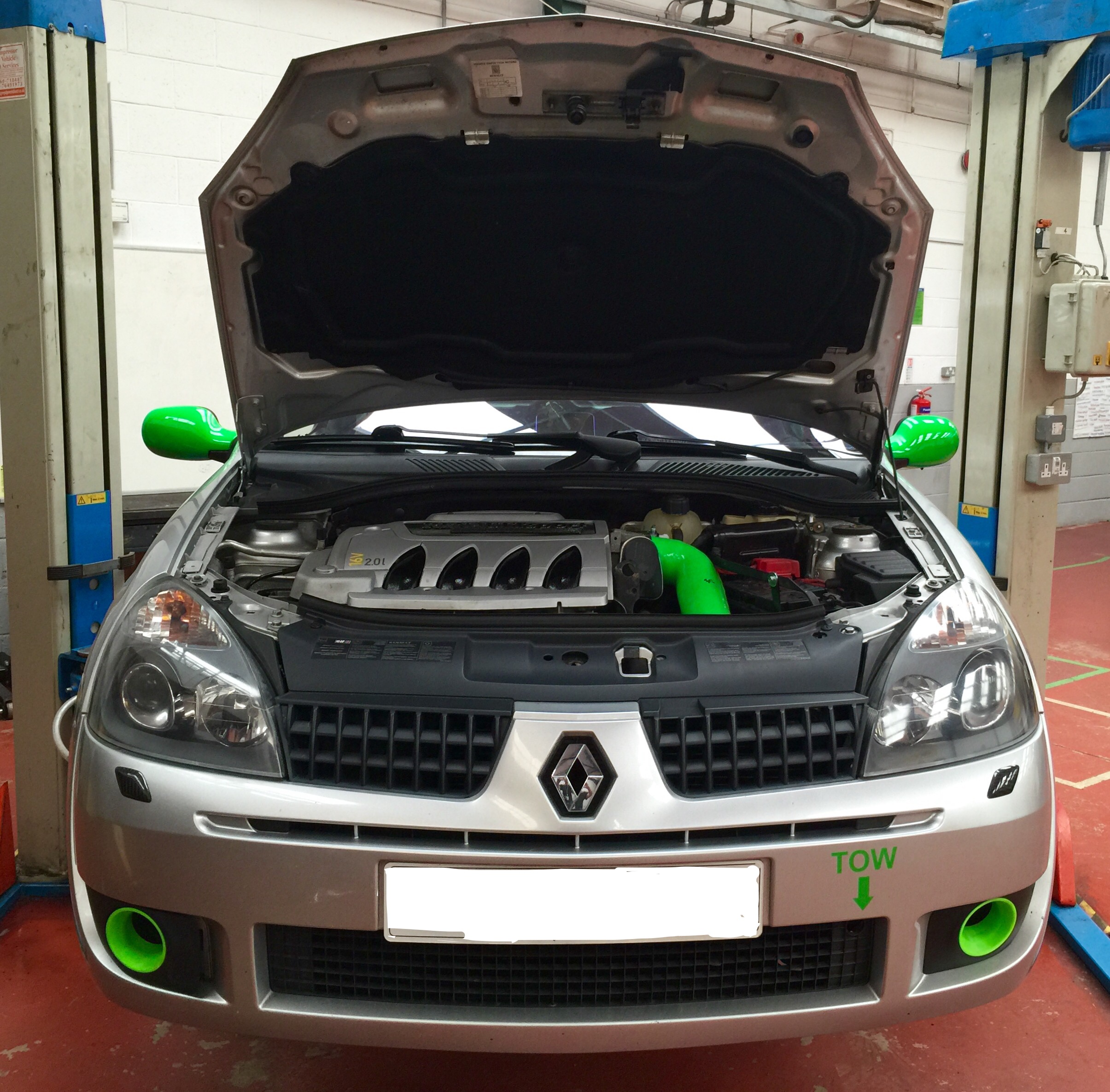

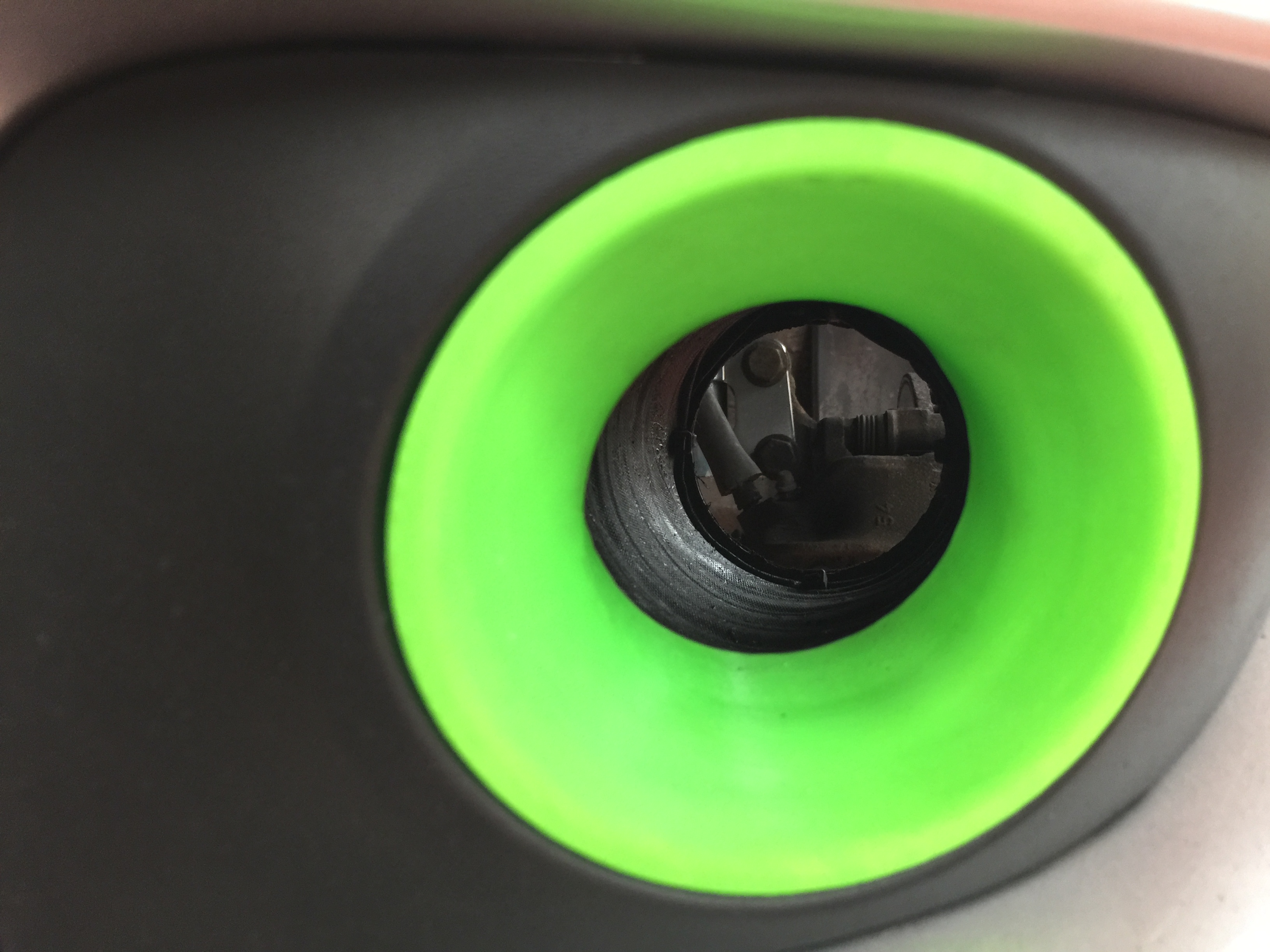

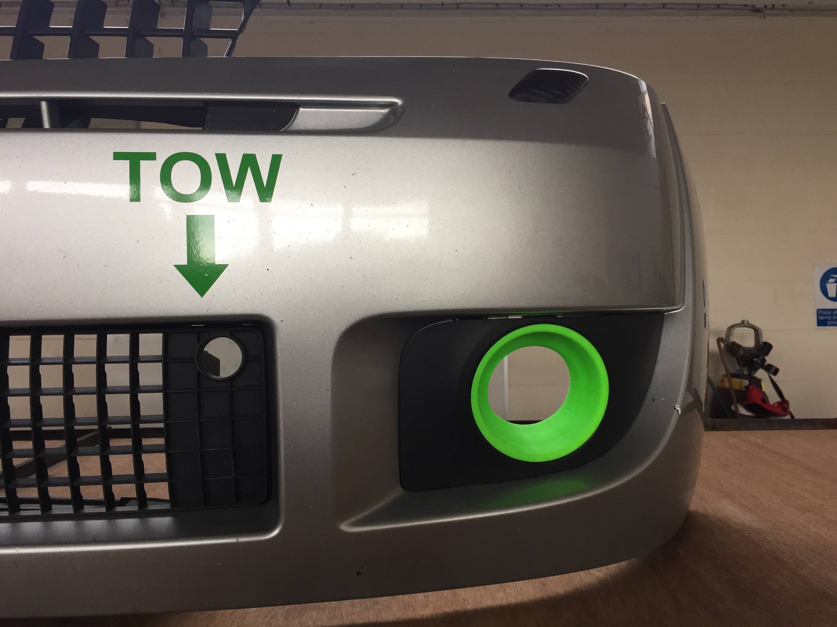

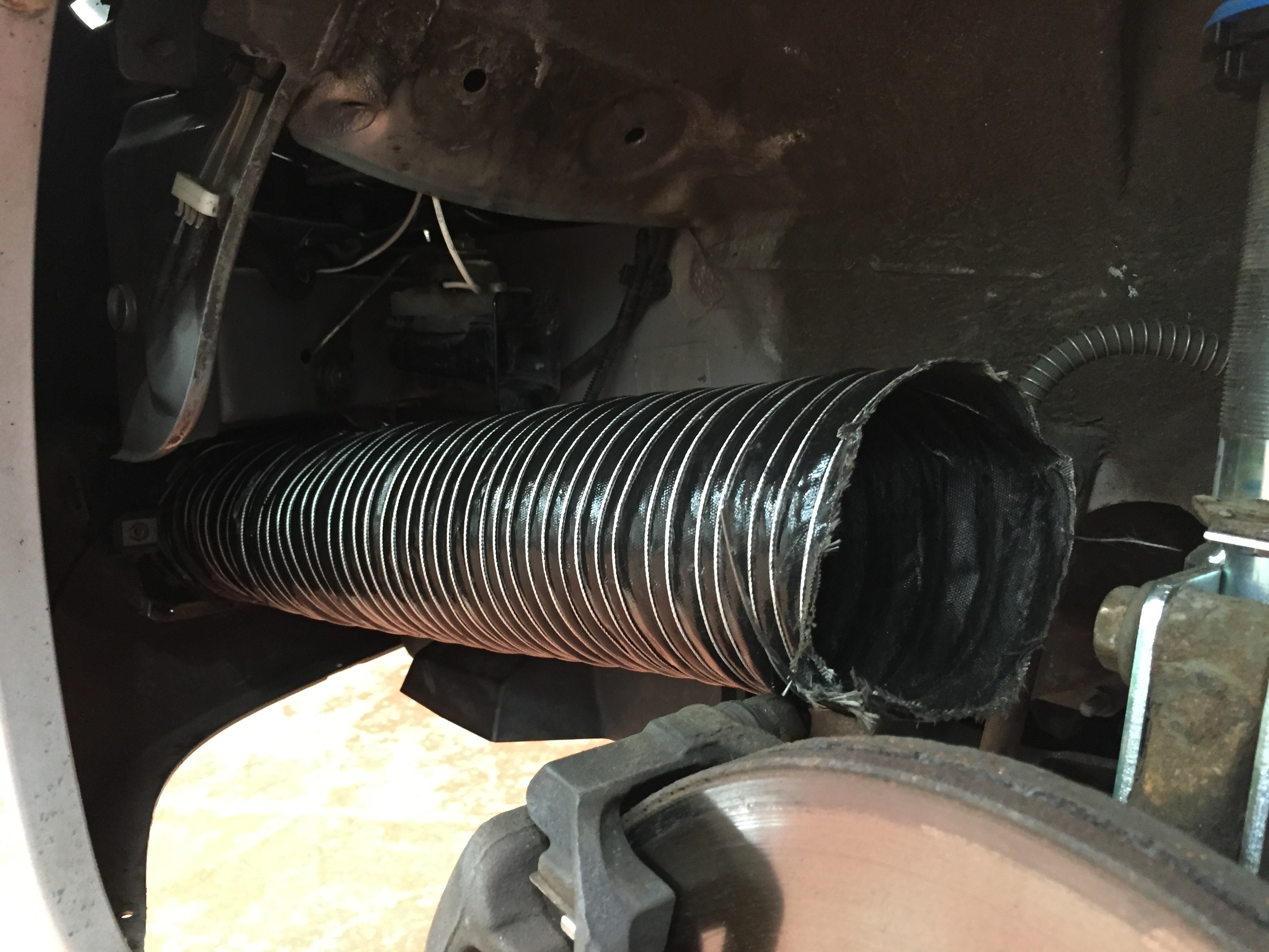

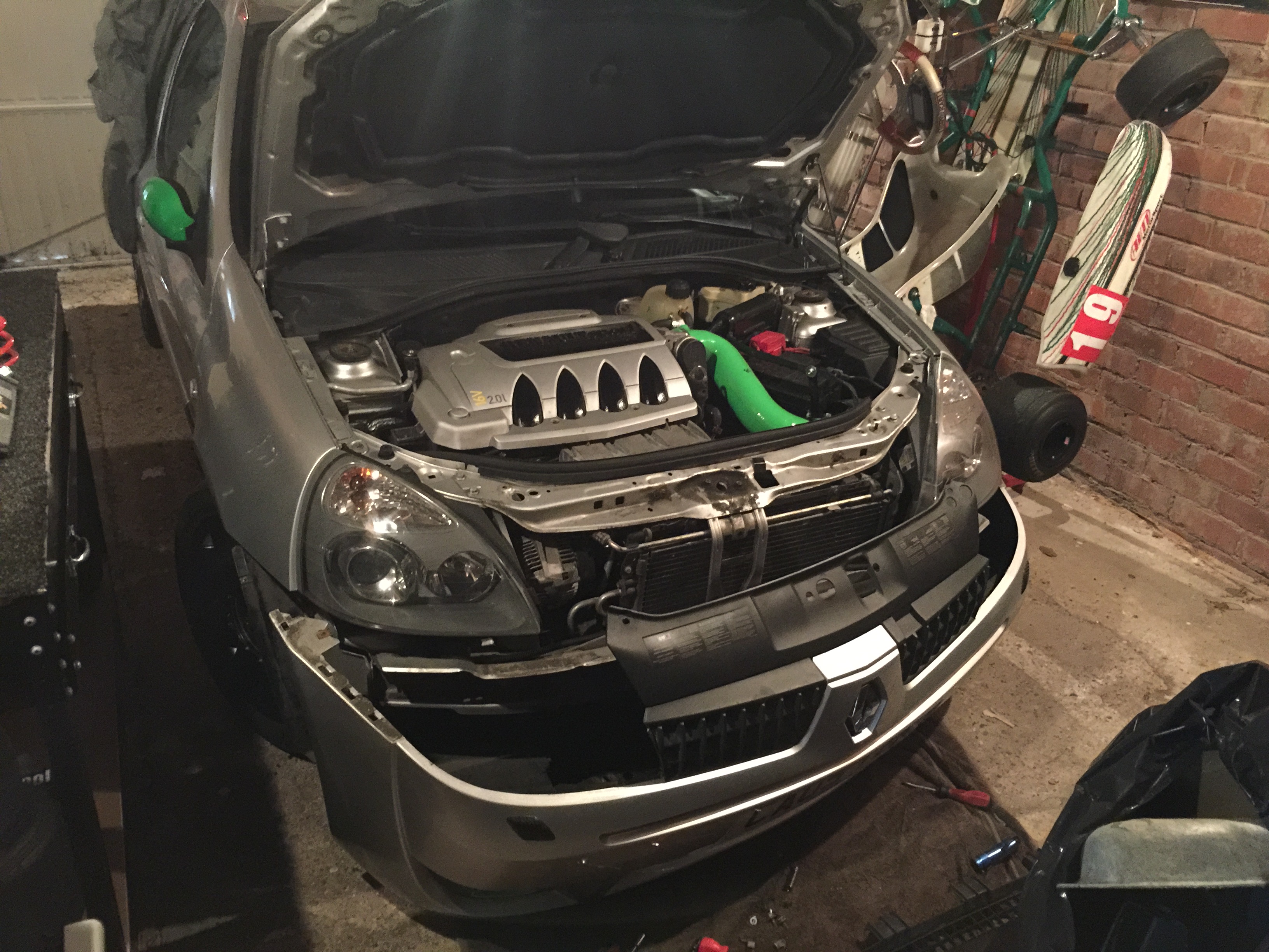

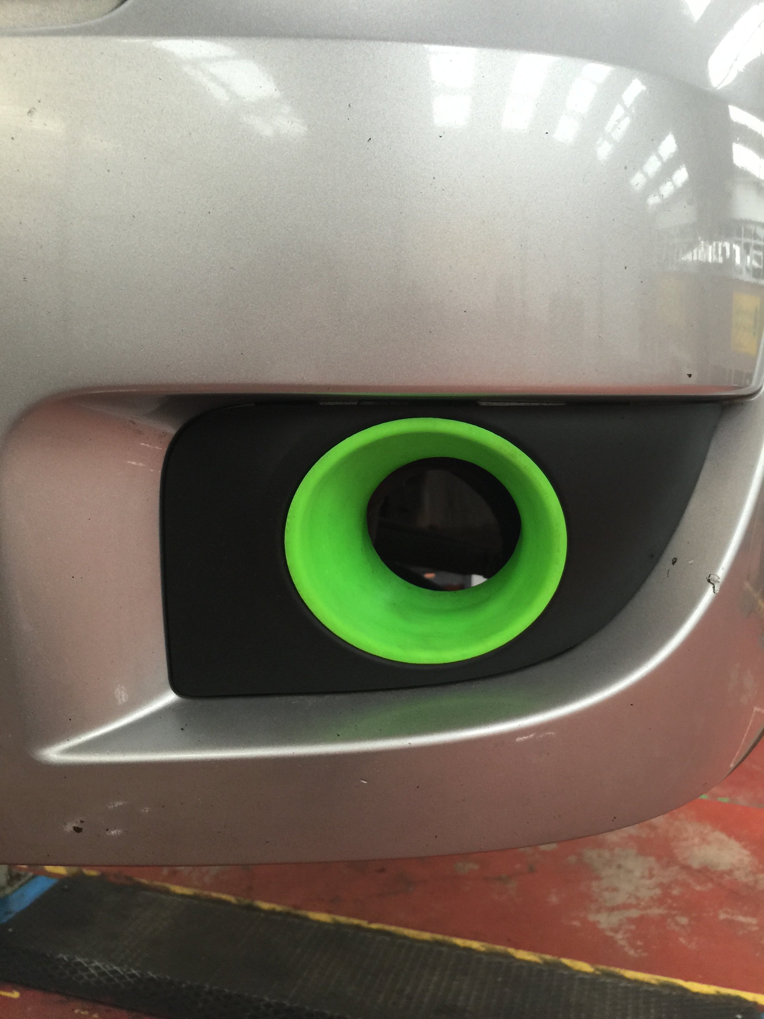

Now i know the clios have a tendency to over cook there brakes so i thought it would be a good idea to run front brake ducts on the car just to try and cool them down a little bit. This is what i did :

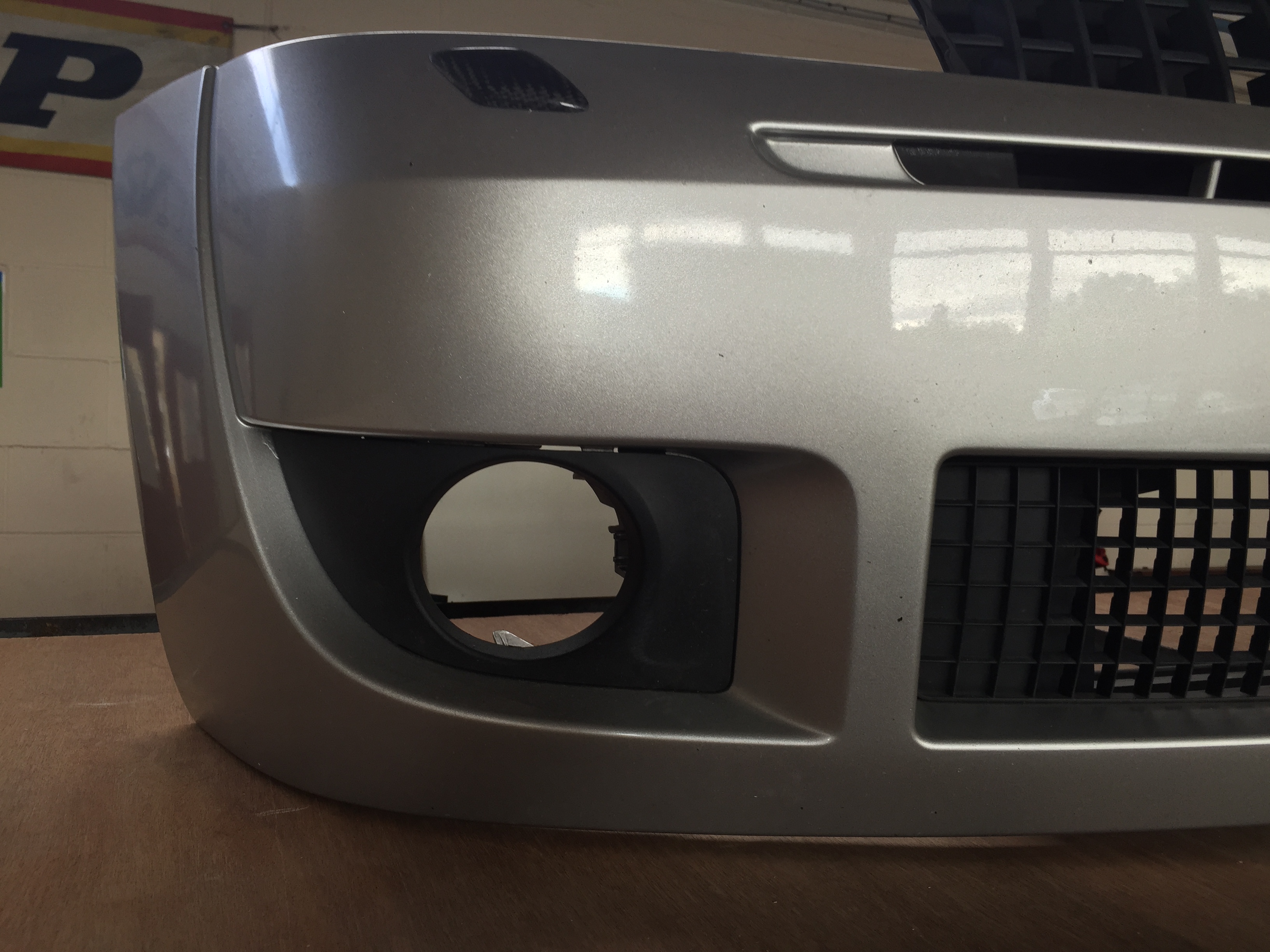

Removed the front bumper.
Removed the fog lights and wiring to them
Removed the part of the air box thats right down the bottom of the bumper so i can have a nice clean pass
Bought green brake ducts ends from eBay :)
I then bought the piping to fit on the duct, again an eBay special

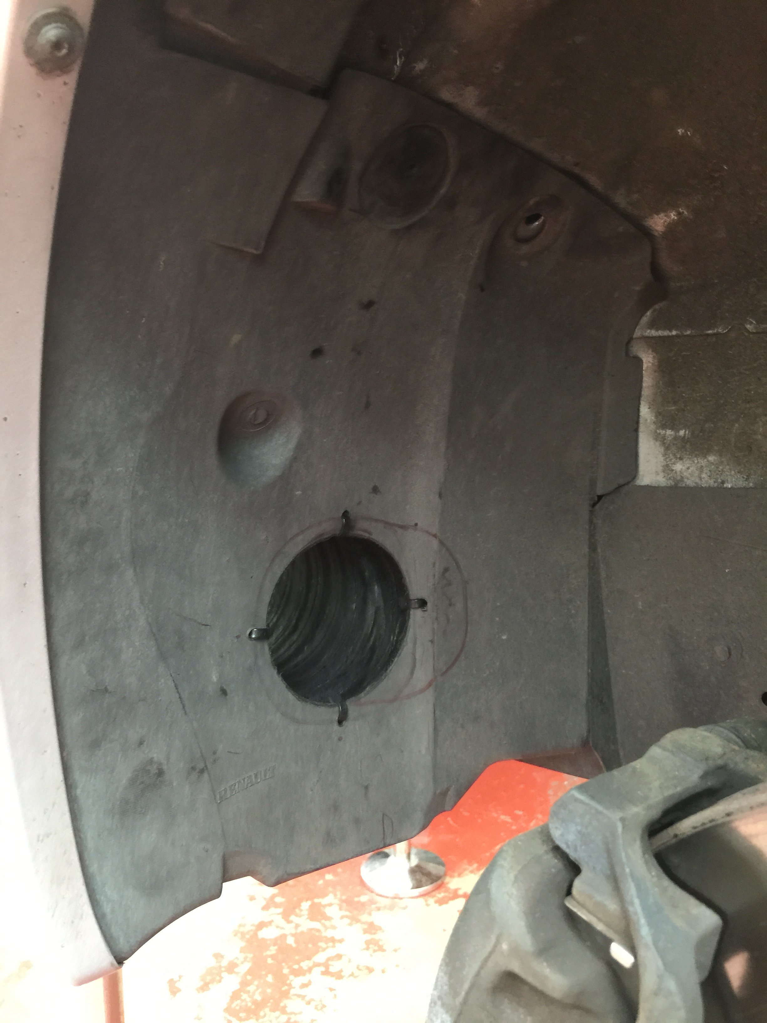

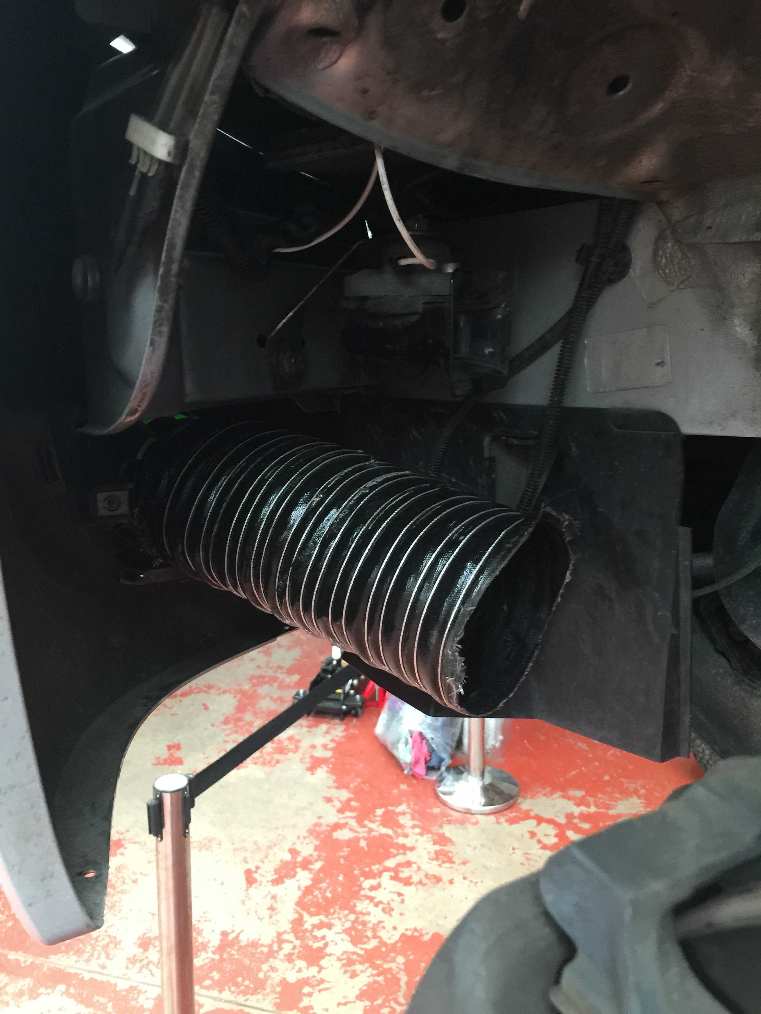

Cut a hole in the wheel arch and zip tied the duct to the inner wheel arch and zip tied to the green ducted
and refitted the bumper. Job Done :)

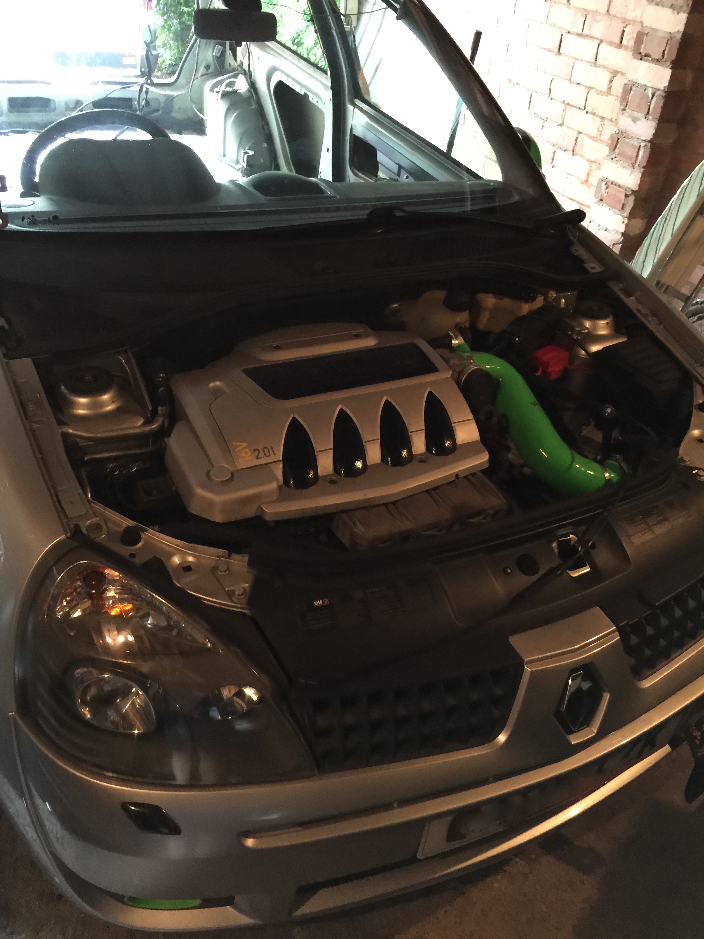

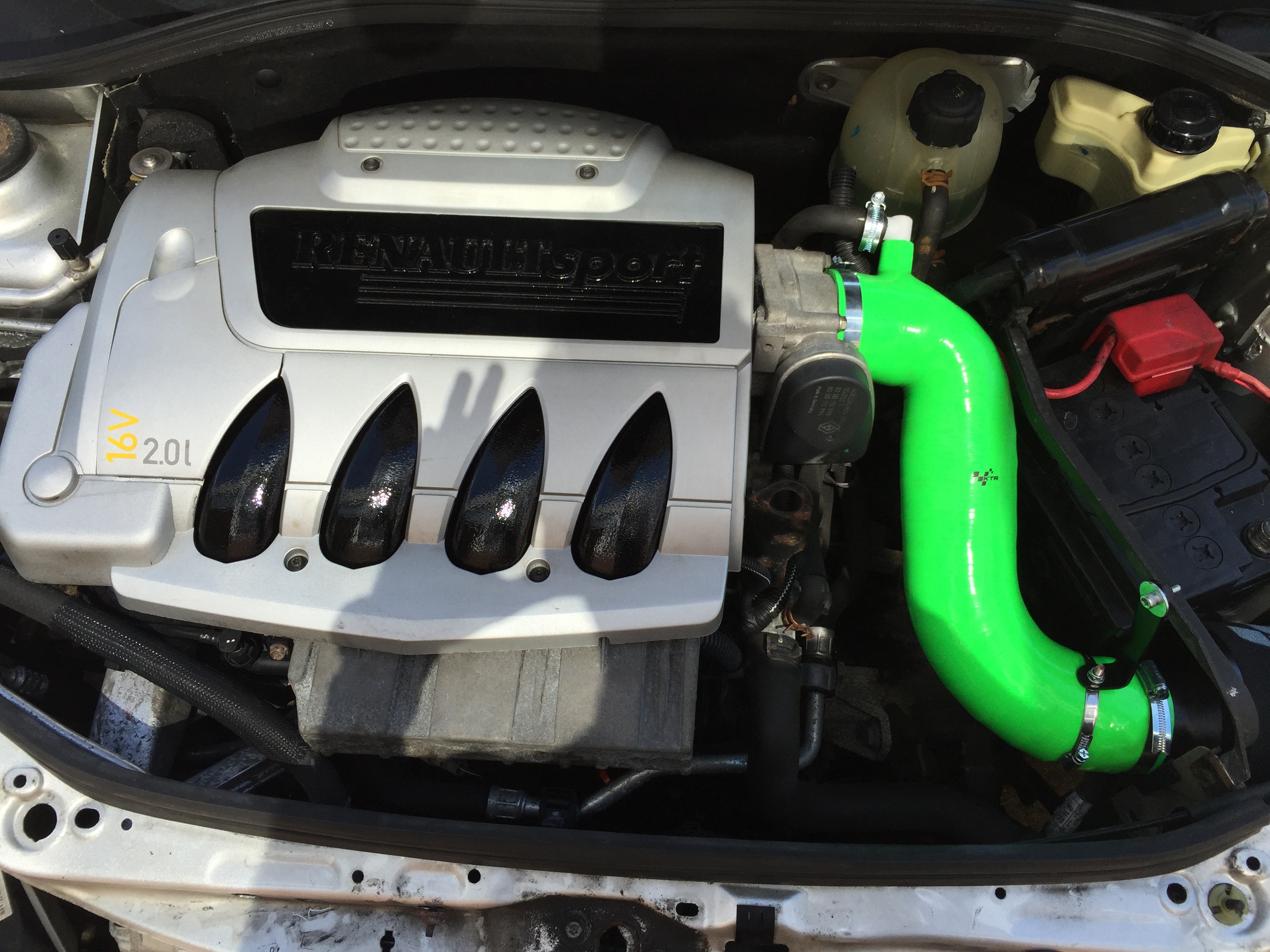

After i put the brake ducts on i put a k-tec induction kit on it and guess what colour i went for ? Really love the sound it make very happy with it :)

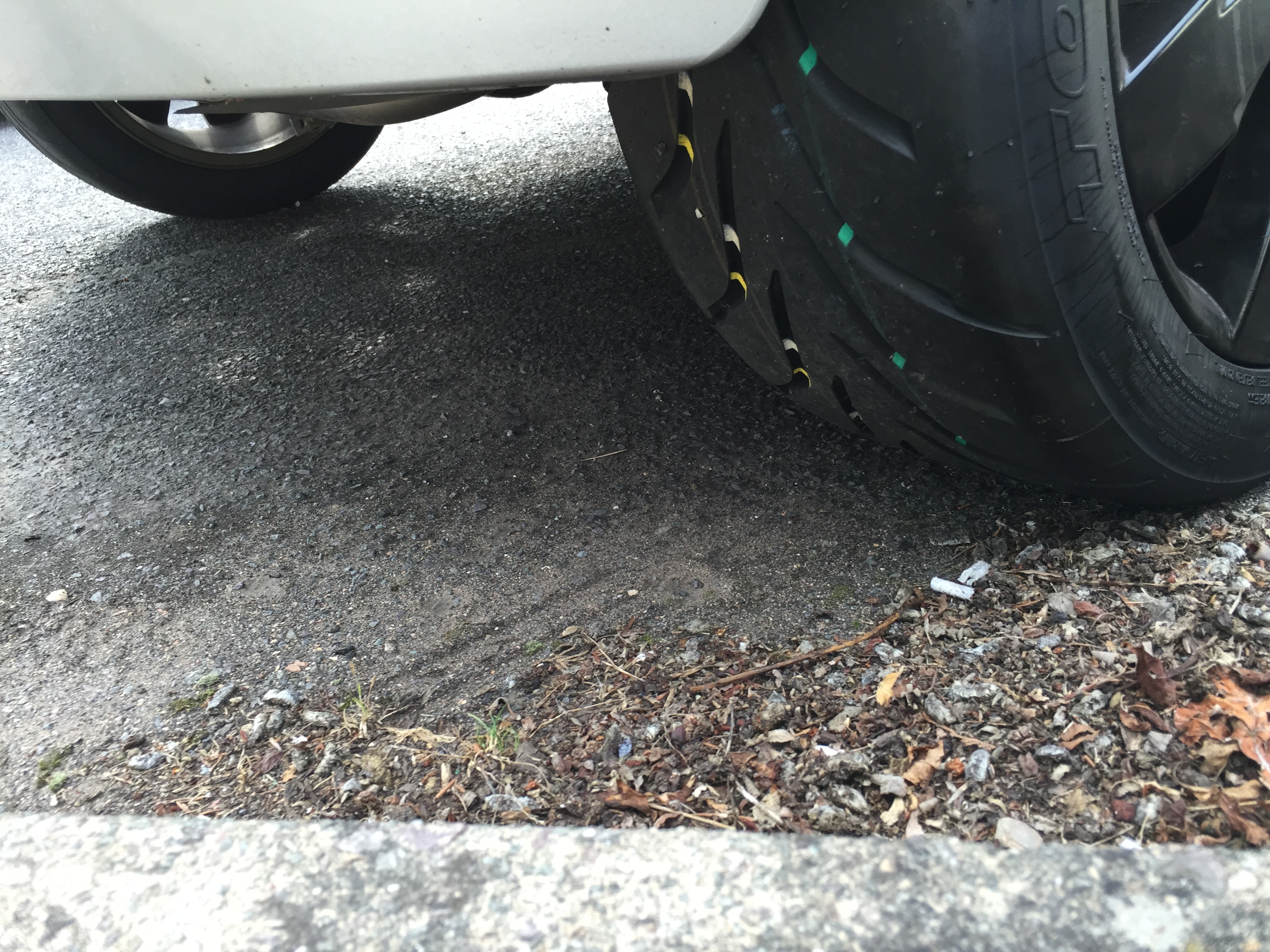

After this i treated the car to a new set of tyres because the tyres were pretty poor that was on it so i bought a set of R888s because thats what my dad runs on his bmw and the grip it has is amazing so i thought thats what the little clio needed haha.

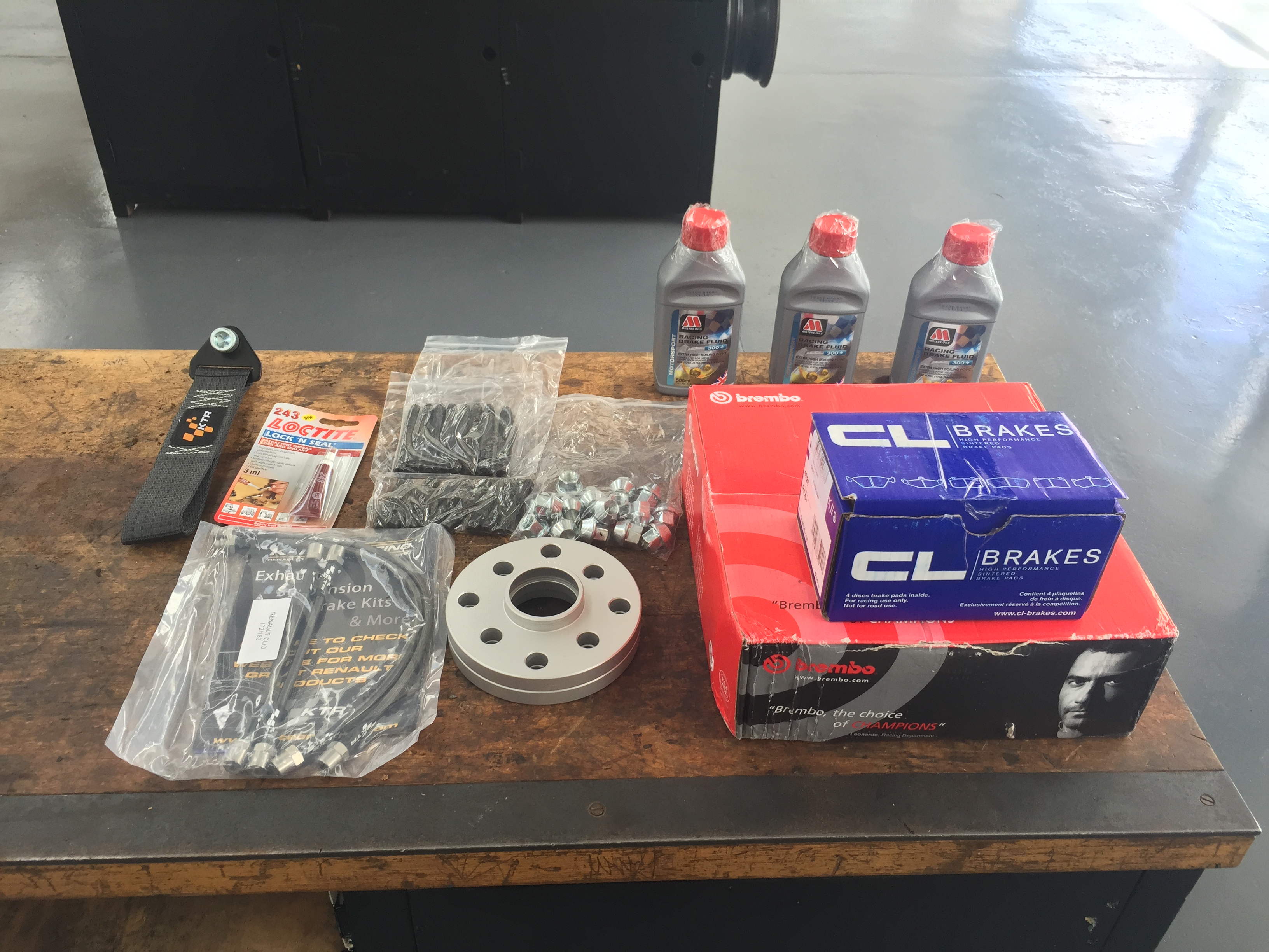

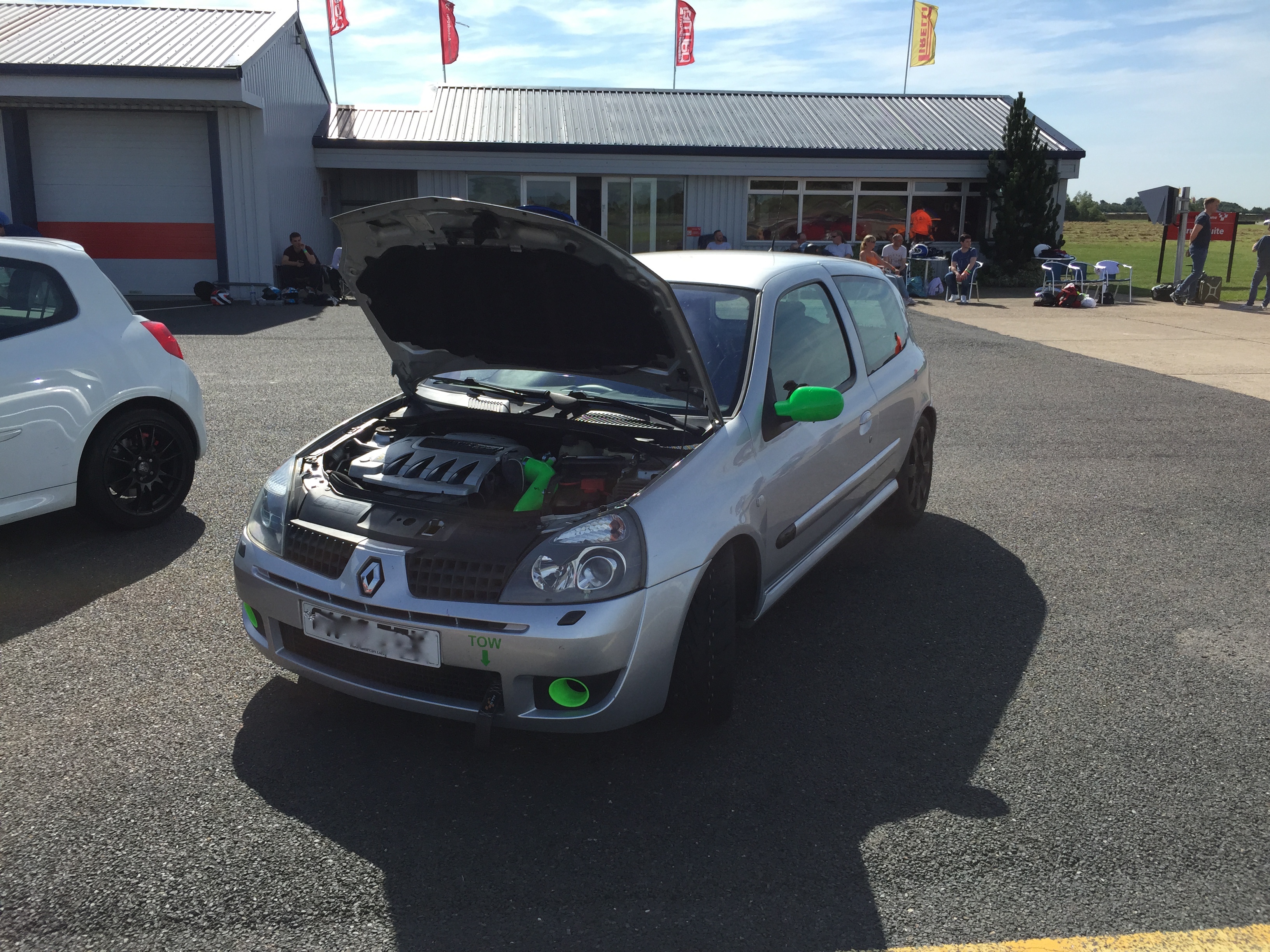

So i booked the car on a track day to see how it handled. i went for bedford because i really like the track and lots of run off just incase haha. That meant i needed a few new parts. So i bought front discs and pads (brembo high carbon discs and CARBONE LORRAINE RC5+) wheel stud conversation, new brake fluid, new braided brake lines, tow strap and wheel spacers for the front only 15mm.
This is what i had to do to fit the tow strap, remove the front bumper to take the lower grill out and cut the grill to allow the strap through.
So once all that was done it was track day time i was so excited as the car was going with a few friends (two ///M cars :smile: ) so it would be a good reference haha.
The car was amazing round the track i was so happy with it the brakes never went off all day and i was really giving them so stick. I would recommend that brake set up to anyone really good :smile: The only thing that needs looking at was the front suspension was a bit soft but apart from that very happy. Meet some really friendly clio sport members as well in their 172 cup (very nice car)

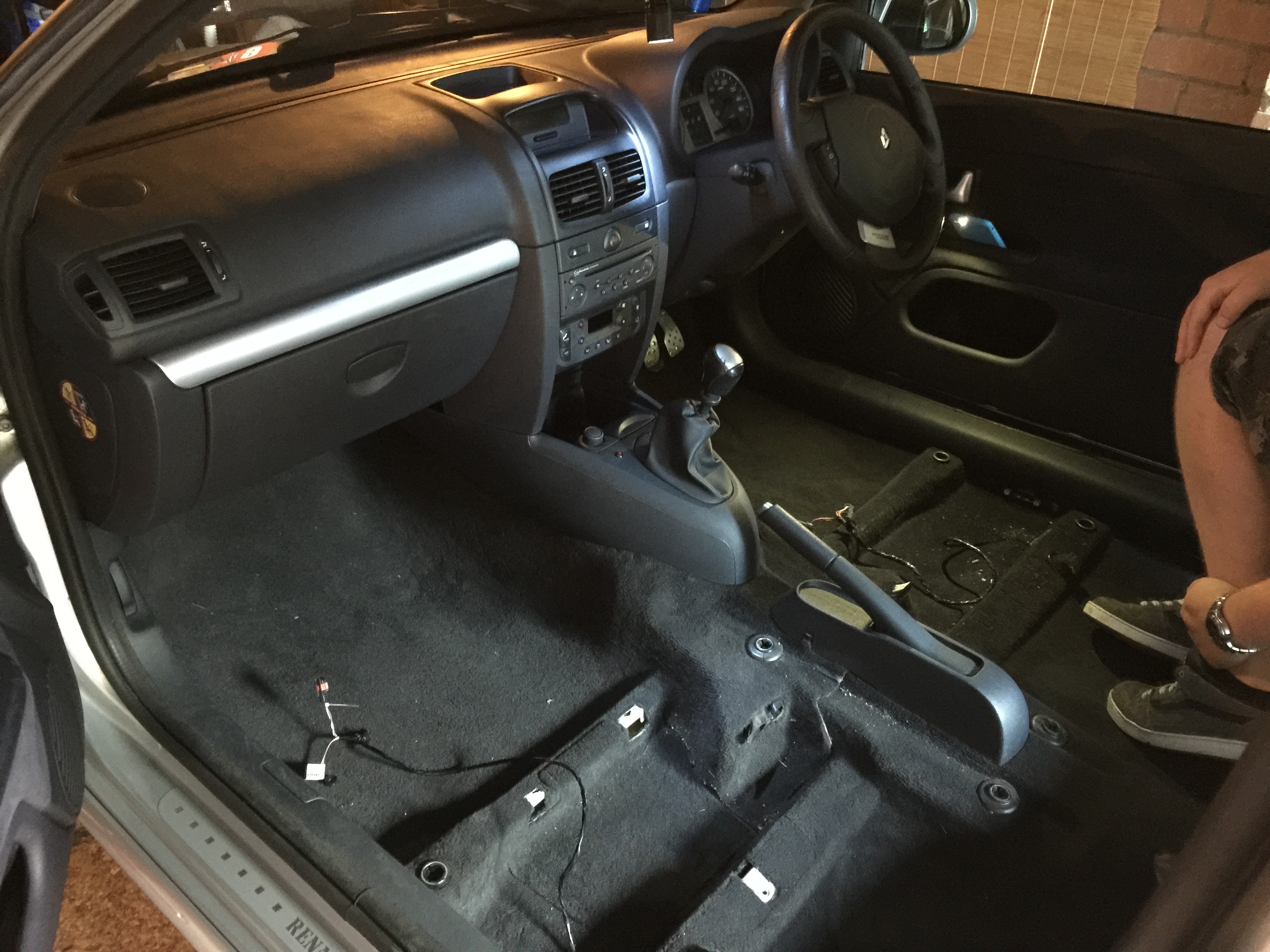

Very happy with the car on the track day but it was just a test now the winter project begins. I have started stripping the car down to save weight here are some pictures :
Seats are out there are not super heavy but still unnecessary weight.

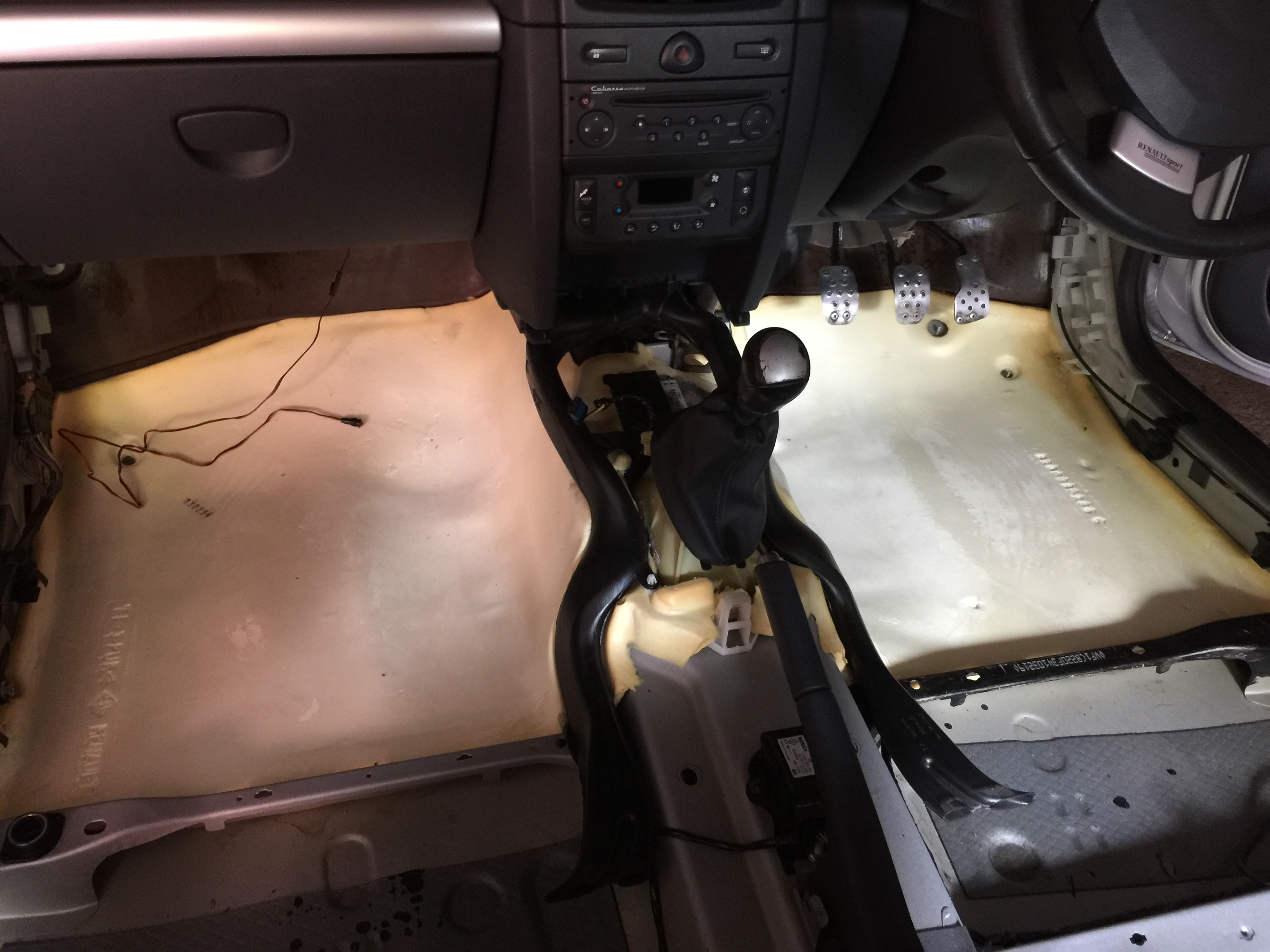

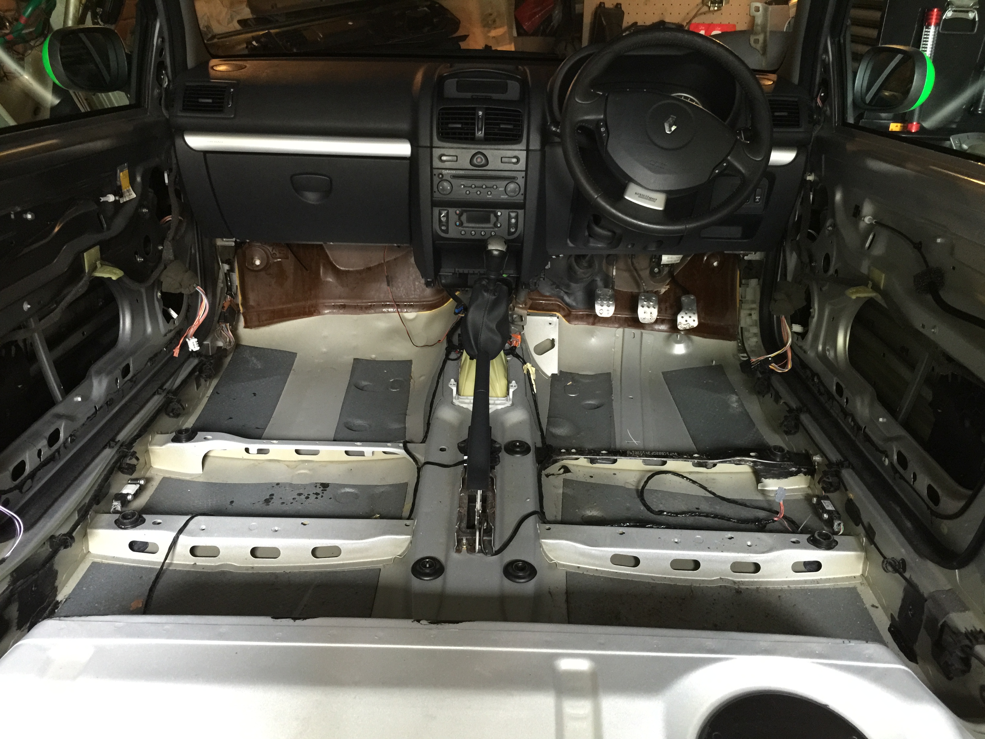

Carpets are gone and what i like to call the mattress under the carpet. I was very surprised how heavy the carpets are big weight saving there.

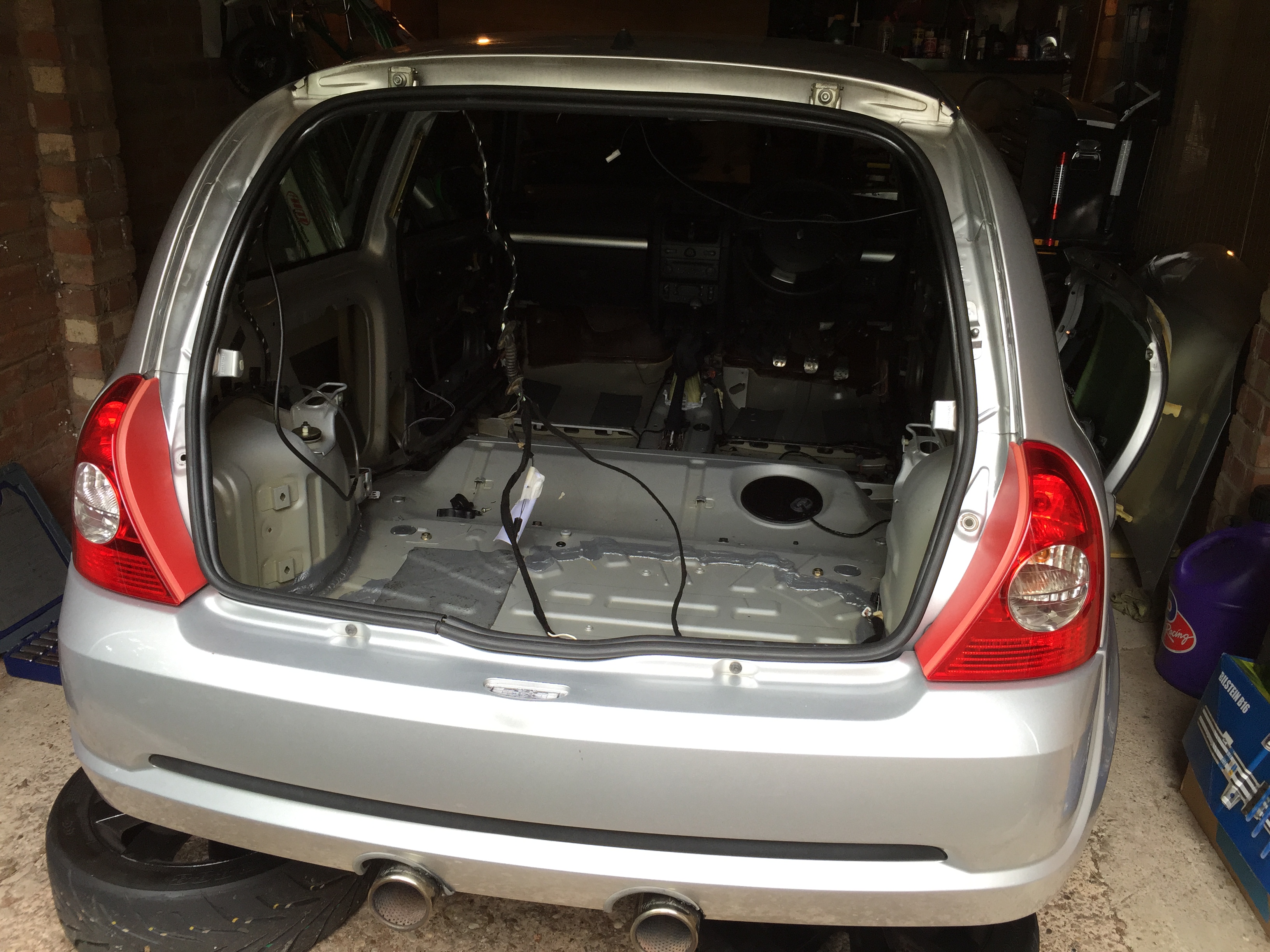

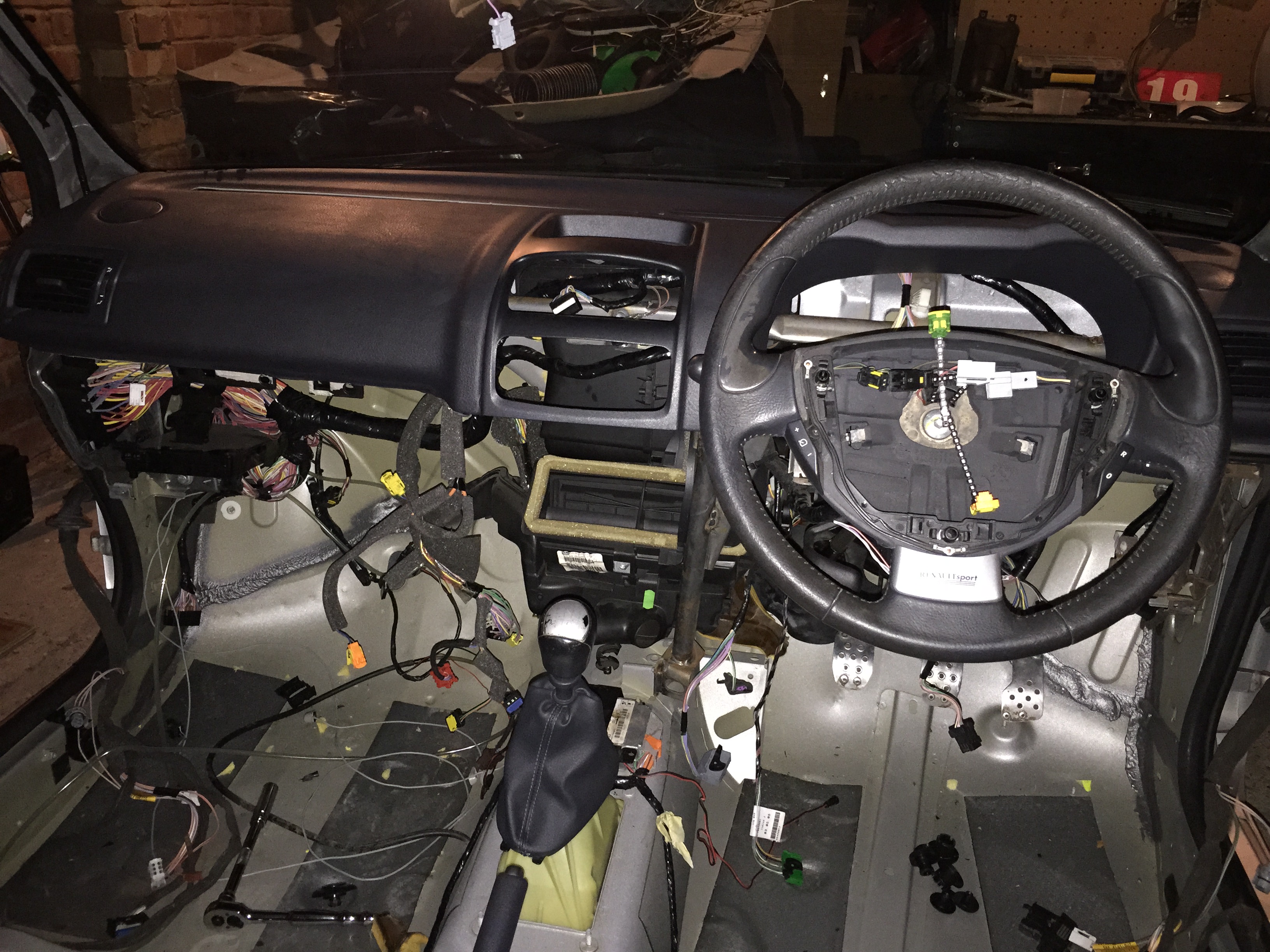

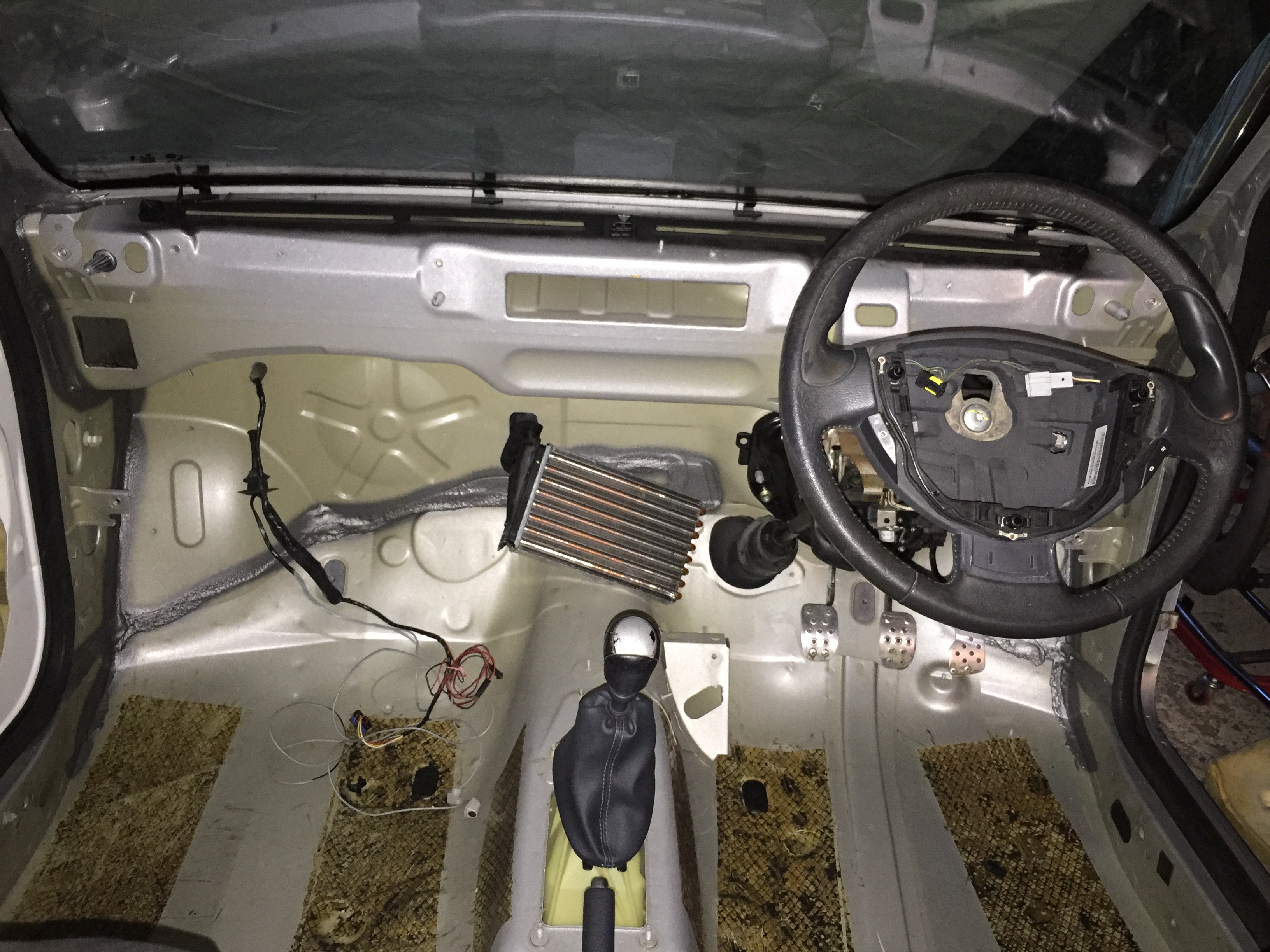

Right since last up date i have started to play around with getting weight out from the inside i have started to cut some wiring out to the back window as i am going to be running poly windows so silly having it in the car. Also as well the sound deadening from behind the dash is going, more weight saved (taking mazda thinking, ever gram removed helps) now i am just thinking what colour to paint the inside (any suggestions) and how to have the dash.
Heres a pictures what it looks like with just the top of the dash what do you think ? Yes the wiring is everywhere but the will be tidied up :)
Just a little up date just had a little bit of time to weigh my interior find out how much weight I have removed from the car. Doors, bonnet and boot included I have removed 171kg however that's not taken into account the sound deadening under the carpets and what not because they are protecting my doors at the minute haha. I am going to guess with all the odds and sods like having a new exhaust stuff like that all together we are touching 200kg removed which I am very happy with. Of course weight will go back in when the cage and new seats are fitted but I am really happy with the weight that can be taken out with out grinding and cutting parts off :)

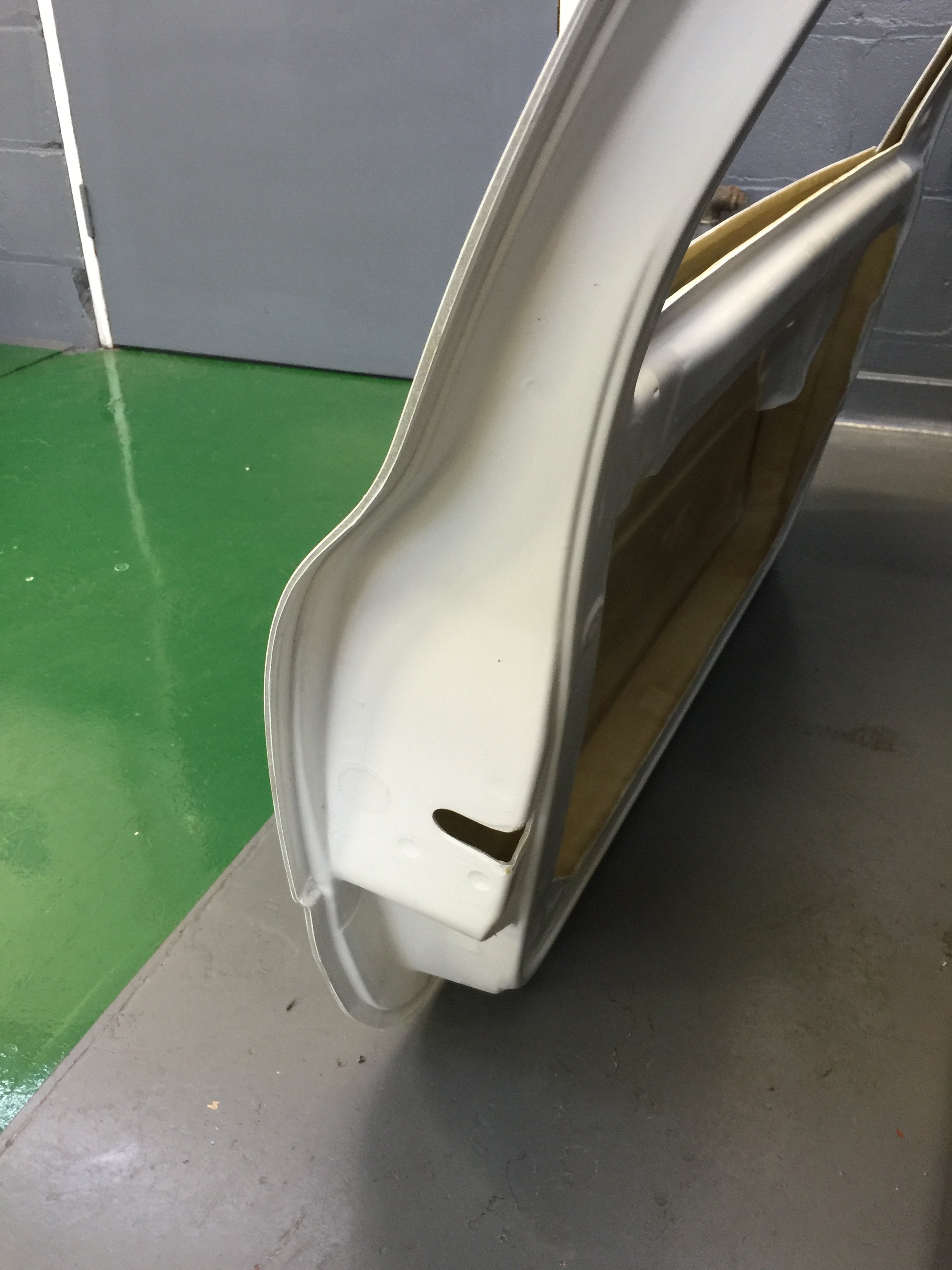

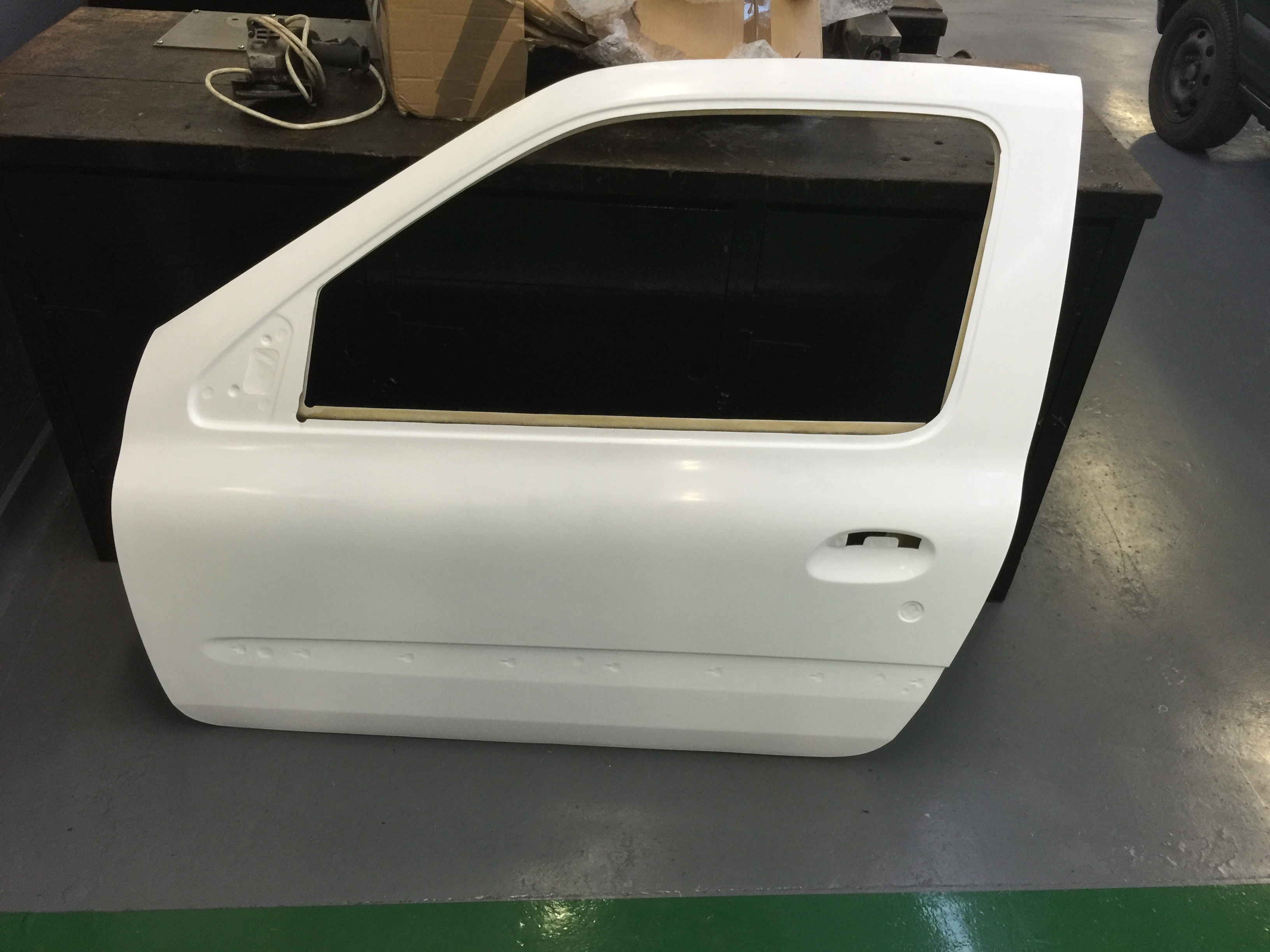

Just a little update to add. My fibreglass doors came from CMC today amazing condition and quality, top job would recommend this company 100% thank you Chris. Super light massive saving over the standard doors.
Here they are will just need some drilling to do for the hinges and what not and then in for paint :smile:

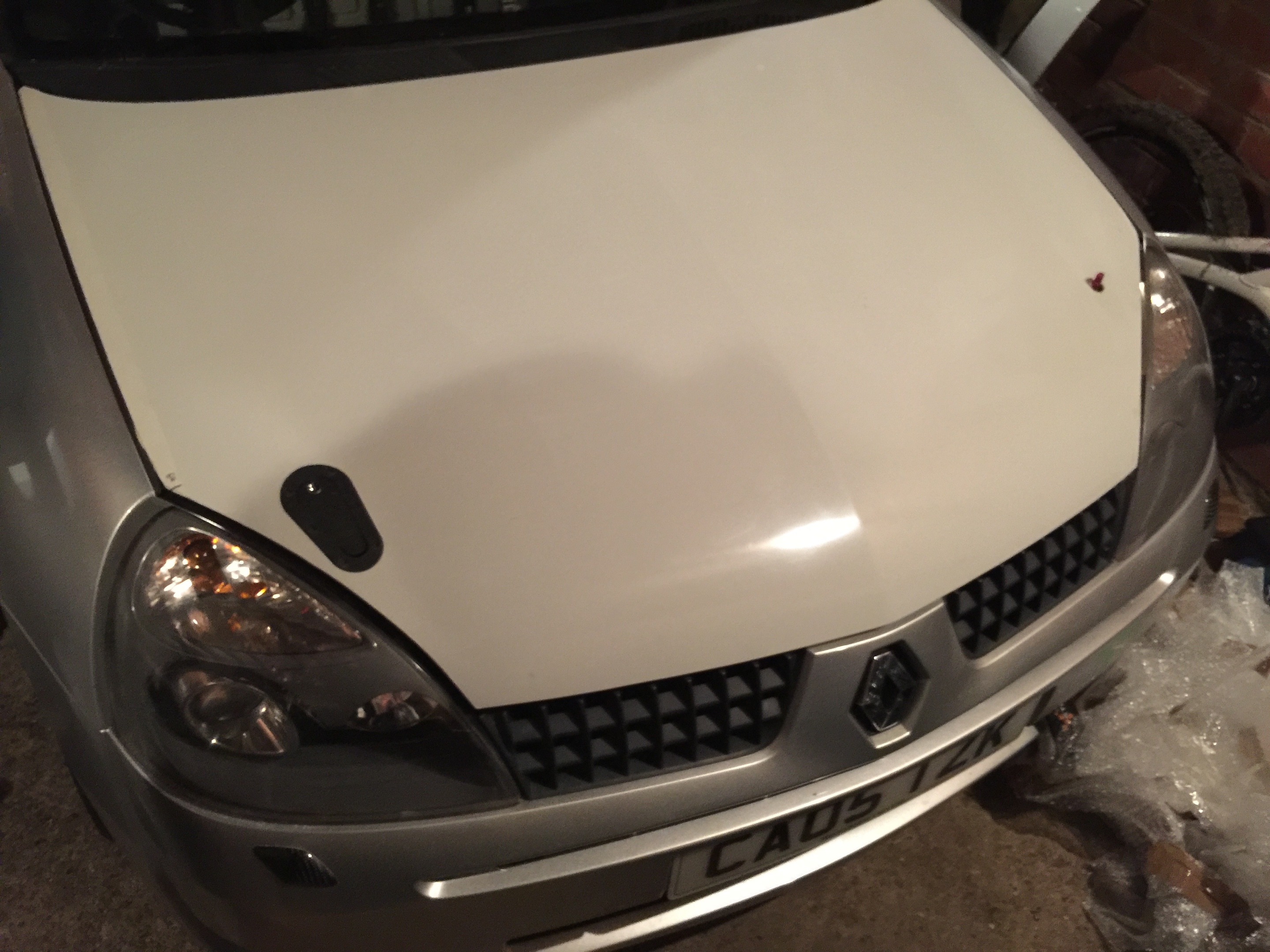

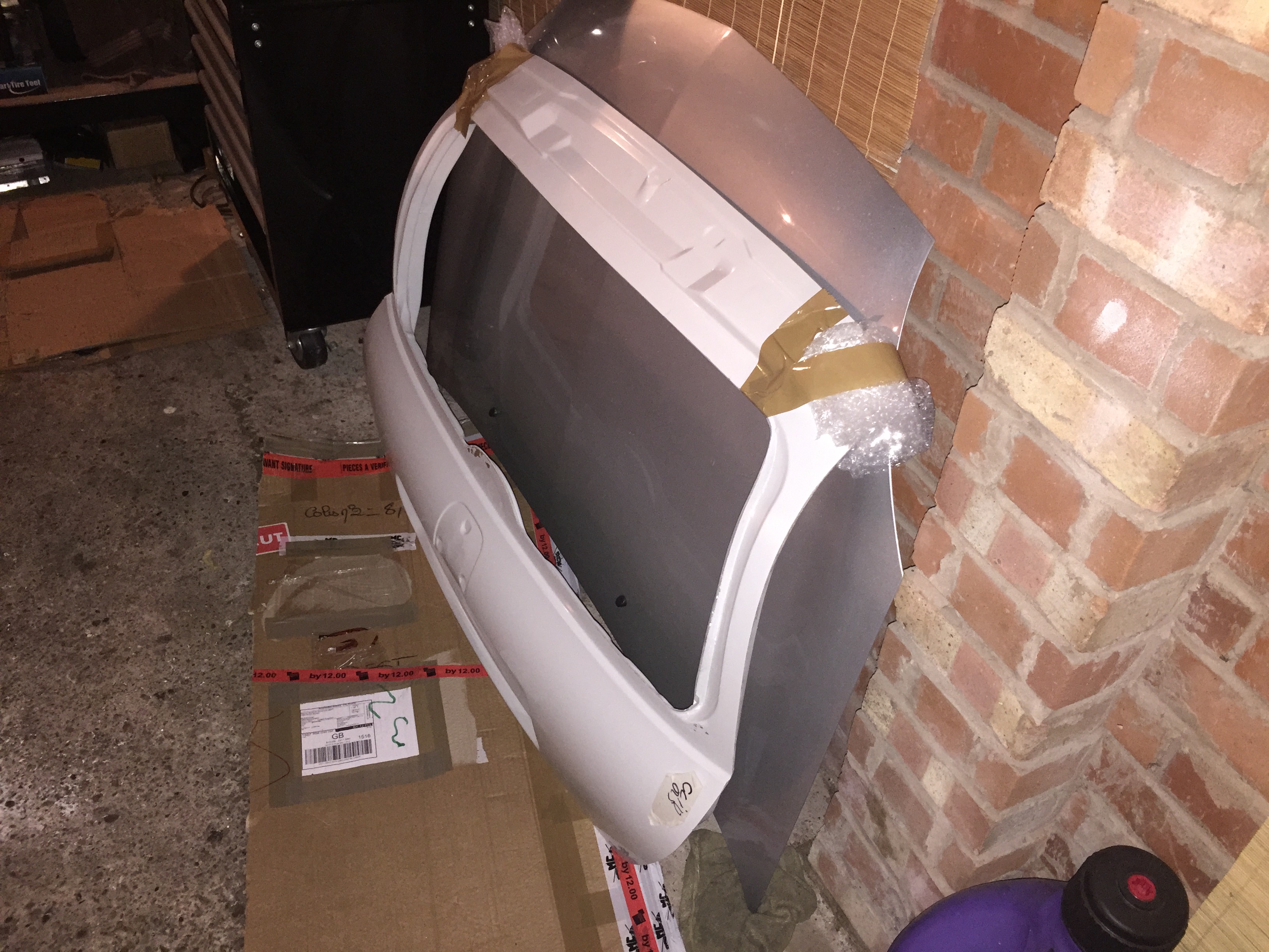

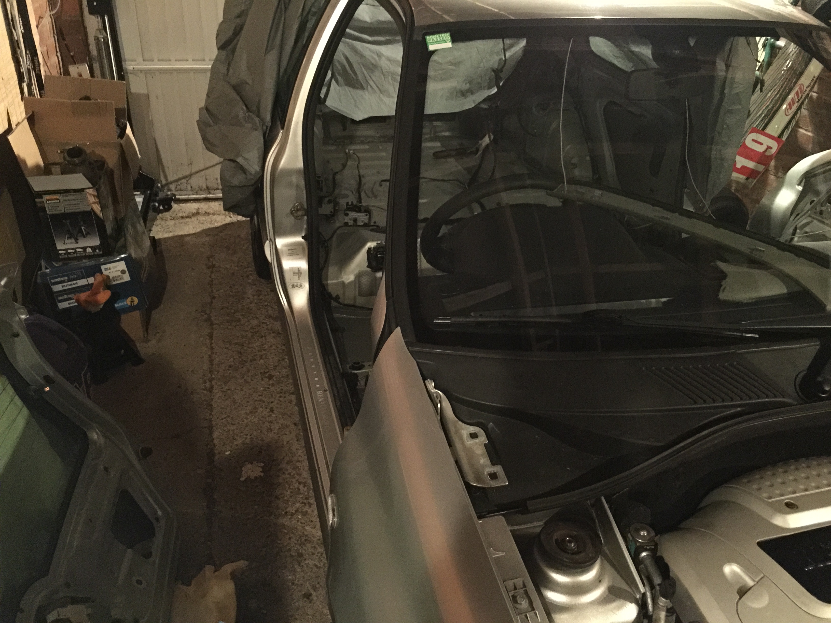

Since my last post i have been pretty busy with the little Clio. My doors turned up as seen in the last pics but i have had my fibreglass bonnet and boot from PMS turn up as well so i can make the car water tight again haha. We have also full stripped the inside of the car to get it ready for its roll cage in Jan which i can not wait for :).

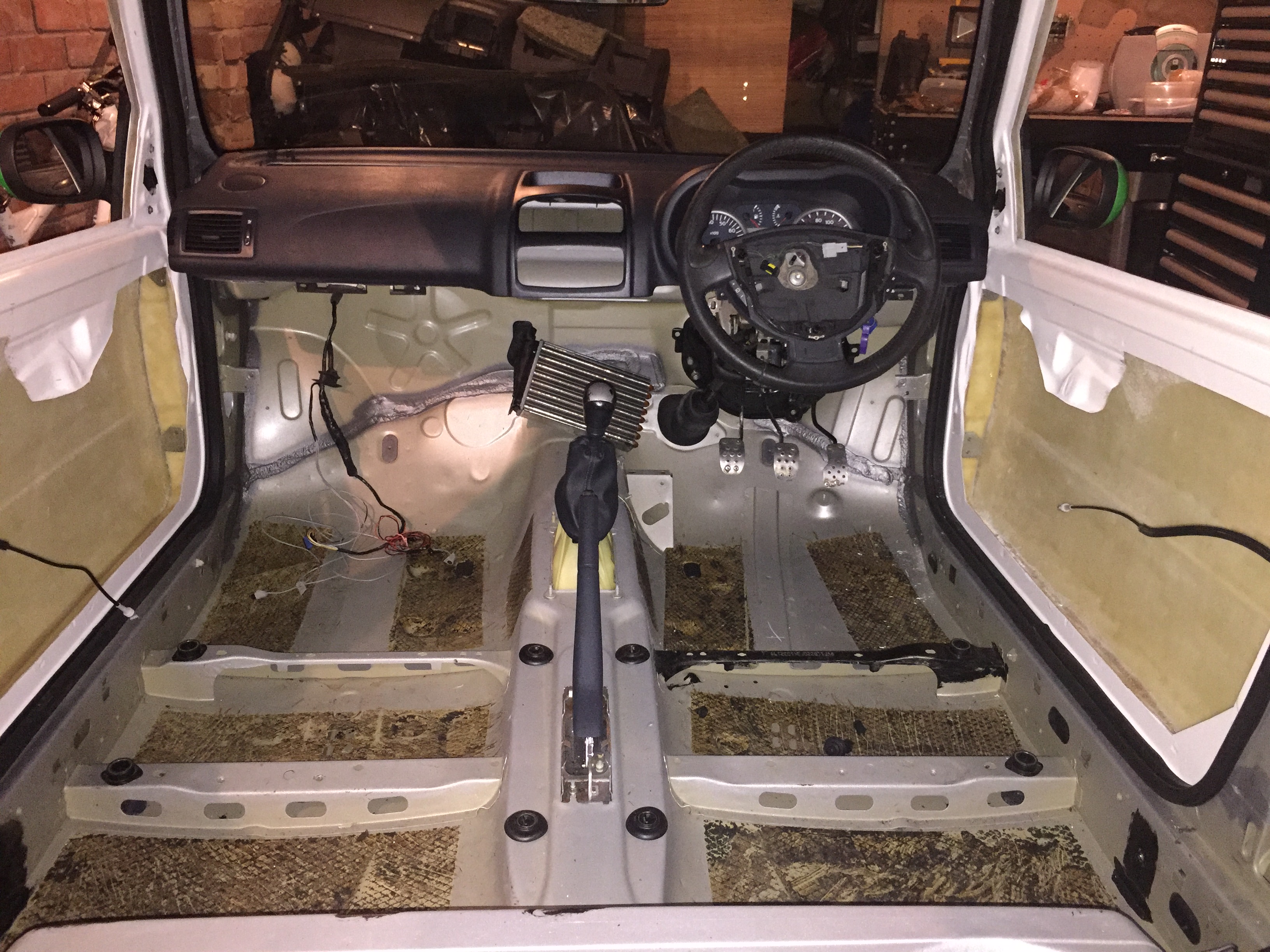

Some pictures of the car without dash or wiring loom and it looks so clean and good, it didn't take too long to do it you just need to make sure you don't just rip it out from frustration (which is easy done).
I need to get rid of the heater matrix rad before it goes for its cage so i can get the fire wall welded up.
I thought i would put the top of the dash back in to see what it will look like :)

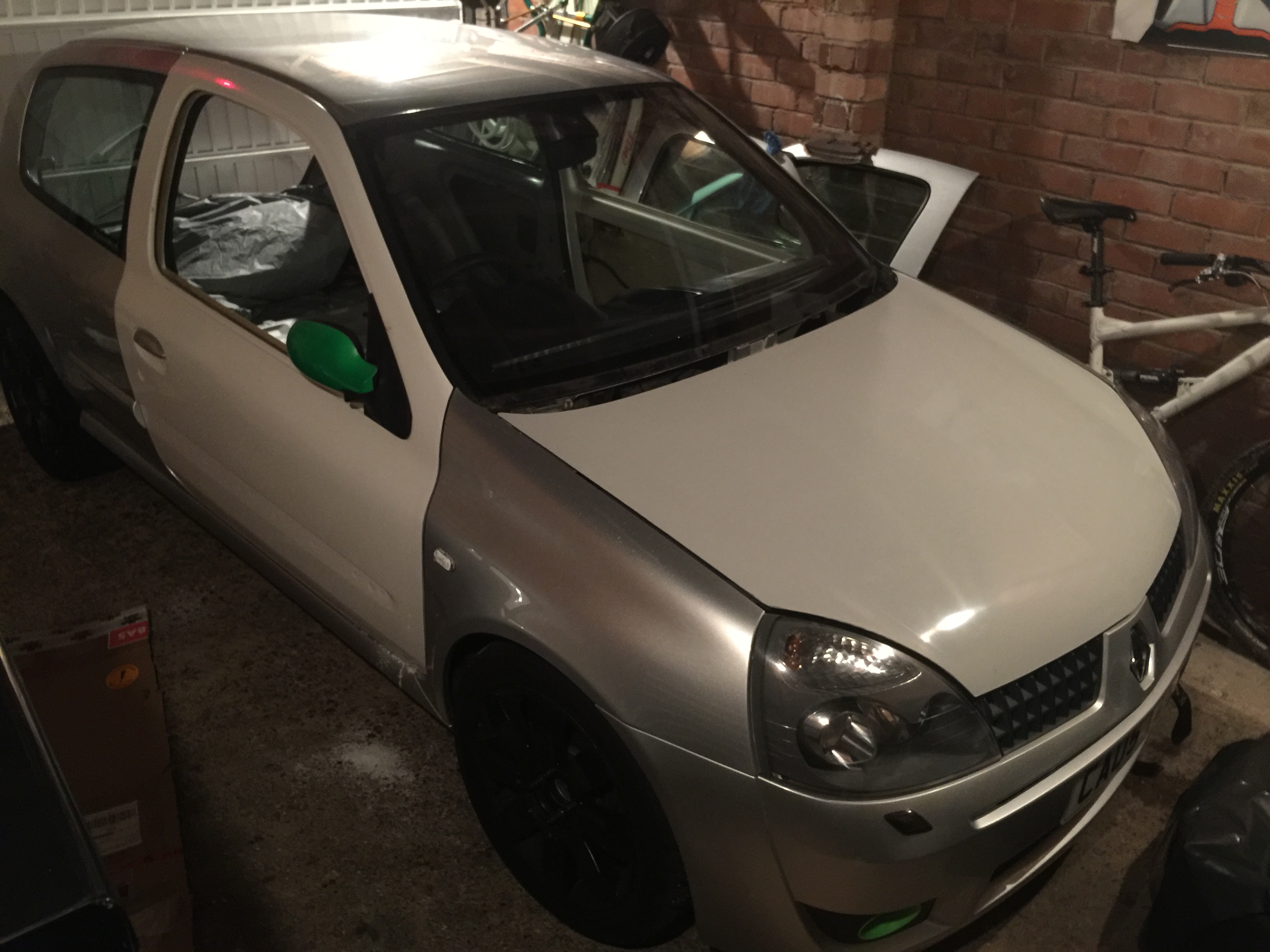

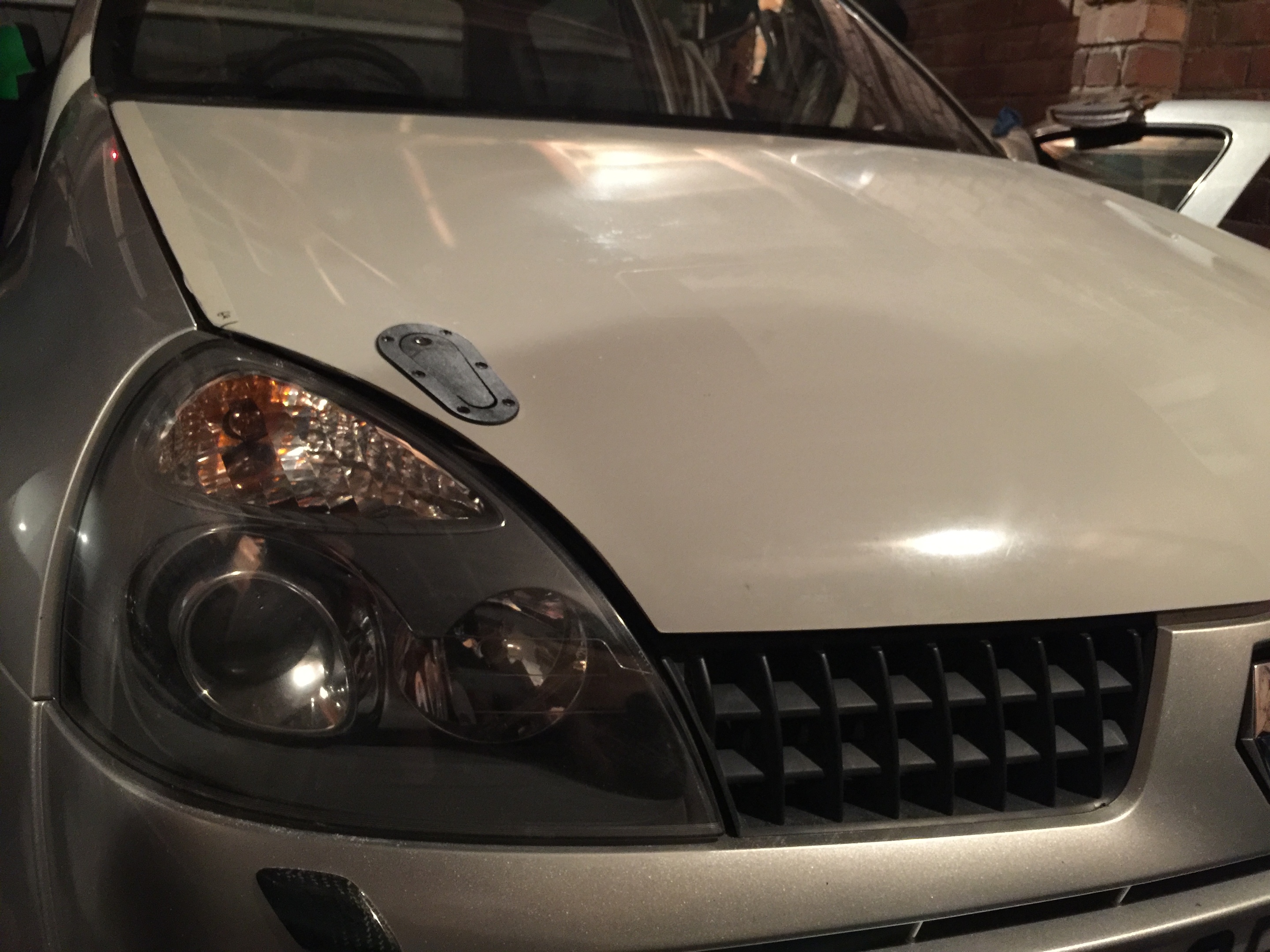

I have also fitted the doors and bonnet to the car and this is what it looks like at the minute (they will get painted later on in the build when the car comes back from the cage company) I must admit i do think it looks a bit funky with the colours going on haha.
The bonnet and boot will both have a set of aerocatches fitted to save weight on the latches and they look cooler :) I haven't fitted the boot yet as i haven't had chance but i am hoping to do it in the next few days. Heres a pic of the boot looks really good and doesn't weigh anything in fact none of the panels do very happy with the weight saving on them.

Just a little update on the little Clio we have managed to fit one aero-catch to the fibre glass bonnet and very happy with how it came out :smile:
I love your brake ducts mate! They look really smart! The colour combination looks surprisingly good! Nice to see you are doing a proper job!
Thank you very much I am really happy with the colour combo how its come out
