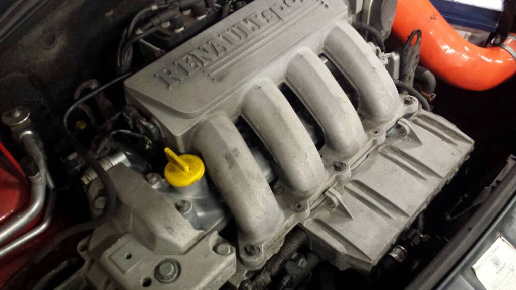

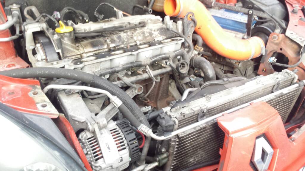

So then came the time to head up the A1 to Durham to get them put in and have the full service. Andy was a really nice chap and his work all looks spot on plus his prices are very competitive.
The drive back was interesting. The car sounded well but it was a bit of a pain to drive due to having a bad habit of stalling all the time at lights and kangerooing badly around 1500-2000rpm. This went on until Saturday just gone and was a b**ch to drive on my rush hour commute and had me wondering if I'd made the right choice...

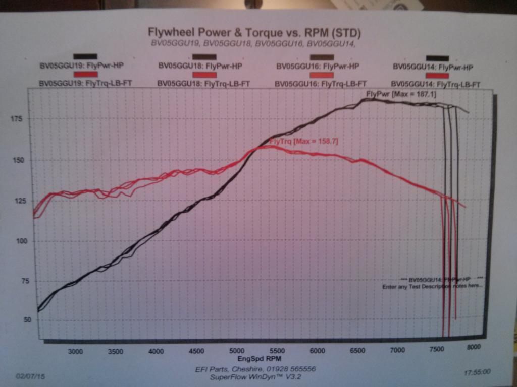

Then came my 1st mapping session by Chris (
@Scoff ) at EFI Parts. There was a slight problem with this from the off and that was that the bean had an RSTuner map on it which because I no longer had the tuner was a bit of a pain because of it's encryption/checksums etc. After a few hours of freezing we had to call it a draw while Chris had some time to think about the best way forward.
Roll on Saturday just gone and a few more weeks of the car being a pain to drive and I was back at EFI. After swapping out the ecu with another and then swapping a troublesome lambda sensor he finally had success with it and the result is below. I can't thank Andy and Chris enough for all the effort they've put in and would highly recommend them to anyone.
As for the 197 cams, I'm delighted with them so far for the cost. The car just pulls so much better once the revs build a bit. They really have made a positive difference. Unfortunately because of the way things panned out with the bump etc I didn't get chance to RR before but I'm happy with the result. It's a good 20bhp up on my old 172 now and it really shows
