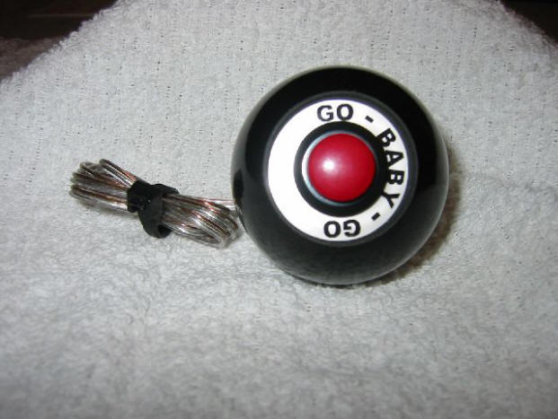

Heres a little hint lol:
Its a wet shot of nitrous from WON with 50bhp (60 lb/ft) metering jets fitted. I've been told the engine could take 60bhp but i'm keeping it safe. And for any doubters to the efficiency of this it is something else. Totally transforms the car into an animal on the straights, addictive lol.
