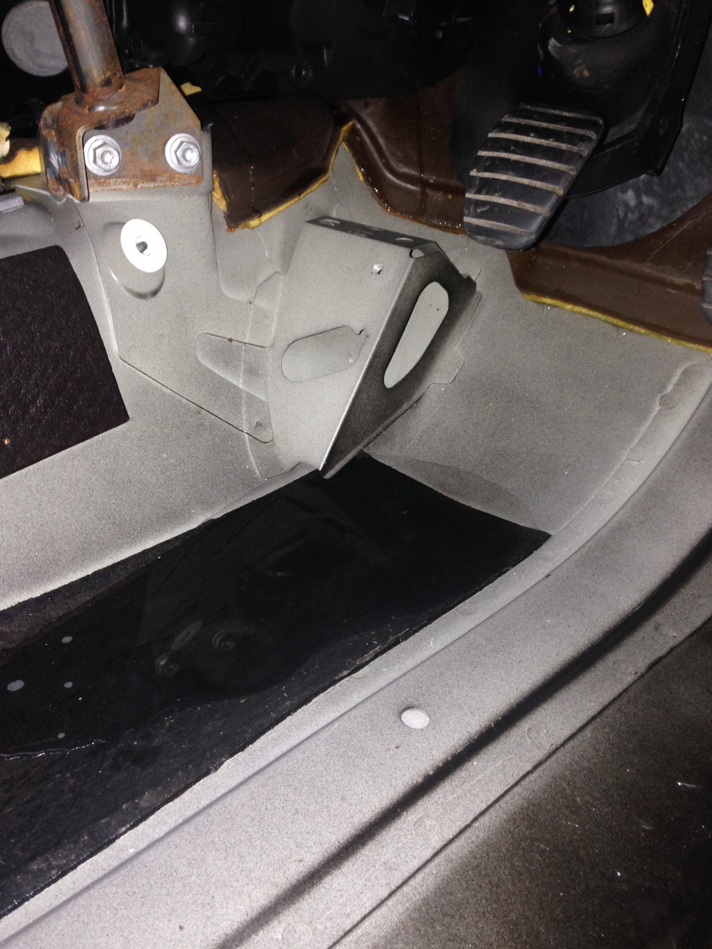

my cars a swimming pool. Where's the Central drainage! Argh
Where the fxck is the central drainage hole? It's got to be this one. The drivers side one is fine, goes straight through, passenger side is fine and not even the tiniest bit wet on the inside. Drivers side...
As you can see I've ripped everything out.

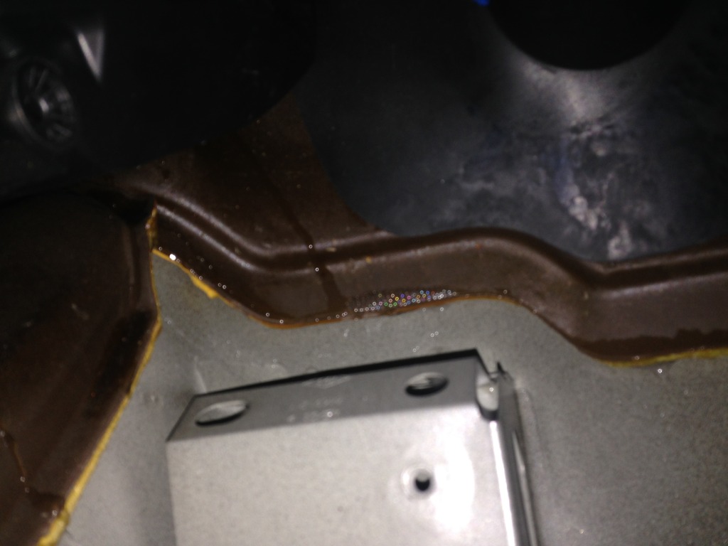

The leak is now from here..
It's the Central drainage hole right? It's not flooded behind the engine it's just got abit of water stuck. So it's the hole?
This is on the 1.4. I've re sealed the sun roof. OTT around 2 weeks ago. It's now this! ARGH!

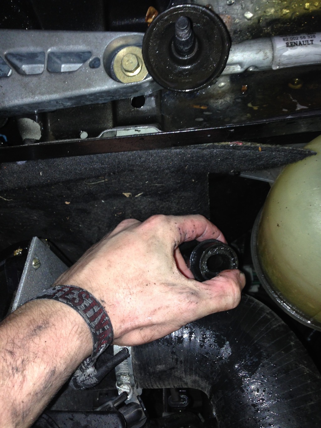

Found the fxcking piece of s**t!
So angry! But triumphant! Gave that ^ a wiggle and everything poured out like a river. Was faffing around fingering in the scuttle for eternity. It was soaking wet too ;)

But! For people reading. The centre drainage tube literally flapping down behind the engine was pinched against its exit. It's worth checking it now and again, give it a wiggle otherwise your whole drivers side is gonna be a literal deep river fxckibg up everything.
