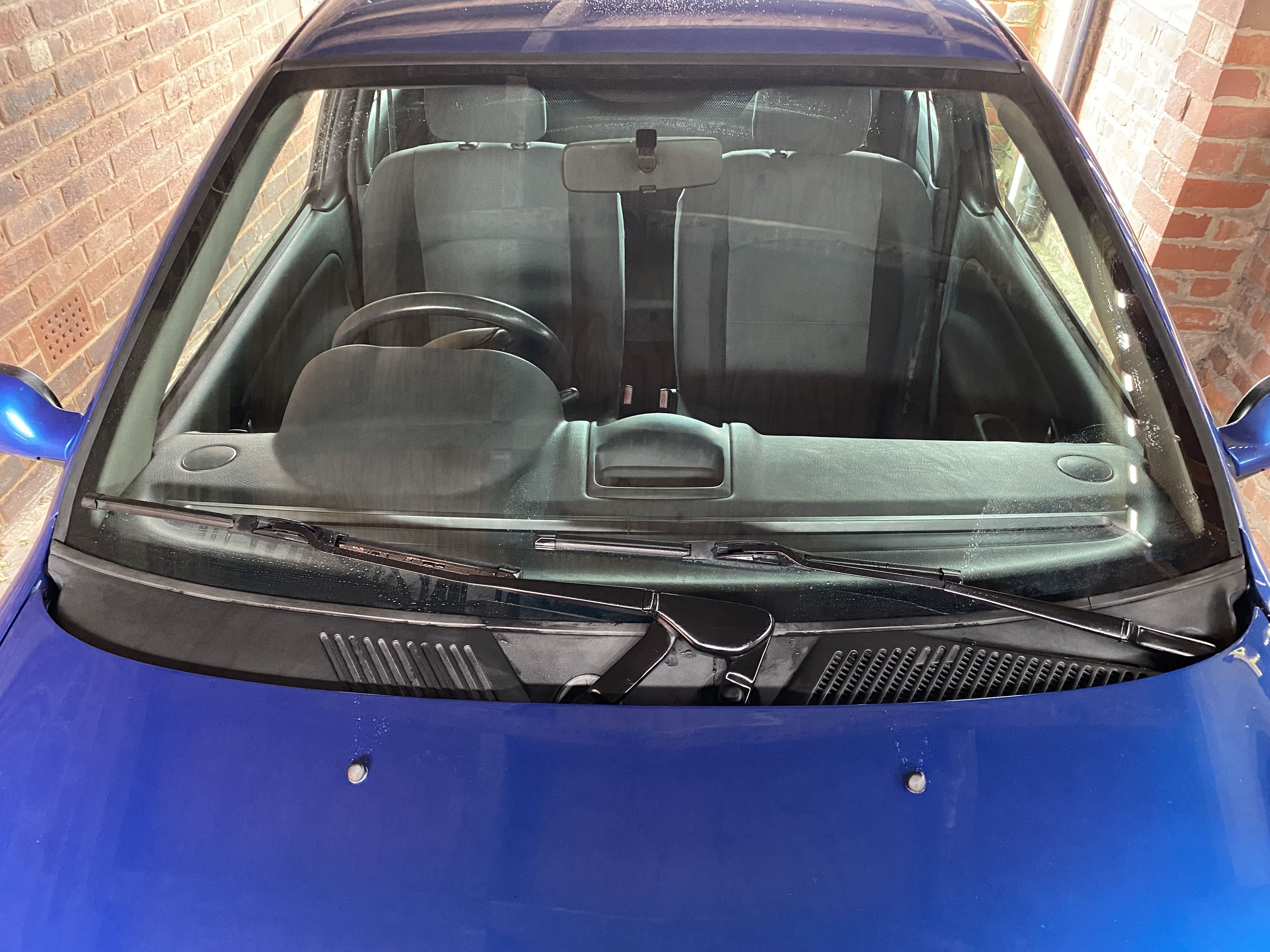

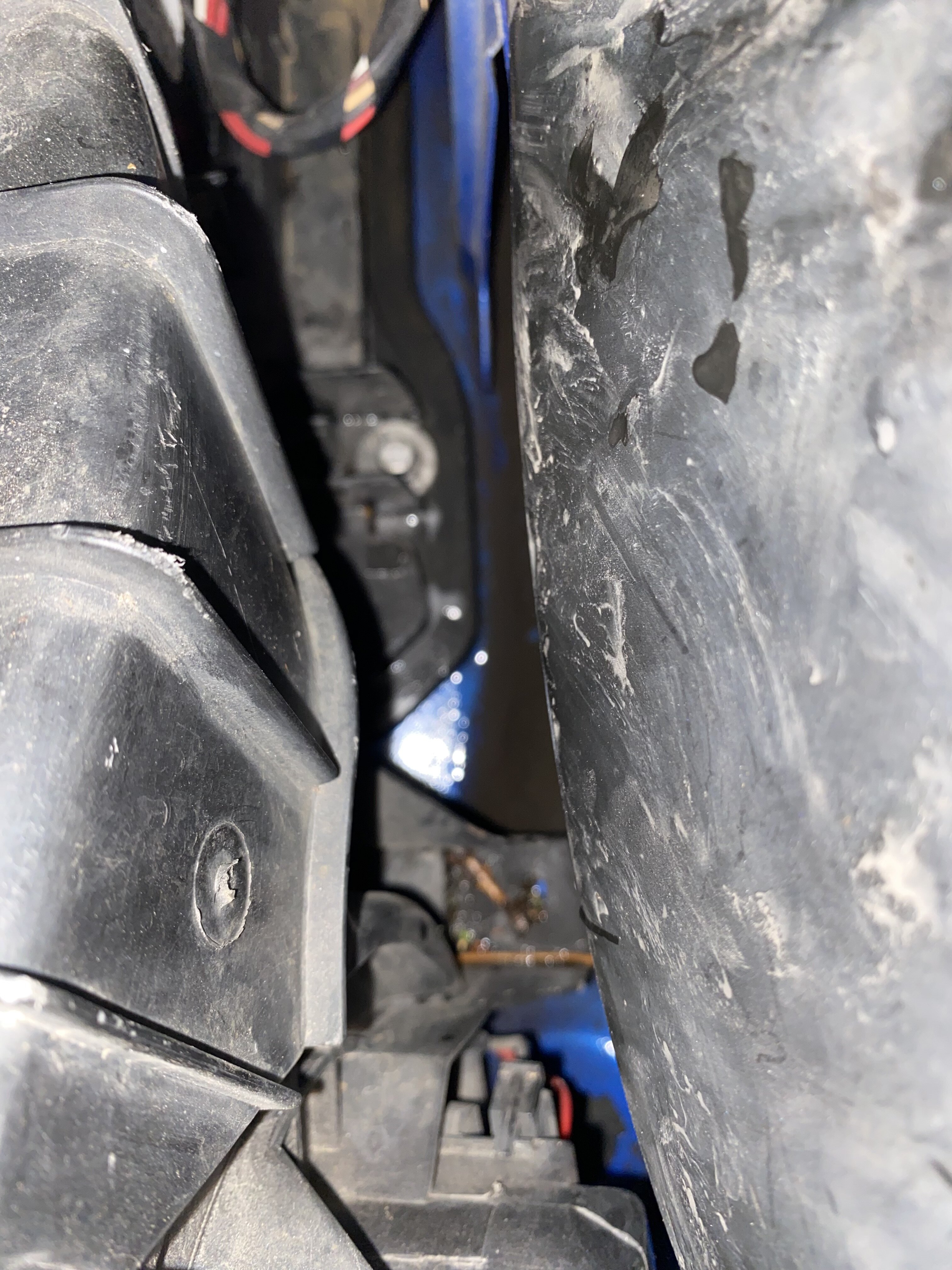

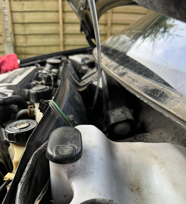

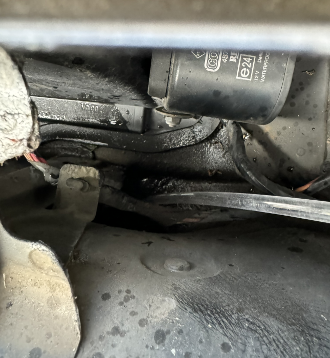

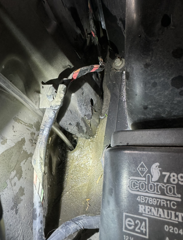

The left side looking towards the windscreen is the one I'm least familiar with. It looks a fair bit different to mine there? Easiest way to test is to get a bottle of water and pour some in - it should piss out behind your driver's side front wheel.
The centre hole is roughly where that first wiper rubber is pictured - I did an image on here a while back, I'll get the link in a sec.
The far right one is underneath the washer bottle, iirc. Again, pour some water in there and it should easily flow out behind the passenger side wheel.
The centre one is just to the right of the mounting bulkhead for the wiper mechanism. I've got a clear plastic tube in this image leading down into it.
Thanks for the info guys. I’ve poured water down different holes to see what happens. Standing at the bonnet looking at the car, the left hole no problem, the next one to the right no problem, and the far right one underneath the washer bottle, no problem. I cannot for life of me see a centre hole anywhere. I’ve had a poke around with a flexible plastic tube and had a good look but I can see nothing. From the photo you can see how much water is left after it has drained out from the second hole along. It’s only a little bit and I think with movement of the car, it would probably all come out.
Without taking off all of the wiper mechanism, which I really don’t want to do, are we sure that the Cup has this hole as everyone thinks?
All sorted. I stuck my phone down the gaps and managed to match up one of the photos with one that Darren sent. One coat anger death later and some water started to trickle out and I could actually see where it was coming from. I had no idea that the pipe was behind the insulation. I managed to open up the rubber flap And pull out probably a decades worth of s**t. Now everything is draining as it’s should.

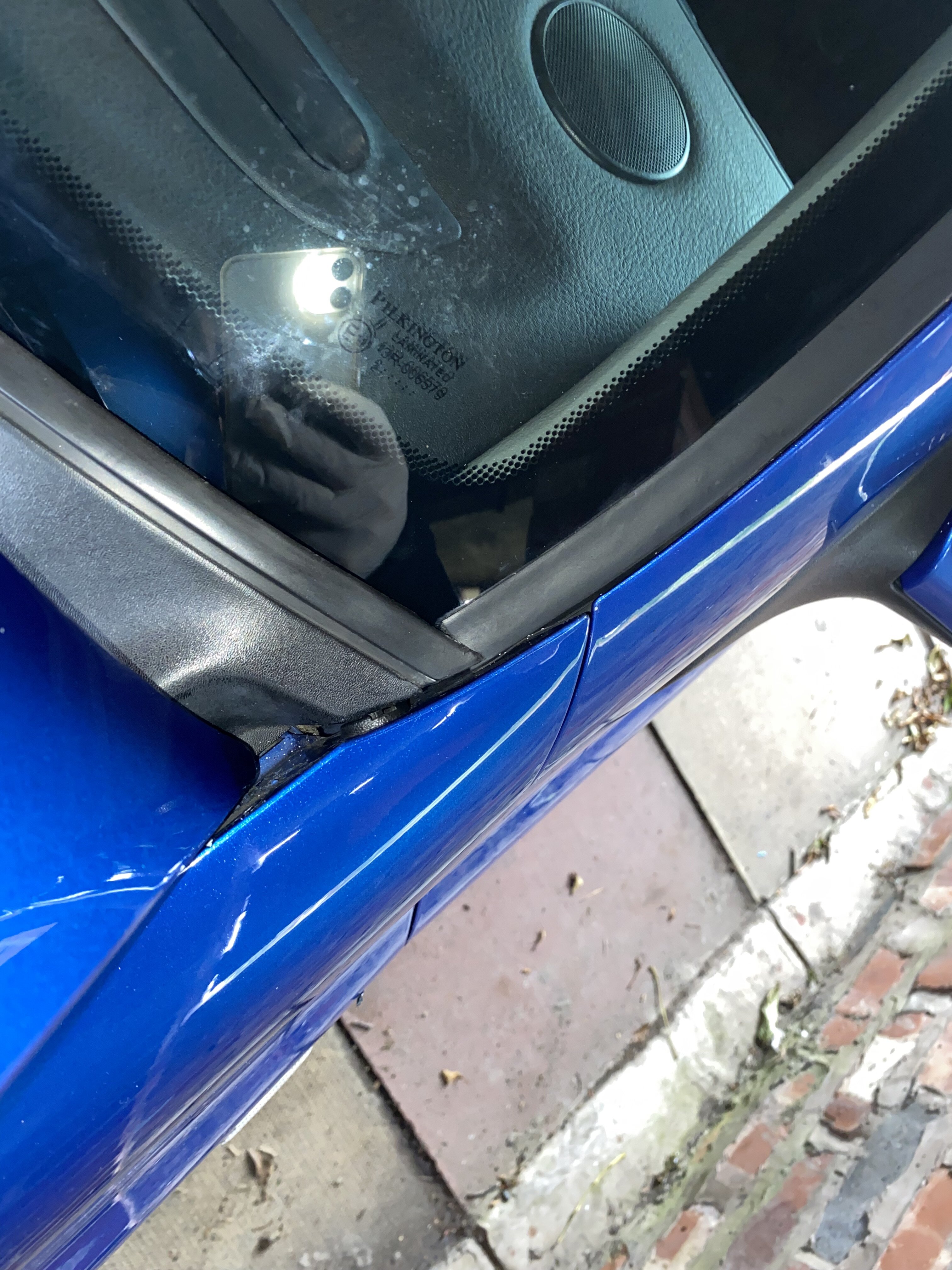

I took the wiper arms off and gave them a bit of a tarting up yesterday. I’d rate the quality of this work 7 out of 10 as I was doing it on top of a wheelie bin. Not ideal. I’ve managed to find and do a semi-repair for the scuttle panel where it meets the windscreen. I think lots of us have had trouble trying to keep this piece as flush as possible to the screen and this is the best solution I can come up with as the original plastic clip is long gone. It sits much better than it did before and considering the condition of the rest of the car this is well passible. Now that’s all of the scuttle panel drain holes are running free I’ve got no worries about this.

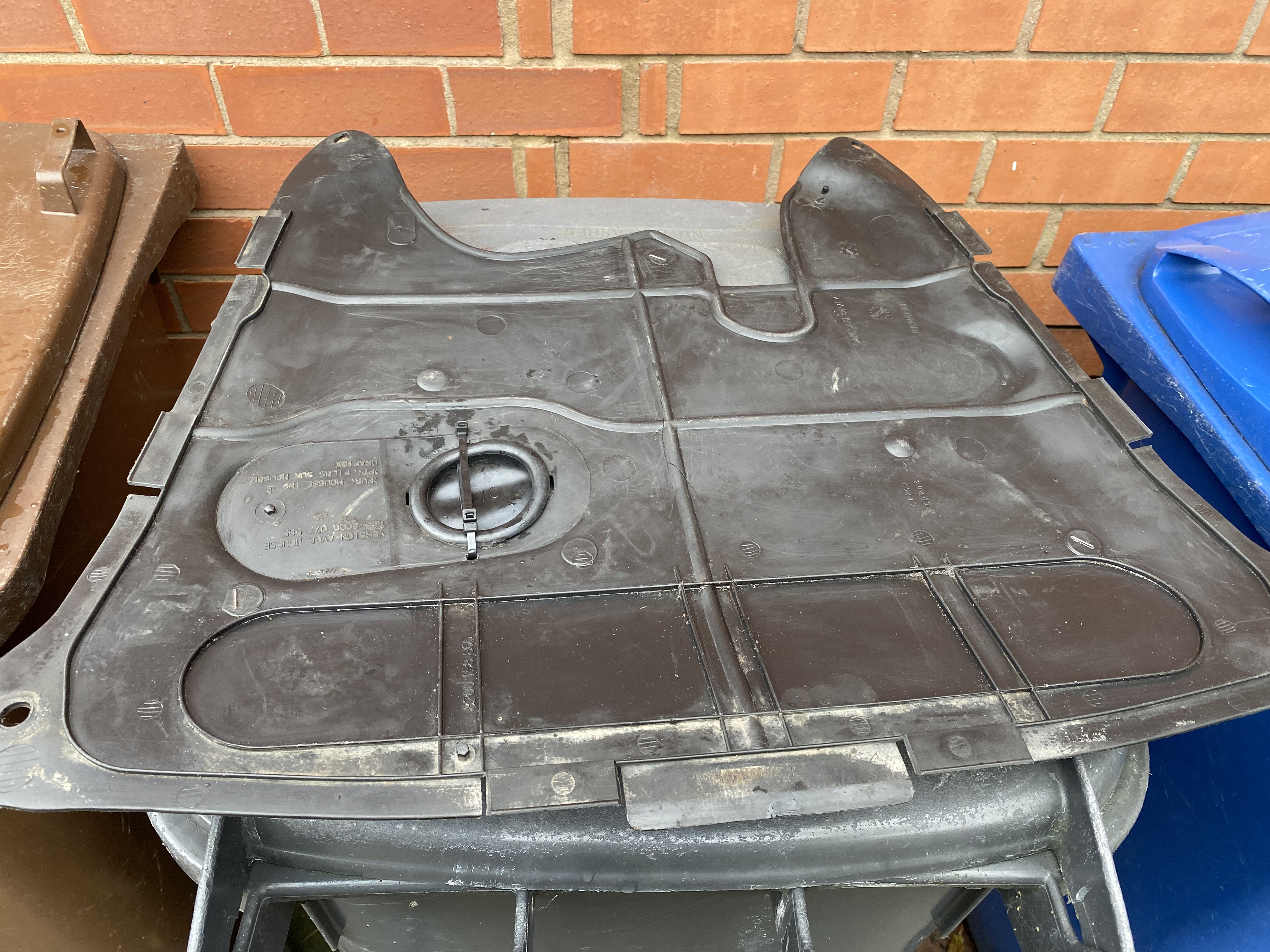

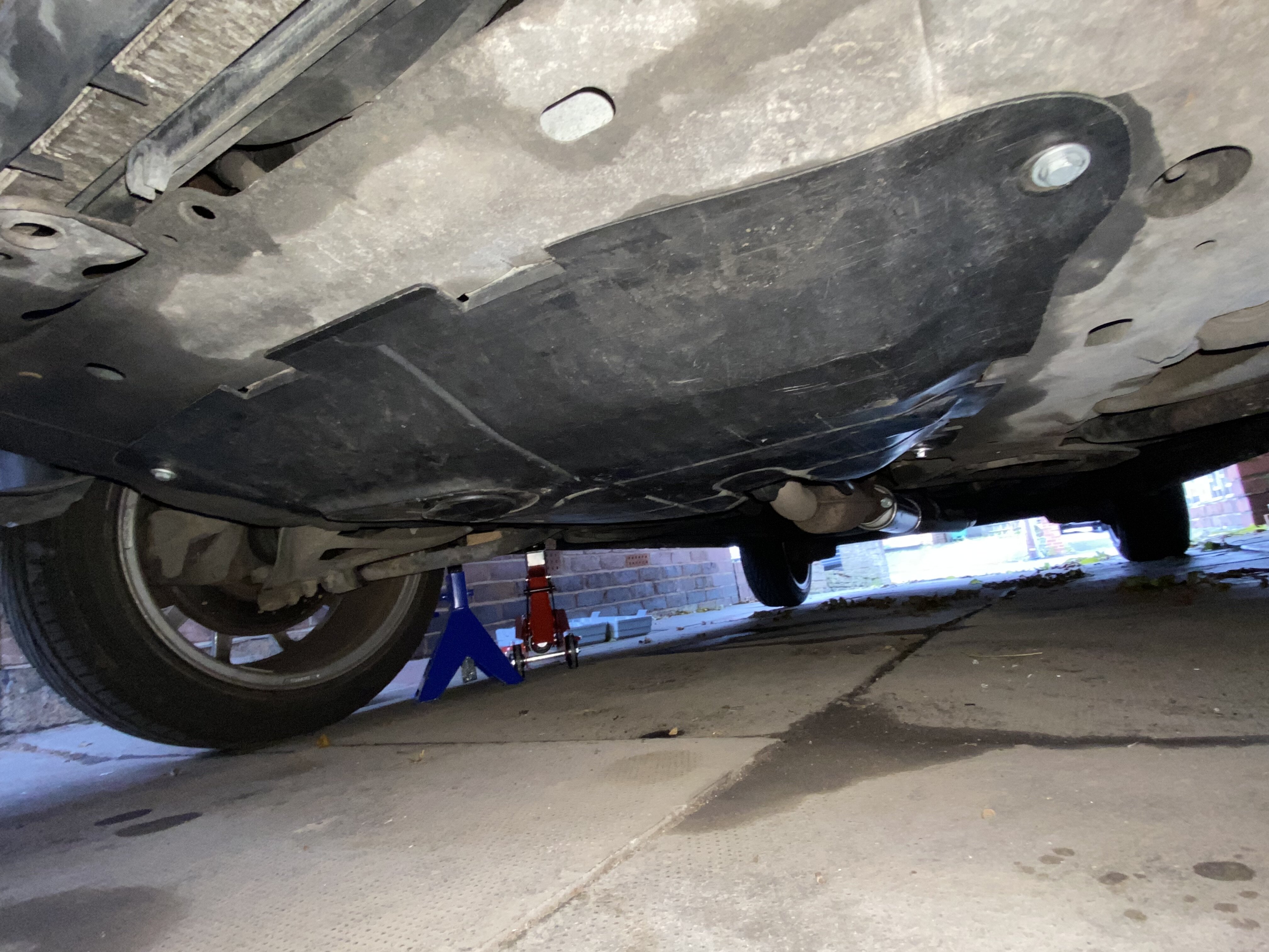

Next was to clean up the cheap under tray I got off FB knobhead place and fit a rubber grommet that doesn’t belong. I think this needs fitting after the bumper goes back on.
Yeah - as Matt says, it connect via four bolts to the subframe. Just a little elevation is enough for you to reach under and have access to all four bolt points - the front two being the easiest. I've got some small plastic shallow ramps - which only lifts the car by about two inches off the ground - but a lot easier than faffing about with the jack. Make sure that you clip on the undertray around the edges of the subframe before screwing it in - there's three sets of 'lips' on the edge of the tray itself.
As ever, worth just dipping the starting threads of the bolts into some copper grease to make them easier to remove again in the future.
One saved undertray back on. The bolt hole threads were ok…..apart from the last one I did. It’s stripped! I’ve used a longer bolt but it’s hardly gripped. I’ll have to find an Acme nut that will fit.

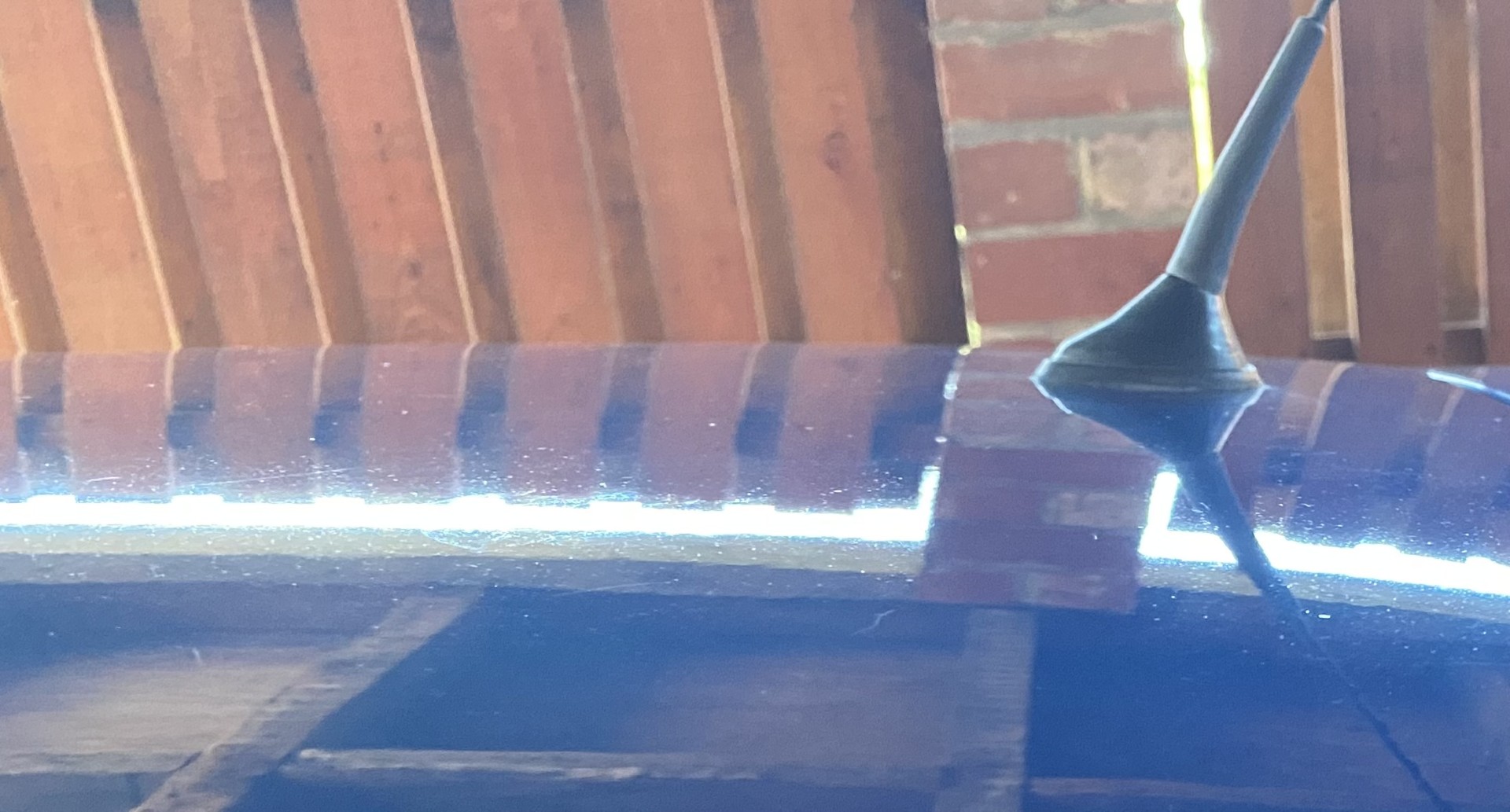

I also gave the roof another cutting polish but I think it'll need a full wet n dry and then a full polish to bring it back. It's smooth but there are millions of little marks in the lacquer. The photo should show it better.

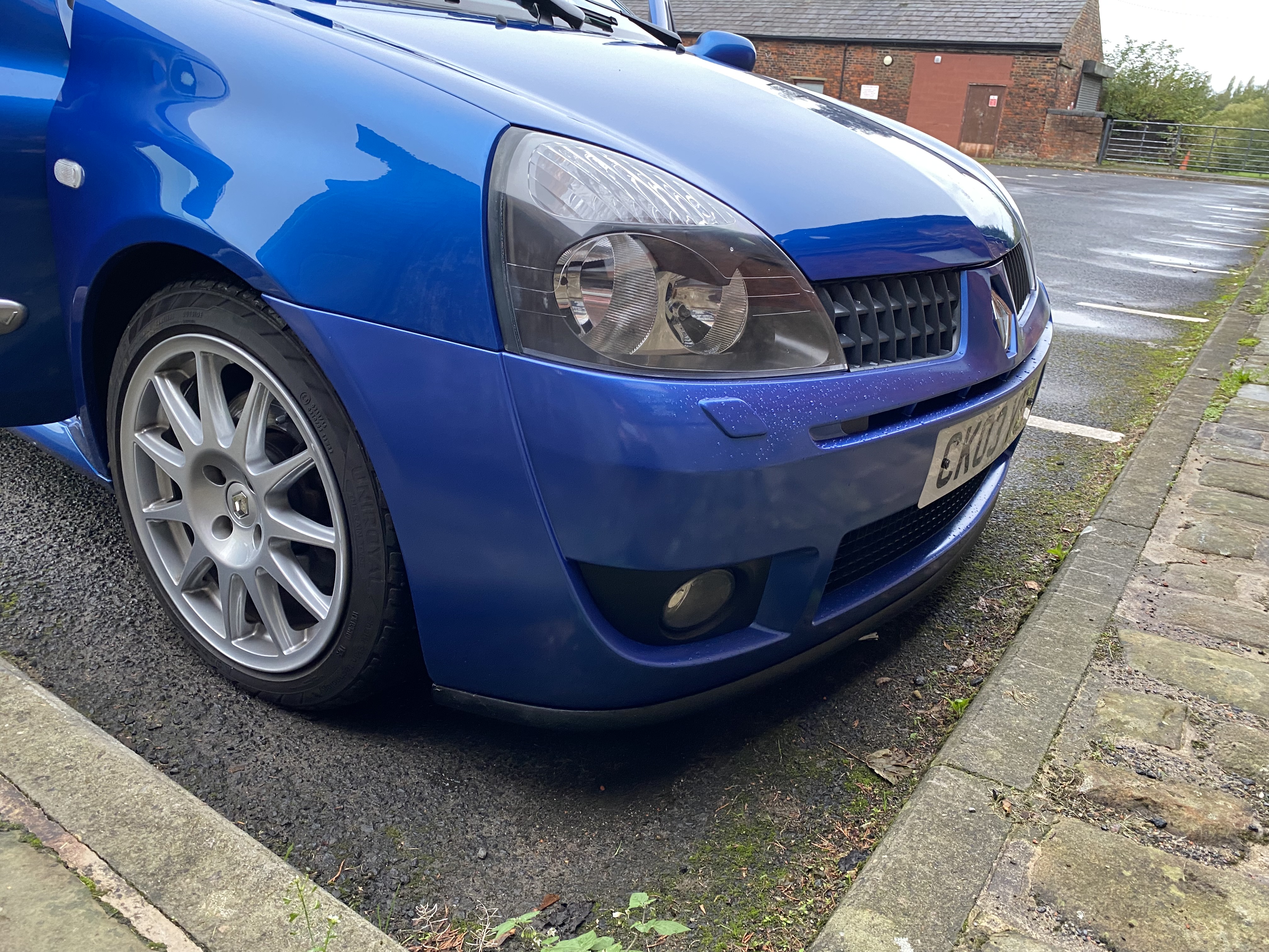

As for the bumper......well the traffic is bad here so i'm not taking the car out just yet to see the colour match (it's under the carport) and I really can't tell if it's a good match or not. However it is it's better than before.. I bought the best paint that was recommended and did my best but it's not ideal unless you have a room to work in. And when refitting I can feel the stress on the bumper whilst trying to get it back into position and secure. It looks ok but we now know that the little kiss the car had in the past means it's difficult to line things up. If anything else happens to the front end I'll be looking for a new bumper rather than try to repair this one again.
Bonnet got a quick machine polish and the black stickers were added to the bumper before the plates went back on. A bit of that black trim gel bullshit was put on and the lights checked. I've had enough this week. Golf tomorrow and pics to follow eventually..
And here is the big reveal. I absolutely did my best to make this a good job. I’ve already documented the difficulties I faced and you can now see how it is turned out. I got the paint from Saint Helens Paint and it was the correct colour match. Even doing the best I could with this just goes to show that it’s impossible to match paint work up well if you don’t have the car to do so. From some angles and in some light the match looks very close, but I’ve deliberately taken these photos to show how different it looks from different angles.
The car will definitely have to go to a body shop to be sprayed up to get the correct match. I’ve already had a few recommendations from one nearby so I will be using those.

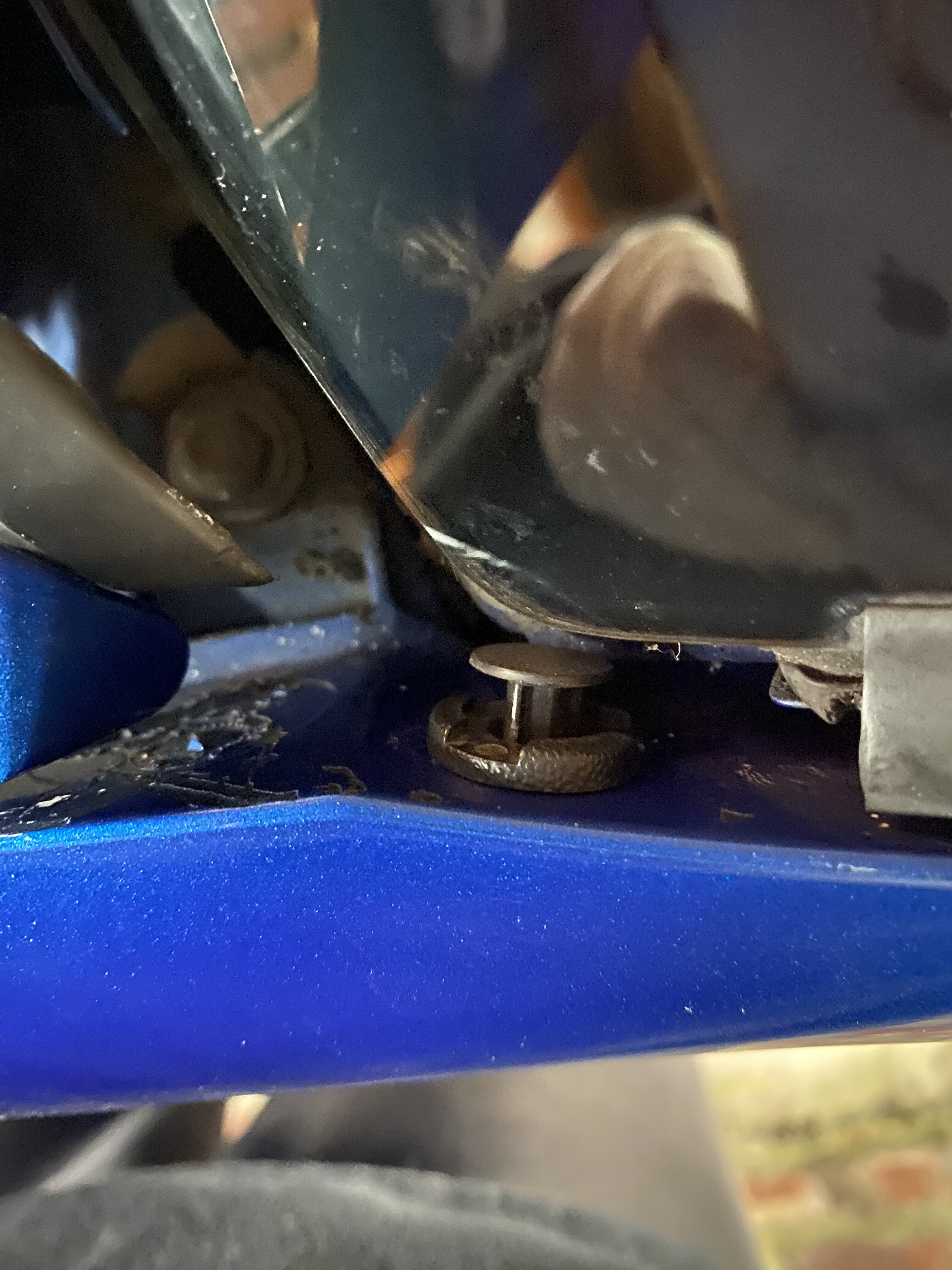

Removed the gold acme bolts and screws that hold the side skirts on and fitted silver acme bolts so everything is uniformed. I know the skirts are riveted but I bought the rivets and a cheap riveter and it just dissolved whilst using it. The bolts look fine even though they are not OEM and i'll fit the correct rivets if I ever have the skirts repainted.....and that won't be happening any time soon.

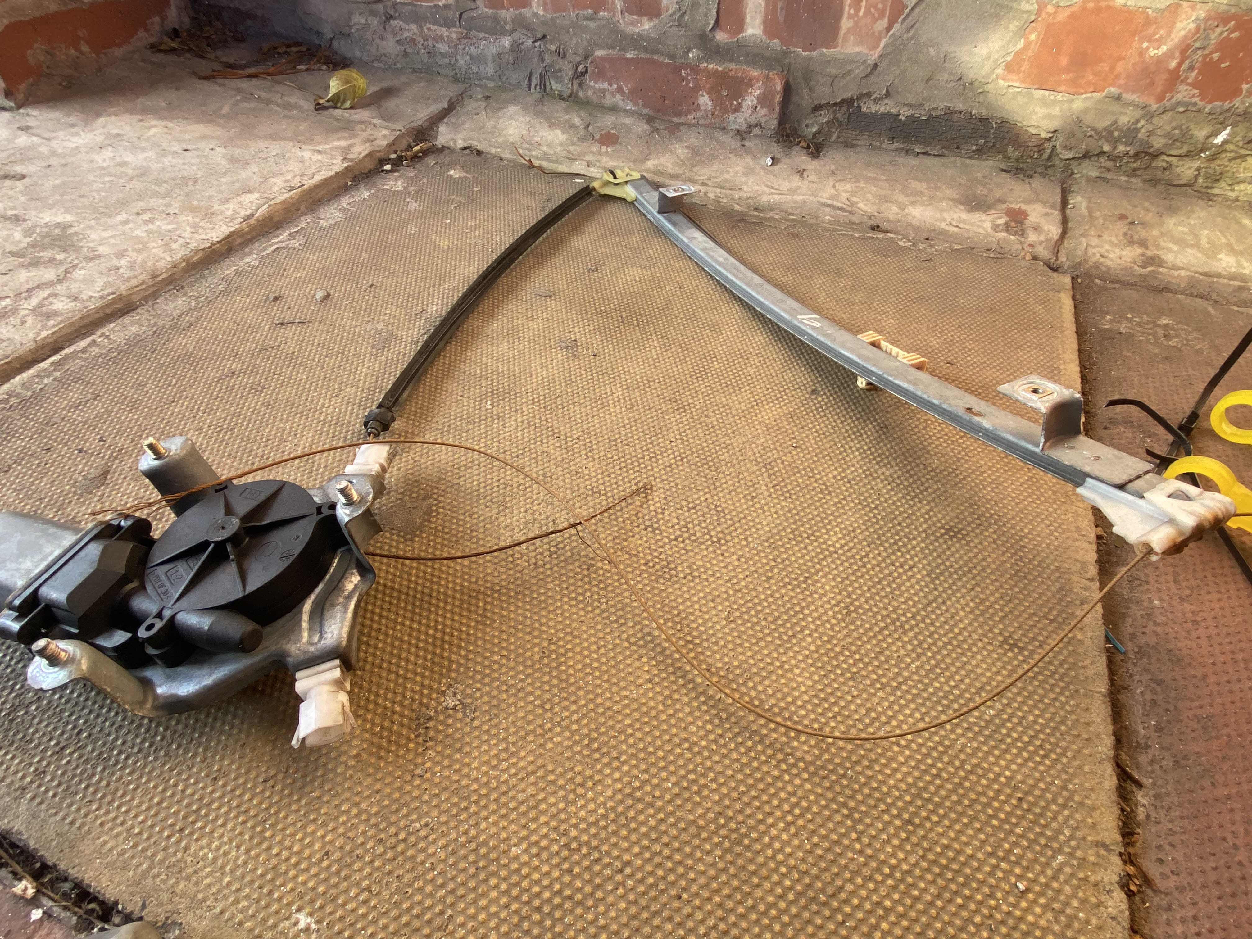

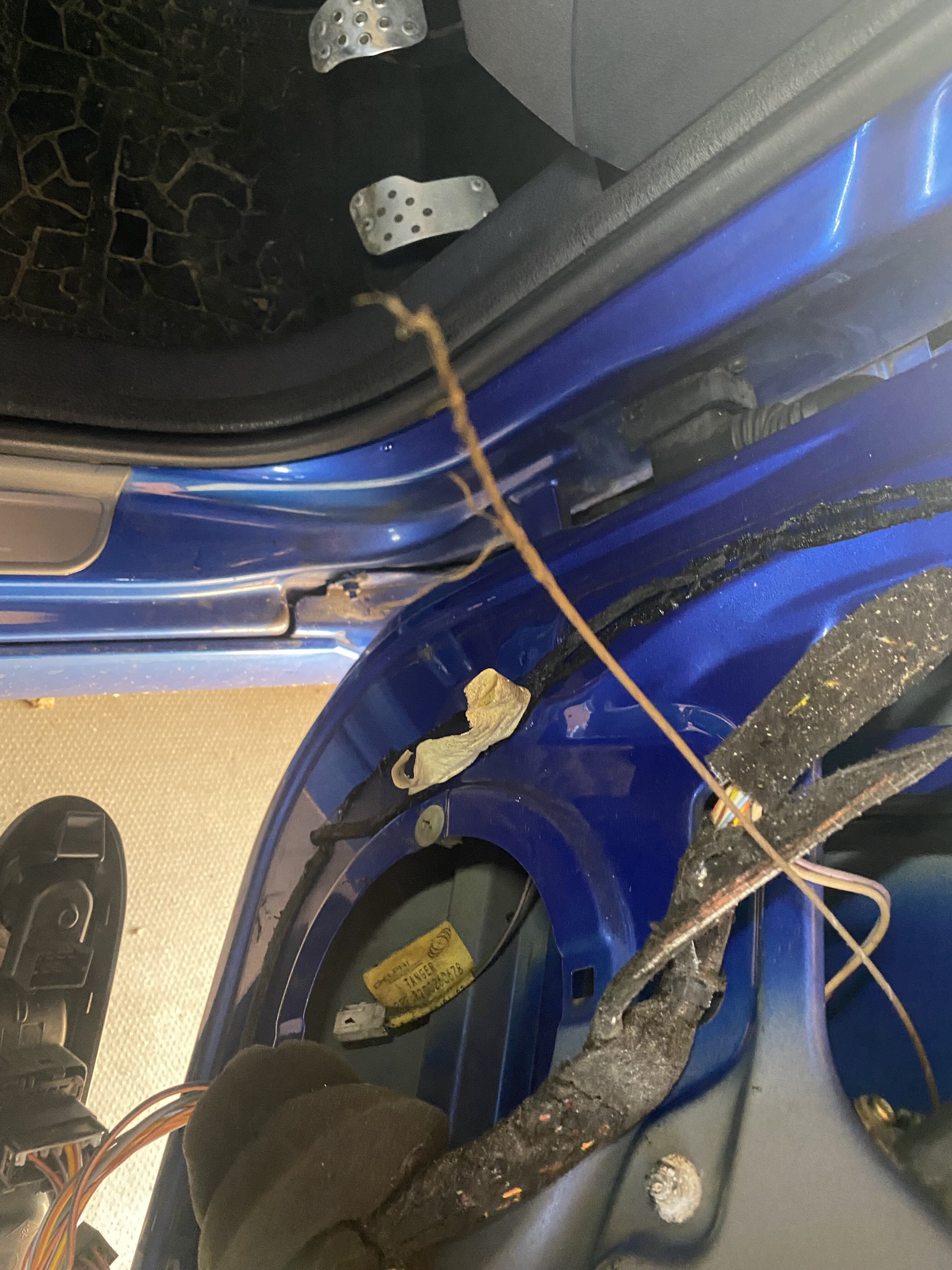

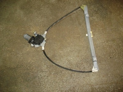

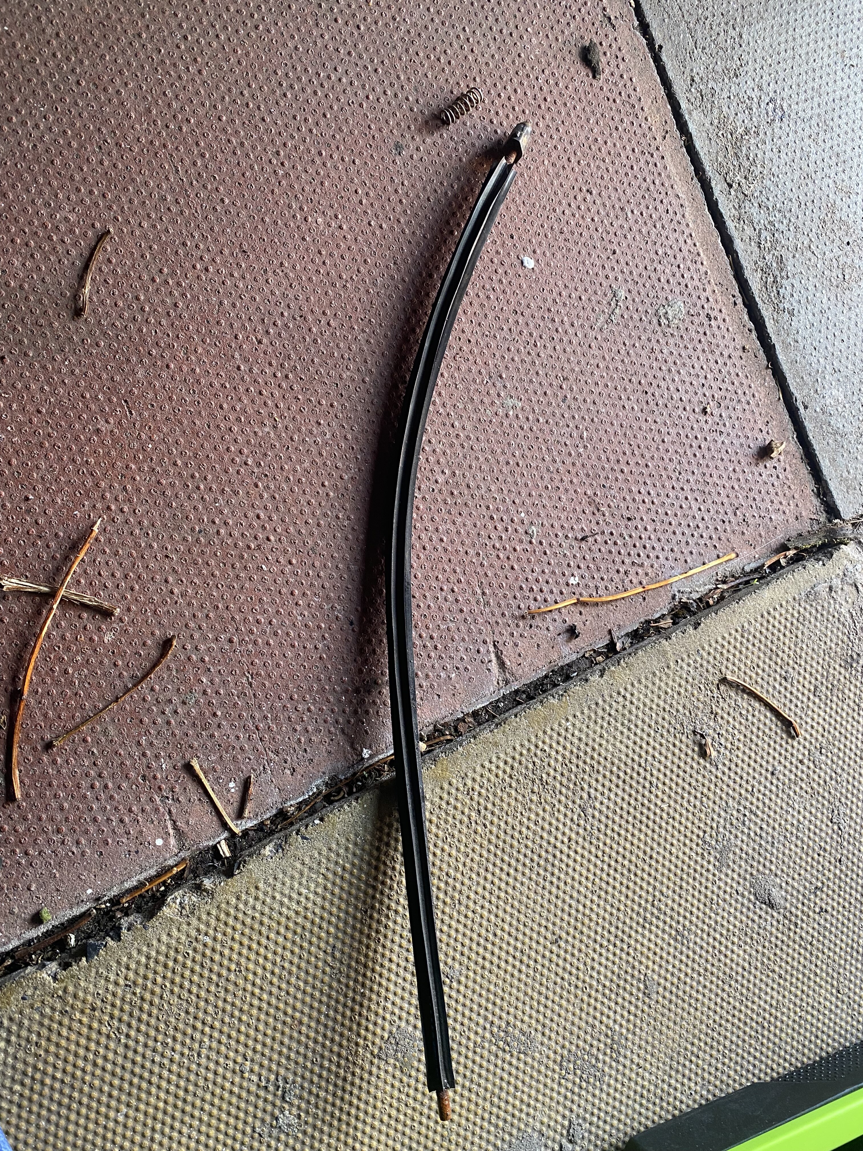

An issue cropped up last week. The drivers window suddenly made a grinding noise when being lowered and it struggled to close. I have this morning taken the door card off to have a look and found a broken piece of cable, a frayed cable end and a spring. Looking at a repair kit these seem to be from the cable of the regulator. The motor is fine as is the guide. I broke the top piece of trim that sits between the window and the door card and have posted up in the wanted section. I've also posted in the 'Interior' section about what repair kit I need and having a look through some older posts I struggle to see how to fit the repair kit. If you know please post a link. I feel a bit of a tit breaking the trim but it just exploded as I applied a bit of force to loosen off the door card from it's glue. I've left the door card off for now and just refitted the door handle and switch control panel.
Just buy a complete window regulator. Easy fix.
Mine did the same thing
I fitted a 2nd hand regulator today. The original had a broken cable as per pic.
Decided against going down the repair kit route as time was short. It’s a pretty easy fix but just remember to make sure that the bracket that goes through the hole in the window is as the bottom of its travel otherwise you’ll not fit the unit into the door. I ordered some new door card clips as once the door card is pulled off the originals are knackered.
I just need the top strip now to finish it off. The window works perfectly now and it’s much smoother.

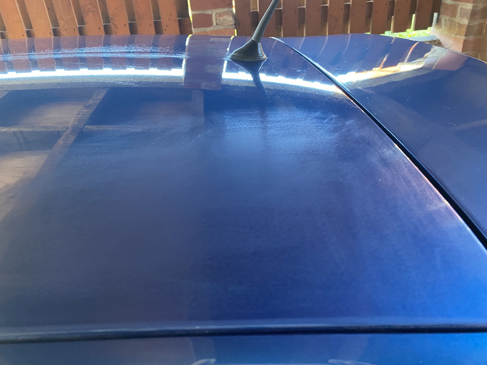

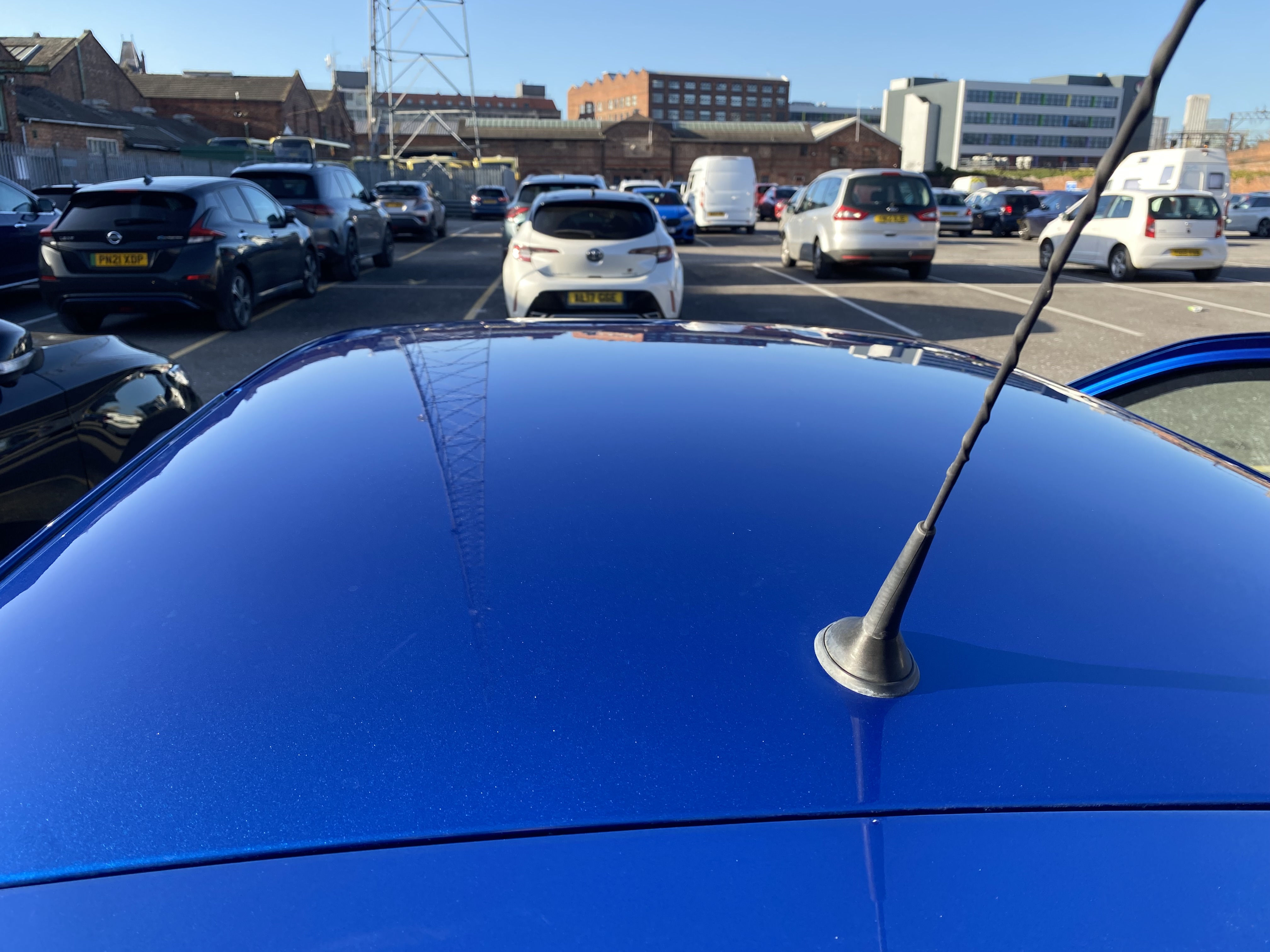

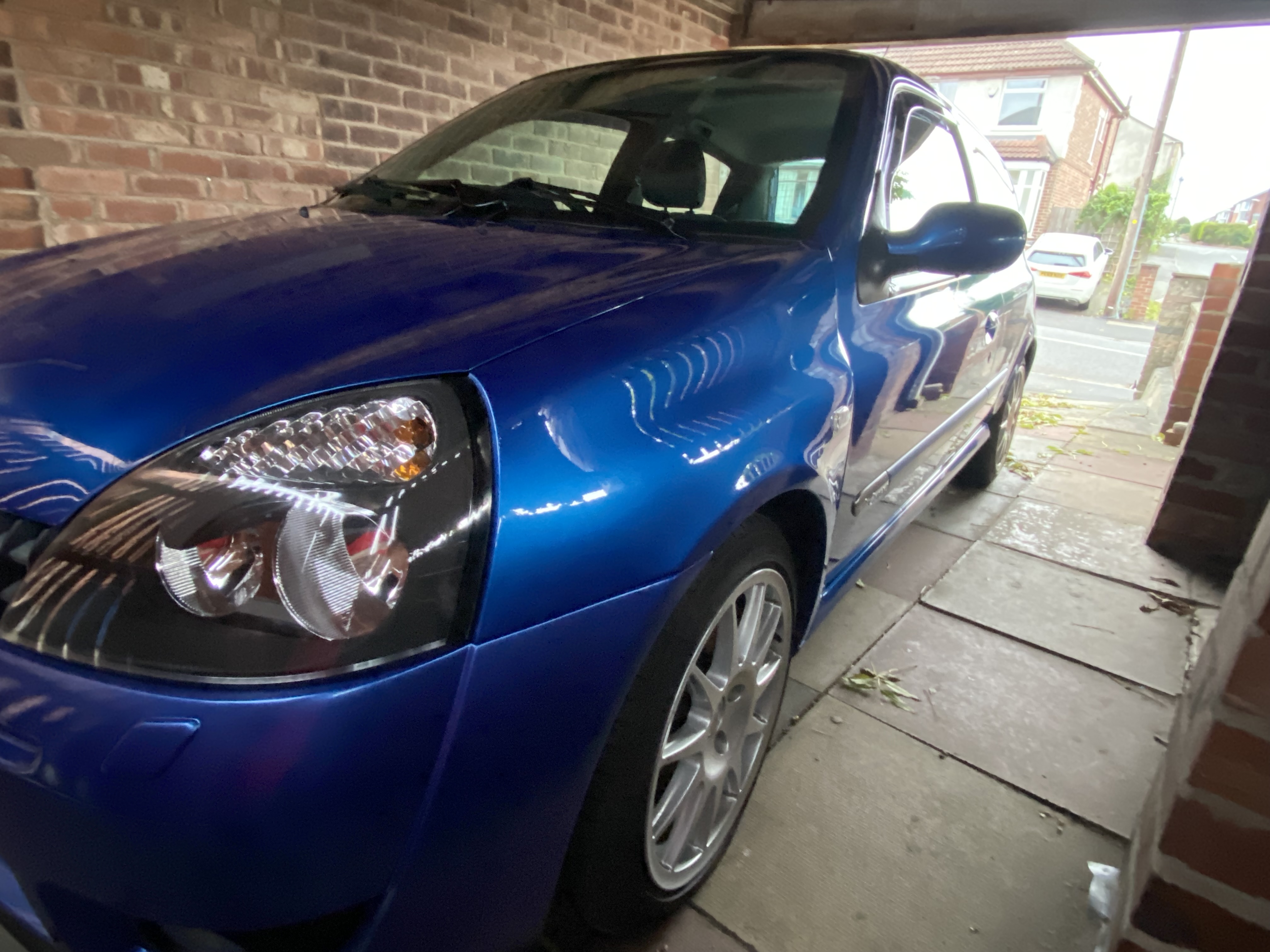

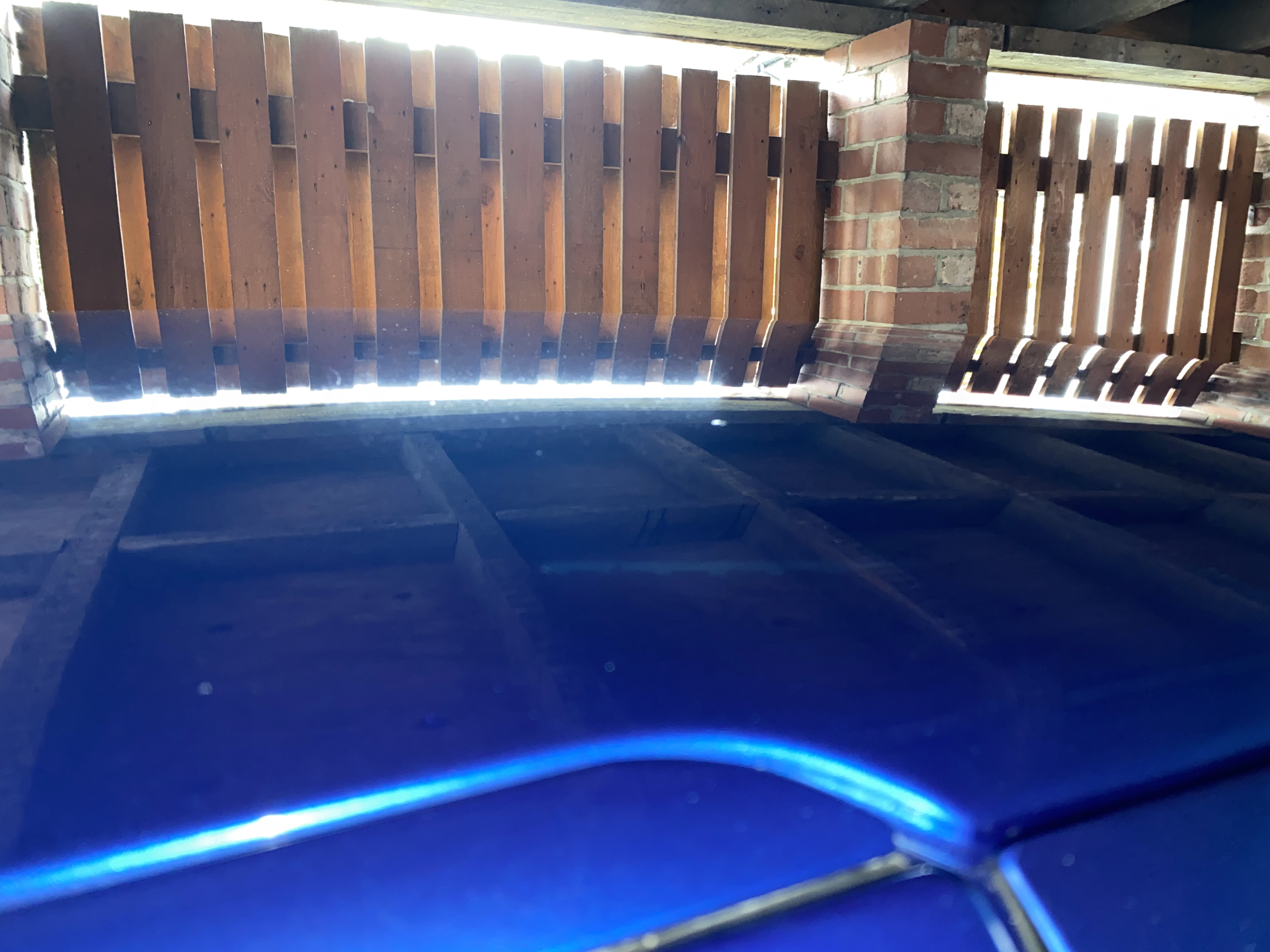

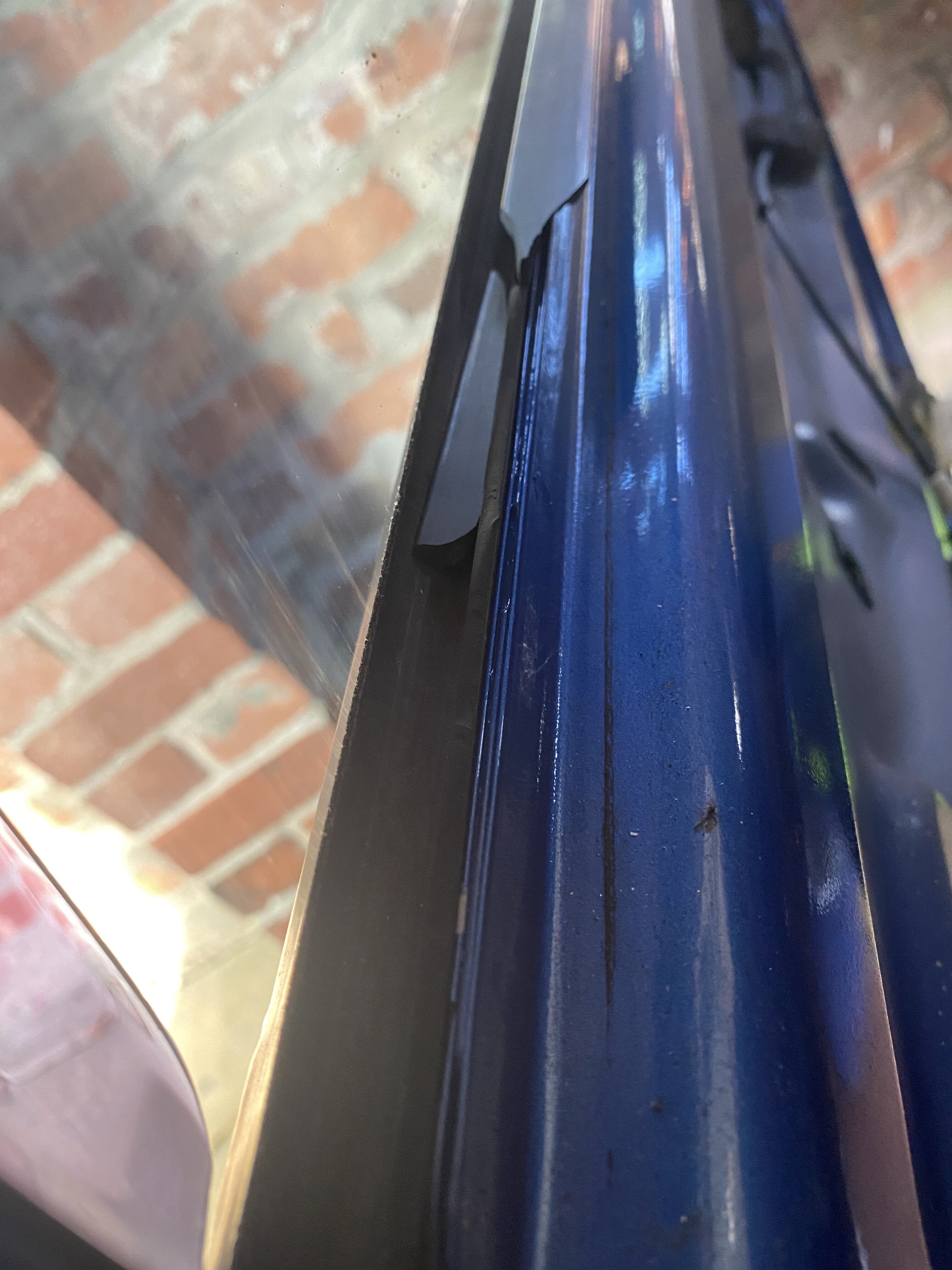

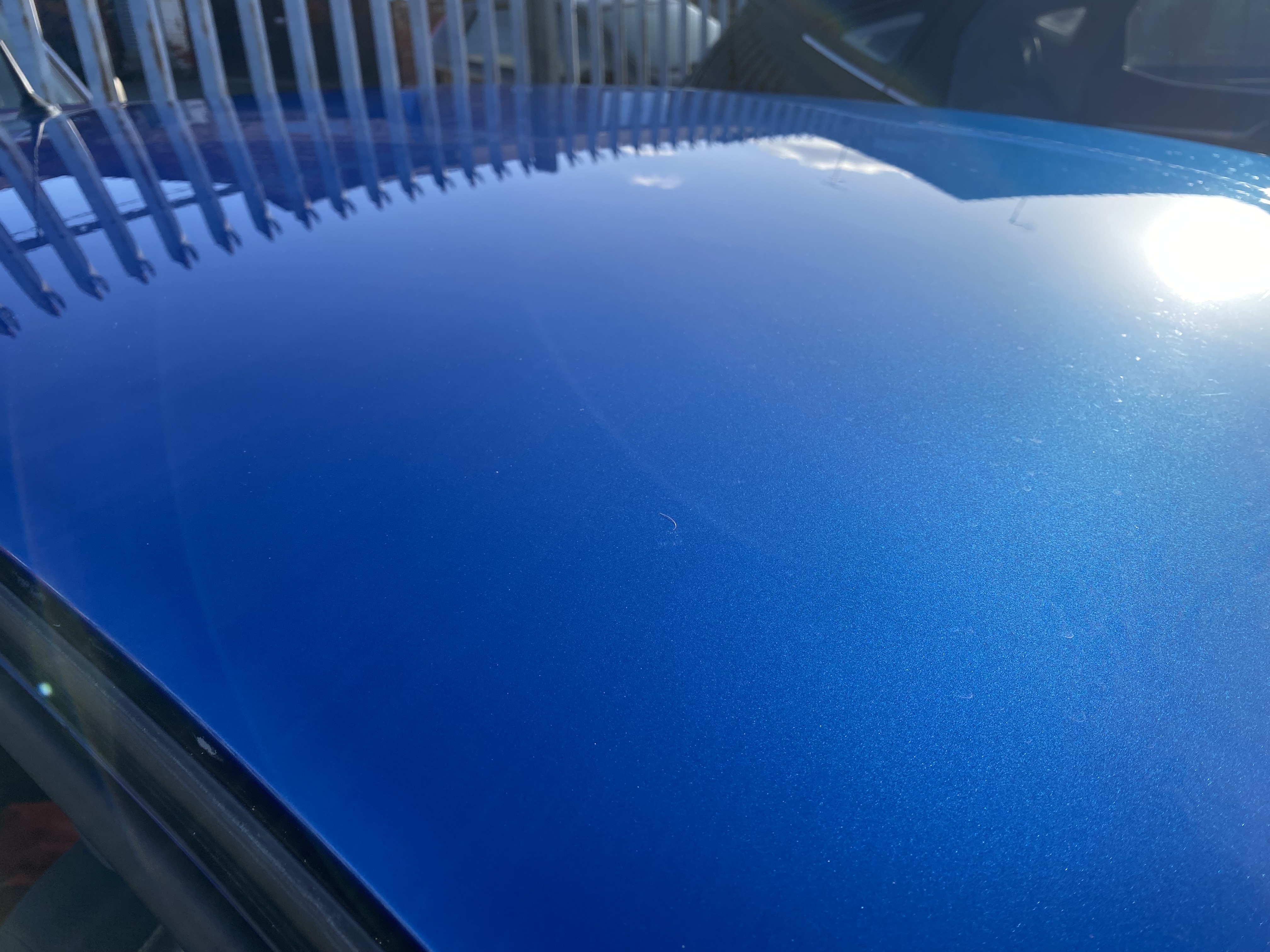

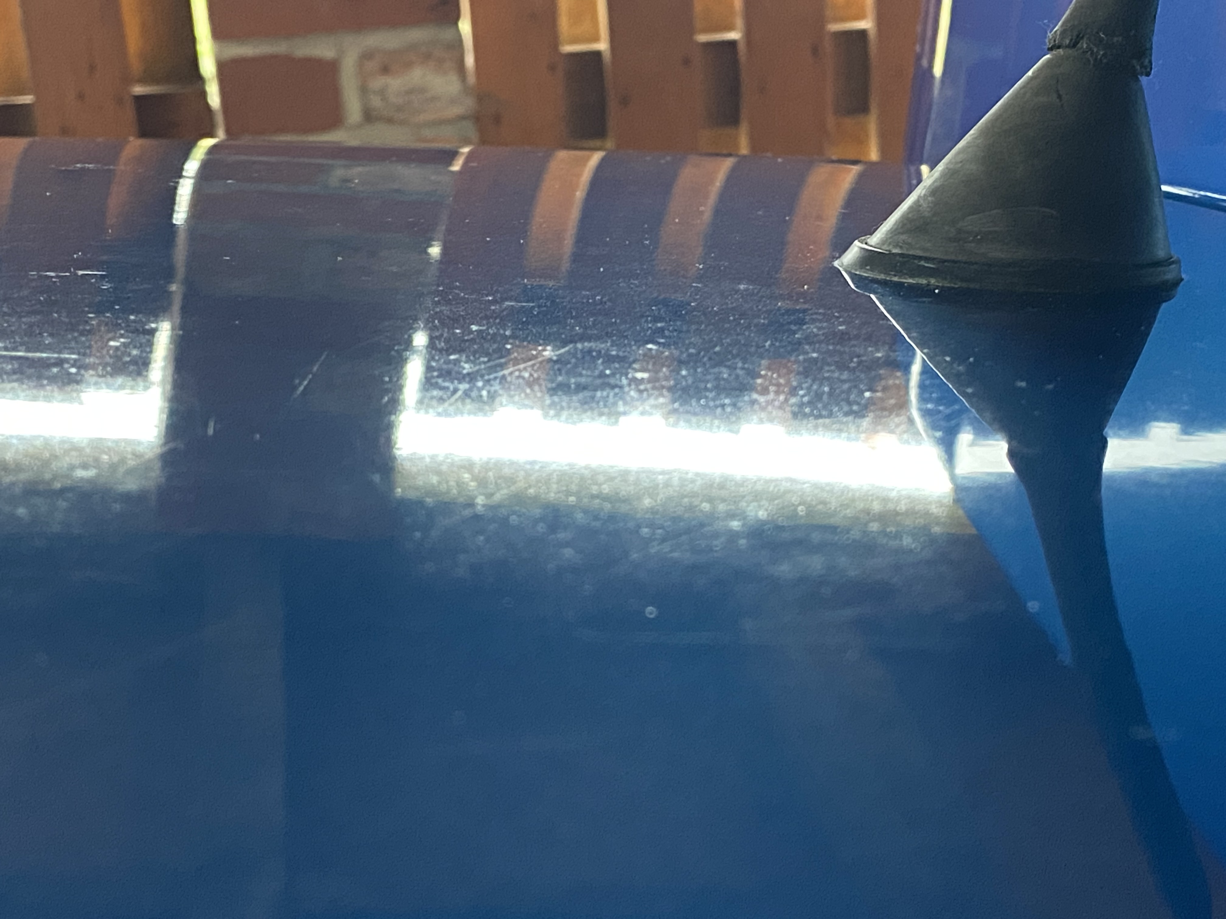

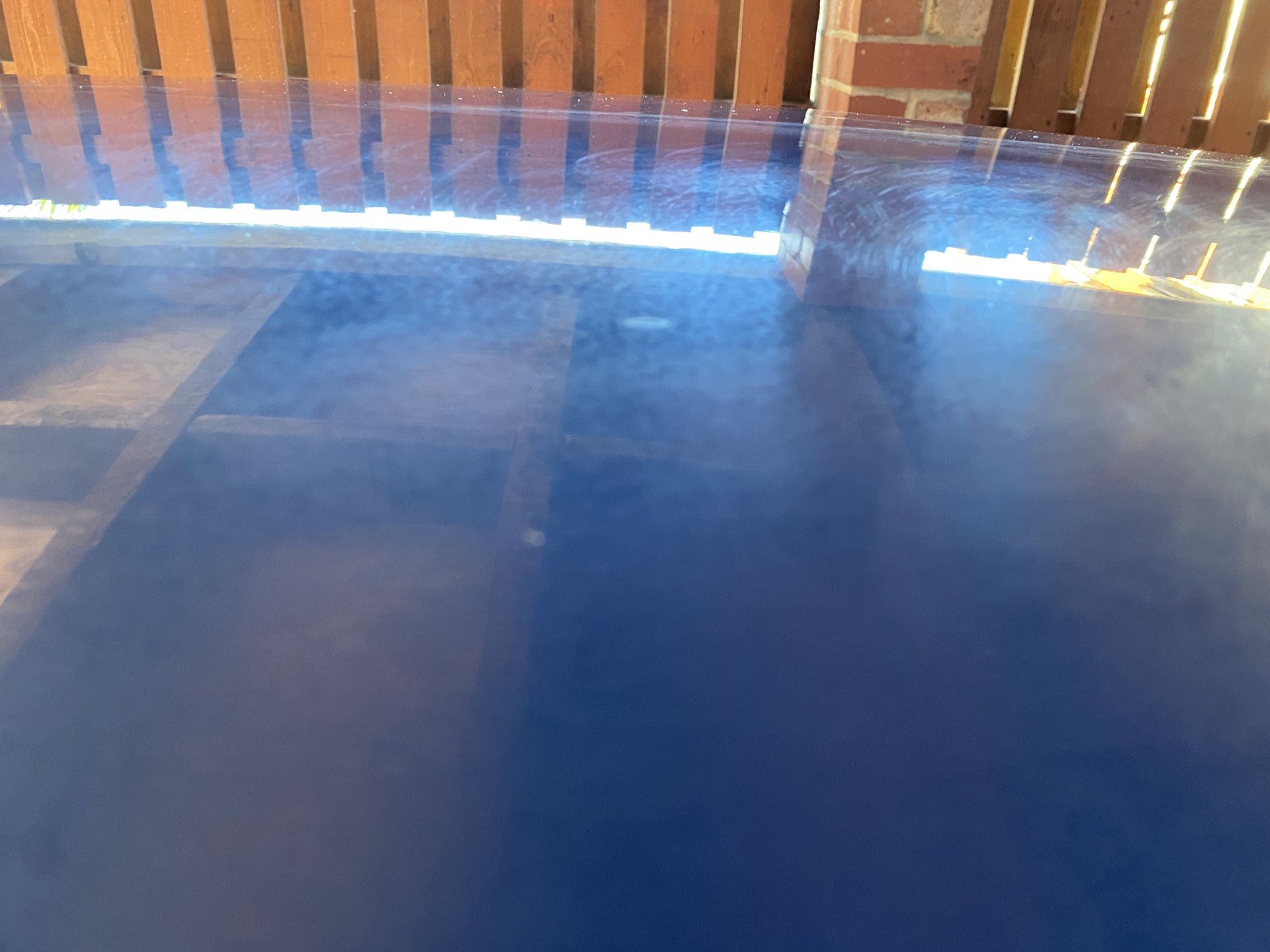

I had the use of the driveway today and with the car under the carport and I decided to try and tackle the paintwork on the roof. With car being22 years old the paintwork has it's fair share of chips and scratches all over as I'm sure those of you with these older cars will understand. I have posted somewhere on here about the roof before and how after a good machine polish it still looked awful. And there is no way to get the paintwork to original condition as where there are hundreds of tiny chips around the lower parts this will require new paint, and as it's my daily it's not going for a full respray. So, I have to live with what I have and try to improve it the best I can. For the roof only that meant breaking out the wet 'n' dry sandpaper.
WTF?
Yes, wet 'n' dry sandpaper was used. And the fun bit is that I don't fully know the result yet as it went dark. Typical British weather!!
This is what I did, so for all you detailers out there please don't hammer me. First up was a good wash, a wipe over with a clean cloth and a good check and feel that there was nothing lumpy stuck in the lacquer. Oh, the lacquer. I read up that it was probably not to thick so I had to be careful. There are two marks on the roof where it seems to be missing but these are very small areas. I used 3000 grit paper and soaked it for 2 hours before use. I very lightly rubbed over the surface using water with a little detergent in it and it was obvious that the surface was very rough. I did one side at a time and wiped it down to check i'd not missed anywhere.
Upon checking it was clear that there were some areas where bird sh1t had eaten the lacquer and these needed to be sanded a little more. Everything cleaned and dried again it looked like a bad idea so out came the polisher. I used an intense cut foam pad and some heavy cut polish with a speed of 2 on the polisher. I went over all of the roof evenly and wiped off the polish. It was clear that it needed more work and with the pad now primed I used double the speed, a little more pressure and a tiny dab of polish for each section. It looked so much better over the whole roof so I wiped off the residue and went for a softer pad, softer polish and less pressure. Finally I used a soft pad and a finishing polish. It was getting a little dark by this time so I took a few photos and a video, rinsed the car off and went for fuel. When I got back it was completely dark but the roof was pretty much dry. I won't know the full results until I see it tomorrow in natural light but if it needs a bit more polishing I'll do it again but won't be going back to the sandpaper. The roof was in such poor condition that it looked like different paintwork from the rest of the car. If you look at the first photo that is the condition after a good wash, cutting polish and hand polish. It looked like someone had tried to respray lacquer over the original.
I'll post up some photos tomorrow taken in the daytime. Fingers crossed....

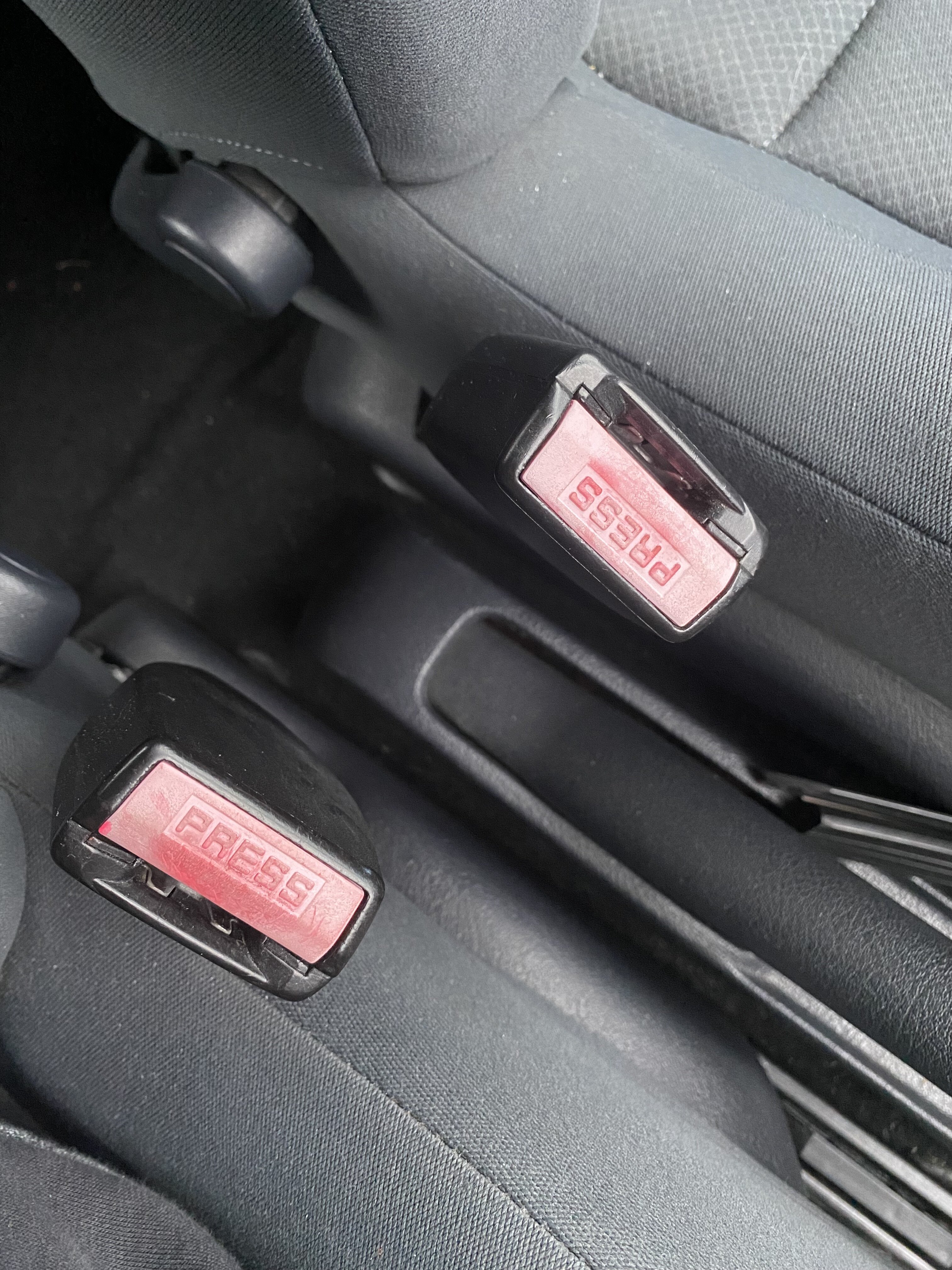

I haven’t been able to do much on the car these last few days, mainly because of the weather and the fact that the car is just sat outside and not undercover. I bought a cheap heat gun online which I will be using for some DIY jobs and I thought I’d give the seatbelt buttons are going over with it as I’ve seen many times on YouTube videos. It looks better than it did but to be honest it’s a s**t job. Even on a low heat setting it just suddenly reaches a point where it’s gone too far. They look better at a glance but I know That they really need changing. I don’t know how easy it is to take the red inserts out to either clean them up or replace them, but it’s definitely a job that needs doing. Here are two photos that obviously show before and after. And I’ve only just realised that the rear seats on the cup can only take two passengers as there are only two seatbelts.

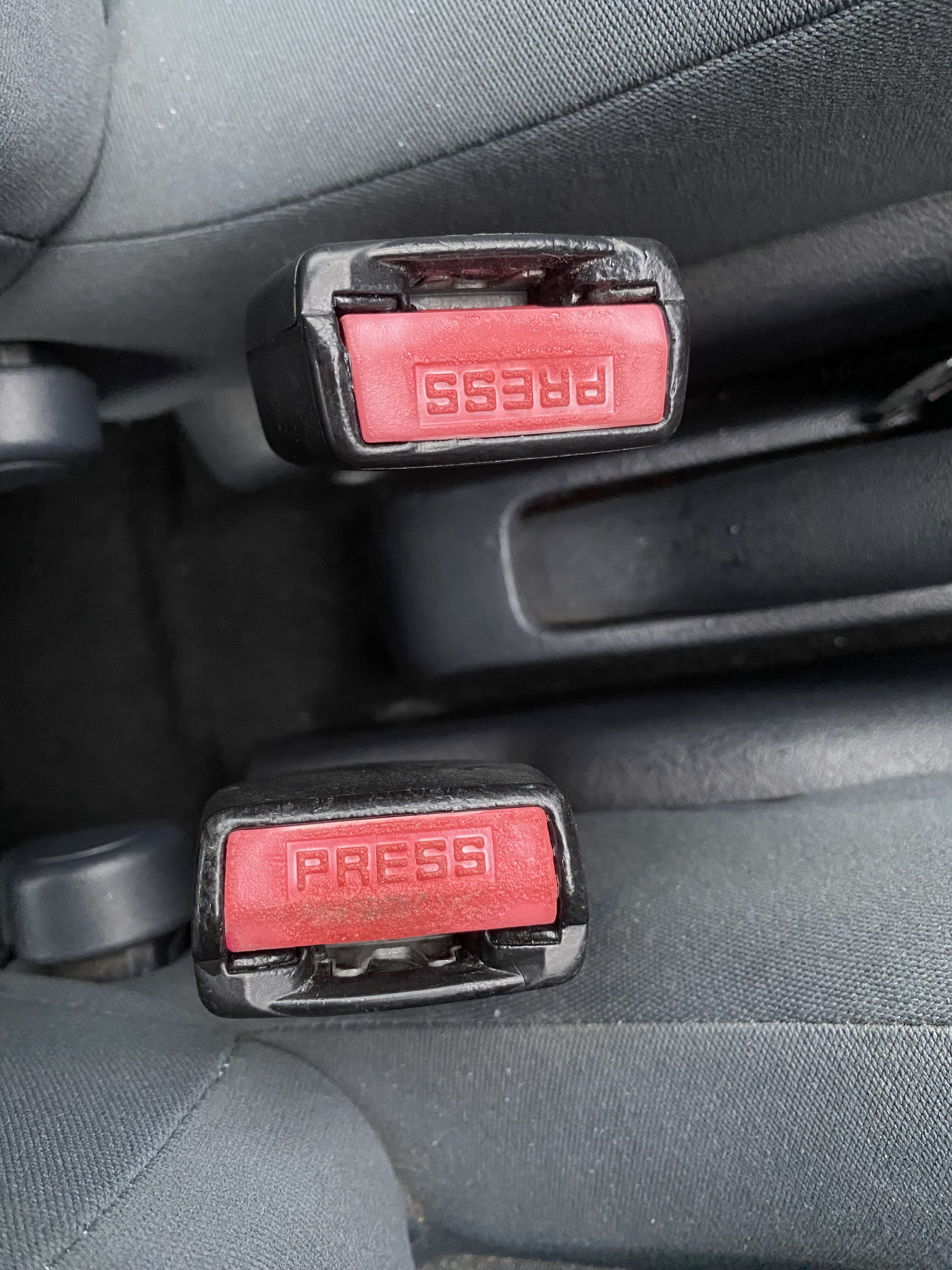

I'm going to colour mine in. The chap on YouTube M539 Restorations showed some once on one of his BMW's, he went over them with IPA, dried them off, then coloured them in with a red sharpie. I'm going to give that a go when I get time.
I've seen that done online. I'm not sure how long it will last for or if you'll end up with pink fingers or not. Like most plastic things replacement is the best option.
I've been looking and can't find anything. You can buy new units that are genuine parts and then I guess you could carefully remove the new button and fit it. I think you can remove the buttons with a small flathead screw driver pushed down the sides and the flip out the button, but they may break. I've not seen anything showing someone doing that.
