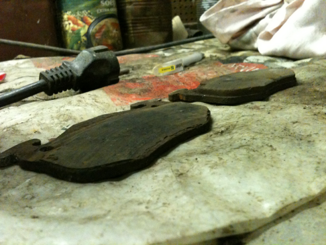

Rear breakpads :(

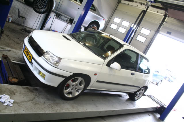

Finally.. after weeks of almost every night working on the Clio..
The first time for the MOT: Passed!
Proud of my car!

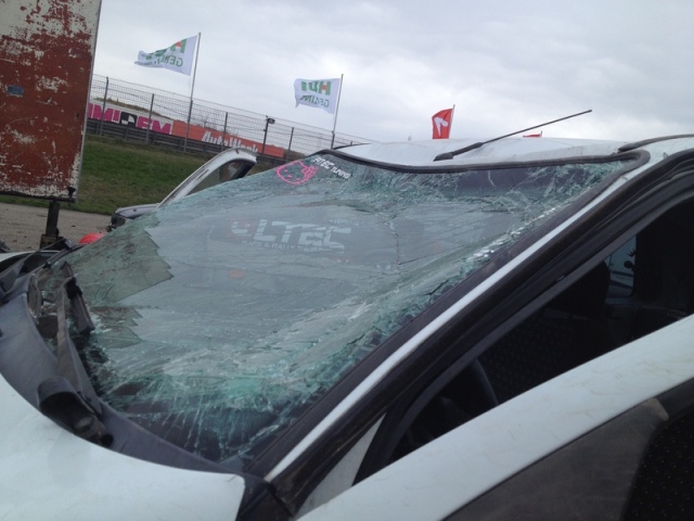

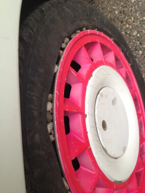

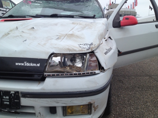

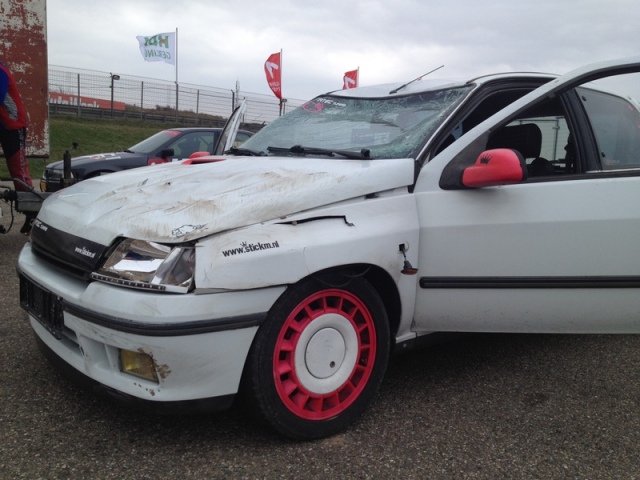

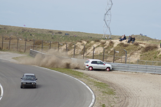

And it did. I was driving with a speed of something about 160 km/ph, and on the Zandvoort track we have a bump that's called 'Scheivlak'. It's known as a bump where a lot of people crash. So the car broke out, I could not correct it and went into the gravel, straight to the guardrail. Unfortunately I was still trying to correct the car, scooped gravel and made a roll over.
Well pictures say alot more then some words:

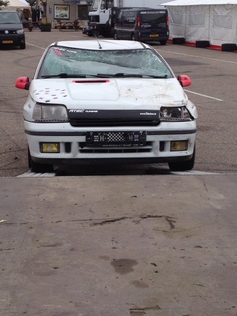

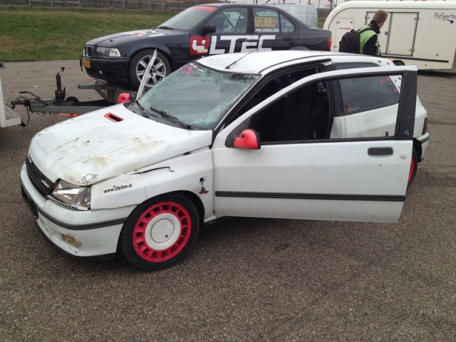

I was completely constricted by the ambulance staff and was not allowed to move any more, so some luck: I did not suffer from a 'lap of shame "lol.

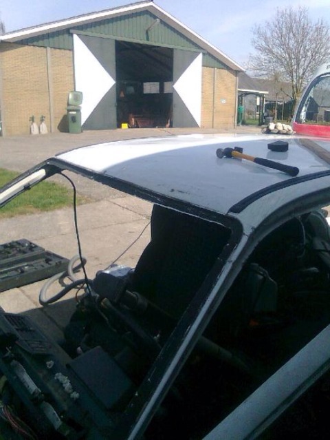

This everything happened on the 8th of April, my dad immediatly tried to help me and started to recover the car..
April 12th:
May 7th:

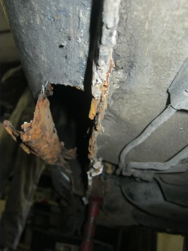

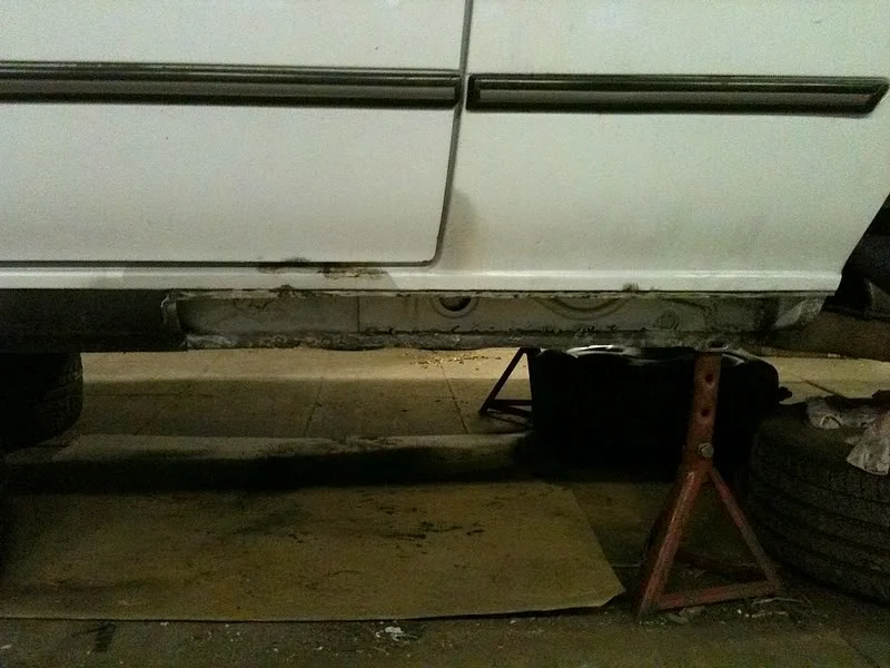

Some welding to do...
