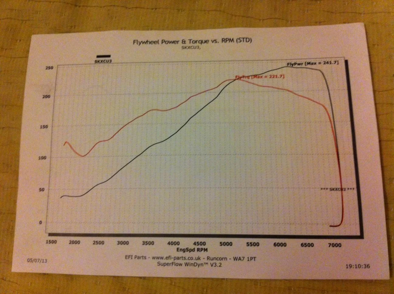

got the graphs up :)

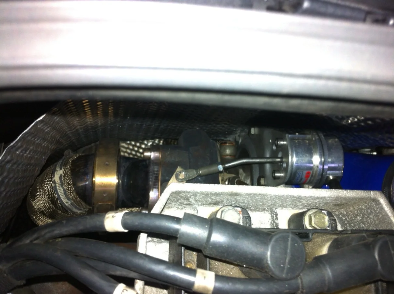

picture of the turbo as well, very tight squeeze. already limited space in a 182/172 engine bay so i can imagion the first turbo conversions on these where abit of a head scratcher.
Cool stuff :)
Should think that drives very well indeed.
Great results mate and glad you like it:)
