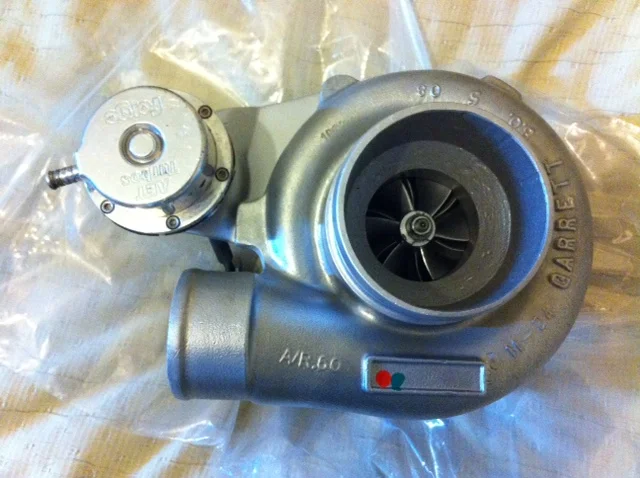

ive had my 182 for just under a year now, ive had a 172 in the past aswell. i bought the 182 in great condition nd enjoyed driving it around most of last summer but took it off the road over the winter before buying a used turbo kit. ive always loved the clio sports but always wanted more power and after having an impreza i missed my dump valve. the kit i bought was fairly complete but still needed to spend a fair bit more finishing it off and improving parts. the big blow was when i had the turbo sent of to get checked and it was bad news, i ended up having a new garrett t25 ball bearing built with forge t2 actuator (worth it tho for piece of mind). its felt like its been an endless mission learning and buying new parts but im finaly taking it to efi-parts in runcorn tomorrow for full instalation, new ecu and map. cannot wait to get it back ready for the summer. il put a pick of the car and the turbo up. bellow is a list of the mods already on the car:

Turbo is a nice addition, dump valves are for homos though
If you are running high boost on a roller bearing turbo (very small diameter shafter so easy for it to flex) then it requires a dump valve (either atmo or recirc) not to damage the turbo.

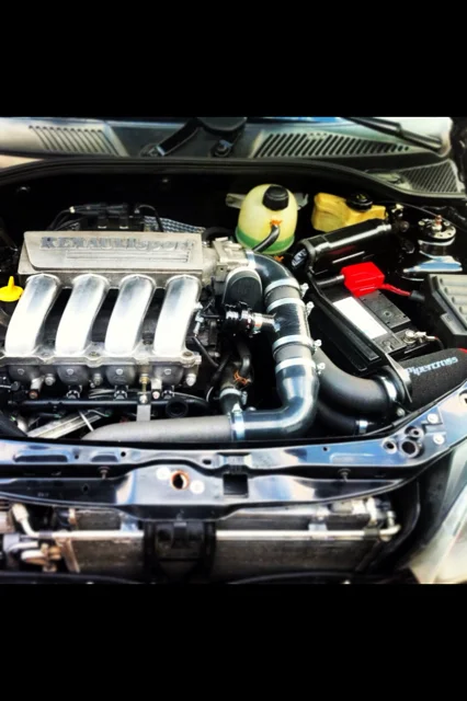

heres a picture chris sent me of the 182 with the kit in. looks smart, gona be picking it up soon, just ironing out some problems with the lamba sensor and actuator spring then fingers crossed can pick it up soon. he also sent me a video of it on the dyno and said its averaging 247 bhp. great figure, cant wait to drive it. driving round in my 16 year old 1.2 clio isnt quite as fun. still a clio tho ;)

few changes to the original spec, went for the Adaptronic ecu as Chris recommended it, also got a Pipercross foam filter out of preference which u can see in the new uploaded pic. also finaly got the 225 injector clips so the injectors are installed properly

What boost are you running mate? looks a tidy job but then again its only really the boost pipes that can look untidy lol
  clio 182
think hes running it at 7psi but i could be wrong, he emailed me today saying its holding 7psi but it was creeping over 10psi at high rpm so hes had to get a new 0.5 bar spring to be able to level the boost? im new to the whole boost/psi thing so im not to sure. he ordered the new spring and lamba sensor today on express delivery so it should hopefully be sorted tomorow or thursday with abit of luck. he said my actuator origionaly had a 0.3 spring in so hes had to change it. happy to wait for the job to be done right tho. if he recomends it il do it.

picking the car up today, ment to get it last tuesday but a few suprises poped up, always suprises in any kind of modification. going after work and probably get to efi at 8pm. cant weight to get it now. final figures are All done, 241hp & 221 lb/ft at 7-8psi. just need a good summer now!

chris has done a brillliant job and im more than pleased. no room for anything under the bonnet now.
