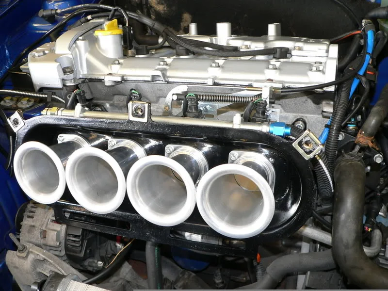

  GDI 227bhp ITB`d 172 cup
morning all, got my cup back last night wiv all work finished :cool:, and my god does it f**king fly :evil:!! before work started in made peak power of 179 bhp wiv 164 lb.ft at the fly (which wasn`t to bad??) but after the ITB`s,cams,omex it made peak off 227bhp! and 179 lb.ft not bad :rasp:, (will put the graphs up l8r cause i ain`t got a scanner) if you see a 172 cup wiv no top grills in the front bumper then u know is me lol ;) ;)! i wud defo recommend the work to any1, it`s alot of money but it turns the baby clio in2 a bloody missile!!
got to say a huge thanx to andy n the team at gdi cause they were al there till quite late last night sorting everyfink out n making sure i was happy wiv the car (which i certainly am). i even got a fone call off andy at 8.30ish to make sure i got home ok (cause i`m a nut case driver lol :eek:) to see how the cup was preforming n to make sure everyfink was fine, how`s that for costumer service!!! :star: :star:

don`t know about the meet yet mate, n i ain`t talking dollar ova cliosport lol, quite alot but its bloody worth it!! but i did have cam`s, ITB`s including porting n matchin ect, omex, bonnet pins, stainless stell top mounts, new gear box mount, smaller fan, a pre-work rr, 36,000 mile service including all belts changed so got alot of work done for the price.

this is just to wet your appitite for now as im shockin on computers, and brother is helpin me before he goes out. :)

mine was on a different RR near me that imo over reads, but I think mine still makes more peak power, but speaking to Andy and Stu's power band and torque is a fair bit better than mine, as his is still making power at 7500rpm, where mine tails off quite a bit due to the cams... not to worry though, mine's being dropped off soon for more toys ;)
