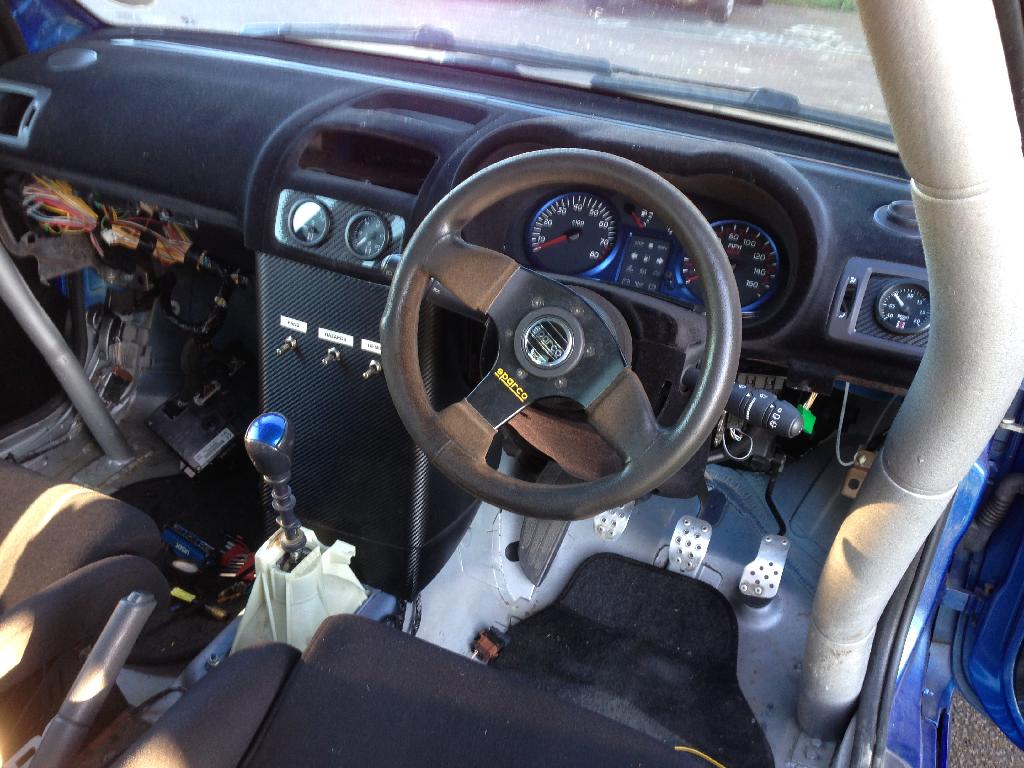

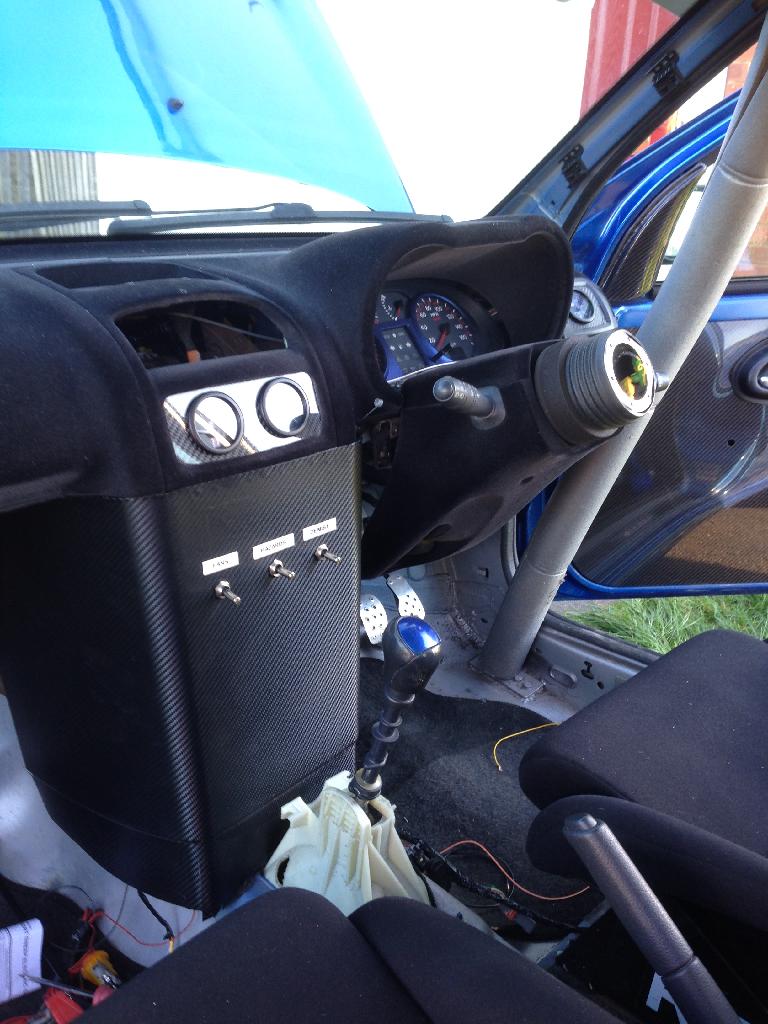

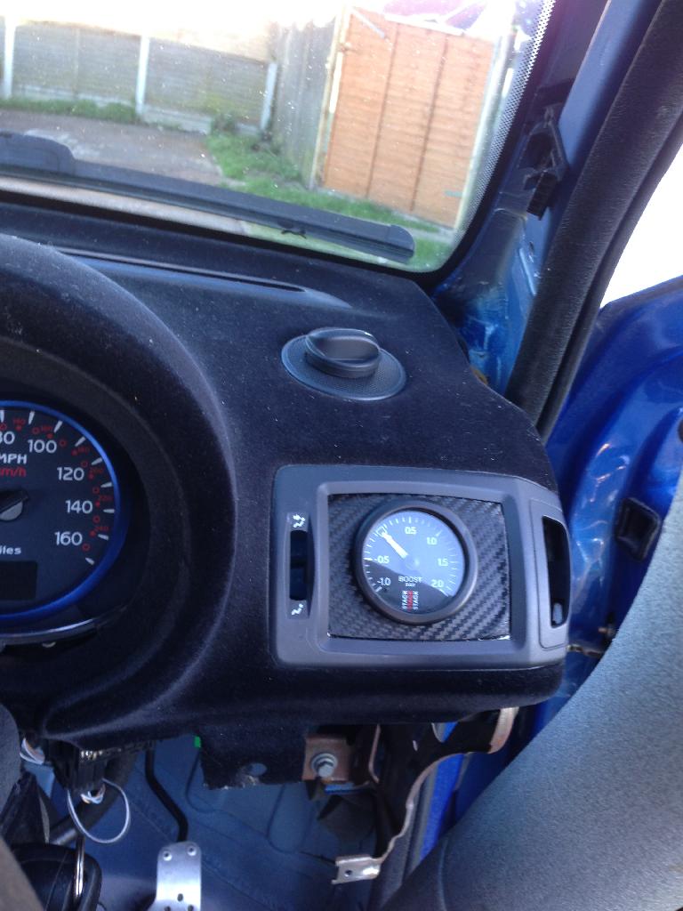

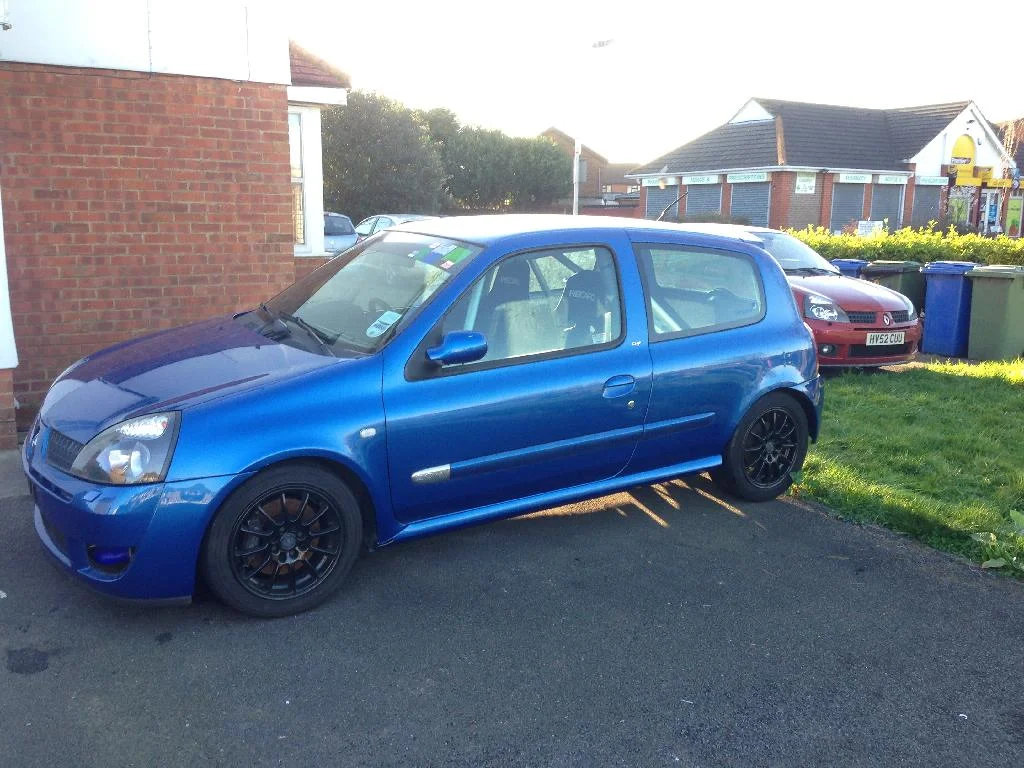

I did a few bits to my cup today so thought I'd share some pics and vids
I fitted an oil cooler, boost, oil temp and oil pressure gauges. Plus rigged up some dash switches! My flame red daily sneaks in to some if the pics too....

Haha! Good point Mark! I've not actually driven it in anger yet, so not sure! I can modify it to fit if need be tho!
HMS - yes mate, it was the only place I could think to put it that was out the way and still OEM-ish! If you zoom in on the second to last pic, behind the indicator, there's a cable, that's my hot/cold selector for the heaters! Out is cold, push in and it's hot!
I've tried to keep it as if it would has just come out the factory, but obviously with me doing it, there's some imperfections!

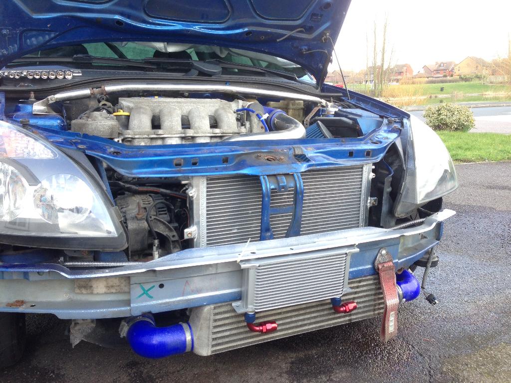

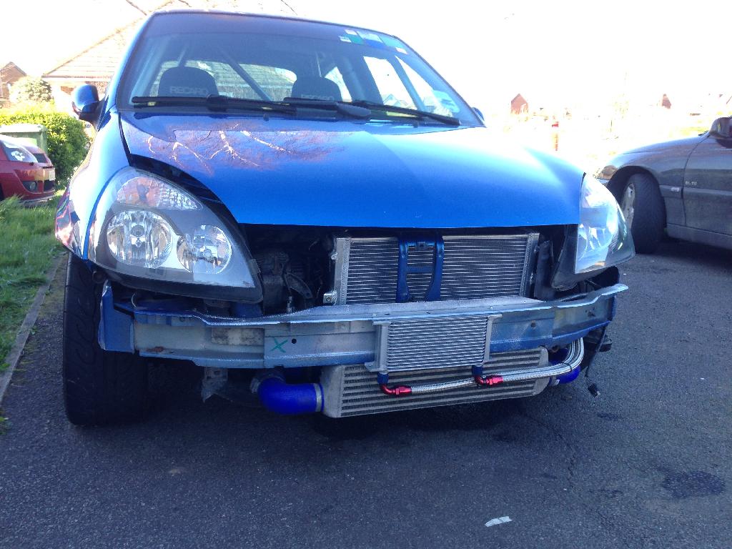

Looks good, not sure thats the best place for the oil cooler though, you really need a low pressure area behind it so the air gets drawn through it.
  Cup Turbo, Flamer
Cheers guys! Yeah the cooler is all part of a trial, several people have given me tips etc which have been really useful, so we'll see how I get on, if it doesn't cool enough ill drill the cross member behind it so the air will go through.
