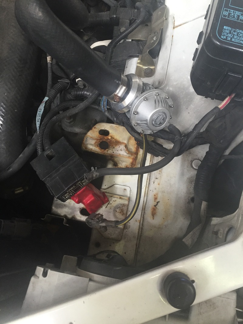

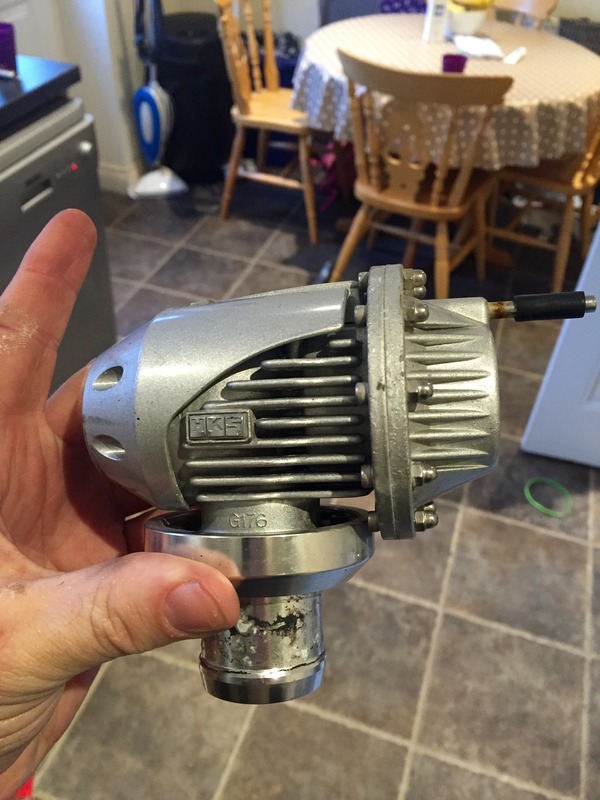

Also removed the HKS Bov as wasn't my scene;

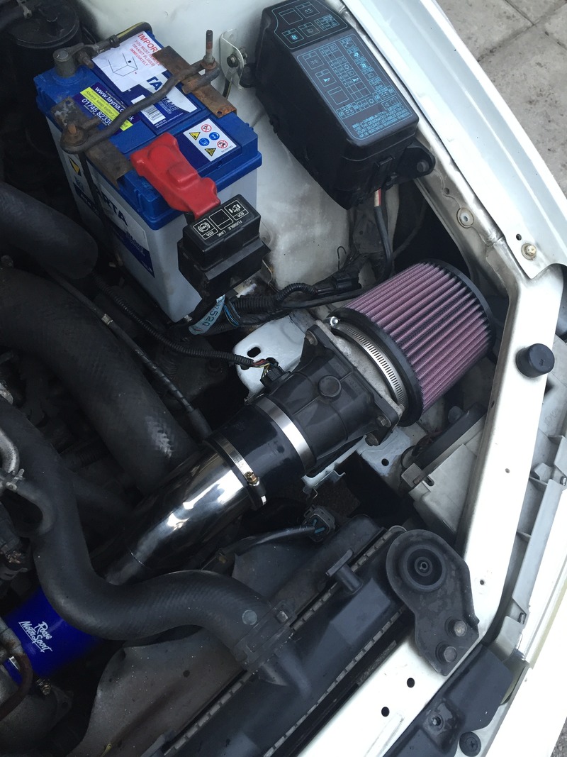

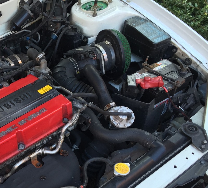

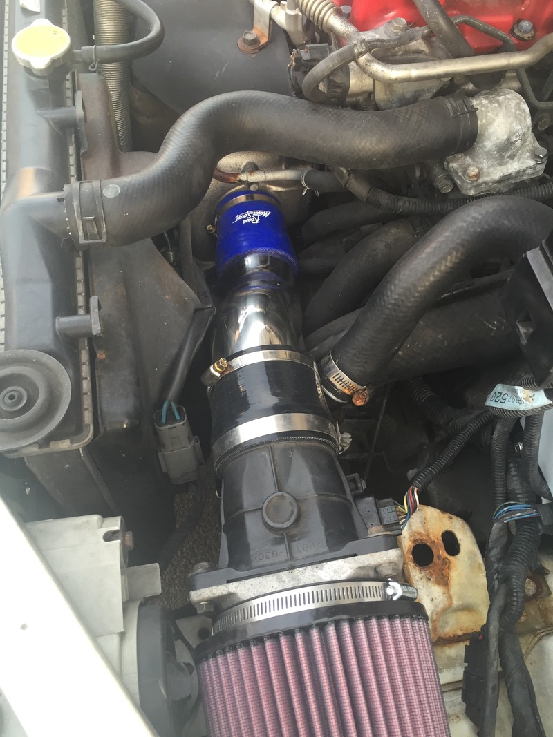

One of the popular mods is to relocate the battery slightly to allow better air flow to be filter and also run a different filter. This is the set up before. HKS shroom filter aka the 'grit muncher' and battery in standard slot.

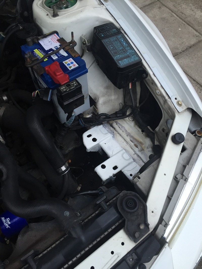

Battery removed and relocated with the relocate kit left a lovely patch of visible rust!

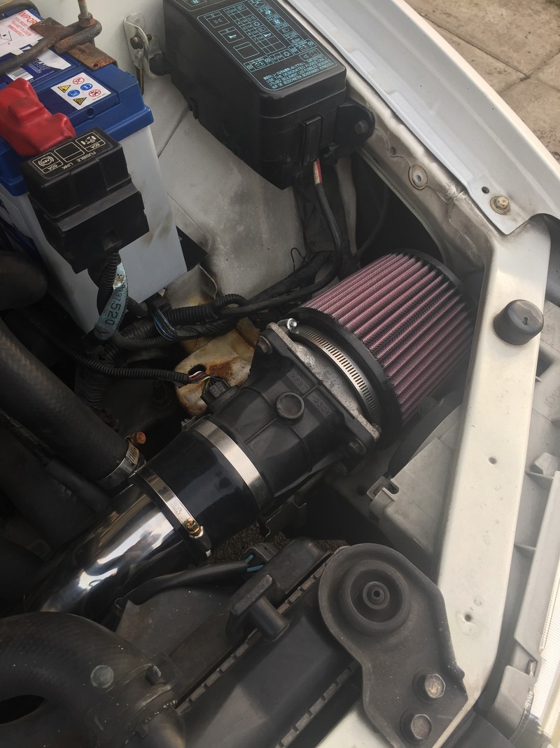

Opened the induction kit and the maf adaptor plate was rubbish and it was missing the turbo reducer pipe. Not happy! Luckily my pal had a spare to use for the time being until the replacement arrives. Fitted the filter and this is how it looks. Positioned a lot closer to the front arch for better flow.

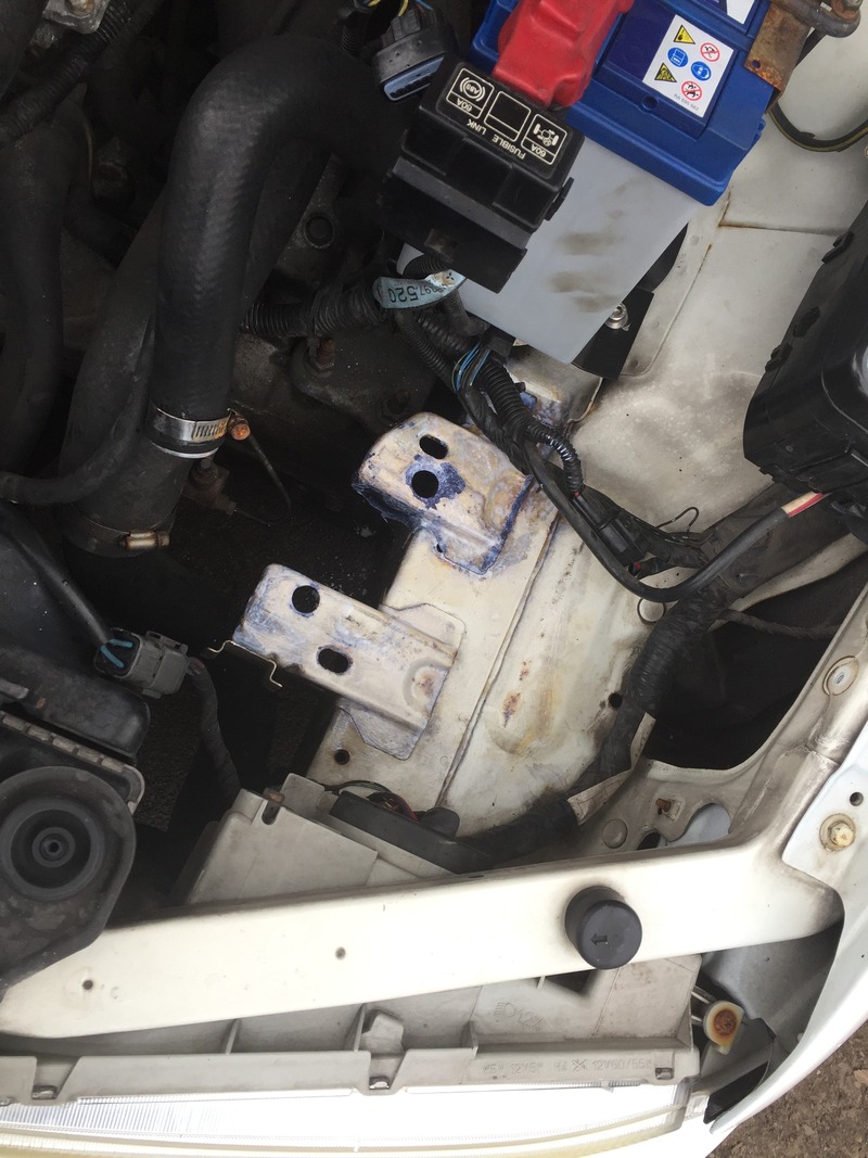

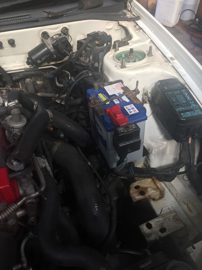

So got to work trying to make the rust look a little better. I scrubbed off the surface rust and treated with krust.
Then it was pikey time so broke out the paint brush and coated the area in etch primer and then a couple of coats of scotia white.
Certainly not the best finish but with the filter back in I think it looks a lot better than rust.
