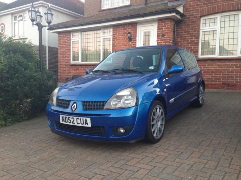

Anyway heres a picture to start, same as every other cup to be honest not that that's a tragedy, I'll get some more later.

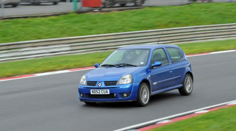

The car behaved itself and was an awesome laugh.
Hopefully will manage a few upgrades after xmas before another track day.
i'll add a few more photos when I find them....

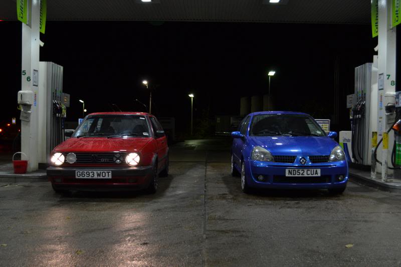

The clio and my mates Golf 8v
Two great cars there - my first car was a 1991 8v in Oak Green metallic and I followed that with a 172 Cup.
