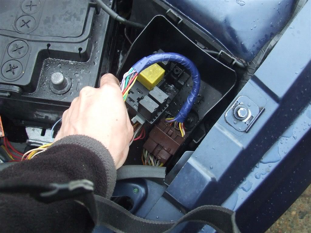

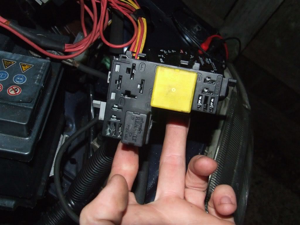

For the fuel pump, you do need to connect it to the relay.
The 172 fuel pump relay has two white wires coming out of it (on the same spade connection). these going via the crash switch (so make so it's 'set') and one goes to the coil pack and the other to the fuel pump. You've found the valver feed, so it shouldn't be hard to connect up :D
in this pic, there are 3 relay spaces on the top row and 2 on the bottom:
the fuel pump relay is the bottom left (not inserted in my picture)
these are the connections:
as for the dash lights not coming on, check your ignition live within the car (yellow wires), there must be power getting there though if the car is turning over
to get it running, you need an ignition live hooked up to the 172 loom (from the valver loom), so you must have it working somewhere

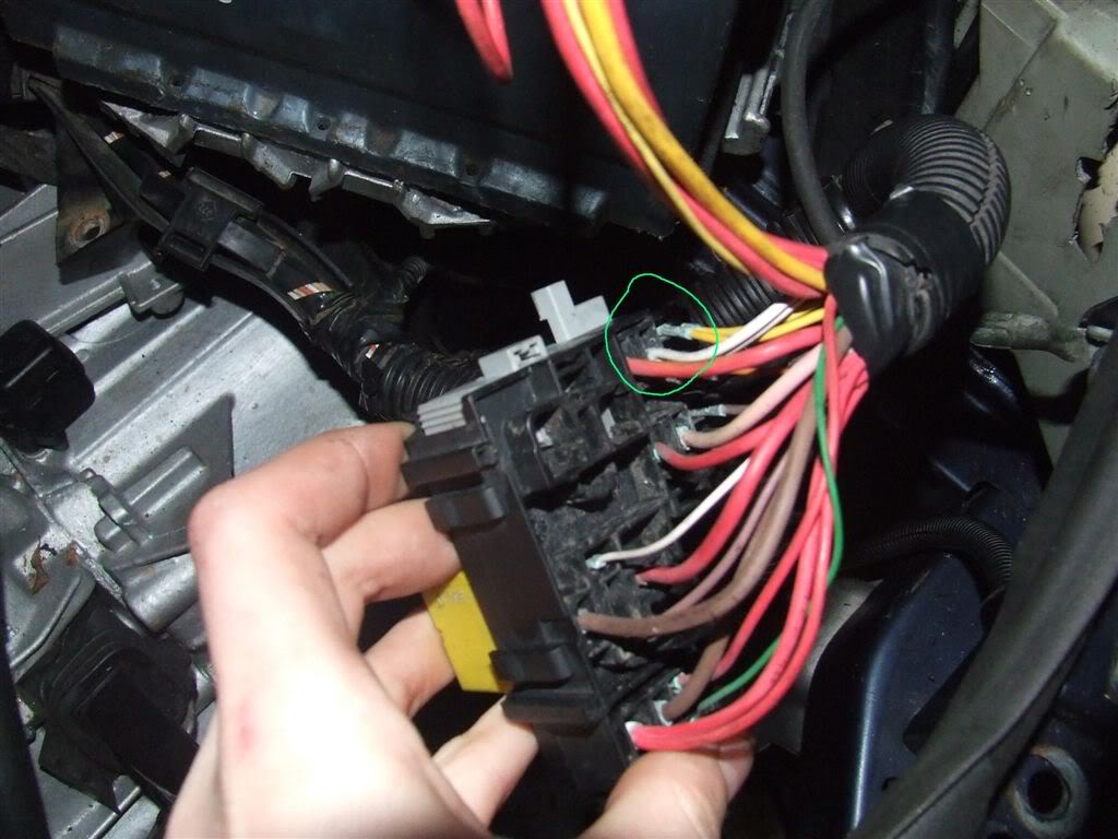

Matteh, Been up at the car tonight. Am still struggling like!!
We found the two white wires coming ou tof the relay. We traced one back to the coil pack and then the other to the crash switch.
We counld'nt seem to trace the white wire from the crash switch back to the 172 loom plug? We managed to trace the pink wire that runs from the crash switch to the 172 loom plug thou, but when we connected it up to the phase 1 16v feed and turned the igntion on nothing happened!!
Is it the pink wire we were meant to trace back to the 172 loom plug?
Look forward to your comments.
Cheers.
must be
have you probed it with a multimeter? find out where the voltage is stopping...
when you turn the ignition to stage 2, you should get a 12V pulse to prime the pump. when you start the car, it should be a constant 12V
This is the crash switch with one white wiring going in from the relay and a pink coming out which goes to the 172 loom plug.
This photo (below) is of the 172 loom plug you can see the pink wire which comes from the crash switch.(Circled) But when I connect it up to the ph1 16v feed and put the ignition onto click 2 nothing happens.
The one thing I did'nt do was see if it was geting 12 volts when the key is turned to click 2. I'll give that a try unless you can think of anything else?
