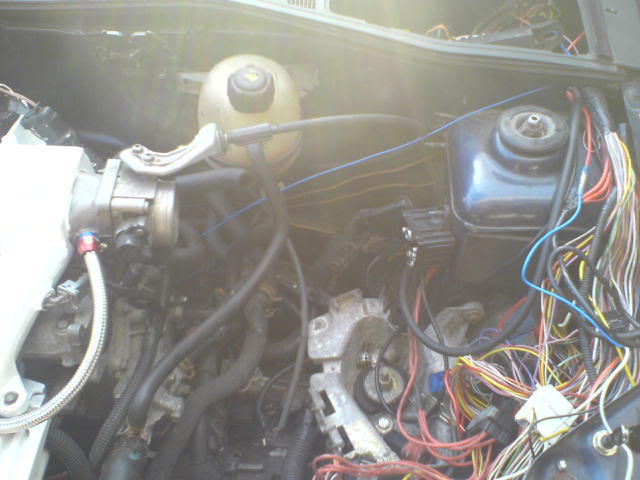

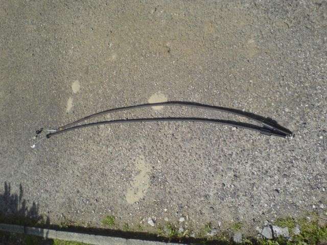

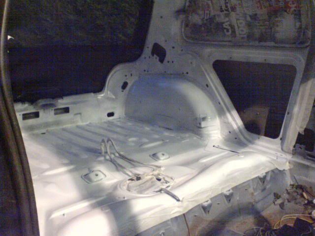

right peeps, only got sunday to mess with the car this weekend, and it was soo damn hot in the car i could only manage half hour stints before having to take a break and cool down.

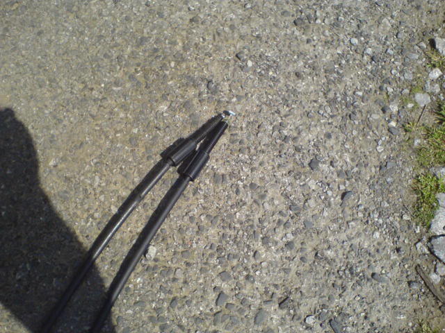

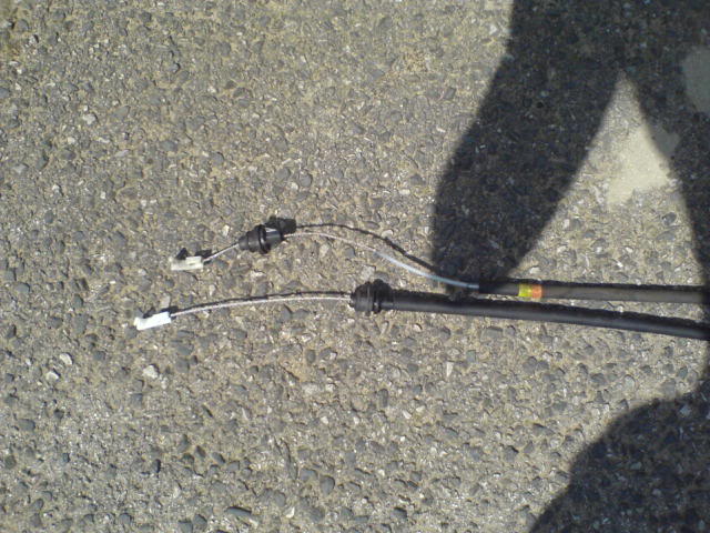

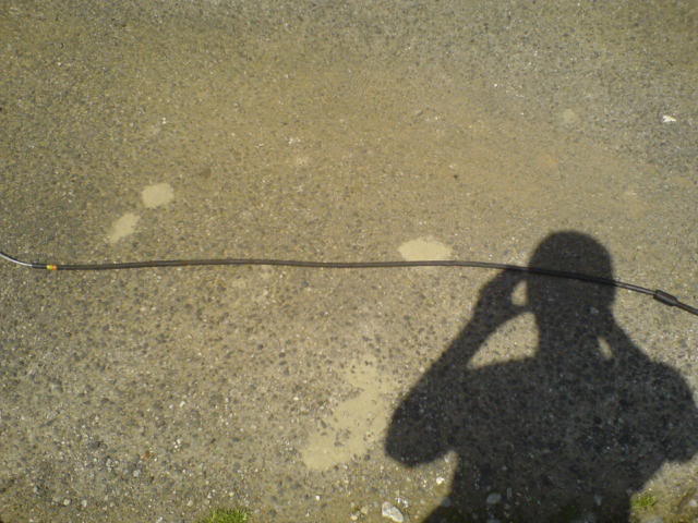

but i got my 172 accelerator cable fitted, was using the valver cable but it had frayed and didnt move smoothly, causing the pedal to stick every now and again.
took the valver one off and capmpared to the 172 cable
as you can see they are identical, and is is normally the case removing the old cable was considerably easier than fitting the new one! but alot of swearing seemed to help :approve:
i then started removing all the clips around the car that hold the interior trims in place, boring task but needed to be done. and then took some measurements for more purchases :evil: :rolleyes:
also looking at the engine bay i dont think i am going to be able to squeeze my maxogen in there AND close the bonnet, so battery may have to be relocated, another job to add to the list!

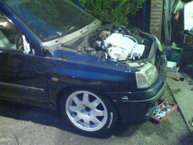

Re: My mk1 track car blog

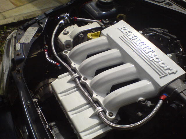

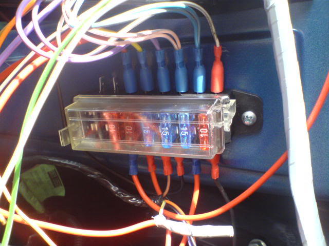

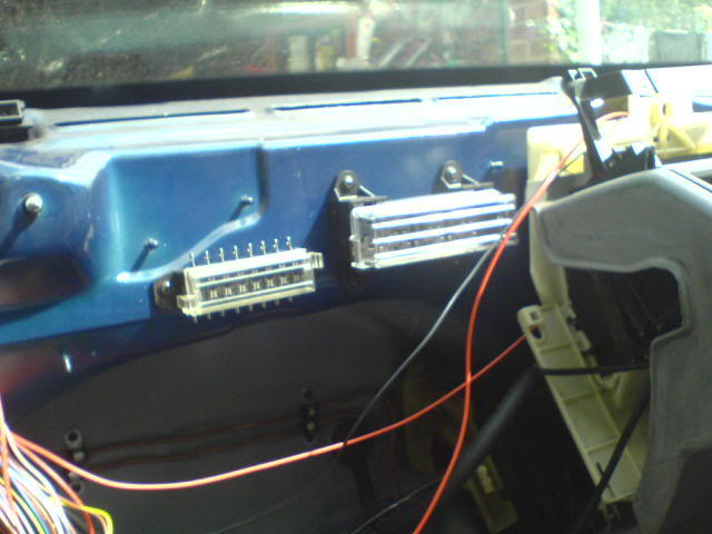

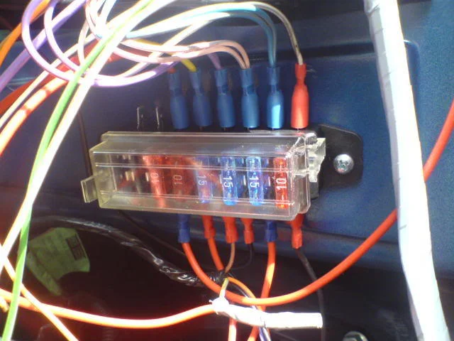

right got a bit more done yesterday, sparky came round and sorted the rear lights, all fused neatly on the drivers side
then another fuse holder on the passenger side along with a relay holder
and whilst he was sorting wires out i decided to tidy up the engine bay a bit, although it's a track toy i cant help but tart it up a bit :eek:

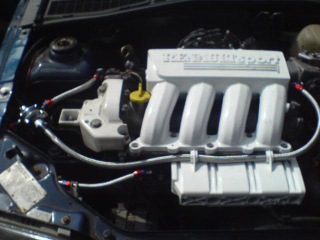

bought a proper bung (instead of a bolt) for the pipe that would normally connect to the carbon cannister

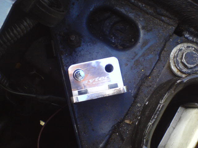

then fit my sytec fuel regulator bracket

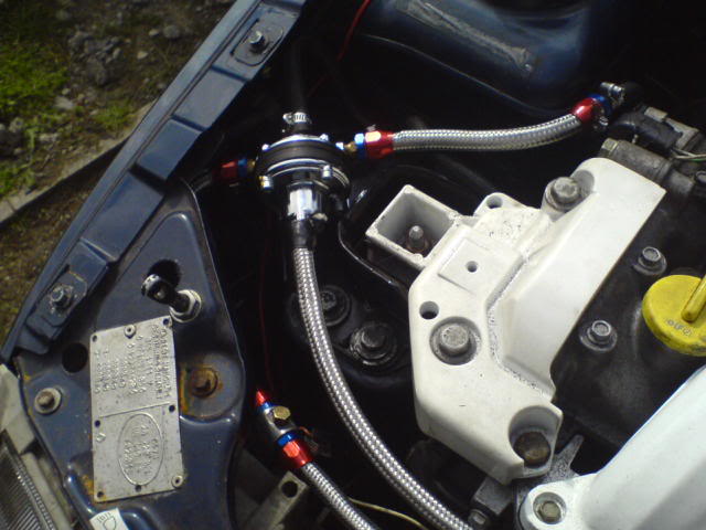

and then mounted my pressure regulator and fit my braided fuel hoses and finishers

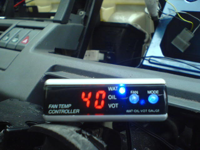

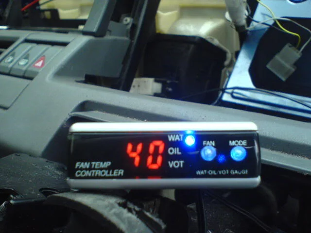

and after that i got on with wiring in my fan temp controller, very impressed with it and its ease of installation
haven't connected my water temp sender or oil sender (need to fit oil cooler and sandwich plate for that) so i just put the sender in a cup of boiling water to check it works.......you can hear the fan kick in at 71 deg and then cut out at 65. it can be adjusted to cut in at anything from 70 to 100 deg in 2 degree increments :cool:
so with a bit more work i will have all electrics working and the fan cutting in when it should :D

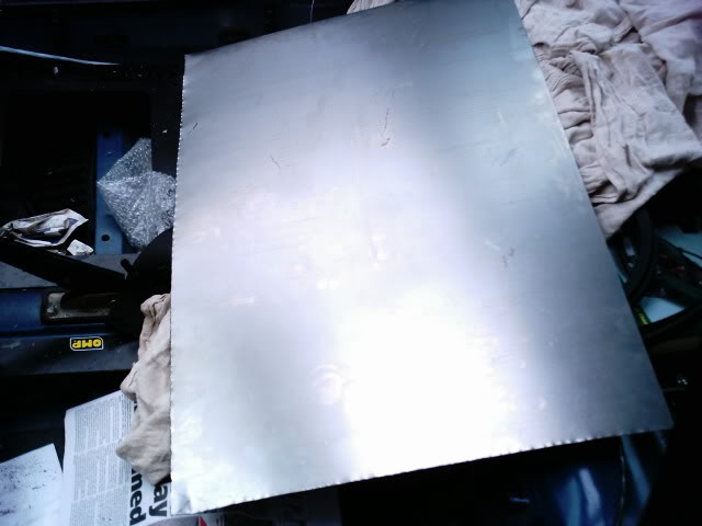

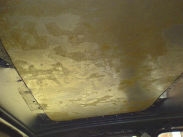

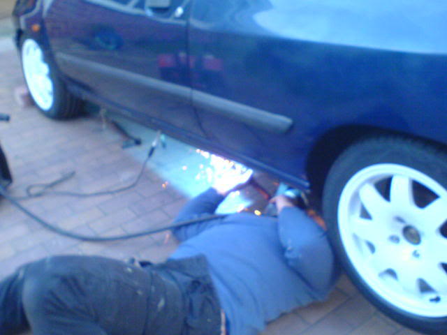

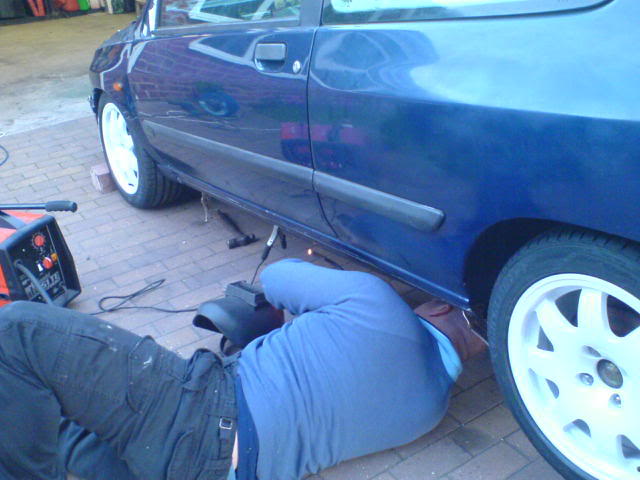

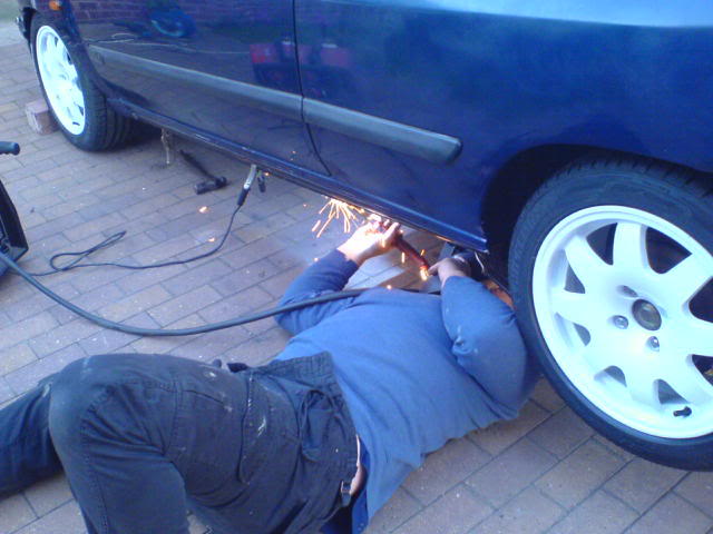

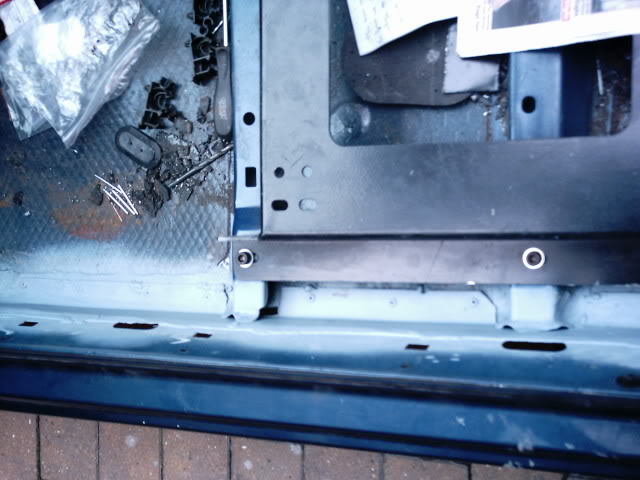

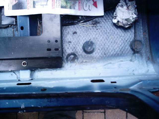

right got a bit more done on saturday, took the car next door for some more welding
we managed to get the inner part and the middle part of the sill done, riveted and welded the inner part, and then welded the middle part, stood on the floor and jumped up and down to test it, solid as a rock.
not the prettiest work lmao but its functional

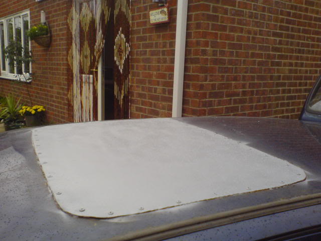

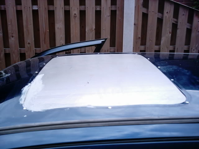

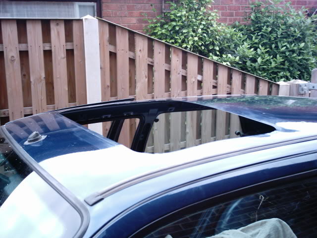

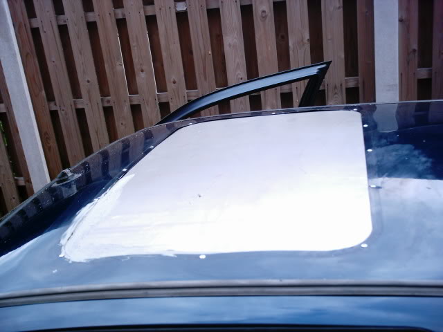

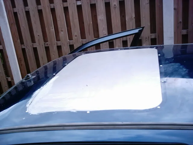

then i set about taking the old leaky sunroof out, and replacing it with a manual one i picked up at FCS, i spent ages getting the old one out, and was so annoyed with it afterwards that i decided to do away with a sunroof all together :mad:
half hour later......
will seal and paint it when i get chance

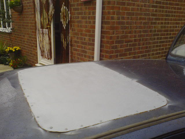

Would it not have been easier to paint the sheet metal before you riveted it? It going to be a pain to paint now surely?
By putting the metal sheet there have you achieved much weight reduction? Do you think you could have got away with a piece of thick Perspex plastic?
  F4R'd ITB'd '92 cup racer
The choice out there isnt great so will take either.
Ready prepped is cheaper, but no fun.
true, evouk is selling his ex clio cup racer for 6k, get alot of car for the money! but as you say, part of the fun is to build it yourself.
prob would have been easier to paint it first, but time was not on my side, just going to mask it off, prime and spray it in situe, simple enough job. plus ive got to seal it before painting.

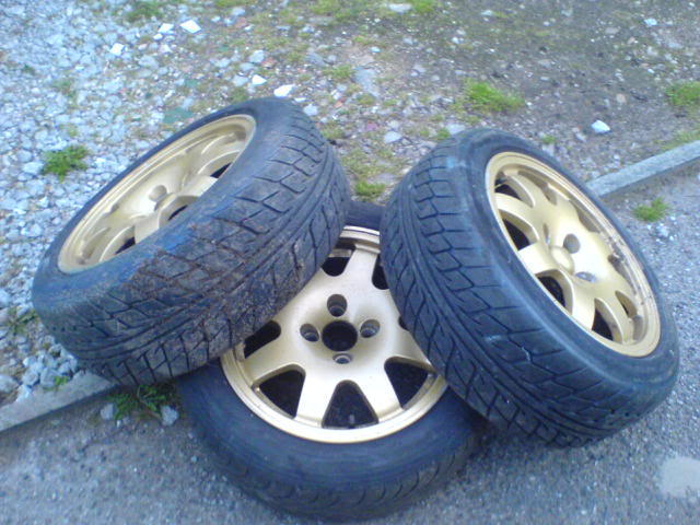

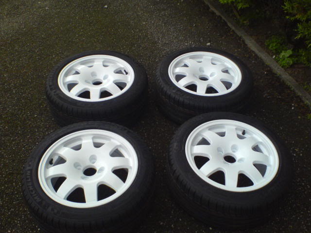

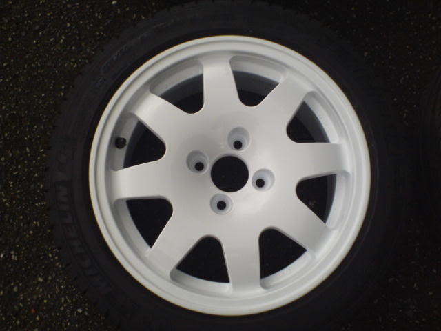

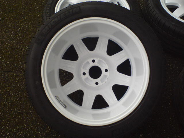

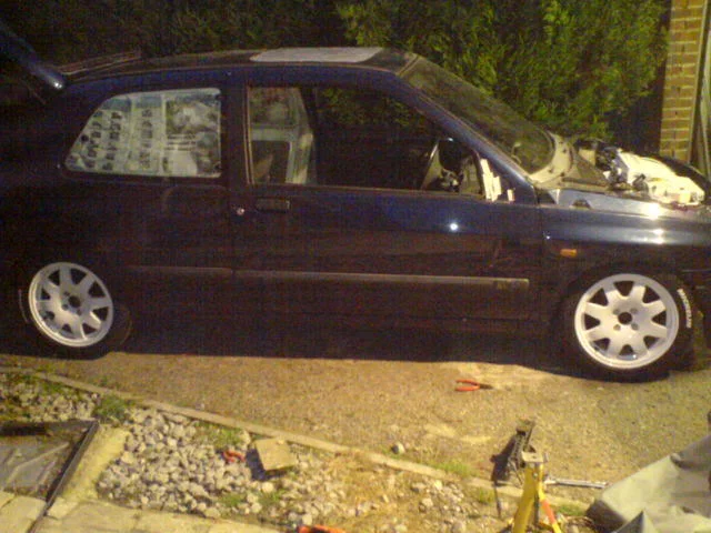

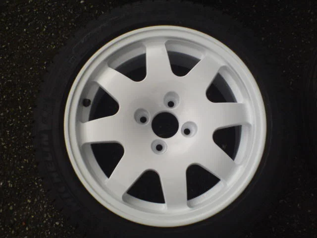

right bit more of an update from this weekends work, this weeks been a busy one, started by taking my speedlines off the car on sunday, getting tyres removed on monday, then taking the alloys for sandblasting on tuesday.

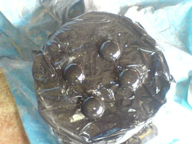

got sandblasted wheels back on thursday dinner hour and took them straight to the powdercoater. i wanted to get the wheels back on the car at the weekend but didnt think i stood a chance taking the wheels so late in the week. happily however the powdercoater was a gem of a guy, by far one of the nicest guys i have ever met. he asked when i wanted them done by (bear in mind it was 1pm thursday) i said as soon as possible please, to which he replied saying he could have them done by the same time friday!! :D
i went to pick them up on friday, to which the guy said he did them that day when i left and they were actually ready at 9am friday! now thats some good going considering he had about 20 oher sets of alloys to do! the other surprise was the price, i couldnt thank the guy enough, and he said i was welcome back anytime :D
the finished article with the new pe2's fitted and balanced 8)

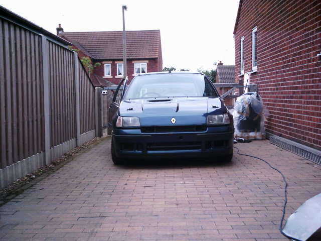

i put them on the car and then moved it onto the drive for some piccies and for some serious work to start

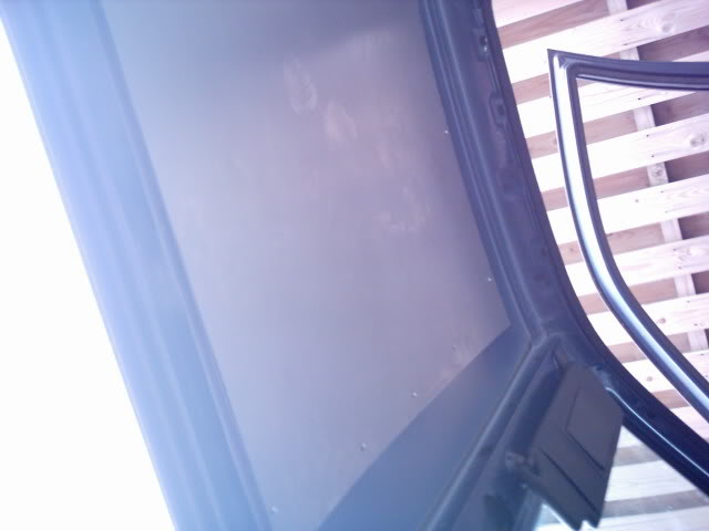

then i got to work on the sunroof, drilled out the previous rivets, cut the metal to shape then refit it and re-riveted it, then applied primer, which is all i could to as it then started to rain on and off for the next 3 hours :roll:

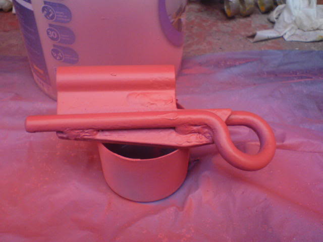

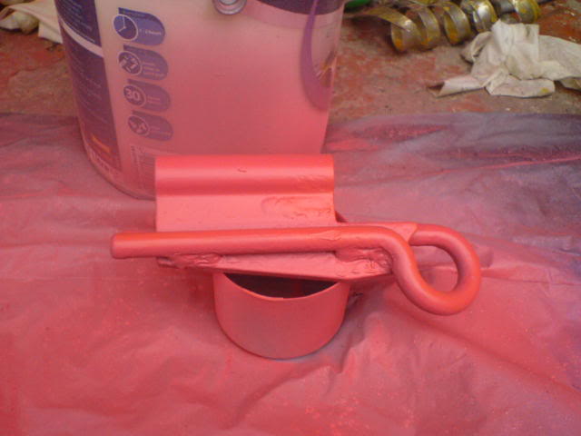

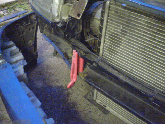

also sprayed the standard tow hook pink (looks red in the pic!)

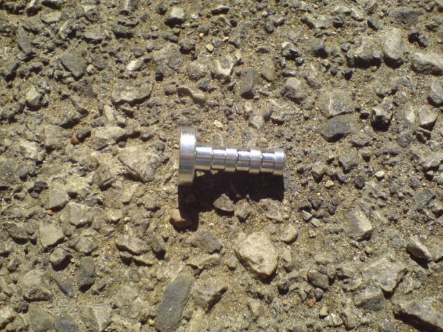

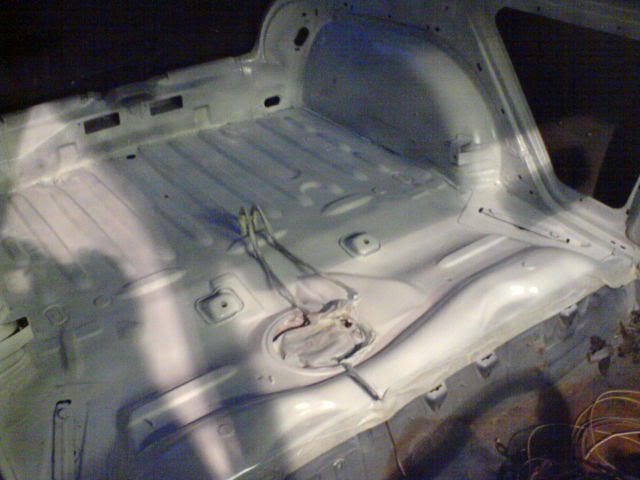

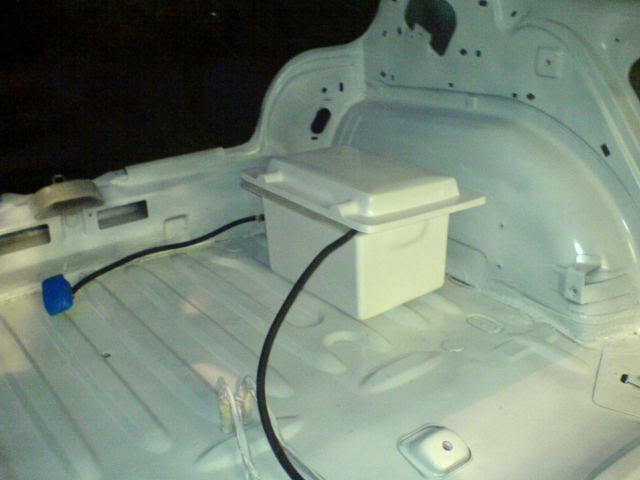

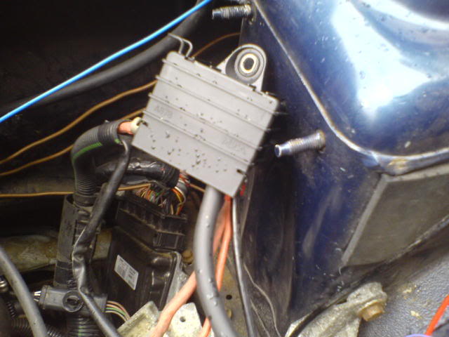

next job was to relocate the battery in the boot, i have spent about 2 weeks buying all the parts and planning what i needed to do it without any
problems. the planning paid off, sadly i didnt take any pics of the battery box in the boot as we removed it pretty much straight away to do some painting.
junction box in the bay
and a nice big space for my induction kit 8)

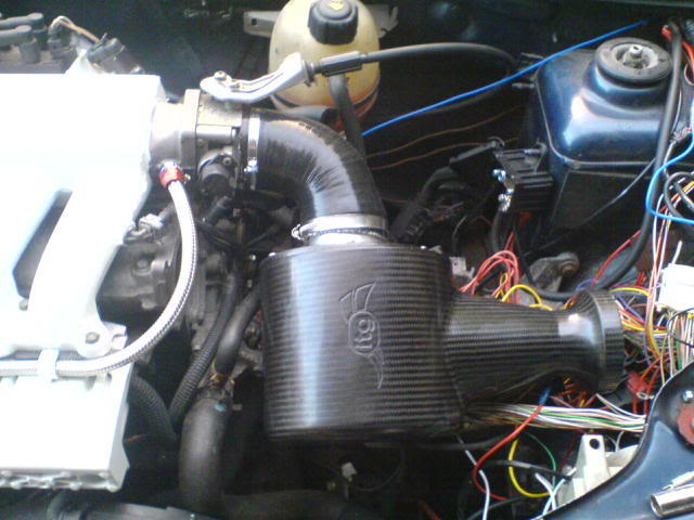

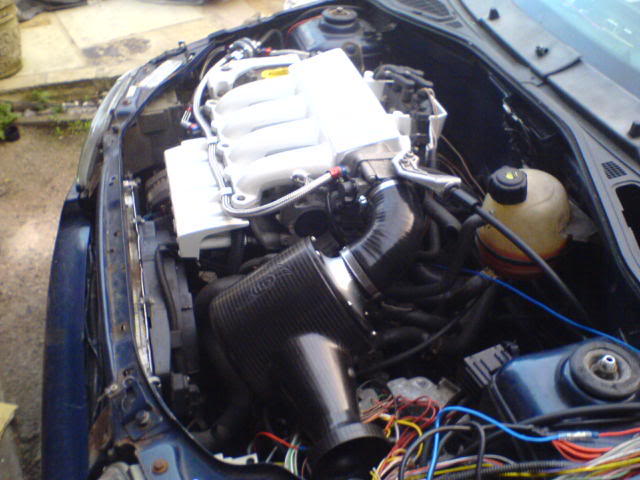

so with the battery out of the way i set about fitting my ITG kit
took a fair bit of fettling to get it into that position, and even then there isn't alot of room for the cold air feed, but i'll tackle that when i get to it

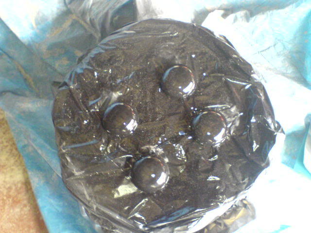

while i was sorting this out the gf was again busy using the heat gun to remove the tar on the boot floor, then removing the rest with thinners, then masking out the rear windows etc, then applying primer and basecoat :)
it was pretty dark by this time but i tried to get some pics, needs another coat to finish it, which we will be doing tonight as we are back on a mission to get it ready for trax.

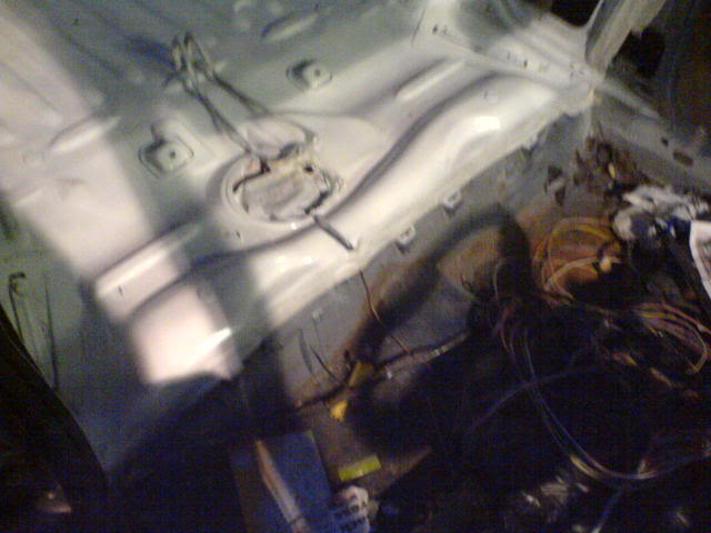

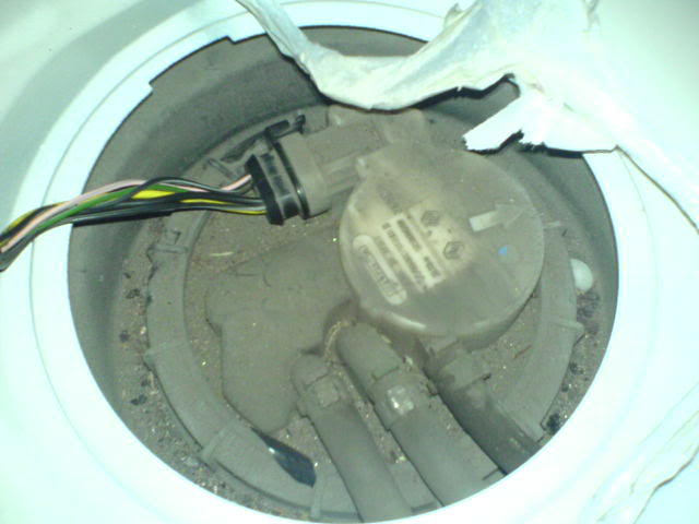

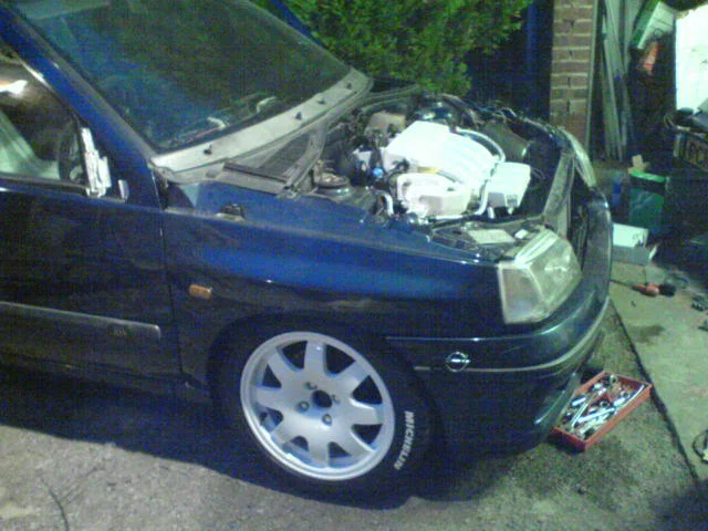

last nights task was to weld the outer sill into place, ready for me to finish off, however not all went to plan, i connected the battery and turned the key to drive it round......nothing
after a few checks with the multimeter the fuel pump wasnt priming or working under cranking, but i had voltage there on both
my diagnosis is that this little beauty decided it didn't want to be part of the team anymore :x
so after that we pushed the clio round next door, and started welding.
however not all went to plan either, we couldn't get a good weld between the 2 panels, so we decided to call it a night and try again another day.
i also tried to get a few more pics, but it was dark by this time so they didnt come out too good :oops:

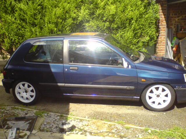

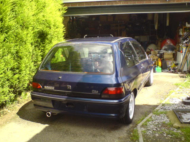

battery box in boot, just needs securing to the floor

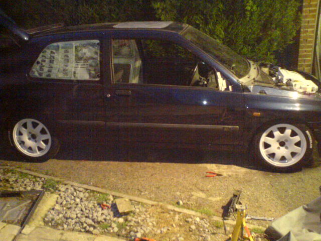

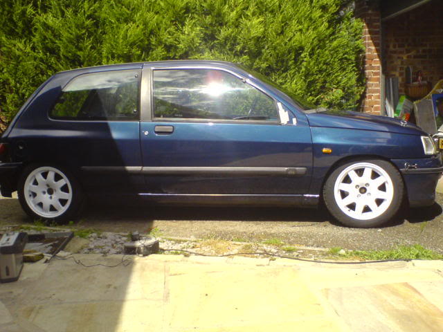

and an overall pic of the car

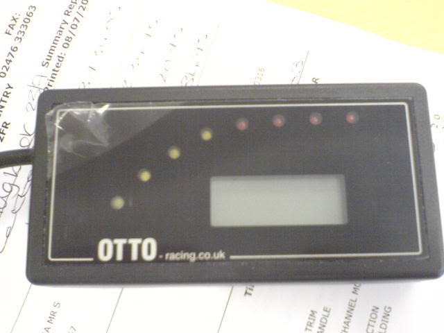

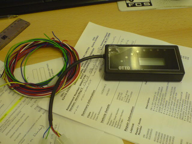

had an eagerly awaited delivery today
basically i was looking at rigging up a datatool rev light as some have done on here, however when i looked into setting it up it meant holding the car at certain revs so the led's can 'learn' when to come on.
this was a problem as i dont have a working tacho (known problem with the 17poo conversion) so it would mean buying an aftermarket tacho, setting up the rev light, then selling the tacho, too much hassle for my liking!!
so instead i did a bit of research and after about 2 days searching on the web for what i needed, i found this
it is a digital tacho and has 8 led's that can be setup anywhere in the rev range, this way i can set it up just right using the digital readout, and can monitor engine speed more accurately
