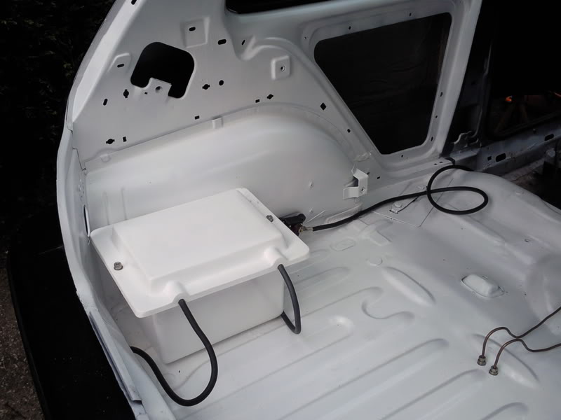

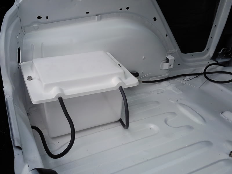

spent this weekend sorting various bits out as we couldnt work on the sill, first job was to fit my battery bracket to stop it flying around in the event of an accident, drilled through the boot floor and fastened it down, then drilled the holes for the cables in the grp box lid, and then bolted that down aswell with some cap bolts i had lying around

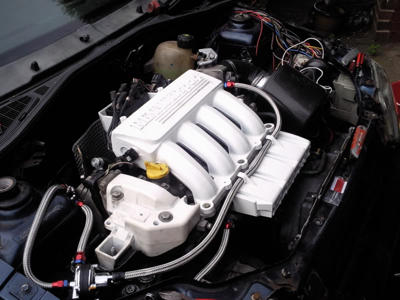

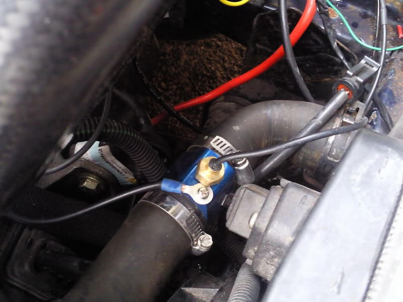

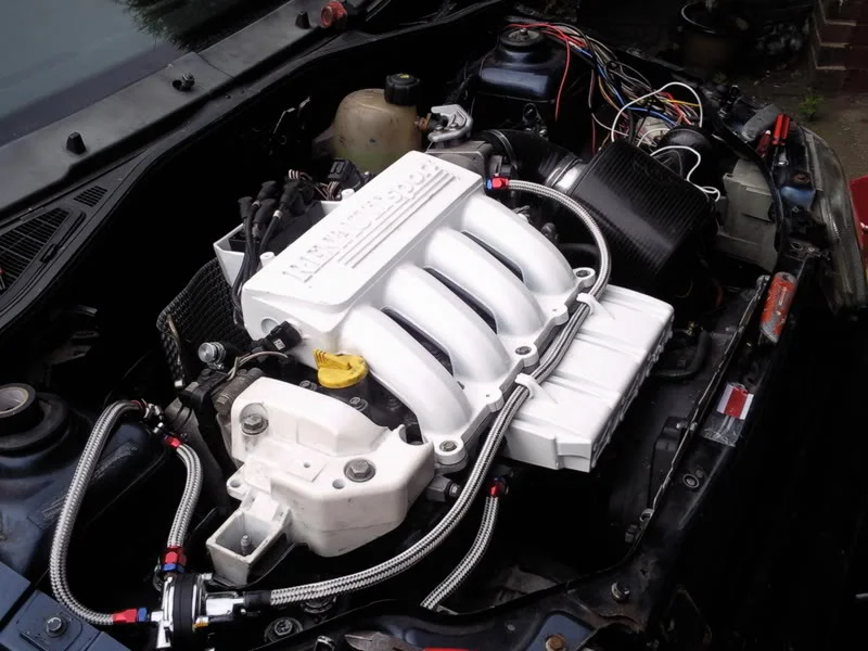

next job was to fit the sender take off in the top rad hose (for the fan controller) and also put some renault type D coolant in, i have said this before, and i will say it again, the bottom rad hose clip is the biggest b**ch to get on in the world! i spent about 30 mins on that clip alone! :x
but after some chopping of the hoses and a full coolant refill/de-gassing all seems well, apart from i took my eye off the expansion bottle for about 30 secs and the engine guzzled it up!! the pipes got rather warm in a very short space of time, but i quickly filled it back up again, hope no damage was done (the last thing i need now is a headgasket failure) :oops:
i also fit some heat shield material to the back of the engine to stop the heat from the manifold boiling my brake fluid, all i can say is i now know why this stuff is so expensive! :shock: after having the engine idling for 20 mins (time for fan to cut in) the manifold was super hot, i could put my hand down the back of the heat shield and hold it there indefinately! very very good stuff! you can just about see it in this pic
look at all those wires!! :lol:

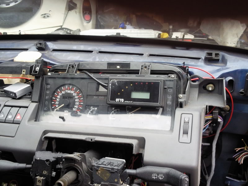

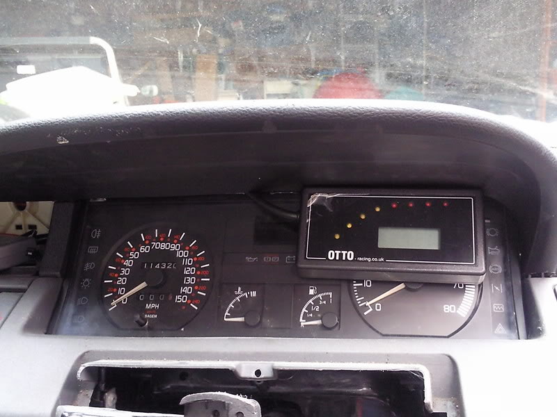

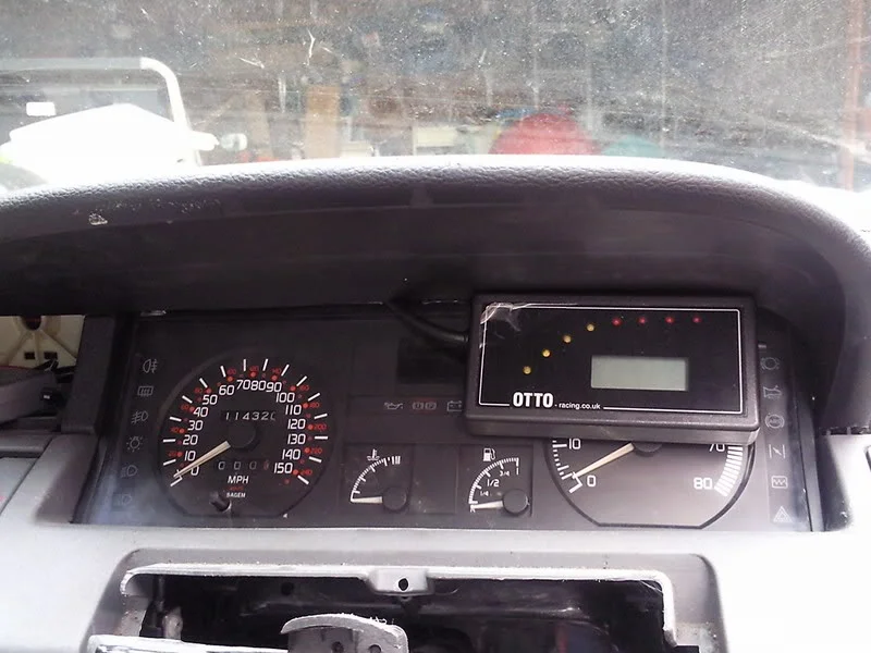

after i had tested the fan temp controller i turned my attention to my new otto-racing rev counter, a quick read of the instructions it seemed like a doddle to wire up, even for an electrical noob like me :oops:
so about 15 mins later i was done
i have attached it over the stock rev counter with no more nails, making sure i didnt obstruct any warning lights etc needed for the mot, fit perfectly, another ghetto mod 8)
and after setting the led's up where i want them, i took a quick vid
i am well and truly impressed with this piece of kit, well made, easy to install, some good functions on it too, like maximum rpm recall, wiring for an external shift light and lap timer switch input.

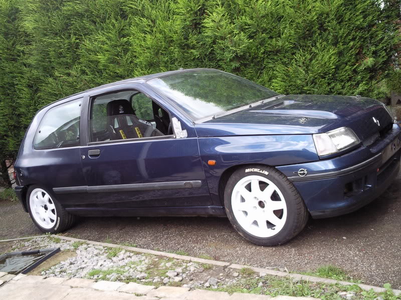

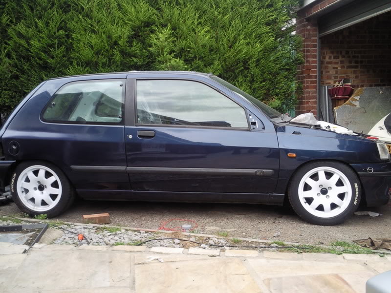

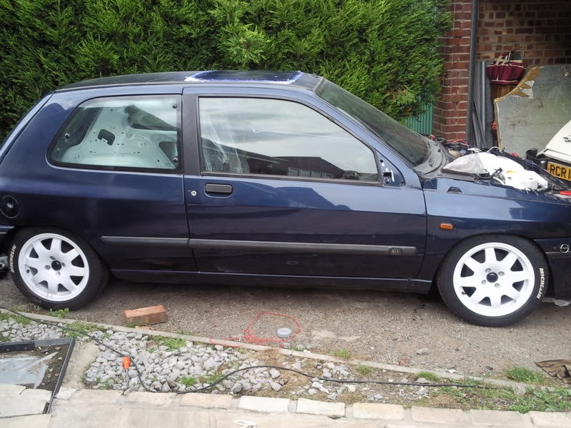

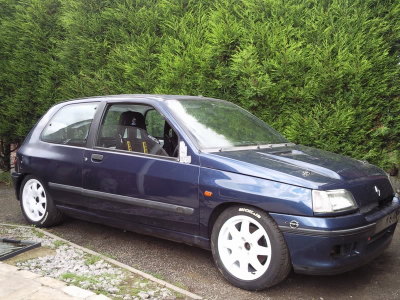

and with my new phone i took a couple of overall pics of the car, now with black centre caps

You know what I love most............ the white writing on the tyres.
Fully old skool cool

Youd never know that the rev counter wasnt standard ;)
However Im liking the fat its easy to do, may get one of them for the ol' turbo if teh price is right!
  F4R'd ITB'd '92 cup racer
Re: My mk1 track car blog
cheers for all the comments guys :D
lmao yeh got that 'factory fitted' look hasnt it :cool:
i was gonna piss around and flush mount it and make it look neat and tidy, but why spoil the habit of a lifetime and start paying attention to detail now? :rasp:
oh and it was £69, billy bargain if you ask me!

This is awesome progress fella and it's so good to see an overall view of the car it looks so sweet and purposful. As Cookson said the tyres are such a touch!!! Keep it coming mate so i can have a good ok round it at trax.

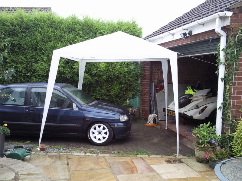

right bit of an update, didn't take many pics as i just forget when i'm busy
this was the setup for doing the cambelt, did the job and kept us dry, tried to blow away a few times!

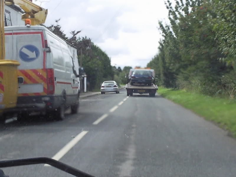

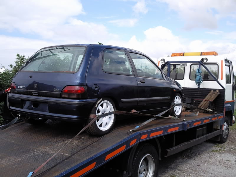

then with the cambelt done it was time for the clio to come home, not sure if you are aware but i have been doing all this work on the gf's parents drive, some 40 miles away! so found a local recovery company and the journey began
sat on the drive ready to go
on the truck, good job i raised the front coilovers as the middle exhaust section scraped a little as it went on, all was good though
reversing down the street
and on our way
recovery driver was a legend, seemed really interested in the car, and i don't think i have ever seen a D reg truck go so fast :shock:
