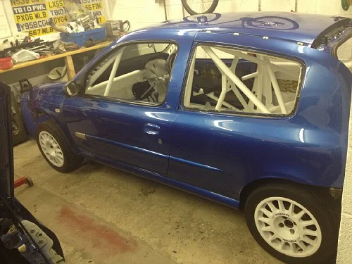

So after buying a tidy 172 cup to prep to race i saw Icemans caged shell for sale and decided to save my self some time and work and buy it instead of doing all the hard graft on my shell. Picked it up on saturday and after swapping all my running gear onto it in record time in Marks garage it was on the trailer.

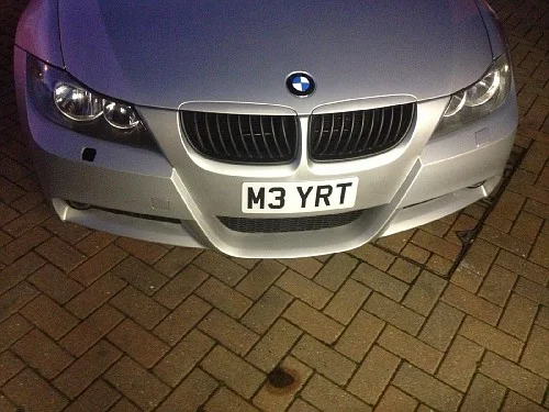

First things first, 10 points to anyone who can see what was missing from my 335d when i got the car back home!

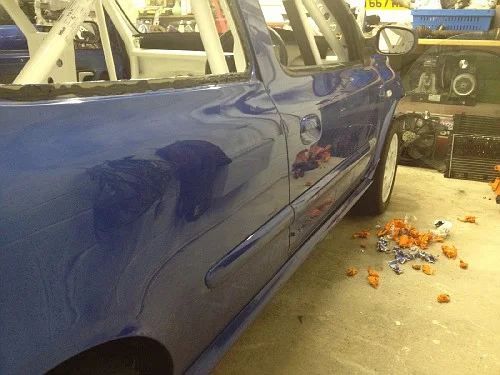

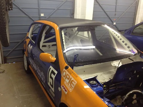

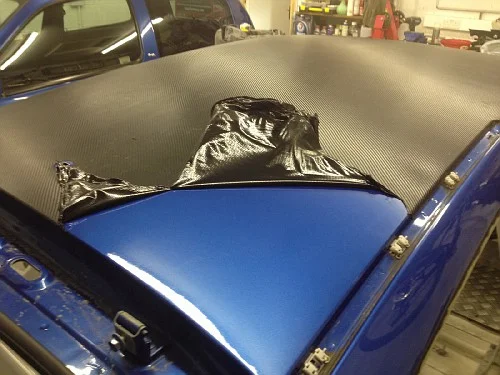

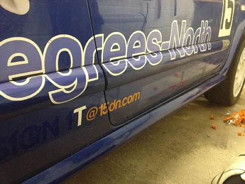

Anyway, wasted no time on sunday stripping all the graphics etc off the car. This is how it looked before i touched it.
In progress with heat gun!
One side stripped
And the rest

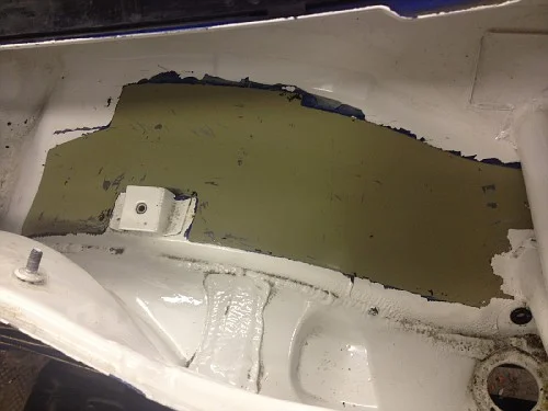

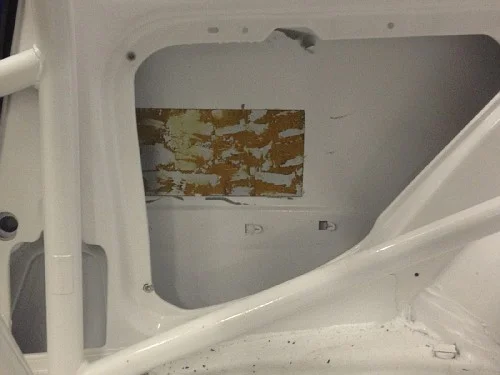

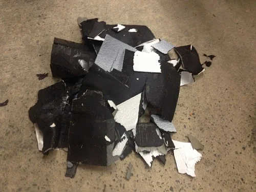

Next job was to remove any sound deadening that had strangely been left in the car, x2 bits under the scuttle, x1 bit on the drivers side inner wing and x4 bits on the inner 1/4 panels.
Tidied all the tar/glue residue off ready to be primed/painted.

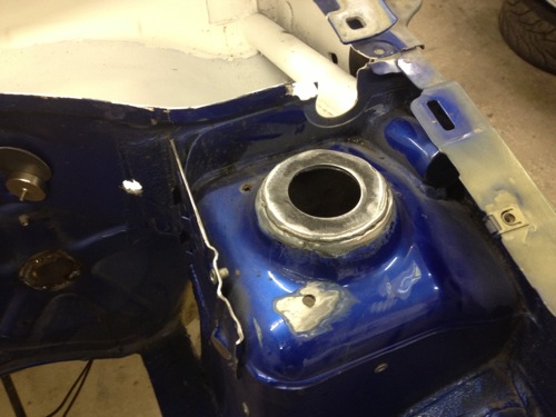

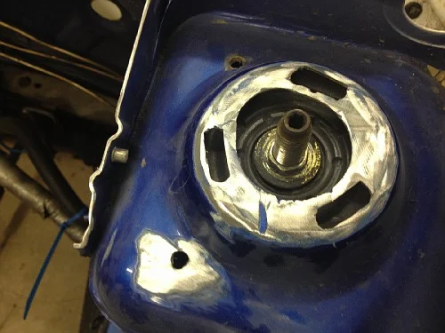

The plan was to prep the engine bay and get it primed up and painted Renault Glacier white. However the strut tops are a mess from previous bolt in top mounts i suspect. Measured up some plates to be cut out and i'll weld them on top to strenthen the strut top. Have buffed the paint off ready to weld.

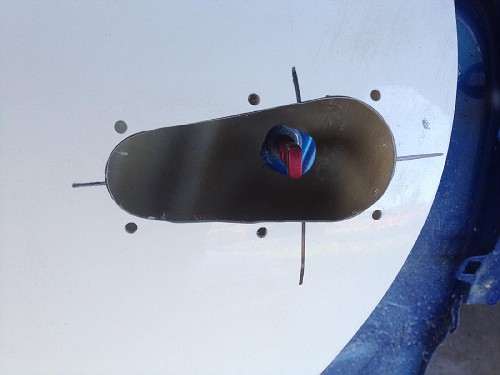

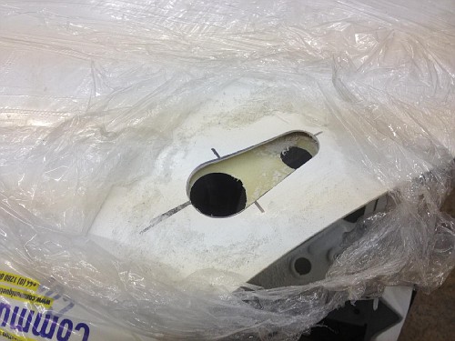

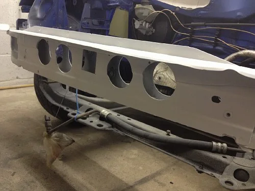

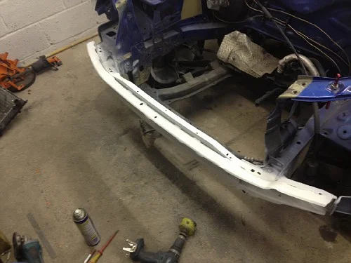

Added some lighteness while in the engine bay, dispossed of various unused studs and brackets and took a hole saw to the front cross member. At least that was able to be primed up.
Should get the welding done one night this week and hopefully have the engine bay and front under arches painted at the weekend. Subrame and pedal box is now off ready along with the arches and skirts. Plan is to have the whole car repainted Renault Glacier White in the next couple of weeks ready for me to start building it back up using all the parts from my 172 cup + have a set of Clio Cup Car Bilsteins here, have some fibreglass panels to pick up off Hal too. Will update more when i get a chance.

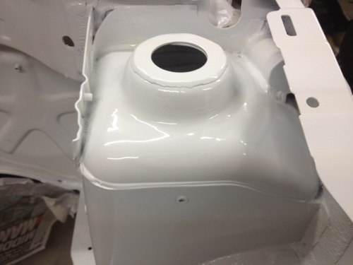

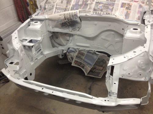

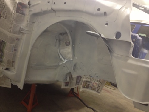

Been mostly trying to get the engine bay sorted and painted.
Strut top plates cut out and welded on.

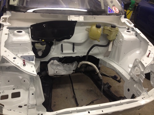

Also filled all the holes in the bulkhead and anywhere else i saw fit. Whole engine bay was then rubbed down and primed, given a couple of coats of Glacier White and then a couple of coats of laquer for good measure. All under the arches etc was also primed and painted.
Looks ok i think, however my garage and everything else is covered in dust/overspray.

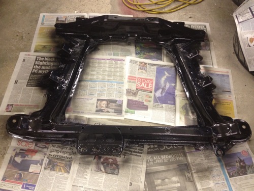

Also cleaned my subframe up, rubbed it down and painted it satin black just to tidy it up a bit.
With everything painted up i could get on and start putting some bits back on the car. Subframe with rack and arb are back on along with the pas resevoir and coolant bottle.

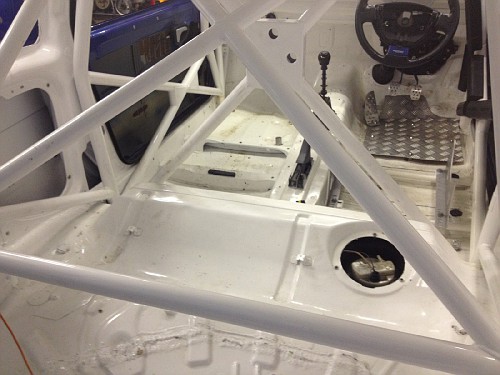

The best pic i have of the white is this one
Not the best but gives you an idea.

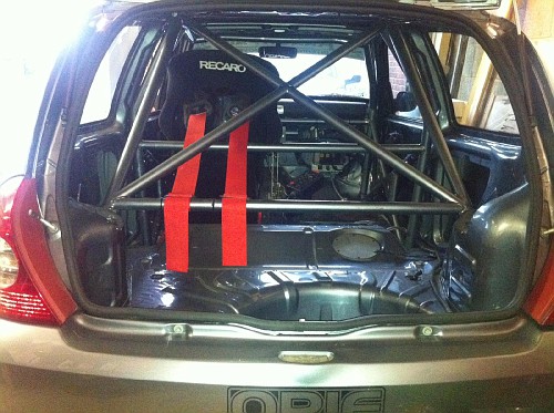

2 better pics of the anthacite inside
If i was building from scratch i'd go for grey, looks fresher for longer, white gets grubby quickly on a race/track car.

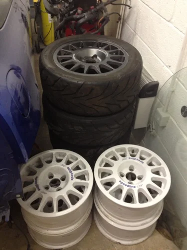

Not updated for a while, bought a couple of bits for it, notably some more 2118 speedlines with R888's, i now have a set of both white and anthacite.

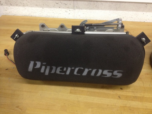

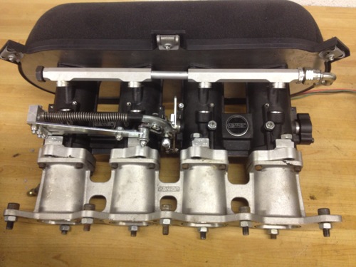

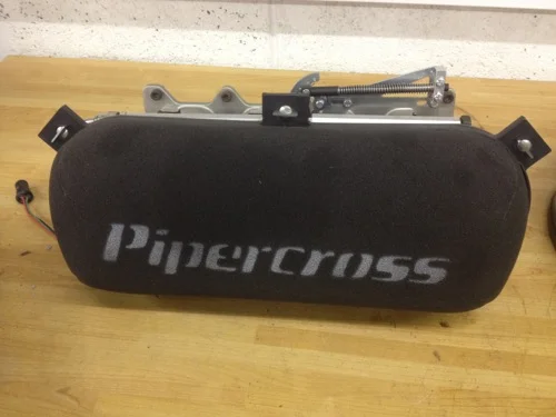

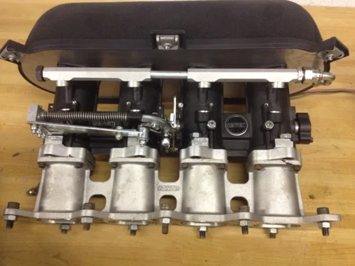

Also managed to bag a set of used Jenvey Throttle bodies that have only done dyno time, came complete with everything, filter, TPS, lingage, manifold etc.

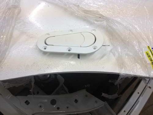

The main focus however has been getting the car ready for paint, externally its all stripped down with everything removed. Had to fit my aerocatches to the fibreglass bonnet and boot, or at least cut it all out ready for fitment after paint. Fibregalss was very easy to work with, i'm going to use the new aerocatch spreader plates so had to trim the underside of the bonnet to suit, hopefully on the boot i can put the plate through the hole i've cut and bond it in so it stays cpative and avoids me having to hack the rear of the boot to pieces and keep it tidy. A dremmel is definately the ideal tool here.

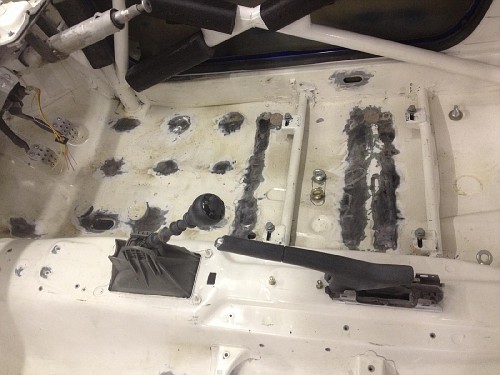

I wasn't intending to touch the inside but the quality of the paint and prep was really bugging me, nearly 20 holes drilled in the footwells and the old drivers side seat mounts butchered on removal had to be sorted. All the holes were welded up and buffed off and the seat rails removed properly.
Obviously this now means i've got paint to do inside so more cost and hassle but it'll be worth it. Its now at the painters and it'll be back in a week to 10 days all resplendant in Renault Glacier White. Last pic of it before it went on the trailer this morning.

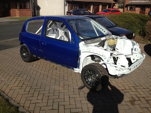

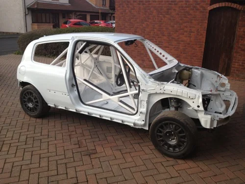

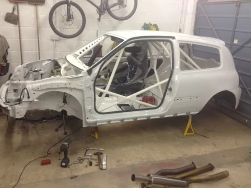

Its been a while but I've got the shell back from paint, looks pretty good, just need to pick my panels etc up and start building it back up. No metal panels to go back on now, boot, bonnet and doors are all fibreglass so should bring the weigh down a bit.

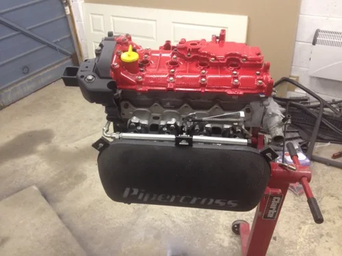

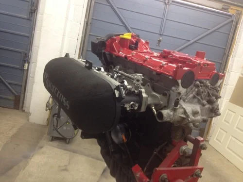

Managed to get the engine built up while the shell has been away, Cat 421 cams fitted along with arp rod bolts. Various gaskets and seals added as necessary along the way, obviously a lick of paint too. Still a bit paranoid cams aren't fitted/timed up correctly but i'll double check before the engine goes back in. Test fitted the bodies to see what the looked like really!

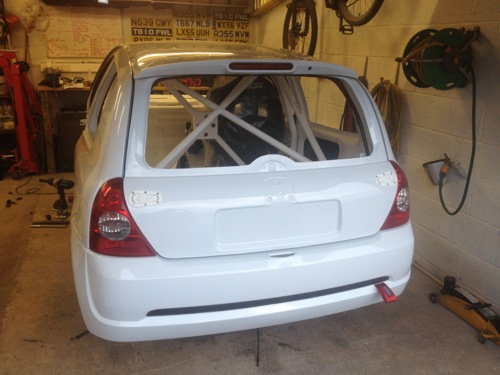

Not a massive amount of progress to show but now have a lot of parts so hopefully should go a lot quicker from here on in.

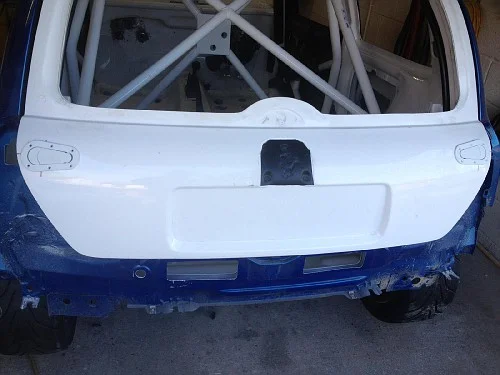

Rear end is built up, fitted the rear bumper, tow strap and fibreglass bootlid with spoiler.
Waiting on my poly windows coming from Plastics4performace and acw and they can all be bonded in along with my heated front screen which is sat here ready to go in. Fitted the drivers side fibreglass door which was a pain to get lined up, left the passenger onbe off for now for access so i can finish the wiring etc off inside the car.

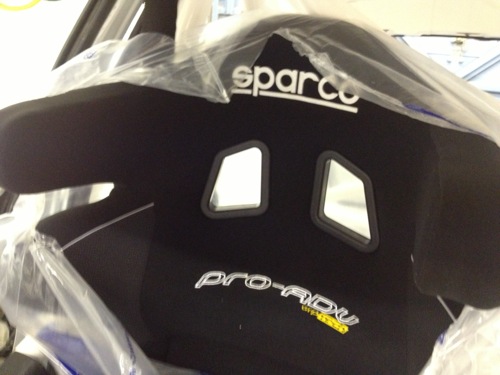

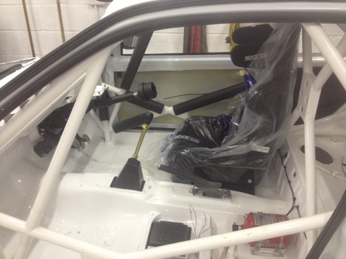

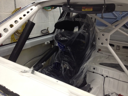

Had a trip to Demon Tweeks at the weekend to try out a few seats, settled on a Sparco Pro ADV in standard width. Had it in the car but i need to make some adapters to bring the seat back as far as the cage will allow.

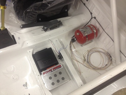

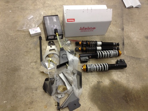

Bought a few other things from Tweeks too, a Lifeline electrical fire extinguisher system, cartek battery isolator and a TRS 6 point harness. Got the extinguisher bottle and battery cutoff fitted along with my battery i already had, all in the passenger footwell along with my new fuse/relay box.
Also bought in the last week a load of bits from Pure Motorsport, along with the shifter from the group buy on here i also went for all the solid bearings and strengthening kits for the front wishbones and rear beam. While on my travels i called in to see Chris (Crispy Clio) and took his AST Sportline 2's off his hands, funnily enough they were fitted to this shell when mark had it too?

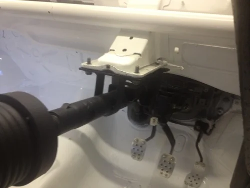

Managed to get my seating position roughed out, modified column fitted with a proper bracket.
Got the pms shifter fitted too, at least the internal parts anyway, no engine/gearbox fitted yet so didn't bother with the linkage bar obvously.

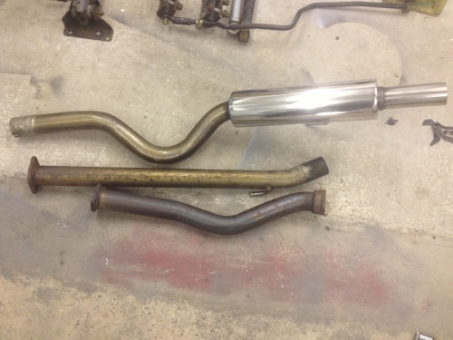

Last but not least picked up a used Oreca Group A system, front pipe will need modified to fit my 182 manifold but thats no big deal. For those that havent noticed i'm using a 182 flatfloor shell but i've converted it back to 172 rear bumper and exhaust to save some weight over the 182 system.
