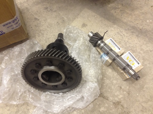

Small update. Gearbox has gone away to my gearbox guy to be checked over and rebuilt as necessary. Sent him a box with afew other bits in too, notably a Gripper LSD and 13/59 crownwheel and pinion + a shorter 5th gear set.

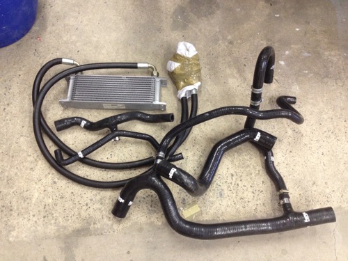

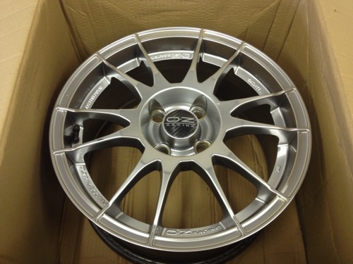

Also bought some more bits from Chris (Crispy Clio) as he was breaking his car, already bought my AST's from him and now have his OZ Ultraleggeras, Forge coolant hoses with heater matrix bypass, oil cooler kit and an AX wiper kit that i've been looking for for a while.

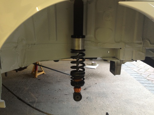

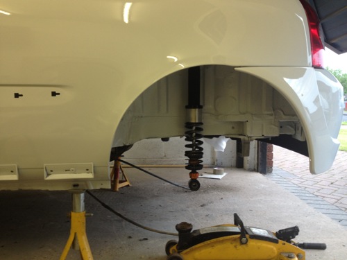

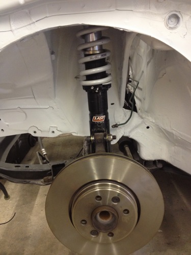

Tidying up some loose ends, painted under the rear arches in body colour, means the whole shell inside out and underneath the arches is in Glacier white now. Fitted my rear coilovers after the paint was dry.

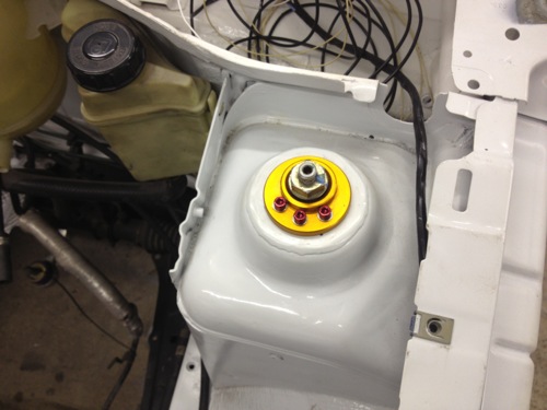

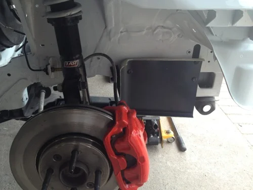

Got my front struts fitted too along with the hubs, including new wheel bearings and Brembo HC discs. As much camber as i can get with smaller diamter bolts in the hub and top mounts to max caster. Give me a base to start from when setting it up.

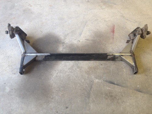

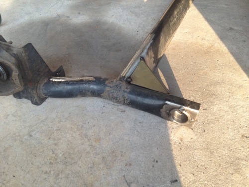

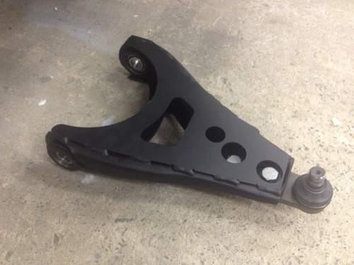

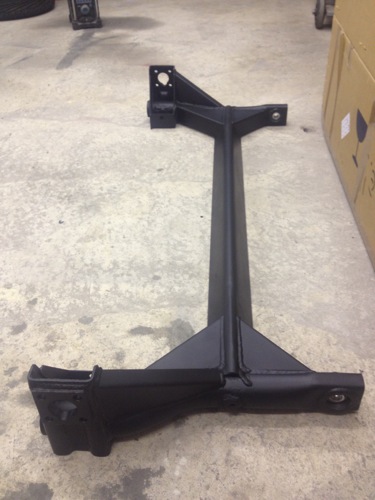

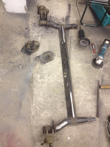

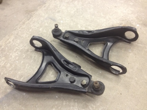

Rest of the focus this week has been on fitting all the Pure Motorsport suspension bits, front wishbone bearing kit and strengthing plates + new balljoints and the full rear strengthening plate and bearing kit. Got the front arms stripped of the original bushes first before buffing the powdercoat off them ready to weld up.

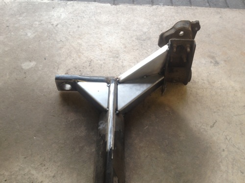

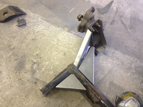

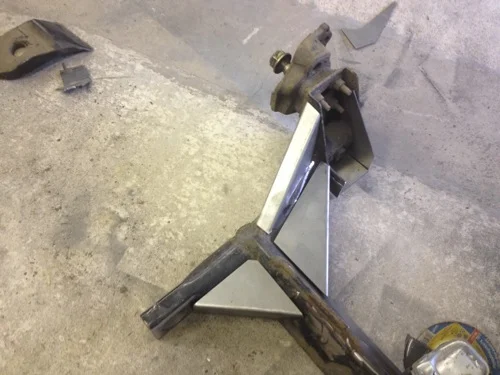

The intention was to get these done first but i need to press the pure motorsport collars back in the arms, as they're so tight, before i can weld them so moved onto the rear beam. Got it stripped down with the bushes out and removed all the original mounts and spring plates with the trusty grinder.

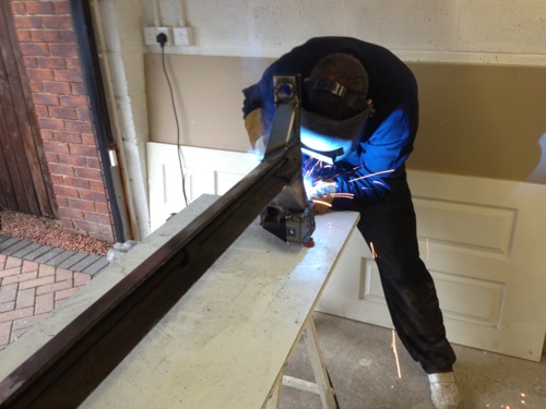

Just got the bearing housings tacked in for now, need to fully weld them up.

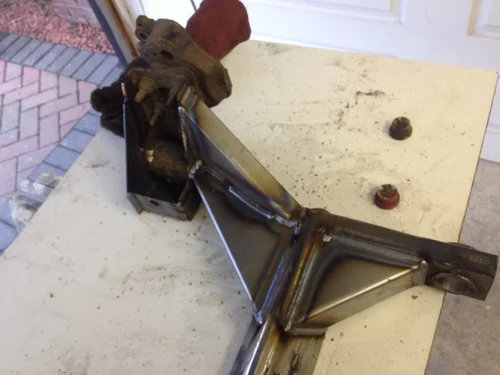

Its a pretty involved task fitting the full kit but hopefully will be worth it when its all built up and painted and back on the car. Got all the plates tacked in first with some minor mods.
Managed to get one side all completely welded. See my tame welder Andy in action!

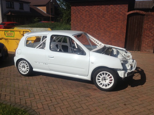

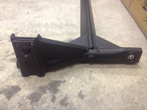

Thanks for the comments guys, got some more bits done this week. Finished the suspension bits off, gave them a lick of paint and pressed the bearings in etc.

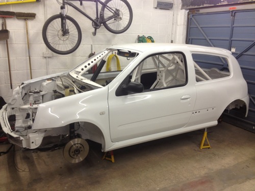

Also got the rest of my bodywork fitted, both fibreglass doors from CM Composites and my front wings, skirts and door mirrors etc, it actually looks like a car again!

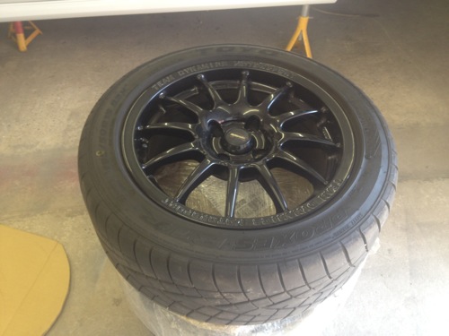

Also bought another set of wheels set of ET38 Pro Race 1.2's with Toyo R1-r tyres, hopefully use these for wet/damp running.

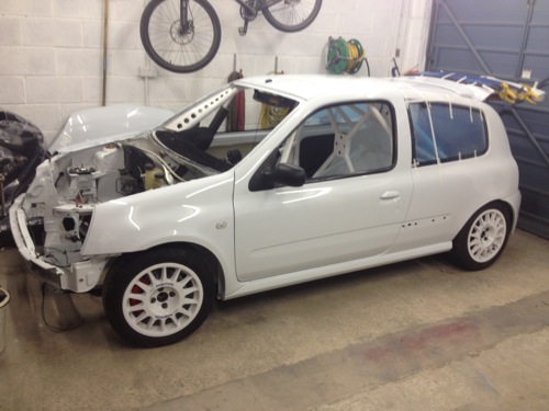

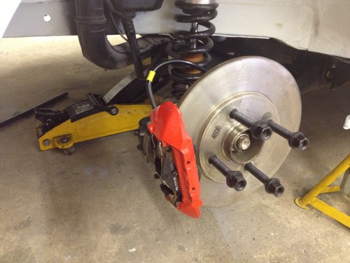

Today i managed to get all the suspension and brakes refitted and got it back on its wheels for the first time in ages, all new discs and pads fitted along with my rear camber shims/spacers that ive had sat here for a while. Measured up for the new rear brake lines too that im going to have made up in flexi. Pushed it outside and gave it a wipe over as it was looking a little grubby.

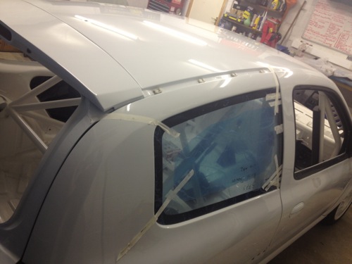

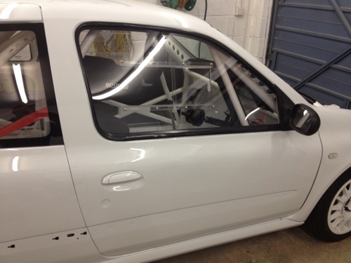

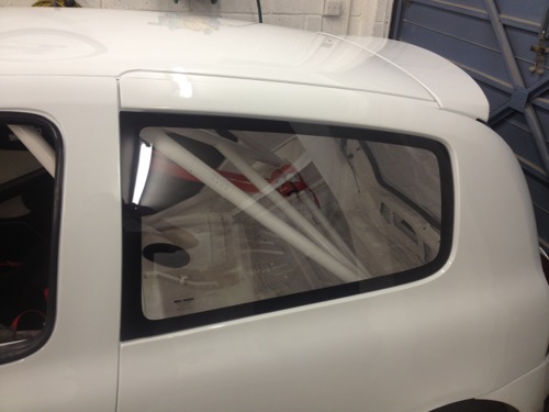

Also started fitting my polycarb windows, just done the drivers side rear 1/4 for today will finish them tomorrow night and get my seat, harness and steering wheel back in.
With a bit of luck my gearbox will be back this week so there's nothing stopping me getting the engine and 'box back in the car so really making progress now.

Rear beam looks class. Can't decide whether to go this route and get rid of the whiteline ARB. Looking forward to hearing how you find it at the limit!

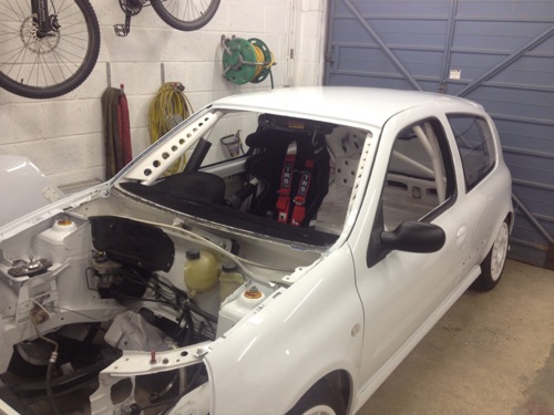

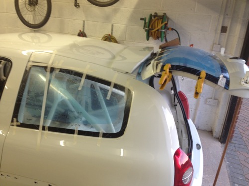

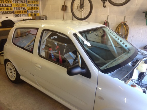

Some more bits done today/yesterday. Got the rest of the rear windows fitted.
Got my seat and harness fitted properly too.

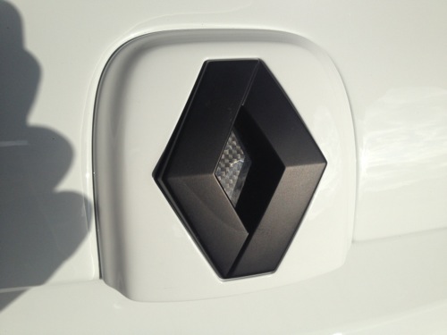

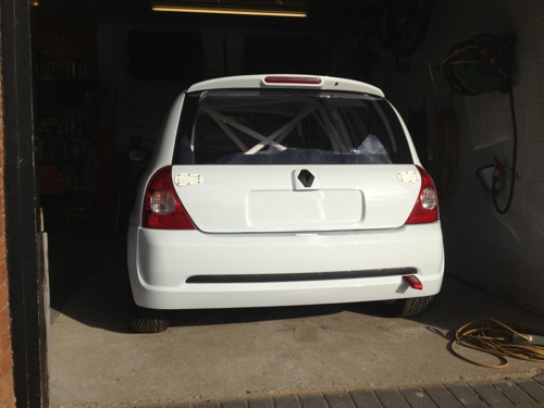

Couple of little bodywork details, been waiting for my boot handle to be painted so i fitted that to the boot lid, because its a fibre glass boot and i have no boot release button in the middle of the diamond i made a blanking plate out of some carbon i had lying around. Looks pretty good.

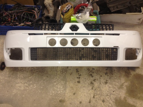

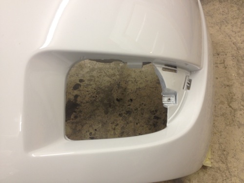

Also got my bumper back from paint as its been with Chris at CM Composites been used to trial some brake ducts that are nearly ready for production, i modified the bumper to allow fitment of the cup racer ducts + added some holes for cooling that actually match the holes in the front cross member.

Hopefully by tomorrow evening I should have some bits ready to go into those bumper holes for you ;-)

Everything else is pretty much done, carrying on from last time all my windows are now done, heated windscreen fitted and front side windows fitted.

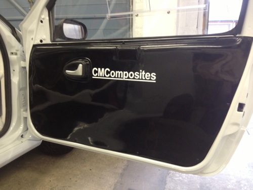

Once the front windows where done i could fit a set of Chris's front door cards.

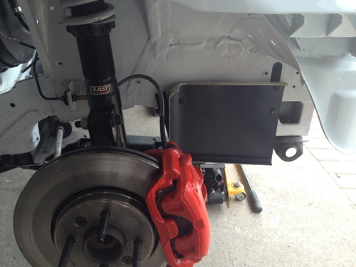

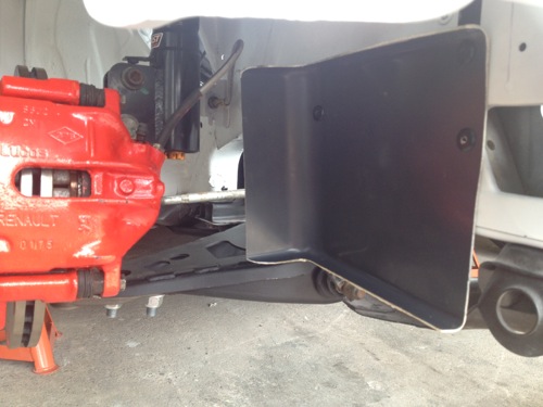

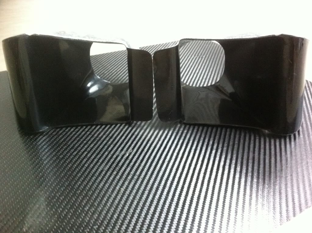

While on the subject of brakes i fitted my brake duct deflectors after a lot of messing about, had to trim them down and generally just keep trial fitting them and tweaking their position. Hopefully they're somewhere near now.

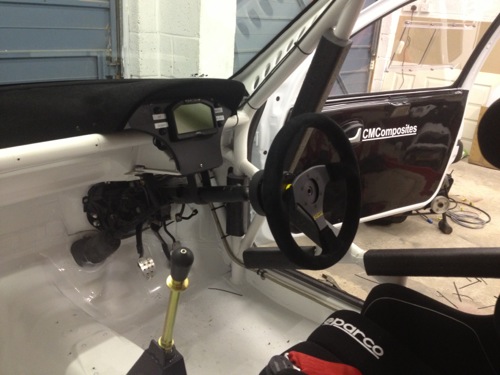

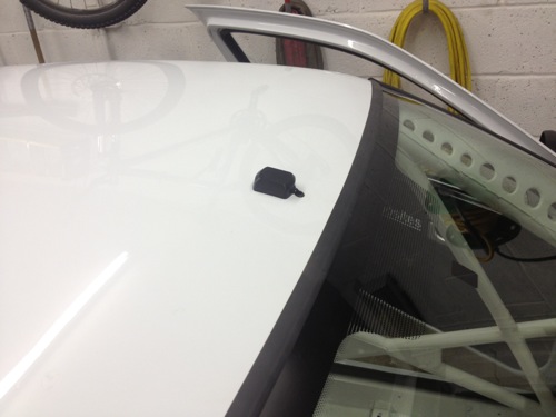

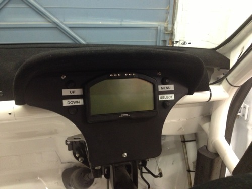

Leaving most of the wiring until the engine is in but thought i'd fit the Dash2 Pro and its associated bits and pieces, fitted the dash and buttons to the dash plate and wired them all in. Also fitted the GPS antenna, its magnetic so that helps and the Go-Pro interface cable. Once datalogging is started it starts the go-pro recording too so all the data is synced with the video which is cool. Once the wiring was done i fitted the dash top, think this is the only piece from the car that has survived from the previous owner! Its a Mk1 clio dash top that has been flocked for those wondering.

Looking awesome Russ :) I would suggest having an up or down button for the dash within reach while harnessed in as then you can do page changes to see other parameters.

Thanks James, I can just about reach the buttons if i need to. The theory is that while racing i wont be touching it anyway, as long i can see the basics i'm happy. The less to distract the better!

Fair enough Russ :) just like last year in quali at donny I could scroll between screens when the car failed to pin point the issues. Look forward to seeing this in action! What are your plans? Testing this year or straight into racing? If so what series?

Yeah just about mark, in fairness i'm 6'2" and i'm limited by how far i can go with my seat due to the cage so i can't sit as far back as i want so can still reach the dash buttons. The buttons only scroll through the dash menus etc anyway, all of my other controls will be more local for ease of use.

Looks great Russ. And yes the genuine brake ducts are shocking the passenger side (at the tip) is about 5/10mm shorter than the drivers side.
Just like you i didn't like how they fitted and extended it to make it the same length so it looked the same as the drivers.

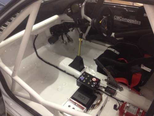

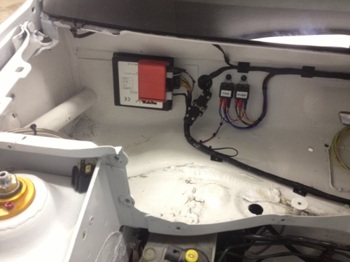

Anyway, i've been trying to get the car totally finished bar putting the engine and gearbox in so all the wiring had to be finished. It probably wont please some on here that there are no Deutsch or MIL spec contectors or fancy overbraid but its tidy enough for now and is functional. First up i made my switch box/panel with all the required switches and buttons in to sit down by the handbrake.

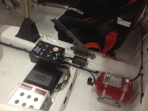

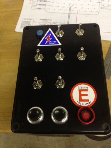

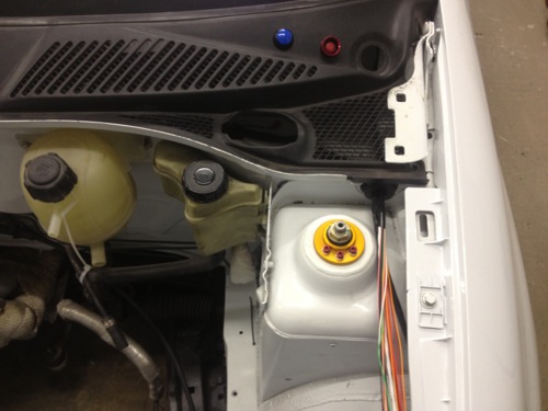

The scuttle was made up with the extinguisher and cutout buttons fitted and wired on plugs for ease of removal. You can see the engine loom ready to connect to the engine once in.
The ecu and wideband controller are under the drivers side scuttle along with relays for the fan and fuel pump.
All fitted and wired inside along with the battery, fuse box and extinguisher with control. Not powered anything up yet, only testing the extinguisher system and all is well so thats a good start, just need to position the nozzles next.
Looks pretty clean and tidy when its all sorted, need to give the inside a good hoover out though as theres swarf and wire clippings everywhere!

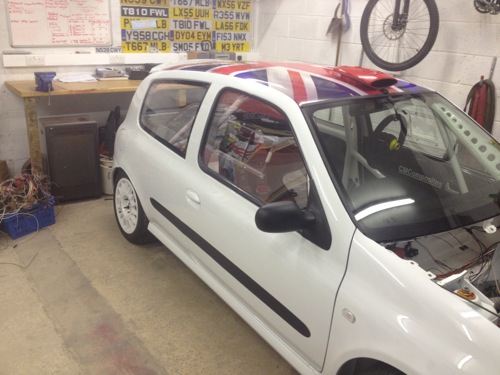

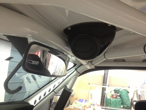

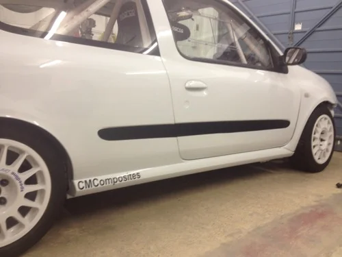

Got my mate to do me a few stickers this week as well while he was passing. Done my 'side moulding' stickers in satin black and wrapped the roof as you can see. I also went for one of Chris' (CM Composites) Clio Cup III roof scoops as i know how hot race cars get and the guys running them already say they help out a lot. Really nice bit of kit with the internal pod and vents that i hadnt seen a picture of beofre i got mine, nice tidy job. I gave the scoop a coat of Peugeot Cherry Red which will match my Ultraleggeras when i get them painted.
