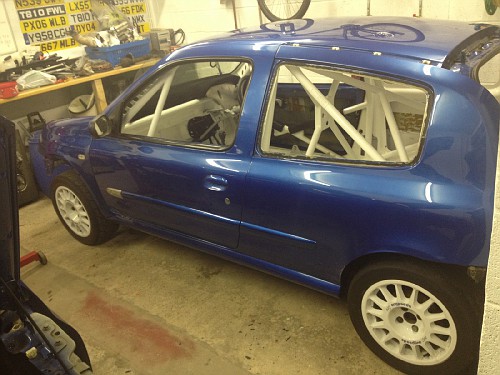

Anyway, wasted no time on sunday stripping all the graphics etc off the car. This is how it looked before i touched it.
In progress with heat gun!
One side stripped
And the rest

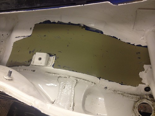

Next job was to remove any sound deadening that had strangely been left in the car, x2 bits under the scuttle, x1 bit on the drivers side inner wing and x4 bits on the inner 1/4 panels.
Tidied all the tar/glue residue off ready to be primed/painted.

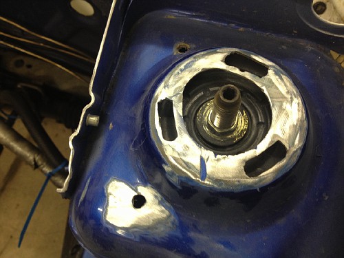

The plan was to prep the engine bay and get it primed up and painted Renault Glacier white. However the strut tops are a mess from previous bolt in top mounts i suspect. Measured up some plates to be cut out and i'll weld them on top to strenthen the strut top. Have buffed the paint off ready to weld.

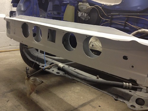

Added some lighteness while in the engine bay, dispossed of various unused studs and brackets and took a hole saw to the front cross member. At least that was able to be primed up.

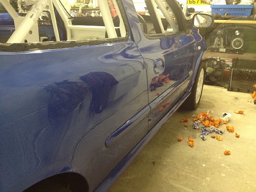

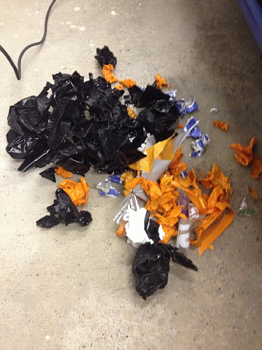

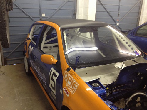

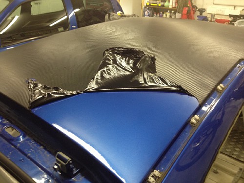

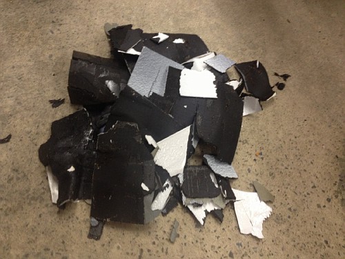

One side stripped
And the rest
