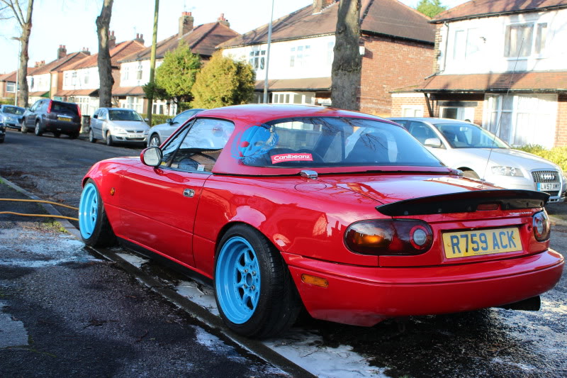

Looks brilliant mate. Love that rear spoiler, goes well with the splitter.

Tom the spoilers a KG works one, mx5parts sell um.

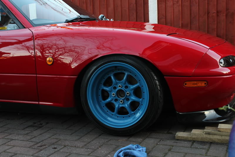

what offset and size are your wheels guys? my 14's are depressing me to oblivion.....as well as the frigging open diff :(

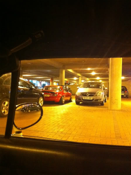

I'm sure it was you I parked near on friday night at asda trafford park? ;)
I think that's probably quite likely! I didn't see your trophy though :( ... out before I was perhaps?
Your car was gone when I got out. Wasn't 100% sure if it was you as the paint looked in good condition :eek:, Wheels looked the same though.

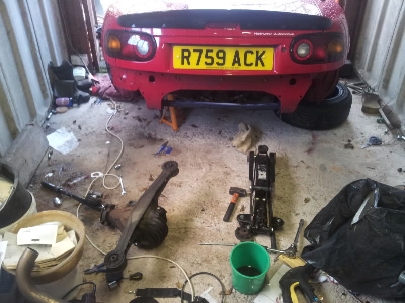

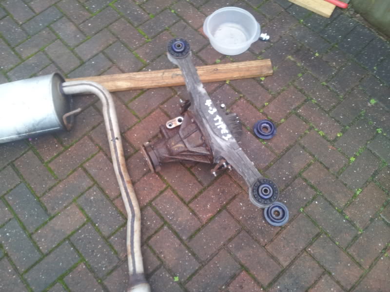

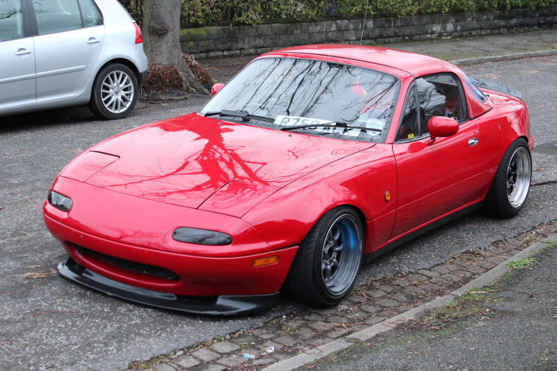

Nice update, After months of hating driving my own car i finally changed the thing i hated most on it. The diff. Now as an ambassador on here for welded diffs I feel I should explain.... The skipping wasn't a problem, the odd handling wasn't a problem. However the welding was. The welds wouldnt ever break due to the way they were done, but there was excess weld on where the driveshafts go in, meaning that the drivers side was never in properly, this also gave off a very very odd squeal at times and meant that i had to top up oil twice a month, So I bit the bullet, read up on torsens and what suited me best. Decided on a 4.1 type 1 after reading the gear ratios and that the type 1's are a bit more "old school" in there delivery. So I ordered off junkyard dog and it arrived on friday, I started at about 12 oclock in the afternoon and finished at about half 6 which wasn't too bad seeing as I did it all on my own, and the greatest difficulty was getting the stub shafts that the diff was delivered with out.
Needless to say due to the stress and time constraints i Only took two pictures but whilst I was out there I made more effort with my diff void fills and what wonderfull things they are :). They probably will be replaced in the future for proper diff mounts but we shall see :)
Needless to say my god it feels so nice now and actually handles well again, Whether it drifts well or not is yet to be seen but for now its fine for me.

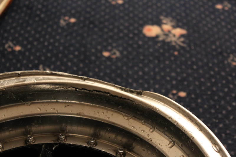

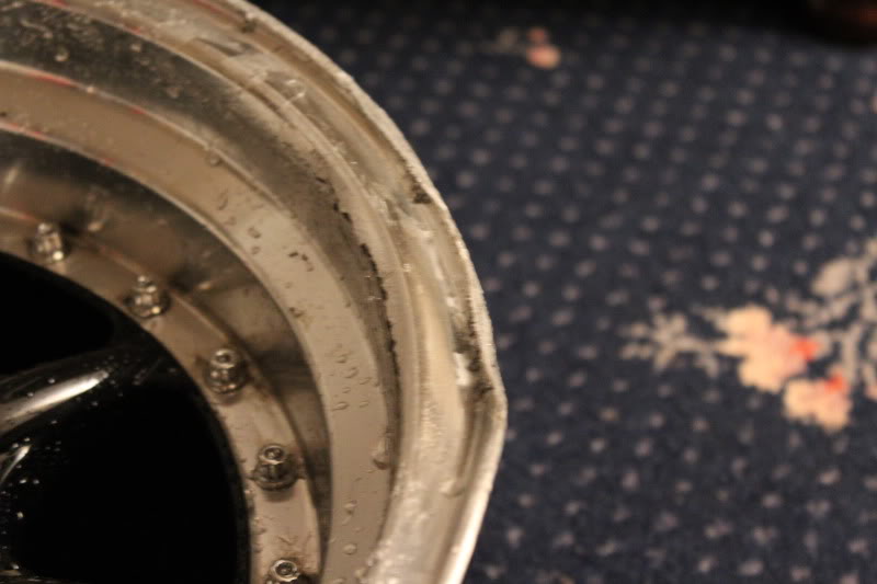

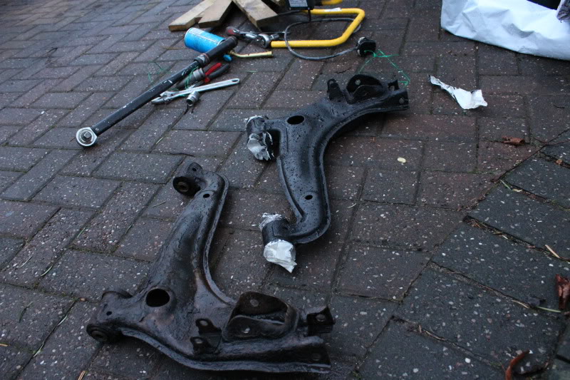

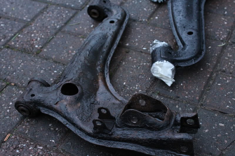

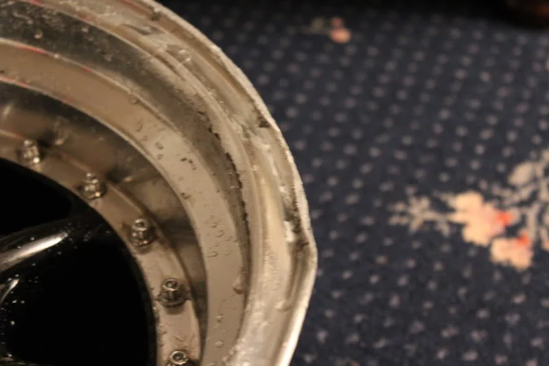

So last friday I cleaned the car, then went go karting, then crashed it. The term handles like a go kart is porkies.
I managed to bend a wheel a wishbone and a droplink,but wasn't even doing 30, god this cars made of cheese.
said wheel.
So I swapped the wheel over and adjusted the toe all they way in so it wasn't tooooooo bad, then posted a wanted thread on here to which "indykid" replied, being the true gent he let me pick up two polybushed wishbones on saturday night, So we headed down and he even threw in a track rod end like a true gent.
So as the car sat on sunday morning, take note of the one grey wheel as thats the colour i wassss going to do them but it didnt go to plan.
managed to do the bent side however the straight side alignment bolts were truely goosed so i left that until i get more alignment bolts.
bent wishbone though.

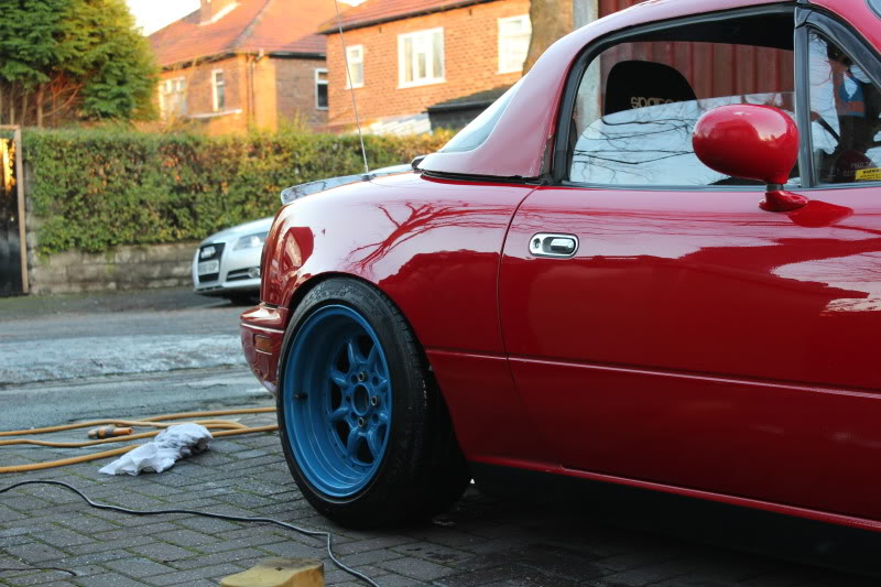

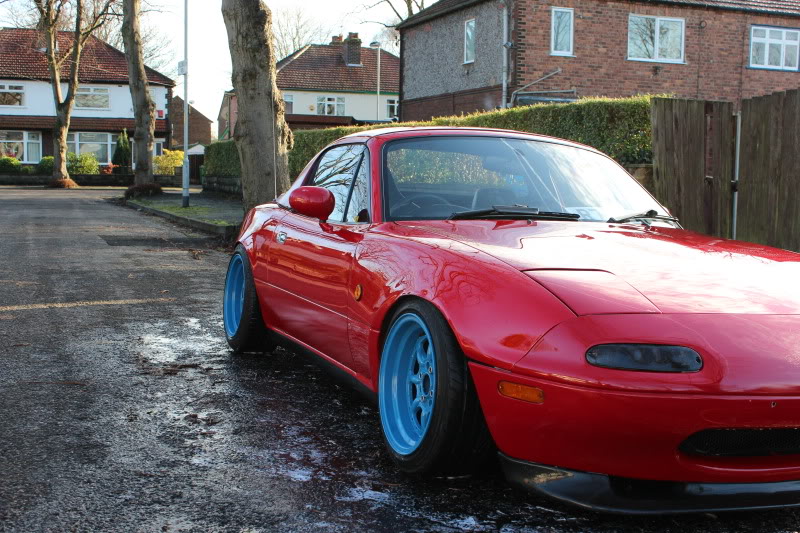

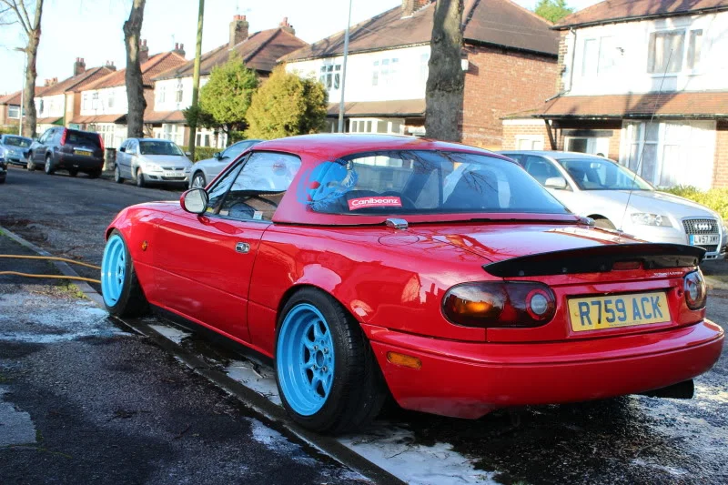

Then it was time to refurb the wheels but halfords only had one can of toyota decuma grey as above so I went for a risky option but I quite like it, it is very temporary though. I washed it today and this is how its sat.

Hawsome, I wouldn't think the red and blue would work but I really like that. Shame on stacking it, I drove over a roundabout in mine but luckily caused no damage.
Feel free to buy my pretty much new bronze Rota Grids ;)
Gally
It looked so good. Seb that colour has ruined the total look of the car. :(
Makes me sad.
Gally
I missed the temp word. :eek:
It's actually one of my favourite cars on here.

Wheel colour will probably be permanent, however il be changing the wheels when I see something else I like.

Looks awesome with the blue, as I said on Facey. Keep 'em Blue IMO.
