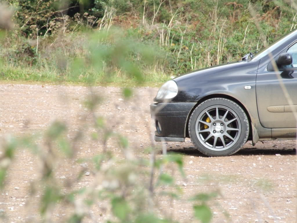

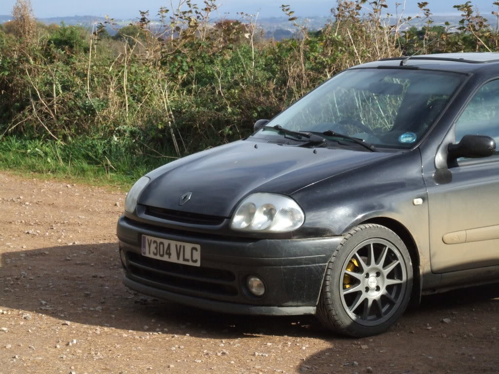

For some reason it didnt show the nice pics of the new car at the top so here they are...
