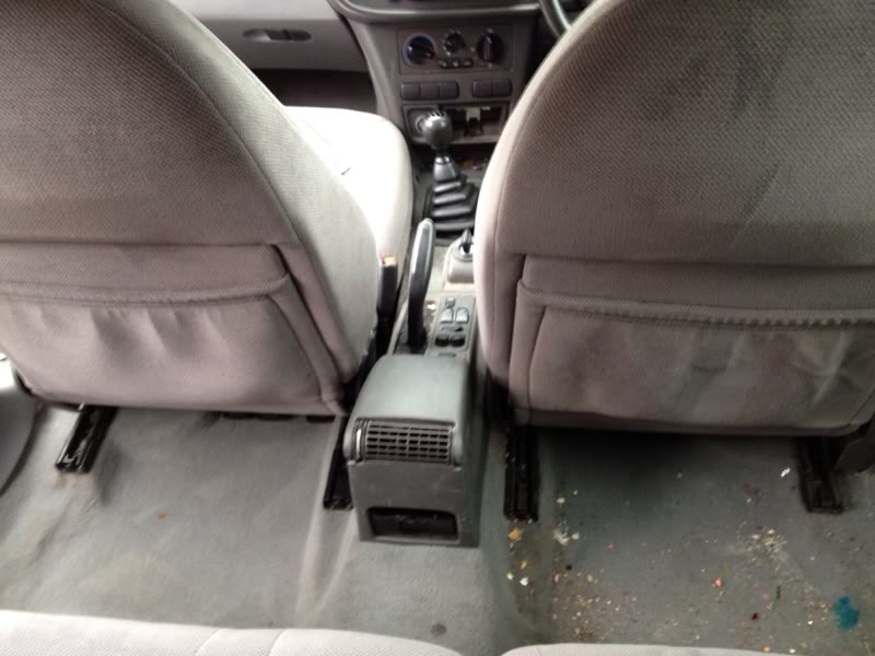

First thing to do was to clean out the inside, there were mats but they were past being ruined so got them out and was left with this
This was under the back seat, and having seen the rest it was actually better than I expected!
Halfway through the back
And finished
Used a lot of AG interior shampoo with a stiff brush and the hoover but I think its come up very well for its age, mileage and use!

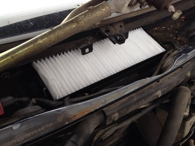

Having read the saab forums it seemed that the fan motor was the most likely culprit which involved removing the wipers and scuttle panel to get to it. Then I saw the pollen filter. The original pollen filter. So I put gloves on and removed it! I couldn't put it back on in this state!
So anyway, tested the fan and it worked fine, all the wiring was good so then checked the switch which I had seen no mention of being an issue. Of course that was the problem! I managed to bodge it together so I could at least have 2 speeds, on or off!
Before putting the scuttle back together I had to go get a pollen filter but as I was buying a service kit anyway it wasnt much hassle.
Side by side you can really see the difference
and the new one fitted

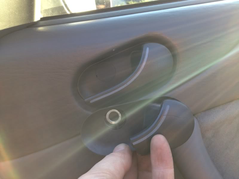

So firstly I changed the drivers door handle and you can see why! God knows how he broke it, its metal all the way through!

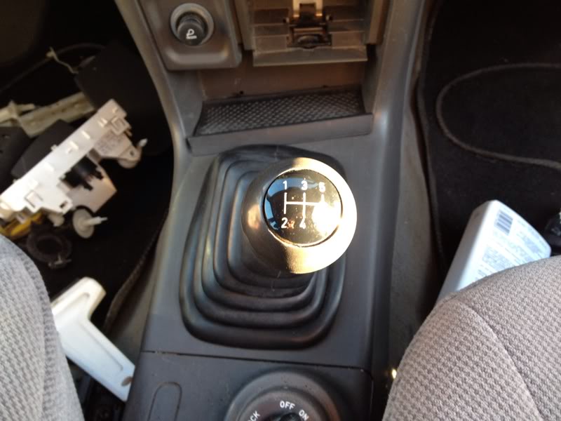

The gearknob span round at will and could come off in your hand so changed that
And finished
